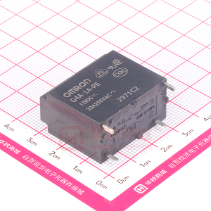

Power PCB Relay G4A Miniature Single-pole Relay with 80-A Surge Current and 20-A Switching Current • Ideal for motor switching. • Miniature, relay with high switching power and long endurance. • Creepage distance conforms to UL and CSA standards. • Highly noise-resistive insulation materials employed. • Standard model available with flux protection construction. • RoHS Compliant RCX VDE Ordering Information Classification #250 tab terminals/PCB coil terminals PCB terminals/PCB coil terminals SPST-NO Contact form G4A-1A-E G4A-1A-PE Model Note: When ordering, add the rated coil voltage to the model number. Example: G4A-1A-E DC12 Rated coil voltage Model Number Legend G4A 12 34 DC 5 5. Rated Coil Voltage 3. Terminals 5, 12, 24 VDC None: #250 tab/PCB coil terminals P: Straight PCB/PCB coil terminals 4. Special Function E: For long endurance 1. Number of Poles 1: 1 Pole 2. Contact Form A: SPST-NO Specifications ■ Contact Ratings Rated load Rated carry current Max. switching voltage Max. switching current Max. switching capacity Min. Permissible Load (reference value - see note) Note: P level: λ60 = 0.1 x 10-6/operation 20 A at 250 VAC 20 A 250 VAC 20 A 5,000 VA 100 mA at 5 VDC Power PCB Relay G4A 221 ■ Coil Ratings Rated voltage Rated current Coil resistance Coil inductance (ref. value) Armature OFF Armature ON 5 VDC 180 mA 27.8 Ω ----70% of rated voltage max. 10% of rated voltage min. 160% of rated voltage at (23°C) Approx. 0.9 W 12 VDC 75 mA 160 Ω 0.8 H 1.1 H 24 VDC 37.5 mA 640 Ω 3.5 H 4.8 H Pick-up voltage (max.) Dropout voltage (min.) Maximum coil voltage Power consumption Note: 1. The rated current and coil resistance are measured at a coil temperature of 23°C with a tolerance of ±10%. 2. Operating characteristics are measured at a coil temperature of 23°C. 3. Max. permissible voltage refers to the maximum value in a varying range of operating power voltage, not a continuous voltage. ■ Endurance With Motor Load Load conditions 250 VAC: Inrush current: 80 A, 0.3 s (cosφ= 0.7) Break current: 20 A (cosφ = 0.9) ON:1.5 s OFF:1.5 s Switching frequency Electrical endurance 200,000 operations With Overload Load conditions 250 VAC: Inrush current: 80 A (cosφ= 0.7) Break current: 80 A (cosφ = 0.7) ON:1.5 s OFF:99 s Switching frequency Electrical endurance 1,500 operations With Inverter Load Load conditions 100 VAC; Inrush current: 200 A (0−P) Break current: 20 A ON:3 s OFF:5 s Switching frequency Electrical endurance 30,000 operations ■ Characteristics Contact resistance Operate time Release time Max. operating frequency Insulation resistance Dielectric strength Vibration resistance Shock resistance Service Life 100 mΩ max. 20 ms max. 10 ms max. Mechanical: 18,000 operations/hr 1,000 MΩ min. (at 500 VDC) 4,500 VAC 50/60 Hz for 1 min between coil and contacts 1,000 VAC 50/60 Hz for 1 min between contacts of same polarity Destruction: 10 to 55, 1.5-mm double amplitude Malfunction: 10 to 55, 1.5-mm double amplitude Destruction: 1,000 m/s2 Malfunction: 200 m/s2 Mechanical: Motor load: Ambient temperature Ambient humidity Weight 2,000,000 operations min. (at 18,000 operations/hr) 100,000 operations min. (ON/OFF: 1.5 s) Inverter load: 30,000 operations min. (ON: 3 s, OFF: 5 s Operating: −20°C to 60°C (with no icing) Operating: 5% to 85% Approx. 23 g Note: The data shown above are initial values. 222 Power PCB Relay G4A Engineering Data Maximum Switching Capacity AC resistive load Electrical Service Life Electrical Service Life (x103 operations) 5,000 3,000 Switching current (A) AC inductive load cosφ = 0.4 1,000 700 500 300 250-VAC resistive load 100 70 50 250-VAC inductive load cosφ = 0.4 Switching voltage (V) Switching current (A) Dimensions Note: All units are in millimeters unless otherwise indicated; dimensions shown in parentheses are in inches. G4A-1A-E 30.5 max. (30.1)* 16 max. (15.7)* Mounting Holes (Bottom View) Four,1.8 +0.1 0 dia. 23.5 max. (23.3)* Terminal Arrangement /Internal Connections (Top View) (Bottom View) *Average value Tab Terminal PCB Terminal G4A-1A-PE 30.5 max. (30.1)* 16 max. (15.7)* Mounting Holes (Bottom View) Four, 1.8 +0.1 dia. 0 26.8 max. (26.5)* Terminal Arrangement /Internal Connections (Bottom View) *Average value Power PCB Relay G4A 223 Precautions Mounting When mounting two or more relays side by side, provide a minimum space of 3 mm between relays. Terminal Connection The terminals fit FASTON receptacle 250 and are suitable for positive-lock mounting. Do not apply excessive force on the terminals when mounting or dismounting the relay. The following positive-lock connectors made by AMP are recommended. Type #250 terminals (width: 6.35 mm) Receptacle terminals AMP 170333-1 (170327-1) AMP 170334-1 (170328-1) AMP 170335-1 (170329-1) Positive housing AMP 172076-1 natural color AMP 172076-4 yellow AMP 172076-5 green AMP 172076-6 blue Note: The numbers shown in parentheses are for air-feeding. 224 Power PCB Relay G4A Omron Electronic Components, LLC Terms and Conditions of Sales I. GENERAL 1. Definitions: The words used herein are defined as follows. (a) Terms: These terms and conditions (b) Seller: Omron Electronic Components LLC and its subsidiaries (c) Buyer: The buyer of Products, including any end user in section III through VI (d) Products: Products and/or services of Seller (e) Including: Including without limitation 2. Offer; Acceptance: These Terms are deemed part of all quotations, acknowledgments, invoices, purchase orders and other documents, whether electronic or in writing, relating to the sale of Products by Seller. Seller hereby objects to any Terms proposed in Buyer's purchase order or other documents which are inconsistent with, or in addition to, these Terms. 3. Distributor: Any distributor shall inform its customer of the contents after and including section III of these Terms. II. SALES 1. Prices; Payment: All prices stated are current, subject to change without notice by Seller. Buyer agrees to pay the price in effect at the time the purchase order is accepted by Seller. Payments for Products received are due net 30 days unless otherwise stated in the invoice. Buyer shall have no right to set off any amounts against the amount owing in respect of this invoice. 2. Discounts: Cash discounts, if any, will apply only on the net amount of invoices sent to Buyer after deducting transportation charges, taxes and duties, and will be allowed only if (a) the invoice is paid according to Seller's payment terms and (b) Buyer has no past due amounts owing to Seller. 3. Interest: Seller, at its option, may charge Buyer 1.5% interest per month or the maximum legal rate, whichever is less, on any balance not paid within the stated terms. 4. Orders: Seller will accept no order less than 200 U.S. dollars net billing. 5. Currencies: If the prices quoted herein are in a currency other than U.S. dollars, Buyer shall make remittance to Seller at the then current exchange rate most favorable to Seller; provided that if remittance is not made when due, Buyer will convert the amount to U.S. dollars at the then current exchange rate most favorable to Seller available during the period between the due date and the date remittance is actually made. 6. Governmental Approvals: Buyer shall be responsible for all costs involved in obtaining any government approvals regarding the importation or sale of the Products. 7. Taxes: All taxes, duties and other governmental charges (other than general real property and income taxes), including any interest or penalties thereon, imposed directly or indirectly on Seller or required to be collected directly or indirectly by Seller for the manufacture, production, sale, delivery, importation, consumption or use of the Products sold hereunder (including customs duties and sales, excise, use, turnover and license taxes) shall be charged to and remitted by Buyer to Seller. 8. Financial: If the financial position of Buyer at any time becomes unsatisfactory to Seller, Seller reserves the right to stop shipments or require satisfactory security or payment in advance. If Buyer fails to make payment or otherwise comply with these Terms or any related agreement, Seller may (without liability and in addition to other remedies) cancel any unshipped portion of Products sold hereunder and stop any Products in transit until Buyer pays all amounts, including amounts payable hereunder, whether or not then due, which are owing to it by Buyer. Buyer shall in any event remain liable for all unpaid accounts. 9. Cancellation; Etc: Orders are not subject to rescheduling or cancellation unless Buyer indemnifies Seller fully against all costs or expenses arising in connection therewith. 10. Force Majeure: Seller shall not be liable for any delay or failure in delivery resulting from causes beyond its control, including earthquakes, fires, floods, strikes or other labor disputes, shortage of labor or materials, accidents to machinery, acts of sabotage, riots, delay in or lack of transportation or the requirements of any government authority. 11. Shipping; Delivery: Unless otherwise expressly agreed in writing by Seller: (a) All sales and shipments of Products shall be FOB shipping point (unless otherwise stated in writing by Seller), at which point title to and all risk of loss of the Products shall pass from Seller to Buyer, provided that Seller shall retain a security interest in the Products until the full purchase price is paid by Buyer; (b) Delivery and shipping dates are estimates only; and (c) Seller will package Products as it deems proper for protection against normal handling and extra charges apply to special conditions. 12. Claims: Any claim by Buyer against Seller for shortage or damage to the Products occurring before delivery to the carrier or any claim related to pricing or other charges must be presented in detail in writing to Seller within 30 days of receipt of shipment. III. PRECAUTIONS 1. Suitability: IT IS THE BUYER’S SOLE RESPOINSIBILITY TO ENSURE THAT ANY OMRON PRODUCT IS FIT AND SUFFICIENT FOR USE IN A MOTORIZED VEHICLE APPLICATION. BUYER SHALL BE SOLELY RESPONSIBLE FOR DETERMINING APPROPRIATENESS OF THE PARTICULAR PRODUCT WITH RESPECT TO THE BUYER’S APPLICATION INCLUDING (A) ELECTRICAL OR ELECTRONIC COMPONENTS, (B) CIRCUITS, (C) SYSTEM ASSEMBLIES, (D) END PRODUCT, (E) SYSTEM, (F) MATERIALS OR SUBSTANCES OR (G) OPERATING ENVIRONMENT. Buyer acknowledges that it alone has determined that the Products will meet their requirements of the intended use in all cases. Buyer must know and observe all prohibitions of use applicable to the Product/s. 2. Use with Attention: The followings are some examples of applications for which particular attention must be given. This is not intended to be an exhaustive list of all possible use of any Product, nor to imply that any use listed may be suitable for any Product: (a) Outdoor use, use involving potential chemical contamination or electrical interference. (b) Use in consumer Products or any use in significant quantities. (c) Energy control systems, combustion systems, railroad systems, aviation systems, medical equipment, amusement machines, vehicles, safety equipment, and installations subject to separate industry or government regulations. (d) Systems, machines, and equipment that could present a risk to life or property. 3. Prohibited Use: NEVER USE THE PRODUCT FOR AN APPLICATION INVOLVING SERIOUS RISK TO LIFE OR PROPERTY WITHOUT ENSURING THAT THE SYSTEM AS A WHOLE HAS BEEN DESIGNED TO ADDRESS THE RISKS, AND THAT THE PRODUCT IS PROPERLY RATED AND INSTALLED FOR THE INTENDED USE WITHIN THE OVERALL EQUIPMENT OR SYSTEM. 4. Motorized Vehicle Application: USE OF ANY PRODUCT/S FOR A MOTORIZED VEHICLE APPLICATION MUST BE EXPRESSLY STATED IN THE SPECIFICATION BY SELLER. 5. Programmable Products: Seller shall not be responsible for the Buyer's programming of a programmable Product. IV. WARRANTY AND LIMITATION 1. Warranty: Seller's exclusive warranty is that the Products will be free from defects in materials and workmanship for a period of twelve months from the date of sale by Seller (or such other period expressed in writing by Seller). SELLER MAKES NO WARRANTY OR REPRESENTATION, EXPRESS OR IMPLIED, ABOUT ALL OTHER WARRANTIES, NON-INFRINGEMENT, MERCHANTABILITY OR FITNESS FOR A PARTICULAR PURPOSE OF THE PRODUCTS. 2. Buyer Remedy: Seller's sole obligation hereunder shall be to replace (in the form originally shipped with Buyer responsible for labor charges for removal or replacement thereof) the non-complying Product or, at Seller's election, to repay or credit Buyer an amount equal to the purchase price of the Product; provided that there shall be no liability for Seller or its affiliates unless Seller's analysis confirms that the Products were correctly handled, stored, installed and maintained and not subject to contamination, abuse, misuse or inappropriate modification. Return of any Products by Buyer must be approved in writing by Seller before shipment. 3. Limitation on Liability: SELLER AND ITS AFFILIATES SHALL NOT BE LIABLE FOR SPECIAL, INDIRECT, INCIDENTAL OR CONSEQUENTIAL DAMAGES, LOSS OF PROFITS OR PRODUCTION OR COMMERCIAL LOSS IN ANY WAY CONNECTED WITH THE PRODUCTS, WHETHER SUCH CLAIM IS BASED IN CONTRACT, WARRANTY, NEGLIGENCE OR STRICT LIABILITY. FURTHER, IN NO EVENT SHALL LIABILITY OF SELLER OR ITS AFFILITATES EXCEED THE INDIVIDUAL PRICE OF THE PRODUCT ON WHICH LIABILITY IS ASSERTED. 4. Indemnities: Buyer shall indemnify and hold harmless Seller, its affiliates and its employees from and against all liabilities, losses, claims, costs and expenses (including attorney's fees and expenses) related to any claim, investigation, litigation or proceeding (whether or not Seller is a party) which arises or is alleged to arise from Buyer's acts or omissions under these Terms or in any way with respect to the Products. V. INFORMATION; ETC. 1. Intellectual Property: The intellectual property embodied in the Products is the exclusive property of Seller and its affiliates and Buyer shall not attempt to duplicate it in any way without the written permission of Seller. Buyer (at its own expense) shall indemnify and hold harmless Seller and defend or settle any action brought against Seller to the extent that it is based on a claim that any Product made to Buyer specifications infringed intellectual property rights of another party. 2. Property; Confidentiality: Notwithstanding any charges to Buyer for engineering or tooling, all engineering and tooling shall remain the exclusive property of Seller. All information and materials supplied by Seller to Buyer relating to the Products are confidential and proprietary, and Buyer shall limit distribution thereof to its trusted employees and strictly prevent disclosure to any third party. 3. Performance Data: Performance data is provided as a guide in determining suitability and does not constitute a warranty. It may represent the result of Seller's test conditions, and the users must correlate it to actual application requirements. 4. Change In Specifications: Product specifications and descriptions may be changed at any time based on improvements or other reasons. It is Seller’s practice to change part numbers when published ratings or features are changed, or when significant engineering changes are made. However, some specifications of the Product may be changed without any notice. 5. Errors And Omissions: The information on Seller’s website or in other documentation has been carefully checked and is believed to be accurate; however, no responsibility is assumed for clerical, typographical or proofreading errors or omissions. 6. Export Controls: Buyer shall comply with all applicable laws, regulations and licenses regarding (a) export of the Products or information provided by Seller; (b) sale of Products to forbidden or other proscribed persons or organizations; (c) disclosure to noncitizens of regulated technology or information. VI. MISCELLANEOUS 1. Waiver: No failure or delay by Seller in exercising any right and no course of dealing between Buyer and Seller shall operate as a waiver of rights by Seller. 2. Assignment: Buyer may not assign its rights hereunder without Seller's written consent. 3. Law: These Terms are governed by Illinois law (without regard to conflict of laws). Federal and state courts in Cook County, Illinois have exclusive jurisdiction for any dispute hereunder. 4. Amendment: These Terms constitute the entire agreement between Buyer and Seller relating to the Products, and no provision may be changed or waived unless in writing signed by the parties. 5. Severability: If any provision hereof is rendered ineffective or invalid, such provision shall not invalidate any other provision. Power PCB Relay G4A Certain Precautions on Specifications and Use 1. Suitability for Use. Seller shall not be responsible for conformity with any standards, codes or regulations which apply to the combination of the Product in Buyer's application or use of the Product. At Buyer's request, Seller will provide applicable third party certification documents identifying ratings and limitations of use which apply to the Product. This information by itself is not sufficient for a complete determination of the suitability of the Product in combination with the end product, machine, system, or other application or use. Buyer shall be solely responsible for determining appropriateness of the particular Product with respect to Buyer's application, product or system. Buyer shall take application responsibility in all cases but the following is a nonexhaustive list of applications for which particular attention must be given: (i) Outdoor use, uses involving potential chemical contamination or electrical interference, or conditions or uses not described in this document. (ii) Energy control systems, combustion systems, railroad systems, aviation systems, medical equipment, amusement machines, vehicles, safety equipment, and installations subject to separate industry or government regulations. (iii) Use in consumer products or any use in significant quantities. (iv) Systems, machines and equipment that could present a risk to life or property. Please know and observe all prohibitions of use applicable to this product. NEVER USE THE PRODUCT FOR AN APPLICATION INVOLVING SERIOUS RISK TO LIFE OR PROPERTY WITHOUT ENSURING THAT THE SYSTEM AS A WHOLE HAS BEEN DESIGNED TO ADDRESS THE RISKS, AND THAT THE OMRON PRODUCT IS PROPERLY RATED AND INSTALLED FOR THE INTENDED USE WITHIN THE OVERALL EQUIPMENT OR SYSTEM. 2. Programmable Products. Seller shall not be responsible for the user's programming of a programmable product, or any consequence thereof. 3. Performance Data. Performance data given in this publication is provided as a guide for the user in determining suitability and does not constitute a warranty. It may represent the result of Seller's test conditions, and the users must correlate it to actual application requirements. Actual performance is subject to Seller's Warranty and Limitations of Liability. 4. Change in Specifications. Product specifications and accessories may be changed at any time based on improvements and other reasons. It is our practice to change part numbers when published ratings or features are changed, or when significant construction changes are made. However, some specifications of the Product may be changed without any notice. When in doubt, special part numbers may be assigned to fix or establish key specifications for your application. Please consult with your Seller representative at any time to confirm actual specifications of purchased Product. 5. Errors and Omissions. The information in this publication has been carefully checked and is believed to be accurate; however, no responsibility is assumed for clerical, typographical or proofreading errors, or omissions. 6. RoHS Compliance. Where indicated, our products currently comply, to the best of our knowledge as of the date of this publication, with the requirements of the European Union's Directive on the Restriction of certain Hazardous Substances ("RoHS"), although the requirements of RoHS do not take effect until July 2006. These requirements may be subject to change. Please consult our website for current information. Complete “Terms and Conditions of Sale” for product purchase and use are on Omron’s website at http://www.components.omron.com – under the “About Us” tab, in the Legal Matters section. ALL DIMENSIONS SHOWN ARE IN MILLIMETERS. To convert millimeters into inches, multiply by 0.03937. To convert grams into ounces, multiply by 0.03527. OMRON ELECTRONIC COMPONENTS LLC 55 E. Commerce Drive, Suite B Schaumburg, IL 60173 OMRON ON-LINE Global - http://www.omron.com USA - http://www.components.omron.com 847-882-2288 Cat. No. X301-E-1 06/09 Specifications subject to change without notice Printed in USA Power PCB Relay G4A

1. 物料型号: - G4A-1A-E:#250片式端子/PCB线圈端子,SPST-NO - G4A-1A-PE:PCB端子/PCB线圈端子
2. 器件简介: - G4A系列为小型单刀单掷继电器,具有80A浪涌电流和20A开关电流能力,适合电机切换使用。该继电器体积小,具有高开关功率和长寿命。爬电距离符合UL和CSA标准,采用高度抗噪绝缘材料,标准型号具备助焊保护结构,符合RoHS标准。
3. 引脚分配: - G4A-1A-E:#250片式端子/PCB线圈端子 - G4A-1A-PE:PCB端子/PCB线圈端子
4. 参数特性: - 额定负载:20A,250VAC - 额定电流:20A - 最大开关电压:250VAC - 最大开关电流:20A - 最大开关容量:5000VA - 最小允许负载(参考值):100mA at 5VDC
5. 功能详解: - 该继电器适用于电机负载和过载条件,具有不同的开关频率和电气寿命。例如,对于250VAC的电机负载,允许的浪涌电流为80A,断开电流为20A,开关频率为1.5秒ON和1.5秒OFF,电气寿命为20万次操作。
6. 应用信息: - 该继电器可用于能量控制系统、燃烧系统、铁路系统、航空系统、医疗设备、游乐设施、车辆、安全设备等领域,这些领域可能受到特定行业或政府法规的约束。
7. 封装信息: - 所有单位均为毫米,除非另有说明。例如,G4A-1A-E的尺寸为30.5mm最大值(30.1英寸)。
