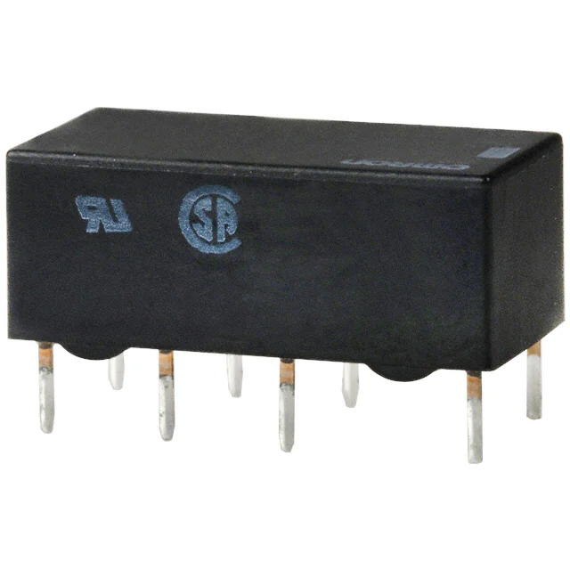

Low Signal Relay ■ ■ ■ ■ ■ G6A High sensitivity – can be driven by digital circuits Low-profile design allows use in 12.70 mm (0.50 in) PC board rack Surge withstand voltage meets FCC Part 68 regulation Units can be mounted side by side due to low magnetic leakage Special models available for ultrasonic cleaning and low thermoelectromotive force Unique moving loop (permanent magnet) armature reduces relay size, magnetic interference, and contact bounce time ■ Single or double coil winding types available ■ Ordering Information To Order: Select the part number and add the desired coil voltage rating, (e.g., G6A-274P-ST-US-DC12). ■ NON-LATCHING Type Standard High-sensitivity Low-sensitivity Contact form DPDT 4PDT DPDT 4PDT DPDT 4PDT Part number AgPd (Au clad) G6A-234P-ST-US G6A-434P-ST-US G6A-234P-ST15-US G6A-434P-ST20-US G6A-234P-ST40-US G6A-434P-ST40-US Ag (Au clad) G6A-274P-ST-US G6A-474P-ST-US G6A-274P-ST15-US G6A-474P-ST20-US G6A-274P-ST40-US G6A-474P-ST40-US Contact form DPDT 4PDT Part number AgPd (Au clad) G6AU-234P-ST-US G6AU-434P-ST-US Ag (Au clad) G6AU-274P-ST-US G6AU-474P-ST-US Contact form DPDT 4PDT DPDT 4PDT Part number AgPd (Au clad) G6AK-234P-ST-US G6AK-434P-ST-US G6AK-234P-ST40-US G6AK-434P-ST40-US Ag (Au clad) G6AK-274P-ST-US G6AK-474P-ST-US G6AK-274P-ST40-US G6AK-474P-ST40-US ■ LATCHING Single coil Type Standard Dual coil Type Standard Low-sensitivity Note: Other options available for ST10 ultra high reliability, high temperature 85°C (185°F), ST1 reverse coil polarity, BS British standard. Contact your OMRON sales representative for details. G6A G6A Specifications ■ CONTACT DATA Type Load Rated load Contact material Carry current Max. operating voltage Max. operating current Max. switching capacity Min. permissible load G6A-234P-ST(15, 40)-US, G6A-434P-ST(20, 40)-US G6AK-234P-ST(40)-US, G6AK-434P-ST(40)-US G6AU-234P-ST-US, G6AU-434P-ST-US Resistive load (p.f. = 1) Inductive load (p.f. = 0.4) (L/R = 7 ms) 0.30 A at 125 VAC, 0.20 A at 125 VAC, 1 A at 30 VDC 0.50 A at 30 VDC AgPd (Au clad) AgPd (Au clad) 3A 3A 250 VAC, 220 VDC 250 VAC, 220 VDC 2A 1A 125 VA, 60 W 62.50 VA, 30 W 10 µA, 10 mVDC 10 µA, 10 mVDC G6A-274P-ST(15, 40)-US, G6A-474P-ST(20, 40)-US G6AK-274P-ST(40)-US, G6AK-474P-ST(40)-US G6AU-274P-ST-US, G6AU-474P-ST-US Resistive load (p.f. = 1) Inductive load (p.f. = 0.4) (L/R = 7 ms) 0.50 A at 125 VAC, 0.25 A at 125 VAC, 2 A at 30 VDC 1 A at 30 VDC Ag (Au clad) Ag (Au clad) 3A 3A 250 VAC, 220 VDC 250 VAC, 220 VDC 2A 1A 125 VA, 60 W 62.50 VA, 30 W 10 µA, 10 mVDC 10 µA, 10 mVDC ■ COIL DATA Standard non-latching DPDT (G6A-234P-ST-US, G6A-274P-ST-US) Rated voltage (VDC) Rated current (mA) Coil resistance (Ω) 3 5 6 9 12 24 48 66.70 40 33.30 22.20 16.70 8.30 4.90 45 125 180 405 720 2,880 9,750 Coil inductance (ref. value) (H) Armature OFF Armature ON 0.07 0.20 0.29 0.63 1.10 4.50 13.70 0.07 0.18 0.26 0.57 1.06 4.10 12.50 Pick-up voltage Dropout voltage % of rated voltage 70% max. 10% min. Maximum voltage Power consumption (mW) 200% at 23°C (73°F) Approx. 200 150% at 70°C (158°F) Approx. 235 High-sensitivity non-latching DPDT (G6A-234P-ST15-US, G6A-274P-ST15-US) Rated voltage (VDC) Rated current (mA) Coil resistance (Ω) 1.50 3 4.50 5 6 9 12 24 48 100 50 33.30 30 25 16.70 12.50 6.30 3.20 15 60 135 167 240 540 960 3,840 15,000 Coil inductance (ref. value) (H) Armature OFF Armature ON 0.02 0.09 0.22 0.25 0.35 0.80 1.35 5.60 22.50 0.02 0.08 0.20 0.21 0.31 0.70 1.25 5.10 20.00 Pick-up voltage Dropout voltage % of rated voltage 80% max. 10% min. Maximum voltage Power consumption (mW) 200% Approx. 150 Note: The rated current and coil resistance are measured at a coil temperature of 23°C (73°F) with a tolerance of ±10%. 2 G6A G6A ■ COIL DATA (continued) Low-sensitivity non-latching DPDT (G6A-234P-ST40-US, G6A-274P-ST40-US) Rated voltage (VDC) Rated current (mA) Coil resistance (Ω) 3 5 6 9 12 24 48 133.30 80 66.70 44.30 33.30 16.70 8.30 22.50 62.50 90 203 360 1,440 5,760 Coil inductance (ref. value) (H) Armature OFF Armature ON 0.03 0.08 0.11 0.27 0.52 2.10 7.50 0.02 0.07 0.10 0.23 0.43 1.80 6.40 Pick-up voltage Dropout voltage % of rated voltage 70% max. 10% min. Maximum voltage Power consumption (mW) 150% at 23°C (73°F) Approx. 400 110% at 70°C (158°F) Standard non-latching 4PDT (G6A-434P-ST-US, G6A-474P-ST-US) Rated voltage (VDC) Rated current (mA) Coil resistance (Ω) 3 5 6 9 12 24 48 120 72.50 60 40 30 15 7.50 25 69 100 225 400 1,600 6,400 Coil inductance (ref. value) (H) Armature OFF Armature ON 0.05 0.14 0.20 0.45 0.80 3.20 12.80 0.05 0.12 0.17 0.38 0.68 2.70 10.90 Pick-up voltage Dropout voltage % of rated voltage 70% max. 10% min. Maximum voltage Power consumption (mW) 150% at 23°C (73°F) Approx. 360 110% max. at 70°C (158°F) High-sensitivity non-latching 4PDT (G6A-434P-ST20-US, G6A-474P-ST20-US) Rated voltage (VDC) Rated current (mA) Coil resistance (Ω) 3 5 6 9 12 24 48 66.70 40 33.30 22.20 16.70 8.30 4.20 45 125 180 405 720 2,880 11,520 Coil inductance (ref. value) (H) Armature OFF Armature ON — — — — — — — — — — — — — — Pick-up voltage Dropout voltage % of rated voltage 70% max. 10% min. Maximum voltage Power consumption (mW) 200% max. at 50°C (122°F) Approx. 200 Maximum voltage Power consumption (mW) 150% at 23°C (73°F) Approx. 400 Low-sensitivity non-latching 4PDT (G6A-434P-ST40-US, G6A-474P-ST40-US) Rated voltage (VDC) Rated current (mA) Coil resistance (Ω) 3 5 6 9 12 24 48 133.30 80 66.70 44.30 33.30 16.70 8.30 22.50 62.50 90 203 360 1,440 5,760 Coil inductance (ref. value) (H) Armature OFF Armature ON 0.04 0.12 0.17 0.42 0.70 2.80 10.20 0.02 0.09 0.13 0.30 0.52 2.20 8.60 Pick-up voltage Dropout voltage % of rated voltage 70% max. 10% min. 110% max. at 70°C (158°F) Note: The rated current and coil resistance are measured at a coil temperature of 23°C (73°F) with a tolerance of ±10%. 3 G6A G6A ■ COIL DATA (continued) Standard single coil latching DPDT (G6AU-234P-ST-US, G6AU-274P-ST-US) Rated voltage (VDC) Rated current (mA) Coil resistance (Ω) 3 5 6 9 12 24 48 33.70 20 16.70 11.10 8.30 4.20 2.50 89 250 360 810 1,440 5,760 19,000 Coil inductance (ref. value) (H) Armature OFF Armature ON 0.15 0.44 0.64 1.38 2.50 9.20 28.50 0.11 0.35 0.48 1.07 2 7.20 22 Set pick-up voltage Reset pick-up voltage % of rated voltage 70% max. 70% max. Maximum voltage Power consumption (mW) 200% at 23°C (73°F) Approx. 100 150% at 70°C (158°F) Approx. 120 Standard dual coil latching DPDT (G6AK-234P-ST-US, G6AK-274P-ST-US) Rated voltage (VDC) Rated current (mA) Coil resistance (Ω) Coil inductance (ref. value) (H) Set coil Reset coil Armature Armature Armature Armature OFF ON OFF ON 3 5 6 9 12 24 48 66.70 36 30 20 15 7.50 4.20 45 139 200 450 800 3,200 11,520 0.04 0.11 0.16 0.38 0.60 2.10 8.50 0.03 0.08 0.12 0.28 0.45 1.50 6.30 0.03 0.08 0.12 0.28 0.45 1.50 6.30 0.04 0.11 0.16 0.38 0.60 2.10 8.50 Set pick-up voltage Reset pick-up voltage % of rated voltage 70% max. 70% max. Maximum voltage Power consumption (mW) 200% at 23°C (73°F) Approx. 200 Approx. 180 150% max. at 70°C (158°F) Approx. 200 Dual coil latching low-sensitivity DPDT (G6AK-234P-ST40-US, G6AK-274P-ST40-US) Rated voltage (VDC) Rated current (mA) Coil resistance (Ω) Coil inductance (ref. value) (H) Set coil Reset coil Armature Armature Armature Armature OFF ON OFF ON 3 5 6 9 12 24 48 120 72.50 60 40 30 15 7.50 25 69 100 225 400 1,600 6,400 0.02 0.05 0.07 0.16 0.28 1.10 4 0.01 0.04 0.05 0.12 0.20 0.75 2.90 0.01 0.04 0.05 0.12 0.20 0.75 2.9 0.02 0.05 0.07 0.16 0.28 1.10 4 Set pick-up voltage Reset pick-up voltage % of rated voltage 70% max. 70% max. Maximum voltage Power consumption (mW) 150% max. at 23°C (73°F) Approx. 360 110% max. at 70°C (158°F) Note: The rated current and coil resistance are measured at a coil temperature of 23°C (73°F) with a tolerance of ±10%. 4 G6A G6A ■ COIL DATA (continued) Standard single coil latching 4PDT (G6AU-434P-ST-US, G6AU-474P-ST-US) Rated voltage (VDC) Rated current (mA) Coil resistance (Ω) 3 5 6 9 12 24 48 106.80 64 53.30 35.60 26.70 13.30 6.70 28.10 78.10 112.50 253 450 1,800 7,200 Coil inductance (ref. value) (H) Armature OFF Armature ON 0.03 0.08 0.11 0.25 0.45 1.80 7.00 0.02 0.06 0.08 0.18 0.32 1.30 5.20 Set pick-up voltage Reset pick-up voltage % of rated voltage 70% max. 70% max. Maximum voltage Power consumption (mW) 150% at 23°C (73°F) Approx. 320 110% at 70°C (158°F) Standard dual coil latching 4PDT (G6AK-434P-ST-US, G6AK-474P-ST-US) Rated voltage (VDC) Rated current (mA) Coil resistance (Ω) Coil inductance (ref. value) (H) Set coil Reset coil Armature Armature Armature Armature OFF ON OFF ON 3 5 6 9 12 24 48 106.80 64 53.30 35.60 26.70 13.30 6.70 28.10 78.10 112.50 253 450 1,800 7,200 0.03 0.08 0.11 0.25 0.45 1.80 7.00 0.02 0.06 0.08 0.18 0.32 1.30 5.20 0.02 0.06 0.08 0.18 0.32 1.30 5.20 0.03 0.08 0.11 0.25 0.45 1.80 7.00 Set pick-up voltage Reset pick-up voltage % of rated voltage 70% max. 70% max. Maximum voltage Power consumption (mW) 150% at 23°C (73°F) Approx. 320 110% max. at 70°C (158°F) Dual coil latching low-sensitivity 4PDT (G6AK-434P-ST40-US, G6AK-474P-ST40-US) Rated voltage (VDC) Rated current (mA) Coil resistance (Ω) Coil inductance (ref. value) (H) Set coil Reset coil Armature Armature Armature Armature OFF ON OFF ON 3 5 6 9 12 24 48 120 72.50 60 40 30 15 7.50 25 69 100 225 400 1,600 6,400 0.02 0.07 0.09 0.18 0.30 1.20 4.40 0.02 0.05 0.08 0.14 0.23 0.82 3.20 0.02 0.05 0.08 0.14 0.23 0.82 3.20 0.02 0.07 0.09 0.18 0.30 1.20 4.40 Set pick-up voltage Reset pick-up voltage % of rated voltage 70% max. 70% max. Maximum voltage Power consumption (mW) 150% max. at 23°C (73°F) Approx. 360 110% max. at 70°C (158°F) Note: The rated current and coil resistance are measured at a coil temperature of 23°C (73°F) with a tolerance of ±10%. 5 G6A G6A ■ CHARACTERISTICS Type Contact resistance Operate (set) time Release (reset) time Bounce time Operating frequency Non-latching 50 mΩ max. 5 ms max. (mean value: approx. 3 ms) 7 ms max. (mean value: approx. 3.80 ms) 3 ms max. (mean value: approx. 1.20 ms) 5 ms max. (mean value: approx. 1.30 ms) Actual value approx. 0.50 ms Actual value approx. 0.50 ms 36,000 operations/hour 1,800 operations/hour (under rated load) DPDT 4PDT DPDT 4PDT Operate Release Mechanical Electrical Insulation resistance Dielectric strength (see note 2) 5 ms max. (mean value: approx. 2.50 ms) 7 ms max. (mean value: approx. 3.30 ms) 5 ms max. (mean value: approx. 2.50 ms) 7 ms max. (mean value: approx. 2.70 ms) 1,000 MΩ min. (at 500 VDC) 1,000 VAC, 50/60 Hz for 1 minute between coil and contacts 1,000 VAC, 50/60 Hz for 1 minute between contacts of different poles 1,000 VAC, 50/60 Hz for 1 minute between contacts of same pole 250 VAC, 50/60 Hz for 1 minute between set and reset coils 1,500 V 10 x 160 µs (conforms to FCC Part 68) 10 to 55 Hz; 5 mm (0.20 in) double amplitude 10 to 55 Hz; 3.30 mm (0.13 in) double amplitude 1,000 m/s2 (Approx. 100 G) DPDT: 500 m/s2 (Approx. 50 G); 4PDT: 300 m/s2 (Approx. 30 G) -40° to 70°C (-40° to 158°F) 45% to 85% RH 100 million operations min. (at 36,000 operations/hour) See “Characteristic Data” Approx. 3.5 g (0.12 oz) Approx 6.0 g (0.21 oz) Surge withstand voltage (see note 3) Vibration Mechanical durability Malfunction durability Shock Mechanical durability Malfunction durability Ambient temperature Humidity Service life (see note 4) Mechanical Electrical Weight DPDT 4PDT Note: 1. 2. 3. 4. Latching Data shown are of initial value. The dielectric strength of Type G6A-2D34P-ST-US is 500 VAC when the relay is not energized. The surge withstand of Type G6A-2D34P-ST-US is 1,000 V 10 x 160 µs when the relay is not energized. The mechanical service life of Type G6A-2D34P-ST-US is 10,000,000 operations min. Maximum switching capacity DPDT Ambient temperature vs. maximum voltage (reference only) Electrical service life DPDT Rated operating current (A) Maximum voltage (%) Service life (x103 operations) ■ CHARACTERISTIC DATA Rated operating voltage (V) 6 Ambient temperature (°C) Rated operating current (A) G6A G6A Dimensions Unit: mm (inch) ■ NON-LATCHING G6A-234P-ST(15, 40)-US, G6A-274P-ST(15, 40)-US Terminal arrangement/ Internal connections (Bottom view) Mounting holes (Bottom view) G6A-434P-ST(20, 40)-US, G6A-474P-ST(20, 40)-US Terminal arrangement/ Internal connections (Bottom view) Mounting holes (Bottom view) ■ LATCHING G6AU-234P-ST-US, G6AU-274P-ST-US Terminal arrangement/ Internal connections (Bottom view) Mounting holes (Bottom view) Terminal arrangement/ Internal connections (Bottom view) Mounting holes (Bottom view) G6AK-234P-ST(40)-US, G6AK-274P-ST(40)-US 123456 Note: 123456 123456and indicate mounting orientation marks. 7 G6A G6A G6AU-434P-ST-US, G6AU-474P-ST-US Terminal arrangement/ Internal connections (Bottom view) Mounting holes (Bottom view) Terminal arrangement/ Internal connections (Bottom view) Mounting holes (Bottom view) G6AK-434P-ST(40)-US, G6AK-474P-ST(40)-US 12345 12345 Note: 12345 and indicate mounting orientation marks. ■ APPROVALS UL (File No. E41515)/CSA (File No. LR24825) Type G6A-234P-ST-US G6A-234P-ST40-US G6A-234P-ST15-US G6A-274P-ST-US G6A-274P-ST40-US G6A-274P-ST15-US G6A-434P-ST-US G6A-434P-ST20-US G6A-434P-ST40-US G6A-474P-ST-US G6A-474P-ST20-US G6A-474P-ST40-US G6AK-234P-ST(40)-US G6AU-234P-ST-US Contact form DPDT Coil rating 1 to 48 VDC 4PDT 1 to 48 VDC DPDT 1 to 48 VDC 4PDT 1 to 48 VDC G6AK-274P-ST(40)-US G6AU-274P-ST-US G6AK-434P-ST(40)-US G6AU-434P-ST(40)-US G6AK-474P-ST(40)-US G6AU-474P-ST(40)-US Contact ratings 0.60 A, 125 VAC 1 A, 30 VDC 0.60 A, 110 V+DC 0.60 A, 125 VAC 2 A, 30 VDC 0.60 A, 110 VDC 0.60 A, 125 VAC 1 A, 30 VDC 0.60 A, 110 VDC 0.60 A, 125 VAC 2 A, 30 VDC 0.60 A, 110 VDC 0.60 A, 125 VAC 1 A, 30 VDC 0.60 A, 110 VDC 0.60 A, 125 VAC 2 A, 30 VDC 0.60 A, 110 VDC 0.60 A, 125 VAC 1 A, 30 VDC 0.60 A, 110 VDC 0.60 A, 125 VAC 2 A, 30 VDC 0.60 A, 110 VDC Note: 1. The rated values approved by each of the safety standards (e.g., UL and CSA) may be different from the performance characteristics individually defined in this catalog. 2. In the interest of product improvement, specifications are subject to change. 8 G6A G6A OMRON ELECTRONICS, INC. OMRON CANADA, INC. One East Commerce Drive Schaumburg, IL 60173 885 Milner Avenue Scarborough, Ontario M1B 5V8 1-800-55-OMRON 416-286-6465 Cat. No. GC RLY6 9/97 Specifications subject to change without notice. Printed in the U.S.A. 9

物料型号:OMRON G6A系列继电器
器件简介: - 高灵敏度,可由数字电路驱动 - 低剖面设计,适用于12.70毫米(0.50英寸)PCB板架 - 浪涌耐压符合FCC第68部分规定 - 由于低磁泄露,可以并排安装单元 - 特殊型号适用于超声波清洗和低热电势 - 独特的移动线圈(永久磁铁)电枢减少了继电器尺寸、磁干扰和接触弹跳时间 - 提供单线圈或双线圈绕组类型
引脚分配:文档中未明确列出具体的引脚分配图,但提供了继电器的端子排列和内部连接图。
参数特性: - 多种接触形式和额定电压选项 - 详细的线圈数据,包括额定电压、额定电流、线圈电阻、线圈电感等 - 操作时间和释放时间 - 绝缘电阻和耐电压 - 振动、冲击和环境温度规格
功能详解: - 非锁存和锁存型继电器 - 提供了不同灵敏度的继电器选项 - 特殊型号包括超高频可靠性、高温85°C(185°F)、反向线圈极性和英国标准
应用信息: - 适用于需要高灵敏度和小型化设计的场合 - 可用于数字电路驱动的继电器应用
封装信息: - 提供了继电器的尺寸和安装孔信息
