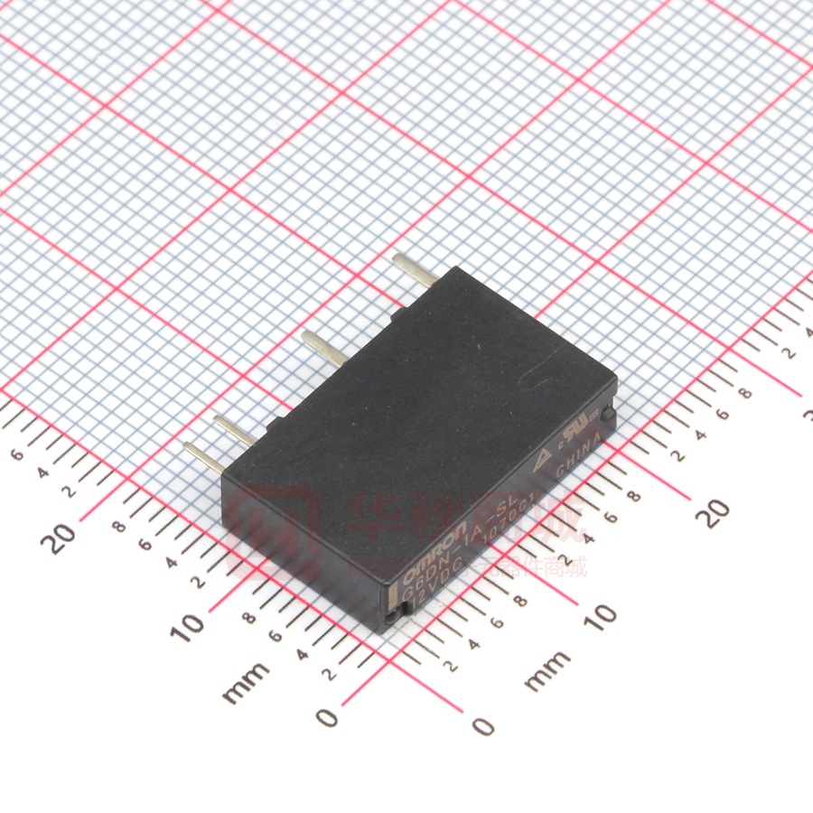

G6DN-1A-SL DC12 数据手册
G6DN PCB Power Relay SPST Slim Power Relay for 5 A switching • Slim 5-mm width and miniature size. (20 × 5.08 × 12.5 mm) • High switching capability 5 A (250 VAC and 30 VDC), and high contact reliability by crossbar-twin contact. • Low power consumption 110 mW. • Meets application standards EN61010-1 and EN61010-2-201 for reinforced insulation (CTI 600 V min. and Rated insulation voltage 300 V). • Actualize electrical durability 100 Kops (-L type) ■Model Number Legend ■Application Examples G 6 D N -@@ @ - @ ——— — • • • • 1 2 3 4 1. Number of Poles 1: 1-pole 2. Contact Form A: SPST-NO (1a) 3. Enclosure Rating None: Fully sealed Programmable Controller output Temperature Controller Building Automation Output of control system G 6 D N 4. Classification None: Standard (E-LIFE 80 Kops) L: High durability type (E-LIFE 100 Kops) SL: General purpose ■Ordering Information Classification Contact form Enclosure rating Standard High durability SPST-NO (1a) Fully sealed General purpose Note. When ordering, add the rated coil voltage to the model number. Example: G6DN-1A DC5 Rated coil voltage Terminal shapes Model G6DN-1A G6DN-1A-L G6DN-1A-SL PCB terminal Minimum packing unit 25 pcs/ tube 100pcs/tray However, the notation of the coil voltage on the product case as well as on the packaging will be marked as @@ VDC. Example: G6DN-1A 5VDC ■Ratings ●Coil Classification Standard High durability General purpose Rated voltage 4.5 VDC 5 VDC 12 VDC 24 VDC 5 VDC 12 VDC 24 VDC 5 VDC 12 VDC 24 VDC Rated current (mA) Coil resistance (Ω) 24.4 22.0 9.2 4.6 36.0 15.0 7.5 22.0 9.2 4.6 184 227 1,309 5,236 139 800 3,200 227 1,309 5,236 Must operate voltage (V) Must release voltage (V) % of rated voltage Max. voltage (V) Power consumption (mW) Approx. 110 70% max. * 5% min. 160% Approx. 180 Approx. 110 Note. The rated current and resistance are measured at a coil temperature of 23°C with a tolerance of ±10%. * Operating voltage is less than 72% when the relay is sideways and the marking is right way. ●Contacts Resistive load Contact Type Contact material Rated load Rated carry current Max. switching voltage Max. switching current Cross bar twin Ag-Alloy and Au plating * 5 A at 250 VAC 5 A at 30 VDC 5A 277 VAC, 125 VDC 5A Inductive load (cos φ = 0.4, L/R = 7 ms) 2 A at 250 VAC 2 A at 30 VDC * Au plating is applied to stationary contact. 1 G6DN PCB Power Relay ■Characteristics Standard Contact resistance Operate time 10 ms max. Release time 5 ms max. Insulation resistance Dielectric strength Surge withstand voltage Vibration resistance Shock resistance Durability G 6 D N High durability General purpose 100 mΩ max. 1,000 MΩ min. (at 500 VDC) Between coil and contacts 3,000 VAC, 50/60 Hz for 1 min Between contacts of the same polarity 750 VAC, 50/60 Hz for 1 min Between coil and contacts 6 kV (1.2 ✕ 50 μs) Destruction 10 to 55 to 10 Hz, 2.5 mm single amplitude (5.0 mm double amplitude) Malfunction 10 to 55 to 10 Hz, 0.75 mm single amplitude (1.5 mm double amplitude) Destruction 1,000 m/s2 Malfunction 100 m/s2 Mechanical 20,000,000 operations min. (at 18,000 operations/hr) Electrical 100,000 operations min. (3 A at 250 VAC, 3 A at 30 VDC Resistive load) 80,000 operations min. (5 A at 250 VAC, 5 A at 30 VDC Resistive load) 100,000 operations min. (2 A at 250 VAC, 2 A at 30 VDC Inductive load) 100,000 operations min. (5 A at 250 VAC, Resistive load) 100,000 operations min. (5 A at 30 VDC, Resistive load) 200,000 operations min. (2 A at 250 VAC, Inductive load) 200,000 operations min. (2 A at 30 VDC, Inductive load) Failure rate (P level) (reference value) * 0.1 mA at 0.1 VDC Ambient temperature Operating -40°C to +90°C (with no icing or condensation) Humidity 5% RH to 85% RH Weight Approx. 3 g 50,000 operations min. (5 A at 250 VAC, Resistive load) 50,000 operations min. (5 A at 30 VDC, Resistive load) 100,000 operations min. (2 A at 250 VAC, Inductive load) 100,000 operations min. (2 A at 30 VDC, Inductive load) Note 1. Values in the above table are initial values. Note 2. The contact resistance is measured with 1 A applied at 5 VDC using a fall-of-potential method. Note 3. The insulation resistance is measured between coil and contacts and between contacts of the same polarity at 500 VDC. * This value was measured at a switching frequency of 120 operations/min. 2 G6DN PCB Power Relay ■Engineering Data ●G6DN-1A, G6DN-1A-L ●G6DN-1A 50 30 10 AC resistive load 5 3 2.5 500 300 100 50 250 VAC/30 VDC Resistive load 30 25 200 180 160 140 126 120 DC resistive load 10 1 5 250 VAC/30 VDC Inductive load 3 0.5 0.4 0.3 0.1 ●Ambient Temperature vs. Maximum Coil Voltage ●G6DN-1A, G6DN-1A-L Maximum coil voltage (%) Durability (x104 operations) ●Durability Switching current (A) ●Maximum Switching Capacity 100 80 1 3 5 10 30 0 100 125 277 500 1,000 1 2 3 4 5 6 7 8 9 60 10 0 23 30 40 50 Switching current (A) Switching voltage (V) 60 70 80 90 100 Ambient temperature (°C) Note. The maximum coil voltage refers to the maximum voltage in a varying range of operating power voltage, not a continuous voltage. ●Shock Malfunction Must operate and must release voltage (ratio of rated voltage) (%) ●Ambient Temperature vs. Must Operate and Must Release Voltages G6DN-1A, G6DN-1A-L Y 1,000 90 80 G 6 D N Energized 800 70 1,000 X max. X min. 60 1,000 Z De-energized 600 400 200 50 Sample: G6DN-1A Number of Relays: 5 pcs Test conditions: Impose a shock in the ±X, ±Y, and ±Z directions three times each with the Relay energized to check the shock values that cause the Relay to malfunction. Standard:100 m/s2 40 30 X' 1,000 Z' 1,000 max. X min. 20 1,000 10 0 −60 −40 −20 0 20 40 60 80 100 Ambient temperature (°C) Y' Unit: m/s2 Shock direction X X' Y Z Z' Y' Coil terminals ■Dimensions G6DN-1A(-L) PCB Mounting Holes (Bottom View) 5.08 max. (5.05)* 20 max. (19.97)* Terminal Arrangement/ Internal Connections (Bottom View) 7.62±0.1 12.5 max. (12.45)* 7.62±0.1 Four, 1.1-dia. holes 2.54±0.1 1 2 5 8 3.3 Two, 0.4-dia. t 0.2 t 0.26 7.62 7.62 (1.32) 2.54 (1.28) 1.28 2-0.8 (No coil polarity) 1.32 * Average value G6DN-1A-SL PCB Mounting Holes (Bottom View) 5.08 max. 20 max. Terminal Arrangement/ Internal Connections (Bottom View) 7.62±0.1 7.62±0.1 12.5 max. Four, 1.1-dia. holes 2.54±0.1 1 2 5 8 3.3 2-t0.3 t 0.2 t 0.26 7.62 7.62 2-0.5 2.54 (1.32) 2-0.8 1.28 (1.28) (No coil polarity) 1.32 3 G6DN PCB Power Relay ■Approved Standards ●The rated values approved by each of the safety standards may be different from the performance characteristics individually defined in this datasheet. UL/C-UL-approved models Model Contact form (File No. E41515) Coil ratings Contact ratings 5 A at 277 VAC (Resistive) 95°C 5 A at 30 VDC (Resistive) 90°C 3A, 250V ac, Resistive 85°C G6DN-1A(-SL) SPST-NO G6DN-1A-L SPST-NO 4.5 to 24 VDC 5 to 24 VDC Operations 6,000 6,000 100,000 1/10 hp 125 VAC 95°C 1,000 1/10 hp 277 VAC 95°C 1,000 D300 120 VAC/240 VAC 95°C 6,000 C300 120 VAC/240 VAC 95°C 6,000 R300 125 VDC/250 VDC 95°C 6,000 5 A 250 VAC (Resistive) 95°C 100,000 2 A 250 VAC (General Use) 95°C 100,000 2 A 30 VDC (General Use) 95°C 100,000 1/10 hp 120 VAC 40°C 6,000 C300 120 VAC/240 VAC 95°C 6,000 D150 120 VAC 95°C 6,000 R150 125 VDC 95°C 6,000 Note. CSA certification CSA 22.2 No.14 can be recognized by C-UL. (Certificate No. 40042696) G VDE (EN61810-1) 6 Model Contact form Coil ratings Contact ratings D 5 A at 250 VAC (cosφ= 1.0) 90°C G6DN-1A SPST-NO 4.5, 5, 12, 24 VDC N G6DN-1A-L SPST-NO TÜV (EN61810-1) Model 10,000 5 A 250 VAC (cosφ= 1.0) 90°C 100,000 2 A 250 VAC (cosφ= 0.4) 90°C 100,000 2 A 250 VAC (cosφ= 0.6) 90°C 100,000 5 A 30 VDC (L/R = 0 ms) 90°C 100,000 2 A 30 VDC (L/R = 7 ms) 90°C 100,000 SPST-NO Coil ratings 5, 12, 24 VDC Contact ratings 10,000 5 A at 30 VDC (L/R = 0 ms) 90°C 10,000 3.5 mm min. Creepage distance 3.6 mm min. Type of insulation coil-contact circuit open contact circuit Basic (PD.2) Micro disconnection Rated Insulation voltage 300 V Pollution degree 2 Rated voltage system 250 V Over voltage category II Operations 5 A at 250 VAC (cosφ= 1.0) 90°C Clearance distance Category of protection according to IEC 61810-1 RT III (Sealed) Insulation material group I Tracking resistance according to IEC 60112 CTI 600 V min. Flammability class according to UL94 V-0 Coil insulation system according to UL Class B ■Precautions ●Please refer to “PCB Relays Common Precautions” for correct use. 4 10,000 5 A at 30 VDC (L/R = 0 ms) 90°C (Registration No. R 50396359) Contact form G6DN-1A-SL 5, 12, 24 VDC Operations G6DN PCB Power Relay G 6 D N Please check each region's Terms & Conditions by region website. OMRON Corporation Electronic and Mechanical Components Company Regional Contact Americas https://www.components.omron.com/ Asia-Pacific https://ecb.omron.com.sg/ Korea https://www.omron-ecb.co.kr/ Europe http://components.omron.eu/ China https://www.ecb.omron.com.cn/ Japan https://www.omron.co.jp/ecb/ © OMRON Corporation 2018-2019 All Rights Reserved. In the interest of product improvement, specifications are subject to change without notice. Cat. No. K276-E1-08 0218(1115) 5
