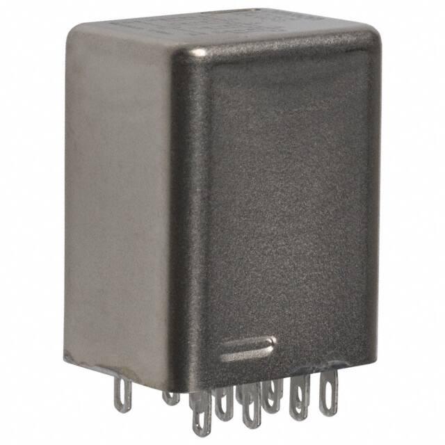

    RELAY GEN PURPOSE 4PDT 3A 110V
MY4H DC100/110 数据手册
General Purpose Relay MY ■ Designed small, 2- and 3-pole types break 5 A loads and 4-pole type, 3 A load ■ High reliability, long life ■ Ultra-high sensitivity with quick response ■ ■ ■ ■ ■ ■ ■ High vibration/shock resistance 3- and 4-pole types have an arc barrier UL and CSA approved Withstands dielectric strength of 2,000 V Relays with high-capacity, LED indicator, diode surge suppression, push-to-test button, or RC circuit are available Changes due to aging are negligible because of use of special magnetic materials, thus ensuring long continuous holding time Little change in characteristics such as contact follow, contact pressure, etc., throughout long life Ordering Information To Order: Select the part number and add the desired coil voltage rating (e.g., MY4-DC6). Type Standard Terminal Plug-in/solder PCB Plug-in/solder PCB Plug-in/solder PCB Contact form DPDT 3PDT 4PDT DPDT 3PDT 4PDT 4PDT 4PDT 4PDT 4PDT Construction Unsealed Sealed Hermetically Sealed Part number Single contact Standard Upper bracket mounting mounting bracket MY2 MY2F MY3 MY3F MY4 MY4F MY2-02 — MY3-02 — MY4-02 — MYQ4 — MYQ4-02 — MY4H — MY4H-0 — Lower mounting bracket MY2S MY3S MY4S — — — — — — — Bifurcated contact Standard Upper bracket mounting mounting bracket MY2Z MY2ZF — — MY4Z MY4ZF MY2Z-02 — — — MY2Z-02 — MYQ4Z — MYQ4Z-02 — MY4ZH — MY4ZH-0 — Note: 1. For SEV approved type, order the following: MY4-SV-DC6. (Lloyd's Register approval. See “Approvals” section.) 2. To order connecting sockets and mounting tracks, see “Accessories” section. 3. AgCdO contacts are also available (MY2E, MY3E, MY4E). Contact your OMRON sales representative for details. Lower mounting bracket MY2ZS — MY4ZS — — — — — — — MY MY Ordering information (continued) Type LED indicator Terminal Plug-in/solder High-capacity Diode surge suppression* LED indicator and diode surge suppression* RC circuit** DPDT 3PDT 4PDT DPDT 4PDT DPDT 4PDT DPDT 4PDT Push-to-test button LED indicator and RC circuit Type Latching Note: 1. 2. 3. 4. Contact form Construction DPDT 3PDT 4PDT DPDT w/o LED indicator LED indicator DPDT 3PDT 4PDT DPDT 3PDT 4PDT Terminal Plug-in PC board w/o LED indicator LED indicator Contact form DPDT Part number Single contact Standard Upper bracket mounting mounting bracket MY2N — MY3N — MY4N — MY2-Y — Lower mounting bracket — — — — Bifurcated contact Standard Upper bracket mounting mounting bracket MY2ZN — — — MY4ZN — — — Lower mounting bracket — — — — MY2N-Y MY2-D MY3-D MY4-D MY2N-D2 MY3N-D2 MY4N-D2 — — — — — — — — — — — — — — — MY2Z-D — MY4Z-D MY2ZN-D2 — MY4ZN-D2 — — — — — — — — — — — — — — MY2-CR MY3-CR MY4-CR MY2N-CR MY4N-CR MY214 MY414 MY214N MY414N — — — — — — — — — — — — — — — — — — MY2Z-CR — MY4Z-CR — — MY2Z12 MY4Z12 MY2Z12N MY4Z12N — — — — — — — — — — — — — — — — — — Part number MY2K-US MY2K-02-US For SEV approved type, order as the following: MY4-SV-DC6. (Lloyd's Register approval. See “Approvals” section.) To order connecting sockets and mounting tracks, see “Accessories” section. AgCdO contacts are also available. Contact your OMRON sales representative for details. * DC coils only ** AC coils only ■ ACCESSORIES Connecting Sockets To Order: Select the appropriate part numbers for sockets, clips, and mounting tracks (if required) from the available types chart. Available Types Track mounted sockets Relay DPDT 3PDT 4PDT Socket* PYF08A-E PYF11A PYF14A-E Relay hold-down clip Standard PYC-A1 * Track mounted socket can be used as a front connecting socket. 2 RC circuit Y92-H3 Mounting track PFP-100N/PFP-50N & PFP-M or PFP-100N2 PFP-S (Optional spacer) MY MY Back connecting sockets Relay DPDT 3PDT 4PDT Solder terminal socket PY08 PY11 PY14 Wire wrap terminal socket PY08QN PY11QN PY14QN Relay hold-down clip Standard PYC-P Socket Mounting Plate Push-to-test RC circuit PYC-P2 PYC-1 Mtg. plate PYC-S 1 PYP-1 18 PYP-18 36 PYP-36 Note: Types PYP-18, PTP-12 and PTP-10 may be cut to any desired length. Relay DPDT 3PDT 4PDT Relay hold-down clip Standard PYC-P PC terminal socket PY08-02 PY11-02 PY14-02 Push-to-test PYC-P2 RC circuit PYC-1 Specifications ■ CONTACT DATA Non-latching – Unsealed DPDT, 3PDT Resistive load (p.f. = 1) Load Rated load Contact material Carry current Max. operating voltage Max. operating current Max. switching capacity Min. permissible load (see note) 5 A at 220 VAC 5 A at 24 VDC Ag 5A 250 VAC 125 VDC 5A Inductive load (p.f. = 0.4) (L/R = 7 ms) 2 A at 220 VAC 2 A at 24 VDC 3A 1,100 VA 440 VA 120 W 48 W Standard type: 1 mA, 5 VDC 4DPT Resistive load (p.f. = 1) Inductive load (p.f. = 0.4) (L/R = 7 ms) 0.8 A at 220 VAC 1.5 A at 24 VDC High-capacity Resistive load (p.f. = 1) 3 A at 220 VAC 3 A at 24 VDC Ag (Au Flash) 1A 3A 7 A 220 VAC 7 A 24 VDC AgCdO 7A 1A 3A 7A 660 VA 176 VA 72 W 36 W Standard and high sensitivity types: 1 mA, 1 VDC 1,540 VA 168 W 100 µA, 1 VDC Inductive load (p.f. = 0.4) (L/R = 7 ms) 3.5 A 220 VAC 3.5 A 24 VDC 770 VA 84 W Bifurcated type: 100 µA, 1 VDC Non-latching – Sealed/Hermetically sealed Sealed, 4PDT Resistive load (p.f. = 1) Load Rated load Contact material Carry current Max. operating voltage Max. operating current Max. switching capacity Min. permissible load (see note) 1 A at 220 VAC 1 A at 24 VDC Ag (Au Flash) 1A 250 VAC 125 VDC 1A Inductive load (p.f. = 0.4) (L/R = 7 ms) 0.5 A at 220 VAC 0.5 A at 24 VDC 220 VA 110 VA 24 W 12 W Standard and high sensitivity types: 1 mA, 1 VDC Bifurcated type: 100 µA, 1 VDC Hermetically sealed, 4DPT Resistive load (p.f. = 1) 3 A at 110 VAC 3 A at 24 VDC Inductive load (p.f. = 0.4) (L/R = 7 ms) 0.8 A at 110 VAC 1.5 A at 24 VDC 3A 125 VAC 125 VDC 3A 330 VA 72 W 88 VA 36 W Note: P level: λ60 = 0.1 x 10-6/operation 3 MY MY ■ COIL DATA Non-latching – AC Rated voltage (V) 6 12 24 50 100/110 110/120 200/220 220/240 Rated current (mA) 50 Hz 214.10 106.50 53.80 25.70 11.70/12.90 9.90/10.80 6.20/6.80 4.80/5.30 60 Hz 183 91 46 22 10/11 8.40/9.20 5.30/5.80 4.20/4.60 Coil resistance (Ω) 12.20 46 180 788 3,750 4,430 12,950 18,790 Coil inductance (ref. value) (H) Armature Armature OFF ON 0.04 0.08 0.17 0.33 0.69 1.30 3.22 5.66 14.54 24.60 19.20 32.10 54.75 94.07 83.50 136.40 Pick-up Dropout voltage voltage (% of rated voltage) 80% max. 30% min. Maximum voltage Power consumption (VA, W) 110% max. Approx. 1.00 to 1.20 Approx. 0.90 to 1.10 Non-latching – DC Rated voltage (V) Rated current (mA) Coil resistance (Ω) 6 12 24 48 100/110 150 75 36.90 18.50 9.10/10 40 160 650 2,600 11,000 Coil inductance (ref. value) (H) Armature Armature OFF ON 0.17 0.33 0.73 1.37 3.20 5.72 10.60 21.00 45.60 86.20 Pick-up voltage Dropout voltage Maximum voltage (% of rated voltage) 80% max. 10% min. Power consumption (VA, W) 110% max. Approx. 0.90 Dropout voltage Power consumption (VA, W) Latching – AC Rated voltage (V) 6 12 24 50 120 Rated current (mA) Set coil Reset coil Coil resistance (Ω) 50 Hz 146 57 27.40 14 15.80 Set coil 13 72 320 1,400 8,300 60 Hz 142 56 26.40 13.40 5.60 50/60 Hz 68 39 18.60 3.50 3.50 Reset coil 32 130 550 3,000 3,000 Pick-up voltage Maximum voltage (% of rated voltage) 80% max. 80% max. Set coil 110% max. Approx. 0.60 to 0.90 Pick-up Dropout voltage voltage (% of rated voltage) 80% max. 80% max. Maximum voltage Reset coil Approx. 0.20 to 0.50 Latching – DC Rated voltage (V) 6 12 24 Rated current (mA) Set coil Reset coil 50/60 Hz 50/60 Hz 230 100 110 50 52 25 Coil resistance (Ω) Set coil Reset coil 26 60 110 235 470 940 Power consumption (VA, W) Set coil Reset coil 110% max. Approx. Approx. 1.30 0.06 Note: 1. The rated current and coil resistance are measured at a coil temperature of 23°C (73°F) with tolerances of +15%, -20% for AC rated current, and ±15% for DC rated coil resistance. 2. The AC coil resistance and inductance are reference values at 60 Hz. 3. The performance characteristics are measured at a coil temperature of 23°C (73°F). 4. Because the coil is designed for low power consumption, connect a bleeder (if necessary after confirming the leakage current), when the coil is driven by an SCR. 5. For AC type latching coils, the rated current values are half-wave rectified current values measured with a DC ammeter. 4 MY MY ■ CHARACTERISTICS Non-latching Contact resistance Operate time Release time Operating frequency Insulation resistance Dielectric strength Mechanically Under rated load Single contact type Bifurcated contact type Vibration Mechanical durability Ambient temperature Malfunction durability Mechanical durability Malfunction durability Operating Humidity Service Life Mechanically Shock Mechanically Electrically Weight 50 mΩ max. 20 ms max. 20 ms max. 18,000 operations/hour 1,800 operations/hour 100 MΩ min. (at 500 VDC) Unsealed: 2,000 VAC, 50/60 Hz for 1 minute 1,000 VAC, 50/60 Hz for 1 minute between contacts of same polarity Sealed: 1,500 VAC, 50/60 Hz for 1 minute 1,000 VAC, 50/60 Hz for 1 minute between contacts of same polarity Hermetically sealed: 1,000 VAC, 50/60 Hz for 1 minute 700 VAC, 50/60 Hz for 1 minute between contacts of same polarity 1,500 VAC, 50/60 Hz for 1 minute 1,000 VAC, 50/60 Hz for 1 minute between non-continuous contacts 10 to 55 Hz, 1.00 mm (0.04 in) double amplitude 10 to 55 Hz, 1.00 mm (0.04 in) double amplitude 1,000 m/s2 (approx. 100 G) 200 m/s2 (approx. 20 G) Unsealed: -55° to 70°C (-67° to 158°F) Sealed: -55° to 60°C (-67° to 140°F) Hermetically sealed: 25° to 60°C (77° to 140°F) 35% to 85% RH Single contact type: AC: 50 million operations min. (at operating frequency of 18,000 operations/hour) DC: 100 million operations min. (at operating frequency of 18,000 operations/hour) Bifurcated contact type: AC: 50 million operations min. DC: 20 million operations min. (5 million operations for the sealed/hermetically sealed types) (at operating frequency of 1,800 operations/hour) See “Characteristic Data” Sealed/unsealed: Approx. 35 g (1.23 oz) Hermetically sealed: Approx. 50 g (1.76 oz) Latching Contact resistance Operate time Release time Operating frequency Mechanically Under rated load Insulation resistance Dielectric strength Vibration Shock Ambient temperature Humidity Service Life Mechanical durability Malfunction durability Mechanical durability Malfunction durability Operating Mechanically Electrically Weight 50 mΩ max. AC: 30 ms max.; DC: 15 ms max. AC: 30 ms max.; DC: 15 ms max. 18,000 operations/hour 1,800 operations/hour 100 MΩ min. (at 500 VDC) 1,500 VAC, 50/60 Hz for 1 minute 1,000 VAC, 50/60 Hz for 1 minute between contacts of same polarity, and between set and reset coils 10 to 55 Hz, 1.00 mm (0.04 in) double amplitude 10 to 55 Hz, 1.00 mm (0.04 in) double amplitude 1,000 m/s2 (approx. 100 G) 200 m/s2 (approx. 20 G) -55° to 70°C (-67° to 158°F) 45% to 85% RH 100 million operations min. (at operating frequency of 18,000 operations/hour) See “Characteristic Data” Approx. 30 g (1.06 oz) Note: Data shown are of initial value. 5 MY MY ■ CHARACTERISTIC DATA Rated operating current (A) Rated operating voltage (V) MY4(Z)H MYQ4(Z)H Rated operating current (A) MY4 Rated operating current (A) MY2, MY3 Rated operating current (A) Maximum switching capacity – Non-latching Rated operating voltage (V) Rated operating voltage (V) Rated operating voltage (V) MY2, MY3 (Resistive load) MY2, MY3 (Inductive load) MY4 (Resistive load) MY4 (Inductive load) Service life (operations x 106) Service life (operations x 106) Service life (operations x 106) Service life (operations x 106) Electrical service life Rated operating current (A) MY4Z (Resistive load) MY4Z (Inductive load) MYQ4 Service life (operations x 106) Service life (operations x 106) Rated operating current (A) 6 MY2-Y (Inductive load) Service life (operations x 106) Service life (operations x 106) Rated operating current (A) MY2-Y(Resistive load) Rated operating current (A) Rated operating current (A) Rated operating current (A) Service life (operations x 106) Service life (operations x 106) MY4H Rated operating current (A) Rated operating current (A) Rated operating current (A) Rated operating current (A) Electrical service life MY2K(-02)-US MY2K(-02)-US (Resistive load) (Inductive load) Rated operating current (A) Maximum switching capacity – Latching Service life (operations x 106) MY Service life (operations x 106) MY Rated operating voltage (V) Rated operating current (A) Rated operating current (A) Dimensions Unit: mm (inch) ■ RELAYS MY2 MY3 MY■ ■ -02 Mounting holes MY■ ■F Mounting holes Note: MY4 The above dimensioned drawing shows the 4-pole type. The dimensions of the 2- and 3-pole types are identical to the 4-pole type. 7 MY MY Unit: mm (inch) ■ RELAYS (continued) MY(Z)H MY■ ■ -5 MY4(Z)H-0 Mounting holes Terminal arrangement (Bottom view) MY2 Note: The above dimensioned drawing shows the 4-pole type. The dimensions of the 2- and 3-pole types are identical the 4-pole type. 8 MYQ4(Z) MYQ4(Z)-02 MY2K-US MY2K-02-US MY3 MY4, MYQ4(Z), MY4(Z)H, MY4H-0 Mounting holes (Bottom view) MY MY Unit: mm (inch) ■ ACCESSORIES Track mounted sockets (UL File No. E87929) (CSA Report No. LR46088) PYF08A-E Terminal arrangement/ mounting holes (Top view) PYF11A PYF14A-E Terminal arrangement/ mounting holes (Top view) Mounting height of relay with socket Terminal arrangement/ mounting holes (Top view) Back connecting socket (UL File No. E87929) (CSA Report No. LR46088) – DPDT PY08 PY08QN PY08-02 Back connecting socket (UL File No. E87929) (CSA Report No. LR46088) – 3PDT PY11 PY11QN PY11-02 Note: 1. UL/CSA does not apply to wire wrap (Q) type sockets. 2. Value in brackets is for MY■ ■ CR. 9 MY MY Unit: mm (inch) ■ ACCESSORIES (continued) Back connecting socket (UL File No. E87929) (CSA Report No. LR46088) – 4PDT PY14 PY14QN Terminal arrangement (Bottom view) DPDT 3DPT PY14-02 Panel cutout Mounting height of relay with socket 4DPT Note: Value in brackets is for MY■ ■ -CR. Mounting holes DPDT 3PDT 4PDT PYC-P for PY■ ■ socket PYC-S for relay mounting plates * For types wiith suffix - 02. Relay hold-down clip PYC-A1 for PYF■ ■ A socket 10 MY MY Relay hold-down clip PYC-P2 for test button self-contained type with PY■ ■ A socket Y92-HC for RC circuit PYC-1 for RC circuit PFP-100N/PFP-50N mounting track PFP-100N2 mounting track * This dimension is 14.99 mm (0.59 in) on both ends in the case of PFP-100N, but on one end in the case of PFP-50N. ** L = Length PFP-50N ............... L = 497.84 mm (19.60 in) PFP-100N ............... L = 990.60 mm (39.00 in) PFP-100N2 ............... L = 990.60 mm (39.00 in) *** A total of twelve 24.89 x 4.57 mm (0.98 x 0.18 in) elliptic holes are provided, with six holes cut from each end of the track at a pitch of 9.91 (0.39) between holes. PFP-M end plate PFP-S spacer 11 MY MY Unit: mm (inch) ■ ACCESSORIES (continued) Socket mounting plates [t=1.52 (.06)] PYP-1 Socket needed PY08, PY11, PY11QN, PY14, PY4QN PYP-18 PYP-36 Number of socket specs. 1 18 36 PYP-1 PYP-18 PYP-36 ■ RELAY OPTIONS LED Indicator Terminal arrangement/Internal connections (Bottom view) Specifications and dimensions same as the standard type with the following exception. Because an LED indicator is employed as the operation indicator, the rated current is approximately 3.8 mA higher in the DC types and 0.5 to 5 mA higher in the AC types than in the standard type. MY4N DC coil rating type AC coil rating type Ambient operating temperature: -55° to 60°C (-67° to 140°F). Green LED ............ DC Red LED ............... AC Note: 1. In MY2N and MY3N, only the contact circuit is different from the illustration below. The coil terminals 10 and 11 of MY3N become (-) and (+), respectively. 2. Pay special attention to the polarities when using the DC type. 3. The AC coil-type is provided with a self-diagnostic function that detects a breakage in the coil. RC Circuit Specifications and dimensions same as the standard type with the following exceptions. The panel cutout dimensions are the same as those of the standard type. However, the height is higher by 17.02 mm (0.67 in). Terminal arrangement/ Internal connections (Bottom view) Note: 1. The above dimensioned drawing shows the 4-pole type. The dimensions of the 2- and 3-pole types are identical to the 4pole type. 2. Available on AC versions only. 3. Terminal arrangement/internal connections: MY2-Y is the same as the standard type; MY2N-Y is the same as the LED indicator type. 12 MY MY Characteristic Data Without RC circuit With RC circuit Push-to-test button MY■ ■ 12 Note: Mounting holes When mounting the relay, use the connecting socket PYC-P2 shown in “ACCESSORIES” section. The mounting hole dimensions shown here are applicable to the relay with mounting stud. The dimension drawings show the 4-pole type. The dimensions of the 2- and 3-pole types are identical to the 4-pole type. Diode Surge Suppression Terminal arrangement/Internal connections (Bottom view) Specifications and dimensions same as the standard type with the following exceptions. MY4-D 6, 12, 24, 48 100/110 VDC Terminal arrangement/internal connections: MY2(N)D(2) is the same as the MY4(N)-D(2) with the exception of the contact configuration. MY4N-D2 6, 12, 24, 48 VDC MY4N-D2 100/110 VDC Ambient operating temperature: -55° to 60°C (-67° to 140°F). Note: 1. 2. 3. 4. Pay special attention to the polarities when using the DC type. The release time is somewhat longer, but satisfies the standard specifications of 25 ms. The reverse-breakdown voltage of the diode is 1,000 VDC. Available on DC versions only. Connecting sockets Use the standard MY4 (4PDT) sockets with the terminal arrangements listed below. Terminal arrangement/Internal connections (Bottom view) AC DC Note: 1. R is a resistor for ampere-turn compensation, and is incorporated in the relays rated at 50 VAC or above. 2. Pay attention to the polarity of the set and reset coils, as incorrect connection of positive and negative terminals will result in malfunctioning of the relay. 13 MY MY ■ APPROVALS UL recognized type (File No. E41515) Type MY■ ■ Contact form DPDT Coil ratings 6 to 240 VAC 6 to 120 VDC 3PDT 4PDT MY2K-■ ■ DPDT 5 to 120 VAC 5 to 48 VDC Contact ratings 5 A, 120 VAC (Resistive) 5 A, 28 VDC (Resistive) 5 A, 240 VAC (Inductive) 5 A, 28 VDC (Resistive) 5 A, 240 VAC (Resistive) 3 A, 28 VDC (Resistive) 3 A, 120 VAC (Inductive) 1.5 A, 240 VAC (Inductive) 5 A, 240 VAC (Inductive, same polarity) 5 A, 28 VDC (Resistive, same polarity) 3 A, 240 VAC (Resistive) 3 A, 28 VDC (Resistive) CSA certified type (File No. LR31928) Type MY■ ■ Contact form DPDT 3PDT 4PDT Coil ratings 6 to 240 VAC 6 to 120 VDC MY2K-■ ■ DPDT 5 to 120 VAC 5 to 48 VDC Contact ratings 5 A, 28 VDC (Resistive) 5 A, 240 VAC (Inductive) 3 A, 28 VDC (Resistive) 3 A, 240 VAC (Inductive) 5 A, 240 VAC (Inductive, same polarity) 5 A, 28 VDC (Resistive, same polarity) 3 A, 240 VAC (General purpose) 3 A, 30 VDC (Resistive) LR (Lloyd's Register) approved type (File No. 563KOB-204524) Type MY■ ■ Contact form DPDT 4PDT Coil ratings 6 to 240 VAC 6 to 120 VDC Contact ratings 2 A, 30 VDC (Inductive) 2 A, 200 VAC (Inductive) 1.5 A, 30 VDC (Inductive) 0.8 A, 200 VAC (Inductive) 1.5 A, 115 VAC (Inductive) SEV listed type (File No. D791/63 [2- & 4-pole], D791/91 [3-pole]) Type MY■ ■ -SV Contact form DPDT 3PDT 4PDT Coil ratings 6 to 240 VAC 6 to 110 VDC Contact ratings 5 A, 220 VAC (Resistive) 5 A, 24 VDC (Resistive) Note: 1. The rated values approved by each of the safety standards (e.g., UL, CSA, VDE, and SEV) may be different from the performance characteristics individually defined in this catalog. 2. In the interest of product improvement, specifications are subject to change. ■ HINTS ON CORRECT USE When using the relay rated at 120 VAC at a supply voltage of 240 VAC, be sure to connect external resistors Rs and Rr to the relay. 14 MY MY OMRON ELECTRONICS, INC. OMRON CANADA, INC. One East Commerce Drive Schaumburg, IL 60173 885 Milner Avenue Scarborough, Ontario M1B 5V8 1-800-55-OMRON 416-286-6465 Cat. No. GC RLY6 9/97 Specifications subject to change without notice. Printed in the U.S.A. 15
