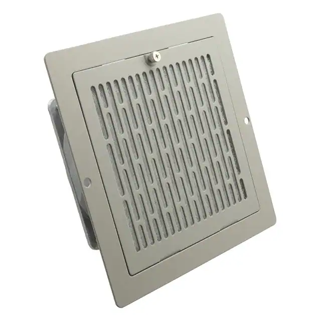

Ratings / Performance - Print Page of R87B-FA3A15HPF | OMRON Industrial Automation Page 1 of 2 Close R87B-FA3A15HPF *3D-CAD CG View Ratings / Performance Ratings Rated voltage 115 V AC (50/60 Hz) Permitted voltage fluctuation range 85 to 110% of rated voltage Rated current (Nominal value) 50Hz: 0.200 A 60Hz: 0.180 A Rated input (Nominal value) 50Hz: 15 W 60Hz: 14 W Rated rotational speed (Nominal value) 50Hz: 2700 r/min 60Hz: 3100 r/min Max. flow rate (Nominal value) 50Hz: 1.30 m**3/min 60Hz: 1.50 m**3/min Max. static pressure (Nominal value) 50Hz: 91 Pa 60Hz: 85 Pa Noise (Nominal value) 50Hz: 49 dB 60Hz: 52 dB Global Characteristics Motor type Single-phase shading coil induction motor (2-pole, open type) Rotation speed High speed size 180 x 180 x 73.1 mm Lead terminal Terminal type Insulation class IEC class B (130 CEL) UL class A (105 CEL) CSA class A (105 CEL) http://www.ia.omron.com/product/item/r87b0007c/print/1.html 10/3/2011 Ratings / Performance - Print Page of R87B-FA3A15HPF | OMRON Industrial Automation Page 2 of 2 Insulation registance Between power supply terminals and flame.: 100 M Ohm min. (at 500 V DC) Dielectric withstand voltage Between power supply terminals and flame.: 2000 V AC 50/60 Hz for 1 min Ambient operating temperature -30 to +70 CEL (with no icing) Ambient storage temperature -40 to +85 CEL (with no icing) Ambient operatoing humidity 25% to 85% RH Protection during lock period Impedance protection Mounted fan Plastic blades axial-flow fan Air direction Inlet Number of fan 1 fan Material Frame: Die-cast Aluminum Blades: PC Bearings Ball bearing Filter caracteristics Material: PUR Heat resistant temperature: 100 CEL max. Filtration wind speed: 2.5 m/s Pressure drop: Beginning : 49Pa ,Final : 70Pa Dust removal rate: 70% min. Dust pick-up rate: 800 g/m2 min. Weight Approx. 1120 g Compliant standards PSE EN/IEC 60335 (CE self-declaration) Certified standards UL/CSA Accessories Instruction Manual / Mounting Screw / Hexagon Nut / Plain Washer / Spring Washer / Plug Cord / Finger Guard / Filter As of March 27, 2009 Close Top of page © Copyright OMRON Corporation 2007 - 2011. All Rights Reserved. http://www.ia.omron.com/product/item/r87b0007c/print/1.html 10/3/2011

- 物料型号:R87B-FA3A15HPF - 额定电压:115V AC(50/60Hz) - 允许的电压波动范围:额定电压的85%至110% - 额定电流:50Hz时0.200A,60Hz时0.180A - 额定输入:50Hz时15W,60Hz时14W - 额定转速:50Hz时2700转/分钟,60Hz时3100转/分钟 - 最大流量:50Hz时1.30立方米/分钟,60Hz时1.50立方米/分钟 - 最大静压:50Hz时91帕,60Hz时85帕 - 噪音:50Hz时49分贝,60Hz时52分贝 - 电机类型:单相罩极式感应电机(2极,开启式) - 尺寸:180x180x73.1mm - 绝缘等级:IEC B级(130°C),UL A级(105°C),CSA A级(105°C) - 绝缘电阻:电源端子与外壳之间至少100 MOhm(500V DC下) - 耐电压:电源端子与外壳之间2000V AC,50/60 Hz,持续1分钟 - 环境运行温度:-30°C至+70°C(无结冰) - 环境存储温度:-40°C至+85°C(无结冰) - 环境运行湿度:25%至85%RH - 锁定期间的保护:阻抗保护 - 风扇:塑料叶片的轴流风扇 - 空气流向:吸入 - 风扇数量:1个风扇 - 材料:框架-压铸铝,叶片-PC - 轴承:球轴承 - 过滤器特性:材料-PUR,最高耐温-100°C,过滤风速-2.5 m/s,压降-初始49Pa,最终70Pa,除尘率-至少70%,尘土收集率-至少800 g/m² - 重量:大约1120克 - 符合标准:PSE EN/IEC 60335(CE自我声明) - 认证标准:UL/CSA - 配件:说明书/安装螺丝/六角螺母/平垫圈/弹簧垫圈/插头/手指保护/过滤器
