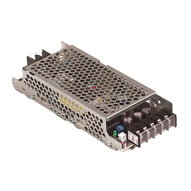

Switching Power Supply S8E3 Compact and Economical Power Supply with 3-Point Switching Capacity 30-or 50-watt models Open-frame and covered types available UL and CSA approval 3-year warranty D D D D Ordering Information J SWITCHING POWER SUPPLIES Description Part number Input voltage Configuration Open-frame p type yp 120 VAC Power ratings 30 W 50 W Covered-type 30 W 50 W Output voltage/Current Front terminals Top terminals V1 V2 V3 5 V/3 A 12 V/1.2 A –12 V/0.3 A S8E3-03031A S8E3-03031B 5 V/3 A 15 V/1 A –15 V/0.3 A S8E3-03032A S8E3-03032B 5 V/5 A 12 V/1.5 A –12 V/0.5 A S8E3-05031A S8E3-05031B 5 V/5 A 15 V/1.2 A –15 V/0.5 A S8E3-05032A S8E3-05032B 5 V/3 A 12 V/1.2 A –12 V/0.3 A S8E3-03031D S8E3-03031E 5 V/3 A 15 V/1 A –15 V/0.3 A S8E3-03032D S8E3-03032E 5 V/5 A 12 V/1.5 A –12 V/0.5 A S8E3-05031D S8E3-05031E 5 V/5 A 15 V/1.2 A –15 V/0.5 A S8E3-05032D S8E3-05032E J MODEL NUMBER LEGEND S8E31 1 2 3 1. Power Ratings 030: 30 W 050: 50 W Switching Power Supply S8E3 2. Output Voltage 31: 5 V, 12 V, –12 V 32: 5 V, 15V, –15 V 3. Configuration A: Open-frame type, front terminals B: Open-frame type, top terminals D: Covered-type, front terminals E: Covered-type, top terminals Specifications Item 30 W Efficiency (typical) 73% 50 W Input Voltage 120 VAC (85 to 132 VAC) Frequency 47 to 450 Hz Current (See Note 2.) 1.2 A max. Leakage current (See Note 2.) 0.3 mA max. (at 100 VAC) Inrush current (See Note 2.) 25 A max. (25°C, cold start, at 100 VAC) Noise filter Yes 1.6 A max. Output (See Note 1.) Voltage adjustment range 0% to 5% (V1 only) Ripple (See Note 2.) 2% (p-p) max. Input variation influence 0.4% max. Load variation influence V1: 0.8% max.; V2, V3: 2.5% max. Temperature variation influence 0.05%/°C max. (with rated input and output) Rise time 100 ms max. Hold time (See Note 2.) 20 ms min. (at 100 VAC) Additional function Overload protection V1: inverted drop type, automatic reset; V2, V3: short-circuit protection Overvoltage protection Yes (V1 only) Characteristics Ambient temperature Operating See the derating curve in the Engineering Data section. Ambient temperature Storage –25°C to 65°C (–13°F to 145°F) with no condensation and icing Dielectric strength 2,000 VAC, 50/60 Hz for 1 min (between all inputs and all outputs/GR terminals) Insulation resistance 100 MΩ min. (between all outputs and all inputs/GR terminals at 500 VDC) Vibration resistance 10 to 55 Hz, 0.75-mm double amplitude (44.1 m/s2 (4.5G)) for 2 hrs each in X, Y, and Z directions Shock resistance 294 m/s2 (30G), 3 times each in ±X, ±Y, and ±Z directions Electromagnetic interference Conforms to FCC class B, VCCI 2nd category, EN55011 Gr1 class B: EN50081-2 Approved standards UL1950, CSA C22.2 No. 234 Output indicator Yes (green) Life expectancy 8 yrs min. (used at 40°C at the rated input with a 50% load) Weight (covered-type) 450 g max. 570 g max. Note: 1. The specification is defined at the power supply output terminals. 2. At 100% load for rated input voltage (100 VAC). Switching Power Supply S8E3 2 Engineering Data J MINIMUM CURRENTS FOR V1, V2, AND V3 V1 Load V2 Load V1, V2, and V3 can be used at 0% loads. Input 0% to 100% Load 0% to 100% V3 J DERATING CURVE (STANDARD INSTALLATION) Note: 1. The derating curve depends on the mounting position of the Power Supply. 2. The above ambient temperature curves for forced air-cooling were obtained with an air capacity of 1 m3 per minute. Open-frame Type Covered-type Natural air cooling Forced-air cooling Natural air cooling Load (%) Load (%) Forced-air cooling Ambient temperature (°C) 3 Switching Power Supply Mounting Position For Standard Installation Ambient temperature (°C) S8E3 Vertical – Front Terminal Model Horizontal – Top Terminal Model J OVERLOAD PROTECTION Rated voltage Output voltage (V) The S8E3 is provided with an overload protection function that protects the load and the S8E3 from possible damage by overcurrent. The following graph shows the overload detection and reset operation of the S8E3. Rated voltage Output current (%) Type Operating method Detection Reset V1 Inverted drop 105% min. of rated load current Automatically resets when the output current returns to normal V2, V3 Short-circuit protection --- Automatically resets when the output current returns to normal Note: 1. The overload protection function of output V1 is triggered when the total output of V1, V2, and V3 exceeds the permissible output capacity of the S8E3 (total overcurrent protection). If outputs V2 and V3 are within their rated currents, overload protection for V1 operates with its output current is 105% or more of the rated output current. Caution is required, however, because operation depends on the output status of outputs V2 and V3. 2. V2 and V3 have an independent short-circuit protection function. 3. Do not continue operating the S8E3 if an output terminal is short-circuited or overloaded, or the S8E3 may incur output voltage fluctuation, internal element deterioration, or damage. J OVERVOLTAGE PROTECTION (V1 OUTPUT ONLY) Output voltage (V) The Power Supply is provided with an overvoltage protection function that protects the load and the Power Supply from possible damage by overvoltage. When the output voltage rises above a set value (120% of the rated output voltage), the protection function is triggered, shutting off all of the output voltage. If this occurs, reset the Power Supply by turning it off for 1 minute min. and then turning it on again. Overvoltage protection operating Approx. 20% 5% Rated output voltage Variable range J INRUSH CURRENT, START UP TIME, HOLD TIME Input ON Input OFF AC input voltage Inrush current on input application AC input current 96.5% 90% Output voltage Start up time (100 ms max.) Hold time (20 ms min.) Switching Power Supply S8E3 4 Operation J BLOCK DIAGRAM 30-W, 50-W Models Fuse (3.15 A) AC (L) INPUT OUTPUT V2 Noise filter AC (N) Inrush current Rectifier protection circuit Rectifier Regulator G2 V3 Rectifier Regulator V1 Drive overload protection circuit GR Rectifier G1 Detector Photocoupler Overvoltage detection circuit Photocoupler J PEAK LOAD CURRENT (S8E3-05031jONLY) J SERIES OR PARALLEL OPERATION Model S8E3 cannot be used in series or parallel operation. Load current (%) The rated current of the S8E3-05031j is 1.5 A at 12 V. The peak load current of the S8E3-05031j is available at 12 V under the following conditions, in which case the waveform of the load current must satisfy the following formula. Time (s) Iav y Im = Ip: Iav: Im: τ: T: a: (Ip – a)τ T + a (see note) Peak current (2 A max.) Rated output current (1.5 A) Mean load current Pulse width of peak current (30 s max.) Frequency Continuous load current (A) (A) (A) (S) (S) (A) Note: When the output current rises above the peak current, the overload protection function is triggered and the output voltage will decrease. 5 Switching Power Supply S82K Dimensions Unit: mm (inch) J SWITCHING POWER SUPPLIES 30-W Models Front Terminal Models Two, M3 mounting holes (each) 14 max. 10 max. Eight, M3 terminal screw 172 (6.77) 69 (2.71) 35 29 25 138 (5.43) 19 22 Two, 3.5 dia. 15 25 83 (3.27) Two, M3 mounting holes Top Terminal Models 69 (2.71) 29 33 35 100 25 19 22 138 (5.43) Two, 3.5 dia. 15 25 50-W Models Two, M3 mounting holes (each) 5 max. 172 (6.77) Eight, M3 terminal screw 83 (3.27) Two, M3 mounting holes Two, M3 mounting holes (each) 14 max. Front Terminal Models 10 max. Eight, M3 terminal screw 193.5 (7.62) 69 (2.71) 35 25 75 159 (6.26) 19 22 Two, 3.5 dia. 15 25 Two, M3 mounting holes 75 (2.95) Top Terminal Models Two, M3 mounting holes (each) 5 max. 193.5 (7.60) Eight, M3 terminal screw 69 (2.71) 35 29 33 22 25 19 75 25 75 (2.95) 159 (6.26) Two, 3.5 dia. 15 Switching Power Supply Two, M3 mounting holes S8E3 6 J MOUNTING HOLES Side Mounting Back Mounting Two, 3.5 dia. holes, 4mm depth Two, 3.5 dia. holes Output 30 W 50 W L1 100 mm (3.94 in) 75 mm (2.95 in) L2 83 mm (3.27 in) 75 mm (2.95 in) L3 138 mm (5.43 in) 159 mm (6.26 in) L2 L1 Bottom Mounting Two, M3 dia. holes L3 Nomenclature Front Terminal Models (30-/50-W) 6 7 1 V1 G1 AC(L) 4 AC(N) 2 V2 G2 3 5 GR V3 Top Terminal Models (30-/50-W) 6 7 1 V1 G1 AC(L) 2 4 V2 AC(N) G2 3 5 GR V3 1. V1: DC Output Terminals 2. V2: DC Output Terminals 3. V3: DC Output Terminals Note: Connect the load lines to V1, V2, and V3. 4. 5. 6. 7. 7 AC Input Terminals: Connect input lines to these terminals. Ground Terminals: Connect ground line to this terminal. Output Indicator: Lights while direct current (DC) output is ON. V.ADJ Adjuster: It is possible to increase or decrease the output voltage by 5%. Switching Power Supply S82K Precautions J MOUNTING Mounting Screws • When tightening the mounting screws into the power supply, do not allow them to penetrate more than 4 mm into the power supply. • To improve and maintain the reliability of the Power Supply over a long period of time, mount the Power Supply so that air flow takes place around the Power Supply. The Power Supply is designed to dissipate heat through natural air-flow. Forced-air cooling is recommended. Two (or More) Power Supplies Mounted Side-by-Side When mounting two or more Power Supplies side-by-side, allow at least 20 mm spacing between them, as shown in the following illustration. Penetration of Metal Filings and Cuttings If drilling and other work is carried out over the power supply, metal filings, cuttings, and other materials may fall onto the printed circuit boards inside the power supply, leading to internal shorts and damage. If it is necessary to work over top of the power supply, cover the power supply with a sheet or other suitable material to prevent the entry of foreign matter into the power supply. This step is necessary even if the power supply is equipped with a cover. After completing the above work and before supplying power, remove the sheet to avoid interference with appropriate cooling. 20 mm min. $//',0(16,2166+2:1$5(,10,//,0(7(567RFRQYHUWPLOOLPHWHUVLQWRLQFKHVGLYLGHE\ 20521(/(&7521,&6//& 2QH&RPPHUFH'ULYH 6FKDXPEXUJ,/  )RU86WHFKQLFDOVXSSRUWRURWKHULQTXLULHV 20521&$1$'$,1& 2052121/,1(  *OREDOKWWSZZZRPURQFRP 86$KWWSZZZRPURQFRPRHL &DQDGDKWWSZZZRPURQFD 0LOQHU$YHQXH 7RURQWR2QWDULR0%9  Cat No. GC PS6 2/03 Specifications subject to change without notice Switching Power Supply Printed in USA S8E3 8
