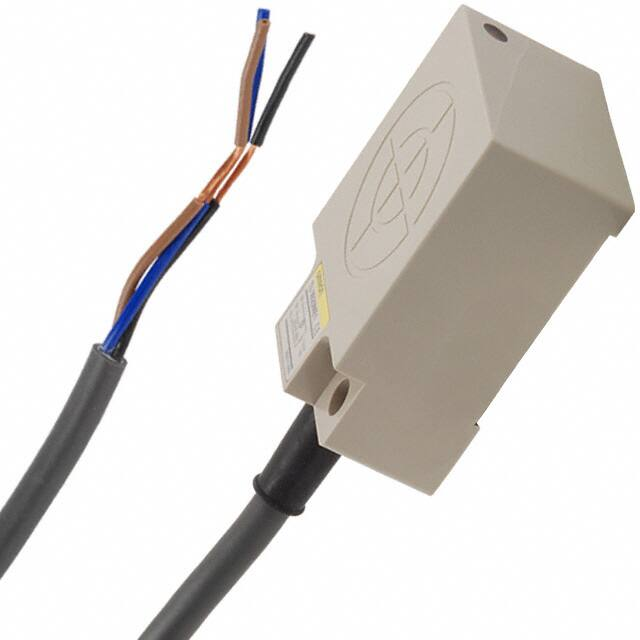

    SENSOR PROX INDUCT 20MM IP67 MOD
TL-W20ME1 10M 数据手册
Flat Inductive Proximity Sensor TL-W CSM_TL-W_DS_E_6_1 Standard Flat Sensors in Many Different Variations • Only 6 mm thick yet provides a sensing distance of 3 mm (TL-W3MC1). • Aluminum die-cast models also available. Be sure to read Safety Precautions on page 7. Ordering Information Sensors [Refer to Dimensions on page 8.] DC 2-Wire Models Appearance Model Operation mode Sensing distance NO Unshielded TL-W5MD1 2M 5 mm NC *1 *2 TL-W5MD2 2M *2 DC 3-Wire Models Appearance Sensing distance Model Operation mode Output configuration NO 1.5 mm Unshielded 3 mm 20 mm --- TL-W3MC1 2M *1 *2 TL-W3MC2 2M TL-W5MC1 2M *1 *2 TL-W5MC2 2M TL-W20ME1 2M *1 TL-W20ME2 2M DC 3-wire, NPN 5 mm Shielded NC *1 TL-W1R5MC1 2M *2 DC 3-wire, NPN TL-W5E1 2M TL-W5E2 2M DC 3-wire, PNP TL-W5F1 2M TL-W5F2 2M *1 *2 *1 5 mm *1. Models with a different frequency are also available to prevent mutual interference. The model numbers are TL-W@M@@5 (e.g., TL-W5MD15). *2. Models with robotics cables are also available. The model numbers are TL-W@MC1-R (e.g., TL-W1R5MC1-R). 1 TL-W Ratings and Specifications DC 2-Wire Models Item Model TL-W5MD@ Sensing distance 5 mm ±10% Set distance 0 to 4 mm Differential travel 10% max. of sensing distance Detectable object Ferrous metal (The sensing distance decreases with non-ferrous metal. Refer to Engineering Data on page 5.) Standard sensing object Iron, 18 × 18 × 1 mm Response frequency *1 500 Hz Power supply voltage (operating voltage range) 12 to 24 VDC (10 to 30 VDC), ripple (p-p): 10% max. Leakage current 0.8 mA max. Control output Load current 3 to 100 mA Residual voltage 3.3 V max. (under load current of 100 mA with cable length of 2 m) Indicators D1 Models: Operation indicator (red), Setting indicator (green) D2 Models: Operation indicator (red) Operation mode (with sensing object approaching) D1 Models: NO D2 Models: NC Protection circuits Load short-circuit protection, Surge suppressor Ambient temperature range Operating/Storage: −25 to 70°C (with no icing or condensation) *2 Ambient humidity range Operating/Storage: 35% to 95% (with no condensation) Temperature influence ±10% max. of sensing distance at 23°C in the temperature range of −25 to 70°C Voltage influence ±2.5% max. of sensing distance at rated voltage in the rated voltage ±15% range Insulation resistance 50 MΩ min. (at 500 VDC) between current-carrying parts and case Dielectric strength 1,000 VAC for 1 min between current-carrying parts and case Vibration resistance Destruction: 10 to 55 Hz, 1.5-mm double amplitude for 2 hours each in X, Y, and Z directions Shock resistance Destruction: 500 m/s2 3 times each in X, Y, and Z directions Degree of protection IEC 60529 IP67, in-house standards: oil-resistant *2 Connection method Pre-wired Models (Standard cable length: 2 m) Weight (packed state) Approx. 45 g Materials Accessories Case Sensing surface Refer to the timing charts under I/O Circuit Diagrams on page 6 for details. Heat-resistant ABS Instruction manual *1. The response frequency is an average value. Measurement conditions are as follows: standard sensing object, a distance of twice the standard sensing object, and a set distance of half the sensing distance. *2. For environments that require oil resistance, the upper limit of the ambient operating temperature range is 40°C. 2 TL-W DC 3-Wire Models Model Item TL-W1R5MC1 TL-W3MC@ TL-W5E1, TL-W5E2 TL-W5F1, TL-W5F2 TL-W5MC@ TL-W20ME1 TL-W20ME2 Sensing distance 1.5 mm ±10% 3 mm ±10% 5 mm ±10% 20 mm ±10% Set distance 0 to 1.2 mm 0 to 2.4 mm 0 to 4 mm 0 to 16 mm Differential travel 10% max. of sensing distance Detectable object Ferrous metal (The sensing distance decreases with non-ferrous metal. Refer to Engineering Data on page 5.) Standard sensing object Iron, 8 × 8 × 1 mm Iron, 12 × 12 × 1 mm Iron, 18 × 18 × 1 mm Response frequency 1 kHz min. 600 Hz min. 1% to 15% of sensing distance 300 Hz min. 40 Hz min. Power supply voltage (operating volt- 12 to 24 VDC (10 to 30 VDC), ripple (p-p): 10% max. age range) 12 to 24 VDC (10 to 30 VDC), ripple (p-p): 20% max. 12 to 24 VDC (10 to 30 VDC), ripple (p-p): 10% max. Current consumption Load current 500 Hz min. Iron, 50 × 50 × 1 mm 15 mA max. at 24 VDC (no-load) 10 mA max. 15 mA max. at 24 VDC (no-load) 8 mA at 12 VDC, 15 mA at 24 VDC NPN open collector 100 mA max. at 30 VDC max. NPN open collector 50 mA max. at 12 VDC (30 VDC max.) 100 mA max. at 24 VDC (30 VDC max.) 200 mA 100 mA max. at 12 VDC 200 mA max. at 24 VDC Control output Residual 1 V max. (under load current of 100 mA with voltage cable length of 2 m) 1 V max. (under 1 V max. (under load 2 V max. (under load current of load current of current of 50 mA with 200 mA with cable length of 2 m) 200 mA with cacable length of 2 m) ble length of 2 m) Indicators Detection indicator (red) Operation mode (with sensing object approaching) NO Protection circuits Reverse polarity protection, Surge suppressor Ambient temperature range Operating/Storage: −25 to 70°C (with no icing or condensation) * Ambient humidity range Operating/Storage: 35% to 95% (with no condensation) Temperature influence ±10% max. of sensing distance at 23°C in the temperature range of −25 to 70°C Voltage influence ±2.5% max. of sens±2.5% max. of sensing distance at rated volt- ing distance at rated age in the rated voltage ±10% range voltage in the rated voltage ±20% range Insulation resistance 50 MΩ min. (at 500 VDC) between current-carrying parts and case Dielectric strength 1,000 VAC, 50/60 Hz for 1 minute between current-carrying parts and case Vibration resistance Destruction: 10 to 55 Hz, 1.5-mm double amplitude for 2 hours each in X, Y, and Z directions C1 Models: NO C2/B2 Models: NC E1/F1 Models: NO E2/F2 Models: NC Refer to the timing charts under I/O Circuit Diagrams on page 6 for details. Shock resistance Destruction: 500 m/s2 3 times each in X, Y, and Z directions Degree of protection IEC 60529 IP67, in-house standards: oil-resistant * Connection method Pre-wired Models (Standard cable length: 2 m) Weight (packed state) Approx. 30 g Materials Case Heat-resistant ABS Sensing surface Heat-resistant ABS Accessories Mounting Bracket, Instruction manual Approx. 45 g ±2.5% max. of sensing distance at rated voltage in the rated voltage ±10% range Destruction: 500 m/s2 10 times each in X, Y, and Z directions Approx. 70 g Approx. 180 g Aluminum die-cast Heat-resistant ABS Instruction manual * For environments that require oil resistance, the upper limit of the ambient operating temperature range is 40°C. 3 TL-W Engineering Data (Typical) Sensing Area 4 Y X 3 TL-W5MC1/-W5MD@ 4 Y X 3 Distance X (mm) TL-W3MC1 Distance X (mm) Distance X (mm) TL-W1R5MC1 6 5 4 Y X 2 2 1 1 3 2 1 −6 −4 −2 0 2 TL-W5E/-W5F −4 −2 0 2 4 Sensing head Distance Y (mm) −8 −6 −4 −2 0 2 Sensing head 4 6 8 Distance Y (mm) TL-W20@ 6 Distance X (mm) Distance X (mm) −6 4 Distance Y (mm) Sensing head 5 4 30 Y X 25 20 Y X 3 15 2 10 1 5 −10 −8 −6 −4 −2 0 2 Sensing head 4 6 8 Distance Y (mm) −20 −15 −10 −5 0 5 Sensing head 10 15 20 Distance Y (mm) 4 TL-W Influence of Sensing Object Size and Material d× d t = 1 mm X 3 4 d× d TL-W5MC1 Distance X (mm) 4 TL-W3MC1 Distance X (mm) Distance X (mm) TL-W1R5MC1 t = 1 mm X 3 Iron 7 d× d t = 1 mm X 6 5 Iron Stainless steel (SUS304) Stainless steel (SUS304) 4 2 2 Brass Iron Aluminum Copper Stainless steel (SUS304) 1 1 Brass 3 Brass Aluminum 2 Copper 1 Copper Aluminum 10 Distance X (mm) TL-W5E@/-W5F@/-W5MD@ 6 0 20 30 40 50 60 Side length of sensing object: d (mm) d× d X t = 1 mm Iron 5 Stainless steel (SUS304) 4 10 20 30 40 50 60 Side length of sensing object: d (mm) 0 10 20 30 40 50 60 Side length of sensing object: d (mm) TL-W20@ Distance X (mm) 0 24 22 d× d t = 1 mm X 18 16 14 12 3 Brass Iron 20 Stainless steel (SUS304) 10 8 2 Brass Aluminum 6 Aluminum 4 1 2 0 5 10 15 20 25 30 35 40 45 Side length of sensing object: d (mm) 0 10 20 30 40 50 60 70 80 90 Side length of sensing object: d (mm) 5 TL-W I/O Circuit Diagrams DC 2-Wire Models Operation mode Model Timing chart Non-sensing area Unstable Set position Stable sensing sensing area area Output circuit Proximity Sensor Sensing object (%) NO TL-W5MD1 100 Rated sensing distance 80 (TYP) 0 ON OFF Brown ON OFF Operation indicator (red) ON OFF Load Setting indicator (green) +V Proximity Sensor main circuit Control output Blue Non-sensing area Sensing area Note: The load can be connected to either the +V or 0 V side. Sensing object (%) NC TL-W5MD2 0V Proximity Sensor 100 Rated sensing distance 0 ON OFF Operation indicator (red) ON OFF Control output DC 3-Wire Models Operation mode Model Timing chart Sensing object NO TL-W1R5MC1 TL-W3MC1 TL-W5MC1 NC TL-W3MC2 TL-W5MC2 Present Not present Output transistor (load) ON OFF Detection indicator (red) ON OFF Sensing object Present Not present Output transistor (load) ON OFF Detection indicator (red) ON OFF Sensing object NO TL-W5E1 TL-W20ME1 NC Load (between brown and black leads) NO TL-W5F1 High Low Detection indicator (red) ON OFF NC TL-W5F2 Load Output Blue 0V * Load current: 100 mA max. Brown Operate Reset Output voltage (between black and blue leads) High Low Detection indicator (red) ON OFF +V 100 Ω Load Proximity Sensor main circuit 4.7 kΩ 2.2 Ω Present Not present Load (between brown and black leads) Black*1 Output *2 Blue Tr 0V *1. Load current: 200 mA max. *2. When a transistor is connected. Present Not present Operate Reset Load (between blue and black leads) Output voltage (between blue and black leads) High Low Detection indicator (red) ON OFF Sensing object +V Black * Proximity Sensor main circuit Operate Reset Output voltage (between black and blue leads) Sensing object Brown 100 Ω Present Not present Sensing object TL-W5E2 TL-W20ME2 Output circuit Present Not present Load (between blue and black leads) Operate Reset Output voltage (between blue and black leads) High Low Detection indicator (red) ON OFF Brown +V Tr Proximity Sensor main circuit *2 Black 2.2 Ω Output *1 Load 4.7 kΩ 100 Ω Blue 0V *1. Load current: 200 mA max. *2. When a transistor is connected. 6 TL-W Safety Precautions Refer to Warranty and Limitations of Liability. WARNING Mutual Interference This product is not designed or rated for ensuring safety of persons either directly or indirectly. Do not use it for such purposes. When installing Sensors face-to-face or side-by-side, ensure that the minimum distances given in the following table are maintained. B A Precautions for Correct Use Do not use this product under ambient conditions that exceed the ratings. ● Design Influence of Surrounding Metal When mounting the Sensor within a metal panel, ensure that the clearances given in the following table are maintained. Failure to maintain these distances may cause deterioration in the performance of the Sensor. Metal on a Single Side (Not Exceeding the Height of the Sensor Surface) m Metals on Both Sides and in Front of the Sensor Sensing surface l Proximity Sensor Sensing surface n l Proximity Sensor Mutual Interference (Unit: mm) Model Distance TL-W1R5MC1 TL-W3MC@ TL-W5MD@ TL-W5MC1@ TL-W20ME@ TL-W5E@/-W5F@ A B 75 (50) 90 (60) 25 (8) 30 (10) 120 (80) 60 (30) 200 (100) 50 200 (100) 35 Note: Values in parentheses apply to Sensors operating at different frequencies. ● Mounting Influence of Surrounding Metal (Unit: mm) Model Distance TL-W1R5MC1 TL-W3MC@ TL-W5MD@ TL-W5MC1 TL-W20ME@ TL-W5E@/-W5F@ l 2 3 m 0 5 25 0 n 8 12 Model 20 16 0 • Use M3 flat-head screws to mount the TL-W1R5MC1 and TLW3MC1. • Do not exceed the torque in the following table when tightening the resin cover screws. 100 20 TL-W1R5MC1 TL-W3MC@ TL-W5MD@ TL-W20M@ Torque 0.98 N·m 1.5 N·m ● Adjustment Turning ON the Power An error pulse will occur (approximately 1 ms) if adjustments are made when turning ON the power or making AND connections. Applicable e-CON Connector Models and Manufacturers The companies and model number of e-CON connections that can be used with Sensor cables are listed in the following table. Confirm applicability when purchasing e-CON connectors for connection to Pre-wired Sensors. Model TL-W1R5@/-W3@ Tyco Electronics AMP K.K. 1-1473562-4 (red) 7 TL-W (Unit: mm) Dimensions Tolerance class IT16 applies to dimensions in this data sheet unless otherwise specified. TL-W1R5MC1 TL-W3MC@ 25 16±0.2 5±0.2 27 17±0.2 3 5±0.2 Detection indicator (red) 8 8 9 * Mounting hole for M3 pan-head screw 90° 6 dia. Mounting Bracket (Attachment) 7.8 1 8 Sensing surface 5.5 Mounting hole for M3 pan-head screw 90° 6 dia. 6 7.8 1 3.2 dia. * 9 Mounting Bracket (Attachment) 22.4 16 (See note.) 3.2 3.2 3.2 dia. Indicator Indicator R1.6 R1.6 R1.6 3.2 Detection indicator (red) 10 Sensing surface 22.4 16 (See note.) 3 R1.6 3.2 8 5 0.2 7 Note: Mounting hole dimension: 17 ±0.2. Material: Stainless steel (SUS304) Indicator * 2.9-dia. vinyl-insulated round cable with 3 conductors (Conductor cross section: 0.14 mm2, Insulator diameter: 0.9 mm), Standard length: 2 m TL-W5MC@ TL-W5MD@ 10 5.5 0.2 9 Note: Mounting hole dimension: 17 ±0.20. Material: Stainless steel (SUS304) Indicator * 2.9-dia. vinyl-insulated round cable with 3 conductors (Conductor cross section: 0.14 mm2, Insulator diameter: 0.9 mm), Standard length: 2 m TL-W5E@ TL-W5F@ Sensing surface 30.5 8.5 18 Detection indicator (red) 4.5 10.5 8 10 *1 18 4 4.5 12±0.1 0 24.9 -0.4 3.5 5 Indicator *2 Mounting Hole Dimensions 12.5 10 6.5 7.5 15 16-dia. sensing surface (2) 50 * 4.2 dia. 8 3 15±0.2 *1. TL-W5MC1 4-dia. vinyl-insulated round cable with 3 conductors (Conductor cross section: 0.2 mm2, Insulator diameter: 1.2 mm), Standard length: 2 m TL-W5MD@ 4-dia. vinyl-insulated round cable with 2 conductors (Conductor cross section: 0.3 mm2, Insulation diameter: 1.3 mm), Standard length: 2 m *2. C Models: Detection indicator (red) D Models: Operation indicator (red), Setting indicator (green) 10 Two, 4.5 dia. 4 7.2 dia. * 4-dia. vinyl-insulated round cable with 3 conductors (Conductor cross section: 0.2 mm2, Insulator diameter: 1.2 mm), Standard length: 2 m TL-W20ME@ Sensing surface 40 30±0.1 18 5 27±0.1 5 6 20 Two, 5.5-dia. mounting holes Detection indicator (red) 23 18 1 53 1.5 6-dia. vinyl-insulated round cable with 3 conductors (Conductor cross section: 0.5 mm2, Insulator diameter: 1.9 mm), Standard length: 2 m 8 Terms and Conditions of Sale 1. Offer; Acceptance. These terms and conditions (these "Terms") are deemed part of all quotes, agreements, purchase orders, acknowledgments, price lists, catalogs, manuals, brochures and other documents, whether electronic or in writing, relating to the sale of products or services (collectively, the "Products") by Omron Electronics LLC and its subsidiary companies (“Omron”). Omron objects to any terms or conditions proposed in Buyer’s purchase order or other documents which are inconsistent with, or in addition to, these Terms. 2. Prices; Payment Terms. All prices stated are current, subject to change without notice by Omron. Omron reserves the right to increase or decrease prices on any unshipped portions of outstanding orders. Payments for Products are due net 30 days unless otherwise stated in the invoice. 3. Discounts. Cash discounts, if any, will apply only on the net amount of invoices sent to Buyer after deducting transportation charges, taxes and duties, and will be allowed only if (i) the invoice is paid according to Omron’s payment terms and (ii) Buyer has no past due amounts. 4. Interest. Omron, at its option, may charge Buyer 1-1/2% interest per month or the maximum legal rate, whichever is less, on any balance not paid within the stated terms. 5. Orders. Omron will accept no order less than $200 net billing. 6. Governmental Approvals. Buyer shall be responsible for, and shall bear all costs involved in, obtaining any government approvals required for the importation or sale of the Products. 7. Taxes. All taxes, duties and other governmental charges (other than general real property and income taxes), including any interest or penalties thereon, imposed directly or indirectly on Omron or required to be collected directly or indirectly by Omron for the manufacture, production, sale, delivery, importation, consumption or use of the Products sold hereunder (including customs duties and sales, excise, use, turnover and license taxes) shall be charged to and remitted by Buyer to Omron. 8. Financial. If the financial position of Buyer at any time becomes unsatisfactory to Omron, Omron reserves the right to stop shipments or require satisfactory security or payment in advance. If Buyer fails to make payment or otherwise comply with these Terms or any related agreement, Omron may (without liability and in addition to other remedies) cancel any unshipped portion of Products sold hereunder and stop any Products in transit until Buyer pays all amounts, including amounts payable hereunder, whether or not then due, which are owing to it by Buyer. Buyer shall in any event remain liable for all unpaid accounts. 9. Cancellation; Etc. Orders are not subject to rescheduling or cancellation unless Buyer indemnifies Omron against all related costs or expenses. 10. Force Majeure. Omron shall not be liable for any delay or failure in delivery resulting from causes beyond its control, including earthquakes, fires, floods, strikes or other labor disputes, shortage of labor or materials, accidents to machinery, acts of sabotage, riots, delay in or lack of transportation or the requirements of any government authority. 11. Shipping; Delivery. Unless otherwise expressly agreed in writing by Omron: a. Shipments shall be by a carrier selected by Omron; Omron will not drop ship except in “break down” situations. b. Such carrier shall act as the agent of Buyer and delivery to such carrier shall constitute delivery to Buyer; c. All sales and shipments of Products shall be FOB shipping point (unless otherwise stated in writing by Omron), at which point title and risk of loss shall pass from Omron to Buyer; provided that Omron shall retain a security interest in the Products until the full purchase price is paid; d. Delivery and shipping dates are estimates only; and e. Omron will package Products as it deems proper for protection against normal handling and extra charges apply to special conditions. 12. Claims. Any claim by Buyer against Omron for shortage or damage to the Products occurring before delivery to the carrier must be presented in writing to Omron within 30 days of receipt of shipment and include the original transportation bill signed by the carrier noting that the carrier received the Products from Omron in the condition claimed. 13. Warranties. (a) Exclusive Warranty. Omron’s exclusive warranty is that the Products will be free from defects in materials and workmanship for a period of twelve months from the date of sale by Omron (or such other period expressed in writing by Omron). Omron disclaims all other warranties, express or implied. (b) Limitations. OMRON MAKES NO WARRANTY OR REPRESENTATION, EXPRESS OR IMPLIED, ABOUT NON-INFRINGEMENT, MERCHANTABIL- 14. 15. 16. 17. 18. ITY OR FITNESS FOR A PARTICULAR PURPOSE OF THE PRODUCTS. BUYER ACKNOWLEDGES THAT IT ALONE HAS DETERMINED THAT THE PRODUCTS WILL SUITABLY MEET THE REQUIREMENTS OF THEIR INTENDED USE. Omron further disclaims all warranties and responsibility of any type for claims or expenses based on infringement by the Products or otherwise of any intellectual property right. (c) Buyer Remedy. Omron’s sole obligation hereunder shall be, at Omron’s election, to (i) replace (in the form originally shipped with Buyer responsible for labor charges for removal or replacement thereof) the non-complying Product, (ii) repair the non-complying Product, or (iii) repay or credit Buyer an amount equal to the purchase price of the non-complying Product; provided that in no event shall Omron be responsible for warranty, repair, indemnity or any other claims or expenses regarding the Products unless Omron’s analysis confirms that the Products were properly handled, stored, installed and maintained and not subject to contamination, abuse, misuse or inappropriate modification. Return of any Products by Buyer must be approved in writing by Omron before shipment. Omron Companies shall not be liable for the suitability or unsuitability or the results from the use of Products in combination with any electrical or electronic components, circuits, system assemblies or any other materials or substances or environments. Any advice, recommendations or information given orally or in writing, are not to be construed as an amendment or addition to the above warranty. See http://www.omron247.com or contact your Omron representative for published information. Limitation on Liability; Etc. OMRON COMPANIES SHALL NOT BE LIABLE FOR SPECIAL, INDIRECT, INCIDENTAL, OR CONSEQUENTIAL DAMAGES, LOSS OF PROFITS OR PRODUCTION OR COMMERCIAL LOSS IN ANY WAY CONNECTED WITH THE PRODUCTS, WHETHER SUCH CLAIM IS BASED IN CONTRACT, WARRANTY, NEGLIGENCE OR STRICT LIABILITY. Further, in no event shall liability of Omron Companies exceed the individual price of the Product on which liability is asserted. Indemnities. Buyer shall indemnify and hold harmless Omron Companies and their employees from and against all liabilities, losses, claims, costs and expenses (including attorney's fees and expenses) related to any claim, investigation, litigation or proceeding (whether or not Omron is a party) which arises or is alleged to arise from Buyer's acts or omissions under these Terms or in any way with respect to the Products. Without limiting the foregoing, Buyer (at its own expense) shall indemnify and hold harmless Omron and defend or settle any action brought against such Companies to the extent based on a claim that any Product made to Buyer specifications infringed intellectual property rights of another party. Property; Confidentiality. Any intellectual property in the Products is the exclusive property of Omron Companies and Buyer shall not attempt to duplicate it in any way without the written permission of Omron. Notwithstanding any charges to Buyer for engineering or tooling, all engineering and tooling shall remain the exclusive property of Omron. All information and materials supplied by Omron to Buyer relating to the Products are confidential and proprietary, and Buyer shall limit distribution thereof to its trusted employees and strictly prevent disclosure to any third party. Export Controls. Buyer shall comply with all applicable laws, regulations and licenses regarding (i) export of products or information; (iii) sale of products to “forbidden” or other proscribed persons; and (ii) disclosure to non-citizens of regulated technology or information. Miscellaneous. (a) Waiver. No failure or delay by Omron in exercising any right and no course of dealing between Buyer and Omron shall operate as a waiver of rights by Omron. (b) Assignment. Buyer may not assign its rights hereunder without Omron's written consent. (c) Law. These Terms are governed by the law of the jurisdiction of the home office of the Omron company from which Buyer is purchasing the Products (without regard to conflict of law principles). (d) Amendment. These Terms constitute the entire agreement between Buyer and Omron relating to the Products, and no provision may be changed or waived unless in writing signed by the parties. (e) Severability. If any provision hereof is rendered ineffective or invalid, such provision shall not invalidate any other provision. (f) Setoff. Buyer shall have no right to set off any amounts against the amount owing in respect of this invoice. (g) Definitions. As used herein, “including” means “including without limitation”; and “Omron Companies” (or similar words) mean Omron Corporation and any direct or indirect subsidiary or affiliate thereof. Certain Precautions on Specifications and Use 1. Suitability of Use. Omron Companies shall not be responsible for conformity with any standards, codes or regulations which apply to the combination of the Product in the Buyer’s application or use of the Product. At Buyer’s request, Omron will provide applicable third party certification documents identifying ratings and limitations of use which apply to the Product. This information by itself is not sufficient for a complete determination of the suitability of the Product in combination with the end product, machine, system, or other application or use. Buyer shall be solely responsible for determining appropriateness of the particular Product with respect to Buyer’s application, product or system. Buyer shall take application responsibility in all cases but the following is a non-exhaustive list of applications for which particular attention must be given: (i) Outdoor use, uses involving potential chemical contamination or electrical interference, or conditions or uses not described in this document. (ii) Use in consumer products or any use in significant quantities. (iii) Energy control systems, combustion systems, railroad systems, aviation systems, medical equipment, amusement machines, vehicles, safety equipment, and installations subject to separate industry or government regulations. (iv) Systems, machines and equipment that could present a risk to life or property. Please know and observe all prohibitions of use applicable to this Product. NEVER USE THE PRODUCT FOR AN APPLICATION INVOLVING SERIOUS RISK TO LIFE OR PROPERTY OR IN LARGE QUANTITIES WITHOUT ENSURING THAT THE SYSTEM AS A WHOLE HAS BEEN DESIGNED TO 2. 3. 4. 5. ADDRESS THE RISKS, AND THAT THE OMRON’S PRODUCT IS PROPERLY RATED AND INSTALLED FOR THE INTENDED USE WITHIN THE OVERALL EQUIPMENT OR SYSTEM. Programmable Products. Omron Companies shall not be responsible for the user’s programming of a programmable Product, or any consequence thereof. Performance Data. Data presented in Omron Company websites, catalogs and other materials is provided as a guide for the user in determining suitability and does not constitute a warranty. It may represent the result of Omron’s test conditions, and the user must correlate it to actual application requirements. Actual performance is subject to the Omron’s Warranty and Limitations of Liability. Change in Specifications. Product specifications and accessories may be changed at any time based on improvements and other reasons. It is our practice to change part numbers when published ratings or features are changed, or when significant construction changes are made. However, some specifications of the Product may be changed without any notice. When in doubt, special part numbers may be assigned to fix or establish key specifications for your application. Please consult with your Omron’s representative at any time to confirm actual specifications of purchased Product. Errors and Omissions. Information presented by Omron Companies has been checked and is believed to be accurate; however, no responsibility is assumed for clerical, typographical or proofreading errors or omissions. OMRON INDUSTRIAL AUTOMATION • THE AMERICAS HEADQUARTERS • Schaumburg, IL USA • 847.843.7900 • 800.556.6766 • www.omron247.com OMRON CANADA, INC. • HEAD OFFICE Toronto, ON, Canada • 416.286.6465 • 866.986.6766 • www.omron247.com OMRON ARGENTINA • SALES OFFICE Cono Sur • 54.11.4783.5300 OMRON ELECTRONICS DE MEXICO • HEAD OFFICE México DF • 52.55.59.01.43.00 • 001.800.556.6766 • mela@omron.com OMRON CHILE • SALES OFFICE Santiago • 56.9.9917.3920 OMRON ELECTRONICS DE MEXICO • SALES OFFICE Apodaca, N.L. • 52.81.11.56.99.20 • 001.800.556.6766 • mela@omron.com OTHER OMRON LATIN AMERICA SALES 54.11.4783.5300 OMRON ELETRÔNICA DO BRASIL LTDA • HEAD OFFICE São Paulo, SP, Brasil • 55.11.2101.6300 • www.omron.com.br Omron Europe B.V. • Wegalaan 67-69, NL-2132 JD, Hoofddorp, The Netherlands. • Tel: +31 (0) 23 568 13 00 • Fax: +31 (0) 23 568 13 88 • www.industrial.omron.eu Automation Systems • Programmable logic controllers (PLC) • Human machine interfaces (HMI) • Remote I/O • Industrial PC’s • Software Authorized Distributor: Motion & Drives • Motion controllers • Servo systems • AC drives Control Components • Temperature controllers • Power supplies • Timers • Counters • Programmable relays • Digital panel indicators • Electromechanical relays • Monitoring products • Solid-state relays • Limit switches • Pushbutton switches • Low voltage switch gear Sensing & Safety • Photoelectric sensors • Inductive sensors • Capacitive & pressure sensors • Cable connectors • Displacement & width-measuring sensors • Vision systems • Safety networks • Safety sensors • Safety units/relay units • Safety door/guard lock switches CSM_TL-W_DS_E_6_1 08/11 Note: Specifications are subject to change. Printed on recycled paper. © 2011 Omron Electronics LLC Printed in U.S.A.
