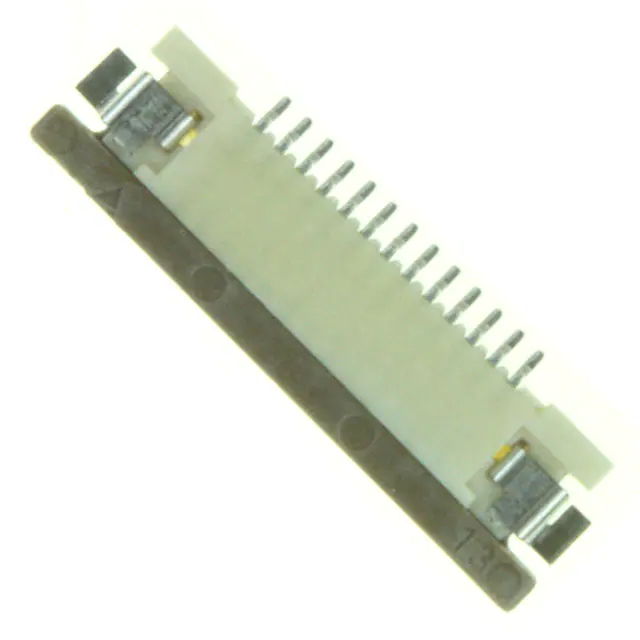

XF2L For FPC ZIF Slide-locking Connector (0.5-mm Pitch) Greater Freedom in Board Design with a Bottom Wall and the Smallest On-board Area in the Industry • Smallest on-board area and volume in the industry. • Low on-board height of only 1.2 mm. • Highest board design surface efficiency in the industry with a bottom wall preventing terminal exposure. • Construction with secure slider locking mechanism. • Applicable FPC thickness of 0.3 mm (Gold-plated type). • Halogen Free (*) * OMRON uses the following standard to determine halogen-free construction: 900 ppm max. for Br, 900 ppm max. for Cl, and 1,500 ppm max. for Br+Cl. RoHS compliant ■ Ratings and Specifications ■ Materials and Finish 0.5 A AC/DC 50 V AC/DC 30 mΩ max. (at 20 mV DC max., 100 mA max.) 100 MΩ min. (at 250 V DC) 250 V AC for 1 min. (leakage current: 1 mA max.) 20 times −30 to 85 °C (With no icing or condensation) Model XF2L (Upper-sided Models) XF2L (Lower-sided Models) Item Housing LCP resin (UL94 V-0)/natural Slider LCP resin (UL94 V-0)/black LCP resin (UL94 V-0)/brown Spring copper alloy/nickel substrate (2 μm) Contacts Gold-plated contacts (0.15 μm) Hold-down Copper alloy/tin-plated (1.5 μm) ■ Dimensions (Unit: mm) XF2L-@@@5-1A Terminal No.1 0.5 F E B A Table of Dimensions Upper sided Model A B C XF2L-0425-1A 1.5 5.9 6.9 XF2L-0625-1A 2.5 6.9 7.9 XF2L-0725-1A 3.0 7.4 8.4 XF2L-0825-1A 3.5 7.9 8.9 XF2L-0925-1A 4.0 8.4 9.4 XF2L-1025-1A 4.5 8.9 9.9 XF2L-1225-1A 5.5 9.9 10.9 XF2L-1325-1A 6.0 10.4 11.4 XF2L-1825-1A 8.5 12.9 13.9 XF2L-2125-1A 10.0 14.4 15.4 XF2L-2625-1A 12.5 16.9 17.9 XF2L-3025-1A 14.5 18.9 19.9 D 2.6 3.6 4.1 4.6 5.1 5.6 6.6 7.1 9.6 11.1 13.6 15.6 E 5.88 6.88 7.38 7.88 8.38 8.88 9.88 10.38 12.88 14.38 16.88 18.88 F 6.88 7.88 8.38 8.88 9.38 9.88 10.88 11.38 13.88 15.38 17.88 19.88 G 5.28 6.28 6.78 7.28 7.78 8.28 9.28 9.78 12.28 13.78 16.28 18.28 H 7.28 8.28 8.78 9.28 9.78 10.28 11.28 11.78 14.28 15.78 18.28 20.28 Lower sided 0.45 Model A B C Cross-section diagram: X-X Pins*1 5 XF2L-0535-1A 2.0 6.4 7.4 1.35 (Effective 2.3 6 XF2L-0635-1A 2.5 6.9 7.9 3.05 stacking length) 7 XF2L-0735-1A 3.0 7.4 8.4 4.55 8 XF2L-0835-1A 3.5 7.9 8.9 1.2 10 XF2L-1035-1A 4.5 8.9 9.9 0.45 12 XF2L-1235-1A 5.5 9.9 10.9 3.45 With slider open Cross-section diagram: Y-Y 13 XF2L-1335-1A 6.0 10.4 11.4 Recommended FPC Dimensions 15 XF2L-1535-1A 7.0 11.4 12.4 (D - 0.1) ± 0.05 18 XF2L-1835-1A 8.5 12.9 13.9 ± 0.05 ± 0.1 A 0.5 19 XF2L-1935-1A 9.0 13.4 14.4 0.5 ± 0.05 20 XF2L-2035-1A 9.5 13.9 14.9 0.35 ± 0.03 22 XF2L-2235-1A 10.5 14.9 15.9 (1.35) 24 XF2L-2435-1A 11.5 15.9 16.9 Effective stacking length 2.5 MIN. 30 XF2L-3035-1A 14.5 18.9 19.9 D 3.1 3.6 4.1 4.6 5.6 6.6 7.1 8.1 9.6 10.1 10.6 11.6 12.6 15.6 E 6.38 6.88 7.38 7.88 8.88 9.88 10.38 11.38 12.88 13.38 13.88 14.88 15.88 18.88 F 7.38 7.88 8.38 8.88 9.88 10.88 11.38 12.38 13.88 14.38 14.88 15.88 16.88 19.88 G 5.78 6.28 6.78 7.28 8.28 9.28 9.78 10.78 12.28 12.78 13.28 14.28 15.28 18.28 H 7.78 8.28 8.78 9.28 10.28 11.28 11.78 12.78 14.28 14.78 15.28 16.28 17.28 20.28 0.2 1 1 Reference pin mark C XF2L-@@25-1A (Upper-sided Models) 2.3 D FPC insertion dimension X 3.05 4.55 1.2 3.45 X XF2L-@@35-1A (Lower-sided Models) D FPC insertion dimension Y 1.2 Y PCB Dimensions (TOP VIEW) 0.55±0.1 Pins*1 4 6 7 8 9 10 12 13 18 1.35 (Effective 21 stacking length) 26 30 1.2 F E A±0.05 0.5±0.05 0.25+0.05 0 (0.3) 1±0.1 With slider open (5) Reinforcement board * 1.34±0.1 G±0.1 H±0.1 T = 0.3 ± 0.03 (Conductive plating) * Use polyimide and thermoset adhesive for reinforcement film material. ■ Ordering Information Pins *1 4 5 6 7 8 9 *1. *2. List of Models Upper sided Lower sided Upper sided Lower sided Upper sided Lower sided Upper sided Lower sided Upper sided Model XF2L-0425-1A XF2L-0535-1A XF2L-0625-1A XF2L-0635-1A XF2L-0725-1A XF2L-0735-1A XF2L-0825-1A XF2L-0835-1A XF2L-0925-1A Pins *1 10 12 13 15 18 List of Models Upper sided Lower sided Upper sided Lower sided Upper sided Lower sided Lower sided Upper sided Lower sided Model XF2L-1025-1A XF2L-1035-1A XF2L-1225-1A XF2L-1235-1A XF2L-1325-1A XF2L-1335-1A XF2L-1535-1A XF2L-1825-1A XF2L-1835-1A Pins *1 19 20 21 22 24 26 30 - List of Models Lower sided Lower sided Upper sided Lower sided Lower sided Upper sided Upper sided Lower sided - Model XF2L-1935-1A XF2L-2035-1A XF2L-2125-1A XF2L-2235-1A XF2L-2435-1A XF2L-2625-1A XF2L-3025-1A XF2L-3035-1A - Quantity per reel (unit) *2 3,000 Please consult your OMRON representative for available pin count. Please order by integer multiple of the quantity per reel. 17 XF2L Rated current Rated voltage Contact resistance Insulation resistance Dielectric strength Insertion durability Ambient operating temperature

物料型号:XF2L ZIF Slide-locking Connector
器件简介:该连接器为0.5毫米间距的滑动锁定式连接器,适用于FPC,具有行业最小的板载面积和体积,低至1.2毫米的板载高度,以及防止端子暴露的底部壁设计。
引脚分配:文档提供了不同型号的XF2L连接器的尺寸和引脚分配,例如XF2L-0425-1A、XF2L-0625-1A等,每个型号都有其特定的尺寸和引脚数量。
参数特性:包括额定电流0.5A AC/DC,额定电压50V AC/DC,接触电阻最大30毫欧,绝缘电阻最小100兆欧,耐电压250V AC持续1分钟,插入耐久性20次,工作温度范围为-30至85°C。
功能详解:连接器具有滑动锁定机制,确保连接的安全性。同时,文档还提供了上侧和下侧模型的材料和表面处理信息。
应用信息:适用于需要FPC连接的应用,特别是在板载空间受限或需要防止端子暴露的场合。
封装信息:提供了连接器的详细尺寸和推荐FPC尺寸,以及PCB布局的参考视图。
