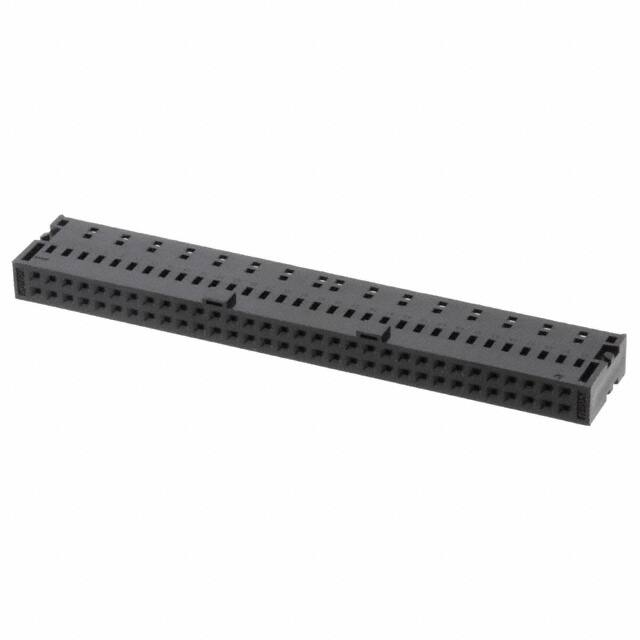

New Product Crimped MIL Connector Sockets for Discrete Wires XG5N/XG5N-U Crimped Sockets for Discrete Wires Join the MIL Connector Series • XG5N-U Sockets with OMRON’s unique lock enable onehand insertion with a secure lock. Save up to 24% of the space required for the XG4A. • See the "Standards certification / conformity list" for information on conformity to certification standards. ■ Conceptual Application Diagram Discrete wires XG5N-U XG5N XG4C XG4A ■ Ratings and Characteristics Rated current 3 A/contact (with AWG22 wire) 2 A/contact (with AWG24 wire) 1 A/contact (with AWG26 or AWG28 wire) Rated voltage 250 VAC Contact resistance 20 mΩ max. (at 20 mV, 100 mA max.) Insulation resistance 1,000 MΩ min. (at 500 V DC) Withstand voltage 500 VAC for 60 s (leakage current: 1 mA max.) Total insertion force No. of contacts × 1.96 N max. Individual pull-out force 0.29 N min. Insertion durability 50 times Ambient operating temperature −55 to 105°C (with no icing at low temperature) ■ Applicable Contacts and Wires Applicable wires Applicable Contacts XG5W-0231 XG5W-0232 Conductor construction AWG No. (UL1007 twisted wires) (elements/element diameter (mm)) 22 17/0.16 24 11/0.16 26 7/0.16 24 11/0.16 26 7/0.16 28 7/0.127 ■ Materials and Finish Housing Fiber-glass reinforced PBT resin (UL94 V-2)/black Lock Levers Mating end Contacts Crimped section POM resin (UL94 HB)/black Phosphor bronze/nickel base, gold plated (0.15 μm) Phosphor bronze/nickel base, tin plated (2.0 μm) 1 XG5N/XG5N-U Crimped MIL Connector Sockets for Discrete Wires ■ Mating Sockets Plugs XG4C Box-type Plugs XG5N-U Discrete Wire Crimping Lock Levers Mates with Sockets Plugs XG4A 2-tier Plugs XG5N Discrete Wire Crimping XG4E IDC Plugs with Long Locks XG4S Strain Reliefs XG4A MIL Plugs with Long Locks XG4C Box-type Plugs XG8W Original Plugs Mates with ■ Dimensions (Unit: mm) XG5N-U (with Lock Levers Attached) (C) (16.4) (15.6) (D) A B 2.54 2.54 6.10 7.90 XG5N 14.4 Polarity guide Triangular mark A B 2.54 2.54 6.10 2 Dimension (mm) No. of contacts A B C D 10 17.26 10.16 26.80 26.20 14 22.34 15.24 31.88 31.28 16 24.88 17.78 34.42 33.82 20 29.96 22.86 39.50 38.90 26 37.58 30.48 47.12 46.52 30 42.66 35.56 52.20 51.60 34 47.74 40.64 57.28 56.68 40 55.36 48.26 64.90 64.30 50 68.06 60.96 77.60 77.00 60 80.76 73.66 90.30 89.70 64 85.84 78.74 95.38 94.78 XG5N/XG5N-U Crimped MIL Connector Sockets for Discrete Wires ■ Ordering Information Appearance Socket and Lock Set Note: The Locks and Sockets are provided separately. Socket Housing Lock Levers *1 Crimp Contacts, Type 1 Crimp Contacts, Type 2 Model Model Model No. of polarity guides Model Model 0 XG5N-100-U XG5N-100 1 XG5N-101-U XG5N-101 14 1 XG5N-141-U XG5N-141 16 1 XG5N-161-U XG5N-161 20 1 XG5N-201-U XG5N-201 26 1 XG5N-261-U XG5N-261 30 1 XG5N-301-U XG5N-301 34 1 XG5N-341-U XG5N-341 40 1 XG5N-401-U XG5N-401 1 XG5N-501-U XG5N-501 2 XG5N-502-U XG5N-502 1 XG5N-601-U XG5N-601 2 XG5N-602-U XG5N602 1 XG5N-641-U XG5N-641 2 XG5N-642-U XG5N-642 No. of contacts 10 50 60 64 XG5W-0231 (loose contacts) XG5W-0232 (loose contacts) XG5W-0231-R *2 (reel contacts) XG5W-0232-R *2 (reel contacts) XG5U-0001 *1. Each XG5N-@@@ Connector requires two Lock Levers. *2. Order the required number of reels (10,000 contacts). Note: The pitch between the two polarity guides on Connectors with 50, 60, or 64 contacts is 22.86 mm. ■ Specified Tools ● Manual Crimping Tool XY2B-7007 ● Automatic Applicator Model XY2B-7007 ● Contact Removal Tool XY2E-0003 Use an Applicator that is manufactured by Japan Automatic Machine Co., Ltd. Contact information is provided below. Japan: Japan Automatic Machine Co., Ltd. TEL 03-3756-1434 China: Japan Automatic Machine Technology (Huizhou) Ltd. 6-1-B,Songshan Industrial Park, Huizhou Zhongkai Hi-Tech Industrial Development Zone, Huizhou,Guangdong,China TEL(86-752)2771-614 FAX(86-752)2771-619 South-eastern Asia: Japan Automatic Machine Singapore Pte. Ltd. HB Centre 12 Tannery Road #04-02, Singapore 347722 TEL 65-6545-8140 FAX 65-6545-8141 USA, Europe: Toyojamco, Ltd. 8370 Burnahm Road Suite 200 EL Paso, TX 79907 USA TEL (915)595-8825 FAX (915)595-8794 Model XY2E-0003 Crimp Contacts, Type 1 Crimp Contacts, Type 2 Crimping Machine Strip Crimper Planned for the near future. *1 SCA-106700 *2 *1. Inquire for details. *2. This model number is for standard specifications. Inquire for other specifications. 3 XG5N/XG5N-U Crimped MIL Connector Sockets for Discrete Wires ■ Safety Precautions ● Crimping Method ● Attaching the Lock Levers Always use the specified Crimping Tool or Applicator to wire the crimped contacts. Refer to the instruction sheet that is provided separately for details. Attach the holes in the Lock Levers to the protrusions on both sides of the housing and make sure that they are set securely. ● Contact Insertion Method Confirm the orientation of the crimped contacts and then insert them all the way to the back of the Socket. After insertion, confirm that the lances are securely set in the lance holes on the socket housing. Lance Lance hole ● Precautions for Correct Use Before Insertion After Insertion (Set in Socket) ● Contact Replacement Method To remove contacts that have been incorrectly inserted, always use the XY2E-0003 Contact Removal Tool. (1) Insert the end of the Removal Tool into the lance hole in the socket housing and press the lance all the way inside the socket housing. (2) While pressing in on the lance, pull out the Contact. (3) Insert a new Contact. When mating the Sockets with XG4C Box Plugs, always use the XG5U-0001 Lock Levers. Otherwise the Connectors may become disconnected due to vibration or shock. ● Storage (1) Do not store the Sockets in locations subject to dust or high humidity. (2) Do not store the Sockets in locations close to sources of gasses such ammonia gas or sulfide gas. Note: Do not use any Contacts that have been removed. Please check each region's Terms & Conditions by region website. OMRON Corporation Electronic and Mechanical Components Company Regional Contact Americas https://www.components.omron.com/ Asia-Pacific https://ecb.omron.com.sg/ Korea https://www.omron-ecb.co.kr/ Europe http://components.omron.eu/ China https://www.ecb.omron.com.cn/ Japan https://www.omron.co.jp/ecb/ © OMRON Corporation 2012-2021 All Rights Reserved. In the interest of product improvement, specifications are subject to change without notice. 4 Cat. No. G023-E1-07 1021(0112)
XG5N-642
物料型号:OMRON XG5N/XG5N-U
器件简介: - XG5N-U系列插座具有OMRON独特的锁定机制,可以实现单手插入并安全锁定。 - 与XG4A系列相比,可以节省高达24%的空间。
引脚分配: - 适用的接触件和电线规格详细列出,包括AWG22至AWG28的不同规格。
参数特性: - 额定电流:3A/接触点(AWG22线),2A/接触点(AWG24线),1A/接触点(AWG26或AWG28线)。 - 额定电压:250VAC。 - 接触电阻:最大20毫欧(在20毫伏,最大100毫安)。 - 绝缘电阻:最小1000兆欧(在500V直流下)。 - 耐电压:500VAC持续60秒(漏电流最大1毫安)。 - 总插入力:接触点数量乘以1.96牛顿最大。 - 单个拔出力:最小0.29牛顿。 - 插入耐久性:50次。 - 环境工作温度:-55至105°C(低温无结冰)。
功能详解: - XG5N-U系列插座适用于与XG4C系列插座和XG4A系列插头配合使用。 - 提供了详细的安装和使用说明,包括压接方法、接触件插入方法、接触件更换方法以及锁定杆的安装。
应用信息: - 适用于需要高可靠性和耐久性的军事和工业应用。
封装信息: - 提供了详细的尺寸图表,包括不同接触点数量的插座尺寸。 - 还提供了订购信息,包括外观型号、插座和锁定套装、插座外壳、锁定杆型号、压接接触件类型等。
安全注意事项: - 强调了使用指定的压接工具或应用器进行压接,并提供了详细的使用说明。 - 提醒用户在使用过程中注意正确安装和更换接触件,以及正确安装锁定杆。
存储: - 建议不要将插座存放在灰尘或高湿度环境中,避免靠近氨气或硫化氢等气体源。
