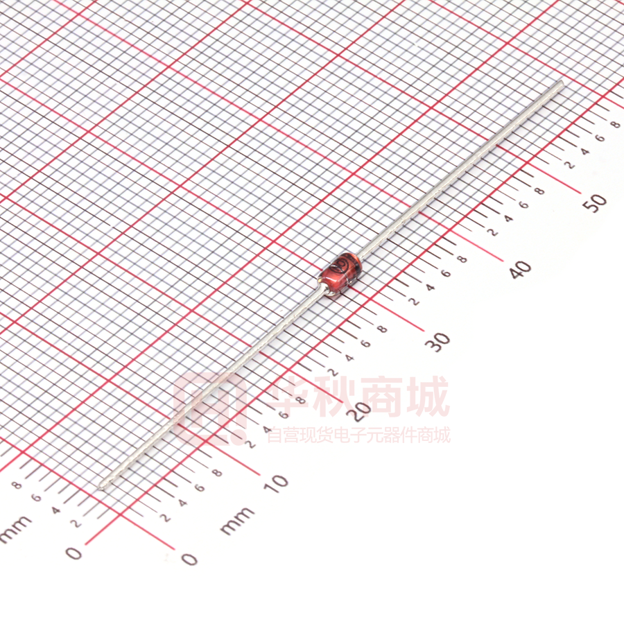

1N4728A - 1N4758A — Zener Diodes 1N4728A - 1N4758A Zener Diodes Tolerance = 5% DO-41 Glass case COLOR BAND DENOTES CATHODE Absolute Maximum Ratings * Symbol PD TJ, TSTG Ta = 25°C unless otherwise noted Value Units Power Dissipation @ TL  50C, Lead Length = 3/8” Parameter 1.0 W Derate above 50C 6.67 mW/C -65 to +200 C Operating and Storage Temperature Range * These ratings are limiting values above which the serviceability of the diode may be impaired. Electrical Characteristics Ta = 25°C unless otherwise noted VZ (V) @ IZ (Note 1) Device Max. Zener Impedance Test Current IZ (mA) ZZ @ IZ ZZK @ IZK Max. () IZK () (mA) VR (V) IZSM (mA) (Note 2) 1 1 1 1 1 100 100 50 10 10 1 1 1 1 1 1380 1260 1190 1070 970 550 600 700 700 700 1 1 1 1 0.5 10 10 10 10 10 1 2 3 4 5 890 810 730 660 605 700 700 700 700 700 0.5 0.5 0.25 0.25 0.25 10 10 10 5 5 6 7 7.6 8.4 9.1 550 500 454 414 380 Typ. 1N4728A 1N4729A 1N4730A 1N4731A 1N4732A 3.135 3.42 3.705 4.085 4.465 3.3 3.6 3.9 4.3 4.7 3.465 3.78 4.095 4.515 4.935 76 69 64 58 53 10 10 9 9 8 400 400 400 400 500 1N4733A 1N4734A 1N4735A 1N4736A 1N4737A 4.845 5.32 5.89 6.46 7.125 5.1 5.6 6.2 6.8 7.5 5.355 5.88 6.51 7.14 7.875 49 45 41 37 34 7 5 2 3.5 4 1N4738A 1N4739A 1N4740A 1N4741A 1N4742A 7.79 8.645 9.5 10.45 11.4 8.2 9.1 10 11 12 8.61 9.555 10.5 11.55 12.6 31 28 25 23 21 4.5 5 7 8 9 © 2009 Semiconductor Components Industries, LLC. Non-Repetitive Peak Reverse Current IR (A) Min. October-2017, Rev. 8 Leakage Current Publication Order Number: 1N4736AT/D Device Max. Zener Impedance Test Current IZ (mA) ZZ @ IZ ZZK @ Max. () IZK () Leakage Current Non-Repetitive Peak Reverse Current IZK (mA) IR (A) VR (V) IZSM (mA) (Note 2) 700 700 700 750 750 0.25 0.25 0.25 0.25 0.25 5 5 5 5 5 9.9 11.4 12.2 13.7 15.2 344 304 285 250 225 23 25 35 40 45 750 750 750 1000 1000 0.25 0.25 0.25 0.25 0.25 5 5 5 5 5 16.7 18.2 20.6 22.8 25.1 205 190 170 150 135 7 6.5 6 5.5 5 50 60 70 80 95 1000 1000 1500 1500 1500 0.25 0.25 0.25 0.25 0.25 5 5 5 5 5 27.4 29.7 32.7 35.8 38.8 125 115 110 95 90 4.5 110 2000 0.25 5 42.6 80 Min. Typ. 1N4743A 1N4744A 1N4745A 1N4746A 1N4747A 12.35 14.25 15.2 17.1 19 13 15 16 18 20 13.65 15.75 16.8 18.9 21 19 17 15.5 14 12.5 10 14 16 20 22 1N4748A 1N4749A 1N4750A 1N4751A 1N4752A 20.9 22.8 25.65 28.5 31.35 22 24 27 30 33 23.1 25.2 28.35 31.5 34.65 11.5 10.5 9.5 8.5 7.5 1N4753A 1N4754A 1N4755A 1N4756A 1N4757A 34.2 37.05 40.85 44.65 48.45 36 39 43 47 51 37.8 40.95 45.15 49.35 53.55 1N4758A 53.2 56 58.8 Notes: 1. Zener Voltage (VZ) The zener voltage is measured with the device junction in the thermal equilibrium at the lead temperature (TL) at 30C ± 1C and 3/8” lead length. 2. 2 Square wave Reverse Surge at 8.3 msec soak time. Top Mark Information Line 1 Line 2 Line 3 Line 4 Line 5 1N4728A 1N4729A 1N4730A 1N4731A 1N4732A Device LOGO LOGO LOGO LOGO LOGO 47 47 47 47 47 28 29 30 31 32 A A A A A XY XY XY XY XY 1N4733A 1N4734A 1N4735A 1N4736A 1N4737A LOGO LOGO LOGO LOGO LOGO 47 47 47 47 47 33 34 35 36 37 A A A A A XY XY XY XY XY 1N4738A 1N4739A 1N4740A 1N4741A 1N4742A LOGO LOGO LOGO LOGO LOGO 47 47 47 47 47 38 39 40 41 42 A A A A A XY XY XY XY XY 1N4743A 1N4744A 1N4745A 1N4746A 1N4747A LOGO LOGO LOGO LOGO LOGO 47 47 47 47 47 43 44 45 46 47 A A A A A XY XY XY XY XY 1N4748A 1N4749A 1N4750A 1N4751A 1N4752A LOGO LOGO LOGO LOGO LOGO 47 47 47 47 47 48 49 50 51 52 A A A A A XY XY XY XY XY 1N4753A 1N4754A 1N4755A 1N4756A 1N4757A LOGO LOGO LOGO LOGO LOGO 47 47 47 47 47 53 54 55 56 57 A A A A A XY XY XY XY XY 1N4758A LOGO 47 58 A XY www.onsemi.com 2 1N4728A - 1N4758A — Zener Diodes VZ (V) @ IZ (Note 1) 1st line: F - ON Semiconductor Logo 47 2nd line: Device Name - 3rd to 4th characters of device name for 1Nxx series or 4th to 6th characters for BZXyy series 36 A 3rd line: Device Name - 5th to 6th characters of device name for 1Nxx series or Voltage rating for BZXyy series 4th line: Device Name - 7th to 8th characters of device name for 1Nxx series or Large Die identification only for BZXyy series 5th line: Date Code - Two Digit - Six Weeks Date Code XY General Requirements: 1.0 Cathode Band 2.0 First Line: - ON Semiconductor Logo 3.0 Second Line: Device name - For 1Nxx series: 3rd to 4th characters of the device name. For BZxx series: 4th to 6th characters of the device name. 4.0 Third Line: Device name - For 1Nxx series: 5th to 6th characters of the device name. For BZXyy series: Voltage rating 5.0 Third Line: Device name - For 1Nxx series: 7th to 8th characters of the device name. (the 8th character is the large die identification) For BZXyy series: Large Die Identification character 6.0 Fourth Line: Date Code - Two Digit - Six Weeks Date Code Where: X represents the last digit of the calendar year Y represents the Six weeks numeric code 7.0 Devices shall be marked as required in the device specification (PID or ON Semiconductor Test Spec). 8.0 Maximum no. of marking lines: 5 9.0 Maximum no. of digits per line: 3 10.0 ON Semiconductor logo must be 20 % taller than the alphanumeric marking and should occupy the 2 characters of the specified line. 11.0 Marking Font: Arial (Except ON Semiconductor Logo) 12.0 First character of each marking line must be aligned vertically. 13.0 All device markings must be based on ON Semiconductor device specification. www.onsemi.com 3 1N4728A - 1N4758A — Zener Diodes Top Mark Information (Continued) ON Semiconductor and are trademarks of Semiconductor Components Industries, LLC dba ON Semiconductor or its subsidiaries in the United States and/or other countries. ON Semiconductor owns the rights to a number of patents, trademarks, copyrights, trade secrets, and other intellectual property. A listing of ON Semiconductor’s product/patent coverage may be accessed at www.onsemi.com/site/pdf/Patent−Marking.pdf. ON Semiconductor reserves the right to make changes without further notice to any products herein. ON Semiconductor makes no warranty, representation or guarantee regarding the suitability of its products for any particular purpose, nor does ON Semiconductor assume any liability arising out of the application or use of any product or circuit, and specifically disclaims any and all liability, including without limitation special, consequential or incidental damages. Buyer is responsible for its products and applications using ON Semiconductor products, including compliance with all laws, regulations and safety requirements or standards, regardless of any support or applications information provided by ON Semiconductor. “Typical” parameters which may be provided in ON Semiconductor data sheets and/or specifications can and do vary in different applications and actual performance may vary over time. All operating parameters, including “Typicals” must be validated for each customer application by customer’s technical experts. ON Semiconductor does not convey any license under its patent rights nor the rights of others. ON Semiconductor products are not designed, intended, or authorized for use as a critical component in life support systems or any FDA Class 3 medical devices or medical devices with a same or similar classification in a foreign jurisdiction or any devices intended for implantation in the human body. Should Buyer purchase or use ON Semiconductor products for any such unintended or unauthorized application, Buyer shall indemnify and hold ON Semiconductor and its officers, employees, subsidiaries, affiliates, and distributors harmless against all claims, costs, damages, and expenses, and reasonable attorney fees arising out of, directly or indirectly, any claim of personal injury or death associated with such unintended or unauthorized use, even if such claim alleges that ON Semiconductor was negligent regarding the design or manufacture of the part. ON Semiconductor is an Equal Opportunity/Affirmative Action Employer. This literature is subject to all applicable copyright laws and is not for resale in any manner. PUBLICATION ORDERING INFORMATION LITERATURE FULFILLMENT: Literature Distribution Center for ON Semiconductor 19521 E. 32nd Pkwy, Aurora, Colorado 80011 USA Phone: 303−675−2175 or 800−344−3860 Toll Free USA/Canada Fax: 303−675−2176 or 800−344−3867 Toll Free USA/Canada Email: orderlit@onsemi.com ❖ © Semiconductor Components Industries, LLC N. American Technical Support: 800−282−9855 Toll Free USA/Canada Europe, Middle East and Africa Technical Support: Phone: 421 33 790 2910 Japan Customer Focus Center Phone: 81−3−5817−1050 ON Semiconductor Website: www.onsemi.com Order Literature: http://www.onsemi.com/orderlit For additional information, please contact your local Sales Representative www.onsemi.com

物料型号:1N4728A - 1N4758A
器件简介:这些是ON Semiconductor生产的稳压二极管,具有5%的容差,封装在DO-41玻璃壳中。二极管的阴极由颜色带表示。
引脚分配:文档中没有明确指出引脚分配,但根据常规的二极管布局,阳极和阴极分别对应二极管的两端。
参数特性: - 最大耗散功率(Po)在25°C以下,引脚长度为3/8英寸时为1.0瓦特。 - 耗散功率随温度升高而降低,每升高1°C减少6.67毫瓦。 - 工作和存储温度范围为-65°C至+200°C。
功能详解:稳压二极管用于维持稳定的电压水平,即使输入电压或负载发生变化。文档提供了详细的电气特性,包括在不同测试电流下的最小、典型和最大稳压电压(Vz),最大稳压阻抗(Zz),漏电流(IR),以及非重复峰值反向电流(Izsm)。
应用信息:稳压二极管广泛应用于电路中,用于稳定电压、过压保护和参考电压源。
封装信息:这些稳压二极管采用DO-41玻璃封装,具有特定的尺寸和物理特性。
