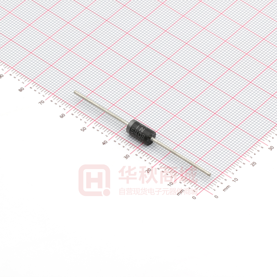

1N5400 thru 1N5408 1N5404 and 1N5406 are Preferred Devices Axial−Lead Standard Recovery Rectifiers Lead mounted standard recovery rectifiers are designed for use in power supplies and other applications having need of a device with the following features: http://onsemi.com Features • • • • • • • High Current to Small Size High Surge Current Capability Low Forward Voltage Drop Void−Free Economical Plastic Package Available in Volume Quantities Plastic Meets UL 94 V−0 for Flammability These are Pb−Free Devices STANDARD RECOVERY RECTIFIERS 50−1000 VOLTS 3.0 AMPERES Mechanical Characteristics: • Case: Epoxy, Molded • Weight: 1.1 Gram (Approximately) • Finish: All External Surfaces Corrosion Resistant and Terminal • • Leads are Readily Solderable Lead and Mounting Surface Temperature for Soldering Purposes: 260°C Max. for 10 Seconds Polarity: Cathode Indicated by Polarity Band AXIAL LEAD CASE 267−05 STYLE 1 MARKING DIAGRAM A 1N 540x YYWWG G A = Assembly Location 1N540x = Device Number x = 0, 1, 2, 4, 6, 7 or 8 YY = Year WW = Work Week G = Pb−Free Package (Note: Microdot may be in either location) ORDERING INFORMATION See detailed ordering and shipping information on page 5 of this data sheet. Preferred devices are recommended choices for future use and best overall value. *For additional information on our Pb−Free strategy and soldering details, please download the ON Semiconductor Soldering and Mounting Techniques Reference Manual, SOLDERRM/D. © Semiconductor Components Industries, LLC, 2006 1 December, 2006 − Rev. 9 Publication Order Number: 1N5400/D 1N5400 thru 1N5408 MAXIMUM RATINGS Rating Peak Repetitive Reverse Voltage Working Peak Reverse Voltage DC Blocking Voltage Non−repetitive Peak Reverse Voltage Average Rectified Forward Current (Single Phase Resistive Load, 1/2 in. Leads, TL = 105°C) Non−repetitive Peak Surge Current (Surge Applied at Rated Load Conditions) Operating and Storage Junction Temperature Range Symbol VRRM VRWM VR VRSM IO 1N5400 50 1N5401 100 1N5402 200 1N5404 400 1N5406 600 1N5407 800 1N5408 1000 Unit V 100 200 300 525 3.0 800 1000 1200 V A IFSM 200 (one cycle) A TJ Tstg − 65 to +170 − 65 to +175 °C Stresses exceeding Maximum Ratings may damage the device. Maximum Ratings are stress ratings only. Functional operation above the Recommended Operating Conditions is not implied. Extended exposure to stresses above the Recommended Operating Conditions may affect device reliability. THERMAL CHARACTERISTICS Characteristic Thermal Resistance, Junction−to−Ambient (PC Board Mount, 1/2 in. Leads) Symbol RqJA Typ 53 Unit °C/W ELECTRICAL CHARACTERISTICS Characteristic Forward Voltage (IF = 3.0 Amp, TA = 25°C) Reverse Current (Rated DC Voltage) TA = 25°C TA = 150°C Ratings at 25°C ambient temperature unless otherwise specified. 60 Hz resistive or inductive loads. For capacitive load, derate current by 20%. Symbol vF IR − − − − 10 100 Min − Typ − Max 1.0 Unit V mA http://onsemi.com 2 1N5400 thru 1N5408 NOTE 1 — AMBIENT MOUNTING DATA Data shown for thermal resistance junction−to−ambient (RqJA) for the mountings shown is to be used as typical guideline values for preliminary engineering or in case the tie point temperature cannot be measured. TYPICAL VALUES FOR RqJA IN STILL AIR Mounting Method 1 2 3 MOUNTING METHOD 1 P.C. Board Where Available Copper Surface area is small L L Lead Length, L (IN) 1/4 1/2 3/4 1/8 55 50 51 53 63 58 59 61 28 RqJA °C/W °C/W °C/W MOUNTING METHOD 3 P.C. Board with 1−1/2” x 1−1/2” Copper Surface ÉÉÉÉÉÉÉÉÉ ÉÉ ÉÉ ÉÉ ÉÉ ÉÉ ÉÉÉÉÉÉÉÉÉ MOUNTING METHOD 2 Vector Push−In Terminals T−28 L L L = 1/2” Board Ground Plane http://onsemi.com 3 1N5400 thru 1N5408 200 TJ = 25°C 100 70 iF, INSTANTANEOUS FORWARD CURRENT (AMPS) TYPICAL 50 IFSM, PEAK HALF WAVE CURRENT (AMPS) 400 300 200 1 CYCLE 100 90 80 70 60 50 40 Surge Applied at Rated Load Conditions f = 60Hz 30 20 1.0 2.0 3.0 5.0 7.0 10 20 30 50 70 100 10 7.0 5.0 3.0 2.0 NUMBER OF CYCLES Figure 2. Maximum Nonrepetitive Surge Current 8.0 L = 1/32” 7.0 6.0 Resistive Load Both Leads to Heat Sink with Lengths as Shown 1.0 0.7 0.5 5.0 4.0 3.0 2.0 1/4” 1/2” 0.3 0.2 0.4 0.8 1.2 1.6 2.0 2.4 2.8 3.2 1.0 0 40 60 80 100 120 140 160 180 vF, INSTANTANEOUS VOLTAGE (VOLTS) TL, LEAD TEMPERATURE (°C) Figure 1. Forward Voltage 4.0 3.5 3.0 2.5 2.0 1.5 1.0 0.5 0 RqJA = 50°C/W Note for Resistive Load 60 80 RqJA = 28°C/W PF(AV), AVERAGE POWER DISSIPATION (WATTS) Figure 3. Current Derating Various Lead Lengths I(PK) I(AV) 5.0 10 20 =π 16 14 12 10 8 6 4 2 0 0 1 2 3 4 5 6 7 TJ = 25°C 8 9 10 dc IPK/IAV = 20 10 5 Square Wave Capacitive Loads I(PK) I(AV) =π 140 160 180 40 100 120 TA, AMBIENT TEMPERATURE (°C) IF(AV), AVERAGE FORWARD CURRENT (AMPS) Figure 4. Current Derating PC Board Mounting Figure 5. Forward Power Dissipation http://onsemi.com 4 1N5400 thru 1N5408 ORDERING INFORMATION Device 1N5400 1N5400G 1N5400RL 1N5400RLG 1N5401 1N5401G 1N5401RL 1N5401RLG 1N5402 1N5402G 1N5402RL 1N5402RLG 1N5404 1N5404G 1N5404RL 1N5404RLG 1N5406 1N5406G 1N5406RL 1N5406RLG 1N5407 1N5407G 1N5407RL 1N5407RLG 1N5408 1N5408G 1N5408RL 1N5408RLG Package Axial Lead* Axial Lead* Axial Lead* Axial Lead* Axial Lead* Axial Lead* Axial Lead* Axial Lead* Axial Lead* Axial Lead* Axial Lead* Axial Lead* Axial Lead* Axial Lead* Axial Lead* Axial Lead* Axial Lead* Axial Lead* Axial Lead* Axial Lead* Axial Lead* Axial Lead* Axial Lead* Axial Lead* Axial Lead* Axial Lead* Axial Lead* Axial Lead* Shipping † 500 Units/Box 500 Units/Box 1200/Tape & Reel 1200/Tape & Reel 500 Units/Box 500 Units/Box 1200/Tape & Reel 1200/Tape & Reel 500 Units/Box 500 Units/Box 1200/Tape & Reel 1200/Tape & Reel 500 Units/Box 500 Units/Box 1200/Tape & Reel 1200/Tape & Reel 500 Units/Box 500 Units/Box 1200/Tape & Reel 1200/Tape & Reel 500 Units/Box 500 Units/Box 1200/Tape & Reel 1200/Tape & Reel 500 Units/Box 500 Units/Box 1200/Tape & Reel 1200/Tape & Reel †For information on tape and reel specifications, including part orientation and tape sizes, please refer to our Tape and Reel Packaging Specifications Brochure, BRD8011/D. *This package is inherently Pb−Free. http://onsemi.com 5 1N5400 thru 1N5408 PACKAGE DIMENSIONS AXIAL LEAD CASE 267−05 ISSUE G K D 1 A 2 NOTES: 1. DIMENSIONING AND TOLERANCING PER ANSI Y14.5M, 1982. 2. CONTROLLING DIMENSION: INCH. DIM A B D K INCHES MIN MAX 0.287 0.374 0.189 0.209 0.047 0.051 1.000 −−− MILLIMETERS MIN MAX 7.30 9.50 4.80 5.30 1.20 1.30 25.40 −−− B K STYLE 1: PIN 1. CATHODE (POLARITY BAND) 2. ANODE ON Semiconductor and are registered trademarks of Semiconductor Components Industries, LLC (SCILLC). SCILLC reserves the right to make changes without further notice to any products herein. SCILLC makes no warranty, representation or guarantee regarding the suitability of its products for any particular purpose, nor does SCILLC assume any liability arising out of the application or use of any product or circuit, and specifically disclaims any and all liability, including without limitation special, consequential or incidental damages. “Typical” parameters which may be provided in SCILLC data sheets and/or specifications can and do vary in different applications and actual performance may vary over time. All operating parameters, including “Typicals” must be validated for each customer application by customer’s technical experts. SCILLC does not convey any license under its patent rights nor the rights of others. SCILLC products are not designed, intended, or authorized for use as components in systems intended for surgical implant into the body, or other applications intended to support or sustain life, or for any other application in which the failure of the SCILLC product could create a situation where personal injury or death may occur. Should Buyer purchase or use SCILLC products for any such unintended or unauthorized application, Buyer shall indemnify and hold SCILLC and its officers, employees, subsidiaries, affiliates, and distributors harmless against all claims, costs, damages, and expenses, and reasonable attorney fees arising out of, directly or indirectly, any claim of personal injury or death associated with such unintended or unauthorized use, even if such claim alleges that SCILLC was negligent regarding the design or manufacture of the part. SCILLC is an Equal Opportunity/Affirmative Action Employer. This literature is subject to all applicable copyright laws and is not for resale in any manner. PUBLICATION ORDERING INFORMATION LITERATURE FULFILLMENT: Literature Distribution Center for ON Semiconductor P.O. Box 5163, Denver, Colorado 80217 USA Phone: 303−675−2175 or 800−344−3860 Toll Free USA/Canada Fax: 303−675−2176 or 800−344−3867 Toll Free USA/Canada Email: orderlit@onsemi.com N. American Technical Support: 800−282−9855 Toll Free USA/Canada Europe, Middle East and Africa Technical Support: Phone: 421 33 790 2910 Japan Customer Focus Center Phone: 81−3−5773−3850 ON Semiconductor Website: www.onsemi.com Order Literature: http://www.onsemi.com/orderlit For additional information, please contact your local Sales Representative http://onsemi.com 6 1N5400/D

1. 物料型号: - 1N5400至1N5408,其中1N5404和1N5406是推荐使用的型号。
2. 器件简介: - 轴向引脚安装的标准恢复整流器,设计用于电源供应和其他需要具有以下特性的设备:高电流至小尺寸、高浪涌电流能力、低正向电压降、无空洞经济型塑料封装,并且可获得大量数量。塑料符合UL 94 V−0可燃性标准。这些是无铅设备。
3. 引脚分配: - 阴极由极性带指示,阳极在另一端。
4. 参数特性: - 机械特性包括环氧模塑封装,重量大约1.1克,所有外表面耐腐蚀,引脚和焊接用的安装表面耐腐蚀,焊接目的的引脚和安装表面温度最高260°C持续10秒。 - 最大额定值包括不同型号的峰值重复反向电压、工作峰值反向电压、直流阻断电压、非重复峰值反向电压、平均整流前向电流、非重复峰值浪涌电流以及操作和存储结温度范围。 - 热特性包括结到环境的热阻(PCB安装,1/2英寸引脚)。
5. 功能详解: - 电气特性包括正向电压(IF = 3.0安培,TA = 25°C)和反向电流(额定直流电压)。
6. 应用信息: - 适用于电源供应和其他需要标准恢复整流器的场合。
7. 封装信息: - 轴向引脚案例267−05风格1,提供了详细的封装尺寸和公差。
