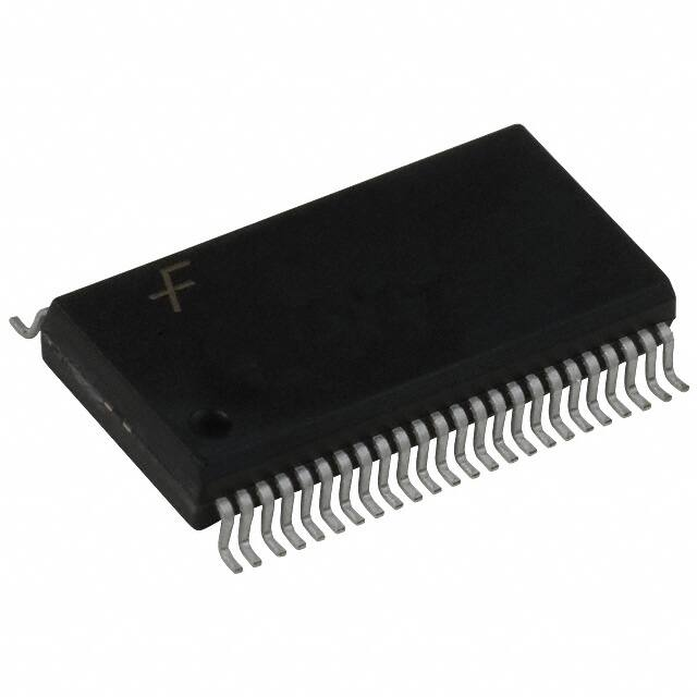

Revised May 2005 74ACT16374 16-Bit D-Type Flip-Flop with 3-STATE Outputs General Description Features The ACT16374 contains sixteen non-inverting D-type flipflops with 3-STATE outputs and is intended for bus oriented applications. The device is byte controlled. A buffered clock (CP) and Output Enable (OE) are common to each byte and can be shorted together for full 16-bit operation. ■ Buffered Positive edge-triggered clock ■ Separate control logic for each byte ■ 16-bit version of the ACT374 ■ Outputs source/sink 24 mA ■ TTL-compatible inputs Ordering Code: Order Number Package Number Package Description 74ACT16374SSC MS48A 48-Lead Small Shrink Outline Package (SSOP), JEDEC MO-118, 0.300" Wide 74ACT16374MTD MTD48 48-Lead Thin Shrink Small Outline Package (TSSOP), JEDEC MO-153, 6.1mm Wide Device also available in Tape and Reel. Specify by appending suffix letter “X” to the ordering code. Logic Symbol Connection Diagram Pin Descriptions Pin Names Description OEn Output Enable Input (Active LOW) CPn Clock Pulse Input I0–I15 Inputs O0–O15 Outputs FACT¥ is a trademark of Fairchild Semiconductor Corporation. © 2005 Fairchild Semiconductor Corporation DS500298 www.fairchildsemi.com 74ACT16374 16-Bit D-Type Flip-Flop with 3-STATE Outputs August 1999 74ACT16374 Functional Description Truth Tables The ACT16374 consists of sixteen edge-triggered flip-flops with individual D-type inputs and 3-STATE true outputs. The device is byte controlled with each byte functioning identically, but independent of the other. The control pins can be shorted together to obtain full 16-bit operation. Each byte has a buffered clock and buffered Output Enable common to all flip-flops within that byte. The description which follows applies to each byte. Each flip-flop will store the state of their individual D inputs that meet the setup and hold time requirements on the LOW-to-HIGH Clock (CPn) transition. With the Output Enable (OEn) LOW, the contents of the flip-flops are available at the outputs. When OEn is HIGH, the outputs go to the high impedance state. Operation of the OEn input does not affect the state of the flip-flops. Inputs CP1   OE1 I0–I7 O0–O7 L H H L L L L L X (Previous) X H X Z Inputs  Logic Diagrams Byte 1 (0:7) Byte 2 (8:15) 2 Outputs   OE2 I8–I15 O8–O15 L H H L L L L L X (Previous) X H X Z CP2 H HIGH Voltage Level L LOW Voltage Level X Immaterial Z HIGH Impedance LOW-to-HIGH Transition www.fairchildsemi.com Outputs Recommended Operating Conditions 0.5V to 7.0V Supply Voltage (VCC) DC Input Diode Current (IIK) VI VI 0.5V VCC  0.5V Supply Voltage (VCC) 20 mA 20 mA DC Output Diode Current (IOK) VO VO 0.5V VCC  0.5V DC Output Voltage (VO) DC Output Source/Sink Current (IO) per Output Pin 0V to VCC Output Voltage (VO) 0V to VCC 40qC to 85qC Operating Temperature (TA) 20 mA 20 mA 0.5V to VCC  0.5V r50 mA Minimum Input Edge Rate ('V/'t) 125 mV/ns VIN from 0.8V to 2.0V VCC @ 4.5V, 5.5V Note 1: Absolute maximum ratings are those values beyond which damage to the device may occur. The databook specifications should be met, without exception to ensure that the system design is reliable over its power supply, temperature, and output/input loading variables. Fairchild does not recommend operation of FACT¥ circuits outside databook specifications. DC VCC or Ground Current Storage Temperature 4.5V to 5.5V Input Voltage (VI) r 50 mA 65qC to 150qC DC Electrical Characteristics Symbol VIH VIL VOH VOL IOZ Parameter VCC TA (V) Typ 25qC TA 40qC to 85qC Guaranteed Limits Minimum HIGH 4.5 1.5 2.0 2.0 Input Voltage 5.5 1.5 2.0 2.0 Maximum LOW 4.5 1.5 0.8 0.8 Input Voltage 5.5 1.5 0.8 0.8 Minimum HIGH 4.5 4.49 4.4 4.4 Output Voltage 5.5 5.49 5.4 5.4 4.5 3.86 3.76 5.5 4.86 4.76 Maximum LOW 4.5 0.001 0.1 0.1 Output Voltage 5.5 0.001 0.1 0.1 Maximum 3-STATE Units V V Maximum Input VOUT 0.1V or VCC  0.1V VOUT 0.1V or VCC  0.1V V IOUT 50 PA VIN VIL or VIH V IOH 24 mA IOH 24 mA (Note 2) V V 50 PA IOUT VIN VIL or VIH IOL 24 mA 4.5 0.36 0.44 5.5 0.36 0.44 5.5 r 0.5 r 5.0 PA VI 5.5 r 0.1 r 1.0 PA VI VCC, GND 1.5 mA VI VCC  2.1V 8.0 80.0 PA VIN 75 mA VOLD 1.65V Max 75 mA VOHD 3.85V Min 24 mA (Note 2) IOL Leakage Current IIN Conditions VIL, VIH VO VCC, GND Leakage Current ICCT Maximum ICC/Input 5.5 ICC Maximum Quiescent 5.5 0.6 VCC or GND Supply Current IOLD Minimum Dynamic IOHD Output Current (Note 3) 5.5 Note 2: All outputs loaded; thresholds associated with output under test. Note 3: Maximum test duration 2.0 ms; one output loaded at a time. 3 www.fairchildsemi.com 74ACT16374 Absolute Maximum Ratings(Note 1) 74ACT16374 AC Electrical Characteristics Symbol Parameter VCC TA 25qC (V) CL 50 pF (Note 4) fMAX Maximum Clock Frequency tPLH Propagation Delay tPHL CP to On tPZH Output Enable Time 5.0 5.0 Output Disable Time 5.0 tPLZ 40qC to 85qC CL 50 pF Typ Max Min 3.1 5.3 7.9 3.1 8.4 3.0 5.1 7.3 3.0 7.8 2.5 4.7 7.4 2.5 7.9 3.0 5.4 8.0 2.0 8.5 2.1 5.1 7.9 2.1 8.2 2.0 4.8 7.4 2.0 7.9 71 5.0 tPZL tPHZ Min TA Units Max 67 MHz ns ns ns Note 4: Voltage Range 5.0 is 5.0V r 0.5V. AC Operating Requirements Symbol tS Parameter Setup Time, HIGH or LOW, Input to Clock tH Hold Time, HIGH or LOW, Input to Clock tW CP Pulse Width, HIGH or LOW VCC TA 25qC (V) CL 50 pF TA 40qC to 85qC CL 50 pF Typ Guaranteed Limits 5.0 0.7 3.0 3.0 ns 5.0 0.8 1.0 1.0 ns 5.0 1.5 5.0 5.0 ns Note 5: Voltage Range 5.0 is 5.0V r 0.5V. Capacitance Symbol Parameter Typ Units CIN Input Capacitance 4.5 pF VCC 5.0V CPD Power Dissipation Capacitance 30 pF VCC 5.0V www.fairchildsemi.com Units (Note 5) 4 Conditions 74ACT16374 Physical Dimensions inches (millimeters) unless otherwise noted 48-Lead Small Shrink Outline Package (SSOP), JEDEC MO-118, 0.300" Wide Package Number MS48A 5 www.fairchildsemi.com 74ACT16374 16-Bit D-Type Flip-Flop with 3-STATE Outputs Physical Dimensions inches (millimeters) unless otherwise noted (Continued) 48-Lead Thin Shrink Small Outline Package (TSSOP), JEDEC MO-153, 6.1mm Wide Package Number MTD48 Fairchild does not assume any responsibility for use of any circuitry described, no circuit patent licenses are implied and Fairchild reserves the right at any time without notice to change said circuitry and specifications. LIFE SUPPORT POLICY FAIRCHILD’S PRODUCTS ARE NOT AUTHORIZED FOR USE AS CRITICAL COMPONENTS IN LIFE SUPPORT DEVICES OR SYSTEMS WITHOUT THE EXPRESS WRITTEN APPROVAL OF THE PRESIDENT OF FAIRCHILD SEMICONDUCTOR CORPORATION. As used herein: 2. A critical component in any component of a life support device or system whose failure to perform can be reasonably expected to cause the failure of the life support device or system, or to affect its safety or effectiveness. 1. Life support devices or systems are devices or systems which, (a) are intended for surgical implant into the body, or (b) support or sustain life, and (c) whose failure to perform when properly used in accordance with instructions for use provided in the labeling, can be reasonably expected to result in a significant injury to the user. www.fairchildsemi.com www.fairchildsemi.com 6
