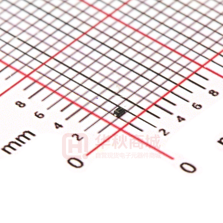

BAS16P2T5G
BAS16P2T5G
    ONSEMI(安森美)
    SOD-923
    开关二极管 VR=100V IF=200mA Trr=6ns P=710mW SOD923
BAS16P2T5G 数据手册
BAS16P2T5G Switching Diode The BAS16P2T5G Switching Diode is a spin−off of our popular SOT−23 three−leaded device. It is designed for switching applications and is housed in the SOD−923 surface mount package. This device is ideal for low−power surface mount applications, where board space is at a premium. http://onsemi.com Features • These Devices are Pb−Free, Halogen Free/BFR Free and are RoHS 1 CATHODE Compliant 2 ANODE MAXIMUM RATINGS Rating Symbol Value Unit Continuous Reverse Voltage VR 100 Vdc Peak Forward Current IF 200 mAdc IFM(surge) 500 mAdc Peak Forward Surge Current Stresses exceeding Maximum Ratings may damage the device. Maximum Ratings are stress ratings only. Functional operation above the Recommended Operating Conditions is not implied. Extended exposure to stresses above the Recommended Operating Conditions may affect device reliability. MARKING DIAGRAM 2 1 A6M SOD−923 CASE 514AA PLASTIC 1 2 A6 = Specific Device Code M = Month Code THERMAL CHARACTERISTICS Symbol Max Unit Thermal Resistance, Junction−to−Ambient (Note 1) Total Power Dissipation @ TA = 25°C Characteristic RqJA PD 520 240 °C/W mW Thermal Resistance, Junction−to−Ambient (Note 2) Total Power Dissipation @ TA = 25°C RqJA PD 175 710 °C/W mW TJ, Tstg −55 to +150 °C Junction and Storage Temperature Range ORDERING INFORMATION Device BAS16P2T5G Package Shipping† SOD−923 (Pb−Free) 8000 / Tape & Reel †For information on tape and reel specifications, including part orientation and tape sizes, please refer to our Tape and Reel Packaging Specifications Brochure, BRD8011/D. 1. Mounted onto a 4 in square FR−4 board 10 mm sq. 1 oz. Cu 0.06″ thick single sided. Operating to steady state. 2. Mounted onto a 4 in square FR−4 board 1 in sq. 1 oz. Cu 0.06″ thick single sided. Operating to steady state. © Semiconductor Components Industries, LLC, 2013 May, 2013 − Rev. 1 1 Publication Order Number: BAS16P2/D BAS16P2T5G ELECTRICAL CHARACTERISTICS (TA = 25°C unless otherwise noted) Symbol Characteristic Min Max − − − − 1.0 100 50 30 100 − − − − − 715 855 1000 1250 Unit OFF CHARACTERISTICS Reverse Voltage Leakage Current (VR = 75 Vdc) (VR = 100 Vdc) (VR = 75 Vdc, TJ = 150°C) (VR = 25 Vdc, TJ = 150°C) IR Reverse Breakdown Voltage (IBR = 100 mAdc) V(BR) mAdc Vdc Forward Voltage (IF = 1.0 mAdc) (IF = 10 mAdc) (IF = 50 mAdc) (IF = 150 mAdc) VF Diode Capacitance (VR = 0, f = 1.0 MHz) CD − 2.0 pF Forward Recovery Voltage (IF = 10 mAdc, tr = 20 ns) VFR − 1.75 Vdc Reverse Recovery Time (IF = IR = 10 mAdc, RL = 50 W) trr − 6.0 ns Stored Charge (IF = 10 mAdc to VR = 5.0 Vdc, RL = 500 W) QS − 45 pC http://onsemi.com 2 mV BAS16P2T5G 820 W +10 V 2.0 k IF 100 mH tp tr 0.1 mF IF t trr 10% t 0.1 mF 90% D.U.T. 50 W INPUT SAMPLING OSCILLOSCOPE 50 W OUTPUT PULSE GENERATOR iR(REC) = 1.0 mA IR VR OUTPUT PULSE (IF = IR = 10 mA; MEASURED at iR(REC) = 1.0 mA) INPUT SIGNAL Notes: 1. A 2.0 kW variable resistor adjusted for a Forward Current (IF) of 10 mA. Notes: 2. Input pulse is adjusted so IR(peak) is equal to 10 mA. Notes: 3. tp » trr Figure 1. Recovery Time Equivalent Test Circuit 10 100 IR , REVERSE CURRENT (μA) TA = 85°C 10 TA = -40°C 1.0 TA = 25°C TA = 125°C 1.0 TA = 85°C 0.1 TA = 55°C 0.01 TA = 25°C 0.001 0.1 0.2 0.4 0.6 0.8 1.0 VF, FORWARD VOLTAGE (VOLTS) 0 1.2 10 Figure 2. Forward Voltage 20 30 40 VR, REVERSE VOLTAGE (VOLTS) Figure 3. Leakage Current 0.68 CD, DIODE CAPACITANCE (pF) IF, FORWARD CURRENT (mA) TA = 150°C 0.64 0.60 0.56 0.52 0 2 4 6 VR, REVERSE VOLTAGE (VOLTS) Figure 4. Capacitance http://onsemi.com 3 8 50 BAS16P2T5G PACKAGE DIMENSIONS SOD−923 CASE 514AA ISSUE E D −X− NOTES: 1. DIMENSIONING AND TOLERANCING PER ASME Y14.5M, 1994. 2. CONTROLLING DIMENSION: MILLIMETERS. 3. MAXIMUM LEAD THICKNESS INCLUDES LEAD FINISH. MINIMUM LEAD THICKNESS IS THE MINIMUM THICKNESS OF BASE MATERIAL. 4. DIMENSIONS D AND E DO NOT INCLUDE MOLD FLASH, PROTRUSIONS, OR GATE BURRS. −Y− E 1 2X b 0.08 X Y 2 TOP VIEW DIM A b c D E HE L L2 A c HE SIDE VIEW MILLIMETERS MIN NOM MAX 0.34 0.39 0.43 0.15 0.20 0.25 0.07 0.12 0.17 0.75 0.80 0.85 0.55 0.60 0.65 0.95 1.00 1.05 0.19 REF 0.05 0.10 0.15 INCHES MIN NOM MAX 0.013 0.015 0.017 0.006 0.008 0.010 0.003 0.005 0.007 0.030 0.031 0.033 0.022 0.024 0.026 0.037 0.039 0.041 0.007 REF 0.002 0.004 0.006 SOLDERING FOOTPRINT* 2X L 2X 0.36 2X L2 PACKAGE OUTLINE BOTTOM VIEW 1.20 2X 0.25 DIMENSIONS: MILLIMETERS See Application Note AND8455/D for more mounting details *For additional information on our Pb−Free strategy and soldering details, please download the ON Semiconductor Soldering and Mounting Techniques Reference Manual, SOLDERRM/D. ON Semiconductor and are registered trademarks of Semiconductor Components Industries, LLC (SCILLC). SCILLC owns the rights to a number of patents, trademarks, copyrights, trade secrets, and other intellectual property. A listing of SCILLC’s product/patent coverage may be accessed at www.onsemi.com/site/pdf/Patent−Marking.pdf. SCILLC reserves the right to make changes without further notice to any products herein. SCILLC makes no warranty, representation or guarantee regarding the suitability of its products for any particular purpose, nor does SCILLC assume any liability arising out of the application or use of any product or circuit, and specifically disclaims any and all liability, including without limitation special, consequential or incidental damages. “Typical” parameters which may be provided in SCILLC data sheets and/or specifications can and do vary in different applications and actual performance may vary over time. All operating parameters, including “Typicals” must be validated for each customer application by customer’s technical experts. SCILLC does not convey any license under its patent rights nor the rights of others. SCILLC products are not designed, intended, or authorized for use as components in systems intended for surgical implant into the body, or other applications intended to support or sustain life, or for any other application in which the failure of the SCILLC product could create a situation where personal injury or death may occur. Should Buyer purchase or use SCILLC products for any such unintended or unauthorized application, Buyer shall indemnify and hold SCILLC and its officers, employees, subsidiaries, affiliates, and distributors harmless against all claims, costs, damages, and expenses, and reasonable attorney fees arising out of, directly or indirectly, any claim of personal injury or death associated with such unintended or unauthorized use, even if such claim alleges that SCILLC was negligent regarding the design or manufacture of the part. SCILLC is an Equal Opportunity/Affirmative Action Employer. This literature is subject to all applicable copyright laws and is not for resale in any manner. PUBLICATION ORDERING INFORMATION LITERATURE FULFILLMENT: Literature Distribution Center for ON Semiconductor P.O. Box 5163, Denver, Colorado 80217 USA Phone: 303−675−2175 or 800−344−3860 Toll Free USA/Canada Fax: 303−675−2176 or 800−344−3867 Toll Free USA/Canada Email: orderlit@onsemi.com N. American Technical Support: 800−282−9855 Toll Free USA/Canada Europe, Middle East and Africa Technical Support: Phone: 421 33 790 2910 Japan Customer Focus Center Phone: 81−3−5817−1050 http://onsemi.com 4 ON Semiconductor Website: www.onsemi.com Order Literature: http://www.onsemi.com/orderlit For additional information, please contact your local Sales Representative BAS16P2/D
