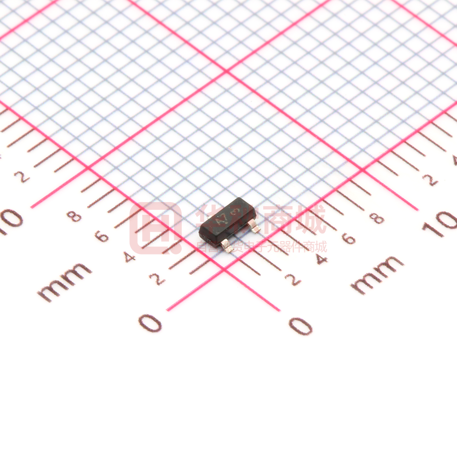

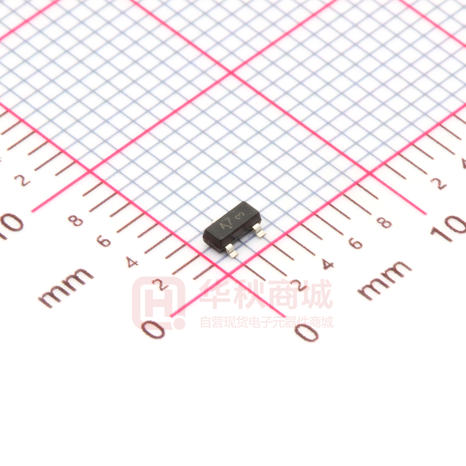

    开关二极管(小信号) VR=100V IF=215mA P=225mW
BAV99LT3G 数据手册
BAV99LT1 Dual Series Switching Diode Features • Pb−Free Packages are Available http://onsemi.com MAXIMUM RATINGS (Each Diode) Rating Reverse Voltage Forward Current Peak Forward Surge Current Repetitive Peak Reverse Voltage Average Rectified Forward Current (Note 1) (averaged over any 20 ms period) Repetitive Peak Forward Current Non−Repetitive Peak Forward Current t = 1.0 ms t = 1.0 ms t = 1.0 s Symbol VR IF IFM(surge) VRRM IF(AV) IFRM IFSM 2.0 1.0 0.5 Value 70 215 500 70 715 450 Unit Vdc mAdc mAdc V mA mA A ANODE 1 CATHODE 2 3 CATHODE/ANODE 3 1 2 CASE 318 SOT−23 STYLE 11 MARKING DIAGRAM A7 MG G 1 A7 = Specific Device Code M = Date Code G = Pb−Free Package (Note: Microdot may be in either location) Stresses exceeding Maximum Ratings may damage the device. Maximum Ratings are stress ratings only. Functional operation above the Recommended Operating Conditions is not implied. Extended exposure to stresses above the Recommended Operating Conditions may affect device reliability. THERMAL CHARACTERISTICS Characteristic Total Device Dissipation FR−5 Board (Note 1) TA = 25°C Derate above 25°C Thermal Resistance, Junction−to−Ambient Total Device Dissipation Alumina Substrate (Note 2) TA = 25°C Derate above 25°C Thermal Resistance, Junction−to−Ambient Junction and Storage Temperature Range Symbol PD Max 225 1.8 RqJA PD 556 300 2.4 RqJA TJ, Tstg 417 −65 to +150 Unit mW mW/°C °C/W mW mW/°C °C/W °C ORDERING INFORMATION Device BAV99LT1 BAV99LT1G BAV99LT3 BAV99LT3G Package SOT−23 SOT−23 (Pb−Free) SOT−23 SOT−23 (Pb−Free) Shipping † 3000/Tape & Reel 3000/Tape & Reel 10,000/Tape & Reel 10,000/Tape & Reel 1. FR−5 = 1.0  0.75  0.062 in. 2. Alumina = 0.4  0.3  0.024 in 99.5% alumina. †For information on tape and reel specifications, including part orientation and tape sizes, please refer to our Tape and Reel Packaging Specifications Brochure, BRD8011/D. © Semiconductor Components Industries, LLC, 2006 1 September, 2006 − Rev. 4 Publication Order Number: BAV99LT1/D BAV99LT1 OFF CHARACTERISTICS (TA = 25°C unless otherwise noted) (Each Diode) Characteristic Reverse Breakdown Voltage, (I(BR) = 100 mA) Reverse Voltage Leakage Current, (VR = 70 Vdc) (VR = 25 Vdc, TJ = 150°C) (VR = 70 Vdc, TJ = 150°C) Diode Capacitance, (VR = 0, f = 1.0 MHz) Forward Voltage, (IF = 1.0 mAdc) (IF = 10 mAdc) (IF = 50 mAdc) (IF = 150 mAdc) Reverse Recovery Time, (IF = IR = 10 mAdc, iR(REC) = 1.0 mAdc) RL = 100 W Forward Recovery Voltage, (IF = 10 mA, tr = 20 ns) VFR − 1.75 V trr − 6.0 ns VF − − − − 715 855 1000 1250 mVdc CD − 1.5 pF V(BR) IR 70 − − − − 2.5 30 50 Vdc mAdc Symbol Min Max Unit http://onsemi.com 2 BAV99LT1 CURVES APPLICABLE TO EACH DIODE 100 IF, FORWARD CURRENT (mA) I R, REVERSE CURRENT (μ A) 10 TA = 150°C 1.0 TA = 125°C 10 TA = 85°C 1.0 TA = 25°C TA = −40°C 0.1 0.2 0.4 0.6 0.8 1.0 1.2 0.1 TA = 85°C TA = 55°C 0.01 TA = 25°C 0 10 20 30 40 50 VR, REVERSE VOLTAGE (VOLTS) 0.001 VF, FORWARD VOLTAGE (VOLTS) Figure 1. Forward Voltage Figure 2. Leakage Current 0.68 CD , DIODE CAPACITANCE (pF) 0.64 0.60 0.56 0.52 0 2 4 6 8 VR, REVERSE VOLTAGE (VOLTS) Figure 3. Capacitance http://onsemi.com 3 BAV99LT1 PACKAGE DIMENSIONS SOT−23 (TO−236) CASE 318−08 ISSUE AN D 3 SEE VIEW C NOTES: 1. DIMENSIONING AND TOLERANCING PER ANSI Y14.5M, 1982. 2. CONTROLLING DIMENSION: INCH. 3. MAXIMUM LEAD THICKNESS INCLUDES LEAD FINISH THICKNESS. MINIMUM LEAD THICKNESS IS THE MINIMUM THICKNESS OF BASE MATERIAL. 4. 318−01 THRU −07 AND −09 OBSOLETE, NEW STANDARD 318−08. E 1 2 HE c b e q 0.25 A L A1 L1 VIEW C DIM A A1 b c D E e L L1 HE MIN 0.89 0.01 0.37 0.09 2.80 1.20 1.78 0.10 0.35 2.10 MILLIMETERS NOM MAX 1.00 1.11 0.06 0.10 0.44 0.50 0.13 0.18 2.90 3.04 1.30 1.40 1.90 2.04 0.20 0.30 0.54 0.69 2.40 2.64 MIN 0.035 0.001 0.015 0.003 0.110 0.047 0.070 0.004 0.014 0.083 INCHES NOM 0.040 0.002 0.018 0.005 0.114 0.051 0.075 0.008 0.021 0.094 MAX 0.044 0.004 0.020 0.007 0.120 0.055 0.081 0.012 0.029 0.104 STYLE 11: PIN 1. ANODE 2. CATHODE 3. CATHODE−ANODE SOLDERING FOOTPRINT* 0.95 0.037 0.95 0.037 2.0 0.079 0.9 0.035 0.8 0.031 SCALE 10:1 mm inches *For additional information on our Pb−Free strategy and soldering details, please download the ON Semiconductor Soldering and Mounting Techniques Reference Manual, SOLDERRM/D. ON Semiconductor and are registered trademarks of Semiconductor Components Industries, LLC (SCILLC). SCILLC reserves the right to make changes without further notice to any products herein. SCILLC makes no warranty, representation or guarantee regarding the suitability of its products for any particular purpose, nor does SCILLC assume any liability arising out of the application or use of any product or circuit, and specifically disclaims any and all liability, including without limitation special, consequential or incidental damages. “Typical” parameters which may be provided in SCILLC data sheets and/or specifications can and do vary in different applications and actual performance may vary over time. All operating parameters, including “Typicals” must be validated for each customer application by customer’s technical experts. SCILLC does not convey any license under its patent rights nor the rights of others. SCILLC products are not designed, intended, or authorized for use as components in systems intended for surgical implant into the body, or other applications intended to support or sustain life, or for any other application in which the failure of the SCILLC product could create a situation where personal injury or death may occur. Should Buyer purchase or use SCILLC products for any such unintended or unauthorized application, Buyer shall indemnify and hold SCILLC and its officers, employees, subsidiaries, affiliates, and distributors harmless against all claims, costs, damages, and expenses, and reasonable attorney fees arising out of, directly or indirectly, any claim of personal injury or death associated with such unintended or unauthorized use, even if such claim alleges that SCILLC was negligent regarding the design or manufacture of the part. SCILLC is an Equal Opportunity/Affirmative Action Employer. This literature is subject to all applicable copyright laws and is not for resale in any manner. PUBLICATION ORDERING INFORMATION LITERATURE FULFILLMENT: Literature Distribution Center for ON Semiconductor P.O. Box 5163, Denver, Colorado 80217 USA Phone: 303−675−2175 or 800−344−3860 Toll Free USA/Canada Fax: 303−675−2176 or 800−344−3867 Toll Free USA/Canada Email: orderlit@onsemi.com N. American Technical Support: 800−282−9855 Toll Free USA/Canada Europe, Middle East and Africa Technical Support: Phone: 421 33 790 2910 Japan Customer Focus Center Phone: 81−3−5773−3850 ON Semiconductor Website: www.onsemi.com Order Literature: http://www.onsemi.com/orderlit For additional information, please contact your local Sales Representative http://onsemi.com 4 BAV99LT1/D
BAV99LT3G
### 物料型号 - 型号:BAV99LT1 - 封装:SOT-23 - 包装:3000/卷带
### 器件简介 BAV99LT1是一款双系列开关二极管,由ON Semiconductor生产。该器件具有无铅封装版本,并能在最大额定反向电压下工作。
### 引脚分配 - SOT-23封装:引脚1为阳极,引脚2和3为阴极。
### 参数特性 - 最大反向电压(VR):70Vdc - 最大正向电流(IF):215mAdc - 峰值正向浪涌电流(IFM(surge)):500mAdc - 重复峰值反向电压(VRRM):70V - 平均整流正向电流(IF(AV)):715mA - 重复峰值正向电流(FRM):450mA - 非重复峰值正向电流(IFSM):2.0A, 1.0A, 0.5A(分别对应t=1.0us, t=1.0ms, t=1.0s)
### 功能详解 BAV99LT1二极管的主要功能是在电路中作为开关使用,允许电流单向流动,同时阻断反向电流。它适用于需要快速开关和低正向电压降的应用。
### 应用信息 BAV99LT1适用于多种电子设备,特别是在需要高效率和低功耗的场合,如电源管理、电机控制和信号处理等。
### 封装信息 - SOT-23(TO-236)CASE 318-08:这是BAV99LT1的标准封装形式,具有特定的尺寸和引脚配置。
