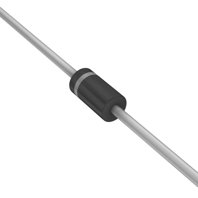

BZX85C3V3 - BZX85C56 — Zener Diodes BZX85C3V3 - BZX85C56 Zener Diodes Tolerance = 5% DO-41 Glass Case COLOR BAND DENOTES CATHODE Absolute Maximum Ratings Stresses exceeding the absolute maximum ratings may damage the device. The device may not function or be operable above the recommended operating conditions and stressing the parts to these levels is not recommended. In addition, extended exposure to stresses above the recommended operating conditions may affect device reliability. The absolute maximum ratings are stress ratings only. Values are at TA = 25°C unless otherwise noted. Symbol PD TJ, TSTG Parameter Value Power Dissipation @ TA = 25°C Power Dissipation @ TL = 25°C at 4 mm distance from the glass package Derate above 50°C Operating and Storage Temperature Range 1.0 © 2007 Semiconductor Components Industries, LLC. October-2017, Rev. 2 1.3 6.67 -65 to +200 Units W mW/°C °C Publication Order Number: BZX85C3V3/D Values are at TA = 25°C unless otherwise noted. Device Zener Voltage(1) IZ VZ (V) Min. Max. mA BZX85C3V3 3.1 3.5 80 BZX85C3V6 3.4 3.8 60 BZX85C3V9 3.7 4.1 60 BZX85C4V3 4.0 4.6 50 BZX85C4V7 4.4 5 45 BZX85C5V1 4.8 5.4 45 BZX85C5V6 5.2 6 45 BZX85C6V2 5.8 6.6 35 BZX85C6V8 6.4 7.2 35 BZX85C7V5 7.0 7.9 35 BZX85C8V2 7.7 8.7 25 BZX85C9V1 8.5 9.6 25 BZX85C10 9.4 10.6 25 BZX85C11 10.4 11.6 20 BZX85C12 11.4 12.7 20 BZX85C13 12.4 14.1 20 BZX85C15 13.8 15.6 15 BZX85C16 15.3 17.1 15 BZX85C18 16.8 19.1 15 BZX85C20 18.8 21.2 10 BZX85C22 20.8 23.3 10 BZX85C24 22.8 25.6 10 BZX85C27 25.1 28.9 8 BZX85C30 28 32 8 BZX85C33 31 35 8 8 34 38 BZX85C36 6 41 BZX85C39 37 46 6 40 BZX85C43 50 4 44 BZX85C47 48 54 4 BZX85C51 BZX85C56 52 60 4 VF Forward Voltage = 1.2 V Max @ IF = 200 mA Zener Impedance ZZ @ IZ ZZK @ IZK (Ω) (Ω) (mA) 20 15 15 13 13 10 7 4 3.5 3 5 5 7 8 9 10 15 15 20 24 25 25 30 30 35 40 45 50 90 115 120 400 500 500 500 600 500 400 300 300 200 200 200 200 300 350 400 500 500 500 600 600 600 750 1000 1000 1000 1000 1000 1500 1500 2000 1 1 1 1 1 1 1 1 1 0.5 0.5 0.5 0.5 0.5 0.5 0.5 0.5 0.5 0.5 0.5 0.5 0.5 0.25 0.25 0.25 0.25 0.25 0.25 0.25 0.25 0.25 Leakage Current IR @ VR μA Max. Volts 60 30 5 3 3 1 1 1 1 1 1 1 0.5 0.5 0.5 0.5 0.5 0.5 0.5 0.5 0.5 0.5 0.5 0.5 0.5 0.5 0.5 0.5 0.5 0.5 0.5 Note: 1. Zener Voltage (VZ): The zener voltage is measured with the device junction in the thermal equilibrium at the lead temperature (TL) at 30°C ± 1°C and 3/8” lead length. www.onsemi.com 2 1 1 1 1 1.5 2 2 3 4 4.5 5 6.5 7 7.7 8.4 9.1 10.5 11 12.5 14 15.5 17 19 21 23 25 27 30 33 36 39 BZX85C3V3 - BZX85C56 — Zener Diodes Electrical Characteristics Device Line 1 Line 2 Line 3 BZX85C3V3 BZX85C3V6 BZX85C3V9 BZX85C4V3 BZX85C4V7 BZX85C5V1 BZX85C5V6 BZX85C6V2 BZX85C6V8 BZX85C7V5 BZX85C8V2 BZX85C9V1 BZX85C10 BZX85C11 BZX85C12 BZX85C13 BZX85C15 BZX85C16 BZX85C18 BZX85C20 BZX85C22 BZX85C24 BZX85C27 BZX85C30 BZX85C33 BZX85C36 BZX85C39 BZX85C43 BZX85C47 BZX85C51 BZX85C56 LOGO LOGO LOGO LOGO LOGO LOGO LOGO LOGO LOGO LOGO LOGO LOGO LOGO LOGO LOGO LOGO LOGO LOGO LOGO LOGO LOGO LOGO LOGO LOGO LOGO LOGO LOGO LOGO LOGO LOGO LOGO 85C 85C 85C 85C 85C 85C 85C 85C 85C 85C 85C 85C 85C 85C 85C 85C 85C 85C 85C 85C 85C 85C 85C 85C 85C 85C 85C 85C 85C 85C 85C 3V3 3V6 3V9 4V3 4V7 5V1 5V6 6V2 6V8 7V5 8V2 9V1 10 11 12 13 15 16 18 20 22 24 27 30 33 36 39 43 47 51 56 www.onsemi.com 3 Line 4 Line 5 XY XY XY XY XY XY XY XY XY XY XY XY XY XY XY XY XY XY XY XY XY XY XY XY XY XY XY XY XY XY XY BZX85C3V3 - BZX85C56 — Zener Diodes Top Mark Information 1st line: - ON Semiconductor Logo 47 2nd line: Device Name - 3rd to 4th characters of device name for 1Nxx series or 4th to 6th characters for BZXyy series 36 A 3rd line: Device Name - 5th to 6th characters of device name for 1Nxx series or Voltage rating for BZXyy series XY 4th line: Device Name - 7th to 8th characters of device name for 1Nxx series or Large Die identification only for BZXyy series 5th line: Date Code - Two Digit - Six Weeks Date Code General Requirements: 1.0 Cathode Band 2.0 First Line: - ON Semiconductor Logo 3.0 Second Line: Device name - For 1Nxx series: 3rd to 4th characters of the device name. For BZxx series: 4th to 6th characters of the device name. 4.0 Third Line: Device name - For 1Nxx series: 5th to 6th characters of the device name. For BZXyy series: Voltage rating 5.0 Third Line: Device name - For 1Nxx series: 7th to 8th characters of the device name. (the 8th character is the large die identification) For BZXyy series: Large Die Identification character 6.0 Fourth Line: Date Code - Two Digit - Six Weeks Date Code Where: X represents the last digit of the calendar year Y represents the Six weeks numeric code 7.0 Devices shall be marked as required in the device specification (PID or OSPI Test Spec). 8.0 Maximum no. of marking lines: 5 9.0 Maximum no. of digits per line: 3 10.0 OSPI logo must be 20% taller than the alphanumeric marking and should occupy the 2 characters of the specified line. 11.0 Marking Font: Arial (Except OSPI Logo) 12.0 First character of each marking line must be aligned vertically 13.0 All device markings must be based on ON Semiconductor device specification. www.onsemi.com 4 BZX85C3V3 - BZX85C56 — Zener Diodes Top Mark Information (Continued) DO-204AL (DO-41) 25.40 MIN (2X) 5.20 4.06 0.86 0.71 2.72 2.03 NOTES: UNLESS OTHERWISE SPECIFIED A) PACKAGE STANDARD REFERENCE: JEDEC DO-204 VARIATION AL. B) PACKAGE BODY CAN BE PLASTIC OR HERMETICALLY SEALED GLASS . D) ALL DIMENSIONS ARE IN MILLIMETERS. E) DRAWING FILE NAME: DO41AREV2 Figure 7. AXIAL LEADED, GLASS, JEDEC DO204, VARIATION AL Package drawings are provided as a service to customers considering ON Semiconductor components. Drawings may change in any manner without notice. Please note the revision and/or date on the drawing and contact a ON Semiconductor representative to verify or obtain the most recent revision. Package specifications do not expand the terms of ON Semiconductor’s worldwide terms and conditions, specifically the warranty therein, which covers ON Semiconductor products. www.onsemi.com 5 BZX85C3V3 - BZX85C56 — Zener Diodes Physical Dimensions ON Semiconductor and are trademarks of Semiconductor Components Industries, LLC dba ON Semiconductor or its subsidiaries in the United States and/or other countries. ON Semiconductor owns the rights to a number of patents, trademarks, copyrights, trade secrets, and other intellectual property. A listing of ON Semiconductor’s product/patent coverage may be accessed at www.onsemi.com/site/pdf/Patent−Marking.pdf. ON Semiconductor reserves the right to make changes without further notice to any products herein. ON Semiconductor makes no warranty, representation or guarantee regarding the suitability of its products for any particular purpose, nor does ON Semiconductor assume any liability arising out of the application or use of any product or circuit, and specifically disclaims any and all liability, including without limitation special, consequential or incidental damages. Buyer is responsible for its products and applications using ON Semiconductor products, including compliance with all laws, regulations and safety requirements or standards, regardless of any support or applications information provided by ON Semiconductor. “Typical” parameters which may be provided in ON Semiconductor data sheets and/or specifications can and do vary in different applications and actual performance may vary over time. All operating parameters, including “Typicals” must be validated for each customer application by customer’s technical experts. ON Semiconductor does not convey any license under its patent rights nor the rights of others. ON Semiconductor products are not designed, intended, or authorized for use as a critical component in life support systems or any FDA Class 3 medical devices or medical devices with a same or similar classification in a foreign jurisdiction or any devices intended for implantation in the human body. Should Buyer purchase or use ON Semiconductor products for any such unintended or unauthorized application, Buyer shall indemnify and hold ON Semiconductor and its officers, employees, subsidiaries, affiliates, and distributors harmless against all claims, costs, damages, and expenses, and reasonable attorney fees arising out of, directly or indirectly, any claim of personal injury or death associated with such unintended or unauthorized use, even if such claim alleges that ON Semiconductor was negligent regarding the design or manufacture of the part. ON Semiconductor is an Equal Opportunity/Affirmative Action Employer. This literature is subject to all applicable copyright laws and is not for resale in any manner. PUBLICATION ORDERING INFORMATION LITERATURE FULFILLMENT: Literature Distribution Center for ON Semiconductor 19521 E. 32nd Pkwy, Aurora, Colorado 80011 USA Phone: 303−675−2175 or 800−344−3860 Toll Free USA/Canada Fax: 303−675−2176 or 800−344−3867 Toll Free USA/Canada Email: orderlit@onsemi.com ❖ © Semiconductor Components Industries, LLC N. American Technical Support: 800−282−9855 Toll Free USA/Canada Europe, Middle East and Africa Technical Support: Phone: 421 33 790 2910 Japan Customer Focus Center Phone: 81−3−5817−1050 ON Semiconductor Website: www.onsemi.com Order Literature: http://www.onsemi.com/orderlit For additional information, please contact your local Sales Representative www.onsemi.com

物料型号:BZX85C3V3 - BZX85C56,这是一系列稳压二极管。
器件简介:文档描述的是ON Semiconductor生产的稳压二极管,具有5%的容差,采用DO-41玻璃封装,并通过颜色带标识阴极。
引脚分配:文档中未明确指出引脚分配,但根据常规的DO-41封装,阴极通过颜色带标识,阳极则是另一端。
参数特性:包括最大额定功率耗散、工作和存储温度范围、稳压电压、稳压阻抗、漏电流等。
功能详解:稳压二极管用于维持稳定的电压水平,即使在电流变化的情况下也能保持电压恒定。
应用信息:文档中未提供具体的应用信息,但稳压二极管通常用于电路中进行电压稳定和保护。
封装信息:采用DO-204AL (DO-41)封装,文档提供了详细的物理尺寸和封装标准参考。
