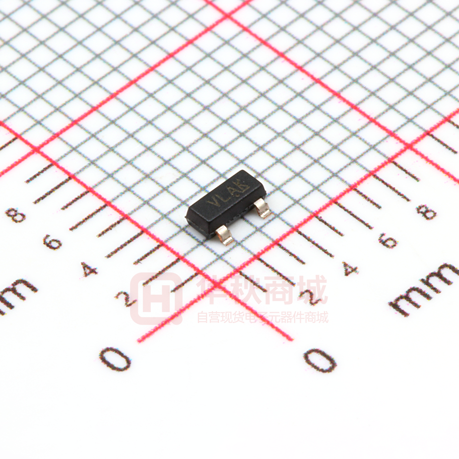

CAT803, CAT809, CAT810 3-Pin Microprocessor Power Supply Supervisors Description The CAT803, CAT809, and CAT810 are supervisory circuits that monitor power supplies in digital systems. The CAT803, CAT809, and CAT810 are direct replacements for the MAX803, MAX809 and MAX810 in applications operating over the industrial temperature range. These devices generate a reset signal, which is asserted while the power supply voltage is below a preset threshold level and for at least 140 ms after the power supply level has risen above that level. The underlying floating gate technology, Analog EEPROM used by ON Semiconductor, makes it possible to offer any custom reset threshold value. Seven industry standard threshold levels are offered to support +5.0 V, +3.3 V, +3.0 V and +2.5 V systems. The CAT803 has an open−drain RESET output (active LOW). The CAT803 requires a pull−up resistor on the reset output. The CAT809 features a push−pull RESET output (active LOW) and the CAT810 features a push−pull RESET output (active HIGH). Fast transients on the power supply are ignored and the output is guaranteed to be in the correct state at VCC levels as low as 1.0 V. The CAT803, CAT809, and CAT810 are available in both the compact 3−pin SOT−23 and SC−70 packages. • • • • • • SC−70 SD SUFFIX CASE 419AB PIN CONFIGURATION 3−Lead SOT23 3−Lead SC70 GND • Precision Monitoring of • SOT−23 TB SUFFIX CASE 527AG 1 Features • http://onsemi.com +5.0 V (−5%, −10%, −20%), +3.3 V (−5%, −10%), +3.0 V (−10%) and +2.5 V (−5%) Power Supplies Offered in Three Output Configurations: − CAT803: Open−Drain Active LOW Reset − CAT809: Push−Pull Active LOW Reset − CAT810: Push−Pull Active HIGH Reset Direct Replacements for the MAX803, MAX809 and MAX810 in Applications Operating over the Industrial Temperature Range Reset Valid down to VCC = 1.0 V 6 mA Power Supply Current Power Supply Transient Immunity Industrial Temperature Range: −40°C to +85°C Available in SOT−23 and SC−70 Packages These Devices are Pb−Free and are RoHS Compliant 3 VCC 2 RESET (RESET) (Top View) CAT803 CAT809 (CAT810) MARKING DIAGRAMS XXXMG G XXXMG G SOT−23 SC−70 XXX M G = Specific Device Code = Month Code = Pb−Free Package (*Note: Microdot may be in either location) Applications • • • • • • Computers, Servers, Laptops, Cable Modems Wireless Communications Embedded Control Systems White Goods, Power Meters Intelligent Instruments PDAs and Handheld Equipment © Semiconductor Components Industries, LLC, 2012 October, 2012 − Rev. 33 ORDERING INFORMATION See detailed ordering and shipping information in the package dimensions section on page 8 of this data sheet. 1 Publication Order Number: CAT803/D CAT803, CAT809, CAT810 Table 1. THRESHOLD SUFFIX SELECTOR Nominal Threshold Voltage Threshold Suffix Designation 4.63 V L 4.55 V H 4.38 V M 4.00 V J 3.08 V T 2.93 V S 2.63 V R 2.32 V Z 1.60 V V Table 2. PIN DESCRIPTIONS Pin Number CAT803 CAT809 CAT810 Name 1 1 1 GND 2 2 − RESET Active LOW reset. RESET is asserted if VCC falls below the reset threshold and remains low for at least 140 ms after VCC rises above the reset threshold. − − 2 RESET Active HIGH reset. RESET is asserted if VCC falls below the reset threshold and remains high for at least 140 ms after VCC rises above the reset threshold. 3 3 3 VCC Description Ground Power supply voltage that is monitored. Table 3. ABSOLUTE MAXIMUM RATINGS Parameter Rating Units −0.3 to +6.0 V Input Current, VCC 20 mA Output Current, RESET, RESET 20 mA Rate of Rise, VCC 100 V/ms Continuous Power Dissipation Derate 2.2 mW/°C above 70°C (SC70) Derate 4 mW/°C above 70°C (SOT23) 175 320 Any pin with respect to ground mW Operating Temperature Range −40 to +85 °C Storage Temperature Range −65 to +105 °C 300 °C Lead Soldering Temperature (10 sec) Stresses exceeding Maximum Ratings may damage the device. Maximum Ratings are stress ratings only. Functional operation above the Recommended Operating Conditions is not implied. Extended exposure to stresses above the Recommended Operating Conditions may affect device reliability. http://onsemi.com 2 CAT803, CAT809, CAT810 VCC VCC VCC TOLERANCE BIAS + RESET DIGITAL DELAY – VOLTAGE REFERENCE CAT803 GND VCC VCC VCC TOLERANCE BIAS + DIGITAL DELAY – VOLTAGE REFERENCE RESET CAT809 GND VCC VCC VCC TOLERANCE BIAS + DIGITAL DELAY – VOLTAGE REFERENCE RESET CAT810 GND Figure 1. Block Diagrams http://onsemi.com 3 CAT803, CAT809, CAT810 Table 4. ELECTRICAL CHARACTERISTICS (VCC = Full range, TA = −40°C to +85°C, unless otherwise specified. Typical values at TA = +25°C and VCC = 5 V for the L/H/M/J versions, VCC = 3.3 V for the T/S versions, VCC = 3 V for the R version and VCC = 2.5 V for the Z/V versions.) Symbol Parameter VCC Range ICC VTH Supply Current Reset Threshold Voltage Conditions Min V 5.5 TA = −40°C to +85°C 1.2 5.5 TA = −40°C to +85°C VCC < 5.5 V, J/L/M/H 8 20 VCC < 3.6 V, R/S/T/Z/V 6 15 L Threshold TA = +25°C 4.56 4.63 4.70 TA = −40°C to +85°C 4.50 TA = +25°C 4.48 TA = −40°C to +85°C 4.43 TA = +25°C 4.31 TA = −40°C to +85°C 4.25 TA = +25°C 3.93 TA = −40°C to +85°C 3.89 TA = +25°C 3.04 TA = −40°C to +85°C 3.00 TA = +25°C 2.89 TA = −40°C to +85°C 2.85 TA = +25°C 2.59 TA = −40°C to +85°C 2.55 TA = +25°C 2.28 TA = −40°C to +85°C 2.25 TA = +25°C 1.58 TA = −40°C to +85°C 1.56 J Threshold T Threshold S Threshold R Threshold Z Threshold V Threshold Reset Threshold Tempco VCC to Reset Delay (Note 2) VCC = VTH to (VTH − 100 mV) TR Reset Active Timeout Period TA = −40°C to +85°C 4.55 VOL RESET Output Voltage Low (Open−drain active LOW, CAT803 and push−pull, active LOW, CAT809) V 4.62 4.67 4.38 4.45 4.50 4.00 4.06 4.10 3.08 3.11 3.15 2.93 2.96 3.00 2.63 2.66 2.70 2.32 2.35 2.38 1.60 1.62 1.64 ppm/°C 20 140 mA 4.75 30 TD VOH Units 1.0 M Threshold VOL Max TA = 0°C to +70°C H Threshold VOH Typ (Note 1) 240 ms 460 ms VCC = VTH min, ISINK = 1.2 mA CAT803R/S/T/Z, CAT809R/S/T/Z/V 0.3 V VCC = VTH min, ISINK = 3.2 mA CAT803J/L/M, CAT809J/L/M/H 0.4 VCC > 1.0 V, ISINK = 50 mA 0.3 RESET Output Voltage High (Push−pull, active LOW, CAT809) VCC = VTH max, ISOURCE = 500 mA CAT809R/S/T/Z/V 0.8 VCC VCC = VTH max, ISOURCE = 800 mA CAT809J/L/M/H VCC − 1.5 RESET Output Voltage Low (Push−pull, active HIGH, CAT810) VCC > VTH max, ISINK = 1.2 mA CAT810R/S/T/Z 0.3 VCC > VTH max, ISINK = 3.2 mA CAT810J/L/M 0.4 RESET Output Voltage High (Push−pull, active HIGH, CAT810) 1.8 V < VCC VTH min, ISOURCE = 150 mA 1. Production testing done at TA = +25°C; limits over temperature guaranteed by design only. 2. RESET output for the CAT809; RESET output for the CAT810. http://onsemi.com 4 0.8 VCC V V V CAT803, CAT809, CAT810 TYPICAL OPERATING CHARACTERISTICS (VCC = Full range, TA = −40°C to +85°C, unless otherwise specified. Typical values at TA = +25°C and VCC = 5 V for the L/M/J versions, VCC = 3.3 V for the T/S versions, VCC = 3 V for the R version and VCC = 2.5 V for the Z version.) 12 SUPPLY CURRENT (mA) VCC = 5 V 240 220 VCC = 2.5 V 200 180 160 −50 0 50 100 10 VCC = 5.5 V 8 4 2 0 50 100 150 TEMPERATURE (°C) TEMPERATURE (°C) Figure 2. Power−up Reset Timeout vs. Temperature Figure 3. Supply Current vs. Temperature (No Load, CAT8xxR/S/T/Z) 14 1.0002 12 1.0000 10 8 6 4 2 0 −50 VCC = 3.6 V 6 0 −50 150 NORMALIZED THRESHOLD POWER−DOWN RESET DELAY (mS) POWER−UP RESET TIMEOUT (mS) 260 0 50 100 0.9998 0.9996 0.9994 0.9992 0.9990 0.9988 150 0 20 40 60 80 100 TEMPERATURE (°C) TEMPERATURE (°C) Figure 4. Power−down Reset Delay vs. Temperature (CAT8xxR/S/T/Z) Figure 5. Normalized Reset Threshold vs. Temperature http://onsemi.com 5 120 CAT803, CAT809, CAT810 Detailed Descriptions Reset Timing The reset signal is asserted LOW for the CAT803/CAT809 and HIGH for the CAT810 when the power supply voltage falls below the threshold trip voltage and remains asserted for at least 140 ms after the power supply voltage has risen above the threshold. 5V VTH VCC 0V TR TD 5V CAT803, CAT809 Reset Timeout Period (140 ms minimum) RESET 0V 5V CAT810 RESET 0V Figure 6. Reset Timing Diagram 30 VCC Transient Response TAMB = 25°C TRANSIENT DURATION (ms) The CAT803/CAT809/CAT810 protect mPs against brownout failure. Short duration transients of 4 msec or less and 100 mV amplitude typically do not cause a false RESET. Figure 7 shows the maximum pulse duration of negative− going VCC transients that do not cause a reset condition. As the amplitude of the transient goes further below the threshold (increasing VTH − VCC), the maximum pulse duration decreases. In this test, the VCC starts from an initial voltage of 0.5 V above the threshold and drops below it by the amplitude of the overdrive voltage (VTH − VCC). 25 20 15 CAT809Z 10 CAT809M 5 0 1 10 100 1000 RESET OVERDRIVE VTH − VCC (mV) Figure 7. Maximum Transient Duration without Causing a Reset Pulse vs. Reset Comparator Overdrive http://onsemi.com 6 CAT803, CAT809, CAT810 Valid RESET with VCC Under 1.0 V To ensure that the CAT809 RESET pin is in a known state when VCC is under 1.0 V, a >10 kW pull−down resistor between RESET pin and GND is recommended. For the CAT810, a pull−up resistor from RESET pin to VCC is needed. Power Supply Power Supply VCC VCC 10 kW CAT810 CAT809 RESET RESET 10 kW GND GND Figure 8. RESET Valid with VCC Under 1.0 V Figure 9. RESET Valid with VCC Under 1.1 V Bi−directional Reset Pin Interfacing The CAT809/810 can interface with mP/mC bi−directional reset pins by connecting a 4.7 kW resistor in series with the CAT809/810 reset output and the mP/mC bi−directional reset pin. BUF Power Supply Buffered RESET VCC VCC CAT809 mP 4.7 kW (For example: 68HC11) RESET INPUT RESET GND GND Bi−directional I/O Pin Figure 10. Bi−directional Reset Pin Interfacing CAT803 Open−Drain RESET Application Power Supply The CAT803 features an open−drain RESET output and therefore needs a pull−up resistor on the output for proper operation, as shown on Figure 11. An advantage of the open−drain output includes the ability to “wire AND” several outputs together to form an inexpensive logic circuit. It is also possible to have the pull−up resistor connected to a different supply which can be higher than the CAT803 VCC pin. The value of the pull−up resistor is not critical in most applications, typical values being between 5 kW and 10 kW. VCC 5 kW CAT803 VCC mP RESET GND RESET INPUT GND Figure 11. Typical CAT803 Open−Drain Circuit Configuration http://onsemi.com 7 CAT803, CAT809, CAT810 Table 5. ORDERING PART NUMBER Top Mark (Note 4) Order Number NiPdAu (Note 3) Matte−Tin Voltage NiPdAu Matte−Tin CAT803LSDI−GT3 CAT803LSDI−T3 4.63 V VKA VKL CAT803MSDI−GT3 CAT803MSDI−T3 4.38 V VKA VKL CAT803JSDI−GT3 CAT803JSDI−T3 4.00 V VKA VKL CAT803TSDI−GT3 CAT803TSDI−T3 3.08 V VKA VKL CAT803SSDI−GT3 CAT803SSDI−T3 2.93 V VKA VKL CAT803RSDI−GT3 CAT803RSDI−T3 2.63 V VKA VKL CAT803ZSDI−GT3 CAT803ZSDI−T3 2.32 V VKA VKL CAT803LTBI−GT3 CAT803LTBI−T3 4.63 V VKA VKL CAT803MTBI−GT3 CAT803MTBI−T3 4.38 V VKA VKL CAT803JTBI−GT3 CAT803JTBI−T3 4.00 V VKA VKL CAT803TTBI−GT3 CAT803TTBI−T3 3.08 V VKA VKL CAT803STBI−GT3 CAT803STBI−T3 2.93 V VKA VKL CAT803RTBI−GT3 CAT803RTBI−T3 2.63 V VKA VKL CAT803ZTBI−GT3 CAT803ZTBI−T3 2.32 V VKA VKL CAT809LSDI−GT3 CAT809LSDI−T3 4.63 V VLA VLD CAT809MSDI−GT3 CAT809MSDI−T3 4.38 V VLA VLD CAT809JSDI−GT3 CAT809JSDI−T3 4.00 V VLA VLD CAT809TSDI−GT3 CAT809TSDI−T3 3.08 V VLA VLD CAT809SSDI−GT3 CAT809SSDI−T3 2.93 V VLA VLD CAT809RSDI−GT3 CAT809RSDI−T3 2.63 V VLA VLD CAT809ZSDI−GT3 CAT809ZSDI−T3 2.32 V VLA VLD CAT809LTBI−GT3 CAT809LTBI−T3 4.63 V VLA VLD CAT809HTBI−GT3 CAT809HTBI−T3 4.55 V VLA VLD CAT809MTBI−GT3 CAT809MTBI−T3 4.38 V VLA VLD CAT809JTBI−GT3 CAT809JTBI−T3 4.00 V VLA VLD CAT809TTBI−GT3 CAT809TTBI−T3 3.08 V VLA VLD CAT809STBI−GT3 CAT809STBI−T3 2.93 V VLA VLD CAT809RTBI−GT3 CAT809RTBI−T3 2.63 V VLA VLD CAT809ZTBI−GT3 CAT809ZTBI−T3 2.32 V VLA VLD CAT809VTBI−GT3 CAT809VTBI−T3 1.60 V VLA VLD Output Reset Package Open Drain LOW SC70−3 Quantity per Reel (Note 5) 3,000 Open Drain LOW SOT−23−3 CMOS / Push−Pull LOW SC70−3 3,000 CMOS / Push−Pull LOW SOT−23−3 3. Not recommended for new designs. 4. Threshold and full part numbers will be provided on box and reel labels as well as all Shipping documents. 5. For information on tape and reel specifications, including part orientation and tape sizes, please refer to our Tape and Reel Packaging Specifications Brochure, BRD8011/D. 6. For detailed information and a breakdown of device nomenclature and numbering systems, please see the ON Semiconductor Device Nomenclature document, TND310/D, available at www.onsemi.com http://onsemi.com 8 CAT803, CAT809, CAT810 Table 5. ORDERING PART NUMBER Top Mark (Note 4) Order Number NiPdAu (Note 3) Matte−Tin Voltage NiPdAu Matte−Tin CAT810LSDI−GT3 CAT810LSDI−T3 4.63 V VHA VHT CAT810MSDI−GT3 CAT810MSDI−T3 4.38 V VHA VHT CAT810JSDI−GT3 CAT810JSDI−T3 4.00 V VHA VHT CAT810TSDI−GT3 CAT810TSDI−T3 3.08 V VHA VHT CAT810SSDI−GT3 CAT810SSDI−T3 2.93 V VHA VHT CAT810RSDI−GT3 CAT810RSDI−T3 2.63 V VHA VHT CAT810ZSDI−GT3 CAT810ZSDI−T3 2.32 V VHA VHT CAT810LTBI−GT3 CAT810LTBI−T3 4.63 V VHA VHT CAT810MTBI−GT3 CAT810MTBI−T3 4.38 V VHA VHT CAT810JTBI−GT3 CAT810JTBI−T3 4.00 V VHA VHT CAT810TTBI−GT3 CAT810TTBI−T3 3.08 V VHA VHT CAT810STBI−GT3 CAT810STBI−T3 2.93 V VHA VHT CAT810RTBI−GT3 CAT810RTBI−T3 2.63 V VHA VHT CAT810ZTBI−GT3 CAT810ZTBI−T3 2.32 V VHA VHT Output Reset Package CMOS / Push−Pull HIGH SC70−3 Quantity per Reel (Note 5) 3,000 CMOS / Push−Pull HIGH SOT−23−3 3. Not recommended for new designs. 4. Threshold and full part numbers will be provided on box and reel labels as well as all Shipping documents. 5. For information on tape and reel specifications, including part orientation and tape sizes, please refer to our Tape and Reel Packaging Specifications Brochure, BRD8011/D. 6. For detailed information and a breakdown of device nomenclature and numbering systems, please see the ON Semiconductor Device Nomenclature document, TND310/D, available at www.onsemi.com http://onsemi.com 9 CAT803, CAT809, CAT810 PACKAGE DIMENSIONS SOT−23, 3 Lead CASE 527AG−01 ISSUE O SYMBOL D 3 E1 1 E 2 e e1 MIN A 0.89 1.12 0.013 0.10 b 0.37 0.50 c 0.085 0.18 D 2.80 3.04 E 2.10 2.64 E1 1.20 1.40 e 0.95 BSC e1 1.90 BSC L 0.40 REF 0.54 REF 0º θ A MAX A1 L1 TOP VIEW NOM 8º q b L1 A1 SIDE VIEW L END VIEW Notes: (1) All dimensions are in millimeters. Angles in degrees. (2) Complies with JEDEC TO-236. http://onsemi.com 10 c CAT803, CAT809, CAT810 PACKAGE DIMENSIONS SC−70, 3 Lead, 1.25x2 CASE 419AB−01 ISSUE O MIN SYMBOL D E1 E A 0.80 1.10 0.00 0.10 A2 0.80 b 0.15 0.30 c 0.08 0.22 D 1.80 2.00 2.20 E 1.80 2.10 2.40 E1 1.15 1.25 1.35 TOP VIEW 0.90 1.00 0.65 BSC L e MAX A1 e e NOM 0.26 0.36 L1 0.42 REF L2 0.15 BSC 0.46 θ 0º 8º θ1 4º 10º q1 A2 A q q1 b L L1 A1 SIDE VIEW c L2 END VIEW Notes: (1) All dimensions are in millimeters. Angles in degrees. (2) Complies with JEDEC MO-203. ON Semiconductor and are registered trademarks of Semiconductor Components Industries, LLC (SCILLC). SCILLC reserves the right to make changes without further notice to any products herein. SCILLC makes no warranty, representation or guarantee regarding the suitability of its products for any particular purpose, nor does SCILLC assume any liability arising out of the application or use of any product or circuit, and specifically disclaims any and all liability, including without limitation special, consequential or incidental damages. “Typical” parameters which may be provided in SCILLC data sheets and/or specifications can and do vary in different applications and actual performance may vary over time. All operating parameters, including “Typicals” must be validated for each customer application by customer’s technical experts. SCILLC does not convey any license under its patent rights nor the rights of others. SCILLC products are not designed, intended, or authorized for use as components in systems intended for surgical implant into the body, or other applications intended to support or sustain life, or for any other application in which the failure of the SCILLC product could create a situation where personal injury or death may occur. Should Buyer purchase or use SCILLC products for any such unintended or unauthorized application, Buyer shall indemnify and hold SCILLC and its officers, employees, subsidiaries, affiliates, and distributors harmless against all claims, costs, damages, and expenses, and reasonable attorney fees arising out of, directly or indirectly, any claim of personal injury or death associated with such unintended or unauthorized use, even if such claim alleges that SCILLC was negligent regarding the design or manufacture of the part. SCILLC is an Equal Opportunity/Affirmative Action Employer. This literature is subject to all applicable copyright laws and is not for resale in any manner. PUBLICATION ORDERING INFORMATION LITERATURE FULFILLMENT: Literature Distribution Center for ON Semiconductor P.O. Box 5163, Denver, Colorado 80217 USA Phone: 303−675−2175 or 800−344−3860 Toll Free USA/Canada Fax: 303−675−2176 or 800−344−3867 Toll Free USA/Canada Email: orderlit@onsemi.com N. American Technical Support: 800−282−9855 Toll Free USA/Canada Europe, Middle East and Africa Technical Support: Phone: 421 33 790 2910 Japan Customer Focus Center Phone: 81−3−5817−1050 http://onsemi.com 11 ON Semiconductor Website: www.onsemi.com Order Literature: http://www.onsemi.com/orderlit For additional information, please contact your local Sales Representative CAT803/D
