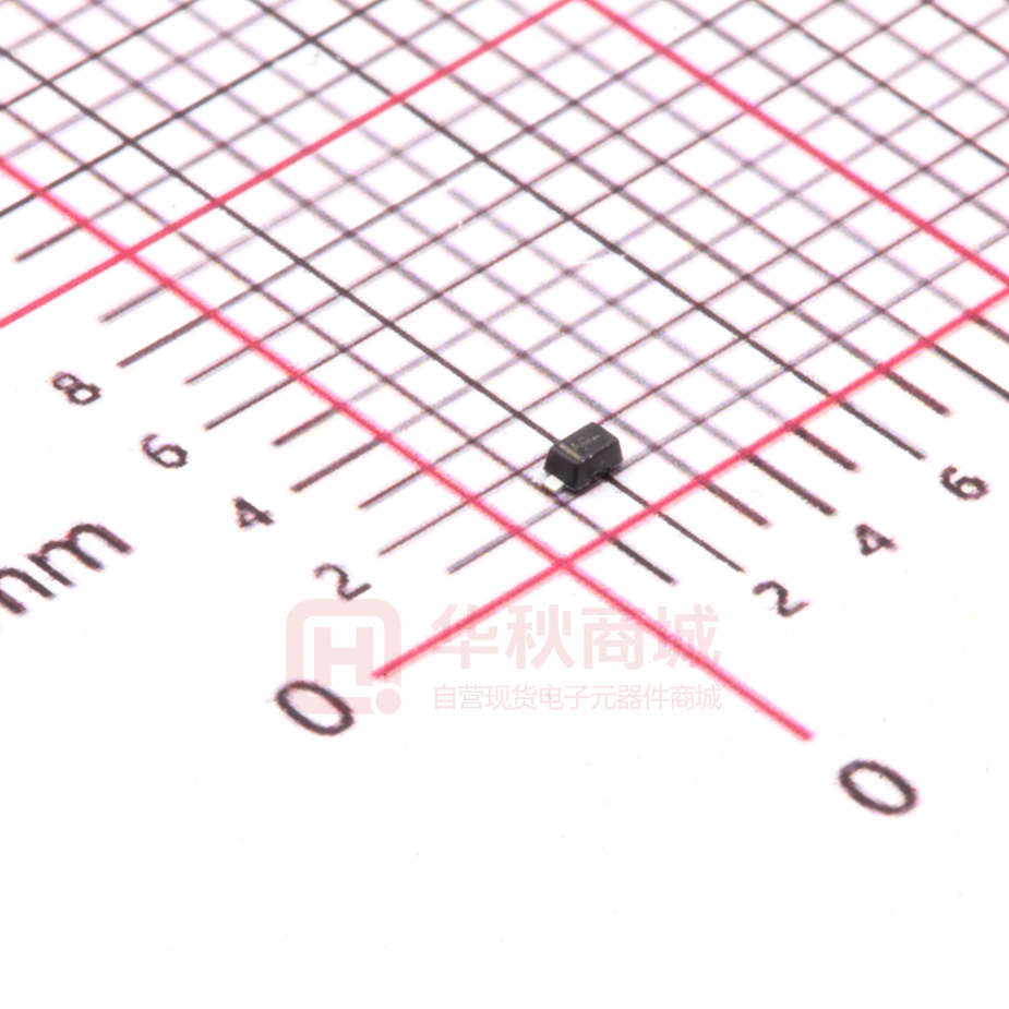

ESD7371XV2T1G
ESD7371XV2T1G
    ONSEMI(安森美)
    SOD-523(SC-79)
    ESD保护二极管5.3VWM SOD523 IPP=3A VC=14V
ESD7371XV2T1G 数据手册
ESD7371, SZESD7371 Series ESD Protection Diode Ultra−Low Capacitance www.onsemi.com MARKING DIAGRAMS 2 SOD−323 CASE 477 1 2 SOD−523 CASE 502 Features • • • • • • • • • Industry Leading Capacitance Linearity Over Voltage Low Capacitance (0.7 pF Max, I/O to GND) Stand−off Voltage: 5.3 V Low Leakage: < 1 nA Low Dynamic Resistance < 1 W IEC61000−4−2 Level 4 ESD Protection 1000 ESD IEC61000−4−2 Strikes ±8 kV Contact / Air Discharged SZ Prefix for Automotive and Other Applications Requiring Unique Site and Control Change Requirements; AEC−Q101 Qualified and PPAP Capable These Devices are Pb−Free, Halogen Free/BFR Free and are RoHS Compliant Typical Applications • • • • Unit IEC 61000−4−2 (ESD) (Note 1) 20 kV IEC 61000−4−5 (ESD) (Note 2) 3.0 A °PD° RqJA 300 400 mW °C/W TJ, Tstg −55 to +150 °C TL 260 °C Junction and Storage Temperature Range Lead Solder Temperature − Maximum (10 Second Duration) X, XX M AE M = Specific Device Code = Date Code PIN CONFIGURATION AND SCHEMATIC 2 Anode ORDERING INFORMATION Value Total Power Dissipation (Note 3) @ TA = 25°C Thermal Resistance, Junction−to−Ambient 2 See detailed ordering and shipping information in the package dimensions section on page 5 of this data sheet. MAXIMUM RATINGS (TA = 25°C unless otherwise noted) Symbol AG 1 SOD−923 CASE 514AB 1 Cathode RF Signal ESD Protection RF Switching, PA, and Antenna ESD Protection Near Field Communications USB 2.0, USB 3.0 Rating 1 AG M M The ESD7371 Series is designed to protect voltage sensitive components that require ultra−low capacitance from ESD and transient voltage events. Excellent clamping capability, low capacitance, high breakdown voltage, high linearity, low leakage, and fast response time make these parts ideal for ESD protection on designs where board space is at a premium. It has industry leading capacitance linearity over voltage making it ideal for RF applications. This capacitance linearity combined with the extremely small package and low insertion loss makes this part well suited for use in antenna line applications for wireless handsets and terminals. Stresses exceeding those listed in the Maximum Ratings table may damage the device. If any of these limits are exceeded, device functionality should not be assumed, damage may occur and reliability may be affected. 1. Non−repetitive current pulse at TA = 25°C, per IEC61000−4−2 waveform. 2. Non−repetitive current pulse at TA = 25°C, per IEC61000−4−5 waveform. 3. Mounted with recommended minimum pad size, DC board FR−4 © Semiconductor Components Industries, LLC, 2014 August, 2018 − Rev. 3 1 Publication Order Number: ESD7371/D ESD7371, SZESD7371 Series See Application Note AND8308/D for further description of survivability specs. ELECTRICAL CHARACTERISTICS I (TA = 25°C unless otherwise noted) IF Parameter Symbol IPP Maximum Reverse Peak Pulse Current VC Clamping Voltage @ IPP VRWM IR VBR IT VC VBR VRWM Working Peak Reverse Voltage V IR VF IT Maximum Reverse Leakage Current @ VRWM Breakdown Voltage @ IT Test Current *See Application Note AND8308/D for detailed explanations of datasheet parameters. IPP Uni−Directional ELECTRICAL CHARACTERISTICS (TA = 25°C unless otherwise specified) Parameter Reverse Working Voltage Breakdown Voltage (Note 4) Symbol Conditions Min Typ Max Unit 5.3 V < 1.0 50 nA VRWM VBR IT = 1 mA 7.0 V Reverse Leakage Current IR VRWM = 5.3 V Clamping Voltage (Note 5) VC IPP = 1 A 11 15 V Clamping Voltage (Note 5) VC IPP = 3 A 14 20 V Junction Capacitance CJ VR = 0 V, f = 1 MHz VR = 0 V, f < 1 GHz 0.43 0.39 0.7 0.7 pF Dynamic Resistance RDYN TLP Pulse 0.45 W Product parametric performance is indicated in the Electrical Characteristics for the listed test conditions, unless otherwise noted. Product performance may not be indicated by the Electrical Characteristics if operated under different conditions. 4. Breakdown voltage is tested from pin 1 to 2 and pin 2 to 1. 5. Non−repetitive current pulse at TA = 25°C, per IEC61000−4−5 waveform. www.onsemi.com 2 ESD7371, SZESD7371 Series 1 1.E−04 0.9 1.E−05 0.8 CAPACITANCE (pF) 1.E−03 1.E−06 I (A) 1.E−07 1.E−08 1.E−09 0.7 0.6 0.5 0.4 0.3 1.E−10 0.2 1.E−11 0.1 1.E−12 0 1 2 3 4 5 6 7 8 9 0 10 11 12 0 1 2 V (V) 4 5 6 Vbias (V) Figure 1. IV Characteristics Figure 2. CV Characteristics 2 2.0 0 1.8 1.6 CAPACITANCE (pF) −2 −4 −6 dB 3 −8 −10 1.4 1.2 1.0 0.8 0.6 0.4 −12 0.2 −14 1E8 1E9 2E10 1E10 0.0 0.5 1.5 2.5 FREQUENCY (Hz) 4.5 5.5 6.5 7.5 8.5 9.5 FREQUENCY Figure 3. RF Insertion Loss Figure 4. Capacitance over Frequency −16 8 16 8 10 4 8 6 2 4 EQUIVALENT VIEC (kV) TLP CURRENT (A) 6 12 −12 6 −10 −8 4 −6 −4 2 −2 2 0 0 2 4 6 8 10 12 VOLTAGE (V) 14 16 18 0 0 20 0 Figure 5. Positive TLP I−V Curve 2 4 6 8 10 12 VOLTAGE (V) 14 16 Figure 6. Negative TLP I−V Curve www.onsemi.com 3 18 0 20 EQUIVALENT VIEC (kV) −14 14 TLP CURRENT (A) 3.5 ESD7371, SZESD7371 Series IEC61000−4−2 Waveform IEC 61000−4−2 Spec. Ipeak Level Test Voltage (kV) First Peak Current (A) Current at 30 ns (A) Current at 60 ns (A) 1 2 7.5 4 2 2 4 15 8 4 3 6 22.5 12 6 4 8 30 16 8 100% 90% I @ 30 ns I @ 60 ns 10% tP = 0.7 ns to 1 ns Figure 7. IEC61000−4−2 Spec Device ESD Gun Under Oscilloscope Test 50 W 50 W Cable Figure 8. Diagram of ESD Clamping Voltage Test Setup The following is taken from Application Note AND8308/D − Interpretation of Datasheet Parameters for ESD Devices. from a 100 ns long rectangular pulse from a charged transmission line. A simplified schematic of a typical TLP system is shown in Figure 9. TLP I−V curves of ESD protection devices accurately demonstrate the product’s ESD capability because the 10s of amps current levels and under 100 ns time scale match those of an ESD event. This is illustrated in Figure 10 where an 8 kV IEC 61000−4−2 current waveform is compared with TLP current pulses at 8 A and 16 A. A TLP I−V curve shows the voltage at which the device turns on as well as how well the device clamps voltage over a range of current levels. ESD Voltage Clamping For sensitive circuit elements it is important to limit the voltage that an IC will be exposed to during an ESD event to as low a voltage as possible. The ESD clamping voltage is the voltage drop across the ESD protection diode during an ESD event per the IEC61000−4−2 waveform. Since the IEC61000−4−2 was written as a pass/fail spec for larger systems such as cell phones or laptop computers it is not clearly defined in the spec how to specify a clamping voltage at the device level. ON Semiconductor has developed a way to examine the entire voltage waveform across the ESD protection diode over the time domain of an ESD pulse in the form of an oscilloscope screenshot, which can be found on the datasheets for all ESD protection diodes. For more information on how ON Semiconductor creates these screenshots and how to interpret them please refer to AND8307/D. L S Attenuator ÷ 50 W Coax Cable 10 MW IM 50 W Coax Cable VM DUT VC Oscilloscope Transmission Line Pulse (TLP) Measurement Transmission Line Pulse (TLP) provides current versus voltage (I−V) curves in which each data point is obtained Figure 9. Simplified Schematic of a Typical TLP System www.onsemi.com 4 ESD7371, SZESD7371 Series Figure 10. Comparison Between 8 kV IEC 61000−4−2 and 8 A and 16 A TLP Waveforms ORDERING INFORMATION Package Shipping† ESD7371HT1G, SZESD7371HT1G* SOD−323 (Pb−Free) 3000 / Tape & Reel ESD7371XV2T1G, SZESD7371XV2T1G* SOD−523 (Pb−Free) 3000 / Tape & Reel ESD7371XV2T5G, SZESD7371XV2T5G* SOD−523 (Pb−Free) 8000 / Tape & Reel ESD7371P2T5G, SZESD7371P2T5G* SOD−923 (Pb−Free) 8000 / Tape & Reel Device †For information on tape and reel specifications, including part orientation and tape sizes, please refer to our Tape and Reel Packaging Specifications Brochure, BRD8011/D. *SZ Prefix for Automotive and Other Applications Requiring Unique Site and Control Change Requirements; AEC−Q101 Qualified and PPAP Capable. www.onsemi.com 5 MECHANICAL CASE OUTLINE PACKAGE DIMENSIONS 2 1 STYLE 1 SOD−323 CASE 477−02 ISSUE H 2 SCALE 4:1 NOTES: 1. DIMENSIONING AND TOLERANCING PER ANSI Y14.5M, 1982. 2. CONTROLLING DIMENSION: MILLIMETERS. 3. LEAD THICKNESS SPECIFIED PER L/F DRAWING WITH SOLDER PLATING. 4. DIMENSIONS A AND B DO NOT INCLUDE MOLD FLASH, PROTRUSIONS OR GATE BURRS. 5. DIMENSION L IS MEASURED FROM END OF RADIUS. HE D b 1 2 E A3 A C NOTE 3 DATE 13 MAR 2007 1 STYLE 2 L A1 NOTE 5 MILLIMETERS DIM MIN NOM MAX A 0.80 0.90 1.00 A1 0.00 0.05 0.10 A3 0.15 REF b 0.25 0.32 0.4 C 0.089 0.12 0.177 D 1.60 1.70 1.80 E 1.15 1.25 1.35 L 0.08 HE 2.30 2.50 2.70 INCHES NOM MAX 0.035 0.040 0.002 0.004 0.006 REF 0.010 0.012 0.016 0.003 0.005 0.007 0.062 0.066 0.070 0.045 0.049 0.053 0.003 0.090 0.098 0.105 MIN 0.031 0.000 GENERIC MARKING DIAGRAM* SOLDERING FOOTPRINT* XX M 0.63 0.025 STYLE 1 0.83 0.033 *This information is generic. Please refer to device data sheet for actual part marking. Pb−Free indicator, “G” or microdot “ G”, may or may not be present. 2.85 0.112 *For additional information on our Pb−Free strategy and soldering details, please download the ON Semiconductor Soldering and Mounting Techniques Reference Manual, SOLDERRM/D. DESCRIPTION: 98ASB17533C SOD−323 STYLE 2 XX = Specific Device Code M = Date Code 1.60 0.063 DOCUMENT NUMBER: XX M STYLE 1: PIN 1. CATHODE (POLARITY BAND) 2. ANODE STYLE 2: NO POLARITY Electronic versions are uncontrolled except when accessed directly from the Document Repository. Printed versions are uncontrolled except when stamped “CONTROLLED COPY” in red. PAGE 1 OF 1 ON Semiconductor and are trademarks of Semiconductor Components Industries, LLC dba ON Semiconductor or its subsidiaries in the United States and/or other countries. ON Semiconductor reserves the right to make changes without further notice to any products herein. ON Semiconductor makes no warranty, representation or guarantee regarding the suitability of its products for any particular purpose, nor does ON Semiconductor assume any liability arising out of the application or use of any product or circuit, and specifically disclaims any and all liability, including without limitation special, consequential or incidental damages. ON Semiconductor does not convey any license under its patent rights nor the rights of others. © Semiconductor Components Industries, LLC, 2019 www.onsemi.com MECHANICAL CASE OUTLINE PACKAGE DIMENSIONS 2 2 1 1 STYLE 1 STYLE 2 SOD−523 CASE 502−01 ISSUE E SCALE 4:1 −X− D NOTES: 1. DIMENSIONING AND TOLERANCING PER ASME Y14.5M, 1994. 2. CONTROLLING DIMENSION: MILLIMETERS. 3. MAXIMUM LEAD THICKNESS INCLUDES LEAD FINISH. MINIMUM LEAD THICKNESS IS THE MINIMUM THICKNESS OF BASE MATERIAL. 4. DIMENSIONS D AND E DO NOT INCLUDE MOLD FLASH, PROTRUSIONS, OR GATE BURRS. −Y− E M 2 X Y DIM A b c D E HE L L2 TOP VIEW A c HE MILLIMETERS MIN NOM MAX 0.50 0.60 0.70 0.25 0.30 0.35 0.07 0.14 0.20 1.10 1.20 1.30 0.70 0.80 0.90 1.50 1.60 1.70 0.30 REF 0.15 0.20 0.25 GENERIC MARKING DIAGRAM* SIDE VIEW 2X XX L 1 XX 2 1 STYLE 1 2X XX M L2 RECOMMENDED SOLDERING FOOTPRINT* PACKAGE OUTLINE = Specific Device Code Date Code STYLE 1: PIN 1. CATHODE (POLARITY BAND) 2. ANODE 1.80 0.48 2 STYLE 2 *This information is generic. Please refer to device data sheet for actual part marking. Pb−Free indicator, “G” or microdot “ G”, may or may not be present. BOTTOM VIEW 2X M b 0.08 1 M 2X DATE 28 SEP 2010 2X STYLE 2: NO POLARITY 0.40 DIMENSION: MILLIMETERS *For additional information on our Pb−Free strategy and soldering details, please download the ON Semiconductor Soldering and Mounting Techniques Reference Manual, SOLDERRM/D. DOCUMENT NUMBER: DESCRIPTION: 98AON11524D SOD−523 Electronic versions are uncontrolled except when accessed directly from the Document Repository. Printed versions are uncontrolled except when stamped “CONTROLLED COPY” in red. PAGE 1 OF 1 ON Semiconductor and are trademarks of Semiconductor Components Industries, LLC dba ON Semiconductor or its subsidiaries in the United States and/or other countries. ON Semiconductor reserves the right to make changes without further notice to any products herein. ON Semiconductor makes no warranty, representation or guarantee regarding the suitability of its products for any particular purpose, nor does ON Semiconductor assume any liability arising out of the application or use of any product or circuit, and specifically disclaims any and all liability, including without limitation special, consequential or incidental damages. ON Semiconductor does not convey any license under its patent rights nor the rights of others. © Semiconductor Components Industries, LLC, 2019 www.onsemi.com MECHANICAL CASE OUTLINE PACKAGE DIMENSIONS SOD−923 CASE 514AB ISSUE D STYLE 1 DATE 03 SEP 2020 STYLE 2 SCALE 8:1 D −X− NOTES: 1. DIMENSIONING AND TOLERANCING PER ASME Y14.5M, 1994. 2. CONTROLLING DIMENSION: MILLIMETERS. 3. MAXIMUM LEAD THICKNESS INCLUDES LEAD FINISH. MINIMUM LEAD THICKNESS IS THE MINIMUM THICKNESS OF BASE MATERIAL. 4. DIMENSIONS D AND E DO NOT INCLUDE MOLD FLASH, PROTRUSIONS, OR GATE BURRS. 5. DIMENSION L WILL NOT EXCEED 0.30mm. −Y− E 1 2X b 0.08 X Y 2 TOP VIEW c HE SIDE VIEW 2X 2X BOTTOM VIEW XM XM STYLE 1 STYLE 2 X M SOLDERING FOOTPRINT* = Specific Device Code = Date Code *This information is generic. Please refer to device data sheet for actual part marking. Pb−Free indicator, “G” or microdot “ G”, may or may not be present. 1.20 2X INCHES MIN NOM MAX 0.013 0.015 0.016 0.006 0.008 0.010 0.003 0.005 0.007 0.030 0.031 0.033 0.022 0.024 0.026 0.037 0.039 0.041 0.007 REF 0.002 0.004 0.006 GENERIC MARKING DIAGRAM* L L2 2X 0.36 MILLIMETERS MIN NOM MAX 0.34 0.37 0.40 0.15 0.20 0.25 0.07 0.12 0.17 0.75 0.80 0.85 0.55 0.60 0.65 0.95 1.00 1.05 0.19 REF 0.05 0.10 0.15 DIM A b c D E HE L L2 A 0.25 STYLE 1: PIN 1. CATHODE (POLARITY BAND) 2. ANODE PACKAGE OUTLINE STYLE 2: NO POLARITY DIMENSIONS: MILLIMETERS See Application Note AND8455/D for more mounting details *For additional information on our Pb−Free strategy and soldering details, please download the ON Semiconductor Soldering and Mounting Techniques Reference Manual, SOLDERRM/D. DOCUMENT NUMBER: DESCRIPTION: 98AON23284D Electronic versions are uncontrolled except when accessed directly from the Document Repository. Printed versions are uncontrolled except when stamped “CONTROLLED COPY” in red. SOD−923, 1.0X0.6X0.37, MAX HEIGHT 0.40 PAGE 1 OF 1 ON Semiconductor and are trademarks of Semiconductor Components Industries, LLC dba ON Semiconductor or its subsidiaries in the United States and/or other countries. ON Semiconductor reserves the right to make changes without further notice to any products herein. ON Semiconductor makes no warranty, representation or guarantee regarding the suitability of its products for any particular purpose, nor does ON Semiconductor assume any liability arising out of the application or use of any product or circuit, and specifically disclaims any and all liability, including without limitation special, consequential or incidental damages. ON Semiconductor does not convey any license under its patent rights nor the rights of others. © Semiconductor Components Industries, LLC, 2019 www.onsemi.com onsemi, , and other names, marks, and brands are registered and/or common law trademarks of Semiconductor Components Industries, LLC dba “onsemi” or its affiliates and/or subsidiaries in the United States and/or other countries. onsemi owns the rights to a number of patents, trademarks, copyrights, trade secrets, and other intellectual property. A listing of onsemi’s product/patent coverage may be accessed at www.onsemi.com/site/pdf/Patent−Marking.pdf. onsemi reserves the right to make changes at any time to any products or information herein, without notice. The information herein is provided “as−is” and onsemi makes no warranty, representation or guarantee regarding the accuracy of the information, product features, availability, functionality, or suitability of its products for any particular purpose, nor does onsemi assume any liability arising out of the application or use of any product or circuit, and specifically disclaims any and all liability, including without limitation special, consequential or incidental damages. Buyer is responsible for its products and applications using onsemi products, including compliance with all laws, regulations and safety requirements or standards, regardless of any support or applications information provided by onsemi. “Typical” parameters which may be provided in onsemi data sheets and/or specifications can and do vary in different applications and actual performance may vary over time. All operating parameters, including “Typicals” must be validated for each customer application by customer’s technical experts. onsemi does not convey any license under any of its intellectual property rights nor the rights of others. onsemi products are not designed, intended, or authorized for use as a critical component in life support systems or any FDA Class 3 medical devices or medical devices with a same or similar classification in a foreign jurisdiction or any devices intended for implantation in the human body. Should Buyer purchase or use onsemi products for any such unintended or unauthorized application, Buyer shall indemnify and hold onsemi and its officers, employees, subsidiaries, affiliates, and distributors harmless against all claims, costs, damages, and expenses, and reasonable attorney fees arising out of, directly or indirectly, any claim of personal injury or death associated with such unintended or unauthorized use, even if such claim alleges that onsemi was negligent regarding the design or manufacture of the part. onsemi is an Equal Opportunity/Affirmative Action Employer. This literature is subject to all applicable copyright laws and is not for resale in any manner. PUBLICATION ORDERING INFORMATION LITERATURE FULFILLMENT: Email Requests to: orderlit@onsemi.com onsemi Website: www.onsemi.com ◊ TECHNICAL SUPPORT North American Technical Support: Voice Mail: 1 800−282−9855 Toll Free USA/Canada Phone: 011 421 33 790 2910 Europe, Middle East and Africa Technical Support: Phone: 00421 33 790 2910 For additional information, please contact your local Sales Representative
