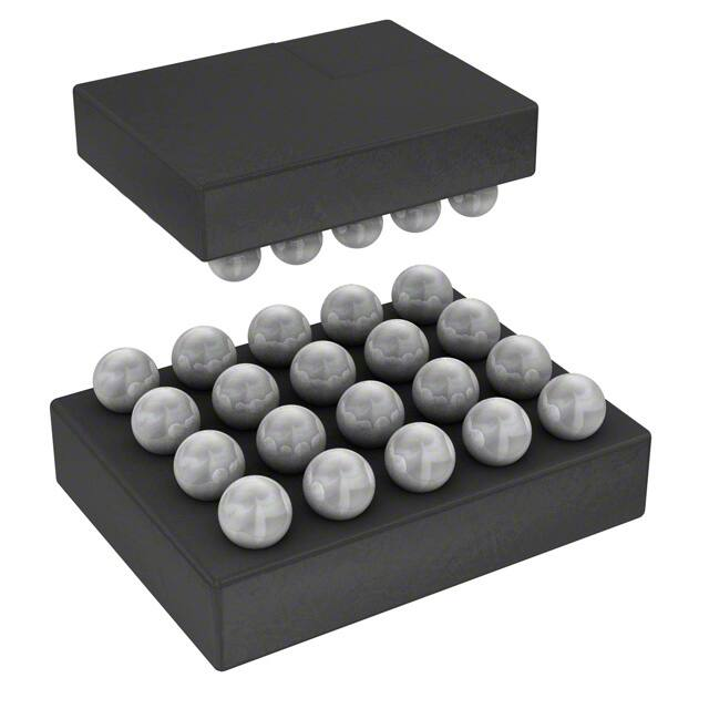

FAN53555 5 A, 2.4 MHz, Digitally Programmable TinyBuck® Regulator Description www.onsemi.com The FAN53555 is a step−down switching voltage regulator that delivers a digitally programmable output from an input voltage supply of 2.5 V to 5.5 V. The output voltage is programmed through an I2C interface capable of operating up to 3.4 MHz. Using a proprietary architecture with synchronous rectification, the FAN53555 is capable of delivering 5 A continuous at over 80% efficiency, while maintaining over 80% efficiency at load currents as low as 10 mA. Pulse currents as high as 6.5 A can be supported by the 05 option. The regulator operates at a nominal fixed frequency of 2.4 MHz, which reduces the value of the external components to 330 nH for the output induction and as low as 20 mF for the output capacitor. Additional output capacitance can be added to improve regulation during load transients without affecting stability. Inductance up to 1.2 mH may be used with additional output capacitance. At moderate and light loads, Pulse Frequency Modulation (PFM) is used to operate in Power−Save Mode with a typical quiescent current of 60 mA. Even with such a low quiescent current, the part exhibits excellent transient response during large load swings. At higher loads, the system automatically switches to fixed−frequency control, operating at 2.4 MHz. In Shutdown Mode, the supply current drops below 1 mA, reducing power consumption. PFM Mode can be disabled if constant frequency is desired. The FAN53555 is available in a 20−bump, 1.6 × 2 mm, WLCSP. • Pulse Current Capability: 6.5 A (05 Option) • 2.5 V to 5.5 V Input Voltage Range • Digitally Programmable Output Voltage: 00/01/03/05/08/18 Options: 0.6−1.23 V in 10 mV Steps ♦ 04/042/09/ Options: 0.603−1.411 V in 12.826 mV Steps ♦ 23, 79 Option: 0.60−1.3875 V in 12.5 mV Steps ♦ 24 Option: 0.603−1.420 V in 12.967 mV Steps ♦ 13 Option: 0.8−1.43 V in 10 mV Steps Programmable Slew Rate for Voltage Transitions I2C−Compatible Interface Up to 3.4 Mbps PFM Mode for High Efficiency in Light Load Quiescent Current in PFM Mode: 60 mA (Typical) Internal Soft−Start Input Under−Voltage Lockout (UVLO) Thermal Shutdown and Overload Protection 20−Bump Wafer−Level Chip Scale Package (WLCSP) ♦ • • • • • • • • Applications • Application, Graphic, and DSP Processors • • • • Features • Fixed−Frequency Operation: 2.4 MHz • Best−in−Class Load Transient • Continuous Output Current Capability: 5 A Arm®, Krait, OMAPt, NovaThort, ARMADA Hard Disk Drives Tablets, Netbooks, Ultra−Mobile PCs Smart Phones Gaming Devices PVIN C IN1 EN VOUT SDA SCL VSEL C IN FAN53555 SW L1 C OUT GND AGND VDD Core Processor (System Load) GND Figure 1. Typical Application © Semiconductor Components Industries, LLC, 2010 June, 2018 − Rev. 4 1 Publication Order Number: FAN53555/D FAN53555 Table 1. ORDERING INFORMATION Power−Up Defaults A1 PIN Function Max. R5C MS Current Max. Pulse Current (50 ms) Programmable Output Voltage VSEL 5A N/A 0.6−1.23 V in 10mV Registers not reset Part Number VSEL0 VSEL1 I2C Slave Address FAN53555UC00X 1.05 1.20 C0 FAN53555UC01X 0.90 OFF VSEL 5A N/A FAN53555UC03X 0.90 N/A PGOOD 5A N/A FAN53555UC04X 1.10 1.20 VSEL 5A N/A 0.603−1.411 V in 12.826mV Registers reset FAN53555UC05X 0.90 OFF VSEL 5A 6.5 A 0.6−1.23 V in 10mV FAN53555BUC05X (Note 1) 0.90 OFF VSEL 5A 6.5 A Registers not reset FAN53555UC08X 1.02 1.15 VSEL 4A N/A FAN53555BUC08X (Note 1) 1.02 1.15 VSEL 4A N/A FAN53555BUC09X (Note 1) 1.10 1.10 VSEL 3A N/A FAN53555UC09X 1.10 1.10 VSEL 3A N/A FAN53555UC13X 1.15 1.15 VSEL 5A N/A FAN53555BUC13X (Note 1) 1.15 1.15 VSEL 5A N/A FAN53555UC18X 1.02 1.15 VSEL 5A N/A FAN53555BUC18X (Note 1) 1.02 1.15 VSEL 5A N/A FAN5355BUC79X 0.85 N/A PGOOD 5A N/A FAN53555BUC23X (Note 1) 1.15 1.15 VSEL 5A N/A 0.6−1.3875 V in 12.5mV Registers not reset FAN53555UC24X 1.225 1.212 VSEL 4A N/A FAN53555BUC24X (Note 1) 1.225 1.212 VSEL 4A N/A 0.603−1.42 V in 12.967mV Registers reset FAN53555UC042X (Note 2) 1.10 1.20 VSEL 5A N/A C4 EN Pin Low 0.603−1.411 V in 12.826mV 0.8−1.43 V in 10mV 0.6−1.23 V in 10mV Registers reset 0.603−1.411 V in 12.826mV 1. The FAN53555BUC05X, FAN53555BUC08X, FAN53555BUC09X, FAN53555BUC13X, FAN53555BUC18X, FAN53555BUC23X, and FAN53555BUC24X, include backside lamination. 2. The 042 option is the same as the 04 option, except the I2C slave addresses. 3. Temperature Range −40 to 85 °C, Package WLCSP−20, Packing Method Tape & Reel www.onsemi.com 2 FAN53555 RECOMMENDED EXTERNAL COMPONENTS Table 2. RECOMMENDED EXTERNAL COMPONENTS FOR 5 A MAXIMUM LOAD CURRENT Component Description Vendor L1 330 nH Nominal See Table 3 Parameter Typ. L 0.33 mH DCR 13 mW mF COUT 2 Pieces; 22 mF, 6.3 V, X5R, 0805 GRM21BR60J226M (Murata) C2012X5R0J226M (TDK) C 44 CIN 1 Piece; 10 mF, 10 V, X5R, 0805 LMK212BJ106KG−T (Taiyo Yuden) C2012X5R1A106M (TDK) C 10 2 Pieces; 10 mF, 6.3 V, X5R, 0805 GRM21BR60J106M (Murata) C2012X5R0J106M (TDK) C 20 10 nF, 25 V, X7R, 0402 GRM155R71E103K (Murata) C1005X7R1E103K (TDK) C 10 CIN1 Unit nF Table 3. RECOMMENDED INDUCTORS FOR HIGH−CURRENT APPLICATIONS Manufacturer Part# L (nH) DCR (mW) IMAXDC (Note 4) Vishay IHLP1616ABERR47M01 470 20.0 Mag. Layers (Note 5) MMD−04ABNR33M−M1−RU 330 Mag. Layers MMD−04ABNR47M−M1−RU 470 Inter−Technical SM1608−R33M Bournes Component Dimensions L W H 5.0 4.5 4.1 1.2 12.5 7.5 4.5 4.1 1.2 20.0 5.0 4.5 4.1 1.2 330 9.6 9.0 4.5 4.1 2.0 SRP4012−R33M 330 15.0 6.7 4.7 4.2 1.2 Bournes SRP4012−R47M 470 20.0 5.0 4.7 4.2 1.2 TDK VLC5020T−R47M 470 15.0 5.4 5.0 5.0 2.0 4. IMAXDC is the lesser current to produce 40°C temperature rise or 30% inductance roll−off. 5. Preferred inductor value is 330 nH and all dynamic characterization was performed with this coil. FAN53555−24, −08, and −09 REDUCED OUTPUT CURRENT (4 A Max. RMS. for 08, and 24, 3 A Max. RMS for 09) SMALLER FOOTPRINT APPLICATION assume that additional bypass capacitance exists across the battery in fairly close proximity to the regulator(s). The CIN capacitors specified below are the capacitors that are required in very close proximity to VIN and PGND (see layout recommendations in Figure 2 below). The FAN53555−24, −08, and −09 were developed to provide power for core processors with high−performance graphics acceleration in Li−Ion−powered handheld devices. These applications require a very compact solution. The smaller input and output capacitors in the table below Table 4. RECOMMENDED EXTERNAL COMPONENTS FOR LOWER−CURRENT APPLICATIONS WITH FAN53555−08−09−24 Component Description L1 470 or 330 nH, 2016 case size COUT −08, ,24 Option 2 Pieces 22 mF, 6.3 V, X5R, 0603 Vendor Parameter Typ Unit C 44 mF See Table 5 C1608X5R0J226M (TDK) −09 Option 1 Piece 22 mF, 6.3 V, X5R, 0603 22 CIN 1 Piece; 10 mF, 10 V, X5R, 0402 GRM155R61A106M (Murata) C 10 CIN1 10 nF, 25 V, X5R, 0201 TMK063CG100DT−F (Taiyo Yuden) C 10 www.onsemi.com 3 nF FAN53555 Table 5. RECOMMENDED INDUCTORS FOR LOWER−CURRENT APPLICATIONS WITH FAN53555−08−09−24 Manufacturer Part# L (nH) DCR (mW Typ.) IMAXDC (Note 6) Toko DFE201612R-H−R33N 330 25 Toko DFE201612C−R47N 470 40 Cyntek PIFE20161B−R47MS−39 470 SEMCO CIGT201610HMR47SCE 470 Component Dimensions L W H 3.2 2.0 1.6 1.2 3.2 2.0 1.6 1.2 30 3.1 2.0 1.6 1.2 30 3.1 2.0 1.6 0.9 6. IMAXDC is the lesser current to produce 40°C temperature rise or 30% inductance roll−off. LAYOUT Figure 2. Reduced−Footprint Layout PIN CONFIGURATION VSEL* EN SCL VOUT A1 A2 A3 A4 B2 B3 B4 C2 C3 C4 D1 D2 D3 D4 E1 E2 E3 E4 SDA AGND B1 GND C1 VIN SW A4 A3 A2 A1 B4 B3 B2 B1 C4 C3 C2 C1 D4 D3 D2 D1 E4 E3 E2 E1 A1 = VSEL for 00, 01, 04, 05, 08, 09, 13, 18, 23, 24 A1 = PGOOD for 03,79 Figure 3. Top View Figure 4. Bottom View Table 6. PIN DEFINITIONS Pin # Name A1 VSEL (Except −03 Option) PGOOD (03) Description Voltage Select. When this pin is LOW, VOUT is set by the VSEL0 register. When this pin is HIGH, VOUT is set by the VSEL1 register. Power Good. This open−drain pin pulls LOW if an overload condition occurs or soft−start is in progress. A2 EN Enable. The device is in Shutdown Mode when this pin is LOW. All register values are kept during shutdown. Options 00, 01, 03, 05, 08 09, 13, 18, and 23 do not reset register values when EN is raised. The 04, 24, 79, and 042 options reset all registers to default values when EN pin is LOW. If pulled up to a low−impedance voltage source greater than 1.8 V, use at least 100 W series resistor. A3 SCL I2C Serial Clock A4 VOUT B1 SDA I2C Serial Data B2, B3, C1 – C4 GND Ground. Low−side MOSFET is referenced to this pin. CIN and COUT should be returned with a minimal path to these pins. B4 AGND Analog Ground. All signals are referenced to this pin. Avoid routing high dV/dt AC currents through this pin. VOUT. Sense pin for VOUT. Connect to COUT. www.onsemi.com 4 FAN53555 Table 6. PIN DEFINITIONS (continued) Pin # Name Description D1, D2, E1, E2 VIN Power Input Voltage. Connect to the input power source. Connect to CIN with minimal path. D3, D4, E3, E4 SW Switching Node. Connect to the inductor. Table 7. ABSOLUTE MAXIMUM RATINGS Symbol VIN Parameter Voltage on SW, VIN Pins Voltage on EN Pin Min Max Unit IC Not Switching −0.3 7.0 V IC Switching −0.3 6.5 Tied without Series Resistance −0.3 2.0 Tied through Series Resistance of at Least 100 W −0.3 VIN (Note 7) IC Not Switching −0.3 VIN (Note 7) V −0.3 3.0 V 100 V/ms Voltage on All Other Pins VOUT Voltage on VOUT Pin VINOV_SLEW Maximum Slew Rate of VIN > 6.5 V, PWM Switching ESD Electrostatic Discharge Protection Level Human Body Model per JESD22−A114 2000 Charged Device Model per JESD22−C101 1500 V V TJ Junction Temperature −40 +150 °C TSTG Storage Temperature −65 +150 °C TL Lead Soldering Temperature, 10 Seconds +260 °C Stresses exceeding those listed in the Maximum Ratings table may damage the device. If any of these limits are exceeded, device functionality should not be assumed, damage may occur and reliability may be affected. 7. Lesser of 7 V or VIN + 0.3 V. Table 8. RECOMMENDED OPERATING CONDITIONS The Recommended Operating Conditions table defines the conditions for actual device operation. Recommended operating conditions are specified to ensure optimal performance to the datasheet specifications. ON Semiconductor does not recommend exceeding them or designing to Absolute Maximum Ratings. Symbol Parameter VIN Supply Voltage Range IOUT Output Current L CIN COUT Min Max Unit 2.5 5.5 V 0 5 A Inductor Typ 0.33 mH Input Capacitor 10 mF Output Capacitor 44 mF TA Operating Ambient Temperature −40 +85 °C TJ Operating Junction Temperature −40 +125 °C Table 9. THERMAL PROPERTIES Symbol θJA Parameter Min Junction−to−Ambient Thermal Resistance (Note 8) Typ 38 8. See Thermal Considerations in the Application Information section. www.onsemi.com 5 Max Unit °C/W FAN53555 Table 10. ELECTRICAL CHARACTERISTICS Minimum and maximum values are at VIN = 2.5 V to 5.5 V, TA = −40°C to +85°C, unless otherwise noted. Typical values are at TA = 25°C, VIN = 5 V, and EN = HIGH. Parameter Typ Max Unit ILOAD = 0 60 100 mA ILOAD = 0, MODE Bit = 1 (Forced PWM) 43 H/W Shutdown Supply Current EN = GND 0.1 Symbol Condition Min POWER SUPPLIES IQ ISD Quiescent Current S/W Shutdown Supply Current EN = VIN, BUCK_ENx = 0 VUVLO Under−Voltage Lockout Threshold VIN Rising VUVHYST Under−Voltage Lockout Hysteresis mA 5.0 mA 41 75 mA 2.35 2.45 V 350 mV EN, VSEL, SDA, SCL VIH High−Level Input Voltage VIL Low−Level Input Voltage VLHYST IIN 1.1 0.4 Logic Input Hysteresis Voltage Input Bias Current V 160 Input Tied to GND or VIN 0.01 V mV 1.00 mA 1 mA 1.00 mA PGOOD (03, 79 OPTION) IOUTL PGOOD Pull−Down Current IOUTH PGOOD HIGH Leakage Current 0.01 VOUT REGULATION VREG DVOUT DILOAD VOUT DC Accuracy IOUT(DC) = 0, Forced PWM, VOUT = VSEL0 Default Value −1.5 1.5 % 08, 24 Options 2.5 V ≤ VIN ≤ 4.5 V, VOUT from Minimum to Maximum, IOUT(DC) = 0 to 4 A, Auto PFM/PWM −2.0 4.0 % 09 Option 2.5 V ≤ VIN ≤ 4.5 V, VOUT from Minimum to Maximum, IOUT(DC) = 0 to 3 A, Auto PFM/PWM −2.0 4.0 % 13, 18, 23 Options 2.5 V ≤ VIN ≤ 4.5 V, VOUT from Minimum to Maximum, IOUT(DC) = 0 to 5 A, Auto PFM/PWM −2.0 4.0 % All Other Options 2.5 V ≤ VIN ≤ 5.5 V, VOUT from Minimum to Maximum, IOUT(DC) = 0 to 5 A, Auto PFM/PWM −3.0 5.0 % Load Regulation IOUT(DC) = 1 to 5 A −0.1 %/A Line Regulation 2.5 V ≤ VIN ≤ 5.5 V, IOUT(DC) = 1.5 A 0.01 %/V Transient Response ILOAD Step 0.1 A to 1.5 A, tr = tf = 100 ns, VOUT = 1.2 V ±40 mV DVOUT DVIN VTRSP POWER SWITCH AND PROTECTION RDS(on)P P−Channel MOSFET On Resistance VIN = 5 V 28 mW RDS(on)N N−Channel MOSFET On Resistance VIN = 5 V 17 mW www.onsemi.com 6 FAN53555 Table 10. ELECTRICAL CHARACTERISTICS (continued) Minimum and maximum values are at VIN = 2.5 V to 5.5 V, TA = −40°C to +85°C, unless otherwise noted. Typical values are at TA = 25°C, VIN = 5 V, and EN = HIGH. Symbol Parameter Condition Min Typ Max Unit 00, 01, 03, 04, 13, 18, 23, 042, 79 Options 6.3 7.4 8.5 A 05 Option 8.5 10.0 11.5 A 08, 24 Options 5.0 5.9 6.8 A 09 Option 4.0 4.75 5.5 POWER SWITCH AND PROTECTION ILIMPK P−MOS Peak Current Limit TLIMIT Thermal Shutdown 150 °C THYST Thermal Shutdown Hysteresis 17 °C VSDWN Input OVP Shutdown 6.15 V 5.50 5.85 V 2.05 2.40 Rising Threshold Falling Threshold FREQUENCY CONTROL fSW Oscillator Frequency 2.75 MHz DAC Resolution 6 Differential Nonlinearity (Note 9) Bits 0.5 LSB TIMING I2CEN EN = HIGH to I2C Start 100 ms SOFT−START tSS ROFF Regulator Enable to Regulated VOUT VOUT Pull−Down Resistance, Disabled RLOAD > 5 W; to VOUT = 1.2 V; 00, 01, 03, 04, 042, 05, 09, 13, 23 and 79 Options 300 2.5 V ≤ VIN ≤ 4.5 V; RLOAD = 2 W; to VOUT = 1.127 V with 1.1 V Pre−Bias Voltage; 08 and 18 Options 135 EN = 0 or VIN < VUVLO 160 mS 175 mS W Product parametric performance is indicated in the Electrical Characteristics for the listed test conditions, unless otherwise noted. Product performance may not be indicated by the Electrical Characteristics if operated under different conditions. 9. Monotonicity assured by design. Table 11. I2C TIMING SPECIFICATIONS Guaranteed by design. Symbol fSCL tBUF tHD;STA Parameter SCL Clock Frequency Bus−Free Time between STOP and START Conditions START or REPEATED START Hold Time Condition Min. Typ. Max. Unit Standard Mode 100 kHz Fast Mode 400 Fast Mode Plus 1000 High−Speed Mode, CB ≤100 pF 3400 High−Speed Mode, CB ≤ 400 pF 1700 Standard Mode 4.7 Fast Mode 1.3 Fast Mode Plus 0.5 Standard Mode 4 ms Fast Mode 600 ns Fast Mode Plus 260 ns High−Speed Mode 160 ns www.onsemi.com 7 ms FAN53555 Table 11. I2C TIMING SPECIFICATIONS (continued) Guaranteed by design. Symbol tLOW tHIGH tSU;STA tSU;DAT tHD;DAT tRCL Parameter SCL LOW Period SCL HIGH Period Repeated START Setup Time Data Setup Time Data Hold Time SCL Rise Time Condition Max. Unit 4.7 ms Fast Mode 1.3 ms Fast Mode Plus 0.5 ms High−Speed Mode, CB ≤ 100 pF 160.0 ns High−Speed Mode, CB ≤ 400 pF 320.0 ns 4 ms Fast Mode 600 ns Fast Mode Plus 260 ns High−Speed Mode, CB ≤ 100 pF 60 ns High−Speed Mode, CB ≤ 400 pF 120 ns Standard Mode 4.7 ms Fast Mode 600.0 ns Fast Mode Plus 260.0 ns High−Speed Mode 160.0 ns Standard Mode 250 ns Fast Mode 100 Fast Mode Plus 50 High−Speed Mode 10 Standard Mode Standard Mode 0 3.45 ms Fast Mode 0 900.00 ns Fast Mode Plus 0 450.00 ns High−Speed Mode, CB ≤ 100 pF 0 70.00 ns High−Speed Mode, CB ≤ 400 pF 0 150.00 ns ns Standard Mode 20+0.1CB 1000 Fast Mode 20+0.1CB 300 Fast Mode Plus 20+0.1CB 120 High−Speed Mode, CB ≤ 400 pF SCL Fall Time Typ. Standard Mode High−Speed Mode, CB ≤ 100 pF tFCL Min. 10 80 20 160 Standard Mode 20+0.1CB 300 Fast Mode 20+0.1CB 300 Fast Mode Plus 20+0.1CB 120 High−Speed Mode, CB ≤ 100 pF 10 40 High−Speed Mode, CB ≤ 400 pF 20 80 10 80 tRCL1 Rise Time of SCL After a REPEATED START Condition and After ACK Bit High−Speed Mode, CB ≤ 100 pF tRDA SDA Rise Time Standard Mode 20+0.1CB 1000 Fast Mode 20+0.1CB 300 Fast Mode Plus 20+0.1CB 120 High−Speed Mode, CB ≤ 400 pF 20 10 80 High−Speed Mode, CB ≤ 400 pF 20 160 8 ns 160 High−Speed Mode, CB ≤ 100 pF www.onsemi.com ns ns FAN53555 Table 11. I2C TIMING SPECIFICATIONS (continued) Guaranteed by design. Symbol Parameter tFDA Condition SDA Fall Time tSU;STO Stop Condition Setup Time CB Min. Typ. Max. Unit ns Standard Mode 20+0.1CB 300 Fast Mode 20+0.1CB 300 Fast Mode Plus 20+0.1CB 120 High−Speed Mode, CB ≤ 100 pF 10 80 High−Speed Mode, CB ≤ 400 pF 20 160 Standard Mode 4 ms Fast Mode 600 ns Fast Mode Plus 120 ns High−Speed Mode 160 ns Capacitive Load for SDA and SCL 400 pF TIMING DIAGRAMS ÒÒÒ ÒÒÒ ÒÒÒ ÒÒÒ ÒÒÒ ÒÒÒ ÒÒÒ ÕÕÕ ÔÔ ÔÔ ÔÔ ÔÔ ÔÔ ÔÔ ÖÖÖÖ ÖÖÖÖ tF SDA SCL tSU;STA tR TSU;DAT tHIGH tLOW tHD;STA tHD;DAT tBUF tHD;STO tHD;STA REPEATED START START ÓÓÌÌ ÓÓ ÌÌ ÓÓÌÌ ÓÓ ÌÌ ÓÓ ÌÌ ÓÓ ÓÓÌÌ ÌÌ ŠŠ ÑÑ STOP Figure 5. I2C Interface Timing for Fast Plus, Fast, and Slow Modes ÜÜ ÜÜ ÜÜ ÜÜ ÜÜ ÜÜ ÜÜ ÙÙÙ ÙÙÙ tFDA SDAH tSU;STA SCLH tRDA tRCL1 REPEATED START tFCL tRCL tSU;STO tHIGH tLOW tHD;STA REPEATED START ÛÛÛÛŽŽŸŸŸ ÛÛÛÛŽŽ ŸŸŸ ÚÚ ÚÚ ÚÚ ÚÚ ÚÚ tSU;DAT tHD;DAT note A = MCS Current Source Pull−up = RP Resistor Pull−up Note A: First rising edge of SCLH after Repeated Start and after each ACK bit. Figure 6. I2C Interface Timing for High−Speed Mode www.onsemi.com 9 STOP START FAN53555 TYPICAL CHARACTERISTICS Unless otherwise specified, Auto PFM/PWM, VIN = 3.6 V, VOUT = 1.2 V, SCL = SDA = VSEL = EN = 1.8 V, TA = 25°C; circuit and components according to Figure 1 and Table 1. 92% 92% 2.7 VIN 3.6 VIN 5.0 VIN 90% 90% 88% EFFICENCY EFFICENCY 88% 86% 84% 82% 86% 84% 82% 80% 80% 78% 78% 76% 0 1000 2000 3000 LOAD CURRENT (mA) 4000 5000 76% −40°C +25°C +85°C 0 90% 90% 88% 88% 86% 86% 84% 84% 82% 82% 80% 78% 76% 74% 70% 0 1000 4000 76% −40°C +25°C +85°C 5000 70% 0 Figure 9. Efficiency vs. Load Current and Input Voltage, VOUT = 0.9 V 90% 75% 70% 2000 3000 LOAD CURRENT (mA) 4000 5000 90% 85% EFFICENCY EFFICENCY 80% 1000 Figure 10. Efficiency vs. Load Current and Temperature, VIN = 5 V, VOUT = 1.2 V 2.7 VIN 3.6 VIN 5.0 VIN 85% 5000 78% 72% 2000 3000 LOAD CURRENT (mA) 4000 80% 74% 2.7 VIN 3.6 VIN 5.0 VIN 72% 2000 3000 LOAD CURRENT (mA) Figure 8. Efficiency vs. Load Current and Temperature EFFICENCY EFFICENCY Figure 7. Efficiency vs. Load Current and Input Voltage 1000 80% 75% 70% 3.6VIN, 1.2VOUT, L=MMD−04ABNR33M 65% 65% 60% 60% 3.6VIN, 1.2VOUT, L=VLC5020T−R47M 5.0VIN, 1.2VOUT, L=MMD−04ABNR33M 5.0VIN, 1.2VOUT, L=VLC5020T−R47M 5.0VIN, 0.9VOUT, L=MMD−04ABNR33M 0 1000 2000 3000 LOAD CURRENT (mA) 4000 5000 5.0VIN, 0.9VOUT, L=VLC5020T−R47M 0 1000 2000 3000 4000 5000 6000 7000 LOAD CURRENT (mA) Figure 11. Efficiency vs. Load Current and Input Voltage, VOUT = 0.6 V Figure 12. Efficiency vs. Load Current, VIN = 3.6 V and 5 V, VOUT = 1.2 V and 0.9 V www.onsemi.com 10 FAN53555 TYPICAL CHARACTERISTICS (continued) Unless otherwise specified, Auto PFM/PWM, VIN = 3.6 V, VOUT = 1.2 V, SCL = SDA = VSEL = EN = 1.8 V, TA = 25°C; circuit and components according to Figure 1 and Table 1. 25 20 VOUT SHIFT (mV) 20 2.7 VIN 3.6 VIN 5.0 VIN 16 15 12 10 8 5 4 0 0 1000 2000 3000 LOAD CURRENT (mA) 4000 2.7 VIN 3.6 VIN 5.0 VIN 0 5000 0 1000 1,000 PFM Exit PFM Enter 800 LOAD CURRENT (mA) LAOD CURRENT (mA) 5000 1,000 PFM Exit PFM Enter 600 400 3.0 3.5 4.0 4.5 INPUT VOLTAGE (V) 5.0 800 600 400 200 5.5 2.5 Figure 15. PFM Entry / Exit Level vs. Input Voltage, VOUT = 1.2 V 3.0 3.5 4.0 4.5 INPUT VOLTAGE (V) 5.0 5.5 Figure 16. PFM Entry / Exit Level vs. Input Voltage, VOUT = 0.9 V 25 3.6VIN, 1.2VOUT, PWM 5.0VIN, 1.2VOUT, Auto 20 5.0VIN, 1.2VOUT, PWM 5.0VIN, 0.9VOUT, Auto 15 10 5 SWITCHING FREQUENCY (kHz) 3,000 3.6VIN, 1.2VOUT, Auto OUTPUT RIPPLE (mVpp) 4000 Figure 14. Output Regulation vs. Load Current and Input Voltage, VOUT=0.9 V Figure 13. Output Regulation vs. Load Current and Input Voltage, VOUT = 1.2 V 200 2.5 2000 3000 LOAD CURRENT (mA) 2,500 2,000 1,500 1,000 3.6VIN, 1.2VOUT, Auto 500 3.6VIN, 0.9VOUT, Auto 5.0VIN, 1.2VOUT, Auto 5.0VIN, 0.9VOUT, Auto 0 0 1000 2000 3000 4000 5000 0 0 LOAD CURRENT (mA) 1000 2000 3000 LOAD CURRENT (mA) Figure 17. Output Ripple vs. Load Current, VIN = 5 V and 3.6 V, VOUT = 1.2 V and 0.9 V, Auto and FPWM 4000 Figure 18. Frequency vs. Load Current, VIN = 5 V and 3.6 V, VOUT = 1.2 V and 0.9 V, Auto PWM www.onsemi.com 11 5000 FAN53555 80 60 70 50 INPUT CURRENT (mA) INPUT SUPPLY CURRENT (mA) TYPICAL CHARACTERISTICS (Continued) Unless otherwise specified, Auto PFM/PWM, VIN = 3.6 V, VOUT = 1.2 V, SCL = SDA = VSEL = EN = 1.8 V, TA = 25°C; circuit and components according to Figure 1 and Table 1. 60 50 40 −40°C +25°C +85°C 30 20 2.5 3.0 3.5 4.0 4.5 5.0 40 30 20 −40°C +25°C +85°C 10 0 2.5 5.5 3.0 3.5 INPUT SUPPLY VOLTAGE (V) 4.0 4.5 5.0 5.5 INPUT VOLTAGE (V) Figure 19. Quiescent Current vs. Input Voltage and Temperature, Auto PWM Figure 20. Quiescent Current vs. Input Voltage and Temperature, FPWM 70 60 EN_BUCK=0, −40C EN_BUCK=0, +25C EN_BUCK=0, +85C EN=0, +25C 60 40 PSSR (dB) INPUT CURRENT (mA) 50 30 20 50 40 30 10 3.6VIN, 1.2VOUT, 2A Load 3.6VIN, 0.9VOUT, 2A Load 5.0VIN, 0.9VOUT, 18mA Load, PFM 0 2.5 3.0 3.5 4.0 4.5 INPUT VOLTAGE (V) 5.0 20 5.5 10 100 1,000 10,000 100k FREQUENCY (Hz) Figure 21. Shutdown Current vs. Input Voltage and Temperature Figure 22. PSRR vs. Frequency Figure 23. Line Transient, 3−4 VIN, 1.2 VOUT, 10 ms Edge, 50 W Load Figure 24. Line Transient, 3−4 VIN, 1.2 VOUT, 10 ms Edge, 1 A Load www.onsemi.com 12 FAN53555 TYPICAL CHARACTERISTICS (Continued) Unless otherwise specified, Auto PFM/PWM, VIN = 3.6 V, VOUT = 1.2 V, SCL = SDA = VSEL = EN = 1.8 V, TA = 25°C; circuit and components according to Figure 1 and Table 1. Figure 25. Load Transient, 5 VIN, 0.9 VOUT, 0.3−3 A, 100 ns Edge Figure 26. Load Transient, 3.6 VIN, 1.2 VOUT, 0.3−3 A, 100 ns Edge Figure 27. Load Transient, 3.6 VIN, 1.2 VOUT, 0.3−3 A, 100 ns Edge, COUT = 4x22 mF Figure 28. Load Transient, 3.6 VIN, 1.2 VOUT, 1.5−6 A, 100 ns Edge, COUT = 4x22 mF Figure 29. Input Over−Voltage Protection www.onsemi.com 13 FAN53555 TYPICAL CHARACTERISTICS (Continued) Unless otherwise specified, Auto PFM/PWM, VIN = 3.6 V, VOUT = 1.2 V, SCL = SDA = VSEL = EN = 1.8 V, TA = 25°C; circuit and components according to Figure 1 and Table 1. Figure 30. Startup / Shutdown, No Load, VOUT = 0.9 V Figure 31. Startup / Shutdown, 180 mW Load, VOUT = 0.9 V Figure 32. Overload Protection and Recovery Figure 33. Startup into Faulted Load, VOUT = 0.9 V OPERATION DESCRIPTION • Reprogram the mode to enable or disable PFM; • Control voltage transition slew rate; or • Enable / disable the regulator. The FAN53555 is a step−down switching voltage regulator that delivers a programmable output voltage from an input voltage supply of 2.5 V to 5.5 V. Using a proprietary architecture with synchronous rectification, the FAN53555 is capable of delivering 5 A at over 80% efficiency. Pulse currents as high as 6.5 A can be supported by the 05 option. The regulator operates at a nominal frequency of 2.4 MHz at full load, which reduces the value of the external components to 330 nH for the output inductor and 22 mF for the output capacitor. High efficiency is maintained at light load with single−pulse PFM. The FAN53555 integrates an I2C−compatible interface, allowing transfers up to 3.4 Mbps. This communication interface can be used to: • Dynamically re−program the output voltage in 10 mV, 12.826 mV increments (option 04, 09, and 042), 12.5 mV increments (option 23), or 12.967 mV increments (option 24); Control Scheme The FAN53555 uses a proprietary non−linear, fixed−frequency PWM modulator to deliver a fast load transient response, while maintaining a constant switching frequency over a wide range of operating conditions. The regulator performance is independent of the output capacitor ESR, allowing for the use of ceramic output capacitors. Although this type of operation normally results in a switching frequency that varies with input voltage and load current, an internal frequency loop holds the switching frequency constant over a large range of input voltages and load currents. For very light loads, the FAN53555 operates in Discontinuous Current Diode (DCM) single−pulse PFM, www.onsemi.com 14 FAN53555 In the 01 and 05 options, BUCK_EN0 and BUCK_EN1 are initialized to 10. Using these options, VSEL must be LOW after a POR if the IC is powering the processor used to communicate through I2C. The 03 option has the VSEL input to the modulator logic internally tied LOW. which produces low output ripple compared with other PFM architectures. Transition between PWM and PFM is relatively seamless, providing a smooth transition between DCM and CCM Modes. PFM can be disabled by programming the MODE bit HIGH in the VSEL registers. Table 12. HARDWARE AND SOFTWARE ENABLE Enable and Soft−Start When the EN pin is LOW; the IC is shut down, all internal circuits are off, and the part draws very little current. In this state, I2C cannot be written to or read from. For all options except the 04, 24, and 042 options, all register values are kept while EN pin is LOW. For the 04, 24 042 and 79 options; registers are reset to default values when EN pin is LOW. For all options, registers are reset to default values during a Power On Reset (POR). When the OUTPUT_DISCHARGE bit in the CONTROL register is enabled (logic HIGH) and the EN pin is LOW or the BUCK_ENx bit is LOW, a load is connected from VOUT to GND to discharge the output capacitors. Raising EN while the BUCK_ENx bit is HIGH activates the part and begins the soft−start cycle. During soft−start, the modulator’s internal reference is ramped slowly to minimize surge currents on the input and prevent overshoot of the output voltage. Synchronous rectification is inhibited during soft−start, allowing the IC to start into a pre−charged capacitive load. If large output capacitance values are used, the regulator may fail to start. Maximum COUT capacitance for successfully starting with a heavy constant−current load is approximately: C OUTMAX + ǒI LIMPK * I LOADǓ @ 320m V OUT Pins BITS EN VSEL BUCK_EN0 BUCK_EN1 Output 0 X X X OFF 1 0 0 X OFF 1 0 1 X ON 1 1 X 0 OFF 1 1 X 1 ON VSEL Pin and I2C Programming Output Voltage The output voltage is set by the NSELx control bits in VSEL0 and VSEL1 registers. The output voltage for options 00, 01, 03, 05, 08, 18 and 79 is given as: V OUT + 0.60 V ) NSELx @ 10 mV (eq. 2) For example, when NSEL = 011111 (31 decimal), then VOUT = 0.60 + 0.310 = 0.91 V. For the 04, 042, and 09 options; the output voltage is given as: V OUT + 0.603 ) NSELx @ 12.826 mV (eq. 3) For the 13 option, the output voltage is given as: V OUT + 0.80 ) NSELx @ 10 mV (eq. 1) (eq. 4) For the 23 option, the output voltage is given as: V OUT + 0.60 V ) NSELx @ 12.5 mV where COUTMAX is expressed in μF and ILOAD is the load current during soft−start, expressed in A. If the regulator is at its current limit for 16 consecutive current limit cycles, the regulator shuts down and enters 3−state before reattempting soft−start 1700 ms later. This limits the duty cycle of full output current during soft−start to prevent excessive heating. The IC allows for software enable of the regulator, when EN is HIGH, through the BUCK_EN bits. BUCK_EN0 and BUCK_EN1 are both initialized HIGH in the 00, 04, 08, 09, 23, 24, 42 and 79 options. These options start after a POR regardless of the state of the VSEL pin. (eq. 5) For the 24 option, the output voltage is given as: V OUT + 0.603 V ) NSELx 12.967 mV (eq. 6) Output voltage can also be controlled by toggling the VSEL pin LOW or HIGH. VSEL LOW corresponds to VSEL0 and VSEL HIGH corresponds to VSEL1. Upon POR, VSEL0 and VSEL1 are reset to their default voltages, shown in Table 9. www.onsemi.com 15 FAN53555 Transition Slew Rate Limiting currents from causing damage. Sixteen consecutive current limit cycles in current limit cause the regulator to shut down and stay off for about 1700 μs before attempting a restart. When transitioning from a low to high voltage, the IC can be programmed for one of eight possible slew rates using the SLEW bits in the CONTROL register. Thermal Shutdown When the die temperature increases, due to a high load condition and/or high ambient temperature, the output switching is disabled until the die temperature falls sufficiently. The junction temperature at which the thermal shutdown activates is nominally 150°C with a 17°C hysteresis. Table 13. TRANSITION SLEW RATE Decimal Bin Slew Rate 0 000 64.00 mV / ms 1 001 32.00 mV / ms 2 010 16.00 mV / ms 3 011 8.00 mV / ms 4 100 4.00 mV / ms 5 101 2.00 mV / ms 6 110 1.00 mV / ms 7 111 0.50 mV / ms Monitor Register (Reg05) The Monitor register indicates of the regulation state of the IC. If the IC is enabled and is regulating, its value is (1000 0000). I2C Interface The FAN53555’s serial interface is compatible with Standard, Fast, Fast Plus, and HS Mode I2C−Bus specifications. The FAN53555’s SCL line is an input and its SDA line is a bi−directional open−drain output; it can only pull down the bus when active. The SDA line only pulls LOW during data reads and when signaling ACK. All data is shifted in MSB (bit 7) first. Transitions from high to low voltage rely on the output load to discharge VOUT to the new set point. Once the high−to−low transition begins, the IC stops switching until VOUT has reached the new set point. For options 04, 042, 09, 23, and 24 where the Dynamic Voltage Scaling (DVS) step is not 10 mV; the actual slew rate is the corresponding number shown in Table 6 scaled by the ratio of the DVS step to 10 mV. For example, the slew rate of option 13 for Bin=011 is 8.00 mV / ms x 12.5 mV / 10 mV = 10.00 mV / ms. I2C Slave Address In hex notation, the slave address assumes a 0 LS Bit. The hex slave address is C0 for all options except −42, which has a hex slave address of C4. Under−Voltage Lockout Table 14. I2C SLAVE ADDRESS When EN is HIGH, the under−voltage lockout keeps the part from operating until the input supply voltage rises HIGH enough to properly operate. This ensures proper operation of the regulator during startup or shutdown. Bits Input Over−Voltage Protection (OVP) Option Hex 7 6 5 4 3 2 1 0 00 to 24, 79 C0 1 1 0 0 0 0 0 R/ W 42 C4 1 1 0 0 0 1 0 R/ W When VIN exceeds VSDWN (about 6.2 V) the IC stops switching to protect the circuitry from internal spikes above 6.5 V. An internal filter prevents the circuit from shutting down due to noise spikes. Other slave addresses can be assigned. Contact a ON Semiconductor representative. Power Good (03 & 79 Option) Bus Timing As shown in Figure 34, data is normally transferred when SCL is LOW. Data is clocked in on the rising edge of SCL. Typically, data transitions shortly at or after the falling edge of SCL to allow ample time for the data to set up before the next SCL rising edge. The PGOOD pin is an open−drain output indicating that the regulator is enabled when its state is HIGH. PGOOD pulls LOW under the following conditions: • Regulator is disabled (EN pin LOW, disabled by I2C, fault time−out, UVLO, OVP, over−temperature); • Regulator is performing a soft−start. Data change allowed PGOOD remains HIGH during I2C initiated VOUT transitions. SDA tH Current Limiting SCL A heavy load or short circuit on the output causes the current in the inductor to increase until a maximum current threshold is reached in the high−side switch. Upon reaching this point, the high−side switch turns off, preventing high tSU Figure 34. Data Transfer Timing www.onsemi.com 16 FAN53555 High−Speed (HS) Mode Each bus transaction begins and ends with SDA and SCL HIGH. A transaction begins with a START condition, which is defined as SDA transitioning from 1 to 0 with SCL HIGH, as shown in Figure 35. tHD;STA SDA The protocols for High−Speed (HS), Low−Speed (LS), and Fast−Speed (FS) Modes are identical, except the bus speed for HS mode is 3.4 MHz. HS Mode is entered when the bus master sends the HS master code 00001XXX after a START condition. The master code is sent in Fast or Fast−Plus Mode (less than 1 MHz clock); slaves do not ACK this transmission. The master generates a REPEATED START condition () that causes all slaves on the bus to switch to HS Mode. The master then sends I2C packets, as described above, using the HS Mode clock rate and timing. The bus remains in HS Mode until a STOP bit (Figure 36) is sent by the master. While in HS Mode, packets are separated by REPEATED START conditions (Figure 37). Slave Address MS Bit SCL Figure 35. START Bit A transaction ends with a STOP condition, which is defined as SDA transitioning from 0 to 1 with SCL HIGH, as shown in Figure 36. Slave Releases Master Drives Read and Write Transactions The following figures outline the sequences for data read and write. Bus control is signified by the shading of the packet, defined as Master Drives Bus and Slave Drives Buss. All addresses and data are MSB first. tHD;STO ACK(0) or NACK(1) SDA SCL Table 15. I2C BIT DEFINITIONS FOR FIGURE 38 AND FIGURE 39 Figure 36. STOP Bit Symbol During a read from the FAN53555, the master issues a REPEATED START after sending the register address, and before resending the slave address. The REPEATED START is a 1 to 0 transition on SDA while SCL is HIGH, as shown in Figure 37. Slave Releases tSU;STA SLADDR MS Bit SCL Figure 37. REPEATED START Timing 7 bits S R REPEATED START, see Figure 37 P STOP, see Figure 36 S START, see Figure 35 A ACK. The slave drives SDA to 0 to acknowledge the preceding packet. A NACK. The slave sends a 1 to NACK the preceding packet. R Repeated START, see Figure 37. P STOP, see Figure 36. tHD;STA ACK(0) or NACK(1) SDA Slave Address 0 Definition 0 8 bits 0 8 bits 0 A Reg Addr A Data A P Figure 38. Write Transaction 7 bits S Slave Address 0 0 8 bits 0 A Reg Addr A 7 bits R Slave Address Figure 39. Read Transaction www.onsemi.com 17 1 0 8 bits 1 A Data A P FAN53555 REGISTER DESCRIPTION Table 16. REGISTER MAP POR Default Hex Address Name 00 VSEL0 01 02 03 VSEL1 CONTROL ID1 04 ID2 05 MONITOR Function Controls VOUT settings when VSEL pin = 0 Controls VOUT settings when VSEL pin = 1 Option VOUT Binary Hex 00 1.050 10101101 AD 08, 18 1.020 10101010 AA 01, 03, 05 0.900 10011110 9E 04 1.100 10100111 A7 24 1.225 10110000 B0 13 1.150 10100011 A3 23 1.150 10101100 AC 09 1.100 10100111 A7 79 0.85 10011001 99 00 1.200 11111100 FC 01, 05 1.000 01101000 68 04 1.200 11101111 EF 24 1.212 10101111 AF 08, 18 1.150 10110111 B7 13 1.150 10100011 A3 23 1.150 10101100 AC 09 1.100 11100111 E7 00, 01, 03, 04, 05, 24 10000000 80 08, 09, 18 00000000 00 13, 23 10110000 B0 00, 13, 23, 24 10000000 80 01 10000001 81 03 10000011 83 04 10000100 84 05 10000101 85 08, 18 10001000 88 09 10001100 8C Read−only register identifies die revision All 0000XXXX 0X Indicates device status All X0000000 X0 Determines whether VOUT output discharge is enabled and also the slew rate of positive transitions Read−only register identifies vendor and chip type www.onsemi.com 18 FAN53555 Table 17. BIT DEFINITIONS The following table defines the operation of each register bit. Bold indicates power−on default values. Bit VSEL0 Name R/W Value Description Register Address: 00 7 BUCK_EN0 1 Software buck enable. When EN pin is LOW, the regulator is off. When EN pin is HIGH, BUCK_EN bit takes precedent. 6 MODE0 0 Allow Auto−PFM Mode during light load. 1 Forced PWM Mode. 5:0 NSEL0 00 Option 101101 Sets VOUT value from 0.6 to 1.23 V in 10 mV steps (see Eq. (2)). 08, 18 Options 101010 01, 03, 05 Options 011110 79 Option 011001 04 Option 100111 Sets VOUT value from 0.603 to 1.411 V in 12.826 mV steps (see Eq. (3)). 09 Option 100111 VSEL1 7 R/W 13 Option 100011 Sets VOUT value from 0.8 to 1.43 V in 10 mV steps (see Eq. (4)). 23 Option 101100 Sets VOUT value from 0.6 to 1.3875 V in 12.5 mV steps (see Eq. (5)). 24 Option 110000 Sets VOUT value from 0.603 to 1.42 V in 12.967 mV steps (see Eq. (6)). Register Address: 01 BUCK_EN1 00, 04, 08, 09,13, 18, 23, 24 Options 1 Software buck enable. When EN pin is LOW, the regulator is off. When EN pin is HIGH, BUCK_EN bit takes precedent. 01, 05 Options 0 6 MODE1 08, 13, 18, 23, 24 Options 0 Allow AUTO−PFM Mode during light load. 00, 01, 04, 05, 09 Options 1 Forced PWM Mode. www.onsemi.com 19 FAN53555 Table 17. BIT DEFINITIONS (continued) The following table defines the operation of each register bit. Bold indicates power−on default values. Bit Name VSEL1 R/W 5:0 Value Description Register Address: 01 NSEL1 00 Option 111100 Sets VOUT value from 0.6 to 1.23 V in 10 mV steps (see Eq. (2)). 01, 05 Options 101000 08, 18 Options 110111 04 Option 101111 Sets VOUT value from 0.603 to 1.411 V in 12.826 mV steps (see Eq. (3)). 09 Option 100111 CONTROL 7 R/W OUTPUT_DISCHARGE 6:4 SLEW 13 Option 100011 Sets VOUT value from 0.8 to 1.43 V in 10 mV steps (see Eq. (4)). 23 Option 010100 Sets VOUT value from 0.6 to 1.3875 V in 12.5 mV steps (see Eq. (5)). 24 Option 101111 Sets VOUT value from 0.603 to 1.42 V in 12.967 mV steps (see Eq. (6)). Register Address: 02 08, 09, 18, 79 Options 0 When the regulator is disabled, VOUT is not discharged. 00, 01, 03, 04, 05,13, 23, 24 Options 1 When the regulator is disabled, VOUT discharges through an internal pull−down. 000 –111 011 Sets the slew rate for positive voltage transitions (see Table 6). Default value for 13 and 23 options 3 Reserved 0 Always reads back 0 2 04, 09, 24, 79 Options RESET 0 Setting to 1 resets all registers to default values. All other options Reserved 0 Always reads back 0 Reserved 00 Always reads back 00 1:0 ID1 R Register Address: 03 7:5 VENDOR 100 4 Reserved 0 Signifies ON Semiconductor as the IC vendor Always reads back 0 www.onsemi.com 20 FAN53555 Table 17. BIT DEFINITIONS (continued) The following table defines the operation of each register bit. Bold indicates power−on default values. Bit ID1 Name R 3:0 ID2 Value Register Address: 03 DIE_ID R Description 0000 IC Type = 00 Option (FAN53555UC00X / FAN53555BUC24X) 0001 IC Type = 01 Option (FAN53555UC01X/ FAN5355BUC79X) 0011 IC Type = 03 Option (FAN53555UC03X) 0100 IC Type = 04 Option (FAN53555UC04X) 0100 IC Type = 042 Option (FAN53555UC042X) 0101 IC Type = 05 Option (FAN53555UC05X / FAN53555BUC05X) 1000 IC Type = 08, 18 Options (FAN53555UC08X / FAN53555BUC08X, FAN53555UC18X / FAN53555BUC18X) 1100 IC Type = 09 Option (FAN53555UC09X / FAN53555BUC09X) 0000 IC Type = 13 Option (FAN53555UC13X / FAN53555BUC13X) 0000 IC Type = 23 Option (FAN53555BUC23X) Register Address: 04 7:4 Reserved 0000 3:0 DIE_REV 00 Option 0011 Always reads back 0000 IC mask revision 01 Option 0011 03 Option 0011 04 Option 1111 24−Option 0100 042 Option 1111 05 Option 0011 08, 18 Options 0001 BUC08, BUC18 Options 1111 09 Option 1111 13 Option 1111 23 Option 1100 79 Option 1000 MONITOR R Register Address: 05 7 PGOOD 0 6:0 Not used 000 0000 1: buck is enabled and soft−start is completed Always reads back 000 0000 www.onsemi.com 21 FAN53555 APPLICATION INFORMATION Selecting the Inductor Output Capacitor and VOUT Ripple The output inductor must meet both the required inductance and the energy−handling capability of the application. The inductor value affects the average current limit, the output voltage ripple, and the efficiency. The ripple current (DI) of the regulator is: DI + V OUT V IN @ ǒ Ǔ V IN * V OUT L @ f sw Table 1 suggests 0805 capacitors, but 0603 capacitors may be used if space is at a premium. Due to voltage effects, the 0603 capacitors have a lower in−circuit capacitance than the 0805 package, which can degrade transient response and output ripple. Increasing COUT has negligible effect on loop stability and can be increased to reduce output voltage ripple or to improve transient response. Output voltage ripple, DVOUT, is calculated by: (eq. 7) The maximum average load current, IMAX(LOAD), is related to the peak current limit, ILIM(PK), by the ripple current such that: DI I MAX(LOAD) + I LIM(PK) * 2 ƪ DV OUT + DI L (eq. 8) ǸI OUT(DC) 2 ) DI 2 12 (eq. 9) The increased RMS current produces higher losses through the RDS(ON) of the IC MOSFETs as well as the inductor ESR. Increasing the inductor value produces lower RMS currents, but degrades transient response. For a given physical inductor size, increased inductance usually results in an inductor with lower saturation current. DVOUT (Eq.(11)) Transient Response Increase Decrease Degraded ) ƫ 1 8 @ f SW @ C OUT ESL Effects The Equivalent Series Inductance (ESL) of the output capacitor network should be kept low to minimize the square−wave component of output ripple that results from the division ratio COUT ESL and the output inductor (LOUT). The square−wave component due to the ESL can be estimated as: DVOUT(SQ) [ V IN @ Table 18. EFFECTS OF INDUCTOR VALUE (FROM 330 nH RECOMMENDED) ON REGULATOR PERFORMANCE IMAX(LOAD) 2 @ D @ ( 1 * D) 2 where COUT is the effective output capacitance. The capacitance of COUT decreases at higher output voltages, which results in higher DVOUT. Equation (10) is only valid for Continuous Current Mode (CCM) operation, which occurs when the regulator is in PWM Mode. For large COUT values, the regulator may fail to start under a load. If an inductor value greater than 1.0 mH is used, at least 30 mF of COUT should be used to ensure stability. The lowest DVOUT is obtained when the IC is in PWM Mode and, therefore, operating at 2.4 MHz. In PFM Mode, fSW is reduced, causing DVOUT to increase. The FAN53555 is optimized for operation with L = 330 nH, but is stable with inductances up to 1.0 μH (nominal). The inductor should be rated to maintain at least 80% of its value at ILIM(PK). Failure to do so lowers the amount of DC current the IC can deliver. Efficiency is affected by the inductor DCR and inductance value. Decreasing the inductor value for a given physical size typically decreases the DCR; but since DI increases, the RMS current increases, as do core and skin−effect losses. I RMS + (eq. 10) f SW @ C OUT @ ESR ESL COUT L1 (eq. 11) A good practice to minimize this ripple is to use multiple output capacitors to achieve the desired COUT value. For example, to obtain COUT = 20 mF, a single 22 mF 0805 would produce twice the square wave ripple as two x 10 mF 0805. To minimize ESL, try to use capacitors with the lowest ratio of length to width. 0805s have lower ESL than 1206s. If low output ripple is a chief concern, some vendors produce 0508 or 0612 capacitors with ultra−low ESL. Placing additional small−value capacitors near the load also reduces the high−frequency ripple components. Inductor Current Rating The current limit circuit can allow substantial peak currents to flow through L1 under worst−case conditions. If it is possible for the load to draw such currents, the inductor should be capable of sustaining the current or failing in a safe manner. For space−constrained applications, a lower current rating for L1 can be used. The FAN53555 may still protect these inductors in the event of a short circuit, but may not be able to protect the inductor from failure if the load is able to draw higher currents than the DC rating of the inductor. Input Capacitor The ceramic input capacitors should be placed as close as possible between the VIN pin and PGND to minimize the parasitic inductance. If a long wire is used to bring power to the IC, additional “bulk” capacitance (electrolytic or www.onsemi.com 22 FAN53555 tantalum) should be placed between CIN and the power source lead to reduce under−damped ringing that can occur between the inductance of the power source leads and CIN. The effective CIN capacitance value decreases as VIN increases due to DC bias effects. This has no significant impact on regulator performance. 2. Calculate total power dissipation using: P T + V OUT ǒ1h * 1Ǔ I LOAD (eq. 12) where h is efficiency from Figure 7 through Figure 12. 3. Estimate inductor copper losses using: Thermal Considerations P L + I LOAD Heat is removed from the IC through the solder bumps to the PCB copper. The junction−to−ambient thermal resistance (θJA) is largely a function of the PCB layout (size, copper weight, and trace width) and the temperature rise from junction to ambient (ΔT). For the FAN53555UC, θJA is 38°C/W when mounted on its four−layer evaluation board in still air with two−ounce outer layer copper weight and one−ounce inner layers. Halving the copper thickness results in an increased θJA of 48°C/W. For long−term reliable operation, the IC’s junction temperature (TJ) should be maintained below 125°C. To calculate maximum operating temperature (
