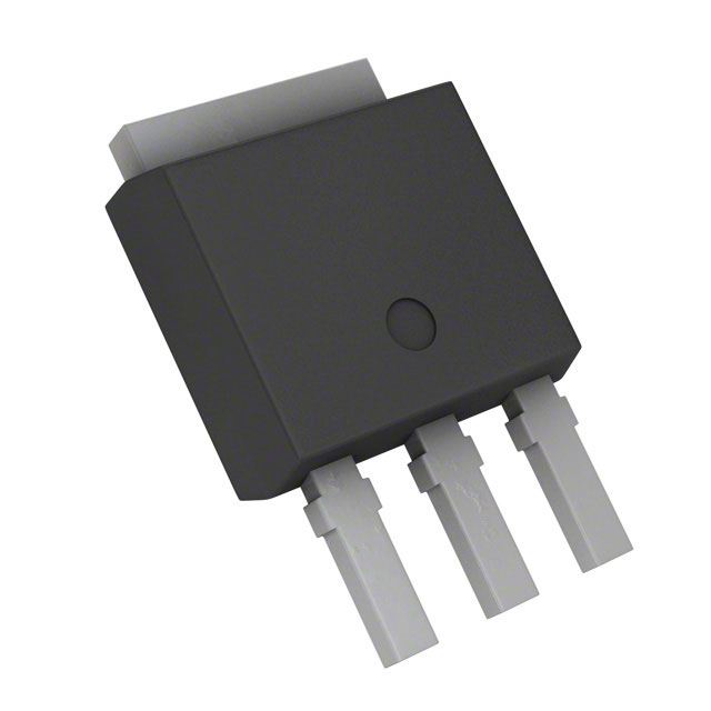

    SUPERFET III MOSFET 是安森美半导体的全新高压超结 (SJ) MOSFET 系列,利用电荷平衡技术实现出色的低导通电阻,以及更低门极电荷方面的卓越性能。此先进工艺专用于最大程度降低导...
FCU360N65S3R0 数据手册
FCU360N65S3R0 MOSFET – Power, N-Channel, SUPERFET III, Easy Drive 650 V, 10 A, 360 mW Description SUPERFET III MOSFET is ON Semiconductor’s brand−new high voltage super-junction (SJ) MOSFET family that is utilizing charge balance technology for outstanding low on-resistance and lower gate charge performance. This advanced technology is tailored to minimize conduction loss, provide superior switching performance, and withstand extreme dv/dt rate. Consequently, SUPERFET III MOSFET is very suitable for various power systems for miniaturization and higher efficiency. www.onsemi.com VDSS RDS(ON) MAX ID MAX 650 V 360 mW @ 10 V 10 A D Features • • • • • • 700 V @ TJ = 150°C Typ. RDS(on) = 310 mW Ultra Low Gate Charge (Typ. Qg = 18 nC) Low Effective Output Capacitance (Typ. Coss(eff.) = 173 pF) 100% Avalanche Tested These Devices are Pb−Free and are RoHS Compliant Applications • • • • G S N-Channel MOSFET G Computing / Display Power Supplies Telecom / Server Power Supplies Industrial Power Supplies Lighting / Charger / Adapter D S I−PAK CASE 369AP MARKING DIAGRAM $Y&Z&3&K FCU360 N65S3R0 $Y &Z &3 &K FCU360N65S3R0 = ON Semiconductor Logo = Assembly Plant Code = Numeric Date Code = Lot Code = Specific Device Code ORDERING INFORMATION See detailed ordering and shipping information on page 2 of this data sheet. © Semiconductor Components Industries, LLC, 2017 August, 2019 − Rev. 3 1 Publication Order Number: FCU360N65S3R0/D FCU360N65S3R0 ABSOLUTE MAXIMUM RATINGS (TC = 25°C, Unless otherwise specified) Symbol Parameter VDSS Drain to Source Voltage VGSS Gate to Source Voltage ID Drain Current Value Unit 650 V DC ±30 V AC (f > 1 Hz) ±30 V Continuous (TC = 25°C) 10 A Continuous (TC = 100°C) 6 Pulsed (Note 1) IDM Drain Current 25 A EAS Single Pulsed Avalanche Energy (Note 2) 40 mJ IAS Avalanche Current (Note 1) 2.1 A EAR Repetitive Avalanche Energy (Note 1) 0.83 mJ dv/dt MOSFET dv/dt 100 V/ns Peak Diode Recovery dv/dt (Note 3) 20 PD Power Dissipation (TC = 25°C) 83 W 0.67 W/°C −55 to +150 °C 300 °C Derate Above 25°C TJ, TSTG TL Operating and Storage Temperature Range Maximum Lead Temperature for Soldering, 1/8″ from Case for 5 s Stresses exceeding those listed in the Maximum Ratings table may damage the device. If any of these limits are exceeded, device functionality should not be assumed, damage may occur and reliability may be affected. 1. Repetitive rating: pulse-width limited by maximum junction temperature. 2. IAS = 2.1 A, RG = 25 W, starting TJ = 25°C. 3. ISD ≤ 5 A, di/dt ≤ 200 A/ms, VDD ≤ 400 V, starting TJ = 25°C. THERMAL CHARACTERISTICS Symbol Parameter Value Unit _C/W RqJC Thermal Resistance, Junction to Case, Max. 1.5 RqJA Thermal Resistance, Junction to Ambient, Max. 100 PACKAGE MARKING AND ORDERING INFORMATION Part Number Top Marking Package Packing Method Reel Size Tape Width Quantity FCU360N65S3R0 FCU360N65S3R0 IPAK Tube N/A N/A 75 Units www.onsemi.com 2 FCU360N65S3R0 ELECTRICAL CHARACTERISTICS (TC = 25°C unless otherwise noted) Parameter Symbol Test Conditions Min Typ Max Unit VGS = 0 V, ID = 1 mA, TJ = 25_C 650 − − V VGS = 0 V, ID = 1 mA, TJ = 150_C 700 − − V OFF CHARACTERISTICS BVDSS Drain to Source Breakdown Voltage DBVDSS/DTJ Breakdown Voltage Temperature Coefficient ID = 1 mA, Referenced to 25_C − 0.68 − V/_C IDSS Zero Gate Voltage Drain Current VDS = 650 V, VGS = 0 V − − 1 mA VDS = 520 V, TC = 125_C − 0.58 − IGSS Gate to Body Leakage Current VGS = ±30 V, VDS = 0 V − − ±100 nA 2.5 − 4.5 V ON CHARACTERISTICS VGS(th) Gate Threshold Voltage VGS = VDS, ID = 0.2 mA RDS(on) Static Drain to Source On Resistance VGS = 10 V, ID = 5 A − 310 360 mW Forward Transconductance VDS = 20 V, ID = 5 A − 6 − S VDS = 400 V, VGS = 0 V, f = 1 MHz − 730 − pF − 15 − pF gFS DYNAMIC CHARACTERISTICS Ciss Input Capacitance Coss Output Capacitance Coss(eff.) Effective Output Capacitance VDS = 0 V to 400 V, VGS = 0 V − 173 − pF Coss(er.) Energy Related Output Capacitance VDS = 0 V to 400 V, VGS = 0 V − 26 − pF Total Gate Charge at 10 V VDS = 400 V, ID = 5 A, VGS = 10 V (Note 4) − 18 − nC − 4.3 − nC Qg(tot) Qgs Gate to Source Gate Charge Qgd Gate to Drain “Miller” Charge ESR Equivalent Series Resistance − 7.6 − nC f = 1 MHz − 1 − W VDD = 400 V, ID = 5 A, VGS = 10 V, Rg = 4.7 W (Note 4) − 12 − ns − 11 − ns SWITCHING CHARACTERISTICS td(on) Turn-On Delay Time tr Turn-On Rise Time td(off) Turn-Off Delay Time − 34 − ns Turn-Off Fall Time − 10 − ns Maximum Continuous Source to Drain Diode Forward Current − − 10 A ISM Maximum Pulsed Source to Drain Diode Forward Current − − 25 A VSD Source to Drain Diode Forward Voltage VGS = 0 V, ISD = 5 A − − 1.2 V trr Reverse Recovery Time − 241 − ns Qrr Reverse Recovery Charge VGS = 0 V, ISD = 5 A, dIF/dt = 100 A/ms − 2.4 − mC tf SOURCE-DRAIN DIODE CHARACTERISTICS IS Product parametric performance is indicated in the Electrical Characteristics for the listed test conditions, unless otherwise noted. Product performance may not be indicated by the Electrical Characteristics if operated under different conditions. 4. Essentially independent of operating temperature typical characteristics. www.onsemi.com 3 FCU360N65S3R0 TYPICAL PERFORMANCE CHARACTERISTICS ID, Drain Current[A] 10 50 VGS = 10.0V 8.0V 7.0V 6.5V 6.0V 5.5V ID, Drain Current[A] 50 1 *Notes: 1. VDS = 20V 2. 250 ms Pulse Test 10 o 150 C o 25 C 1 o −55 C *Notes: 1. 250 ms Pulse Test o 2. TC = 25 C 0.1 0.2 1 10 VDS, Drain−Source Voltage[V] 0.1 20 2 Figure 1. On-Region Characteristics *Notes: 1. VGS = 0V 1.0 0.8 0.6 VGS = 10V VGS = 20V 0.2 0.0 0 5 10 15 20 ID, Drain Current [A] 25 10 o 1 o 25 C 0.1 o VGS, Gate−Source Voltage [V] Capacitances [pF] 10000 1 Ciss Coss *Note: 1. VGS = 0V 2. f = 1MHz Ciss = C gs + Cgd (C ds = shorted) Coss = C ds + Cgd Crss = Cgd 0.1 0.1 1 10 100 VDS, Drain−Source Voltage [V] 0.0 0.5 1.0 VSD, Body Diode Forward Voltage [V] 1.5 Figure 4. Body Diode Forward Voltage Variation vs. Source Current and Temperature 10 100 −55 C 0.01 100000 1000 2. 250 ms Pulse Test 150 C 0.001 30 Figure 3. On-Resistance Variation vs. Drain Current and Gate Voltage 10 8 100 o *Note: TC = 25 C 0.4 4 5 6 7 VGS, Gate−Source Voltage[V] Figure 2. Transfer Characteristics IS, Reverse Drain Current [A] RDS(ON), Drain−Source On−Resistance [W ] 1.2 3 Crss 8 Figure 5. Capacitance Characteristics VDS = 130V VDS = 400V 6 4 2 0 1000 *Note: I D = 5A 0 5 10 15 Qg, Total Gate Charge [nC] Figure 6. Gate Charge Characteristics www.onsemi.com 4 20 FCU360N65S3R0 TYPICAL PERFORMANCE CHARACTERISTICS (Continued) 3.0 *Notes: 1. VGS = 0V 2. I D = 10mA 1.1 RDS(on), [Normalized] Drain−Source On−Resistance BVDSS, [Normalized] Drain−Source Breakdown Voltage 1.2 1.0 0.9 0.8 −50 0 50 100 o TJ, Junction Temperature [ C] 1.0 0.5 −50 0 50 100 o TJ, Junction Temperature [ C] 150 12 10 10m s 10 ID, Drain Current [A] 100m s 1ms 10ms DC 1 Operation in This Area is Limited by R DS(on) *Notes: 0.1 o 1. TC = 25 C 2. TJ = 150 C 3. Single Pulse 1 10 100 VDS, Drain−Source Voltage [V] 4 3 2 1 130 260 390 520 VDS, Drain to Source Voltage [V] 4 25 50 75 100 125 TC, Case Temperature [ o C] 150 Figure 10. Maximum Drain Current vs. Case Temperature 5 0 6 0 1000 Figure 9. Maximum Safe Operation Area 0 8 2 o EOSS [m J] 1.5 Figure 8. On-Resistance Variant vs. Temperature 100 ID, Drain Current [A] 2.0 0.0 150 Figure 7. Breakdown Voltage Variation vs. Temperature 0.01 2.5 *Notes: 1. VGS = 10V 2. I D = 5A 650 Figure 11. EOSS vs. Drain to Source Voltage www.onsemi.com 5 FCU360N65S3R0 r(t), NORMALIZED EFFECTIVE TRANSIENT THERMAL RESISTANCE TYPICAL PERFORMANCE CHARACTERISTICS (Continued) 2 1 0.1 DUTY CYCLE−DESCENDING ORDER D = 0.5 0.2 0.1 0.05 0.02 0.01 PDM t1 t2 0.01 0.001 −5 10 NOTES: Z qJC(t) = r(t) x RqJC RqJC = 1.5 oC/W Peak T J = PDM x ZqJC(t) + TC Duty Cycle, D = t1 / t2 SINGLE PULSE −4 10 −3 10 −2 −1 10 10 t, RECTANGULAR PULSE DURATION (sec) Figure 12. Transient Thermal Response Curve www.onsemi.com 6 0 10 1 10 2 10 FCU360N65S3R0 Figure 13. Gate Charge Test Circuit & Waveform VDS RG V 10V GS RL VDS 90% VDD VGS VGS DUT 10% tr td(on) t on Figure 14. Resistive Switching Test Circuit & Waveforms Figure 15. Unclamped Inductive Switching Test Circuit & Waveforms www.onsemi.com 7 td(off) t off tf FCU360N65S3R0 DUT + VDS _ I SD L Driver RG VGS VGS ( Driver ) I SD ( DUT ) Same Type as DUT VDD Sdv/dt controlled by R G SI SD controlled by pulse period Gate Pulse Width D = −−−−−−−−−−−−−−−−−−−−−−−−−− Gate Pulse Period 10V IFM , Body Diode Forward Current di/dt IRM Body Diode Reverse Current VDS ( DUT ) Body Diode Recoverydv/dt VSD VDD Body Diode Forward Voltage Drop Figure 16. Peak Diode Recovery dv/dt Test Circuit & Waveforms SUPERFET is a registered trademark of Semiconductor Components Industries, LLC (SCILLC) or its subsidiaries in the United States and/or other countries. www.onsemi.com 8 MECHANICAL CASE OUTLINE PACKAGE DIMENSIONS DPAK3 (STRAIGHT LEADS) CASE 369AP ISSUE O DOCUMENT NUMBER: DESCRIPTION: 98AON13816G DATE 30 SEP 2016 Electronic versions are uncontrolled except when accessed directly from the Document Repository. Printed versions are uncontrolled except when stamped “CONTROLLED COPY” in red. DPAK3 (STRAIGHT LEADS) PAGE 1 OF 1 ON Semiconductor and are trademarks of Semiconductor Components Industries, LLC dba ON Semiconductor or its subsidiaries in the United States and/or other countries. ON Semiconductor reserves the right to make changes without further notice to any products herein. ON Semiconductor makes no warranty, representation or guarantee regarding the suitability of its products for any particular purpose, nor does ON Semiconductor assume any liability arising out of the application or use of any product or circuit, and specifically disclaims any and all liability, including without limitation special, consequential or incidental damages. ON Semiconductor does not convey any license under its patent rights nor the rights of others. © Semiconductor Components Industries, LLC, 2019 www.onsemi.com onsemi, , and other names, marks, and brands are registered and/or common law trademarks of Semiconductor Components Industries, LLC dba “onsemi” or its affiliates and/or subsidiaries in the United States and/or other countries. onsemi owns the rights to a number of patents, trademarks, copyrights, trade secrets, and other intellectual property. A listing of onsemi’s product/patent coverage may be accessed at www.onsemi.com/site/pdf/Patent−Marking.pdf. onsemi reserves the right to make changes at any time to any products or information herein, without notice. The information herein is provided “as−is” and onsemi makes no warranty, representation or guarantee regarding the accuracy of the information, product features, availability, functionality, or suitability of its products for any particular purpose, nor does onsemi assume any liability arising out of the application or use of any product or circuit, and specifically disclaims any and all liability, including without limitation special, consequential or incidental damages. Buyer is responsible for its products and applications using onsemi products, including compliance with all laws, regulations and safety requirements or standards, regardless of any support or applications information provided by onsemi. “Typical” parameters which may be provided in onsemi data sheets and/or specifications can and do vary in different applications and actual performance may vary over time. All operating parameters, including “Typicals” must be validated for each customer application by customer’s technical experts. onsemi does not convey any license under any of its intellectual property rights nor the rights of others. onsemi products are not designed, intended, or authorized for use as a critical component in life support systems or any FDA Class 3 medical devices or medical devices with a same or similar classification in a foreign jurisdiction or any devices intended for implantation in the human body. Should Buyer purchase or use onsemi products for any such unintended or unauthorized application, Buyer shall indemnify and hold onsemi and its officers, employees, subsidiaries, affiliates, and distributors harmless against all claims, costs, damages, and expenses, and reasonable attorney fees arising out of, directly or indirectly, any claim of personal injury or death associated with such unintended or unauthorized use, even if such claim alleges that onsemi was negligent regarding the design or manufacture of the part. onsemi is an Equal Opportunity/Affirmative Action Employer. This literature is subject to all applicable copyright laws and is not for resale in any manner. PUBLICATION ORDERING INFORMATION LITERATURE FULFILLMENT: Email Requests to: orderlit@onsemi.com onsemi Website: www.onsemi.com ◊ TECHNICAL SUPPORT North American Technical Support: Voice Mail: 1 800−282−9855 Toll Free USA/Canada Phone: 011 421 33 790 2910 Europe, Middle East and Africa Technical Support: Phone: 00421 33 790 2910 For additional information, please contact your local Sales Representative
