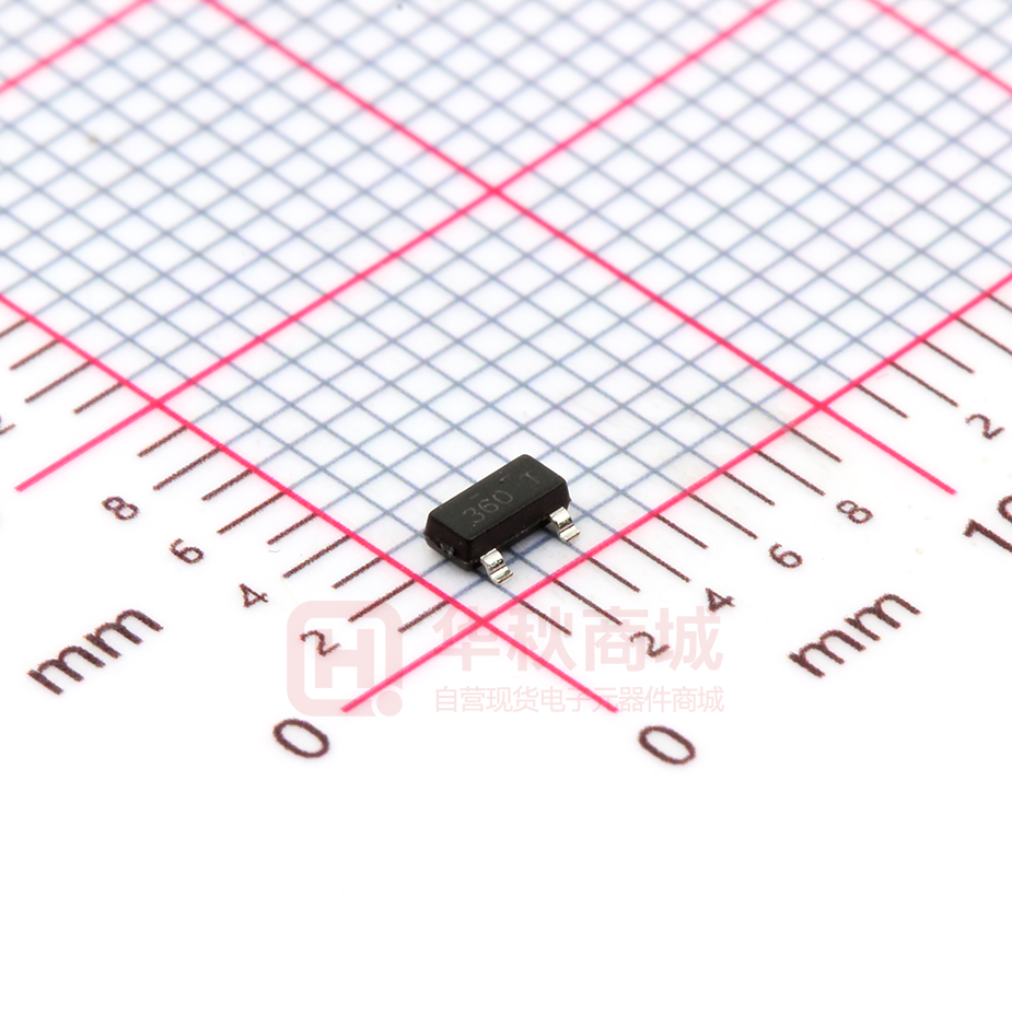

    MOS管 P-Channel VDS=30V VGS=±20V ID=2A RDS(ON)=80mΩ@10V SOT23-3
FDN360P 数据手册
FDN360P FDN360P Single P-Channel, PowerTrench MOSFET Features General Description • –2 A, –30 V. This P-Channel Logic Level MOSFET is produced using ON Semiconductor advanced Power Trench process that has been especially tailored to minimize the on-state resistance and yet maintain low gate charge for superior switching performance. RDS(ON) = 80 mΩ @ VGS = –10 V RDS(ON) = 125 mΩ @ VGS = –4.5 V • Low gate charge (6.2 nC typical) • High performance trench technology for extremely low RDS(ON) . These devices are well suited for low voltage and battery powered applications where low in-line power loss and fast switching are required. • High power version of industry Standard SOT-23 package. Identical pin-out to SOT-23 with 30% higher power handling capability. • These Devices are Pb-Free and are RoHS Compliant D D S G TM SuperSOT -3 Absolute Maximum Ratings Symbol S G TA=25oC unless otherwise noted Ratings Units VDSS Drain-Source Voltage Parameter –30 V VGSS Gate-Source Voltage ±20 V ID Drain Current –2 A PD Power Dissipation for Single Operation – Continuous (Note 1a) – Pulsed TJ, TSTG –10 (Note 1a) 0.5 (Note 1b) 0.46 W –55 to +150 °C (Note 1a) 250 °C/W (Note 1) 75 °C/W Operating and Storage Junction Temperature Range Thermal Characteristics RθJA Thermal Resistance, Junction-to-Ambient RθJC Thermal Resistance, Junction-to-Case Package Marking and Ordering Information Device Marking Device Reel Size Tape width Quantity 360 FDN360P 7’’ 8mm 3000 units 2003 Semiconductor Components Industries, LLC. November-2018, Rev. 7 Publication Order Number: FDN360P /D Symbol Parameter TA = 25°C unless otherwise noted Test Conditions Min Typ Max Units Off Characteristics VGS = 0 V, ID = –250 µA BVDSS ∆BVDSS ∆TJ Drain–Source Breakdown Voltage Breakdown Voltage Temperature Coefficient IDSS Zero Gate Voltage Drain Current IGSSF Gate–Body Leakage, Forward VGS = 20 V, VDS = 0 V 100 nA IGSSR Gate–Body Leakage, Reverse VGS = –20 V, VDS = 0 V –100 nA –3 V On Characteristics –30 ID = –250 µA, Referenced to 25°C VDS = –24V, V –22 VGS = 0 V mV/°C –1 µA –10 VDS = –24V, VGS = 0 V, TJ=55°C (Note 2) VGS(th) ∆VGS(th) ∆TJ RDS(on) Gate Threshold Voltage Gate Threshold Voltage Temperature Coefficient Static Drain–Source On–Resistance VDS = VGS, ID = –250 µA ID = –250 µA, Referenced to 25°C ID(on) On–State Drain Current VGS = –10 V, VDS = –5 V gFS Forward Transconductance VDS = –5 V, ID = –2 A 5 S VDS = –15 V, f = 1.0 MHz V GS = 0 V, 298 pF 83 pF 39 pF –1 –1.9 4 VGS = –10 V, ID = –2 A VGS = –10 V, ID = –2 A, TJ=125°C VGS= –4.5 V, ID = –1.5A 63 90 100 mV/°C 80 136 125 –10 mΩ A Dynamic Characteristics Ciss Input Capacitance Coss Output Capacitance Crss Reverse Transfer Capacitance Switching Characteristics td(on) Turn–On Delay Time tr Turn–On Rise Time td(off) tf Qg Total Gate Charge (Note 2) 6 12 ns 13 23 ns Turn–Off Delay Time 11 20 ns Turn–Off Fall Time 6 12 ns 6.2 9 nC Qgs Gate–Source Charge Qgd Gate–Drain Charge VDD = –15 V, VGS = –10 V, VDS = –15V, VGS = –10 V ID = –1 A, RGEN = 6 Ω ID = –3.6 A, 1 nC 1.2 nC Drain–Source Diode Characteristics and Maximum Ratings IS VSD Maximum Continuous Drain–Source Diode Forward Current Drain–Source Diode Forward VGS = 0 V, IS = –0.42 A Voltage (Note 2) –0.8 –0.42 A –1.2 V Notes: 1. RθJA is the sum of the junction-to-case and case-to-ambient thermal resistance where the case thermal reference is defined as the solder mounting surface of the drain pins. RθJC is guaranteed by design while RθCA is determined by the user's board design. a) 250°C/W when mounted on a 0.02 in2 pad of 2 oz. copper. b) 270°C/W when mounted on a minimum pad. Scale 1 : 1 on letter size paper 2. Pulse Test: Pulse Width ≤ 300 µs, Duty Cycle ≤ 2.0% www.onsemi.com 2 FDN360P Electrical Characteristics FDN360P Typical Characteristics 15 2 -6.0V -5.0V V RDS(ON), NORMALIZED DRAIN-SOURCE ON-RESISTANCE -ID, DRAIN CURRENT (A) VGS = -10V -4.5V 12 9 -4.0V 6 -3.5V 3 -3.0V 1.8 VGS = -3.5V 1.6 1.4 -4.0V 1.2 -4.5V 1 -5.0V -6.0V 0.8 -7.0V -10V 0.6 0 0 1 2 3 4 0.4 5 0 -VDS, DRAIN TO SOURCE VOLTAGE (V) 3 6 9 12 15 -ID, DRAIN CURRENT (A) Figure 1. On-Region Characteristics. Figure 2. On-Resistance Variation with Drain Current and Gate Voltage. 0.3 ID = -2A VGS = -10V RDS(ON), ON-RESISTANCE (OHM) RDS(ON), NORMALIZED DRAIN-SOURCE ON-RESISTANCE 1.6 1.4 1.2 1 0.8 0.6 ID = -1A 0.25 0.2 TA = 125oC 0.15 0.1 TA = 25oC 0.05 -50 -25 0 25 50 75 100 125 150 2 4 TJ, JUNCTION TEMPERATURE (oC) Figure 3. On-Resistance Variation with Temperature. 8 10 Figure 4. On-Resistance Variation with Gate-to-Source Voltage. 10 10 -IS, REVERSE DRAIN CURRENT (A) 25oC TA = -55oC VDS = -5.0V -ID, DRAIN CURRENT (A) 6 -VGS, GATE TO SOURCE VOLTAGE (V) 8 125oC 6 4 2 0 VGS = 0V 1 TA = 125oC 0.1 25oC -55oC 0.01 0.001 0.0001 1 2 3 4 5 0 -VGS, GATE TO SOURCE VOLTAGE (V) Figure 5. Transfer Characteristics. 0.2 0.4 0.6 0.8 1 1.2 -VSD, BODY DIODE FORWARD VOLTAGE (V) Figure 6. Body Diode Forward Voltage Variation with Source Current and Temperature. www.onsemi.com 3 FDN360P Typical Characteristics 400 VDS = -5V ID = -3.6A f = 1 MHz VGS = 0 V -10V CISS 8 -15V CAPACITANCE (pF) -VGS, GATE-SOURCE VOLTAGE (V) 10 6 4 2 300 200 COSS 100 CRSS 0 0 0 1 2 3 4 5 6 7 0 6 Qg, GATE CHARGE (nC) Figure 7. Gate Charge Characteristics. 24 20 P(pk), PEAK TRANSIENT POWER (W) RDS(ON) LIMIT 10µs 10 100µs 1ms 10ms 100ms 1s 1 VGS = -10V SINGLE PULSE RθJA =270oC/W 0.1 DC TA = 25oC 0.1 1 30 10 SINGLE PULSE RθJA = 270°C/W TA = 25°C 15 10 5 0 0.001 0.01 100 0.01 0.1 1 -VDS, DRAIN-SOURCE VOLTAGE (V) 10 100 1000 t1, TIME (sec) Figure 9. Maximum Safe Operating Area. r(t), NORMALIZED EFFECTIVE TRANSIENT THERMAL RESISTANCE 18 Figure 8. Capacitance Characteristics. 100 -ID, DRAIN CURRENT (A) 12 -VDS, DRAIN TO SOURCE VOLTAGE (V) Figure 10. Single Pulse Maximum Power Dissipation. 1 D = 0.5 RθJA(t) = r(t) + RθJA RθJA = 270 °C/W 0.2 0.1 0.1 0.05 P(pk) 0.02 0.01 t1 0.01 t2 TJ - TA = P * RθJA(t) Duty Cycle, D = t1 / t2 SINGLE PULSE 0.001 0.0001 0.001 0.01 0.1 1 10 t1, TIME (sec) Figure 11. Transient Thermal Response Curve. Thermal characterization performed using the conditions described in Note 1b. Transient thermal response will change depending on the circuit board design. www.onsemi.com 4 100 1000 MECHANICAL CASE OUTLINE PACKAGE DIMENSIONS SOT−23/SUPERSOTt−23, 3 LEAD, 1.4x2.9 CASE 527AG ISSUE A GENERIC MARKING DIAGRAM* XXXMG G DOCUMENT NUMBER: DESCRIPTION: XXX = Specific Device Code M = Month Code G = Pb−Free Package (Note: Microdot may be in either location) 98AON34319E DATE 09 DEC 2019 *This information is generic. Please refer to device data sheet for actual part marking. Pb−Free indicator, “G” or microdot “G”, may or may not be present. Some products may not follow the Generic Marking. Electronic versions are uncontrolled except when accessed directly from the Document Repository. Printed versions are uncontrolled except when stamped “CONTROLLED COPY” in red. SOT−23/SUPERSOT−23, 3 LEAD, 1.4X2.9 PAGE 1 OF 1 ON Semiconductor and are trademarks of Semiconductor Components Industries, LLC dba ON Semiconductor or its subsidiaries in the United States and/or other countries. ON Semiconductor reserves the right to make changes without further notice to any products herein. ON Semiconductor makes no warranty, representation or guarantee regarding the suitability of its products for any particular purpose, nor does ON Semiconductor assume any liability arising out of the application or use of any product or circuit, and specifically disclaims any and all liability, including without limitation special, consequential or incidental damages. ON Semiconductor does not convey any license under its patent rights nor the rights of others. © Semiconductor Components Industries, LLC, 2019 www.onsemi.com ON Semiconductor and are trademarks of Semiconductor Components Industries, LLC dba ON Semiconductor or its subsidiaries in the United States and/or other countries. ON Semiconductor owns the rights to a number of patents, trademarks, copyrights, trade secrets, and other intellectual property. A listing of ON Semiconductor’s product/patent coverage may be accessed at www.onsemi.com/site/pdf/Patent−Marking.pdf. ON Semiconductor reserves the right to make changes without further notice to any products herein. ON Semiconductor makes no warranty, representation or guarantee regarding the suitability of its products for any particular purpose, nor does ON Semiconductor assume any liability arising out of the application or use of any product or circuit, and specifically disclaims any and all liability, including without limitation special, consequential or incidental damages. Buyer is responsible for its products and applications using ON Semiconductor products, including compliance with all laws, regulations and safety requirements or standards, regardless of any support or applications information provided by ON Semiconductor. “Typical” parameters which may be provided in ON Semiconductor data sheets and/or specifications can and do vary in different applications and actual performance may vary over time. All operating parameters, including “Typicals” must be validated for each customer application by customer’s technical experts. ON Semiconductor does not convey any license under its patent rights nor the rights of others. ON Semiconductor products are not designed, intended, or authorized for use as a critical component in life support systems or any FDA Class 3 medical devices or medical devices with a same or similar classification in a foreign jurisdiction or any devices intended for implantation in the human body. Should Buyer purchase or use ON Semiconductor products for any such unintended or unauthorized application, Buyer shall indemnify and hold ON Semiconductor and its officers, employees, subsidiaries, affiliates, and distributors harmless against all claims, costs, damages, and expenses, and reasonable attorney fees arising out of, directly or indirectly, any claim of personal injury or death associated with such unintended or unauthorized use, even if such claim alleges that ON Semiconductor was negligent regarding the design or manufacture of the part. ON Semiconductor is an Equal Opportunity/Affirmative Action Employer. This literature is subject to all applicable copyright laws and is not for resale in any manner. PUBLICATION ORDERING INFORMATION LITERATURE FULFILLMENT: Email Requests to: orderlit@onsemi.com ON Semiconductor Website: www.onsemi.com ◊ TECHNICAL SUPPORT North American Technical Support: Voice Mail: 1 800−282−9855 Toll Free USA/Canada Phone: 011 421 33 790 2910 www.onsemi.com 1 Europe, Middle East and Africa Technical Support: Phone: 00421 33 790 2910 For additional information, please contact your local Sales Representative
