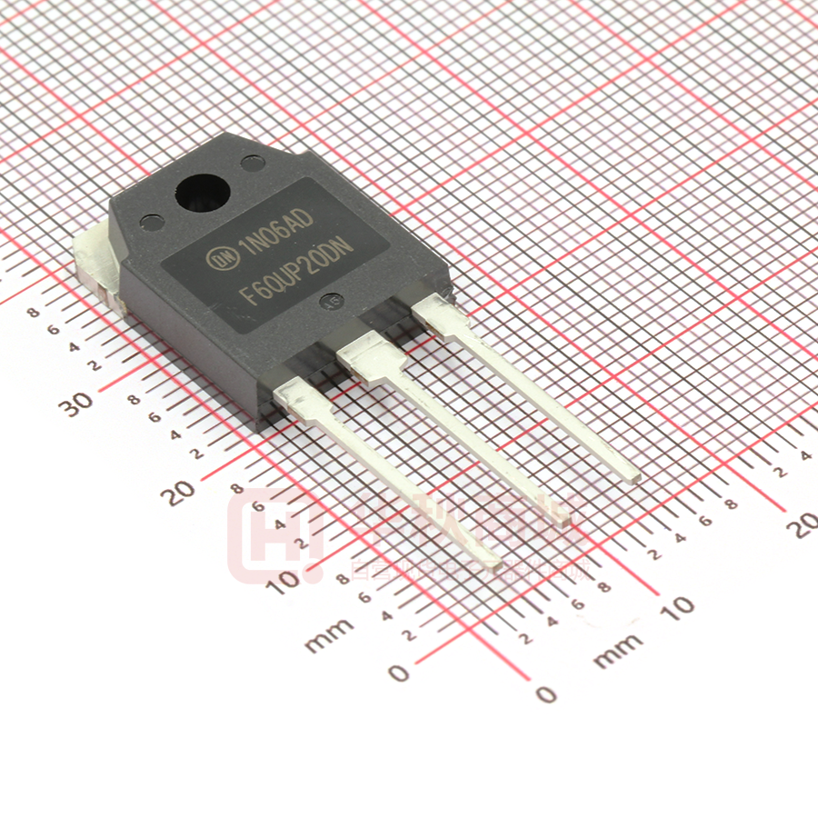

    快恢复二极管 VRRM=200V If=30A VF=1.15V trr=40ns TO3P
FFA60UP20DNTU 数据手册
FFA60UP20DN Features • Ultrafast with soft recovery (@ IF = 1A), < 40ns • Reverse Voltage, 200V • Forward Voltage (@ TC = 100°C), < 1V TO-3P Applications • • • • 1 2 3 Power switching circuits Output rectifiers Freewheeling diodes Switching mode power supply 1. Anode 2.Cathode 3. Anode Absolute Maximum Ratings Symbol (per diode) TC=25°C unless otherwise noted VRRM Parameter Peak Repetitive Reverse Voltage Value 200 Units V IF(AV) Average Rectified Forward Current IFSM Non-repetitive Peak Surge Current 60Hz Single Half-Sine Wave 30 A 300 A TJ, TSTG Operating Junction and Storage Temperature - 65 to +150 °C Value 1.4 Units °C/W @ TC = 100°C Thermal Characteristics Symbol RθJC Parameter Maximum Thermal Resistance, Junction to Case Electrical Characteristics Symbol VFM * IRM * (per diode) TC=25 °C unless otherwise noted Parameter Maximum Instantaneous Forward Voltage IF = 30A IF = 30A Maximum Instantaneous Reverse Current @ rated VR Min. Typ. Max. TC = 25 °C TC = 100 °C - - 1.15 1.0 TC = 25 °C TC = 100 °C - - 10 100 Units V µA trr Irr Qrr Reverse Recovery Time Reverse Recovery Current Reverse Recovery Charge (IF =30A, di/dt = 200A/µs) - 32 2.4 38.4 - ns A nC trr Maximum Reverse Recovery Time (IF =1A, di/dt = 100A/µs) - - 40 ns WAVL Avalanche Energy (L=40mH) 2 - - mJ * Pulse Test: Pulse Width=300µs, Duty Cycle=2% ©2004 Fairchild Semiconductor Corporation Rev. A, August 2004 FFA60UP20DN Ultrafast Rectifier FFA60UP20DN Typical Characteristics 10 100 o Reverse Current , I R [µA] Forward Current , IF [A] TC = 100 C o TC = 100 C 10 o TC = 25 C 1 0.1 0.0 1 o TC = 25 C 0.1 0.01 0.001 0.5 1.0 1.5 0 2.0 50 Reverse Recovery Time , trr [ns] Typical Capacitance at 0V = 473.9 pF 400 Capacitance , Cj [pF] 200 40 500 200 1 10 IF = 30A o Tc = 25 C 35 30 25 100 100 500 di/dt [A/µs] Reverse Voltage , VR [V] Figure 4. Typical Reverse Recovery Time vs. di/dt Figure 3. Typical Junction Capacitance IF = 30A o 5 TC = 25 C 4 3 2 1 0 100 500 di/dt [A/µs] Figure 5. Typical Reverse Recovery Current vs. di/dt ©2004 Fairchild Semiconductor Corporation 35 30 25 DC Average Forward Current , IF(AV) [A] 6 Reverse Recovery Current , Irr [A] 150 Figure 2. Typical Reverse Current vs. Reverse Voltage Figure 1. Typical Forward Voltage Drop vs. Forward Current 0.1 100 Reverse Voltage , VR [V] Forward Voltage , VF [V] 20 15 10 5 0 60 80 100 120 140 160 o Case Temperature , TC [ C] Figure 6. Forward Current Derating Curve Rev. A, August 2004 FFA60UP20DN Package Dimensions TO-3P 15.60 ±0.20 3.00 ±0.20 3.80 ±0.20 +0.15 1.00 ±0.20 18.70 ±0.20 23.40 ±0.20 19.90 ±0.20 1.50 –0.05 16.50 ±0.30 2.00 ±0.20 9.60 ±0.20 4.80 ±0.20 3.50 ±0.20 13.90 ±0.20 ø3.20 ±0.10 12.76 ±0.20 13.60 ±0.20 1.40 ±0.20 +0.15 5.45TYP [5.45 ±0.30] 5.45TYP [5.45 ±0.30] 0.60 –0.05 Dimensions in Millimeters ©2004 Fairchild Semiconductor Corporation Rev. A, August 2004 TRADEMARKS The following are registered and unregistered trademarks Fairchild Semiconductor owns or is authorized to use and is not intended to be an exhaustive list of all such trademarks. ACEx™ FAST® FASTr™ FPS™ FRFET™ GlobalOptoisolator™ GTO™ HiSeC™ I2C™ i-Lo™ ImpliedDisconnect™ ActiveArray™ Bottomless™ CoolFET™ CROSSVOLT™ DOME™ EcoSPARK™ E2CMOS™ EnSigna™ FACT™ FACT Quiet Series™ Across the board. Around the world.™ The Power Franchise® Programmable Active Droop™ ISOPLANAR™ LittleFET™ MICROCOUPLER™ MicroFET™ MicroPak™ MICROWIRE™ MSX™ MSXPro™ OCX™ OCXPro™ OPTOLOGIC® OPTOPLANAR™ PACMAN™ POP™ Power247™ PowerSaver™ PowerTrench® QFET® QS™ QT Optoelectronics™ Quiet Series™ RapidConfigure™ RapidConnect™ µSerDes™ SILENT SWITCHER® SMART START™ SPM™ Stealth™ SuperFET™ SuperSOT™-3 SuperSOT™-6 SuperSOT™-8 SyncFET™ TinyLogic® TINYOPTO™ TruTranslation™ UHC™ UltraFET® VCX™ DISCLAIMER FAIRCHILD SEMICONDUCTOR RESERVES THE RIGHT TO MAKE CHANGES WITHOUT FURTHER NOTICE TO ANY PRODUCTS HEREIN TO IMPROVE RELIABILITY, FUNCTION OR DESIGN. FAIRCHILD DOES NOT ASSUME ANY LIABILITY ARISING OUT OF THE APPLICATION OR USE OF ANY PRODUCT OR CIRCUIT DESCRIBED HEREIN; NEITHER DOES IT CONVEY ANY LICENSE UNDER ITS PATENT RIGHTS, NOR THE RIGHTS OF OTHERS. LIFE SUPPORT POLICY FAIRCHILD’S PRODUCTS ARE NOT AUTHORIZED FOR USE AS CRITICAL COMPONENTS IN LIFE SUPPORT DEVICES OR SYSTEMS WITHOUT THE EXPRESS WRITTEN APPROVAL OF FAIRCHILD SEMICONDUCTOR CORPORATION. As used herein: 1. Life support devices or systems are devices or systems 2. A critical component is any component of a life support which, (a) are intended for surgical implant into the body, device or system whose failure to perform can be or (b) support or sustain life, or (c) whose failure to perform reasonably expected to cause the failure of the life support when properly used in accordance with instructions for use device or system, or to affect its safety or effectiveness. provided in the labeling, can be reasonably expected to result in significant injury to the user. PRODUCT STATUS DEFINITIONS Definition of Terms Datasheet Identification Product Status Definition Advance Information Formative or In Design This datasheet contains the design specifications for product development. Specifications may change in any manner without notice. Preliminary First Production This datasheet contains preliminary data, and supplementary data will be published at a later date. Fairchild Semiconductor reserves the right to make changes at any time without notice in order to improve design. No Identification Needed Full Production This datasheet contains final specifications. Fairchild Semiconductor reserves the right to make changes at any time without notice in order to improve design. Obsolete Not In Production This datasheet contains specifications on a product that has been discontinued by Fairchild semiconductor. The datasheet is printed for reference information only. ©2004 Fairchild Semiconductor Corporation Rev. I11
