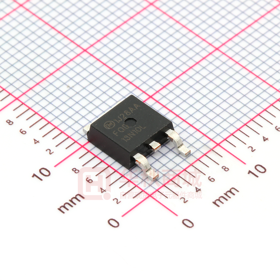

FQD13N10L / FQU13N10L N-Channel QFET® MOSFET 100 V, 10 A, 180 mΩ Description Features This N-Channel enhancement mode power MOSFET • 10 A, 100 V, RDS(on) = 180 mΩ (Max.) @ VGS = 10 V, is produced using Fairchild Semiconductor’s proprietary ID = 5.0 A planar stripe and DMOS technology. This advanced MOSFET technology has been especially tailored to reduce • Low Gate Charge (Typ. 8.7 nC) on-state resistance, and to provide superior switching • Low Crss (Typ. 20 pF) performance and high avalanche energy strength. These devices are suitable for switched mode power supplies, • 100% Avalanche Tested audio amplifier, DC motor control, and variable switching • Low Level Gate Drive Requirement Allowing power applications. Direct Operation Form Logic Drivers D D G S I-PAK D-PAK G D G S S Absolute Maximum Ratings Symbol VDSS ID TC = 25°C unless otherwise noted. FQD13N10LTM / FQU13N10LTU 100 Parameter Drain-Source Voltage - Continuous (TC = 25°C) Drain Current - Continuous (TC = 100°C) IDM Drain Current VGSS Gate-Source Voltage EAS IAR EAR dv/dt PD TJ, TSTG TL - Pulsed Unit V 10 A 6.3 A 40 A ± 20 V Single Pulsed Avalanche Energy (Note 2) 95 mJ Avalanche Current (Note 1) 10 A Repetitive Avalanche Energy Peak Diode Recovery dv/dt Power Dissipation (TA = 25°C) * (Note 1) 4.0 6.0 2.5 mJ V/ns W 40 0.32 -55 to +150 W W/°C °C 300 °C (Note 1) (Note 3) Power Dissipation (TC = 25°C) - Derate above 25°C Operating and Storage Temperature Range Maximum Lead Temperature for Soldering, 1/8” from Case for 5 Seconds Thermal Characteristics Symbol RJC RJA Parameter FQD13N10LTM / FQU13N10LTU Thermal Resistance, Junction to Case, Max. 3.13 Thermal Resistance, Junction to Ambient (Minimum Pad of 2-oz Copper), Max. 110 Thermal Resistance, Junction to Ambient (*1 in2 Pad of 2-oz Copper), Max. 50 ©2000 Fairchild Semiconductor Corporation FQD13N10L / FQU13N10L Rev. C4 1 Unit oC/W www.fairchildsemi.com FQD13N10L / FQU13N10L — N-Channel QFET® MOSFET January 2014 Part Number FQD13N10LT Top Mark FQD13N10L Package D PAK Packing Method ape and Reel Reel Size 330 mm Tape Width 16 mm Quantity 2500 units FQU13N10LTU FQU13N10L I PAK Tube N/A N/A 70 units Electrical Characteristics Symbol TC = 25°C unless otherwise noted. Parameter Test Conditions Min. Typ. Max. Unit 100 -- -- V -- 0.09 -- V/°C Off Characteristics BVDSS Drain-Source Breakdown Voltage VGS = 0 V, ID = 250 µA ∆BVDSS / ∆TJ Breakdown Voltage Temperature Coefficient ID = 250 µA, Referenced to 25°C IDSS Zero Gate Voltage Drain Current VDS = 100 V, VGS = 0 V -- -- 1 µA VDS = 80 V, TC = 125°C -- -- 10 µA IGSSF Gate-Body Leakage Current, Forward VGS = 20 V, VDS = 0 V -- -- 100 nA IGSSR Gate-Body Leakage Current, Reverse VGS = -20 V, VDS = 0 V -- -- -100 nA On Characteristics VGS(th) Gate Threshold Voltage VDS = VGS, ID = 250 µA 1.0 -- 2.0 V RDS(on) Static Drain-Source On-Resistance VGS = 10 V, ID = 5.0 A VGS = 5 V, ID = 5.0 A -- 0.142 0.158 0.18 0.2 Ω gFS Forward Transconductance VDS = 30 V, ID = 5.0 A -- 8.7 -- S VDS = 25 V, VGS = 0 V, f = 1.0 MHz -- 400 520 pF -- 95 125 pF -- 20 25 pF Dynamic Characteristics Ciss Input Capacitance Coss Output Capacitance Crss Reverse Transfer Capacitance Switching Characteristics td(on) Turn-On Delay Time tr Turn-On Rise Time td(off) Turn-Off Delay Time tf Turn-Off Fall Time Qg Total Gate Charge Qgs Gate-Source Charge Qgd Gate-Drain Charge VDD = 50 V, ID = 12.8 A, RG = 25 Ω (Note 4) VDS = 80 V, ID = 12.8 A, VGS = 5 V (Note 4) -- 7.5 25 ns -- 220 450 ns -- 22 55 ns -- 72 150 ns -- 8.7 12 nC -- 2.0 -- nC -- 5.3 -- nC Drain-Source Diode Characteristics and Maximum Ratings IS Maximum Continuous Drain-Source Diode Forward Current -- -- 10 A ISM -- -- 40 A VSD Maximum Pulsed Drain-Source Diode Forward Current VGS = 0 V, IS = 10 A Drain-Source Diode Forward Voltage -- -- 1.5 V trr Reverse Recovery Time Qrr Reverse Recovery Charge VGS = 0 V, IS = 12.8 A, dIF / dt = 100 A/µs -- 75 -- ns -- 0.17 -- µC Notes: 1. Repetitive rating : pulse-width limited by maximum junction temperature. 2. L = 1.43 mH, IAS = 10 A, VDD = 25 V, RG = 25 Ω, Starting TJ = 25°C. 3. ISD ≤ 12.8 A, di/dt ≤ 300 A/µs, VDD ≤ BVDSS, Starting TJ = 25°C. 4. Essentially independent of operating temperature. ©2000 Fairchild Semiconductor Corporation FQD13N10L / FQU13N10L Rev. C4 2 www.fairchildsemi.com FQD13N10L / FQU13N10L — N-Channel QFET® MOSFET Package Marking and Ordering Information VGS 10.0 V 8.0 V 6.0 V 5.0 V 4.5 V 4.0 V 3.5 V Bottom : 3.0 V Top : ID, Drain Current [A] 1 10 ID , Drain Current [A] 1 10 150℃ 0 10 25℃ -55℃ ※ Notes : 1. VDS = 30V 2. 250μs Pulse Test ※ Notes : 1. 250μs Pulse Test 2. TC = 25℃ 0 10 -1 -1 0 10 10 1 10 0 10 2 4 6 8 10 VGS , Gate-Source Voltage [V] VDS, Drain-Source Voltage [V] Figure 1. On-Region Characteristics Figure 2. Transfer Characteristics 0.8 1 10 VGS = 5V 0.4 IDR , Reverse Drain Current [A] RDS(ON) [Ω ], Drain-Source On-Resistance 0.6 VGS = 10V 0.2 150℃ ※ Notes : 1. VGS = 0V 2. 250μs Pulse Test 25℃ ※ Note : TJ = 25℃ -1 0.0 0 10 20 30 10 40 0.2 0.4 0.6 0.8 1.0 1.2 1.4 1.6 1.8 ID, Drain Current [A] VSD, Source-Drain voltage [V] Figure 3. On-Resistance Variation vs. Drain Current and Gate Voltage Figure 4. Body Diode Forward Voltage Variation vs. Source Current and Temperature 12 1000 Ciss = Cgs + Cgd (Cds = shorted) Coss = Cds + Cgd Crss = Cgd 10 800 VDS = 50V VGS, Gate-Source Voltage [V] Capacitance [pF] 0 10 600 Ciss 400 Coss ※ Notes : 1. VGS = 0 V 2. f = 1 MHz Crss 200 8 VDS = 80V 6 4 2 ※ Note : ID = 12.8A 0 -1 10 0 10 0 1 10 Figure 5. Capacitance Characteristics ©2000 Fairchild Semiconductor Corporation FQD13N10L / FQU13N10L Rev. C4 4 8 12 16 QG, Total Gate Charge [nC] VDS, Drain-Source Voltage [V] Figure 6. Gate Charge Characteristics 3 www.fairchildsemi.com FQD13N10L / FQU13N10L — N-Channel QFET® MOSFET Typical Characteristics (Continued) 2.5 2.0 1.1 RDS(ON) , (Normalized) Drain-Source On-Resistance BV DSS , (Normalized) Drain-Source Breakdown Voltage 1.2 1.0 ※ Notes : 1. VGS = 0 V 2. ID = 250 μA 0.9 0.8 -100 -50 0 50 100 150 1.5 1.0 0.5 ※ Notes : 1. VGS = 10 V 2. ID = 5.0 A 0.0 -100 200 -50 o 0 50 100 150 200 o TJ, Junction Temperature [ C] TJ, Junction Temperature [ C] Figure 7. Breakdown Voltage Variation vs. Temperature Figure 8. On-Resistance Variation vs. Temperature 10 Operation in This Area is Limited by R DS(on) 2 8 100 µs ID, Drain Current [A] ID, Drain Current [A] 10 1 ms 1 10 10 ms DC 0 10 ※ Notes : 6 4 2 o 1. TC = 25 C o 2. TJ = 150 C 3. Single Pulse -1 10 0 1 10 0 25 2 10 10 50 Figure 9. Maximum Safe Operating Area ZJC(t), Thermal Response [oC/W] 75 100 125 150 TC, Case Temperature [℃] VDS, Drain-Source Voltage [V] Figure 10. Maximum Drain Current vs. Case Temperature D = 0 .5 10 0 ※ N o te s : 1 . Z θ J C ( t) = 3 .1 3 ℃ / W M a x . 2 . D u ty F a c to r , D = t 1 /t 2 3 . T J M - T C = P D M * Z θ J C ( t) 0 .2 0 .1 0 .0 5 10 PDM 0 .0 2 -1 0 .0 1 t1 s i n g le p u ls e 10 -5 10 -4 t2 10 -3 10 -2 10 -1 10 0 10 1 t 1 , S q u a r e W a v e P u ls e D u r a t io n [ s e c ] Figure 11. Transient Thermal Response Curve ©2000 Fairchild Semiconductor Corporation FQD13N10L / FQU13N10L Rev. C4 4 www.fairchildsemi.com FQD13N10L / FQU13N10L — N-Channel QFET® MOSFET Typical Characteristics 200nF 12V FQD13N10L / FQU13N10L — N-Channel QFET® MOSFET VGS Same Type as DUT 50KΩ Qg 10V 300nF VDS VGS Qgs Qgd DUT IG = const. 3mA Charge Figure 12. Gate Charge Test Circuit & Waveform VDS RG RL VDS 90% VDD VGS VGS DUT V 10V GS 10% td(on) tr td(off) t on tf t off Figure 13. Resistive Switching Test Circuit & Waveforms BVDSS 1 EAS = ---- L IAS2 -------------------2 BVDSS - VDD L VDS BVDSS IAS ID RG V 10V GS GS VDD ID (t) VDS (t) VDD DUT tp Time tp Figure 14. Unclamped Inductive Switching Test Circuit & Waveforms ©2000 Fairchild Semiconductor Corporation FQD13N10L / FQU13N10L Rev. C4 5 www.fairchildsemi.com + VDS _ I SD L Driver RG VGS VGS ( Driver ) I SD ( DUT ) Same Type as DUT VDD • dv/dt controlled by RG • ISD controlled by pulse period Gate Pulse Width D = -------------------------Gate Pulse Period 10V IFM , Body Diode Forward Current di/dt IRM Body Diode Reverse Current VDS ( DUT ) Body Diode Recovery dv/dt VSD VDD Body Diode Forward Voltage Drop Figure 15. Peak Diode Recovery dv/dt Test Circuit & Waveforms ©2000 Fairchild Semiconductor Corporation FQD13N10L / FQU13N10L Rev. C4 6 www.fairchildsemi.com FQD13N10L / FQU13N10L — N-Channel QFET® MOSFET DUT FQD13N10L / FQU13N10L — N-Channel QFET® MOSFET Mechanical Dimensions Figure 16. TO252 (D-PAK), Molded, 3-Lead, Option AA&AB Package drawings are provided as a service to customers considering Fairchild components. Drawings may change in any manner without notice. Please note the revision and/or date on the drawing and contact a Fairchild Semiconductor representative to verify or obtain the most recent revision. Package specifications do not expand the terms of Fairchild’s worldwide terms and conditions, specifically the warranty therein, which covers Fairchild products. Always visit Fairchild Semiconductor’s online packaging area for the most recent package drawings: http://www.fairchildsemi.com/package/packageDetails.html?id=PN_TT252-003 ©2000 Fairchild Semiconductor Corporation FQD13N10L / FQU13N10L Rev. C4 7 www.fairchildsemi.com FQD13N10L / FQU13N10L — N-Channel QFET® MOSFET Mechanical Dimensions Figure 17. TO251 (I-PAK), Molded, 3-Lead Package drawings are provided as a service to customers considering Fairchild components. Drawings may change in any manner without notice. Please note the revision and/or date on the drawing and contact a Fairchild Semiconductor representative to verify or obtain the most recent revision. Package specifications do not expand the terms of Fairchild’s worldwide terms and conditions, specifically the warranty therein, which covers Fairchild products. Always visit Fairchild Semiconductor’s online packaging area for the most recent package drawings: http://www.fairchildsemi.com/package/packageDetails.html?id=PN_TO251-003 ©2000 Fairchild Semiconductor Corporation FQD13N10L / FQU13N10L Rev. C4 8 www.fairchildsemi.com tm *Trademarks of System General Corporation, used under license by Fairchild Semiconductor. DISCLAIMER FAIRCHILD SEMICONDUCTOR RESERVES THE RIGHT TO MAKE CHANGES WITHOUT FURTHER NOTICE TO ANY PRODUCTS HEREIN TO IMPROVE RELIABILITY, FUNCTION, OR DESIGN. FAIRCHILD DOES NOT ASSUME ANY LIABILITY ARISING OUT OF THE APPLICATION OR USE OF ANY PRODUCT OR CIRCUIT DESCRIBED HEREIN; NEITHER DOES IT CONVEY ANY LICENSE UNDER ITS PATENT RIGHTS, NOR THE RIGHTS OF OTHERS. THESE SPECIFICATIONS DO NOT EXPAND THE TERMS OF FAIRCHILD’S WORLDWIDE TERMS AND CONDITIONS, SPECIFICALLY THE WARRANTY THEREIN, WHICH COVERS THESE PRODUCTS. LIFE SUPPORT POLICY FAIRCHILD’S PRODUCTS ARE NOT AUTHORIZED FOR USE AS CRITICAL COMPONENTS IN LIFE SUPPORT DEVICES OR SYSTEMS WITHOUT THE EXPRESS WRITTEN APPROVAL OF FAIRCHILD SEMICONDUCTOR CORPORATION. As used here in: 1. Life support devices or systems are devices or systems which, (a) are intended for surgical implant into the body or (b) support or sustain life, and (c) whose failure to perform when properly used in accordance with instructions for use provided in the labeling, can be reasonably expected to result in a significant injury of the user. 2. A critical component in any component of a life support, device, or system whose failure to perform can be reasonably expected to cause the failure of the life support device or system, or to affect its safety or effectiveness. ANTI-COUNTERFEITING POLICY Fairchild Semiconductor Corporation’s Anti-Counterfeiting Policy. Fairchild’s Anti-Counterfeiting Policy is also stated on our external website, www.Fairchildsemi.com, under Sales Support. Counterfeiting of semiconductor parts is a growing problem in the industry. All manufactures of semiconductor products are experiencing counterfeiting of their parts. Customers who inadvertently purchase counterfeit parts experience many problems such as loss of brand reputation, substandard performance, failed application, and increased cost of production and manufacturing delays. Fairchild is taking strong measures to protect ourselves and our customers from the proliferation of counterfeit parts. Fairchild strongly encourages customers to purchase Fairchild parts either directly from Fairchild or from Authorized Fairchild Distributors who are listed by country on our web page cited above. Products customers buy either from Fairchild directly or from Authorized Fairchild Distributors are genuine parts, have full traceability, meet Fairchild’s quality standards for handing and storage and provide access to Fairchild’s full range of up-to-date technical and product information. Fairchild and our Authorized Distributors will stand behind all warranties and will appropriately address and warranty issues that may arise. Fairchild will not provide any warranty coverage or other assistance for parts bought from Unauthorized Sources. Fairchild is committed to combat this global problem and encourage our customers to do their part in stopping this practice by buying direct or from authorized distributors. PRODUCT STATUS DEFINITIONS Definition of Terms Datasheet Identification Product Status Definition Advance Information Formative / In Design Datasheet contains the design specifications for product development. Specifications may change in any manner without notice. Preliminary First Production Datasheet contains preliminary data; supplementary data will be published at a later date. Fairchild Semiconductor reserves the right to make changes at any time without notice to improve design. No Identification Needed Full Production Datasheet contains final specifications. Fairchild Semiconductor reserves the right to make changes at any time without notice to improve the design. Obsolete Not In Production Datasheet contains specifications on a product that is discontinued by Fairchild Semiconductor. The datasheet is for reference information only. Rev. I66 ©2000 Fairchild Semiconductor Corporation FQD13N10L / FQU13N10L Rev. C4 9 www.fairchildsemi.com FQD13N10L / FQU13N10L — N-Channel QFET® MOSFET TRADEMARKS The following includes registered and unregistered trademarks and service marks, owned by Fairchild Semiconductor and/or its global subsidiaries, and is not intended to be an exhaustive list of all such trademarks. Sync-Lock™ F-PFS™ AccuPower™ ® FRFET® AX-CAP®* ®* ® SM BitSiC™ Global Power Resource PowerTrench GreenBridge™ PowerXS™ Build it Now™ TinyBoost® Green FPS™ Programmable Active Droop™ CorePLUS™ TinyBuck® ® Green FPS™ e-Series™ QFET CorePOWER™ TinyCalc™ QS™ Gmax™ CROSSVOLT™ TinyLogic® Quiet Series™ GTO™ CTL™ TINYOPTO™ RapidConfigure™ IntelliMAX™ Current Transfer Logic™ TinyPower™ ISOPLANAR™ DEUXPEED® ™ TinyPWM™ Dual Cool™ Marking Small Speakers Sound Louder TinyWire™ EcoSPARK® Saving our world, 1mW/W/kW at a time™ and Better™ TranSiC™ EfficentMax™ SignalWise™ MegaBuck™ TriFault Detect™ ESBC™ SmartMax™ MICROCOUPLER™ TRUECURRENT®* SMART START™ MicroFET™ ® SerDes™ Solutions for Your Success™ MicroPak™ SPM® MicroPak2™ Fairchild® STEALTH™ MillerDrive™ Fairchild Semiconductor® UHC® SuperFET® MotionMax™ FACT Quiet Series™ ® Ultra FRFET™ SuperSOT™-3 mWSaver FACT® UniFET™ SuperSOT™-6 OptoHiT™ FAST® VCX™ SuperSOT™-8 OPTOLOGIC® FastvCore™ VisualMax™ OPTOPLANAR® SupreMOS® FETBench™ VoltagePlus™ SyncFET™ FPS™ XS™
