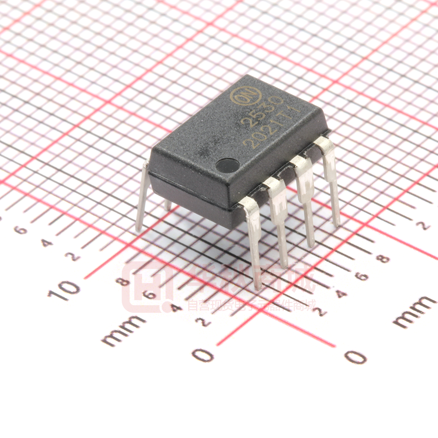

DATA SHEET www.onsemi.com 8-Pin DIP High Speed Transistor Optocouplers PDIP8 6.6x3.81, 2.54P CASE 646BW 8 1 Single-Channel: 6N135M, 6N136M, HCPL4503M Dual-Channel: HCPL2530M, HCPL2531M PDIP8 9.655x6.61, 2.54P CASE 646CQ 8 1 PDIP8 GW CASE 709AC 8 Description 1 The 6N135M, 6N136M, HCPL4503M, HCPL2530M, and HCPL2531M optocouplers consist of an AlGaAs LED optically coupled to a high speed photodetector transistor for each channel. A separate connection for the bias of the photodiode improves the speed by several orders of magnitude over conventional phototransistor optocouplers by reducing the base−collector capacitance of the input transistor. The HCPL4503M has no internal connection to the phototransistor base for improved noise immunity. An internal noise shield provides superior common mode rejection of up to 50,000 V/ms. Features • • • • • • • High Speed – 1 MBit/s Dual−Channel: HCPL2530M, HCPL2531M CTR Guaranteed 0°C to 70°C No Base Connection for Improved Noise Immunity (HCPL4503M) Superior CMR of 15,000 V/ms Minimum (HCPL4503M) Safety and Regulatory Approvals ♦ UL1577, 5,000 VACRMS for 1 Minute ♦ DIN EN/IEC60747−5−5 These are Pb−Free Devices 1 MARKING DIAGRAM ON 6N135 VXXYYB 6N135 = Device Number V = DIN EN/IEC60747−5−5 Option (only appears on component ordered with this option) XX = Two Digit Year Code, e.g., ‘15’ YY = Two Digit Work Week Ranging from ‘01’ to ‘53’ B = Assembly Package Code ORDERING INFORMATION See detailed ordering and shipping information on page 11 of this data sheet. Applications • • • • PDIP8 GW CASE 709AD 8 Line Receivers Pulse Transformer Replacement Output Interface to CMOS−LSTTL−TTL Wide−Bandwidth Analog Coupling Related Resources • https://www.onsemi.com/products/interfaces/high−performance−opto couplers • https://www.onsemi.com/products/interfaces/high−performance−opto couplers/high−performance−transistor−optocouplers/hcpl0500 • https://www.onsemi.com/products/interfaces/high−performance−opto couplers/high−performance−transistor−optocouplers/fodm452 • https://www.onsemi.com/products/interfaces/high−performance−opto couplers/low−voltage−high−performance−optocouplers/fod050l © Semiconductor Components Industries, LLC, 2008 September, 2021 − Rev. 2 1 Publication Order Number: HCPL2530M/D Single−Channel: 6N135M, 6N136M, HCPL4503M Dual−Channel: HCPL2530M, HCPL2531M SCHEMATICS 8 VCC N/C 1 + 1 8 VCC VF1 + 2 7 VB _ 2 6 VO _ 7 VO1 VF _ 3 3 6 VO2 VF2 N/C 4 + 4 5 GND 6N135M, 6N136M, HCPL4503M 5 GND HCPL2530M, HCPL2531M Pin 7 is not connected in the HCPL4503M Figure 1. Schematics SAFETY AND INSULATION RATINGS (As per DIN EN/IEC 60747−5−5, this optocoupler is suitable for “safe electrical insulation” only within the safety limit data. Compliance with the safety ratings shall be ensured by means of protective circuits.) Parameter Characteristics Installation Classifications per DIN VDE 0110/1.89 Table 1, For Rated Mains Voltage Climatic Classification
HCPL2530
物料型号: - 单通道光耦器:6N135M, 6N136M, HCPL4503M - 双通道光耦器:HCPL2530M, HCPL2531M
器件简介: 这些光耦器由一个AlGaAs LED与高速光敏晶体管隔离耦合组成,每个通道一个。光二极管偏置的独立连接通过减少输入晶体管的基极-集电极电容,提高了速度数个数量级。
引脚分配: - 6N135M, 6N136M, HCPL2530M, HCPL4503M的引脚分配如下: - 1: VCC - 2: N/C(无连接) - 3: VF1 - 4: VO1 - 5: VB - 6: GND - 7: VF2(HCPL4503M中不连接) - 8: GND
参数特性: - 高速:双通道HCPL2530M, HCPL2531M可达1 Mbps - CTR在0°C至70°C范围内保证 - 无基极连接以提高抗噪声能力(HCPL4503M) - 至少15,000 V/s的优越共模抑制比(HCPL4503M)
功能详解: 光耦器广泛应用于线路接收器、脉冲变压器替代、CMOS-LSTTL-TTL输出接口、宽带宽模拟耦合等。
应用信息: - 线路接收器 - 脉冲变压器替代 - CMOS-LSTTL-TTL输出接口 - 宽带宽模拟耦合
封装信息: - PDIP8 6.6x3.81, 2.54P CASE 646BW - PDIP8 9.655x6.61, 2.54P CASE 646CQ - PDIP8 GW CASE 709AC - PDIP8 GW CASE 709AD
