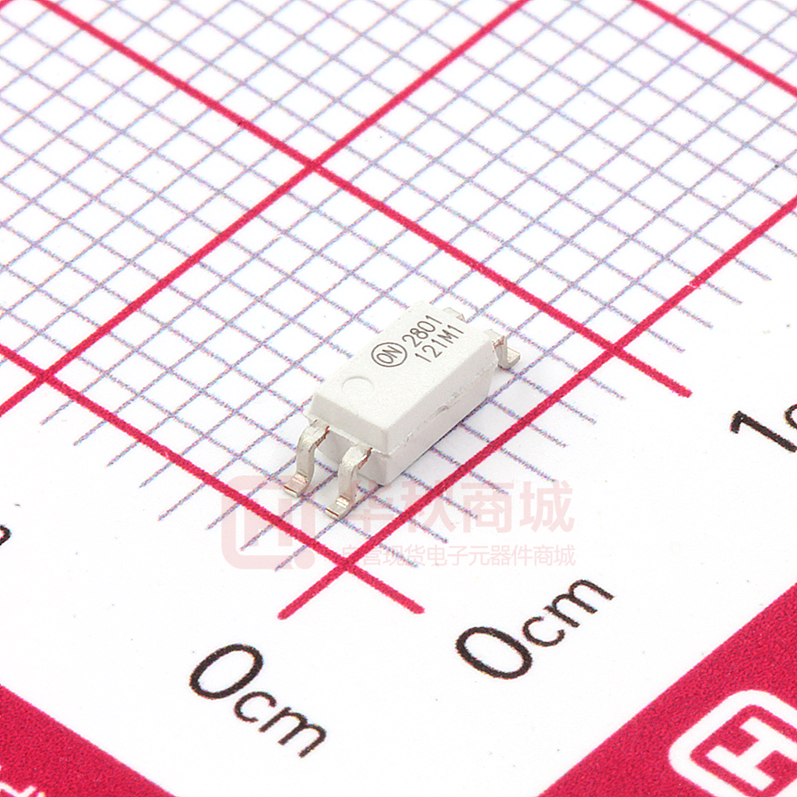

HMHA281, HMHA2801 Series 4-Pin Half-Pitch Mini-Flat Phototransistor Optocouplers Description The HMHA281 and HMHA2801 series devices consist of a gallium arsenide infrared emitting diode driving a silicon phototransistor in a compact 4−pin mini−flat package. The lead pitch is 1.27 mm. www.onsemi.com ANODE 1 Features • Compact 4−Pin Package 2.4 mm Maximum Standoff Height Half−Pitch Leads for Optimum Board Space Savings Current Transfer Ratio: ♦ HMHA281: 50% to 600% ♦ HMHA2801: 80% to 600% ♦ HMHA2801A: 80% to 160% ♦ HMHA2801B: 130% to 260% ♦ HMHA2801C: 200% to 400% Safety and Regulatory Approvals: ♦ UL1577, 3.750 VACRMS for 1 Minute ♦ DIN−EN/IEC60747−5−5, 565 V Peak Working Insulation Voltage These Devices are Pb−Free and are RoHS Compliant ♦ • • • 4 COLLECTOR CATHODE 2 3 EMITTER ♦ Phototransistor Optocoupler MPF4 CASE 100AL MARKING DIAGRAM Applications • • • • • Digital Logic Inputs Microprocessor Inputs Power Supply Monitor Twisted Pair Line Receiver Telephone Line Receiver ON 281 VXYYM1 ON 281 V X YY M1 = ON Semiconductor Logo = Device Number = DIN EN/IEC60747−5−5 Option (only appears on component ordered with this option) = One−Digit Year Code, e.g., ”5” = Digit Work Week, Ranging from ”01” to ”53” = Assembly Package Code ORDERING INFORMATION See detailed ordering and shipping information on page 7 of this data sheet. © Semiconductor Components Industries, LLC, 2011 August, 2018 − Rev. 6 1 Publication Order Number: HMHA2801B/D HMHA281, HMHA2801 Series Table 1. SAFETY AND INSULATION RATINGS (As per DIN EN/IEC 60747-5-5, this optocoupler is suitable for “safe electrical insulation” only within the safety limit data. Compliance with the safety ratings shall be ensured by means of protective circuits.) Characteristics Parameter Installation Classifications per DIN VDE 0110/1.89 Table 1, For Rated Mains Voltage < 150 VRMS I–IV < 300 VRMS I–III Climatic Classification 55/100/21 Pollution Degree (DIN VDE 0110/1.89) 2 Comparative Tracking Index Symbol 175 Value Unit Input−to−Output Test Voltage, Method A, VIORM x 1.6 = VPR, Type and Sample Test with tm = 10 s, Partial Discharge < 5 pC 904 Vpeak Input−to−Output Test Voltage, Method B, VIORM x 1.875 = VPR, 100% Production Test with tm = 1 s, Partial Discharge < 5 pC 1060 Vpeak VIORM Maximum Working Insulation Voltage 565 Vpeak VIOTM Highest Allowable Over−Voltage 4000 Vpeak External Creepage ≥5 mm External Clearance ≥5 mm VPR Parameter DTI Distance Through Insulation (Insulation Thickness) ≥0.4 mm TS Case Temperature (Note 1) 150 °C IS, INPUT Input Current (Note 1) 200 mA PS, OUTPUT Output Power (Note 1) 300 mW Insulation Resistance at TS, VIO = 500 V (Note 1) >109 W RIO 1. Safety limit values – maximum values allowed in the event of a failure. www.onsemi.com 2 HMHA281, HMHA2801 Series ABSOLUTE MAXIMUM RATINGS (TC = 25°C, Unless otherwise specified) Symbol Parameter Value Unit TOTAL PACKAGE TSTG Storage Temperature −55 to +125 °C TOPR Operating Temperature −55 to +100 °C TJ Junction Temperature −40 to +125 °C PD Total Device Power Dissipation @ TA = 25°C 210 mW Derate Above 25°C 2.1 mW/°C IF (avg) Continuous Forward Current 50 mA IF (pk) Peak Forward Current (1 ms pulse, 300 pps) 1 A VR Reverse Input Voltage 6 V PD LED Power Dissipation @ TA = 25°C 60 mW Derate Above 25°C 0.6 mW/°C Continuous Collector Current 50 mA VCEO Collector−Emitter Voltage 80 V VECO Emitter−Collector Voltage 7 V Detector Power Dissipation @ TA = 25°C 150 mW Derate Above 25°C 1.5 mW/°C EMITTER DETECTOR IC PD Stresses exceeding those listed in the Maximum Ratings table may damage the device. If any of these limits are exceeded, device functionality should not be assumed, damage may occur and reliability may be affected. www.onsemi.com 3 HMHA281, HMHA2801 Series ELECTRICAL CHARACTERISTICS (TA = 25°C) Parameter Symbol Test Conditions Device Min Typ Max Unit INDIVIDUAL COMPONENT CHARACTERISTICS Emitter VF Forward Voltage IF = 10 mA All 1.0 − 1.3 V IR Reverse Current VR = 5 V All − − 5 mA BVCEO Breakdown Voltage Collector to Emitter IC = 0.5 mA, IF = 0 All 80 − − V BVECO Emitter to Collector IE = 100 mA, IF = 0 All 7 − − ICEO Collector Dark Current VCE = 80 V, IF = 0 All − − 100 nA CCE Capacitance VCE = 0 V, f = 1 MHz All − 10 − pF IF = 5 mA, VCE = 5 V HMHA281 50 − 600 % HMHA2801 80 − 600 HMHA2801A 80 − 160 HMHA2801B 130 − 260 HMHA2801C 200 − 400 IF = 8 mA, IC = 2.4 mA HMHA281 − − 0.4 IF = 10 mA, IC = 2 mA HMHA2801, HMHA2801A, HMHA2801B, HMHA2801C − − 0.3 Detector TRANSFER CHARACTERISTICS CTR VCE (SAT) DC Current Transfer Ratio Saturation Voltage tr Rise Time (Non−Saturated) IC = 2 mA, VCE = 5 V, RL = 100 W All − 3 − tf Fall Time (Non−Saturated) IC = 2 mA, VCE = 5 V, RL = 100 W All − 3 − 1 Minute All 3750 − − V ms ISOLATION CHARACTERISTICS VISO Steady State Isolation Voltage VACRMS Product parametric performance is indicated in the Electrical Characteristics for the listed test conditions, unless otherwise noted. Product performance may not be indicated by the Electrical Characteristics if operated under different conditions. www.onsemi.com 4 HMHA281, HMHA2801 Series TYPICAL PERFORMANCE CHARACTERISTICS 100 TA = 25°C IC, Collector Current (mA) IF, Forward Current (mA) 100 10 1 0.6 0.8 1.0 1.2 1.4 VF, Forward Voltage (V) VCE = 0.4 V 1 0.1 1.6 Normalized CTR (IF) / CTR (5 mA) IC / IF, Current Transfer Ratio (%) TA = 25°C VCE = 10 V VCE = 5 V 100 VCE = 0.4 V 10 IF, Forward Current (mA) 1 2.0 1.5 IF = 10 mA IF = 5 mA 1.0 0.0 −0.5 −40 100 −20 0 20 40 60 80 TA, Ambient Temperature (5C) VCE = 5 V IF = 5 mA IF = 10 mA IF = 1 mA 1 IF = 0.5 mA −20 0 100 Figure 4. Normalized CTR vs. Temperature IF = 25 mA 10 Normalized to: IF = 5 mA VCE = 5 V TA = 25°C IF = 0.5 mA IF = 1 mA 100 0.1 −40 100 0.5 Figure 3. Current Transfer Ratio vs. Forward Current IC, Collector Current (mA) 10 IF, Forward Current (mA) Figure 2. Collector Current vs. Forward Current 1000 1 VCE = 5 V 10 Figure 1. Forward Current vs. Forward Voltage 10 VCE = 10 V 20 40 60 80 100 TA, Ambient Temperature (5C) Figure 5. Collector Current vs. Temperature www.onsemi.com 5 HMHA281, HMHA2801 Series TYPICAL PERFORMANCE CHARACTERISTICS (Continued) 18 TA = 25°C IF = 40 mA 40 IF = 50 mA IF = 30 mA IF = 20 mA 30 IF = 10 mA IF = 5.0 mA 20 10 0 1 2 3 4 5 6 7 8 9 VCE, Collector−Emitter Voltage, (V) IF = 20 mA 12 10 8 IF = 0.5 mA IF = 10 mA 6 4 IF = 2 mA 2 0 0.0 10 1000 Switching Time (ms) VCE = 10 V 20 40 60 80 TA, Ambient Temperature (5C) 0.26 tON 1 0.1 100 tOFF 10 Figure 8. Collector Dark Current vs. Temperature 0.28 1 10 RL, Load Resistance (kW) IF = 5 mA IC = 1 mA 0.22 0.20 0.18 0.16 0.14 0.12 −40 −20 100 Figure 9. Switching Time vs. Load Resistance 0.24 0.10 1.0 tS VCE = 5 V 0.30 TA = 25°C IF = 16 mA VCC = 5 V 100 0.1 VCE(SAT), Collector−Emitter Saturation Voltage (V) ICEO, Collector Dark Current (mA) VCE = 48 V VCE = 24 V 0.001 0 IF = 1.0 mA Figure 7. Collector Current vs. Collector−Emiter Voltage 10 0.01 IF = 5.0 mA 0.2 0.4 0.6 0.8 VCE, Collector−Emitter Voltage, (V) Figure 6. Collector Current vs. Collector−Emiter Voltage 1 IF = 50 mA IF = 30 mA 14 IF = 1.0 mA 0 IF = 40 mA 16 IC, Collector Current (mA) IC, Collector Current (mA) 50 0 20 40 60 80 100 TA, Ambient Temperature (5C) Figure 10. Collector−Emitter Saturation Voltage vs Temperature www.onsemi.com 6 HMHA281, HMHA2801 Series REFLOW PROFILE 260 245 240 220 Max. Ramp−up Rate = 3°C/S Max. Ramp−down Rate = 6°C/S TP tP TL Tsmax 200 tL Temperature (5C) 180 160 Tsmin 140 ts 120 100 80 60 40 20 0 120 Time 25°C to Peak 240 360 Figure 11. Reflow Profile Profile Freature Pb−Free Assembly Profile Temperature Minimum (Tsmin) 150°C Temperature Maximum (Tsmax) 200°C Time (tS) from (Tsmin to Tsmax) 60 – 120 seconds Ramp−up Rate (tL to tP) 3°C / second maximum Liquidous Temperature (TL) 217°C Time (tL) Maintained Above (TL) 60 – 150 seconds Peak Body Package Temperature 245°C +0°C / –5°C Time (tP) within 5°C of 245°C 30 seconds Ramp−down Rate (TP to TL) 6°C / second maximum Time 25°C to Peak Temperature 8 minutes maximum ORDERING INFORMATION Part Number Package Shipping† HMHA2801 Half Pitch Mini−Flat 4−Pin 100 Units / Tube HMHA2801R2 Half Pitch Mini−Flat 4−Pin 2500 / Tape & Reel HMHA2801V Half Pitch Mini−Flat 4−Pin, DIN EN/IEC60747−5−5 Option 100 Units / Tube HMHA2801R2V Half Pitch Mini−Flat 4−Pin, DIN EN/IEC60747−5−5 Option 2500 / Tape & Reel †For information on tape and reel specifications, including part orientation and tape sizes, please refer to our Tape and Reel Packaging Specifications Brochure, BRD8011/D. www.onsemi.com 7 MECHANICAL CASE OUTLINE PACKAGE DIMENSIONS MFP4 2.5X4.4, 1.27P CASE 100AL ISSUE O DATE 31 AUG 2016 0.3−0.51 2 1 1.52 0.61 3 4.83 7.87 4.40 (Typ) 6.30−7.29 PIN ONE 4 0.55−0.75 2.31−2.69 1.27 2.39 (Max) LAND PATTERN RECOMMENDATION 1.95−2.11 0−0.20 R0.15 (Typ) 2̇\:̇ R0.15 (Typ) 1.27+/− .127 0.30−0.89 0.18−0.25 1.19 (Typ) NOTES: A) NO STANDARD APPLIES TO THIS PACKAGE B) ALL DIMENSIONS ARE IN MILLIMETERS. C) DIMENSIONS ARE EXCLUSIVE OF BURRS, MOLD FLASH, AND TIE BAR EXTRUSION DOCUMENT NUMBER: STATUS: 98AON13485G ON SEMICONDUCTOR STANDARD NEW STANDARD: © Semiconductor Components Industries, LLC, 2002 October, DESCRIPTION: 2002 − Rev. 0 MFP4 2.5X4.4, 1.27P http://onsemi.com 1 Electronic versions are uncontrolled except when accessed directly from the Document Repository. Printed versions are uncontrolled except when stamped “CONTROLLED COPY” in red. Case Outline Number: PAGE 1 OFXXX 2 DOCUMENT NUMBER: 98AON13485G PAGE 2 OF 2 ISSUE O REVISION RELEASED FOR PRODUCTION FROM FAIRCHILD MFP04A TO ON SEMICONDUCTOR. REQ. BY B. MARQUIS. DATE 31 AUG 2016 ON Semiconductor and are registered trademarks of Semiconductor Components Industries, LLC (SCILLC). SCILLC reserves the right to make changes without further notice to any products herein. SCILLC makes no warranty, representation or guarantee regarding the suitability of its products for any particular purpose, nor does SCILLC assume any liability arising out of the application or use of any product or circuit, and specifically disclaims any and all liability, including without limitation special, consequential or incidental damages. “Typical” parameters which may be provided in SCILLC data sheets and/or specifications can and do vary in different applications and actual performance may vary over time. All operating parameters, including “Typicals” must be validated for each customer application by customer’s technical experts. SCILLC does not convey any license under its patent rights nor the rights of others. SCILLC products are not designed, intended, or authorized for use as components in systems intended for surgical implant into the body, or other applications intended to support or sustain life, or for any other application in which the failure of the SCILLC product could create a situation where personal injury or death may occur. Should Buyer purchase or use SCILLC products for any such unintended or unauthorized application, Buyer shall indemnify and hold SCILLC and its officers, employees, subsidiaries, affiliates, and distributors harmless against all claims, costs, damages, and expenses, and reasonable attorney fees arising out of, directly or indirectly, any claim of personal injury or death associated with such unintended or unauthorized use, even if such claim alleges that SCILLC was negligent regarding the design or manufacture of the part. SCILLC is an Equal Opportunity/Affirmative Action Employer. This literature is subject to all applicable copyright laws and is not for resale in any manner. © Semiconductor Components Industries, LLC, 2016 August, 2016 − Rev. O Case Outline Number: 100AL ON Semiconductor and are trademarks of Semiconductor Components Industries, LLC dba ON Semiconductor or its subsidiaries in the United States and/or other countries. ON Semiconductor owns the rights to a number of patents, trademarks, copyrights, trade secrets, and other intellectual property. A listing of ON Semiconductor’s product/patent coverage may be accessed at www.onsemi.com/site/pdf/Patent−Marking.pdf. ON Semiconductor reserves the right to make changes without further notice to any products herein. ON Semiconductor makes no warranty, representation or guarantee regarding the suitability of its products for any particular purpose, nor does ON Semiconductor assume any liability arising out of the application or use of any product or circuit, and specifically disclaims any and all liability, including without limitation special, consequential or incidental damages. Buyer is responsible for its products and applications using ON Semiconductor products, including compliance with all laws, regulations and safety requirements or standards, regardless of any support or applications information provided by ON Semiconductor. “Typical” parameters which may be provided in ON Semiconductor data sheets and/or specifications can and do vary in different applications and actual performance may vary over time. All operating parameters, including “Typicals” must be validated for each customer application by customer’s technical experts. ON Semiconductor does not convey any license under its patent rights nor the rights of others. ON Semiconductor products are not designed, intended, or authorized for use as a critical component in life support systems or any FDA Class 3 medical devices or medical devices with a same or similar classification in a foreign jurisdiction or any devices intended for implantation in the human body. Should Buyer purchase or use ON Semiconductor products for any such unintended or unauthorized application, Buyer shall indemnify and hold ON Semiconductor and its officers, employees, subsidiaries, affiliates, and distributors harmless against all claims, costs, damages, and expenses, and reasonable attorney fees arising out of, directly or indirectly, any claim of personal injury or death associated with such unintended or unauthorized use, even if such claim alleges that ON Semiconductor was negligent regarding the design or manufacture of the part. ON Semiconductor is an Equal Opportunity/Affirmative Action Employer. This literature is subject to all applicable copyright laws and is not for resale in any manner. PUBLICATION ORDERING INFORMATION LITERATURE FULFILLMENT: Literature Distribution Center for ON Semiconductor 19521 E. 32nd Pkwy, Aurora, Colorado 80011 USA Phone: 303−675−2175 or 800−344−3860 Toll Free USA/Canada Fax: 303−675−2176 or 800−344−3867 Toll Free USA/Canada Email: orderlit@onsemi.com ◊ N. American Technical Support: 800−282−9855 Toll Free USA/Canada Europe, Middle East and Africa Technical Support: Phone: 421 33 790 2910 ON Semiconductor Website: www.onsemi.com Order Literature: http://www.onsemi.com/orderlit For additional information, please contact your local Sales Representative

物料型号:HMHA281, HMHA2801系列
器件简介:这些设备由镓砷化物红外发光二极管驱动硅光晶体管,封装在紧凑的4引脚Mini-Flat包中,引脚间距为1.27毫米。
引脚分配:文档中提供了引脚分配图,包括阳极、集电极、阴极和发射极。
参数特性: - 紧凑的4引脚封装 - 最大2.4毫米的引线突出高度 - 电流传输比率:HMHA281为50%至600%,HMHA2801为80%至600%,不同型号有不同范围 - 安全和监管认证:UL1577,3.750 VACRMS 1分钟 - 符合无铅和RoHS标准
功能详解: - 适用于数字逻辑输入、微处理器输入、电源监控、双绞线接收器、电话线接收器等应用。
应用信息: - 适用于多种应用,包括数字逻辑输入、微处理器输入、电源监控等。
封装信息: - 提供了详细的机械案例轮廓和封装尺寸,以及引脚图案推荐。
