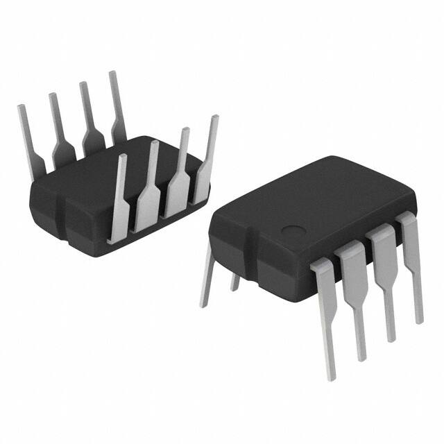

    低偏置电压双比较器 PDIP8_10.16X7.11MM
LM393NG 数据手册
LM393, LM293, LM2903, LM2903V, NCV2903 Low Offset Voltage Dual Comparators The LM393 series are dual independent precision voltage comparators capable of single or split supply operation. These devices are designed to permit a common mode range−to−ground level with single supply operation. Input offset voltage specifications as low as 2.0 mV make this device an excellent selection for many applications in consumer, automotive, and industrial electronics. Features http://onsemi.com • • • • • • • • • • • • 8 1 PDIP−8 N SUFFIX CASE 626 Wide Single−Supply Range: 2.0 Vdc to 36 Vdc Split−Supply Range: ±1.0 Vdc to ±18 Vdc Very Low Current Drain Independent of Supply Voltage: 0.4 mA Low Input Bias Current: 25 nA Low Input Offset Current: 5.0 nA Low Input Offset Voltage: 5.0 mV (max) LM293/393 Input Common Mode Range to Ground Level Differential Input Voltage Range Equal to Power Supply Voltage Output Voltage Compatible with DTL, ECL, TTL, MOS, and CMOS Logic Levels ESD Clamps on the Inputs Increase the Ruggedness of the Device without Affecting Performance NCV Prefix for Automotive and Other Applications Requiring Site and Control Changes Pb−Free Packages are Available VCC + Input − Input Output 8 1 SOIC−8 D SUFFIX CASE 751 Micro8E DM SUFFIX CASE 846A 8 1 PIN CONNECTIONS Output A Inputs A GND 1 2 8 7 − + 3 4 VCC Output B Inputs B − +5 6 (Top View) R2 2.1 k Q3 F1 R4 2.0 k Q4 Q5 Q6 Q14 DEVICE MARKING AND ORDERING INFORMATION See detailed marking information and ordering and shipping information on pages 6 and 7 of this data sheet. Q10 Q1 Q2 R1 4.6 k Q11 Q8 Q9 Q12 Q15 Q16 Figure 1. Representative Schematic Diagram (Diagram shown is for 1 comparator) © Semiconductor Components Industries, LLC, 2006 1 March, 2006 − Rev. 17 Publication Order Number: LM393/D LM393, LM293, LM2903, LM2903V, NCV2903 MAXIMUM RATINGS Rating Power Supply Voltage Input Differential Voltage Range Input Common Mode Voltage Range Output Short Circuit−to−Ground Output Sink Current (Note 1) Power Dissipation @ TA = 25°C Derate above 25°C Operating Ambient Temperature Range LM293 LM393 LM2903 LM2903V, NCV2903 (Note 2) Maximum Operating Junction Temperature LM393, 2903, LM2903V LM293, NCV2903 Storage Temperature Range ESD Protection at any Pin (Note 3) − Human Body Model − Machine Model Symbol VCC VIDR VICR ISC ISink PD 1/RqJA TA −25 to +85 0 to +70 −40 to +105 −40 to +125 TJ(max) 150 150 Tstg VESD 1500 150 −65 to +150 °C V °C Value +36 or ±18 36 −0.3 to +36 Continuous 20 570 5.7 Unit Vdc Vdc Vdc mA mW mW/°C °C Maximum ratings are those values beyond which device damage can occur. Maximum ratings applied to the device are individual stress limit values (not normal operating conditions) and are not valid simultaneously. If these limits are exceeded, device functional operation is not implied, damage may occur and reliability may be affected. 1. The maximum output current may be as high as 20 mA, independent of the magnitude of VCC, output short circuits to VCC can cause excessive heating and eventual destruction. 2. NCV2903 is qualified for automotive use. 3. VESD rating for NCV/SC devices is: Human Body Model − 2000 V; Machine Model − 200 V. http://onsemi.com 2 LM393, LM293, LM2903, LM2903V, NCV2903 ELECTRICAL CHARACTERISTICS (VCC = 5.0 Vdc, Tlow ≤ TA ≤ Thigh, unless otherwise noted.) LM293, LM393 Characteristic Input Offset Voltage (Note 5) TA = 25°C Tlow ≤ TA ≤ Thigh Input Offset Current TA = 25°C Tlow ≤ TA ≤ Thigh Input Bias Current (Note 6) TA = 25°C Tlow ≤ TA ≤ Thigh Input Common Mode Voltage Range (Note 6) TA = 25°C Tlow ≤ TA ≤ Thigh Voltage Gain RL ≥ 15 kW, VCC = 15 Vdc, TA = 25°C Large Signal Response Time Vin = TTL Logic Swing, Vref = 1.4 Vdc VRL = 5.0 Vdc, RL = 5.1 kW, TA = 25°C Response Time (Note 8) VRL = 5.0 Vdc, RL = 5.1 kW, TA = 25°C Input Differential Voltage (Note 9) All Vin ≥ GND or V− Supply (if used) Output Sink Current Vin ≥ 1.0 Vdc, Vin+ = 0 Vdc, VO ≤ 1.5 Vdc TA = 25°C Output Saturation Voltage Vin ≥ 1.0 Vdc, Vin+ = 0, ISink ≤ 4.0 mA, TA = 25°C Tlow ≤ TA ≤ Thigh Output Leakage Current Vin− = 0 V, Vin+ ≥ 1.0 Vdc, VO = 5.0 Vdc, TA = 25°C Vin− = 0 V, Vin+ ≥ 1.0 Vdc, VO = 30 Vdc, Tlow ≤ TA ≤ Thigh Supply Current RL = ∞ Both Comparators, TA = 25°C RL = ∞ Both Comparators, VCC = 30 V Symbol VIO − − IIO − − IIB − − VICR 0 0 AVOL − 50 − − − 200 300 VCC −1.5 VCC −2.0 − − 0 0 25 − − − 200 300 VCC −1.5 VCC −2.0 − − V/mV ns 25 − 250 400 − − 25 200 250 500 V Min Typ ±1.0 − ±5.0 − Max ±5.0 9.0 ±50 ±150 LM2903, LM2903V, NCV2903 Min − − − − Typ ±2.0 9.0 ±5.0 ±50 Max ±7.0 15 nA ±50 ±200 nA Unit mV tTLH VID ISink VOL − − 6.0 1.3 − 16 − VCC − − − 6.0 1.5 − 16 − VCC − ms V mA mV − − IOL − − ICC − − 150 − 0.1 − 0.4 − 400 700 − 1000 1.0 2.5 − − − − − − − 200 0.1 − 0.4 − 400 700 nA − 1000 mA 1.0 2.5 LM293 Tlow = −25°C, Thigh = +85°C LM393 Tlow = 0°C, Thigh = +70°C LM2903 Tlow = −40°C, Thigh = +105°C LM2903V & NCV2903 Tlow = −40°C, Thigh = +125°C NCV2903 is qualified for automotive use. 4. The maximum output current may be as high as 20 mA, independent of the magnitude of VCC, output short circuits to VCC can cause excessive heating and eventual destruction. 5. At output switch point, VO]1.4 Vdc, RS = 0 W with VCC from 5.0 Vdc to 30 Vdc, and over the full input common mode range (0 V to VCC = −1.5 V). 6. Due to the PNP transistor inputs, bias current will flow out of the inputs. This current is essentially constant, independent of the output state, therefore, no loading changes will exist on the input lines. 7. Input common mode of either input should not be permitted to go more than 0.3 V negative of ground or minus supply. The upper limit of common mode range is VCC −1.5 V. 8. Response time is specified with a 100 mV step and 5.0 mV of overdrive. With larger magnitudes of overdrive faster response times are obtainable. 9. The comparator will exhibit proper output state if one of the inputs becomes greater than VCC, the other input must remain within the common mode range. The low input state must not be less than −0.3 V of ground or minus supply. http://onsemi.com 3 LM393, LM293, LM2903, LM2903V, NCV2903 LM293/393 80 IIB , INPUT BIAS CURRENT (nA) 70 60 50 40 30 20 10 0 0 5.0 10 15 20 25 30 VCC, SUPPLY VOLTAGE (Vdc) 35 40 TA = +25° C TA = +125°C TA = −55° C TA = 0° C TA = +70° C IIB , INPUT BIAS CURRENT (nA) 80 70 60 50 40 30 20 10 0 0 5.0 10 15 20 25 VCC, SUPPLY VOLTAGE (Vdc) 30 35 40 TA = 0° C TA = +25° C TA = +85° C TA = −40° C LM2903 Figure 2. Input Bias Current versus Power Supply Voltage Figure 3. Input Bias Current versus Power Supply Voltage VOL , SATURATION VOLTAGE (Vdc) VOL , SATURATION VOLTAGE (Vdc) 10 Out of Saturation TA = +125°C TA = +25° C 10 Out of Saturation 1.0 1.0 TA = +85° C 0.1 TA = +25° C 0.1 TA = −55° C 0.01 0.01 TA = −40° C 0.1 TA = 0° C 0.001 0.01 0.1 1.0 10 100 0.001 0.01 1.0 10 100 ISink, OUTPUT SINK CURRENT (mA) ISink, OUTPUT SINK CURRENT (mA) Figure 4. Output Saturation Voltage versus Output Sink Current Figure 5. Output Saturation Voltage versus Output Sink Current 1.0 ICC , SUPPLY CURRENT (mA) 0.8 TA = 0° C TA = +25° C ICC , SUPPLY CURRENT (mA) TA = −55° C 1.2 1.0 0.8 TA = −40° C TA = 0° C TA = +25° C 0.6 0.4 0.2 0 TA = +70° C TA = +125°C RL = R 5.0 10 15 20 25 30 35 40 0.6 0.4 0 5.0 10 15 20 25 TA = +85° C RL = R 30 35 40 VCC, SUPPLY VOLTAGE (Vdc) VCC, SUPPLY VOLTAGE (Vdc) Figure 6. Power Supply Current versus Power Supply Voltage Figure 7. Power Supply Current versus Power Supply Voltage http://onsemi.com 4 LM393, LM293, LM2903, LM2903V, NCV2903 APPLICATIONS INFORMATION These dual comparators feature high gain, wide bandwidth characteristics. This gives the device oscillation tendencies if the outputs are capacitively coupled to the inputs via stray capacitance. This oscillation manifests itself during output transitions (VOL to VOH). To alleviate this situation, input resistors
