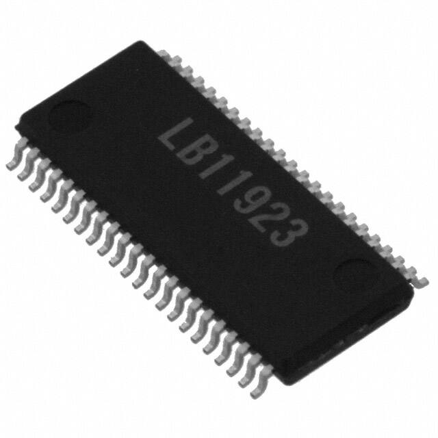

LV8104V-TLM-H 数据手册
Ordering number : ENA1677 LV8104V Bi-CMOS IC For Variable Speed Control http://onsemi.com Three-Phase Brushless Motor Predriver Overview The LV8104V is a pre-driver IC designed for variable speed control of 3-phase brushless motors. It can be used to implement both upper and low output N-channel power FET drive circuit using a built-in charge pump circuit. High-efficiency drive is possible through the use of direct PWM drive and synchronous rectifyication. Functions • VCC max = VG max = 42V • Three-phase bipolar direct PWM drive • Built-in charge pump for the upper side gate drive voltage generation • Speed discriminator and PLL speed control system • High efficiency drive by synchronous rectification • 5V regulator output • Start/Stop switching circuit(power save state in a stop mode) • Forward/reverse switching circuit • Braking circuit (short braking) • Built-in FG amplifier and integrating amplifier • Built-in VCO circuit • Speed lock detection output • Current limiter • Constaint protection circuit • Clock disconnection protection circuit • Thermal shutdown protection circuit • Low-voltage protection circuit Semiconductor Components Industries, LLC, 2013 May, 2013 31710 SY 20100219-S00001 No.A1677-1/19 LV8104V Specifications Absolute Maximum Ratings at Ta = 25°C Parameter Symbol Conditions Ratings Unit Supply voltage VCC max Charge pump output voltage VG max VCC = VG VG pin Output current IO max1 Pins UL, VL, WL -15 to 15 mA IO max2 Pins UH, VH, WH, UOUT, VOUT and WOUT -15 to 15 mA Pd max1 Independent IC 0.65 W Pd max2 Mounted on the specified board * 1.70 W Allowable power dissipation 42 V 42 V Operating temperature Topr -20 to +80 °C Storage temperature Tstg -55 to +150 °C * Specified board:114.3mm × 76.1mm × 1.6mm, glass epoxy board. Stresses exceeding Maximum Ratings may damage the device. Maximum Ratings are stress ratings only. Functional operation above the Recommended Operating Conditions is not implied. Extended exposure to stresses above the Recommended Operating Conditions may affect device reliability. Allowable Operating range at Ta = 25°C Parameter Symbol Conditions Ratings Unit Supply voltage range VCC 16 to 28 V 5V constant voltage output current IREG 0 to -10 mA LD pin applied voltage VLD ILD 0 to 6 V 0 to 5 mA VFGS IFGS 0 to 6 V 0 to 5 mA LD pin output current FGS pin applied voltage FGS pin output current Electrical Characteristics at Ta = 25°C, VCC = 24V Parameter Symbol Supply current 1 ICC1 Supply current 2 ICC2 Conditions Ratings min typ Unit max 6.5 8.2 mA 3 3.8 mA 5.6 6.0 V 10 50 mV 10 50 mV VREG-0.48 VREG-0.35 VREG-0.22 V 0.19 0.30 0.41 V VG-0.65 VG-0.5 VG-0.35 V 0.45 0.6 0.8 V 16 20 24 kHz 1.79 2.24 2.69 MHz VCC+7.9 VCC+9.0 VCC+10.0 V VCC-1.45 0.5 VCC-1.1 VCC-0.8 0.8 V 0.65 112 140 168 -2 -0.1 At stop 5V Constant-voltage Output (VREG pin) Output voltage VREG Line regulation ΔV (REG1) Load regulation ΔV (REG2) IO = 5mA VCC = 16 to 28V IO = -5 to -10mA 5.2 Output block / Conditions : apply a VG voltage of 33V High level output voltage 1 VOH1 Pins UL, VL and WL Low level output voltage 1 VOL1 VOH2 Pins UL, VL and WL High level output voltage 2 Low level output voltage 2 PWM frequency VOL2 f (PWM) Pins UH, VH and WH Pins UH, VH and WH IOH = -2mA IOL = 2mA IOH = -2mA IOL = 2mA Internal Oscillator Oscillation frequency f (REF) Charge Pump Output (VG pin) Output voltage VGOUT CP1 pin High level output voltage VOH (CP1) ICP1 = -2mA Low level output voltage VOL (CP1) f (CP1) ICP1 = 2mA Charge pump frequency V kHz Hall Amplifier Input bias current Common-mode input voltage range 1 IB (HA) VICM1 When using Hall elements Common-mode input voltage range 2 VICM2 At one-side input bias (Hall IC application) Hall input sensitivity SIN wave Input voltage Low → High ΔVIN (HA) VSLH Input voltage High → Low VSHL Hysteresis width μA 0.3 3.5 V 0 VREG V 50 mVp-p 5 13 24 mV 2 7 12 mV -12 -6 -2 mV Continued on next page. No.A1677-2/19 LV8104V Continued from preceding page. Parameter Symbol Conditions Ratings min typ Unit max FG Amplifier Input offset voltage VIO (FG) Input bias current IB (FG) Reference voltage VB (FG) High level output voltage VOH (FG) Low level output voltage VOL (FG) -10 mV 1 μA -5% VREG/2 5% V IFGI = -0.1mA, No load 3.95 4.4 4.85 V IFGI = 0.1mA, No load 0.75 1.2 1.65 -1 FG input sensitivity GAIN : 100 times Schmitt width of the next stage One-side hysteresis comparator 3 fFG = 2kHz V mV 120 200 45 48 Operation frequency range Open-loop gain 10 280 mV 3 kHz dB FGS output Output saturation voltage VOL (FGS) IFGS = 2mA Output leakage current IL (FGS) VO = 6V 0.2 0.4 V 10 μA 3.9 V CSD oscillator High level output voltage VOH (CSD) Low level output voltage VOL (CSD) Amplitude V (CSD) External capacitor charge current ICHG1 External capacitor discharge current ICHG2 Oscillation frequency f (CSD) 2.9 3.4 1.6 2.0 2.4 V 1.15 1.4 1.65 Vp-p -13 -10 -7 μA 7.5 10.5 13.5 μA C = 0.047μF 78 Hz Speed Discriminator output High level output voltage VOH (D) VREG-1.25 VREG-1.0 VREG-0.75 V Low level output voltage VOL (D) 0.65 0.9 1.15 V Counts 512 LD output Output saturation voltage VOL (LD) ILD = 2mA Output leakage current IL (LD) VO = 6V Lock range 0.2 -6.25 0.4 V 10 μA +6.25 % Speed control PLL output High level output voltage VOH (P) VREG-2.0 VREG-1.7 VREG-1.4 V Low level output voltage VOL (P) 1.3 1.6 1.9 V GDF 0.20 0.25 0.32 VRF 0.225 0.25 0.27 Current control circuit Drive gain Current limiter operation Limiter voltage V Integrator Input offset voltage VIO (INT) Input bias current IB (INT) Reference voltage VB (INT) High level output voltage VOH (INT) Low level output voltage VOL (INT) Open-loop gain -10 -1 10 mV 1 μA -5% VREG/2 5% V IINTI = -0.1mA, No load 3.95 4.4 4.85 V IINTI = 0.1mA, No load 0.75 1.2 1.65 45 48 fINT = 2kHz V dB VCO Oscillator (C pin) Oscillation frequency range f (C) C = 120pF, R = 24kΩ 0.15 1.54 MHz High level output voltage VOH (C) FIL = 2.5V 2.71 3.16 3.61 V Low level output voltage VOL (C) FIL = 2.5V 2.20 2.60 3.00 V Amplitude V (C) FIL = 2.5V 0.44 0.56 0.68 Vp-p FIL pin Output source current IOH (FIL) -15 -11 -6 μA Output sink current IOL (FIL) 6 10 15 μA Continued on next page. No.A1677-3/19 LV8104V Continued from preceding page. Parameter Symbol Conditions Ratings min typ Unit max Low-voltage protection circuit Operation voltage VLVSD 10.0 10.7 11.4 V Hysteresis width ΔVLVSD 0.72 0.97 1.22 V 150 175 °C 30 °C Thermal shutdown operation Thermal shutdown operation TSD Design target value* ΔTSD Design target value* temperature Hysteresis width CLK pin Input frequency fI (CLK) High level input voltage range VIH (CLK) 2.0 VREG 3 kHz V Low level input voltage range VIL (CLK) 0 1.0 V Input open voltage VIO (CLK) VREG-0.5 VREG V Hysteresis width VIS (CLK) Design target value* 0.18 0.27 0.36 V High level input current IIH (CLK) VCLK = 5V -22 -10 -3 μA Low level input current IIL (CLK) VCLK = 0V -133 -93 -70 μA Pull-up resistance RU (CLK) 45 60 75 kΩ VIH (S/S) 2.0 VREG V V S/S pin High level input voltage range Low level input voltage range VIL (S/S) 0 1.0 Input open voltage VIO (S/S) VREG-0.5 VREG V Hysteresis width VIS (S/S) 0.18 0.27 0.36 V μA High level input current IIH (S/S) VS/S = 5V -22 -10 -3 Low level input current IIL (S/S) VS/S = 0V -133 -93 -70 μA Pull-up resistance RU (S/S) 45 60 75 kΩ High level input voltage range VIH (F/R) 2.0 VREG V Low level input voltage range VIL (F/R) 0 1.0 V Input open voltage VIO (F/R) VREG-0.5 VREG V F/R pin Hysteresis width VIS (F/R) 0.18 0.27 0.36 V High level input current IIH (F/R) VF/R = 5V -22 -10 -3 μA Low level input current IIL (F/R) VF/R = 0V -133 -93 -70 μA Pull-up resistance RU (F/R) 45 60 75 kΩ VIH (BR) 2.0 VREG V V BR pin High level input voltage range Low level input voltage range VIL (BR) 0 1.0 Input open voltage VIO (BR) VREG-0.5 VREG V Hysteresis width VIS (BR) 0.18 0.27 0.36 V μA High level input current IIH (BR) VBR = 5V -22 -10 -3 Low level input current IIL (BR) VBR = 0V -133 -93 -70 μA Pull-up resistance RU (BR) 45 60 75 kΩ Note : * These items are design target values and are not tested. No.A1677-4/19 LV8104V Package Dimensions unit : mm (typ) 3277 15.0 0.5 5.6 7.6 23 44 1 0.65 0.2 0.1 (1.5) 1.7max (0.68) 22 0.22 SANYO : SSOP44(275mil) Pd max - Ta Allowable power dissipation, Pd max - W 2.0 1.7 Specified board : 114.3 × 76.1 × 1.6mm3 glass epoxy Mounted on a board 1.5 1.0 0.95 0.65 Independent IC 0.5 0.36 0 —20 0 20 40 60 80 100 Ambient temperature, Ta - C IN3+ IN3- IN2+ IN2IN1+ 35 34 RFGND 36 UL 37 RF VH 38 33 32 31 30 29 28 27 26 25 24 23 21 22 UH WL 39 UOUT WOUT 40 VL WH 41 VOUT NC 42 NC VG 44 43 VCC CP2 CP1 Pin Assignment 12 13 14 15 16 17 18 19 20 POUT S/S BR FGS LD FGIN+ IN1- 11 FGOUT FGIN- 10 F/R 9 CLK 8 DOUT C 7 INTREF GND1 6 INTIN GND2 5 CSD 4 INTOUT 3 R 2 FIL 1 VREG LV8104 No.A1677-5/19 LV8104V Three-phase logic truth table (A high level input is the state where IN+ > IN-.) F/R = “L” F/R = “H” IN1 Drive output IN1 IN2 IN3 IN2 IN3 Upper gate Lower gate 1 H L H L H L VH UL 2 H L L L H H WH UL 3 H H L L L H WH VL 4 L H L H L H UH VL 5 L H H H L L UH WL 6 L L H H H L VH WL S/S Input BR Input Input Mode Input Mode High or Open Stop High or Open Brake Low Start Low Release Current Control Characteristics 0.3 RF – INTOUT (typical characteristics) 0.25 GAIN = 0.25 RF – V 0.2 0.1 0 1.5 2.0 2.2 2.5 3.0 3.2 3.5 4.0 INTOUT – V No.A1677-6/19 ±5% 120pF CLK FIL C R FGIN+ FGIN- FGOUT 150pF LD FGS VREG VREG CLK VCO VCO PLL 1/512 + SPEED DISCRI SPEED PLL VREG + FGS LD FG FIL DOUT POUT DOUT POUT INT REF VREG INT IN BR F/R BR F/R CONTROL AMP RST CSD CSD OSC + INT OUT RF CURR COMP LATCH S/S RFGND S/S DRIVE LOGIC HALL FIL INT OSC 1/112 1/16 WH WOUT WL VH VOUT VL UH UOUT UL VG CP2 CP1 VREG VCC GND1 PRE DRIVER CHARGE PUMP VREG GND2 LVSD HALL HYS COMP 4700pF 4700pF 4700pF IN1+ IN1- IN2+ IN2- IN3+ IN3- 680pF 680pF 680pF 680pF 680pF 680pF + FW217 × 3 24V LV8104V Block Diagram (Referance constants) No.A1677-7/19 LV8104V Relations Hall input with Drive output (1) When F/R = ”L” IN1 IN2 IN3 UH VH WH UL VL WL PWM control output Synchronous rectification output (2) When F/R = ”H” IN1 IN2 IN3 UH VH WH UL VL WL PWM control output Synchronous rectification output No.A1677-8/19 LV8104V (3) When F/R = ”L” and the inverting phase input as against Hall input(2). IN1 IN2 IN3 UH VH WH UL VL WL PWM control output Synchronous rectification output (4) When F/R=”H” and the inverting phase input as against Hall input(1). IN1 IN2 IN3 UH VH WH UL VL WL PWM control output Synchronous rectification output No.A1677-9/19 LV8104V Pin Functions Pin No. Pin name 1 VREG Pin function Equivalent circuit 5V constant voltage output pin(5.6V). VCC Connect a capacitor between this pin and GND. 1 2 GND2 GND pins. 3 GND1 GND1 and GND2 are connected in the IC. 4 C VCO oscillation pin. VREG Connect a capacitor between this pin and GND. 4 5 R Pin to set the charge / discharge current of the VCO VREG circuit. Connect a resistor between this pin and GND. 5 6 FIL VCO PLL output filter pin. VREG 6 Continued on next page. No.A1677-10/19 LV8104V Continued from preceding page. Pin No. Pin name 7 CSD Pin function Equivalent circuit Pin to set the operating time of the constraint Reset circuit VREG protection. Connect a capacitor between this pin and GND. This pin combines also functions as the logic circuit block initial reset pin. 7 8 INTOUT Integrating amplifier output pin. VREG 8 9 INTIN 10 INTREF Integrating amplifier inverting input pin. VREG INTOUT Integrating amplifier non-inverting input pin. 1/2 VREG potential. Connect a capacitor between this pin and GND. 10 11 DOUT Speed discriminator output pin. Acceleration → high, deceleration → low. 9 VREG 11 12 POUT Speed control PLL output pin. Outputs the phase comparison result for CLK and VREG FG. 12 Continued on next page. No.A1677-11/19 LV8104V Continued from preceding page. Pin No. Pin name 13 S/S Pin function Start / Stop control pin. Low : 0V to 1.0V Equivalent circuit VREG High : 2.0V to VREG Goes high when left open. Low for start. The hysteresis width is about 0.27V. 14 CLK External clock signal input pin. Low : 0V to 1.0V 13 VREG High : 2.0V to VREG Goes high when left open. The hysteresis width is about 0.27V. f = 3kHz, maximum. 14 15 F/R Forward / reverse control pin. Low : 0V to 1.0V VREG High : 2.0V to VREG Goes high when left open. Low for forward. The hysteresis width is about 0.27V. 15 16 BR Brake pin(short braking operation). Low : 0V to 1.0V VREG High : 2.0V to VREG Goes high when left open. High or open for brake mode operation. The hysteresis width is about 0.27V. 16 17 FGS FG amplifier Schmitt output pin. This is an open collector output. VREG 17 Continued on next page. No.A1677-12/19 LV8104V Continued from preceding page. Pin No. Pin name 18 LD Pin function Equivalent circuit Speed lock detection output pin. VREG This is an open collector output. Goes low when the motor speed is within the speed lock range(±6.25%) 19 FGOUT 18 FG amplifier output pin. VREG This pin is connected to the FG Schmitt comparator circuit internally in the IC. 19 FG Schmitt comparator 20 FGIN- FG amplifier inverting input pin. VREG 21 FGIN+ FGOUT FG amplifier non-inverting input pin. 1/2 VREG potential. 21 20 Connect a capacitor between this pin and GND. IN1IN1+ IN2- Hall input pins. 26 IN2+ IN3- If noise on the Hall signals is a problem, insert capacitors between the corresponding IN+ and IN- 27 IN3+ inputs. 22 23 24 25 The input is seen as a high level input when IN+ > IN-, and as a low level input for the opposite state. VREG 22 24 26 28 RFGND Output current detection reference pin. Connect to GND side of the current detection 23 25 27 VREG resistor Rf. 28 Continued on next page. No.A1677-13/19 LV8104V Continued from preceding page. Pin No. Pin name 29 RF Pin function Output current detection pin. Connect to the current detection resistor Rf. Equivalent circuit VREG Sets the the maximum output current IOUT to be 0.25/Rf. 29 30 UL Output pins for gate drive of the lower side N 33 VL channel power FET. 36 WL VREG 30 33 36 32 UH Output pins for gate drive of the upper side N 35 VH channel power FET. 38 WH VG 32 35 38 31 UOUT Pins to detect the source voltage of the upper side N 34 VOUT channel power FET. 37 WOUT 31 34 37 40 VCC Power supply pin. Connect a capacitor between this pin and GND for stabilization. 42 VG Charge pump output pin. Connect a capacitor between this pin and VCC. 43 CP2 VCC Pin to connect the capacitor for charge pump. Connect a capacitor between this pin and CP1. 42 43 Continued on next page. No.A1677-14/19 LV8104V Continued from preceding page. Pin No. Pin name 44 CP1 Pin function Pin to connect the capacitor for charge pump. Connect a capacitor between this pin and CP2. Equivalent circuit VCC 44 39 NC No connection pins. 41 No.A1677-15/19 LV8104V Description of LV8104V 1. Speed control circuit This IC controls the speed with a combination of the speed discriminator circuit and the PLL circuit. Therefore, when a motor that has large load variation is used, it is possible to prevent the rotation variation as compared with the speed control method only the speed discriminator. The speed discriminator circuit and the PLL circuit outputs an error signal once every one FG period. The FG servo frequency signal (fFG) is controlled to have the equal frequency with the clock signal (fCLK) which is input through the CLK pin. fFG = fCLK 2. VCO circuit This IC has the VCO circuit to generate the reference signal of the speed discriminator circuit. The reference signal frequency is calculated as follows. fVCO = fCLK × 512 fVCO : Reference signal frequency, fCLK : Clock signal frequency The components connected to the R, C and FIL pins must be connected to the GND1 pin (pin 3) with a line that is as short as possible to reduce influence of noise. 3. Output drive circuit This IC can be used to implement both upper and lower output N channel power FET drive circuit using a built-in charge pump circuit. The upper side gate voltage is VCC+9V. The lower side gate voltage is VREG(5.6V). The PWM switching is performed on the UL, VL and WL pins. Therefore, it is performed on the lower output N channel power FET. The driving force of the motor is adjusted by changing the duty that the lower output N channel power FET is on. The PWM frequency is determined with 20kHz (typical) in the IC. When the PWM switching of the lower output N channel power FET is off, the upper output N channel power FET is turned on (Synchronous rectification). Therefore, it is possible to reduce the temperature increase of the upper output N channel power FET.The off-time of the synchronous rectification is determined in the IC and varies from 1.7μs to 3.7μs. 4. Speed lock range The speed lock range is less than ±6.25% of the fixes speed. When the motor speed is in the lock range, the LD pin (an open collector output) goes low. If the motor speed goes out of the lock range, the PWM output on-duty is adjusted according to the speed error to control the motor speed to be within the lock range. 5. Hall input signal The input amplitude of 100mVp-p or more (differential) is desirable in the Hall sensor inputs. The closer the input wave-form is to a square wave, the required input amplitude is lower. Inversely, the closer the input waveform is to a triangular wave, the higher input amplitude is required. Also, note that the input DC voltage must be set to be within the common-mode input voltage range. If a Hall sensor IC is used to provide the Hall inputs, those signals can be input to one side (either the + or - side) of the Hall sensor signal inputs as 0 to VREG level signals if the other side is held fixed at a voltage within the common-mode input voltage range that applies when the Hall sensors are used. If noise on the Hall inputs is a problem, that noise must be excluded by inserting capacitors across the inputs. Those capacitors must be located as close as possible to the input pins. When the Hall inputs for all three phases are in the same state, all the outputs will be in the off state. 6. Current limiter circuit The current limiter circuit limits the (peak) current at the value I = VRF/Rf (VRF = 0.25V (typical), Rf : current detection resistor). The current limitation operation consists of reducing the PWM output on-duty to suppress the current. High accuracy detection can be achieved by connecting the RF and RFGND pins lines near at the ends of the current detection resistor (Rf). 7. S/S switching circuit When the S/S pin is set to the low level, S/S switching circuit is the start mode. Inversely, when the S/S pin is set to the high level or open, S/S switching circuit is the stop mode. This IC will be in the power save state of decreasing the supply current at the stop mode. The bias current to most of the circuit in the IC is cut off in the power save state. The operating circuit in the power save state are limited to the S/S switching circuit , the 5V constant voltage output, FG amplifier and FG amplifier Schmitt output. The other circuit do not operate. The upper side output transistors for all phases (the UH, VH and WH side) and the lower side output transistors for all phases (the UL, VL and WL side) are turned off in the power save state. No.A1677-16/19 LV8104V 8. Braking circuit When the BR pin is set to the high level or open, the brake is on. Inversely, when the BR pin is set to the low level, the brake is released. The brake becomes a short brake that turns on the upper side output transistors for all phases (the UH, VH and WH side) and turns off the lower side output transistors for all phases (the UL, VL and WL side). Note that the current limiter does not operate during braking. The current that flows in the output transistors during braking is determined by the motor back EMF voltage and the coil resistance. Applications must be designed so that this current does not exceed the ratings of the output transistors used. (The higher the motor speed at which braking is applied, the more severe this problem becomes). The BR pin can be switching at the start mode. (This IC is designed to avoid through currents at changeover.) This means that motor startup and stop control can be performed using the BR pin with the S/S pin held at the low level (the start mode). If the startup time becomes excessive, it can be reduced by controlling the motor startup and stop with the BR pin rather than with the S/S pin (Since the IC will be in the power save state at the stop mode, enough time for the VCO circuit to stabilize will be required at the beginning of the motor start operation). 9. Forward/Reverse switching circuit The motor rotation direction can be switched by using the F/R pin. However, the following notes must be observed if the F/R pin is switched while the motor is rotating. • This IC is designed to avoid through currents at changeover. However, the rise in the motor supply voltage (due to instantaneous return of the motor current to the power supply) during direction switching may cause problems. If this rise is a problem, the value of the capacitor inserted between power and ground must be increased. • If the motor current after direction switching exceeds the current limit value, the PWM drive side outputs will be turned off, but the opposite side output will be in the short-circuit braking state, and a current determined by the motor back EMF voltage and the coil resistance will flow. Applications must be designed so that this current does not exceed the ratings of the output transistors used. (The higher the motor speed at which the direction is switched, the more severe this problem becomes.) 10. Constraint protection circuit This IC includes the constraint protection circuit to protect the motor and the output transistors in the motor constrained state. If the LD output remains high (indicating the unlocked state) for a fixed period in the motor drive state (the S/S pin : start, the BR pin : brake release), the lower side output transistors (the UL, VL and WL side) are turned off. This time can be set by adjusting the oscillation frequency of the CSD pin by using a external capacitor. By the value (C) of the capacitor attached to the CSD pin, the set time is calculated as follows. The set time (sec) = 60.8 × C (μF) When a 0.047μF capacitor is connected with the CSD pin, the set time becomes about 2.9sec. By the variance of the IC, “60.8” of the above formula has varied from 40.8 to 80.8. To restart a motor by cancelling the constraint protection function, any of the following operation is necessary. • Put the S/S pin into the start state again after the stop mode (about 1ms or more). • Put the BR pin into the brake release state again after the braking state (about 1ms or more). • Turn on the power supply again after the turn off state. When the clock disconnect protection function, the thermal shutdown function and the low-voltage protection function are operating, the constraint protection function does not operate even if the motor does not rotate. The oscillation waveform of the CSD pin is used as the reference signal for some circuits in addition to the motor constraint protection circuit. Therefore, it is desirable to oscillate the CSD pin even if the constraint protection function is unnecessary. If the constraint protection circuit is not used, the oscillation of the CSD pin must be stopped by connecting a 220kΩ resistor and a 0.01μF capacitor in parallel between the CSD pin and GND. However, in that case, the clock disconnection protection circuit does not operate too. And, the synchronous rectification does not operate in any of the following cases. • When the motor does not rotate in the motor constrained state since the motor is started up by the S/S or the BR input, the PWM switching is performed by using the current limiter circuit. But, the synchronous rectification does not operate when the oscillation of the CSD pin is stopped. The CSD pin combines also functions as the initial reset pin. The time that the CSD pin voltage is charged to about 1.25V is determined as the initial reset. At the initial reset, all the outputs will be in the off state. No.A1677-17/19 LV8104V 11. Clock disconnection protection circuit If the clock input through the CLK pin goes to the no input state in the motor drive state (the S/S pin : start, the BR pin : brake release), the lower side output transistors (the UL, VL and WL side) are turned off. If the clock is resupplied, the clock disconnection protection function is cancelled. When the clock period is longer than about thirty-fourth part of the constraint protection set time, the clock disconnection protection circuit judges the clock input to be the no input state and this protection function will operate. 12. Thermal shutdown circuit If the junction temperature rises to the specified temperature (TSD) in the motor drive state (the S/S pin : start, the BR pin : brake release), the lower side output transistors (the UL, VL and WL side) are turned off. If the junction temperature falls to more than the hysteresis width (ΔTSD), the thermal shutdown function is cancelled. 13. Low-voltage protection circuit The IC includes a low-voltage protection circuit to protect against incorrect operation when the VCC power is applied or if the power supply voltage falls below its operating level. When the VCC voltage falls under the specified voltage (VLVSD), all the outputs will be in the off state. If the VCC voltage rises to more than the hysteresis width (ΔVLVSD), the low-voltage protection function is cancelled. 14. Power supply stabilization Since this IC is used in applications that flow the large output current, the power supply line is subject to fluctuations. Therefore, capacitors with capacitance adequate to stabilize the power supply voltage must be connected between the VCC pin and GND. If diodes are inserted in the power supply line to prevent the IC destruction due to reverse power supply connection, since this makes the power supply voltage even more subject to fluctuations, even larger capacitance will be required. 15. Ground lines The signal system GND and the output system GND must be separated, and connected to one GND at the connector. As the large current flows to the output system GND, this GND line must be made as short as possible. Output system GND : GND for Rf and VCC line capacitors Signal system GND : GND for the IC and external components 16. Integrating amplifier The integrating amplifier integrates the speed error pulses and phase error pulses and converts them to the speed command voltage. At that time it also sets the control loop gain and the frequency characteristics. External components of the integrating amplifier must be placed as close to the IC as possible to reduce influence of noise. 17. FG amplifier The FG amplifier normally makes up a filter amplifier to reject noise. Since a clamp circuit has been added at the FG amplifier output, the output amplitude is clamped at about 3.2Vp-p, even if the amplifier gain is increased. After the FG amplifier, the Schmitt comparator on one side hysteresis(200mV (typical)) is inserted. The Schmitt comparator output (FGS output) becomes high level when the FG amplifier output is lower than the FGIN+ voltage, and becomes low level when the FG amplifier output is higher to more than Schmitt width as compared with the FGIN+ voltage. Therefore, it is desirable that the amplifier gain be set so that the output amplitude is over 1.0Vp-p at the lowest controlled speed to be used. The capacitor connected between the FGIN+ pin and GND is required for bias voltage stabilization. This capacitor must be connected to the GND1 pin (pin 3) with a line that is as short as possible to reduce influence of noise. As the FG amplifier and the FGS output are operating even if the S/S pin is the stop state, it is possible to monitor the motor rotation by the FGS output. No.A1677-18/19 LV8104V ON Semiconductor and the ON logo are registered trademarks of Semiconductor Components Industries, LLC (SCILLC). SCILLC owns the rights to a number of patents, trademarks, copyrights, trade secrets, and other intellectual property. A listing of SCILLC’s product/patent coverage may be accessed at www.onsemi.com/site/pdf/Patent-Marking.pdf. SCILLC reserves the right to make changes without further notice to any products herein. SCILLC makes no warranty, representation or guarantee regarding the suitability of its products for any particular purpose, nor does SCILLC assume any liability arising out of the application or use of any product or circuit, and specifically disclaims any and all liability, including without limitation special, consequential or incidental damages. “Typical” parameters which may be provided in SCILLC data sheets and/or specifications can and do vary in different applications and actual performance may vary over time. All operating parameters, including “Typicals” must be validated for each customer application by customer’s technical experts. SCILLC does not convey any license under its patent rights nor the rights of others. SCILLC products are not designed, intended, or authorized for use as components in systems intended for surgical implant into the body, or other applications intended to support or sustain life, or for any other application in which the failure of the SCILLC product could create a situation where personal injury or death may occur. Should Buyer purchase or use SCILLC products for any such unintended or unauthorized application, Buyer shall indemnify and hold SCILLC and its officers, employees, subsidiaries, affiliates, and distributors harmless against all claims, costs, damages, and expenses, and reasonable attorney fees arising out of, directly or indirectly, any claim of personal injury or death associated with such unintended or unauthorized use, even if such claim alleges that SCILLC was negligent regarding the design or manufacture of the part. SCILLC is an Equal Opportunity/Affirmative Action Employer. This literature is subject to all applicable copyright laws and is not for resale in any manner. PS No.A1677-19/19
