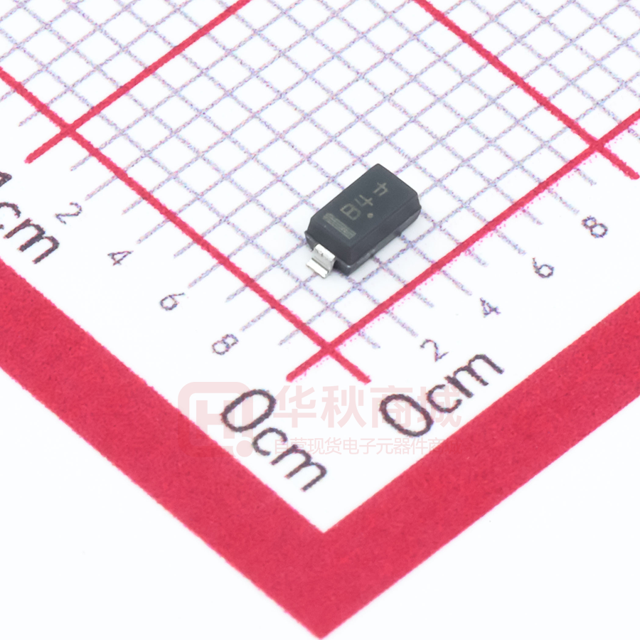

MBR0540T1, MBR0540T3 Surface Mount Schottky Power Rectifier SOD−123 Power Surface Mount Package The Schottky Power Rectifier employs the Schottky Barrier principle with a barrier metal that produces optimal forward voltage drop−reverse current tradeoff. Ideally suited for low voltage, high frequency rectification, or as a free wheeling and polarity protection diodes in surface mount applications where compact size and weight are critical to the system. This package provides an alternative to the leadless 34 MELF style package. Features http://onsemi.com SCHOTTKY BARRIER RECTIFIER 0.5 AMPERES, 40 VOLTS • • • • • • • • • • • • • Guardring for Stress Protection Very Low Forward Voltage Epoxy Meets UL 94 V−0 @ 0.125 in Package Designed for Optimal Automated Board Assembly Pb−Free Packages are Available SOD−123 CASE 425 STYLE 1 Mechanical Characteristics Reel Options: 3,000 per 7 inch reel/8 mm tape Reel Options: 10,000 per 13 inch reel/8 mm tape Device Marking: B4 Polarity Designator: Cathode Band Weight: 11.7 mg (approximately) Case: Epoxy Molded Finish: All External Surfaces Corrosion Resistant and Terminal Leads are Readily Solderable Lead and Mounting Surface Temperature for Soldering Purposes: 260°C max. for 10 Seconds MARKING DIAGRAM B4 MG G B4 = Device Code M = Date Code G = Pb−Free Package (Note: Microdot may be in either location) ORDERING INFORMATION Device MBR0540T1 MBR0540T1G MBR0540T3 MBR0540T3G Package SOD−123 SOD−123 (Pb−Free) SOD−123 SOD−123 (Pb−Free) Shipping† 3000/Tape & Reel 3000/Tape & Reel 10,000/Tape & Reel 10,000/Tape & Reel †For information on tape and reel specifications, including part orientation and tape sizes, please refer to our Tape and Reel Packaging Specifications Brochure, BRD8011/D. © Semiconductor Components Industries, LLC, 2005 1 November, 2005 − Rev. 6 Publication Order Number: MBR0540T1/D MBR0540T1, MBR0540T3 MAXIMUM RATINGS Rating Peak Repetitive Reverse Voltage Working Peak Reverse Voltage DC Blocking Voltage Average Rectified Forward Current (At Rated VR, TC = 115°C) Peak Repetitive Forward Current (At Rated VR, Square Wave, 20 kHz, TC = 115°C) Non−Repetitive Peak Surge Current (Surge Applied at Rated Load Conditions Halfwave, Single Phase, 60 Hz) Storage/Operating Case Temperature Range Operating Junction Temperature Voltage Rate of Change (Rated VR, TJ = 25°C) Symbol VRRM VRWM VR IO IFRM IFSM Value 40 Unit V 0.5 1.0 5.5 A A A Tstg, TC TJ dv/dt −55 to +150 −55 to +150 1000 °C °C V/ms Maximum ratings are those values beyond which device damage can occur. Maximum ratings applied to the device are individual stress limit values (not normal operating conditions) and are not valid simultaneously. If these limits are exceeded, device functional operation is not implied, damage may occur and reliability may be affected. THERMAL CHARACTERISTICS Rating Thermal Resistance − Junction−to−Lead (Note 1) Thermal Resistance − Junction−to−Ambient (Note 2) Symbol Rtjl Rtja Value 118 206 Unit °C/W ELECTRICAL CHARACTERISTICS Maximum Instantaneous Forward Voltage (Note 3) (iF = 0.5 A) (iF = 1 A) Maximum Instantaneous Reverse Current (Note 3) (VR = 40 V) (VR = 20 V) 1. Mounted with minimum recommended pad size, PC Board FR4. 2. 1 inch square pad size (1 X 0.5 inch for each lead) on FR4 board. 3. Pulse Test: Pulse Width ≤ 250 ms, Duty Cycle ≤ 2.0%. IR vF TJ = 25°C 0.51 0.62 TJ = 25°C 20 10 TJ = 100°C 0.46 0.61 TJ = 100°C 13,000 5,000 mA V http://onsemi.com 2 MBR0540T1, MBR0540T3 i F, INSTANTANEOUS FORWARD CURRENT (AMPS) IF, INSTANTANEOUS FORWARD CURRENT (AMPS) 10 100 10 25°C 1.0 TJ = 125°C TJ = −40°C TJ = 25°C TJ = 100°C 0.1 0.2 0.4 0.6 0.8 1.0 1.2 vF, INSTANTANEOUS FORWARD VOLTAGE (VOLTS) 1.0 TJ = 125°C TJ = 100°C TJ = 25°C 0.2 0.4 0.6 0.8 1.0 1.2 0.1 VF, MAXIMUM INSTANTANEOUS FORWARD VOLTAGE (VOLTS) Figure 1. Typical Forward Voltage Figure 2. Maximum Forward Voltage I R, REVERSE CURRENT (AMPS) 10E−3 TJ = 125°C I R, MAXIMUM REVERSE CURRENT (AMPS) 100E−3 100E−3 10E−3 1.0E−3 TJ = 100°C 1.0E−3 100E−6 10E−6 TJ = 100°C 100E−6 10E−6 1.0E−6 TJ = 25°C 1.0E−6 TJ = 25°C 0 10 20 30 40 100E−9 100E−9 0 10 20 30 40 VR, REVERSE VOLTAGE (VOLTS) VR, REVERSE VOLTAGE (VOLTS) Figure 3. Typical Reverse Current Figure 4. Maximum Reverse Current http://onsemi.com 3 MBR0540T1, MBR0540T3 dc 0.7 0.6 0.5 0.4 0.3 0.2 0.1 0 0 20 40 60 80 100 120 140 SQUARE WAVE Ipk/Io = p Ipk/Io = 5 Ipk/Io = 10 Ipk/Io = 20 FREQ = 20 kHz PFO , AVERAGE POWER DISSIPATION (WATTS) I O , AVERAGE FORWARD CURRENT (AMPS) 0.8 0.45 0.40 0.35 0.30 0.25 0.20 0.15 0.10 0.05 0 0 0.1 0.2 0.3 0.4 0.5 0.6 0.7 0.8 IO, AVERAGE FORWARD CURRENT (AMPS) Ipk/Io = 10 Ipk/Io = 20 Ipk/Io = 5 SQUARE WAVE Ipk/Io = p dc TL, LEAD TEMPERATURE (°C) Figure 5. Current Derating Figure 6. Forward Power Dissipation TJ , DERATED OPERATING TEMPERATURE ( °C) 100 TJ = 25°C C, CAPACITANCE (pF) 126 124 122 120 118 116 114 112 110 0 5.0 10 15 20 25 30 149°C/W 180°C/W 206°C/W 228°C/W 35 40 Rtja = 118°C/W 10 0 5.0 10 15 20 25 30 35 40 VR, REVERSE VOLTAGE (VOLTS) VR, DC REVERSE VOLTAGE (VOLTS) Figure 7. Capacitance Figure 8. Typical Operating Temperature Derating* * Reverse power dissipation and the possibility of thermal runaway must be considered when operating this device under any reverse voltage conditions. Calculations of TJ therefore must include forward and reverse power effects. The allowable operating TJ = TJmax − r(t)(Pf + Pr) where TJ may be calculated from the equation: r(t) = thermal impedance under given conditions, Pf = forward power dissipation, and Pr = reverse power dissipation This graph displays the derated allowable TJ due to reverse bias under DC conditions only and is calculated as TJ = TJmax − r(t)Pr, where r(t) = Rthja. For other power applications further calculations must be performed. http://onsemi.com 4 MBR0540T1, MBR0540T3 R (T) , TRANSIENT THERMAL RESISTANCE (NORMALIZED) 1E+00 50% 20% 1E−01 10% 5.0% 2.0% 1.0% 1E−02 Rtjl(t) = Rtjl*r(t) 1E−03 0.00001 0.0001 0.001 0.01 0.1 T, TIME (s) 1.0 10 100 1,000 Figure 9. Thermal Response Junction to Lead R (T) , TRANSIENT THERMAL RESISTANCE (NORMALIZED) 1E+00 50% 1E−01 20% 10% 5.0% 2.0% 1E−02 1.0% Rtjl(t) = Rtjl*r(t) 1E−03 0.00001 0.0001 0.001 0.01 0.1 T, TIME (s) 1.0 10 100 1,000 Figure 10. Thermal Response Junction to Ambient http://onsemi.com 5 MBR0540T1, MBR0540T3 PACKAGE DIMENSIONS SOD−123 PLASTIC CASE 425−04 ISSUE C A C H K 2.36 0.093 4.19 0.165 *For additional information on our Pb−Free strategy and soldering details, please download the ON Semiconductor Soldering and Mounting Techniques Reference Manual, SOLDERRM/D. ON Semiconductor and are registered trademarks of Semiconductor Components Industries, LLC (SCILLC). SCILLC reserves the right to make changes without further notice to any products herein. SCILLC makes no warranty, representation or guarantee regarding the suitability of its products for any particular purpose, nor does SCILLC assume any liability arising out of the application or use of any product or circuit, and specifically disclaims any and all liability, including without limitation special, consequential or incidental damages. “Typical” parameters which may be provided in SCILLC data sheets and/or specifications can and do vary in different applications and actual performance may vary over time. All operating parameters, including “Typicals” must be validated for each customer application by customer’s technical experts. SCILLC does not convey any license under its patent rights nor the rights of others. SCILLC products are not designed, intended, or authorized for use as components in systems intended for surgical implant into the body, or other applications intended to support or sustain life, or for any other application in which the failure of the SCILLC product could create a situation where personal injury or death may occur. Should Buyer purchase or use SCILLC products for any such unintended or unauthorized application, Buyer shall indemnify and hold SCILLC and its officers, employees, subsidiaries, affiliates, and distributors harmless against all claims, costs, damages, and expenses, and reasonable attorney fees arising out of, directly or indirectly, any claim of personal injury or death associated with such unintended or unauthorized use, even if such claim alleges that SCILLC was negligent regarding the design or manufacture of the part. SCILLC is an Equal Opportunity/Affirmative Action Employer. This literature is subject to all applicable copyright laws and is not for resale in any manner. PUBLICATION ORDERING INFORMATION LITERATURE FULFILLMENT: Literature Distribution Center for ON Semiconductor P.O. Box 61312, Phoenix, Arizona 85082−1312 USA Phone: 480−829−7710 or 800−344−3860 Toll Free USA/Canada Fax: 480−829−7709 or 800−344−3867 Toll Free USA/Canada Email: orderlit@onsemi.com N. American Technical Support: 800−282−9855 Toll Free USA/Canada Japan: ON Semiconductor, Japan Customer Focus Center 2−9−1 Kamimeguro, Meguro−ku, Tokyo, Japan 153−0051 Phone: 81−3−5773−3850 ON Semiconductor Website: http://onsemi.com Order Literature: http://www.onsemi.com/litorder For additional information, please contact your local Sales Representative. http://onsemi.com 6 ÉÉÉ ÉÉÉ ÉÉÉ ÉÉÉ ÉÉÉ ÉÉÉ ÂÂÂ ÂÂÂ ÂÂÂ 2 1 NOTES: 1. DIMENSIONING AND TOLERANCING PER ANSI Y14.5M, 1982. 2. CONTROLLING DIMENSION: INCH. DIM A B C D E H J K INCHES MIN MAX 0.055 0.071 0.100 0.112 0.037 0.053 0.020 0.028 0.004 −−− 0.000 0.004 −−− 0.006 0.140 0.152 MILLIMETERS MIN MAX 1.40 1.80 2.55 2.85 0.95 1.35 0.50 0.70 0.25 −−− 0.00 0.10 −−− 0.15 3.55 3.85 B E J STYLE 1: PIN 1. CATHODE 2. ANODE D SOLDERING FOOTPRINT* 0.91 0.036 1.22 0.048 SCALE 10:1 mm inches MBR0540T1/D

1. 物料型号: - MBR0540T1 和 MBR0540T3,这些是表面贴装肖特基功率整流器的型号。
2. 器件简介: - 这些肖特基功率整流器采用肖特基势垒原理,具有最佳的正向电压降-反向电流折衷。非常适合低电压、高频率整流,或作为表面贴装应用中的自由轮流通道和极性保护二极管,这些应用中尺寸和重量对系统至关重要。
3. 引脚分配: - SOD-123封装,引脚1为阴极(Cathode),引脚2为阳极(Anode)。
4. 参数特性: - 峰值重复反向电压:40V - 平均整流正向电流:0.5A - 峰值重复正向电流:1.0A - 非重复峰值浪涌电流:5.5A - 存储/运行外壳温度范围:-55至+150°C - 运行结温:-55至+150°C - 电压变化率:1000V/us
5. 功能详解: - 这些整流器具有应力保护的防护环,非常低的正向电压,环氧树脂符合UL94 V-0@0.125英寸的阻燃等级。无铅封装也可用,设计用于最佳自动化板组装。
6. 应用信息: - 适用于低电压、高频率整流,或作为自由轮流通道和极性保护二极管。
7. 封装信息: - SOD-123表面贴装封装,提供3000/卷和10000/卷的包装选项。
