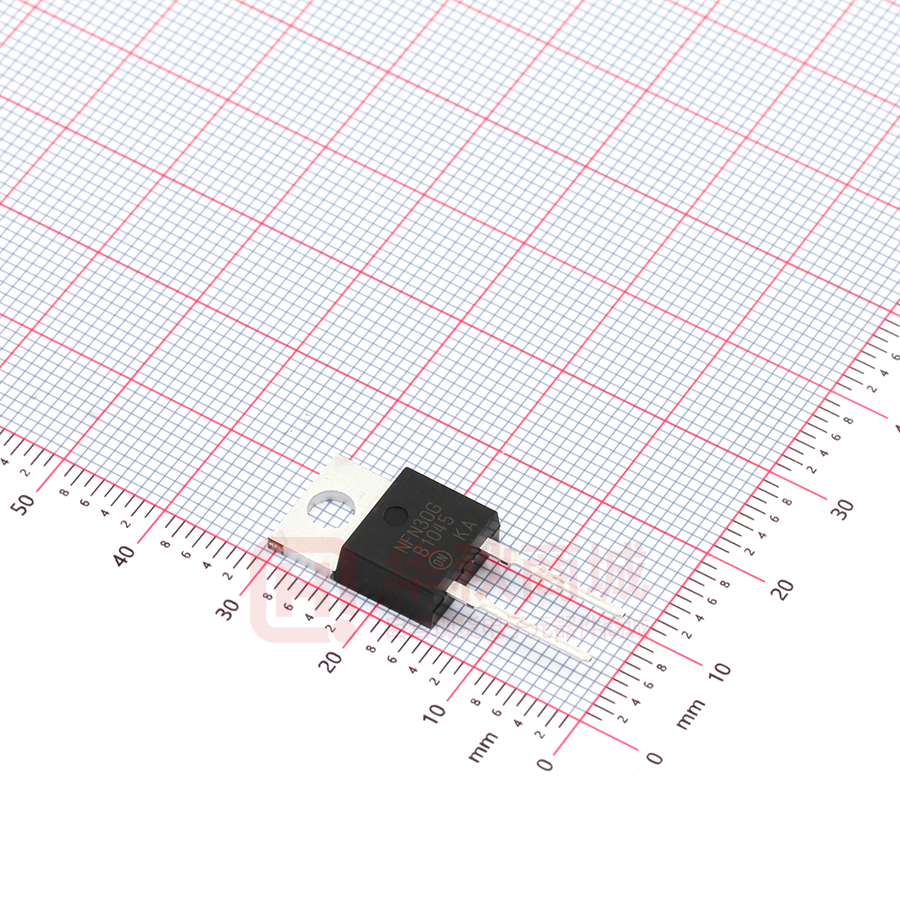

    肖特基二极管 Single VR=45V IF=10A IR=100μA TO220
MBR1045G 数据手册
MBR1035, MBR1045 SWITCHMODE™ Power Rectifiers Features and Benefits • • • • • • Low Forward Voltage Low Power Loss/High Efficiency High Surge Capacity 175°C Operating Junction Temperature 10 A Total Pb−Free Packages are Available* http://onsemi.com Applications SCHOTTKY BARRIER RECTIFIERS 10 AMPERES 35 to 45 VOLTS • Power Supply – Output Rectification • Power Management • Instrumentation Mechanical Characteristics 3 1, 4 • • • • • • Case: Epoxy, Molded Epoxy Meets UL 94, V−0 @ 0.125 in Weight: 1.9 Grams (Approximately) Finish: All External Surfaces Corrosion Resistant and Terminal Leads are Readily Solderable Lead Temperatures for Soldering Purposes: 260°C Max. for 10 Seconds ESD Rating: Human Body Model 3B Machine Model C 4 MARKING DIAGRAM TO−220AC CASE 221B PLASTIC AY WWG B10x5 KA 1 3 *For additional information on our Pb−Free strategy and soldering details, please download the ON Semiconductor Soldering and Mounting Techniques Reference Manual, SOLDERRM/D. A Y WW G B10x5 x KA = Assembly Location = Year = Work Week = Pb−Free Package = Device Code = 3 or 4 = Diode Polarity ORDERING INFORMATION Device MBR1035 MBR1035G MBR1045 MBR1045G Package TO−220 TO−220 (Pb−Free) TO−220 TO−220 (Pb−Free) Shipping 50 Units/Rail 50 Units/Rail 50 Units/Rail 50 Units/Rail © Semiconductor Components Industries, LLC, 2007 1 February, 2007 − Rev. 7 Publication Order Number: MBR1035/D MBR1035, MBR1045 MAXIMUM RATINGS Rating Peak Repetitive Reverse Voltage Working Peak Reverse Voltage DC Blocking Voltage MBR1035 MBR1045 Average Rectified Forward Current (TC = 135°C, Per Device) Peak Repetitive Forward Current, (Square Wave, 20 kHz, TC = 135°C) Non−Repetitive Peak Surge Current (Surge Applied at Rated Load Conditions Halfwave, Single Phase, 60 Hz) Peak Repetitive Reverse Surge Current (2.0 ms, 1.0 kHz) Storage Temperature Range Operating Junction Temperature (Note 1) Voltage Rate of Change (Rated VR) Symbol VRRM VRWM VR IF(AV) 10 IFRM IFSM IRRM Tstg TJ dv/dt 10,000 10 150 1.0 −65 to +175 −65 to +175 A A A °C °C V/ms Value Unit V 35 45 A Maximum ratings are those values beyond which device damage can occur. Maximum ratings applied to the device are individual stress limit values (not normal operating conditions) and are not valid simultaneously. If these limits are exceeded, device functional operation is not implied, damage may occur and reliability may be affected. 1. The heat generated must be less than the thermal conductivity from Junction−to−Ambient: dPD/dTJ < 1/RqJA. THERMAL CHARACTERISTICS Characteristic Maximum Thermal Resistance, Junction−to−Case Maximum Thermal Resistance, Junction−to−Ambient Conditions Min. Pad Min. Pad Symbol RqJC RqJA Max 2.0 60 Unit °C/W ELECTRICAL CHARACTERISTICS Characteristic Instantaneous Forward Voltage (Note 2) (iF = 10 Amps, Tj = 125°C) (iF = 20 Amps, Tj = 125°C) (iF = 20 Amps, Tj = 25°C) Instantaneous Reverse Current (Note 2) (Rated dc Voltage, Tj = 125°C) (Rated dc Voltage, Tj = 25°C) 2. Pulse Test: Pulse Width = 300 ms, Duty Cycle ≤ 2.0%. Symbol vF − − − iR − − 5.3 0.008 15 0.1 0.55 0.67 0.78 0.57 0.72 0.84 mA Min Typical Max Unit V http://onsemi.com 2 MBR1035, MBR1045 100 70 50 30 20 iF, INSTANTANEOUS FORWARD CURRENT (AMPS) iF, INSTANTANEOUS FORWARD CURRENT (AMPS) TJ = 150°C 100°C 25°C 100 70 50 30 20 100°C TJ = 150°C 25°C 10 7.0 5.0 3.0 2.0 10 7.0 5.0 3.0 2.0 1.0 0.7 0.5 0.3 0.2 1.0 0.7 0.5 0.3 0.2 0.1 0.2 0.4 0.6 0.8 1.0 1.2 1.4 vF, INSTANTANEOUS VOLTAGE (VOLTS) 0.1 0.2 0.4 0.6 0.8 1.0 1.2 1.4 vF, INSTANTANEOUS VOLTAGE (VOLTS) Figure 1. Maximum Forward Voltage Figure 2. Typical Forward Voltage http://onsemi.com 3 MBR1035, MBR1045 TJ = 150°C 125°C 100°C 1.0 75°C IFSM , PEAK HALF−WAVE CURRENT (AMPS) 25 30 35 40 45 50 100 IR , REVERSE CURRENT (mA) 200 10 100 70 50 0.1 25°C 0.01 30 20 1.0 2.0 3.0 5.0 7.0 10 20 30 50 70 100 NUMBER OF CYCLES AT 60 Hz 0.001 0 5.0 10 15 20 VR, REVERSE VOLTAGE (VOLTS) Figure 3. Maximum Reverse Current Figure 4. Maximum Surge Capability IF(AV) , AVERAGE FORWARD CURRENT (AMPS) RATED VOLTAGE APPLIED I IF(AV) , AVERAGE FORWARD CURRENT (AMPS) 20 16 14 12 10 8.0 6.0 4.0 2.0 0 0 20 40 I I RATED VOLTAGE APPLIED 15 I I PK + p (RESISTIVE LOAD) AV SQUARE WAVE PK + p (RESISTIVE LOAD) AV SQUARE WAVE dc PK + 5 10 (CAPACITIVE LOAD) I AV 10 5.0 20 dc I (CAPACITIVE LOAD) PK + 20, 10, 5 I 0 110 120 130 140 150 160 TC, CASE TEMPERATURE (°C) AV 60 80 100 120 140 160 TA, AMBIENT TEMPERATURE (°C) Figure 5. Current Derating, Infinite Heatsink PF(AV) , AVERAGE FORWARD POWER DISSIPATION (WATTS) Figure 6. Current Derating, RqJA = 16°C/W IF(AV) , AVERAGE FORWARD CURRENT (AMPS) 10 9.0 8.0 7.0 I SINE WAVE RESISTIVE LOAD SQUARE WAVE dc 5.0 RATED VOLTAGE APPLIED RqJA = 60°C/W I I 4.0 (CAPACITIVE LOAD) PK + 5 I 6.0 AV 5.0 4.0 3.0 2.0 1.0 0 0 2.0 4.0 6.0 8.0 10 12 14 16 IF(AV), AVERAGE FORWARD CURRENT (AMPS) TJ = 150°C 10 20 3.0 PK + p (RESISTIVE LOAD) AV SQUARE WAVE 2.0 dc (CAPACITIVE LOAD) PK + 20, 10, 5 I I 1.0 0 AV 0 20 40 60 80 100 120 140 160 TA, AMBIENT TEMPERATURE (°C) Figure 7. Forward Power Dissipation Figure 8. Current Derating, Free Air http://onsemi.com 4 MBR1035, MBR1045 r(t), TRANSIENT THERMAL RESISTANCE (NORMALIZED) 1.0 0.7 0.5 0.3 0.2 tp 0.1 0.07 0.05 0.03 0.02 0.01 0.01 0.1 1.0 t, TIME (ms) Ppk t1 Ppk TIME DUTY CYCLE, D = tp/t1 PEAK POWER, Ppk, is peak of an equivalent square power pulse. DTJL = Ppk • RqJL [D + (1 − D) • r(t1 + tp) + r(tp) − r(t1)] where: DTJL = the increase in junction temperature above the lead temperature. r(t) = normalized value of transient thermal resistance at time, t, i.e.: r(t1 + tp) = normalized value of transient thermal resistance at time, t1 + tp. 10 100 1000 Figure 9. Thermal Response 1500 1000 C, CAPACITANCE (pF) 700 500 MAXIMUM 300 TYPICAL 200 150 0.05 0.1 0.2 0.5 1.0 2.0 5.0 10 20 50 VR, REVERSE VOLTAGE (VOLTS) Figure 10. Capacitance http://onsemi.com 5 MBR1035, MBR1045 PACKAGE DIMENSIONS TO−220 PLASTIC CASE 221B−04 ISSUE D C Q B F T S NOTES: 1. DIMENSIONING AND TOLERANCING PER ANSI Y14.5M, 1982. 2. CONTROLLING DIMENSION: INCH. DIM A B C D F G H J K L Q R S T U INCHES MIN MAX 0.595 0.620 0.380 0.405 0.160 0.190 0.025 0.035 0.142 0.147 0.190 0.210 0.110 0.130 0.018 0.025 0.500 0.562 0.045 0.060 0.100 0.120 0.080 0.110 0.045 0.055 0.235 0.255 0.000 0.050 CATHODE N/A ANODE CATHODE MILLIMETERS MIN MAX 15.11 15.75 9.65 10.29 4.06 4.82 0.64 0.89 3.61 3.73 4.83 5.33 2.79 3.30 0.46 0.64 12.70 14.27 1.14 1.52 2.54 3.04 2.04 2.79 1.14 1.39 5.97 6.48 0.000 1.27 4 A 1 3 U H K L G D R J STYLE 1: PIN 1. 2. 3. 4. SWITCHMODE is a trademark of Semiconductor Components Industries, LLC. ON Semiconductor and are registered trademarks of Semiconductor Components Industries, LLC (SCILLC). SCILLC reserves the right to make changes without further notice to any products herein. SCILLC makes no warranty, representation or guarantee regarding the suitability of its products for any particular purpose, nor does SCILLC assume any liability arising out of the application or use of any product or circuit, and specifically disclaims any and all liability, including without limitation special, consequential or incidental damages. “Typical” parameters which may be provided in SCILLC data sheets and/or specifications can and do vary in different applications and actual performance may vary over time. All operating parameters, including “Typicals” must be validated for each customer application by customer’s technical experts. SCILLC does not convey any license under its patent rights nor the rights of others. SCILLC products are not designed, intended, or authorized for use as components in systems intended for surgical implant into the body, or other applications intended to support or sustain life, or for any other application in which the failure of the SCILLC product could create a situation where personal injury or death may occur. Should Buyer purchase or use SCILLC products for any such unintended or unauthorized application, Buyer shall indemnify and hold SCILLC and its officers, employees, subsidiaries, affiliates, and distributors harmless against all claims, costs, damages, and expenses, and reasonable attorney fees arising out of, directly or indirectly, any claim of personal injury or death associated with such unintended or unauthorized use, even if such claim alleges that SCILLC was negligent regarding the design or manufacture of the part. SCILLC is an Equal Opportunity/Affirmative Action Employer. This literature is subject to all applicable copyright laws and is not for resale in any manner. PUBLICATION ORDERING INFORMATION LITERATURE FULFILLMENT: Literature Distribution Center for ON Semiconductor P.O. Box 5163, Denver, Colorado 80217 USA Phone: 303−675−2175 or 800−344−3860 Toll Free USA/Canada Fax: 303−675−2176 or 800−344−3867 Toll Free USA/Canada Email: orderlit@onsemi.com N. American Technical Support: 800−282−9855 Toll Free USA/Canada Europe, Middle East and Africa Technical Support: Phone: 421 33 790 2910 Japan Customer Focus Center Phone: 81−3−5773−3850 ON Semiconductor Website: www.onsemi.com Order Literature: http://www.onsemi.com/orderlit For additional information, please contact your local Sales Representative http://onsemi.com 6 MBR1035/D
