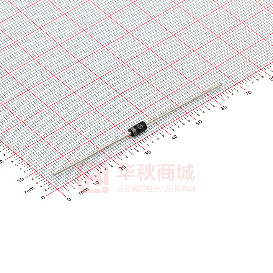

    DO-41(DO-204AL)
    直流反向耐压(Vr):100V 平均整流电流(Io):1A 正向压降(Vf):790mV@1A
MBR1100RLG 数据手册
MBR1100 Axial Lead Rectifier These rectifiers employ the Schottky Barrier principle in a large area metal−to−silicon power diode. State−of−the−art geometry features epitaxial construction with oxide passivation and metal overlap contact. Ideally suited for use as rectifiers in low−voltage, high−frequency inverters, free wheeling diodes, and polarity protection diodes. SCHOTTKY BARRIER RECTIFIER 1.0 AMPERE, 100 VOLTS Features • • • • • • • • • www.onsemi.com Low Reverse Current Low Stored Charge, Majority Carrier Conduction Low Power Loss/High Efficiency Highly Stable Oxide Passivated Junction Guard−Ring for Stress Protection Low Forward Voltage 175°C Operating Junction Temperature High Surge Capacity These Devices are Pb−Free and are RoHS Compliant DO−41 AXIAL LEAD CASE 59 STYLE 1 Mechanical Characteristics: • Case: Epoxy, Molded • Weight: 0.4 Gram (Approximately) • Finish: All External Surfaces Corrosion Resistant and Terminal Leads are Readily Solderable • Lead Temperature for Soldering Purposes: • MARKING DIAGRAM 260°C Max. for 10 Seconds Polarity: Cathode Indicated by Polarity Band A MBR1100 YYWW G G MAXIMUM RATINGS Rating Symbol Value Unit VRRM VRWM VR 100 V Average Rectified Forward Current (VR(equiv) ≤ 0.2 VR (dc), RqJA = 50°C/W, P.C. Board Mounting, [see Note 3], TA = 120°C) IO 1.0 A Peak Repetitive Forward Current (VR(equiv) ≤ 0.2 VR (dc), RqJA = 50°C/W, P.C. Board Mounting, [see Note 3], TA = 110°C) IFRM 2.0 A Non−Repetitive Peak Surge Current (Surge Applied at Rated Load Conditions Halfwave, Single Phase, 60 Hz) IFSM Peak Repetitive Reverse Voltage Working Peak Reverse Voltage DC Blocking Voltage Operating and Storage Junction Temperature Range (Note 1) Voltage Rate of Change (Rated VR) ORDERING INFORMATION 50 A TJ, Tstg −65 to +175 °C dv/dt 10 V/ns Stresses exceeding those listed in the Maximum Ratings table may damage the device. If any of these limits are exceeded, device functionality should not be assumed, damage may occur and reliability may be affected. 1. The heat generated must be less than the thermal conductivity from Junction−to−Ambient: dPD/dTJ < 1/RqJA. © Semiconductor Components Industries, LLC, 2016 February, 2016 − Rev. 7 A = Assembly Location Y = Year WW = Work Week G = Pb−Free Package (Note: Microdot may be in either location) 1 Package Shipping† MBR1100G Axial Lead (Pb−Free) 1000 Units/Bag MBR1100RLG Axial Lead (Pb−Free) 5000/Tape & Reel Device †For information on tape and reel specifications, including part orientation and tape sizes, please refer to our Tape and Reel Packaging Specification Brochure, BRD8011/D. Publication Order Number: MBR1100/D MBR1100 THERMAL CHARACTERISTICS (See Note 4) Characteristic Symbol Max Unit RqJA See Note 3 °C/W Symbol Max Unit Thermal Resistance, Junction−to−Ambient ELECTRICAL CHARACTERISTICS (TL = 25°C unless otherwise noted) Characteristic Maximum Instantaneous Forward Voltage (Note 2) (iF = 1 A, TL = 25°C) (iF = 1 A, TL = 100°C) VF Maximum Instantaneous Reverse Current @ Rated dc Voltage (Note 2) (TL = 25°C) (TL = 100°C) iR mA 0.5 5.0 Pulse Test: Pulse Width = 300 ms, Duty Cycle ≤ 2.0%. 20 1K 400 200 100 40 20 10 10 TJ = 150°C 5.0 IR , REVERSE CURRENT ( mA) i F, INSTANTANEOUS FORWARD CURRENT (AMPS) 2. V 0.79 0.69 100°C 2.0 25°C 1.0 0.5 0.2 0.1 0.05 TJ = 150°C 125°C 100°C 4.0 2.0 1.0 0.4 0.2 0.1 0.04 0.02 0.01 0.02 0 0.1 0.2 0.3 0.4 0.5 0.6 0.7 0.8 0.9 1.0 1.1 1.2 1.3 1.4 0 10 20 30 40 50 60 70 90 80 vF, INSTANTANEOUS VOLTAGE (VOLTS) VR, REVERSE VOLTAGE (VOLTS) Figure 1. Typical Forward Voltage Figure 2. Typical Reverse Current { 100 4.0 3.0 dc 2.0 SQUARE WAVE 1.0 0 0 20 40 60 80 100 120 140 160 180 200 PF(AV) , AVERAGE POWER DISSIPATION (WATTS) IF(AV) , AVERAGE FORWARD CURRENT (AMPS) { The curves shown are typical for the highest voltage device in the voltage grouping. Typical reverse current for lower voltage selections can be estimated from these same curves if VR is sufficiently below rated VR. 4.0 3.0 SQUARE WAVE dc 2.0 1.0 0 0 1.0 2.0 3.0 4.0 TA, AMBIENT TEMPERATURE (°C) IF(AV), AVERAGE FORWARD CURRENT (AMPS) Figure 3. Current Derating (Mounting Method 3 per Note 3) Figure 4. Power Dissipation www.onsemi.com 2 5.0 MBR1100 NOTE 4 — THERMAL CIRCUIT MODEL: (For heat conduction through the leads) 150 C, CAPACITANCE (pF) 100 90 80 70 60 50 RqS(A) RqL(A) RqJ(A) TA(A) TJ = 25°C fTEST = 1 MHz RqL(K) RqJ(K) RqS(K) TA(K) PD TL(A) TC(A) TJ TC(K) TL(K) 40 30 Use of the above model permits junction to lead thermal resistance for any mounting configuration to be found. For a given total lead length, lowest values occur when one side of the rectifier is brought as close as possible to the heat sink. Terms in the model signify: 20 15 0 10 30 20 40 50 60 70 80 90 100 VR, REVERSE VOLTAGE (VOLTS) Figure 5. Typical Capacitance TA = Ambient Temperature TC = Case Temperature TL = Lead Temperature TJ = Junction Temperature RqS = Thermal Resistance, Heat Sink to Ambient RqL = Thermal Resistance, Lead to Heat Sink RqJ = Thermal Resistance, Junction to Case PD = Power Dissipation NOTE 3 — MOUNTING DATA: Data shown for thermal resistance junction−to−ambient (RqJA) for the mounting shown is to be used as a typical guideline values for preliminary engineering or in case the tie point temperature cannot be measured. (Subscripts A and K refer to anode and cathode sides, respectively.) Values for thermal resistance components are: RqL = 100°C/W/in typically and 120°C/W/in maximum. RqJ = 36°C/W typically and 46°C/W maximum. Typical Values for RqJA in Still Air Lead Length, L (in) Mounting Method 1/8 1/4 1/2 3/4 1 52 65 72 85 °C/W 2 67 80 87 100 °C/W 3 — L Mounting Method 2 L Since current flow in a Schottky rectifier is the result of majority carrier conduction, it is not subject to junction diode forward and reverse recovery transients due to minority carrier injection and stored charge. Satisfactory circuit analysis work may be performed by using a model consisting of an ideal diode in parallel with a variable capacitance. (See Figure 5) Rectification efficiency measurements show that operation will be satisfactory up to several megahertz. For example, relative waveform rectification efficiency is approximately 70 percent at 2 MHz, e.g., the ratio of dc power to RMS power in the load is 0.28 at this frequency, whereas perfect rectification would yield 0.406 for sine wave inputs. However, in contrast to ordinary junction diodes, the loss in waveform efficiency is not indicative of power loss: it is simply a result of reverse current flow through the diode capacitance, which lowers the dc output voltage. Mounting Method 3 ÉÉ ÉÉÉÉÉÉÉÉ ÉÉÉÉÉÉÉÉ ÉÉ ÉÉÉÉÉÉÉÉ ÉÉÉÉÉÉÉÉ L NOTE 5 — HIGH FREQUENCY OPERATION: °C/W 50 Mounting Method 1 P.C. Board with 1−1/2″ x 1−1/2″ copper surface. RqJA P.C. Board with 1−1/2″ x 1−1/2″ copper surface. L = 3/8″ BOARD GROUND PLANE L www.onsemi.com 3 MBR1100 PACKAGE DIMENSIONS AXIAL LEAD CASE 59−10 ISSUE U NOTES: 1. DIMENSIONING AND TOLERANCING PER ANSI Y14.5M, 1982. 2. CONTROLLING DIMENSION: INCH. 3. ALL RULES AND NOTES ASSOCIATED WITH JEDEC DO−41 OUTLINE SHALL APPLY 4. POLARITY DENOTED BY CATHODE BAND. 5. LEAD DIAMETER NOT CONTROLLED WITHIN F DIMENSION. B K D DIM A B D F K F A POLARITY INDICATOR OPTIONAL AS NEEDED (SEE STYLES) INCHES MIN MAX 0.161 0.205 0.079 0.106 0.028 0.034 −−− 0.050 1.000 −−− MILLIMETERS MIN MAX 4.10 5.20 2.00 2.70 0.71 0.86 −−− 1.27 25.40 −−− STYLE 1: PIN 1. CATHODE (POLARITY BAND) 2. ANODE F K ON Semiconductor and the are registered trademarks of Semiconductor Components Industries, LLC (SCILLC) or its subsidiaries in the United States and/or other countries. SCILLC owns the rights to a number of patents, trademarks, copyrights, trade secrets, and other intellectual property. A listing of SCILLC’s product/patent coverage may be accessed at www.onsemi.com/site/pdf/Patent−Marking.pdf. SCILLC reserves the right to make changes without further notice to any products herein. SCILLC makes no warranty, representation or guarantee regarding the suitability of its products for any particular purpose, nor does SCILLC assume any liability arising out of the application or use of any product or circuit, and specifically disclaims any and all liability, including without limitation special, consequential or incidental damages. “Typical” parameters which may be provided in SCILLC data sheets and/or specifications can and do vary in different applications and actual performance may vary over time. All operating parameters, including “Typicals” must be validated for each customer application by customer’s technical experts. SCILLC does not convey any license under its patent rights nor the rights of others. SCILLC products are not designed, intended, or authorized for use as components in systems intended for surgical implant into the body, or other applications intended to support or sustain life, or for any other application in which the failure of the SCILLC product could create a situation where personal injury or death may occur. Should Buyer purchase or use SCILLC products for any such unintended or unauthorized application, Buyer shall indemnify and hold SCILLC and its officers, employees, subsidiaries, affiliates, and distributors harmless against all claims, costs, damages, and expenses, and reasonable attorney fees arising out of, directly or indirectly, any claim of personal injury or death associated with such unintended or unauthorized use, even if such claim alleges that SCILLC was negligent regarding the design or manufacture of the part. SCILLC is an Equal Opportunity/Affirmative Action Employer. This literature is subject to all applicable copyright laws and is not for resale in any manner. PUBLICATION ORDERING INFORMATION LITERATURE FULFILLMENT: Literature Distribution Center for ON Semiconductor 19521 E. 32nd Pkwy, Aurora, Colorado 80011 USA Phone: 303−675−2175 or 800−344−3860 Toll Free USA/Canada Fax: 303−675−2176 or 800−344−3867 Toll Free USA/Canada Email: orderlit@onsemi.com N. American Technical Support: 800−282−9855 Toll Free USA/Canada Europe, Middle East and Africa Technical Support: Phone: 421 33 790 2910 Japan Customer Focus Center Phone: 81−3−5817−1050 www.onsemi.com 4 ON Semiconductor Website: www.onsemi.com Order Literature: http://www.onsemi.com/orderlit For additional information, please contact your local Sales Representative MBR1100/D
