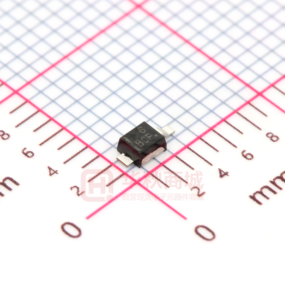

    直流反向耐压(Vr):20V 平均整流电流(Io):1A 正向压降(Vf):450mV@1A
MBRM120LT1G 数据手册
MBRM120LT1G, NRVBM120LT1G, MBRM120LT3G, NRVBM120LT3G Surface Mount Schottky Power Rectifier POWERMITE Power Surface Mount Package The Schottky POWERMITE employs the Schottky Barrier principle with a barrier metal and epitaxial construction that produces optimal forward voltage drop−reverse current tradeoff. The advanced packaging techniques provide for a highly efficient micro miniature, space saving surface mount Rectifier. With its unique heatsink design, the POWERMITE has the same thermal performance as the SMA while being 50% smaller in footprint area, and delivering one of the lowest height profiles,  1.1 mm in the industry. Because of its small size, it is ideal for use in portable and battery powered products such as cellular and cordless phones, chargers, notebook computers, printers, PDAs and PCMCIA cards. Typical applications are AC−DC and DC−DC converters, reverse battery protection, and “ORing” of multiple supply voltages and any other application where performance and size are critical.     Low Profile − Maximum Height of 1.1 mm Small Footprint − Footprint Area of 8.45 mm2 Low VF Provides Higher Efficiency and Extends Battery Life Supplied in 12 mm Tape and Reel Low Thermal Resistance with Direct Thermal Path of Die on Exposed Cathode Heat Sink ESD Ratings:  Human Body Model = 3B (> 16 kV)  Machine Model = C (> 400 V) AEC−Q101 Qualified and PPAP Capable NRVB Prefix for Automotive and Other Applications Requiring Unique Site and Control Change Requirements All Packages are Pb−Free* Mechanical Characteristics:      SCHOTTKY BARRIER RECTIFIER 1.0 AMPERES, 20 VOLTS ANODE CATHODE POWERMITE CASE 457 PLASTIC MARKING DIAGRAM 1 Features      http://onsemi.com POWERMITE is JEDEC Registered as D0−216AA Case: Molded Epoxy Epoxy Meets UL 94 V−0 @ 0.125 in Weight: 16.3 mg (Approximately) Lead and Mounting Surface Temperature for Soldering Purposes: 260C Maximum for 10 Seconds M BCFG 2 M = Date Code BCF = Device Code G = Pb−Free Package ORDERING INFORMATION Package Shipping† MBRM120LT1G POWERMITE (Pb−Free) 3,000 / Tape & Reel NRVBM120LT1G POWERMITE (Pb−Free) 3,000 / Tape & Reel MBRM120LT3G POWERMITE (Pb−Free) 12,000 / Tape & Reel NRVBM120LT3G POWERMITE (Pb−Free) 12,000 / Tape & Reel Device †For information on tape and reel specifications, including part orientation and tape sizes, please refer to our Tape and Reel Packaging Specifications Brochure, BRD8011/D. *For additional information on our Pb−Free strategy and soldering details, please download the ON Semiconductor Soldering and Mounting Techniques Reference Manual, SOLDERRM/D.  Semiconductor Components Industries, LLC, 2012 January, 2012 − Rev. 7 1 Publication Order Number: MBRM120L/D MBRM120LT1G, NRVBM120LT1G, MBRM120LT3G, NRVBM120LT3G MAXIMUM RATINGS Rating Peak Repetitive Reverse Voltage Working Peak Reverse Voltage DC Blocking Voltage Symbol Value Unit VRRM VRWM VR 20 V Average Rectified Forward Current (At Rated VR, TC = 135C) IO A 1.0 Peak Repetitive Forward Current (At Rated VR, Square Wave, 100 kHz, TC = 135C) IFRM Non−Repetitive Peak Surge Current (Non−Repetitive peak surge current, halfwave, single phase, 60 Hz) IFSM Storage Temperature Tstg −55 to 150 C Operating Junction Temperature TJ −55 to 125 C Voltage Rate of Change (Rated VR, TJ = 25C) A 2.0 A 50 dv/dt V/ms 10,000 Stresses exceeding Maximum Ratings may damage the device. Maximum Ratings are stress ratings only. Functional operation above the Recommended Operating Conditions is not implied. Extended exposure to stresses above the Recommended Operating Conditions may affect device reliability. THERMAL CHARACTERISTICS Characteristic Thermal Resistance, Junction−to−Lead (Anode) (Note 1) Thermal Resistance, Junction−to−Tab (Cathode) (Note 1) Thermal Resistance, Junction−to−Ambient (Note 1) Symbol Value Unit Rtjl Rtjtab Rtja 35 23 277 C/W 1. Mounted with minimum recommended pad size, PC Board FR4, See Figures 9 & 10. ELECTRICAL CHARACTERISTICS Characteristic Symbol Value VF Maximum Instantaneous Forward Voltage (Note 2), See Figure 2 TJ = 25C TJ = 85C 0.34 0.45 0.65 0.26 0.415 0.67 TJ = 25C TJ = 85C 0.40 0.10 25 18 (IF = 0.1 A) (IF = 1.0 A) (IF = 3.0 A) IR Maximum Instantaneous Reverse Current (Note 2), See Figure 4 Unit (VR = 20 V) (VR = 10 V) V mA IF, INSTANTANEOUS FORWARD CURRENT (AMPS) iF, INSTANTANEOUS FORWARD CURRENT (AMPS) 2. Pulse Test: Pulse Width  250 ms, Duty Cycle  2%. 10 TJ = 125C TJ = 85C 1.0 TJ = 25C TJ = −40C 0.1 0.1 0.3 0.5 0.7 0.9 vF, INSTANTANEOUS FORWARD VOLTAGE (VOLTS) 10 TJ = 125C 1.0 TJ = 85C TJ = 25C 0.1 0.1 0.3 0.5 0.7 VF, MAXIMUM INSTANTANEOUS FORWARD VOLTAGE (VOLTS) Figure 1. Typical Forward Voltage Figure 2. Maximum Forward Voltage http://onsemi.com 2 0.9 MBRM120LT1G, NRVBM120LT1G, MBRM120LT3G, NRVBM120LT3G IR, REVERSE CURRENT (AMPS) 1.0E−3 TJ = 85C 100E−6 10E−6 1.0E−6 10E−3 TJ = 85C 1.0E−3 100E−6 TJ = 25C 5.0 10 15 VR, REVERSE VOLTAGE (VOLTS) 0 IR, MAXIMUM REVERSE CURRENT (AMPS) 100E−3 10E−3 20 TJ = 25C 10E−6 0 5.0 10 15 VR, REVERSE VOLTAGE (VOLTS) FREQ = 20 kHz dc 1.4 1.2 SQUARE WAVE 1.0 Ipk/Io = p 0.8 Ipk/Io = 5 0.6 Ipk/Io = 10 0.4 Ipk/Io = 20 0.2 0 25 35 45 55 65 75 85 95 105 TL, LEAD TEMPERATURE (C) 115 125 Figure 5. Current Derating C, CAPACITANCE (pF) 1000 TJ = 25C 100 10 0 2.0 4.0 6.0 8.0 10 12 14 16 VR, REVERSE VOLTAGE (VOLTS) Figure 7. Capacitance 18 20 PFO, AVERAGE POWER DISSIPATION (WATTS) 1.8 1.6 Figure 4. Maximum Reverse Current TJ, DERATED OPERATING TEMPERATURE (C) IO, AVERAGE FORWARD CURRENT (AMPS) Figure 3. Typical Reverse Current 20 0.7 0.6 Ipk/Io = 5 0.5 Ipk/Io = p SQUARE WAVE dc Ipk/Io = 10 0.4 Ipk/Io = 20 0.3 0.2 0.1 0 0 0.4 0.8 1.2 1.0 0.2 0.6 1.4 IO, AVERAGE FORWARD CURRENT (AMPS) 1.6 Figure 6. Forward Power Dissipation 125 115 105 Rtja = 33.72C/W 95 119C/W 85 204C/W 75 65 0 2.0 4.0 277.35C/W 6.0 8.0 10 338C/W 12 14 16 18 20 VR, DC REVERSE VOLTAGE (VOLTS) Figure 8. Typical Operating Temperature Derating* * Reverse power dissipation and the possibility of thermal runaway must be considered when operating this device under any reverse voltage conditions. Calculations of TJ therefore must include forward and reverse power effects. The allowable operating TJ = TJmax − r(t)(Pf + Pr) where TJ may be calculated from the equation: r(t) = thermal impedance under given conditions, Pf = forward power dissipation, and Pr = reverse power dissipation This graph displays the derated allowable TJ due to reverse bias under DC conditions only and is calculated as TJ = TJmax − r(t)Pr, where r(t) = Rthja. For other power applications further calculations must be performed. http://onsemi.com 3 R(T), TRANSIENT THERMAL RESISTANCE (NORMALIZED) R(T), TRANSIENT THERMAL RESISTANCE (NORMALIZED) MBRM120LT1G, NRVBM120LT1G, MBRM120LT3G, NRVBM120LT3G 1.0 50% 0.1 20% 10% 5.0% 0.01 2.0% 1.0% 0.001 0.00001 Rtjl(t) = Rtjl*r(t) 0.0001 0.001 0.01 1.0 0.1 10 100 T, TIME (s) Figure 9. Thermal Response Junction to Lead 1.0 50% 0.1 20% 10% 5.0% 0.01 2.0% Rtjl(t) = Rtjl*r(t) 1.0% 0.001 0.00001 0.0001 0.001 0.01 0.1 1.0 T, TIME (s) Figure 10. Thermal Response Junction to Ambient http://onsemi.com 4 10 100 1,000 MBRM120LT1G, NRVBM120LT1G, MBRM120LT3G, NRVBM120LT3G PACKAGE DIMENSIONS POWERMITE CASE 457−04 ISSUE E F 0.08 (0.003) C −A− J M T B S C S S NOTES: 1. DIMENSIONING AND TOLERANCING PER ANSI Y14.5M, 1982. 2. CONTROLLING DIMENSION: MILLIMETER. 3. DIMENSION A DOES NOT INCLUDE MOLD FLASH, PROTRUSIONS OR GATE BURRS. MOLD FLASH, PROTRUSIONS OR GATE BURRS SHALL NOT EXCEED 0.15 (0.006) PER SIDE. PIN 1 −B− DIM A B C D F H J K L R S K PIN 2 R L J D H −T− 0.08 (0.003) M T B S C MILLIMETERS INCHES MIN MAX MIN MAX 1.75 2.05 0.069 0.081 1.75 2.18 0.069 0.086 0.85 1.15 0.033 0.045 0.40 0.69 0.016 0.027 0.70 1.00 0.028 0.039 -0.05 +0.10 -0.002 +0.004 0.10 0.25 0.004 0.010 3.60 3.90 0.142 0.154 0.50 0.80 0.020 0.031 1.20 1.50 0.047 0.059 0.50 REF 0.019 REF STYLE 1: PIN 1. CATHODE 2. ANODE S SOLDERING FOOTPRINT* 0.635 0.025 2.67 0.105 0.762 0.030 2.54 0.100 1.27 0.050 SCALE 10:1 mm Ǔ ǒinches *For additional information on our Pb−Free strategy and soldering details, please download the ON Semiconductor Soldering and Mounting Techniques Reference Manual, SOLDERRM/D. POWERMITE is a registered trademark of and used under a license from Microsemi Corporation. ON Semiconductor and are registered trademarks of Semiconductor Components Industries, LLC (SCILLC). SCILLC reserves the right to make changes without further notice to any products herein. SCILLC makes no warranty, representation or guarantee regarding the suitability of its products for any particular purpose, nor does SCILLC assume any liability arising out of the application or use of any product or circuit, and specifically disclaims any and all liability, including without limitation special, consequential or incidental damages. “Typical” parameters which may be provided in SCILLC data sheets and/or specifications can and do vary in different applications and actual performance may vary over time. All operating parameters, including “Typicals” must be validated for each customer application by customer’s technical experts. SCILLC does not convey any license under its patent rights nor the rights of others. SCILLC products are not designed, intended, or authorized for use as components in systems intended for surgical implant into the body, or other applications intended to support or sustain life, or for any other application in which the failure of the SCILLC product could create a situation where personal injury or death may occur. Should Buyer purchase or use SCILLC products for any such unintended or unauthorized application, Buyer shall indemnify and hold SCILLC and its officers, employees, subsidiaries, affiliates, and distributors harmless against all claims, costs, damages, and expenses, and reasonable attorney fees arising out of, directly or indirectly, any claim of personal injury or death associated with such unintended or unauthorized use, even if such claim alleges that SCILLC was negligent regarding the design or manufacture of the part. SCILLC is an Equal Opportunity/Affirmative Action Employer. This literature is subject to all applicable copyright laws and is not for resale in any manner. PUBLICATION ORDERING INFORMATION LITERATURE FULFILLMENT: Literature Distribution Center for ON Semiconductor P.O. Box 5163, Denver, Colorado 80217 USA Phone: 303−675−2175 or 800−344−3860 Toll Free USA/Canada Fax: 303−675−2176 or 800−344−3867 Toll Free USA/Canada Email: orderlit@onsemi.com N. American Technical Support: 800−282−9855 Toll Free USA/Canada Europe, Middle East and Africa Technical Support: Phone: 421 33 790 2910 Japan Customer Focus Center Phone: 81−3−5817−1050 http://onsemi.com 5 ON Semiconductor Website: www.onsemi.com Order Literature: http://www.onsemi.com/orderlit For additional information, please contact your local Sales Representative MBRM120L/D

物料型号: - MBRM120LT1G - NRVBM120LT1G - MBRM120LT3G - NRVBM120LT3G
器件简介: 这些肖特基功率整流器采用肖特基势垒原理,结合势垒金属和外延结构,实现最佳的正向电压降-反向电流折衷。先进的封装技术提供了高效率的微型表面贴装整流器。由于其独特的散热器设计,POWERMITE具有与SMA相同的热性能,但占用面积小50%,并且提供行业最低的高度配置之一,小于1.1毫米。它的小尺寸使其非常适合用于便携式和电池供电产品,如手机、充电器、笔记本电脑、打印机、PDA和PCMCIA卡。
引脚分配: - 阳极(ANODE) - 阴极(CATHODE)
参数特性: - 最大高度:1.1毫米 - 占用面积:8.45毫米² - 低正向电压,提供更高的效率并延长电池寿命 - 12毫米胶带和卷轴供应 - 低热阻,直接热路径从裸片到暴露的阴极散热器 - ESD等级:人体模型> 16千伏,机器模型> 400伏 - AEC-Q101合格和PPAP能力 - NRVB前缀适用于汽车和其他需要独特场地和控制变更要求的应用 - 所有封装均为无铅
功能详解: - 典型应用包括AC-DC和DC-DC转换器、反向电池保护以及“ORing”多个供电电压,以及任何其他性能和尺寸至关重要的应用。
应用信息: - 适用于便携式和电池供电产品,如手机、充电器、笔记本电脑等。
封装信息: - POWERMITE是Microsemi Corporation的注册商标,并且是SCILLC的许可使用商标。 - 封装尺寸遵循POWERMITE CASE 457标准。
