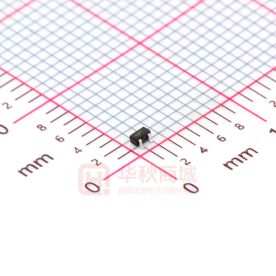

MMBT3904TT1G
MMBT3904TT1G
    ONSEMI(安森美)
    SOT-416
    三极管 NPN Ic=200mA Vceo=40V hfe=100~300 P=300mW SOT416
MMBT3904TT1G 数据手册
MMBT3904TT1 General Purpose Transistors NPN Silicon This transistor is designed for general purpose amplifier applications. It is housed in the SOT-416/SC-75 package which is designed for low power surface mount applications. Features http://onsemi.com • Pb-Free Package is Available MAXIMUM RATINGS (TA = 25°C) Rating Collector - Emitter Voltage Collector - Base Voltage Emitter - Base Voltage Collector Current - Continuous Symbol VCEO VCBO VEBO IC Value 40 60 6.0 200 Unit Vdc Vdc Vdc mAdc GENERAL PURPOSE AMPLIFIER TRANSISTORS SURFACE MOUNT COLLECTOR 3 1 BASE 2 EMITTER Symbol PD 200 1.6 RqJA PD 300 2.4 RqJA TJ, Tstg 400 - 55 to +150 mW mW/°C °C/W °C 600 mW mW/°C °C/W 1 3 2 SOT-416/SC-75 CASE 463 STYLE 1 Max Unit THERMAL CHARACTERISTICS Characteristic Total Device Dissipation, FR-4 Board (Note 1) @TA = 25°C Derated above 25°C Thermal Resistance, Junction- to- Ambient (Note 1) Total Device Dissipation, FR-4 Board (Note 2) @TA = 25°C Derated above 25°C Thermal Resistance, Junction- to- Ambient (Note 2) Junction and Storage Temperature Range MARKING DIAGRAM Stresses exceeding Maximum Ratings may damage the device. Maximum Ratings are stress ratings only. Functional operation above the Recommended Operating Conditions is not implied. Extended exposure to stresses above the Recommended Operating Conditions may affect device reliability. 1. FR-4 @ Minimum Pad 2. FR-4 @ 1.0 × 1.0 Inch Pad AM M G G 1 AM = Device Code M = Date Code* G = Pb-Free Package (Note: Microdot may be in either location) *Date Code orientation may vary depending upon manufacturing location. ORDERING INFORMATION Device MMBT3904TT1 MMBT3904TT1G Package SOT-416 SOT-416 (Pb-Free) Shipping† 3000 Tape & Reel 3000 Tape & Reel †For information on tape and reel specifications, including part orientation and tape sizes, please refer to our Tape and Reel Packaging Specifications Brochure, BRD8011/D. © Semiconductor Components Industries, LLC, 2007 1 June, 2007 - Rev. 4 Publication Order Number: MMBT3904TT1/D MMBT3904TT1 ELECTRICAL CHARACTERISTICS (TA = 25°C unless otherwise noted) Characteristic OFF CHARACTERISTICS Collector-Emitter Breakdown Voltage (Note 3) (IC = 1.0 mAdc, IB = 0) Collector-Base Breakdown Voltage (IC = 10 mAdc, IE = 0) Emitter-Base Breakdown Voltage (IE = 10 mAdc, IC = 0) Base Cutoff Current (VCE = 30 Vdc, VEB = 3.0 Vdc) Collector Cutoff Current (VCE = 30 Vdc, VEB = 3.0 Vdc) ON CHARACTERISTICS (Note 3) DC Current Gain (IC = 0.1 mAdc, VCE = 1.0 Vdc) (IC = 1.0 mAdc, VCE = 1.0 Vdc) (IC = 10 mAdc, VCE = 1.0 Vdc) (IC = 50 mAdc, VCE = 1.0 Vdc) (IC = 100 mAdc, VCE = 1.0 Vdc) Collector-Emitter Saturation Voltage (IC = 10 mAdc, IB = 1.0 mAdc) (IC = 50 mAdc, IB = 5.0 mAdc) Base-Emitter Saturation Voltage (IC = 10 mAdc, IB = 1.0 mAdc) (IC = 50 mAdc, IB = 5.0 mAdc) SMALL-SIGNAL CHARACTERISTICS Current-Gain - Bandwidth Product (IC = 10 mAdc, VCE = 20 Vdc, f = 100 MHz) Output Capacitance (VCB = 5.0 Vdc, IE = 0, f = 1.0 MHz) Input Capacitance (VEB = 0.5 Vdc, IC = 0, f = 1.0 MHz) Input Impedance (VCE = 10 Vdc, IC = 1.0 mAdc, f = 1.0 kHz) Voltage Feedback Ratio (VCE = 10 Vdc, IC = 1.0 mAdc, f = 1.0 kHz) Small-Signal Current Gain (VCE = 10 Vdc, IC = 1.0 mAdc, f = 1.0 kHz) Output Admittance (VCE = 10 Vdc, IC = 1.0 mAdc, f = 1.0 kHz) Noise Figure (VCE = 5.0 Vdc, IC = 100 mAdc, RS = 1.0 k W, f = 1.0 kHz) SWITCHING CHARACTERISTICS Delay Time Rise Time Storage Time Fall Time (VCC = 3.0 Vdc, VBE = -0.5 Vdc) (IC = 10 mAdc, IB1 = 1.0 mAdc) (VCC = 3.0 Vdc, IC = 10 mAdc) (IB1 = IB2 = 1.0 mAdc) MMBT3904TT1 MMBT3904TT1 MMBT3904TT1 MMBT3904TT1 td tr ts tf 35 35 200 ns 50 ns fT 300 Cobo Cibo hie 1.0 hre 0.5 hfe 100 hoe 1.0 NF 5.0 40 dB 400 mmhos 8.0 10 X 10- 4 8.0 kW 4.0 pF pF MHz hFE 40 70 100 60 30 VCE(sat) VBE(sat) 0.65 0.85 0.95 0.2 0.3 Vdc 300 Vdc V(BR)CEO 40 V(BR)CBO 60 V(BR)EBO 6.0 IBL ICEX 50 50 nAdc nAdc Vdc Vdc Vdc Symbol Min Max Unit 3. Pulse Test: Pulse Width v 300 ms, Duty Cycle v 2.0%. http://onsemi.com 2 MMBT3904TT1 r(t), NORMALIZED TRANSIENT THERMAL RESISTANCE 1.0 D = 0.5 0.2 0.1 0.05 0.02 0.01 0.01 SINGLE PULSE 0.001 0.00001 0.0001 0.001 0.01 0.1 t, TIME (s) 1.0 10 100 1000 0.1 Figure 1. Normalized Thermal Response DUTY CYCLE = 2% 300 ns +3 V +10.9 V 10 k 275 10 < t1 < 500 ms DUTY CYCLE = 2% t1 +3 V +10.9 V 275 10 k 0 -0.5 V < 1 ns CS < 4 pF* -9.1 V < 1 ns 1N916 CS < 4 pF* * Total shunt capacitance of test jig and connectors Figure 2. Delay and Rise Time Equivalent Test Circuit Figure 3. Storage and Fall Time Equivalent Test Circuit TYPICAL TRANSIENT CHARACTERISTICS TJ = 25°C TJ = 125°C 10 7.0 CAPACITANCE (pF) Q, CHARGE (pC) 5.0 Cibo 3.0 2.0 Cobo 5000 3000 2000 1000 700 500 300 200 100 70 50 QT QA VCC = 40 V IC/IB = 10 1.0 0.1 0.2 0.3 0.5 0.7 1.0 2.0 3.0 5.0 7.0 10 20 30 40 REVERSE BIAS VOLTAGE (VOLTS) 1.0 2.0 3.0 5.0 7.0 10 20 30 50 70 100 200 IC, COLLECTOR CURRENT (mA) Figure 4. Capacitance Figure 5. Charge Data http://onsemi.com 3 MMBT3904TT1 500 300 200 100 70 50 30 20 10 7 5 IC/IB = 10 500 300 200 t r, RISE TIME (ns) 100 70 50 30 20 10 7 5 1.0 2.0 3.0 5.0 7.0 10 20 30 VCC = 40 V IC/IB = 10 TIME (ns) tr @ VCC = 3.0 V 40 V 15 V td @ VOB = 0 V 1.0 2.0 3.0 5.0 7.0 10 20 30 2.0 V 50 70 100 200 50 70 100 200 IC, COLLECTOR CURRENT (mA) IC, COLLECTOR CURRENT (mA) Figure 6. Turn-On Time 500 300 200 t s, STORAGE TIME (ns) ′ 100 70 50 30 20 10 7 5 1.0 2.0 3.0 5.0 7.0 10 20 30 IC/IB = 20 IC/IB = 10 t′s = ts - 1/8 tf IB1 = IB2 t f , FALL TIME (ns) 500 300 200 Figure 7. Rise Time VCC = 40 V IB1 = IB2 IC/IB = 20 IC/IB = 20 IC/IB = 10 100 70 50 30 20 10 7 5 1.0 2.0 3.0 5.0 7.0 10 20 30 IC/IB = 10 50 70 100 200 50 70 100 200 IC, COLLECTOR CURRENT (mA) IC, COLLECTOR CURRENT (mA) Figure 8. Storage Time Figure 9. Fall Time TYPICAL AUDIO SMALL-SIGNAL CHARACTERISTICS NOISE FIGURE VARIATIONS (VCE = 5.0 Vdc, TA = 25°C, Bandwidth = 1.0 Hz) 12 10 NF, NOISE FIGURE (dB) 8 6 4 2 0 0.1 SOURCE RESISTANCE = 500 W IC = 100 mA 0.2 0.4 1.0 2.0 4.0 10 20 40 100 SOURCE RESISTANCE = 200 W IC = 1.0 mA NF, NOISE FIGURE (dB) SOURCE RESISTANCE = 200 W IC = 0.5 mA SOURCE RESISTANCE = 1.0 k IC = 50 mA 14 f = 1.0 kHz 12 10 8 6 4 2 0 0.1 IC = 100 mA IC = 1.0 mA IC = 0.5 mA IC = 50 mA 0.2 0.4 1.0 2.0 4.0 10 20 40 100 f, FREQUENCY (kHz) RS, SOURCE RESISTANCE (k OHMS) Figure 10. Noise Figure Figure 11. Noise Figure http://onsemi.com 4 MMBT3904TT1 h PARAMETERS (VCE = 10 Vdc, f = 1.0 kHz, TA = 25°C) 300 hoe, OUTPUT ADMITTANCE ( m mhos) 5.0 10 100 50 200 h fe , CURRENT GAIN 20 10 5 100 70 50 2 1 30 0.1 0.2 0.3 0.5 1.0 2.0 3.0 IC, COLLECTOR CURRENT (mA) 0.1 0.2 0.3 0.5 1.0 2.0 3.0 IC, COLLECTOR CURRENT (mA) 5.0 10 Figure 12. Current Gain 20 h re , VOLTAGE FEEDBACK RATIO (X 10 -4 ) h ie , INPUT IMPEDANCE (k OHMS) 10 5.0 10 7.0 5.0 3.0 2.0 Figure 13. Output Admittance 2.0 1.0 0.5 1.0 0.7 0.5 0.1 0.2 0.3 0.5 1.0 2.0 3.0 IC, COLLECTOR CURRENT (mA) 5.0 10 0.2 0.1 0.2 0.3 0.5 1.0 2.0 3.0 IC, COLLECTOR CURRENT (mA) 5.0 10 Figure 14. Input Impedance Figure 15. Voltage Feedback Ratio TYPICAL STATIC CHARACTERISTICS h FE, DC CURRENT GAIN (NORMALIZED) 2.0 TJ = +125°C 1.0 0.7 0.5 0.3 0.2 -55 °C +25°C MMBT3904WT1 VCE = 1.0 V 0.1 0.1 0.2 0.3 0.5 0.7 1.0 2.0 3.0 5.0 7.0 10 20 30 50 70 100 200 IC, COLLECTOR CURRENT (mA) Figure 16. DC Current Gain http://onsemi.com 5 MMBT3904TT1 VCE, COLLECTOR EMITTER VOLTAGE (VOLTS) 1.0 TJ = 25°C 0.8 IC = 1.0 mA 10 mA 30 mA 100 mA 0.6 0.4 0.2 0 0.01 0.02 0.03 0.05 0.07 0.1 0.2 0.3 0.5 0.7 1.0 2.0 3.0 5.0 7.0 10 IB, BASE CURRENT (mA) Figure 17. Collector Saturation Region 1.2 TJ = 25°C 1.0 V, VOLTAGE (VOLTS) 0.8 VBE @ VCE =1.0 V 0.6 0.4 VCE(sat) @ IC/IB =10 0.2 0 VBE(sat) @ IC/IB =10 COEFFICIENT (mV/ °C) 1.0 0.5 qVC FOR VCE(sat) 0 -0.5 -55 °C TO +25°C -1.0 +25°C TO +125°C -1.5 -2.0 qVB FOR VBE(sat) -55 °C TO +25°C +25°C TO +125°C 1.0 2.0 5.0 10 20 50 100 200 0 20 40 60 80 100 120 140 160 180 200 IC, COLLECTOR CURRENT (mA) IC, COLLECTOR CURRENT (mA) Figure 18. “ON” Voltages Figure 19. Temperature Coefficients http://onsemi.com 6 MMBT3904TT1 PACKAGE DIMENSIONS SC-75/SOT-416 CASE 463-01 ISSUE F -E2 3 NOTES: 1. DIMENSIONING AND TOLERANCING PER ANSI Y14.5M, 1982. 2. CONTROLLING DIMENSION: MILLIMETER. MILLIMETERS MIN NOM MAX 0.70 0.80 0.90 0.00 0.05 0.10 0.15 0.20 0.30 0.10 0.15 0.25 1.55 1.60 1.65 0.70 0.80 0.90 1.00 BSC 0.10 0.15 0.20 1.50 1.60 1.70 INCHES NOM MAX 0.031 0.035 0.002 0.004 0.008 0.012 0.006 0.010 0.063 0.067 0.031 0.035 0.04 BSC 0.004 0.006 0.008 0.061 0.063 0.065 MIN 0.027 0.000 0.006 0.004 0.059 0.027 e 1 -D- b 3 PL 0.20 (0.008) M D HE 0.20 (0.008) E DIM A A1 b C D E e L HE C A L A1 STYLE 1: PIN 1. BASE 2. EMITTER 3. COLLECTOR SOLDERING FOOTPRINT* 0.356 0.014 1.803 0.071 0.787 0.031 0.508 0.020 1.000 0.039 SCALE 10:1 mm inches *For additional information on our Pb-Free strategy and soldering details, please download the ON Semiconductor Soldering and Mounting Techniques Reference Manual, SOLDERRM/D. ON Semiconductor and are registered trademarks of Semiconductor Components Industries, LLC (SCILLC). SCILLC reserves the right to make changes without further notice to any products herein. SCILLC makes no warranty, representation or guarantee regarding the suitability of its products for any particular purpose, nor does SCILLC assume any liability arising out of the application or use of any product or circuit, and specifically disclaims any and all liability, including without limitation special, consequential or incidental damages. “Typical” parameters which may be provided in SCILLC data sheets and/or specifications can and do vary in different applications and actual performance may vary over time. All operating parameters, including “Typicals” must be validated for each customer application by customer's technical experts. SCILLC does not convey any license under its patent rights nor the rights of others. SCILLC products are not designed, intended, or authorized for use as components in systems intended for surgical implant into the body, or other applications intended to support or sustain life, or for any other application in which the failure of the SCILLC product could create a situation where personal injury or death may occur. Should Buyer purchase or use SCILLC products for any such unintended or unauthorized application, Buyer shall indemnify and hold SCILLC and its officers, employees, subsidiaries, affiliates, and distributors harmless against all claims, costs, damages, and expenses, and reasonable attorney fees arising out of, directly or indirectly, any claim of personal injury or death associated with such unintended or unauthorized use, even if such claim alleges that SCILLC was negligent regarding the design or manufacture of the part. SCILLC is an Equal Opportunity/Affirmative Action Employer. This literature is subject to all applicable copyright laws and is not for resale in any manner. PUBLICATION ORDERING INFORMATION LITERATURE FULFILLMENT:  Literature Distribution Center for ON Semiconductor  P.O. Box 5163, Denver, Colorado 80217 USA  Phone : 303-675-2175 or 800-344-3860 Toll Free USA/Canada  Fax: 303-675-2176 or 800-344-3867 Toll Free USA/Canada  Email: orderlit@onsemi.com N. American Technical Support: 800-282-9855 Toll Free  USA/Canada Europe, Middle East and Africa Technical Support:  Phone: 421 33 790 2910 Japan Customer Focus Center  Phone: 81-3-5773-3850 ON Semiconductor Website : www.onsemi.com Order Literature: http://www.onsemi.com/orderlit For additional information, please contact your local Sales Representative http://onsemi.com 7 MMBT3904TT1/D
