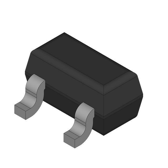

MMBT3906TT1 General Purpose Transistors PNP Silicon This transistor is designed for general purpose amplifier applications. It is housed in the SOT−416/SC−75 package which is designed for low power surface mount applications. Features • Pb−Free Package is Available • NSVM Prefix for Automotive and Other Applications Requiring www.onsemi.com GENERAL PURPOSE AMPLIFIER TRANSISTORS SURFACE MOUNT COLLECTOR 3 Unique Site and Control Change Requirements 1 BASE MAXIMUM RATINGS (TA = 25°C) Symbol Value Unit Collector−Emitter Voltage VCEO −40 Vdc Collector−Base Voltage VCBO −40 Vdc Emitter−Base Voltage VEBO −5.0 Vdc IC −200 mAdc Rating Collector Current − Continuous Total Device Dissipation, FR−4 Board (Note 1) @TA = 25°C Derated above 25°C Thermal Resistance, Junction−to−Ambient (Note 1) Total Device Dissipation, FR−4 Board (Note 2) @TA = 25°C Derated above 25°C 3 Symbol PD RqJA PD Max Unit 200 1.6 mW mW/°C 600 °C/W CASE 463 SOT−416/SC−75 STYLE 1 2 1 THERMAL CHARACTERISTICS Characteristic 2 EMITTER MARKING DIAGRAM 2A M G G 1 300 2.4 mW mW/°C Thermal Resistance, Junction−to−Ambient (Note 2) RqJA 400 °C/W Junction and Storage Temperature Range TJ, Tstg −55 to +150 °C Stresses exceeding those listed in the Maximum Ratings table may damage the device. If any of these limits are exceeded, device functionality should not be assumed, damage may occur and reliability may be affected. 1. FR−4 @ Minimum Pad 2. FR−4 @ 1.0 × 1.0 Inch Pad 2A = Device Code M = Date Code* G = Pb−Free Package (Note: Microdot may be in either location) *Date Code orientation may vary depending upon manufacturing location. ORDERING INFORMATION Device Package MMBT3906TT1 SOT−416 MMBT3906TT1G SOT−416 (Pb−Free) NSVMMBT3906TT1G SOT−416 (Pb−Free) Shipping† 3000 / Tape & Reel 3000 / Tape & Reel †For information on tape and reel specifications, including part orientation and tape sizes, please refer to our Tape and Reel Packaging Specifications Brochure, BRD8011/D. © Semiconductor Components Industries, LLC, 2006 May, 2017 − Rev. 2 1 Publication Order Number: MMBT3906TT1/D MMBT3906TT1 ELECTRICAL CHARACTERISTICS (TA = 25°C unless otherwise noted) Characteristic Symbol Min Max −40 − −40 − −5.0 − − −50 − −50 60 80 100 60 30 − − 300 − − − − −0.25 −0.4 −0.65 − −0.85 −0.95 250 − − 4.5 − 10.0 2.0 12 0.1 10 100 400 3.0 60 − 4.0 Unit OFF CHARACTERISTICS Collector −Emitter Breakdown Voltage (Note 3) (IC = −1.0 mAdc, IB = 0) V(BR)CEO Collector −Base Breakdown Voltage (IC = −10 mAdc, IE = 0) V(BR)CBO Emitter −Base Breakdown Voltage (IE = −10 mAdc, IC = 0) V(BR)EBO Base Cutoff Current (VCE = −30 Vdc, VEB = −3.0 Vdc) IBL Collector Cutoff Current (VCE = −30 Vdc, VEB = −3.0 Vdc) ICEX Vdc Vdc Vdc nAdc nAdc ON CHARACTERISTICS (Note 3) DC Current Gain (IC = −0.1 mAdc, VCE = −1.0 Vdc) (IC = −1.0 mAdc, VCE = −1.0 Vdc) (IC = −10 mAdc, VCE = −1.0 Vdc) (IC = −50 mAdc, VCE = −1.0 Vdc) (IC = −100 mAdc, VCE = −1.0 Vdc) hFE Collector −Emitter Saturation Voltage (IC = −10 mAdc, IB = −1.0 mAdc) (IC = −50 mAdc, IB = −5.0 mAdc) VCE(sat) Base −Emitter Saturation Voltage (IC = −10 mAdc, IB = −1.0 mAdc) (IC = −50 mAdc, IB = −5.0 mAdc) VBE(sat) − Vdc Vdc SMALL− SIGNAL CHARACTERISTICS Current −Gain − Bandwidth Product (IC = −10 mAdc, VCE = −20 Vdc, f = 100 MHz) fT Output Capacitance (VCB = −5.0 Vdc, IE = 0, f = 1.0 MHz) Cobo Input Capacitance1 (VEB = −0.5 Vdc, IC = 0, f = 1.0 MHz) Cibo Input Impedance (VCE = −10 Vdc, IC = −1.0 mAdc, f = 1.0 kHz) hie Voltage Feedback Ratio (VCE = −10 Vdc, IC = −1.0 mAdc, f = 1.0 kHz) hre Small −Signal Current Gain (VCE = −10 Vdc, IC = −1.0 mAdc, f = 1.0 kHz) hfe Output Admittance (VCE = −10 Vdc, IC = −1.0 mAdc, f = 1.0 kHz) hoe Noise Figure (VCE = −5.0 Vdc, IC = −100 mAdc, RS = 1.0 k W, f = 1.0 kHz) NF MHz pF pF kW X 10− 4 − mmhos dB SWITCHING CHARACTERISTICS Delay Time (VCC = −3.0 Vdc, VBE = 0.5 Vdc) td − 35 Rise Time (IC = −10 mAdc, IB1 = −1.0 mAdc) tr − 35 Storage Time (VCC = −3.0 Vdc, IC = −10 mAdc) ts − 225 Fall Time (IB1 = IB2 = −1.0 mAdc) tf − 75 3. Pulse Test: Pulse Width v 300 ms, Duty Cycle v 2.0%. www.onsemi.com 2 ns ns r(t), NORMALIZED TRANSIENT THERMAL RESISTANCE MMBT3906TT1 1.0 D = 0.5 0.1 0.2 0.1 0.05 0.02 0.01 0.01 SINGLE PULSE 0.001 0.00001 0.0001 0.001 0.01 0.1 t, TIME (s) 1.0 10 100 1000 Figure 1. Normalized Thermal Response 3V 3V < 1 ns +9.1 V 275 275 < 1 ns 10 k 10 k 0 CS < 4 pF* +10.6 V 300 ns 1N916 10 < t1 < 500 ms DUTY CYCLE = 2% DUTY CYCLE = 2% t1 CS < 4 pF* 10.9 V * Total shunt capacitance of test jig and connectors Figure 2. Delay and Rise Time Equivalent Test Circuit Figure 3. Storage and Fall Time Equivalent Test Circuit www.onsemi.com 3 MMBT3906TT1 TYPICAL TRANSIENT CHARACTERISTICS 10 5000 7.0 3000 2000 5.0 VCC = 40 V IC/IB = 10 QT Cobo Q, CHARGE (pC) CAPACITANCE (pF) TJ = 25°C TJ = 125°C Cibo 3.0 2.0 1000 700 500 300 200 QA 100 1.0 0.1 0.2 0.3 0.5 0.7 1.0 2.0 3.0 70 50 20 30 40 5.0 7.0 10 1.0 2.0 3.0 5.0 7.0 10 20 30 50 70 100 REVERSE BIAS VOLTAGE (VOLTS) IC, COLLECTOR CURRENT (mA) Figure 4. Capacitance Figure 5. Charge Data 200 500 500 IC/IB = 10 300 200 VCC = 40 V IB1 = IB2 300 200 t f , FALL TIME (ns) IC/IB = 20 TIME (ns) 100 70 50 tr @ VCC = 3.0 V 30 20 10 7 5 15 V 40 V 2.0 V 2.0 3.0 5.0 7.0 10 20 30 50 70 100 70 50 200 IC/IB = 10 30 20 10 7 5 td @ VOB = 0 V 1.0 100 1.0 2.0 3.0 5.0 7.0 10 20 30 50 70 100 IC, COLLECTOR CURRENT (mA) IC, COLLECTOR CURRENT (mA) Figure 6. Turn −On Time Figure 7. Fall Time www.onsemi.com 4 200 MMBT3906TT1 TYPICAL AUDIO SMALL−SIGNAL CHARACTERISTICS NOISE FIGURE VARIATIONS (VCE = −5.0 Vdc, TA = 25°C, Bandwidth = 1.0 Hz) 5.0 4.0 f = 1.0 kHz SOURCE RESISTANCE = 200 W IC = 0.5 mA 3.0 SOURCE RESISTANCE = 2.0 k IC = 50 mA 2.0 SOURCE RESISTANCE = 2.0 k IC = 100 mA 1.0 0 0.1 0.2 0.4 1.0 2.0 4.0 10 f, FREQUENCY (kHz) IC = 1.0 mA 10 NF, NOISE FIGURE (dB) NF, NOISE FIGURE (dB) 12 SOURCE RESISTANCE = 200 W IC = 1.0 mA 20 40 IC = 0.5 mA 8.0 6.0 4.0 IC = 50 mA 2.0 IC = 100 mA 0 0.1 100 0.2 0.4 1.0 2.0 4.0 10 20 40 100 RS, SOURCE RESISTANCE (kW) Figure 8. Figure 9. h PARAMETERS (VCE = −10 Vdc, f = 1.0 kHz, TA = 25°C) 100 hoe, OUTPUT ADMITTANCE (m mhos) 300 hfe , CURRENT GAIN 200 100 70 50 70 50 30 20 10 7.0 5.0 30 0.1 0.2 0.3 0.5 0.7 1.0 2.0 3.0 IC, COLLECTOR CURRENT (mA) 5.0 7.0 10 0.1 0.2 Figure 10. Current Gain 10 5.0 7.0 10 h re , VOLTAGE FEEDBACK RATIO (X 10 -4 ) 10 10 h ie , INPUT IMPEDANCE (k Ω) 5.0 7.0 Figure 11. Output Admittance 20 7.0 5.0 3.0 2.0 1.0 0.7 0.5 0.3 0.2 0.5 0.7 1.0 2.0 3.0 0.3 IC, COLLECTOR CURRENT (mA) 0.1 0.2 0.3 0.5 0.7 1.0 2.0 3.0 IC, COLLECTOR CURRENT (mA) 5.0 7.0 10 7.0 5.0 3.0 2.0 1.0 0.7 0.5 0.1 Figure 12. Input Impedance 0.2 0.3 0.5 0.7 1.0 2.0 3.0 IC, COLLECTOR CURRENT (mA) Figure 13. Voltage Feedback Ratio www.onsemi.com 5 MMBT3906TT1 STATIC CHARACTERISTICS h FE, DC CURRENT GAIN (NORMALIZED) 2.0 TJ = +125°C VCE = 1.0 V +25°C 1.0 0.7 -55°C 0.5 0.3 0.2 0.1 0.1 0.2 0.3 0.5 0.7 1.0 2.0 3.0 5.0 7.0 10 IC, COLLECTOR CURRENT (mA) 20 30 50 70 100 200 VCE, COLLECTOR EMITTER VOLTAGE (VOLTS) Figure 14. DC Current Gain 1.0 TJ = 25°C 0.8 IC = 1.0 mA 10 mA 30 mA 100 mA 0.6 0.4 0.2 0 0.01 0.02 0.03 0.05 0.07 0.1 0.2 0.3 0.5 IB, BASE CURRENT (mA) 0.7 1.0 2.0 3.0 5.0 7.0 10 Figure 15. Collector Saturation Region TJ = 25°C V, VOLTAGE (VOLTS) 0.8 θV, TEMPERATURE COEFFICIENTS (mV/°C) 1.0 VBE(sat) @ IC/IB = 10 VBE @ VCE = 1.0 V 0.6 0.4 0.2 VCE(sat) @ IC/IB = 10 0 1.0 2.0 50 5.0 10 20 IC, COLLECTOR CURRENT (mA) 100 1.0 0.5 +25°C TO +125°C -55°C TO +25°C 0 -0.5 +25°C TO +125°C -1.0 qVS FOR VBE(sat) -55°C TO +25°C -1.5 -2.0 200 qVC FOR VCE(sat) 0 Figure 16. “ON” Voltages 20 40 60 80 100 120 140 IC, COLLECTOR CURRENT (mA) 160 Figure 17. Temperature Coefficients www.onsemi.com 6 180 200 MMBT3906TT1 PACKAGE DIMENSIONS SC−75/SOT−416 CASE 463−01 ISSUE G −E− NOTES: 1. DIMENSIONING AND TOLERANCING PER ANSI Y14.5M, 1982. 2. CONTROLLING DIMENSION: MILLIMETER. 2 3 b 3 PL 0.20 (0.008) e DIM A A1 b C D E e L HE −D− 1 M D HE C 0.20 (0.008) E INCHES NOM MAX 0.031 0.035 0.002 0.004 0.008 0.012 0.006 0.010 0.063 0.065 0.031 0.035 0.04 BSC 0.004 0.006 0.008 0.060 0.063 0.067 MIN 0.027 0.000 0.006 0.004 0.061 0.027 STYLE 1: PIN 1. BASE 2. EMITTER 3. COLLECTOR A L MILLIMETERS MIN NOM MAX 0.70 0.80 0.90 0.00 0.05 0.10 0.15 0.20 0.30 0.10 0.15 0.25 1.55 1.60 1.65 0.70 0.80 0.90 1.00 BSC 0.10 0.15 0.20 1.50 1.60 1.70 A1 SOLDERING FOOTPRINT* 0.356 0.014 1.803 0.071 0.787 0.031 0.508 0.020 1.000 0.039 SCALE 10:1 mm Ǔ ǒinches *For additional information on our Pb−Free strategy and soldering details, please download the ON Semiconductor Soldering and Mounting Techniques Reference Manual, SOLDERRM/D. ON Semiconductor and are trademarks of Semiconductor Components Industries, LLC dba ON Semiconductor or its subsidiaries in the United States and/or other countries. ON Semiconductor owns the rights to a number of patents, trademarks, copyrights, trade secrets, and other intellectual property. A listing of ON Semiconductor’s product/patent coverage may be accessed at www.onsemi.com/site/pdf/Patent−Marking.pdf. ON Semiconductor reserves the right to make changes without further notice to any products herein. ON Semiconductor makes no warranty, representation or guarantee regarding the suitability of its products for any particular purpose, nor does ON Semiconductor assume any liability arising out of the application or use of any product or circuit, and specifically disclaims any and all liability, including without limitation special, consequential or incidental damages. Buyer is responsible for its products and applications using ON Semiconductor products, including compliance with all laws, regulations and safety requirements or standards, regardless of any support or applications information provided by ON Semiconductor. “Typical” parameters which may be provided in ON Semiconductor data sheets and/or specifications can and do vary in different applications and actual performance may vary over time. All operating parameters, including “Typicals” must be validated for each customer application by customer’s technical experts. ON Semiconductor does not convey any license under its patent rights nor the rights of others. ON Semiconductor products are not designed, intended, or authorized for use as a critical component in life support systems or any FDA Class 3 medical devices or medical devices with a same or similar classification in a foreign jurisdiction or any devices intended for implantation in the human body. Should Buyer purchase or use ON Semiconductor products for any such unintended or unauthorized application, Buyer shall indemnify and hold ON Semiconductor and its officers, employees, subsidiaries, affiliates, and distributors harmless against all claims, costs, damages, and expenses, and reasonable attorney fees arising out of, directly or indirectly, any claim of personal injury or death associated with such unintended or unauthorized use, even if such claim alleges that ON Semiconductor was negligent regarding the design or manufacture of the part. ON Semiconductor is an Equal Opportunity/Affirmative Action Employer. This literature is subject to all applicable copyright laws and is not for resale in any manner. PUBLICATION ORDERING INFORMATION LITERATURE FULFILLMENT: Literature Distribution Center for ON Semiconductor 19521 E. 32nd Pkwy, Aurora, Colorado 80011 USA Phone: 303−675−2175 or 800−344−3860 Toll Free USA/Canada Fax: 303−675−2176 or 800−344−3867 Toll Free USA/Canada Email: orderlit@onsemi.com ◊ N. American Technical Support: 800−282−9855 Toll Free USA/Canada Europe, Middle East and Africa Technical Support: Phone: 421 33 790 2910 Japan Customer Focus Center Phone: 81−3−5817−1050 www.onsemi.com 7 ON Semiconductor Website: www.onsemi.com Order Literature: http://www.onsemi.com/orderlit For additional information, please contact your local Sales Representative MMBT3906TT1/D
