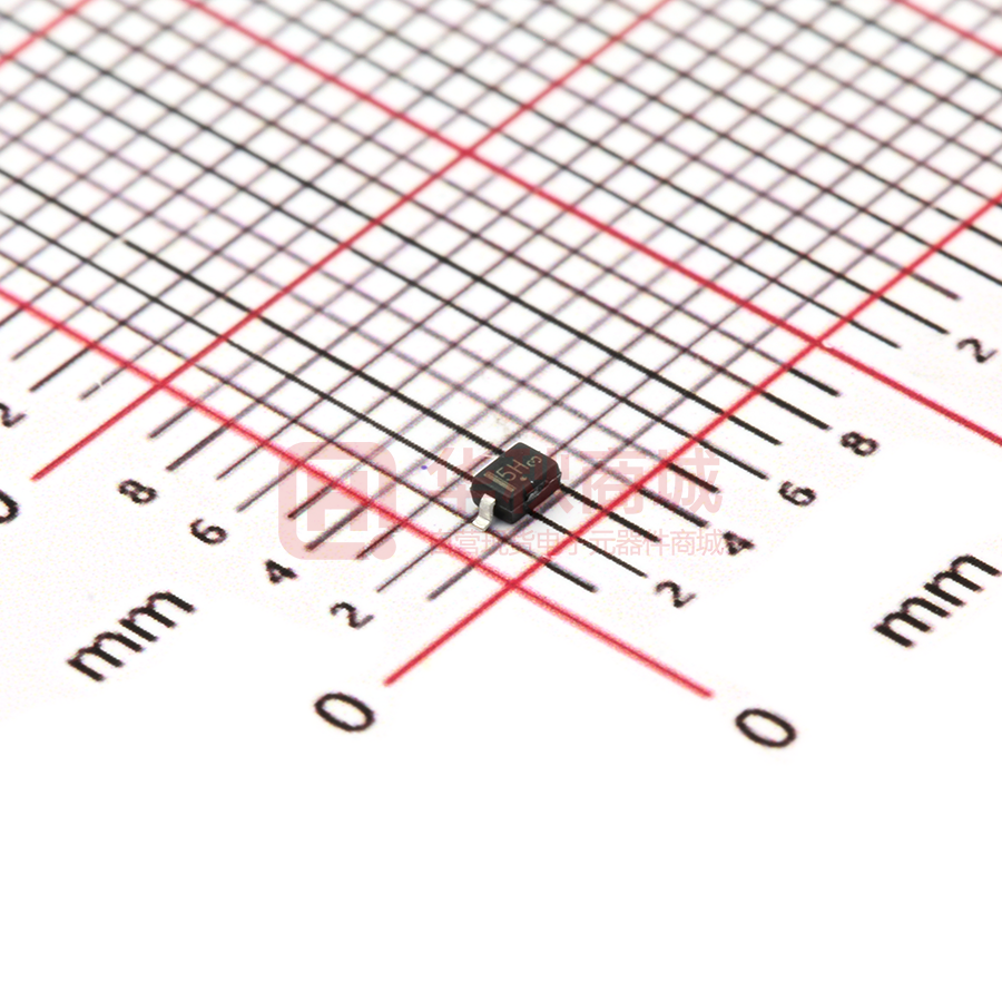

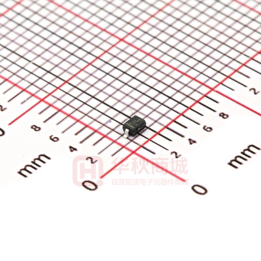

MMDL770T1G
MMDL770T1G
    ONSEMI(安森美)
    SOD-323
    肖特基二极管 Single VR=70V IF=10ma IR=9nA SOD323
MMDL770T1G 数据手册
MMDL770T1G Schottky Barrier Diode Schottky barrier diodes are designed primarily for high−efficiency UHF and VHF detector applications. Readily available to many other fast switching RF and digital applications. Features • • • • • Extremely Low Minority Carrier Lifetime Very Low Capacitance − 1.0 pF @ 20 V Low Reverse Leakage − 200 nA (max) High Reverse Voltage − 70 V (min) These Devices are Pb−Free, Halogen Free/BFR Free and are RoHS Compliant http://onsemi.com 1.0 pF SCHOTTKY BARRIER DIODE 1 CATHODE MAXIMUM RATINGS Rating Reverse Voltage Symbol Value Unit VR 70 Vdc Symbol Max Unit 200 1.57 mW mW/°C 2 ANODE 2 THERMAL CHARACTERISTICS Characteristic Total Device Dissipation FR−5 Board, (Note 1) @TA = 25°C Derate above 25°C PD Thermal Resistance, Junction−to−Ambient RqJA 635 °C/W Junction and Storage Temperature Range TJ, Tstg −55 to +150 °C 1 SOD−323 CASE 477 STYLE 1 MARKING DIAGRAM Stresses exceeding Maximum Ratings may damage the device. Maximum Ratings are stress ratings only. Functional operation above the Recommended Operating Conditions is not implied. Extended exposure to stresses above the Recommended Operating Conditions may affect device reliability. 1. FR−5 Minimum Pad 5H M G G 5H = Device Code M = Date Code* G = Pb−Free Package (Note: Microdot may be in either location) *Date Code orientation may vary depending upon manufacturing location. ORDERING INFORMATION Device Package Shipping† MMDL770T1G SOD−323 (Pb−Free) 3000 / Tape & Reel †For information on tape and reel specifications, including part orientation and tape sizes, please refer to our Tape and Reel Packaging Specifications Brochure, BRD8011/D. © Semiconductor Components Industries, LLC, 2011 June, 2011 − Rev. 3 1 Publication Order Number: MMDL770T1/D MMDL770T1G ELECTRICAL CHARACTERISTICS (TA = 25°C unless otherwise noted) Characteristic Symbol Reverse Breakdown Voltage (IR = 10 mA) V(BR)R Diode Capacitance (VR = 20 V, f = 1.0 MHZ) CT Reverse Leakage (VR = 35 V) IR Forward Voltage (IF = 1.0 mAdc) (IF = 10 mA) VF Min Typ Max 70 − − − 0.5 1.0 − 9.0 200 − − 0.42 0.7 0.5 1.0 Unit V pF nAdc Vdc TYPICAL CHARACTERISTICS 2.0 500 t , MINORITY CARRIER LIFETIME (ps) CT, TOTAL CAPACITANCE (pF) MMBD770T1 f = 1.0 MHz 1.6 1.2 0.8 0.4 0 MMBD770T1 400 KRAKAUER METHOD 300 200 100 0 0 5.0 10 15 20 25 30 35 VR, REVERSE VOLTAGE (VOLTS) 40 45 50 0 10 Figure 1. Total Capacitance 80 90 100 Figure 2. Minority Carrier Lifetime 10 100 MMBD770T1 MMBD770T1 IF, FORWARD CURRENT (mA) IR, REVERSE LEAKAGE ( m A) 30 50 70 40 60 IF, FORWARD CURRENT (mA) 20 TA = 100°C 1.0 TA = 75°C 0.1 10 TA = 85°C TA = -40°C 1.0 0.01 TA = 25°C TA = 25°C 0.1 0.001 0 10 20 30 VR, REVERSE VOLTAGE (VOLTS) 40 0.2 50 Figure 3. Reverse Leakage 0.4 0.8 1.2 VF, FORWARD VOLTAGE (VOLTS) Figure 4. Forward Voltage http://onsemi.com 2 1.6 2.0 MECHANICAL CASE OUTLINE PACKAGE DIMENSIONS 2 1 STYLE 1 SOD−323 CASE 477−02 ISSUE H 2 SCALE 4:1 NOTES: 1. DIMENSIONING AND TOLERANCING PER ANSI Y14.5M, 1982. 2. CONTROLLING DIMENSION: MILLIMETERS. 3. LEAD THICKNESS SPECIFIED PER L/F DRAWING WITH SOLDER PLATING. 4. DIMENSIONS A AND B DO NOT INCLUDE MOLD FLASH, PROTRUSIONS OR GATE BURRS. 5. DIMENSION L IS MEASURED FROM END OF RADIUS. HE D b 1 2 E A3 A C NOTE 3 DATE 13 MAR 2007 1 STYLE 2 L A1 NOTE 5 MILLIMETERS DIM MIN NOM MAX A 0.80 0.90 1.00 A1 0.00 0.05 0.10 A3 0.15 REF b 0.25 0.32 0.4 C 0.089 0.12 0.177 D 1.60 1.70 1.80 E 1.15 1.25 1.35 L 0.08 HE 2.30 2.50 2.70 INCHES NOM MAX 0.035 0.040 0.002 0.004 0.006 REF 0.010 0.012 0.016 0.003 0.005 0.007 0.062 0.066 0.070 0.045 0.049 0.053 0.003 0.090 0.098 0.105 MIN 0.031 0.000 GENERIC MARKING DIAGRAM* SOLDERING FOOTPRINT* XX M 0.63 0.025 STYLE 1 0.83 0.033 *This information is generic. Please refer to device data sheet for actual part marking. Pb−Free indicator, “G” or microdot “ G”, may or may not be present. 2.85 0.112 *For additional information on our Pb−Free strategy and soldering details, please download the ON Semiconductor Soldering and Mounting Techniques Reference Manual, SOLDERRM/D. DESCRIPTION: 98ASB17533C SOD−323 STYLE 2 XX = Specific Device Code M = Date Code 1.60 0.063 DOCUMENT NUMBER: XX M STYLE 1: PIN 1. CATHODE (POLARITY BAND) 2. ANODE STYLE 2: NO POLARITY Electronic versions are uncontrolled except when accessed directly from the Document Repository. Printed versions are uncontrolled except when stamped “CONTROLLED COPY” in red. PAGE 1 OF 1 ON Semiconductor and are trademarks of Semiconductor Components Industries, LLC dba ON Semiconductor or its subsidiaries in the United States and/or other countries. ON Semiconductor reserves the right to make changes without further notice to any products herein. ON Semiconductor makes no warranty, representation or guarantee regarding the suitability of its products for any particular purpose, nor does ON Semiconductor assume any liability arising out of the application or use of any product or circuit, and specifically disclaims any and all liability, including without limitation special, consequential or incidental damages. ON Semiconductor does not convey any license under its patent rights nor the rights of others. © Semiconductor Components Industries, LLC, 2019 www.onsemi.com onsemi, , and other names, marks, and brands are registered and/or common law trademarks of Semiconductor Components Industries, LLC dba “onsemi” or its affiliates and/or subsidiaries in the United States and/or other countries. onsemi owns the rights to a number of patents, trademarks, copyrights, trade secrets, and other intellectual property. A listing of onsemi’s product/patent coverage may be accessed at www.onsemi.com/site/pdf/Patent−Marking.pdf. onsemi reserves the right to make changes at any time to any products or information herein, without notice. The information herein is provided “as−is” and onsemi makes no warranty, representation or guarantee regarding the accuracy of the information, product features, availability, functionality, or suitability of its products for any particular purpose, nor does onsemi assume any liability arising out of the application or use of any product or circuit, and specifically disclaims any and all liability, including without limitation special, consequential or incidental damages. Buyer is responsible for its products and applications using onsemi products, including compliance with all laws, regulations and safety requirements or standards, regardless of any support or applications information provided by onsemi. “Typical” parameters which may be provided in onsemi data sheets and/or specifications can and do vary in different applications and actual performance may vary over time. All operating parameters, including “Typicals” must be validated for each customer application by customer’s technical experts. onsemi does not convey any license under any of its intellectual property rights nor the rights of others. onsemi products are not designed, intended, or authorized for use as a critical component in life support systems or any FDA Class 3 medical devices or medical devices with a same or similar classification in a foreign jurisdiction or any devices intended for implantation in the human body. Should Buyer purchase or use onsemi products for any such unintended or unauthorized application, Buyer shall indemnify and hold onsemi and its officers, employees, subsidiaries, affiliates, and distributors harmless against all claims, costs, damages, and expenses, and reasonable attorney fees arising out of, directly or indirectly, any claim of personal injury or death associated with such unintended or unauthorized use, even if such claim alleges that onsemi was negligent regarding the design or manufacture of the part. onsemi is an Equal Opportunity/Affirmative Action Employer. This literature is subject to all applicable copyright laws and is not for resale in any manner. PUBLICATION ORDERING INFORMATION LITERATURE FULFILLMENT: Email Requests to: orderlit@onsemi.com onsemi Website: www.onsemi.com ◊ TECHNICAL SUPPORT North American Technical Support: Voice Mail: 1 800−282−9855 Toll Free USA/Canada Phone: 011 421 33 790 2910 Europe, Middle East and Africa Technical Support: Phone: 00421 33 790 2910 For additional information, please contact your local Sales Representative
