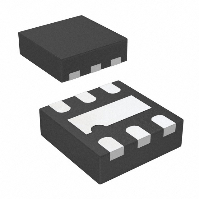

DATA SHEET www.onsemi.com 150mA, Very Low Dropout Bias Rail CMOS Voltage Regulator MARKING DIAGRAM XDFN6 CASE 711AT NCP120 The NCP120 is a 150 mA VLDO equipped with NMOS pass transistor and a separate bias supply voltage (VBIAS). The device provides very stable, accurate output voltage with low noise suitable for space constrained, noise sensitive applications. In order to optimize performance for battery operated portable applications, the NCP120 features low IQ consumption. The XDFN6 1.2 mm x 1.2 mm package is optimized for use in space constrained applications. Features • • • • • • • • • • • • • Input Voltage Range: 0.8 V to 5.5 V Bias Voltage Range: 2.4 V to 5.5 V Fixed Output Voltage Device Output Voltage Range: 0.8 V to 2.1 V ±1.5% Accuracy over Temperature, 0.5% VOUT @ 25°C Ultra−Low Dropout: 75 mV Maximum at 150 mA Very Low Bias Input Current of Typ. 80 mA Very Low Bias Input Current in Disable Mode: Typ. 0.5 mA Logic Level Enable Input for ON/OFF control Output Active Discharge Option available Stable with a 1 mF Ceramic Capacitor Available in XDFN6 − 1.2 mm x 1.2 mm x 0.4 mm package These Devices are Pb−Free, Halogen Free/BFR Free and are RoHS Compliant XX M XX = Specific Device Code M = Date Code PIN CONNECTIONS OUT 6 1 NC 2 EN 3 Thermal Pad IN 5 GND 4 BIAS (Top VIew) ORDERING INFORMATION See detailed ordering, marking and shipping information on page 7 of this data sheet. Typical Applications • Battery−powered Equipment • Smartphones, Tablets • Cameras, DVRs, STB and Camcorders VBIAS 2.7 V NCP120 100 nF BIAS VIN 1.2 V OUT IN 1 mF EN 1 mF VOUT 1.05 V @ 150 mA GND VEN Figure 1. Typical Application Schematics © Semiconductor Components Industries, LLC, 2015 October, 2022 − Rev. 3 1 Publication Order Number: NCP120/D NCP120 CURRENT LIMIT IN OUT ENABLE BLOCK EN UVLO BIAS 150 W VOLTAGE REFERENCE + − THERMAL LIMIT *Active DISCHARGE GND *Active output discharge function is present only in NCP120AMXyyyTCG devices. yyy denotes the particular output voltage option. Figure 2. Simplified Schematic Block Diagram PIN FUNCTION DESCRIPTION Pin No. Pin Name 1 OUT Regulated Output Voltage pin 2 N/C Not internally connected 3 EN Enable pin. Driving this pin high enables the regulator. Driving this pin low puts the regulator into shutdown mode. 4 BIAS Bias voltage supply for internal control circuits. This pin is monitored by internal Under-Voltage Lockout Circuit. 5 GND Ground pin 6 IN Pad Description Input Voltage Supply pin Should be soldered to the ground plane for increased thermal performance. ABSOLUTE MAXIMUM RATINGS Rating Input Voltage (Note 1) Output Voltage Chip Enable and Bias Input Symbol Value Unit VIN −0.3 to 6 V VOUT −0.3 to (VIN+0.3) ≤ 6 V VEN, VBIAS −0.3 to 6 V Output Short Circuit Duration tSC unlimited s Maximum Junction Temperature TJ 150 °C TSTG −55 to 150 °C ESD Capability, Human Body Model (Note 2) ESDHBM 2000 V ESD Capability, Machine Model (Note 2) ESDMM 200 V Storage Temperature Stresses exceeding those listed in the Maximum Ratings table may damage the device. If any of these limits are exceeded, device functionality should not be assumed, damage may occur and reliability may be affected. 1. Refer to ELECTRICAL CHARACTERISTIS and APPLICATION INFORMATION for Safe Operating Area. 2. This device series incorporates ESD protection (except OUT pin) and is tested by the following methods: ESD Human Body Model tested per EIA/JESD22−A114 ESD Machine Model tested per EIA/JESD22−A115 Latchup Current Maximum Rating tested per JEDEC standard: JESD78. THERMAL CHARACTERISTICS Rating Thermal Characteristics, XDFN6 1.2 mm x 1.2 mm Thermal Resistance, Junction−to−Air www.onsemi.com 2 Symbol Value Unit RqJA 170 °C/W NCP120 ELECTRICAL CHARACTERISTICS −40°C ≤ TJ ≤ 85°C; VBIAS = 2.7 V or (VOUT + 1.6 V), whichever is greater, VIN = VOUT(NOM) + 0.3 V, IOUT = 1 mA, VEN = 1 V, unless otherwise noted. CIN = 1 mF, CBIAS = 0.1 mF, COUT = 1 mF (effective capacitance) (Note 3). Typical values are at TJ = +25°C. Min/Max values are for −40°C ≤ TJ ≤ 85°C unless otherwise noted. (Note 4) Parameter Test Conditions Symbol Min VIN Operating Bias Voltage Range VBIAS Undervoltage Lock−out VBIAS Rising Hysteresis UVLO Output Voltage Accuracy VOUT Operating Input Voltage Range −40°C ≤ TJ ≤ 85°C, VOUT(NOM) + 0.3 V ≤ VIN ≤ 5.0 V, 2.7 V or (VOUT(NOM) + 1.6 V), whichever is greater < VBIAS < 5.5 V, 1 mA < IOUT < 150 mA Output Voltage Accuracy Typ Max Unit VOUT+VDO 5.5 V (VOUT+1.35) ≥2.4 5.5 V 1.6 0.2 −1.5 V +1.5 % VOUT ±0.5 % VIN Line Regulation VOUT(NOM) + 0.3 V ≤ VIN ≤ 5.0 V LineReg 0.01 %/V VBIAS Line Regulation 2.7 V or (VOUT(NOM) + 1.6 V), whichever is greater < VBIAS < 5.5 V LineReg 0.01 %/V Load Regulation IOUT = 1 mA to 150 mA LoadReg 1.5 mV VIN Dropout Voltage IOUT = 150 mA (Note 5) VDO 37 75 mV VBIAS Dropout Voltage IOUT = 150 mA, VIN = VBIAS (Note 5) VDO 1.1 1.4 V Output Current Limit VOUT = 90% VOUT(NOM) ICL 330 600 mA Bias Pin Operating Current VBIAS = 2.7 V IBIAS 80 110 mA Bias Pin Disable Current VEN ≤ 0.4 V IBIAS(DIS) 0.5 1 mA Vinput Pin Disable Current VEN ≤ 0.4 V IVIN(DIS) 0.5 1 mA EN Pin Threshold Voltage EN Input Voltage “H” VEN(H) EN Input Voltage “L” VEN(L) EN Pull Down Current VEN = 5.5 V IEN 0.3 Turn−On Time COUT = 1 mF, From assertion of VEN to VOUT = 98% VOUT(NOM), VOUT(NOM) = 1.05 V tON 150 ms Power Supply Rejection Ratio VIN to VOUT, f = 1 kHz, IOUT = 150 mA, VIN ≥ VOUT +0.5 V PSRR(VIN) 70 dB VBIAS to VOUT, f = 1 kHz, IOUT = 150 mA, VIN ≥ VOUT +0.5 V PSRR(VBIAS) 80 dB Output Noise Voltage VIN = VOUT +0.5 V, VOUT(NOM) = 1.05 V, f = 10 Hz to 100 kHz VN 40 mVRMS Thermal Shutdown Threshold Temperature increasing 160 °C Temperature decreasing 140 Output Discharge Pull−Down VEN ≤ 0.4 V, VOUT = 0.5 V, NCP120A options only RDISCH 200 V 0.9 0.4 150 1.0 mA W Product parametric performance is indicated in the Electrical Characteristics for the listed test conditions, unless otherwise noted. Product performance may not be indicated by the Electrical Characteristics if operated under different conditions. 3. Effective capacitance, including the effect of DC bias, tolerance and temperature. See the Application Information section for more information. 4. Performance guaranteed over the indicated operating temperature range by design and/or characterization. Production tested at TA = 25°C. Low duty cycle pulse techniques are used during the testing to maintain the junction temperature as close to ambient as possible. 5. Dropout voltage is characterized when VOUT falls 3% below VOUT(NOM). www.onsemi.com 3 NCP120 APPLICATIONS INFORMATION 2.6 . V − 4.2 V VBAT NCP120 EN DC/DC 1.2 V VOUT(NOM) LX IN EN Processor BIAS 1.2 V OUT 1.05 V IN LOAD GND FB GND I/O I/O To other circuits Figure 3. Typical Application: Low−Voltage Post−Regulator with ON/OFF functionality www.onsemi.com 4 NCP120 TYPICAL CHARACTERISTICS VDO (VBIAS − VOUT) DROPOUT VOLTAGE (mV) 60 VDO (VIN − VOUT) DROPOUT VOLTAGE (mV) VDO (VIN − VOUT) DROPOUT VOLTAGE (mV) AT TJ = +25°C, VIN = VOUT(TYP) + 0.3 V, VBIAS = 2.7 V, VEN = VBIAS, VOUT(NOM) = 1.05 V, IOUT = 150 MA, CIN = 1 MF, CBIAS = 0.1 MF, AND COUT = 1 MF (EFFECTIVE CAPACITANCE), UNLESS OTHERWISE NOTED. 50 +125°C 40 +85°C +25°C 30 −40°C 20 10 0 50 0 150 100 IOUT = 150 mA 180 160 140 120 100 80 +125°C 60 +85°C +25°C −40°C 40 20 0 0.5 1.0 1.5 2.0 2.5 3.0 3.5 4.0 IOUT, OUTPUT CURRENT (mA) VBIAS − VOUT (V) Figure 4. VIN Dropout Voltage vs. IOUT and Temperature TJ Figure 5. VIN Dropout Voltage vs. (VBIAS − VOUT) and Temperature TJ 4.5 140 1400 1300 120 −40°C +25°C IBIAS (mA) 1100 +85°C 1000 +125°C +125°C +85°C 100 1200 80 60 +25°C −40°C 40 900 800 200 20 50 0 0 150 100 50 0 150 100 IOUT, OUTPUT CURRENT (mA) IOUT, OUTPUT CURRENT (mA) Figure 6. VBIAS Dropout Voltage vs. IOUT and Temperature TJ Figure 7. BIAS Pin Current vs. IOUT and Temperature TJ 600 200 180 ICL, CURRENT LIMIT (mA) 160 IBIAS (mA) 140 120 +125°C +85°C 100 80 60 40 20 0 2.0 +25°C −40°C 2.5 3.0 3.5 4.0 4.5 5.0 500 300 +25°C +125°C −40°C 200 100 0 5.5 +85°C 400 0 0.5 1.0 1.5 2.0 2.5 3.0 3.5 4.0 4.5 VBIAS (V) VBIAS − VOUT (V) Figure 8. BIAS Pin Current vs. VBIAS and Temperature TJ Figure 9. Current Limit vs. (VBIAS − VOUT) www.onsemi.com 5 5.0 NCP120 APPLICATIONS INFORMATION In applications where no low input supplies impedance available (PCB inductance in VIN and/or VBIAS inputs as example), the recommended CIN = 1 mF and CBIAS = 0.1 mF or greater. Ceramic capacitors are recommended. For the best performance all the capacitors should be connected to the NCP120 respective pins directly in the device PCB copper layer, not through vias having not negligible impedance. When using small ceramic capacitor, their capacitance is not constant but varies with applied DC biasing voltage, temperature and tolerance. The effective capacitance can be much lower than their nominal capacitance value, most importantly in negative temperatures and higher LDO output voltages. That is why the recommended Output capacitor capacitance value is specified as Effective value in the specific application conditions. The NCP120 dual−rail very low dropout voltage regulator is using NMOS pass transistor for output voltage regulation from VIN voltage. All the low current internal controll circuitry is powered from the VBIAS voltage. The use of an NMOS pass transistor offers several advantages in applications. Unlike a PMOS topology devices, the output capacitor has reduced impact on loop stability. VIN to VOUT operating voltage difference can be very low compared with standard PMOS regulators in very low VIN applications. The NCP120 offers smooth monotonic start-up. The controlled voltage rising limits the inrush current. The Enable (EN) input is equipped with internal hysteresis. NCP120 is a Fixed Voltage linear regulator. Dropout Voltage Because of two power supply inputs VIN and VBIAS and one VOUT regulator output, there are two Dropout voltages specified. The first, the VIN Dropout voltage is the voltage difference (VIN – VOUT) when VOUT starts to decrease by percents specified in the Electrical Characteristics table. VBIAS is high enough, specific value is published in the Electrical Characteristics table. The second, VBIAS dropout voltage is the voltage difference (VBIAS – VOUT) when VIN and VBIAS pins are joined together and VOUT starts to decrease. Enable Operation The enable pin will turn the regulator on or off. The threshold limits are covered in the electrical characteristics table in this data sheet. If the enable function is not to be used then the pin should be connected to VIN or VBIAS. Current Limitation The internal Current Limitation circuitry allows the device to supply the full nominal current and surges but protects the device against Current Overload or Short. Thermal Protection Internal thermal shutdown (TSD) circuitry is provided to protect the integrated circuit in the event that the maximum junction temperature is exceeded. When TSD activated , the regulator output turns off. When cooling down under the low temperature threshold, device output is activated again. This TSD feature is provided to prevent failures from accidental overheating. Input and Output Capacitors The device is designed to be stable for ceramic output capacitors with Effective capacitance in the range from 1 mF to 10 mF. The device is also stable with multiple capacitors in parallel, having the total effective capacitance in the specified range. www.onsemi.com 6 NCP120 ORDERING INFORMATION Nominal Output Voltage Marking Marking Rotation NCP120AMX080TCG 0.80 V A 180° NCP120AMX105TCG 1.05 V D 180° NCP120AMX110TCG (Note 6) 1.10 V E 180° NCP120AMX115TCG 1.15 V F 180° NCP120AMX120TCG 1.20 V J 180° NCP120AMX150TCG 1.50 V K 180° NCP120AMX180TCG 1.80 V L 180° NCP120AMX210TCG 2.10 V P 180° NCP120BMX080TCG 0.80 V A 270° NCP120BMX105TCG 1.05 V D 270° NCP120BMX110TCG 1.10 V E 270° NCP120BMX115TCG 1.15 V F 270° NCP120BMX120TCG 1.20 V J 270° NCP120BMX150TCG 1.50 V K 270° NCP120BMX180TCG 1.80 V L 270° NCP120BMX210TCG 2.10 V P 270° Device Option Package Shipping† XDFN6 (Pb−Free) 3000 or 5000 / Tape & Reel (Note 6) Output Active Discharge Non−Active Discharge †For information on tape and reel specifications, including part orientation and tape sizes, please refer to our Tape and Reel Packaging Specifications Brochure, BRD8011/D. To order other package and voltage variants, please contact your onsemi sales representative 6. Product processed after October 1, 2022 are shipped with quantity 5000 units / tape & reel. www.onsemi.com 7 MECHANICAL CASE OUTLINE PACKAGE DIMENSIONS XDFN6 1.20x1.20, 0.40P CASE 711AT ISSUE C SCALE 4:1 D PIN ONE REFERENCE DATE 04 DEC 2015 NOTES: 1. DIMENSIONING AND TOLERANCING PER ASME Y14.5M, 1994. 2. CONTROLLING DIMENSION: MILLIMETERS. 3. DIMENSION b APPLIES TO THE PLATED TERMINALS. 4. COPLANARITY APPLIES TO THE PAD AS WELL AS THE TERMINALS. A B ÍÍÍ ÍÍÍ ÍÍÍ E L TOP VIEW DETAIL A OPTIONAL CONSTRUCTION A 0.05 C DIM A A1 b D D2 E E2 e L L1 A1 GENERIC MARKING DIAGRAM* 0.05 C C SIDE VIEW NOTE 4 MILLIMETERS TYP MAX 0.37 0.45 0.03 0.05 0.18 0.23 1.20 1.25 0.94 1.04 1.20 1.25 0.40 0.30 0.40 BSC 0.15 0.20 0.25 0.05 0.00 0.10 MIN 0.30 0.00 0.13 1.15 0.84 1.15 0.20 SEATING PLANE XX M D2 1 3 6X L1 XX = Specific Device Code M = Date Code E2 6X *This information is generic. Please refer to device data sheet for actual part marking. Pb−Free indicator, “G” or microdot “ G”, may or may not be present. L 6 DETAIL A 4 6X e b 0.10 BOTTOM VIEW M C A B NOTE 3 RECOMMENDED MOUNTING FOOTPRINT* 1.08 PACKAGE OUTLINE 6X 0.37 1.40 0.40 1 0.40 PITCH 6X 0.24 DIMENSIONS: MILLIMETERS *For additional information on our Pb−Free strategy and soldering details, please download the ON Semiconductor Soldering and Mounting Techniques Reference Manual, SOLDERRM/D. DOCUMENT NUMBER: DESCRIPTION: 98AON76141F XDFN6, 1.20 X 1.20, 0.40P Electronic versions are uncontrolled except when accessed directly from the Document Repository. Printed versions are uncontrolled except when stamped “CONTROLLED COPY” in red. PAGE 1 OF 1 ON Semiconductor and are trademarks of Semiconductor Components Industries, LLC dba ON Semiconductor or its subsidiaries in the United States and/or other countries. ON Semiconductor reserves the right to make changes without further notice to any products herein. ON Semiconductor makes no warranty, representation or guarantee regarding the suitability of its products for any particular purpose, nor does ON Semiconductor assume any liability arising out of the application or use of any product or circuit, and specifically disclaims any and all liability, including without limitation special, consequential or incidental damages. ON Semiconductor does not convey any license under its patent rights nor the rights of others. © Semiconductor Components Industries, LLC, 2019 www.onsemi.com onsemi, , and other names, marks, and brands are registered and/or common law trademarks of Semiconductor Components Industries, LLC dba “onsemi” or its affiliates and/or subsidiaries in the United States and/or other countries. onsemi owns the rights to a number of patents, trademarks, copyrights, trade secrets, and other intellectual property. A listing of onsemi’s product/patent coverage may be accessed at www.onsemi.com/site/pdf/Patent−Marking.pdf. onsemi reserves the right to make changes at any time to any products or information herein, without notice. The information herein is provided “as−is” and onsemi makes no warranty, representation or guarantee regarding the accuracy of the information, product features, availability, functionality, or suitability of its products for any particular purpose, nor does onsemi assume any liability arising out of the application or use of any product or circuit, and specifically disclaims any and all liability, including without limitation special, consequential or incidental damages. Buyer is responsible for its products and applications using onsemi products, including compliance with all laws, regulations and safety requirements or standards, regardless of any support or applications information provided by onsemi. “Typical” parameters which may be provided in onsemi data sheets and/or specifications can and do vary in different applications and actual performance may vary over time. All operating parameters, including “Typicals” must be validated for each customer application by customer’s technical experts. onsemi does not convey any license under any of its intellectual property rights nor the rights of others. onsemi products are not designed, intended, or authorized for use as a critical component in life support systems or any FDA Class 3 medical devices or medical devices with a same or similar classification in a foreign jurisdiction or any devices intended for implantation in the human body. Should Buyer purchase or use onsemi products for any such unintended or unauthorized application, Buyer shall indemnify and hold onsemi and its officers, employees, subsidiaries, affiliates, and distributors harmless against all claims, costs, damages, and expenses, and reasonable attorney fees arising out of, directly or indirectly, any claim of personal injury or death associated with such unintended or unauthorized use, even if such claim alleges that onsemi was negligent regarding the design or manufacture of the part. onsemi is an Equal Opportunity/Affirmative Action Employer. This literature is subject to all applicable copyright laws and is not for resale in any manner. PUBLICATION ORDERING INFORMATION LITERATURE FULFILLMENT: Email Requests to: orderlit@onsemi.com onsemi Website: www.onsemi.com ◊ TECHNICAL SUPPORT North American Technical Support: Voice Mail: 1 800−282−9855 Toll Free USA/Canada Phone: 011 421 33 790 2910 Europe, Middle East and Africa Technical Support: Phone: 00421 33 790 2910 For additional information, please contact your local Sales Representative
