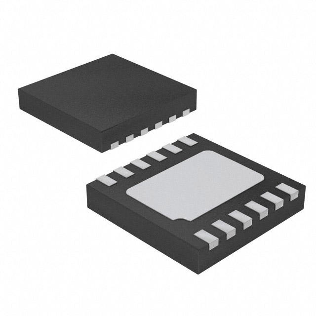

NCS5652, NCV5652 Dual Power Operational Amplifier Description The NCx5652 is a dual power operational amplifier with a versatile output stage configuration that allows conventional op−amp biasing or user tuning of efficiency, isolation, or current monitoring. Integrated flyback diodes protect the amplifiers during inductive load transients. Operating at supply voltages as low as 3.3 V, the NCx5652 is capable of delivering 500 mA of current while maintaining an excellent output swing. The integrated thermal shutdown circuit protects the NCx5652 from excessive power dissipation. A thermal warning flag is provided for external monitoring of the device, providing a flexible interface to a system’s microcontroller. This open−collector thermal flag output doubles as a DISABLE input that can be used to tri−state both amplifier outputs under user control. The 12−pin UDFN 3x3 mm package provides thermal robustness while achieving space savings on high density PCBs. www.onsemi.com 1 UDFN12 MU SUFFIX CASE 517AM MARKING DIAGRAM Features • • • • • • • • • • Operating Supply Voltage Range: 3.3 V to 13.2 V Output Supply Voltage Range: 3.3 V to 13.2 V High Current Drive: 500 mA Operating Thermal Flag: Open−collector for Flexible Interface Thermal Shutdown/ Disable Function Output Short Circuit Tolerable (1 A to Source or Ground) No Power Sequencing Required (VCC, VC1, VC2) UDFN12 Package Features Wettable Flank for Improved Solderability NCV Prefix for Automotive and Other Applications Requiring Unique Site and Control Change Requirements; AEC−Q100 Qualified and PPAP Capable These Devices are Pb−Free, Halogen Free/BFR Free and are RoHS Compliant Typical Applications • • • • • Telecom Vcom Driver Small DC Brush Motors LED String Driver Electrochromic Driver N5652 ALYWG G N5652 = Specific Device Code A = Assembly Location L = Wafer Lot Y = Year W = Work Week G = Pb−Free Package (Note: Microdot may be in either location) IN1− 1 IN1+ 2 − + DISABLE/Tflag 3 IN2+ 4 IN2− 5 GND 6 + − EXPOSED THERMAL PAD (13) 12 GND 11 OUT1 10 VC1 9 VCC 8 VC2 7 OUT2 ORDERING INFORMATION See detailed ordering and shipping information on page 12 of this data sheet. © Semiconductor Components Industries, LLC, 2015 June, 2015 − Rev. 1 1 Publication Order Number: NCS5652/D NCS5652, NCV5652 VCC EN VCC IN1− IN1+ 10 VC1 − 1 Class AB Bias 2 11 OUT1 + VCC 9 EN DISABLE/ Tflag 3 12 GND Thermal Detection VCC EN VCC IN2+ 4 IN2− VCC + − 5 Class AB Bias 6 GND 8 VC2 7 OUT2 Exposed Pad (13) Figure 1. Block Diagram Table 1. PIN DESCRIPTION Pin Name Type 1 IN1− Input Negative input of amplifier 1. Description Positive input of amplifier 1. 2 IN1+ Input 3 DISABLE/Tflag Input/Output 4 IN2+ Input Positive input of amplifier 2. 5 IN2− Input Negative input of amplifier 2. Dual use pin −Thermal flag− an open collector output requiring an external pull−up resistor. The output is pulled low when the thermal limit is reached. It is high−impedance in normal operation. Disable − Must use an open collector/drain for input with pull−up resistor to Vcc. Pulling pin low disables the amplifiers. If pin is not used, a pull−up resistor to Vcc is still required (10 KW recommended) 6 GND Power Power ground. 7 OUT2 Output Output of amplifier 2. 8 VC2 Power Positive supply of output stage 2. 9 VCC Power Positive supply of core circuitry. 10 VC1 Power Positive supply of output stage 1. 11 OUT1 Output Output of amplifier 1. 12 GND Power Power ground. 13 EXPOSED PAD Power The Exposed Pad must be attached to a heat−sinking conduit and connected to GND. www.onsemi.com 2 NCS5652, NCV5652 Table 2. ABSOLUTE MAXIMUM RATINGS Over operating free−air temperature, unless otherwise stated Symbol Limit Unit VCC 16 V VC1, VC2 16 V Vid ±VCC V VICR −0.3 to VCC +0.3 V IOUT ±1000 mA VDISABLE/Tflag 7 V Storage Temperature TSTG −65 to 165 °C Junction Temperature TJ(MAX) 150 °C Human Body Model HBM ±1500 (IN−, Tflag pins). ±2000 (All other pins) V Machine Model MM ±150( IN−, Tflag pins). ±200 (All other pins) V CDM ±2500 V Parameter Supply Voltage (VCC − GND) Output Supply Voltage INPUT AND OUTPUT PINS Differential Input Voltage Input Common Mode Voltage Range Output Current (Note 1) DISABLE/Tflag Pin Voltage (Note 2) TEMPERATURE ESD RATINGS (Note 3) Charge Device Model Stresses exceeding those listed in the Maximum Ratings table may damage the device. If any of these limits are exceeded, device functionality should not be assumed, damage may occur and reliability may be affected. 1. Continuous short−to−ground or source; power dissipation must be taken into consideration. 2. Connected to voltage source via a pull−up resistor. 3. This device series incorporates ESD protection and is tested by the following methods: ESD Human Body Model tested per AEC−Q100−002 (JEDEC standard: JESD22−A114) ESD Machine Model tested per AEC−Q100−003 (JEDEC standard: JESD22−A115) ESD Charged Device Model tested per ANSI/ESD S5.3.1−2009 (AEC−Q100−011) Table 3. THERMAL INFORMATION (Note 4) Thermal Metric Symbol Limit Unit Junction to Ambient – UDFN12 (Exposed pad connected to 50 mm2 one ounce copper.) qJA 147 °C/W Junction to Ambient – UDFN12 (Exposed pad connected to 1200 mm2 one ounce copper.) qJA 52 °C/W Symbol Limit Unit VCC 3.3 to 13.2 V Output Supply Voltage VC1, VC2 3.3 to 13.2 V Output Current (Note 5) IC1, IC2 ±500 mA TA −40 to +125 °C 4. Based on JEDEC. Table 4. RECOMMENDED OPERATING CONDITIONS Parameter Operating Supply Voltage Operating Temperature Range Functional operation above the stresses listed in the Recommended Operating Ranges is not implied. Extended exposure to stresses beyond the Recommended Operating Ranges limits may affect device reliability. 5. Power dissipation must be taken into consideration to avoid thermal shutdown. www.onsemi.com 3 NCS5652, NCV5652 Table 5. ELECTRICAL CHARACTERISTICS: VCC = VC1 = VC2 = 5 V Boldface limits apply over the specified temperature range, TA = –40°C to +125°C. At TA = +25°C, RL = 1 kW connected to midsupply, VOUT = midsupply, unless otherwise noted. Typ Max Unit VOS 1 15 mV dV/dT 2 Input Bias Current IIB 550 1000 nA Input Offset Current IOS 10 100 nA 3.8 V Parameter Symbol Conditions Min INPUT CHARACTERISTICS Offset Voltage Offset Voltage Drift Input Common Mode Range (Note 6) Common Mode Rejection Ratio mV/°C VCM 0 CMRR 90 100 dB 4.0 4.15 V OUTPUT CHARACTERISTICS (OUT1, OUT2) Output Voltage High (Note 7) Output Voltage Low VOH Vid = 1 V, IO = +250 mA VOL Vid = −1 V, IO = −250 mA 200 350 mV DYNAMIC PERFORMANCE Open Loop Voltage Gain AVOL Gain Bandwidth Product GBWP Gain Margin 90 105 dB RL = 47 W, CL = 100 nF 350 kHz AM RL = 47 W, CL = 100 nF 6 dB Phase Margin yM RL = 47 W, CL = 100 nF 45 ° Slew Rate SR 1.5 V/ms 75 dB POWER SUPPLY Power Supply Rejection Ratio PSRR VCC = VC1 = VC2 = 3.3 V to 13.2 V Quiescent Current (Operating) ICC No RL, CL = 100 nF 3 4 mA IC1, IC2 (Per op amp) No RL, CL = 100 nF 4 6 mA Quiescent Current (Output) 65 THERMAL CHARACTERISTICS Thermal Shutdown (Note 8) °C 160 TSHUTDOWN LOGIC CHARACTERISTICS (DISABLE/Tflag) Output Voltage Low (Note 6) VOL Input Voltage High (Note 9) VIH Input Voltage Low (Note 10) VIL IOL = 1 mA 0.7 1.5 V V 1.1 V Product parametric performance is indicated in the Electrical Characteristics for the listed test conditions, unless otherwise noted. Product performance may not be indicated by the Electrical Characteristics if operated under different conditions. 6. VCM is a function of VCC (VCC – 1.2 V). 7. VOH is a function of VCC (VCC − 0.8 V). 8. Guaranteed by design/characterization. 9. DISABLE/Tflag pin with a pull−up resistor for sourcing. 10. DISABLE/Tflag pin with an open collector/drain for sinking. www.onsemi.com 4 NCS5652, NCV5652 TYPICAL CHARACTERISTICS 3.4 12 −40°C 25°C SUPPLY CURRENT (mA) SUPPLY CURRENT (mA) 3.2 3 2.8 125°C 2.6 2.4 2.2 3 4 5 6 7 8 25°C 9 125°C 8 3 4 5 6 7 8 9 10 11 12 13 14 15 16 17 SUPPLY VOLTAGE (V) SUPPLY VOLTAGE (V) Figure 2. ICC Quiescent Current vs. Supply Voltage over Temperature Figure 3. Ic Quiescent Current vs. Supply Voltage over Temperature (Ic1, Ic2 combined) 1.000 25 −40°C SUPPLY CURRENT (mA) SUPPLY CURRENT (mA) −40°C 10 6 9 10 11 12 13 14 15 16 17 30 20 25°C 15 10 125°C 5 VCC = VC1 = VC2 Vid = −1 V 0.100 0.010 −40°C 25°C 0.001 125°C VCC = VC1 = VC2 Vid = −1 V 0 0.0001 3 4 5 6 7 8 9 10 11 12 13 14 15 16 17 3 4 5 6 7 8 9 10 11 12 13 14 15 16 17 SUPPLY VOLTAGE (V) SUPPLY VOLTAGE (V) Figure 4. Comparator Mode (Negative), ICC Quiescent Current vs Supply Voltage Figure 5. Comparator Mode (Negative), Ic Quiescent Current vs Supply Voltage (Ic1,Ic2 Combined) 3.0 12 −40°C 2.8 SUPPLY CURRENT (mA) SUPPLY CURRENT (mA) 11 7 VCC = VC1 = VC2 VOUT = VCC/2 2 VCC = VC1 = VC2 VOUT = VCC/2 25°C 2.6 125°C 2.4 2.2 VCC = VC1 = VC2 Vid = +1 V 2.0 3 4 5 6 7 8 10 −40°C 8 25°C 6 125°C 4 2 VCC = VC1 = VC2 Vid = +1 V 0 9 10 11 12 13 14 15 16 17 3 4 5 6 7 8 9 10 11 12 13 14 15 16 17 SUPPLY VOLTAGE (V) SUPPLY VOLTAGE (V) Figure 6. Comparator Mode (Positive), ICC Quiescent Current vs Supply Voltage Figure 7. Comparator Mode (Positive), Ic Quiescent Current vs Supply Voltage (Ic1,Ic2 Combined) www.onsemi.com 5 NCS5652, NCV5652 OUTPUT VOLTAGE FROM POS RAIL (V) TYPICAL CHARACTERISTICS VOLTAGE FROM NEG RAIL (V) 10 −40°C 1 0°C +125°C +25°C 0.1 0.01 VCC = 3.3 to 13.2 V VCC = VC1 = VC2 Vid = −1 V 0.001 0 100 200 300 400 500 600 +125°C +25°C 0.6 0.8 −40°C 1.0 0°C 1.2 0 700 100 200 300 500 600 80 0 40 Gain −50 −20 −40 100 10K 1K 100K 1M 10 10M 50 0 −50 −100 100 1K −150 −200 −250 10K 100K FREQUENCY (Hz) FREQUENCY (Hz) Figure 10. Open Loop Gain/Phase (No RL, CL = 0) Figure 11. Open Loop Gain/Phase (No RL, CL = Varied) 250 Phase − CL = 50 nF Phase − CL = 100 nF Phase − CL = 200 nF Phase − CL = 300 nF 200 150 100 Gain − CL = 50 nF Gain − CL = 100 nF Gain − CL = 200 nF Gain − CL = 300 nF 0 −200 150 TA = 25°C VOUT = VCC/2 VCC = VC1 = VC2 = 5 V No RL 20 VCC = VC1 = VC2 = 5 V VOUT = VCC/2 No RL, CL = 0 TA = 25°C 200 GAIN (dB) 120 1M 250 Phase − CL = 50 nF Phase − CL = 100 nF Phase − CL = 200 nF Phase − CL = 300 nF 100 80 200 150 PHASE (Deg) −50 −100 60 TA = 25°C VOUT = VCC/2 VCC = VC1 = VC2 = 5 V RL = 47 W 40 20 Gain − CL = 50 nF Gain − CL = 100 nF Gain − CL = 200 nF Gain − CL = 300 nF −150 −200 −250 10 100 1K −20 −40 100K 10 1M 0 −50 −100 Gain − CL = 50 nF Gain − CL = 100 nF Gain − CL = 200 nF Gain − CL = 300 nF 0 10K 50 TA = 25°C VOUT = VCC/2 VCC = VC1 = VC2 = 5 V RL = 150 W 100 1K −150 −200 −250 10K 100K FREQUENCY (Hz) FREQUENCY (Hz) Figure 12. Open Loop Gain/Phase (RL = 47 W, CL = Varied) Figure 13. Open Loop Gain/Phase (RL = 150 W, CL = Varied) www.onsemi.com 6 PHASE (Deg) 100 100 0 PHASE (Deg) 60 250 Phase − CL = 50 nF Phase − CL = 100 nF Phase − CL = 200 nF Phase − CL = 300 nF 100 Phase 50 50 700 Figure 9. High Level Output Voltage vs. Output Current Over Temperature GAIN (dB) 120 10 400 Figure 8. Low Level Output Voltage vs. Output Current Over Temperature 100 PHASE (Deg) 0.4 OUTPUT CURRENT (mA) 150 −150 VCC = 3.3 to 13.2 V VCC = VC1 = VC2 Vid = +1 V 0.2 OUTPUT CURRENT (mA) 200 −100 0 1M NCS5652, NCV5652 TYPICAL CHARACTERISTICS 25 GAIN MARGIN (dB) 20 15 No RL RL =150 W 10 RL = 48 W 5 0 50 100 200 300 CL, CAPACITIVE LOAD (nF) Figure 14. Gain Margin vs. Load 90 PHASE MARGIN (Deg) 80 70 60 50 No RL 40 RL = 150 W 30 RL = 48 W 20 10 0 50 100 200 CL, CAPACITIVE LOAD (nF) 300 Figure 15. Phase Margin vs. Load 0 CHANNEL SEPARATION (dB) OUTPUT IMPEDANCE (W) 1000 100 10 1 −20 −40 −60 −80 −100 −120 0.1 10 100 1K 10K 100K 1M 10 100 1K 10K 100K 1M FREQUENCY (Hz) FREQUENCY (Hz) Figure 16. Open Loop Output Impedance vs. Frequency Figure 17. Channel Separation vs. Frequency www.onsemi.com 7 NCS5652, NCV5652 TYPICAL CHARACTERISTICS 1 10 TA = 25°C FIN = 1 KHz AV = 1 VCC = VC1 = VC2 = 5 V THD + N (%) THD + N (%) 1 TA = 25°C AV = 1 VCC = VC1 = VC2 = 5 V 0.1 0.1 0.01 0.01 0.001 0.001 0 1 2 3 4 5 10 6 100 10K 100K VOUT pk−pk (V) FREQUENCY (Hz) Figure 18. Total Harmonic Distortion + Noise vs. Vout Figure 19. Total Harmonic Distortion + Noise vs. Frequency 120 160 140 100 PSRR− 120 80 PSRR (dB) CMRR (dB) 1K 60 TA = 25°C VCC = VC1 = VC2 = 5 V 40 100 PSRR+ 80 60 40 20 TA = 25°C VCC = VC1 = VC2 = 5 V 20 0 0 10 100 1K 10K 100K 1M 10M 100M 10 100 1K 10K 100K 1M FREQUENCY (Hz) FREQUENCY (Hz) Figure 20. CMRR vs. Frequency Figure 21. PSRR vs. Frequency www.onsemi.com 8 10M NCS5652, NCV5652 APPLICATIONS INFORMATION high power applications. The maximum dissipation the NCx5652 can handle is given by: Figure 22 shows a typical application on how to connect the NCx5652 pins where the VCC is supplied by 5 V and the output stages are supplied with 12 V. In this configuration the inputs can be driven up to 3.8 V. The outputs can be as high as 4 V and able to go near ground due to the excellent VOL parameters. The loads can be up to 500 mA continuous. ƪT P D(MAX) + JǒMAXǓ ƫ * TA R qJA (eq. 1) Since TJ is not recommended to exceed 150°C, then the NCx5652 soldered on 1200 mm2, 1 oz copper area, FR4 can dissipate up to 2.5 W when the ambient temperature (TA) is 25°C. Power Supply The supply pins should be properly bypassed with ceramic 0.1 mF to 1 mF capacitors. The different supply pins for the input stage (VCC) and the output stage (VC1,VC2) provide a flexible power option. In many applications there is often a digital supply and different supply for driving motors or elements. The output stage can be optimized for the voltage requirements of the load. There are no requirements on the voltage levels (as long as they are within specification) and sequencing of the VCC, VC1, and VC2 pins. It should be noted that the input and output swings are a function of VCC. The common mode voltage range and output swings are specified in the electrical section according to the VCC voltage. Output Short Circuit Protection The NCx5652 is designed to withstand short circuits on the outputs. With proper application design, the outputs can be shorted to ground or to a source up to 16 V without damage. Depending on the ambient temperature and thermal conductivity of the PCB, the device may enter thermal shutdown during a short circuit event. Even though the thermal shutdown disables the outputs, the application should not allow the outputs to be enabled continuously during a short circuit event when a thermal shutdown occurs. The DISABLE/Tflag pin (pin 3) should be monitored to recognize when a thermal shutdown event happens. And then respond within 5ms to disable the outputs for a minimum of 5 seconds (DIS and DISHOLD parameters in Figure 23). This low duty cycle keeps the device average junction temperature in a safe zone. Shutdown Feature The NCx5652 provides a thermal shutdown feature to protect the device during fault conditions (See Output Short Circuit Protection section). Pin 3 is an open collector output that can be connected to a microcontroller to alert the system that a thermal shutdown has occurred. The thermal shutdown circuit has approximately 20°C hysteresis. When the device is in a thermal shutdown condition, the outputs are tri−stated. The same pin can be used for an input as well. It can be open collector OR’d so that the microcontroller can disable the device by driving this pin low. This pin must always be pulled high via a 10 kW resistor (recommended value). It should always be driven with an open collector/drain device. Some microcontrollers have open drain configurable outputs. • Output Short to Source When it is possible that the NCx5652 can be shorted to a source higher than VC1, VC2, a diode (D1) should be used to prevent current flow going back to the VC1,VC2 source as shown in Figure 22. The worst case for this event is when VOUT is low (VOL). Figure 23 shows a diagram short from low to high (VOUT = VOL shorted to 12 V−16 V). Note that when the short circuit current (ISC) is low, the device is either operating normal or the outputs are disabled (tri−stated). Table 6 shows typical values for ISC−PK and ISC−CLAMP. The parameter ISC−HOLD is the time it takes the device to enter thermal shutdown. This parameter varies depending on the ambient temperature and the thermal conductivity of the PCB. If the device thermal limit is not reached, the output current will stay clamped to the ISC−CLAMP value. As stated earlier, the device should be disabled as soon as thermal shutdown occurs (noted by TSHDN in figure 23). After TSHDN occurs the device thermal shutdown circuit will disable the outputs for approximately 20ms before enabling them again (a characteristic from the thermal shutdown hysteresis). To allow variations of conditions, it is recommended that the microcontroller responds within 5ms (DIS parameter in Table 6) to keep pin 3 low. After a minimum of 5 seconds the microcontroller can then enable the outputs (indicated by the EN in Figure 23). This cycle will repeat until the short is removed from the outputs. Figures 24 thru 26 show some typical values for an example Stability The NCx5652 is designed to drive large capacitive loads and not oscillate even at unity gain. It is recommended that a minimum of 0.1 mF capacitor be placed on the outputs to ensure stability. This is mainly required for no load or light load conditions. If configuring the device as a follower, it is also recommended to use a 10 kW feedback resistor as shown in Figure 22. Thermal Considerations As power in the NCx5652 increases, it might become necessary to provide some thermal relief. The maximum power dissipation supported by the device is dependent upon board design and layout. Mounting pad configuration on the PCB, the board material, and the ambient temperature affect the rate of junction temperature rise for the part. When the NCS5652 has good thermal conductivity through the PCB, the junction temperature will be relatively low with www.onsemi.com 9 NCS5652, NCV5652 application using a 1200 mm2 one ounce copper PCB. The microcontroller disables the outputs 1ms after detecting the thermal shutdown. Note that at −40°C thermal shutdown does not happen. Again the ISC−HOLD parameter will vary with temperature and PCB characteristics. It is possible that a short from low to high can disable the outputs and not cause a thermal shutdown. When the short is pulled significantly higher than VCC (8−9 V), the high−side NPN protection circuit will be activated. This protection circuitry will turn off the current source providing the drive current to the output stage. This results in a very short ISC−PK pulse and then disables the output. The output is disabled until the short is removed. maximum when shorted to ground. This method helps distribute the heat between the NCx5652 and the current limiting resistors during normal operation and for a short to ground condition. Say that Figure 22 application example will have a 3 V maximum output with a full load of 300 mA. The RILIM resistors of 27 W are chosen so the voltage drop across them will be greater than 3 V at a full load of 300 mA. (VC1 = VC2 = 12 V – VD1− (RILIM * 300 mA) = 3.2 V). Worst case is the voltage across RILIM will be ∼ 11.3 V. So maximum current = 11.3 V / 27 W ∼ 420 mA. If the power dissipation exceeds the thermal shutdown limit, the thermal shutdown circuit will disable the outputs. As discussed with the low to high short above, the microcontroller should disable the outputs within 5 ms and not enable them again for 5 seconds. • Output short to ground When possible, it is recommended that the application use current limiting resistors to limit the output current to 1 A D1 RILIM 27 W VC1 12 V RILIM 27 W VC2 VC1 10 KW VCC EN VCC − 1 Class AB Bias 0 to 3.8 V Input 2 5V + 11 0.1 mF VCC 10 KW To microcontroller 1 mF 10 EN 5V Load 1 500 mA Max 9 1 mF 3 12 Thermal Detection From microcontroller VC2 6 *Optional EN VCC VCC 8 1 mF 0 to 3.8 V Input 4 + 5 − Class AB Bias 7 0.1 mF Exposed Pad (13) NCx5652 10 KW Figure 22. NCx5652 Application Diagram www.onsemi.com 10 Load 2 500 mA Max NCS5652, NCV5652 DIS ISC ISC−PK ISC−CLAMP t Continues Until Short is Removed DISABLE/Tflag DISHOLD ISC−HOLD TSHDN EN Figure 23. Output Short to Source. Output = VOL Shorted to 12−16 V Table 6. SHORT CIRCUIT PARAMETERS Parameter Symbol Peak Instantaneous Short Current Short−Circuit Clamping Current Disable Response Time after Thermal Shutdown Min Typ Max Units ISC−PK 1000 mA ISC−CLAMP 600 mA DIS 5 ms Disable Hold Time DISHOLD 5 seconds Short Circuit Hold Time* ISC−HOLD Varies *Short circuit hold time is dependent on ambient temperature and printed circuit board characteristics. Figure 24. Output Short to Source. Output = VOL Shorted to 12 V, TA = 255C Figure 25. Output Short to Source. Output = VOL Shorted to 12 V, TA = −405C www.onsemi.com 11 NCS5652, NCV5652 Figure 26. Output Short to Source. Output = VOL Shorted to 12 V, TA = 1255C ORDERING INFORMATION Device Automotive Marking Package NCS5652MUTWG No N5652 UDFN12, 3x3 mm Pb−Free NCV5652MUTWG Yes N5652 UDFN12, 3x3 mm Pb−Free Shipping † 3000 / Tape & Reel †For information on tape and reel specifications, including part orientation and tape sizes, please refer to our Tape and Reel Packaging Specifications Brochure, BRD8011/D. www.onsemi.com 12 MECHANICAL CASE OUTLINE PACKAGE DIMENSIONS UDFN12 3x3, 0.5P CASE 517AM ISSUE A 1 A D SCALE 4:1 B ÇÇÇ ÇÇÇ ÇÇÇ PIN ONE REFERENCE 2X 0.10 C 2X 0.10 C DATE 22 JAN 2015 NOTES: 1. DIMENSIONING AND TOLERANCING PER ASME Y14.5M, 1994. 2. CONTROLLING DIMENSION: MILLIMETERS. 3. DIMENSION b APPLIES TO PLATED TERMINAL AND IS MEASURED BETWEEN 0.15 AND 0.30 MM FROM TERMINAL TIP. 4. COPLANARITY APPLIES TO THE EXPOSED PAD AS WELL AS THE TERMINALS. E DIM A A1 A3 b D D2 E E2 e K L L2 TOP VIEW A 0.10 C 0.08 C A3 A1 NOTE 4 C SIDE VIEW SEATING PLANE D2 6 1 12X GENERIC MARKING DIAGRAM* XXXXX XXXXX ALYWG G K L2 E2 12X L 12 A L Y W G 7 e e/2 12X b 0.10 C A B 0.05 C BOTTOM VIEW MILLIMETERS MIN MAX 0.45 0.55 0.00 0.05 0.125 REF 0.20 0.30 3.00 BSC 2.40 2.60 3.00 BSC 1.60 1.80 0.50 BSC 0.20 −−− 0.30 0.50 0.15 REF NOTE 3 SOLDERING FOOTPRINT* 2.60 = Assembly Location = Wafer Lot = Year = Work Week = Pb−Free Package (Note: Microdot may be in either location) *This information is generic. Please refer to device data sheet for actual part marking. Pb−Free indicator, “G” or microdot “ G”, may or may not be present. 11X 0.32 12X 0.58 1.80 3.30 1 0.50 PITCH 0.46 DIMENSIONS: MILLIMETERS *For additional information on our Pb−Free strategy and soldering details, please download the ON Semiconductor Soldering and Mounting Techniques Reference Manual, SOLDERRM/D. DOCUMENT NUMBER: DESCRIPTION: 98AON24906D UDFN12 3 X 3, 0.5P Electronic versions are uncontrolled except when accessed directly from the Document Repository. Printed versions are uncontrolled except when stamped “CONTROLLED COPY” in red. PAGE 1 OF 1 ON Semiconductor and are trademarks of Semiconductor Components Industries, LLC dba ON Semiconductor or its subsidiaries in the United States and/or other countries. ON Semiconductor reserves the right to make changes without further notice to any products herein. ON Semiconductor makes no warranty, representation or guarantee regarding the suitability of its products for any particular purpose, nor does ON Semiconductor assume any liability arising out of the application or use of any product or circuit, and specifically disclaims any and all liability, including without limitation special, consequential or incidental damages. ON Semiconductor does not convey any license under its patent rights nor the rights of others. © Semiconductor Components Industries, LLC, 2019 www.onsemi.com onsemi, , and other names, marks, and brands are registered and/or common law trademarks of Semiconductor Components Industries, LLC dba “onsemi” or its affiliates and/or subsidiaries in the United States and/or other countries. onsemi owns the rights to a number of patents, trademarks, copyrights, trade secrets, and other intellectual property. A listing of onsemi’s product/patent coverage may be accessed at www.onsemi.com/site/pdf/Patent−Marking.pdf. onsemi reserves the right to make changes at any time to any products or information herein, without notice. The information herein is provided “as−is” and onsemi makes no warranty, representation or guarantee regarding the accuracy of the information, product features, availability, functionality, or suitability of its products for any particular purpose, nor does onsemi assume any liability arising out of the application or use of any product or circuit, and specifically disclaims any and all liability, including without limitation special, consequential or incidental damages. Buyer is responsible for its products and applications using onsemi products, including compliance with all laws, regulations and safety requirements or standards, regardless of any support or applications information provided by onsemi. “Typical” parameters which may be provided in onsemi data sheets and/or specifications can and do vary in different applications and actual performance may vary over time. All operating parameters, including “Typicals” must be validated for each customer application by customer’s technical experts. onsemi does not convey any license under any of its intellectual property rights nor the rights of others. onsemi products are not designed, intended, or authorized for use as a critical component in life support systems or any FDA Class 3 medical devices or medical devices with a same or similar classification in a foreign jurisdiction or any devices intended for implantation in the human body. Should Buyer purchase or use onsemi products for any such unintended or unauthorized application, Buyer shall indemnify and hold onsemi and its officers, employees, subsidiaries, affiliates, and distributors harmless against all claims, costs, damages, and expenses, and reasonable attorney fees arising out of, directly or indirectly, any claim of personal injury or death associated with such unintended or unauthorized use, even if such claim alleges that onsemi was negligent regarding the design or manufacture of the part. onsemi is an Equal Opportunity/Affirmative Action Employer. This literature is subject to all applicable copyright laws and is not for resale in any manner. PUBLICATION ORDERING INFORMATION LITERATURE FULFILLMENT: Email Requests to: orderlit@onsemi.com onsemi Website: www.onsemi.com ◊ TECHNICAL SUPPORT North American Technical Support: Voice Mail: 1 800−282−9855 Toll Free USA/Canada Phone: 011 421 33 790 2910 Europe, Middle East and Africa Technical Support: Phone: 00421 33 790 2910 For additional information, please contact your local Sales Representative
