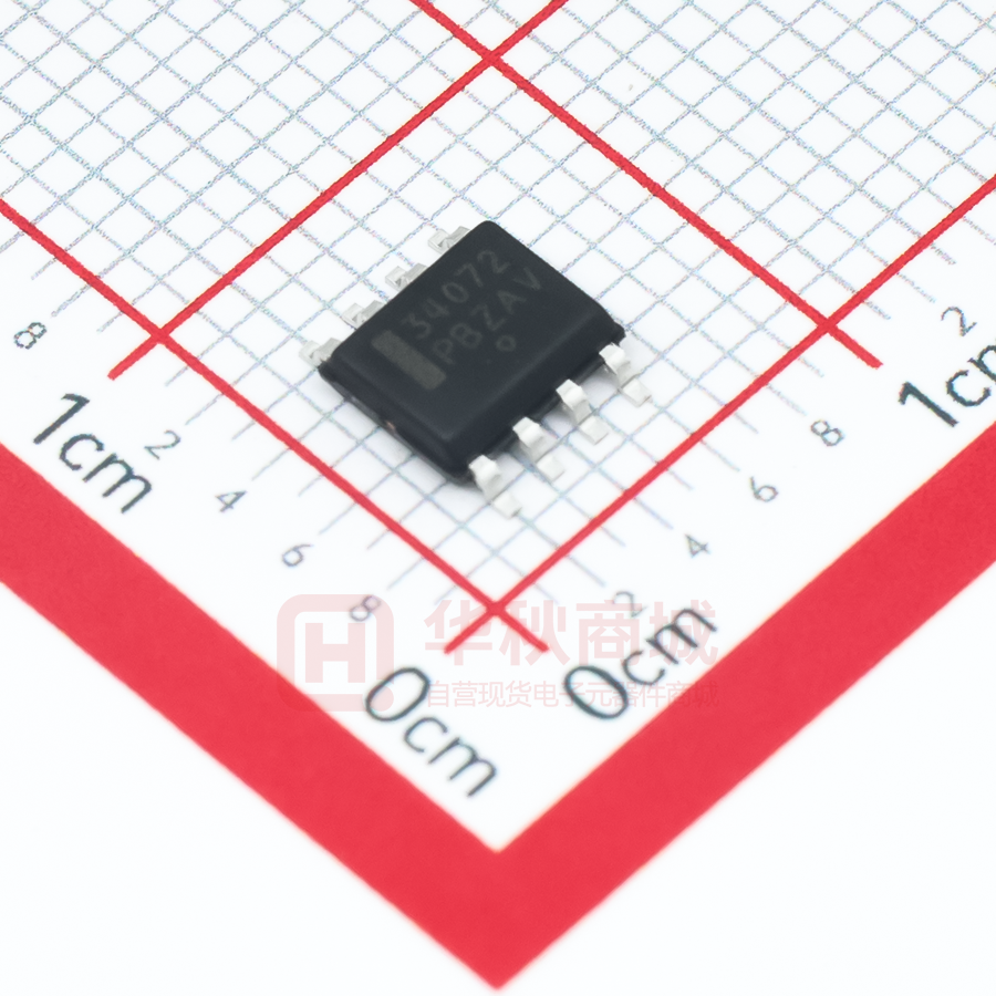

NCV33072DR2G 数据手册
DATA SHEET www.onsemi.com Single Supply 3.0 V to 44 V Operational Amplifiers 8 1 MC34071,2,4,A MC33071,2,4,A, NCV33072,4,A SOIC−8 D SUFFIX CASE 751 WQFN10 MT SUFFIX CASE 510AJ Quality bipolar fabrication with innovative design concepts are employed for the MC33071/72/74, MC34071/72/74, NCV33072/74A series of monolithic operational amplifiers. This series of operational amplifiers offer 4.5 MHz of gain bandwidth product, 13 V/ms slew rate and fast settling time without the use of JFET device technology. Although this series can be operated from split supplies, it is particularly suited for single supply operation, since the common mode input voltage range includes ground potential (VEE). With a Darlington input stage, this series exhibits high input resistance, low input offset voltage and high gain. The all NPN output stage, characterized by no deadband crossover distortion and large output voltage swing, provides high capacitance drive capability, excellent phase and gain margins, low open loop high frequency output impedance and symmetrical source/sink AC frequency response. The MC33071/72/74, MC34071/72/74, NCV33072/74,A series of devices are available in standard or prime performance (A Suffix) grades and are specified over the commercial, industrial/vehicular or military temperature ranges. The complete series of single, dual and quad operational amplifiers are available in plastic SOIC, QFN and TSSOP surface mount packages. SOIC−14 D SUFFIX CASE 751A 14 1 14 1 TSSOP−14 DTB SUFFIX CASE 948G ORDERING INFORMATION See detailed ordering and shipping information on page 18 of this data sheet. DEVICE MARKING INFORMATION See general marking information in the device marking section on page 19 of this data sheet. Features • • • • • • • • • • • • • • • Wide Bandwidth: 4.5 MHz High Slew Rate: 13 V/ms Fast Settling Time: 1.1 ms to 0.1% Wide Single Supply Operation: 3.0 V to 44 V Wide Input Common Mode Voltage Range: Includes Ground (VEE) Low Input Offset Voltage: 3.0 mV Maximum (A Suffix) Large Output Voltage Swing: −14.7 V to +14 V (with ±15 V Supplies) Large Capacitance Drive Capability: 0 pF to 10,000 pF Low Total Harmonic Distortion: 0.02% Excellent Phase Margin: 60° Excellent Gain Margin: 12 dB Output Short Circuit Protection ESD Diodes/Clamps Provide Input Protection for Dual and Quad NCV Prefix for Automotive and Other Applications Requiring Unique Site and Control Change Requirements; AEC−Q100 Qualified and PPAP Capable These Devices are Pb−Free, Halogen Free/BFR Free and are RoHS Compliant © Semiconductor Components Industries, LLC, 2014 October, 2021 − Rev. 24 1 Publication Order Number: MC34071/D MC34071,2,4,A MC33071,2,4,A, NCV33072,4,A PIN CONNECTIONS CASE 751A/CASE 948G CASE 751 CASE 510AJ VCC Offset Null 1 2 Inputs + 3 VEE 4 8 NC 7 VCC Output 1 Inputs 1 6 Output 5 Offset Null (Single, Top View) 2 Inputs 1 VEE 8 1 3 7 + + 4 VCC Output 2 Output 2 1 + 4 + 4 5 Inputs 2 Output 1 2 3 VCC 14 1 6 2 3 Inputs 4 12 8 Output 1 1 9 Output 2 NC 2 8 NC 7 In ­ 2 6 In + 2 VEE In ­ 1 + 10 9 7 10 13 11 + - Output 4 Inputs 3 In + 1 3 4 5 Output 3 VEE/GND 6 5 Inputs 2 ­ (Quad, Top View) (Top View) (Dual, Top View) VCC Q3 Q4 Q1 Q7 Q17 Q2 R1 C1 R2 D2 Bias - Q6 Q5 Q8 Q9 Q11 Q10 Q18 R6 R7 Output R8 Inputs + C2 D3 Q19 Base Current Cancellation Q13 Q14 Q15 Q16 Q12 D1 R5 R3 Current Limit R4 VEE/GND Offset Null (MC33071, MC34071 only) Figure 1. Representative Schematic Diagram (Each Amplifier) www.onsemi.com 2 MC34071,2,4,A MC33071,2,4,A, NCV33072,4,A MAXIMUM RATINGS Rating Symbol Value Unit VS +44 V Input Differential Voltage Range VIDR (Note 1) V Input Voltage Range VIR (Note 1) V Output Short Circuit Duration (Note 2) tSC Indefinite Sec Supply Voltage (from VEE to VCC) Operating Junction Temperature TJ +150 °C Storage Temperature Range Tstg −60 to +150 °C ESDHBM ESDMM 2000 200 ESD Capability, Dual and Quad (Note 3) Human Body Model Machine Model V Stresses exceeding those listed in the Maximum Ratings table may damage the device. If any of these limits are exceeded, device functionality should not be assumed, damage may occur and reliability may be affected. 1. Either or both input voltages should not exceed the magnitude of VCC or VEE. 2. Power dissipation must be considered to ensure maximum junction temperature (TJ) is not exceeded (see Figure 2). 3. This device series incorporates ESD protection and is tested by the following methods: ESD Human Body Model tested per AEC−Q100−002 (JEDEC standard: JESD22−A114) ESD Machine Model tested per AEC−Q100−003 (JEDEC standard: JESD22−A115) www.onsemi.com 3 MC34071,2,4,A MC33071,2,4,A, NCV33072,4,A ELECTRICAL CHARACTERISTICS (VCC = +15 V, VEE = −15 V, RL = connected to ground, unless otherwise noted. See Note 4 for TA = Tlow to Thigh) A Suffix Characteristics Symbol Input Offset Voltage (RS = 100 W, VCM = 0 V, VO = 0 V) VCC = +15 V, VEE = −15 V, TA = +25°C VCC = +5.0 V, VEE = 0 V, TA = +25°C VCC = +15 V, VEE = −15 V, TA = Tlow to Thigh VIO Average Temperature Coefficient of Input Offset Voltage RS = 10 W, VCM = 0 V, VO = 0 V, TA = Tlow to Thigh IIB Input Offset Current (VCM = 0 V, VO = 0V) TA = +25°C TA = Tlow to Thigh IIO Input Common Mode Voltage Range TA = +25°C TA = Tlow to Thigh VICR Large Signal Voltage Gain (VO = ±10 V, RL = 2.0 kW) TA = +25°C TA = Tlow to Thigh AVOL Output Voltage Swing (VID = ±1.0 V) VCC = +5.0 V, VEE = 0 V, RL = 2.0 kW, TA = +25°C VCC = +15 V, VEE = −15 V, RL = 10 kW, TA = +25°C VCC = +15 V, VEE = −15 V, RL = 2.0 kW, TA = Tlow to Thigh VOH VCC = +5.0 V, VEE = 0 V, RL = 2.0 kW, TA = +25°C VCC = +15 V, VEE = −15 V, RL = 10 kW, TA = +25°C VCC = +15 V, VEE = −15 V, RL = 2.0 kW, TA = Tlow to Thigh VOL Output Short Circuit Current (VID = 1.0 V, VO = 0 V, TA = 25°C) Source Sink Typ Max 0.5 0.5 − 3.0 3.0 5.0 − 10 − − − 100 − − − 6.0 − − − − DVIO/DT Input Bias Current (VCM = 0 V, VO = 0 V) TA = +25°C TA = Tlow to Thigh Min Non−Suffix Min Typ Max 1.0 1.5 − 5.0 5.0 7.0 − 10 − 500 700 − − 100 − 500 700 50 300 − − 6.0 − 75 300 Unit mV − − − mV/°C nA nA VEE to (VCC −1.8) VEE to (VCC −2.2) V VEE to (VCC −1.8) VEE to (VCC −2.2) V/mV 50 25 100 − − − 25 20 100 − − − 3.7 13.6 13.4 4.0 14 − − − − 3.7 13.6 13.4 4.0 14 − − − − 0.1 −14.7 − 0.3 −14.3 −13.5 − − − 0.1 −14.7 − 0.3 −14.3 −13.5 V − − − ISC V mA 10 20 30 30 − − 10 20 30 30 − − Common Mode Rejection RS ≤ 10 kW, VCM = VICR, TA = 25°C CMR 80 97 − 70 97 − dB Power Supply Rejection (RS = 100 W) VCC/VEE = +16.5 V/−16.5 V to +13.5 V/−13.5 V, TA = 25°C PSR 80 97 − 70 97 − dB − − − 1.6 1.9 − 2.0 2.5 2.8 − − − 1.6 1.9 − 2.0 2.5 2.8 Power Supply Current (Per Amplifier, No Load) VCC = +5.0 V, VEE = 0 V, VO = +2.5 V, TA = +25°C VCC = +15 V, VEE = −15 V, VO = 0 V, TA = +25°C VCC = +15 V, VEE = −15 V, VO = 0 V, TA = Tlow to Thigh ID mA Product parametric performance is indicated in the Electrical Characteristics for the listed test conditions, unless otherwise noted. Product performance may not be indicated by the Electrical Characteristics if operated under different conditions. 4. Tlow = −40°C for MC33071,2,4,/A, NCV33074/A Thigh = +85°C for MC33071,2,4,/A, NCV33074/A = 0°C for MC34071,2,4,/A = +70°C for MC34071,2,4,/A = −40°C for MC34072,4/V, NCV33072,4A = +125°C for MC34072,4/V, NCV33072,4A, NCV34074V Case 510AJ Tlow/Thigh guaranteed by product characterization. www.onsemi.com 4 MC34071,2,4,A MC33071,2,4,A, NCV33072,4,A AC ELECTRICAL CHARACTERISTICS (VCC = +15 V, VEE = −15 V, RL = connected to ground. TA = +25°C, unless otherwise noted.) A Suffix Characteristics Symbol Non−Suffix Min Typ Max Min Typ Max 8.0 − 10 13 − − 8.0 − 10 13 − − − − 1.1 2.2 − − − − 1.1 2.2 − − GBW 3.5 4.5 − 3.5 4.5 − MHz BW − 160 − − 160 − kHz − − 60 40 − − − − 60 40 − − − − 12 4.0 − − − − 12 4.0 − − SR Slew Rate (Vin = −10 V to +10 V, RL = 2.0 kW, CL = 500 pF) AV = +1.0 AV = −1.0 Setting Time (10 V Step, AV = −1.0) To 0.1% (+1/2 LSB of 9−Bits) To 0.01% (+1/2 LSB of 12−Bits) V/ms ts Gain Bandwidth Product (f = 100 kHz) Power Bandwidth AV = +1.0, RL = 2.0 kW, VO = 20 Vpp, THD = 5.0% Unit ms Phase margin RL = 2.0 kW RL = 2.0 kW, CL = 300 pF fm Gain Margin RL = 2.0 kW RL = 2.0 kW, CL = 300 pF Am Equivalent Input Noise Voltage RS = 100 W, f = 1.0 kHz en − 32 − − 32 − nV/ √ Hz Equivalent Input Noise Current f = 1.0 kHz in − 0.22 − − 0.22 − pA/ √ Hz Differential Input Resistance VCM = 0 V Rin − 150 − − 150 − MW Differential Input Capacitance VCM = 0 V Cin − 2.5 − − 2.5 − pF THD − 0.02 − − 0.02 − % − − 120 − − 120 − dB |ZO| − 30 − − 30 − W Total Harmonic Distortion AV = +10, RL = 2.0 kW, 2.0 Vpp ≤ VO ≤ 20 Vpp, f = 10 kHz Channel Separation (f = 10 kHz) Open Loop Output Impedance (f = 1.0 MHz) Single Supply Deg dB Split Supplies VCC+|VEE|≤44 V 3.0 V to 44 V VCC VCC VCC 2 1 VCC 1 3 2 2 3 3 VEE 4 6 + 1 5 4 10 k 4 VEE 7 - VEE Offset nulling range is approximately ± 80 mV with a 10 k potentiometer (MC33071, MC34071 only). VEE Figure 2. Power Supply Configurations Figure 3. Offset Null Circuit www.onsemi.com 5 V IO INPUT OFFSET VOLTAGE (mV) V, 2400 2000 1600 8 & 14 Pin Plastic Pkg SOIC-14 Pkg 1200 800 400 2.0 0 -4.0 0 -55 -40 -20 0 20 40 60 80 100 120 140 160 -55 25 50 75 100 Figure 4. Maximum Power Dissipation versus Temperature for Package Types Figure 5. Input Offset Voltage versus Temperature for Representative Units VCC VCC/VEE = +1.5 V/ -1.5 V to +22 V/ -22 V VCC -1.6 VCC -2.4 VEE +0.01 VEE -55 -25 0 25 50 75 100 125 125 1.3 VCC = +15 V VEE = -15 V VCM = 0 1.2 1.1 1.0 0.9 0.8 0.7 -55 -25 0 25 50 75 100 TA, AMBIENT TEMPERATURE (°C) TA, AMBIENT TEMPERATURE (°C) Figure 6. Input Common Mode Voltage Range versus Temperature Figure 7. Normalized Input Bias Current versus Temperature 125 50 1.4 VO, OUTPUT VOLTAGE SWING (Vpp ) VCC = +15 V VEE = -15 V TA = 25°C 1.2 1.0 0.8 0.6 0 TA, AMBIENT TEMPERATURE (°C) VCC -0.8 VEE -25 TA, AMBIENT TEMPERATURE (°C) VCC I, IB INPUT BIAS CURRENT (NORMALIZED) VCC = +15 V VEE = -15 V VCM = 0 4.0 -2.0 SOIC-8 Pkg V, ICR INPUT COMMON MODE VOLTAGE RANGE (V) I, IB INPUT BIAS CURRENT (NORMALIZED) P, D MAXIMUM POWER DISSIPATION (mW) MC34071,2,4,A MC33071,2,4,A, NCV33072,4,A RL Connected to Ground TA = 25°C 40 30 RL = 10 k RL = 2.0 k 20 10 0 -12 -8.0 -4.0 0 4.0 8.0 12 0 5.0 10 15 20 VIC, INPUT COMMON MODE VOLTAGE (V) VCC, |VEE|, SUPPLY VOLTAGE (V) Figure 8. Normalized Input Bias Current versus Input Common Mode Voltage Figure 9. Split Supply Output Voltage Swing versus Supply Voltage www.onsemi.com 6 25 VCC/VEE = +4.5 V/ -4.5 V to +22 V/ -22 V Source VCC -1.0 25 125 25 VEE +1.0 85 125 0 5.0 10 15 0.2 0.1 GND 0 100 20 1.0 k 10 k RL, LOAD RESISTANCE TO GROUND (W) Figure 10. Split Supply Output Saturation versus Load Current Figure 11. Single Supply Output Saturation versus Load Resistance to Ground 60 VCC -0.4 -0.8 2.0 VCC = +15 V RL to VCC TA = 25°C 1.0 GND 50 Sink 40 Source 30 20 VCC = +15 V VEE = -15 V RL ≤ 0.1 W DVin = 1.0 V 10 0 100 1.0 k 10 k -55 100 k 25 50 75 100 Figure 12. Single Supply Output Saturation versus Load Resistance to VCC Figure 13. Output Short Circuit Current versus Temperature 20 AV = 1000 AV = 100 AV = 10 AV = 1.0 10 10 k 125 28 VCC = +15 V VEE = -15 V VCM = 0 VO = 0 DIO = ±0.5 mA TA = 25°C 0 1.0 k 0 TA, AMBIENT TEMPERATURE (°C) VO, OUTPUT VOLTAGE SWING (Vpp ) 30 -25 RL, LOAD RESISTANCE TO VCC (W) 50 40 100 k IL, LOAD CURRENT (± mA) 0 Z, Ω O OUTPUT IMPEDANCE () VCC = +15 V RL = GND TA = 25°C VCC-4.0 VEE +2.0 Sink VEE VCC VCC-2.0 −40 VCC -2.0 VCC I, SC OUTPUT CURRENT (mA) Vsat , OUTPUT SATURATION VOLTAGE (V) Vsat , OUTPUT SATURATION VOLTAGE (V) VCC Vsat , OUTPUT SATURATION VOLTAGE (V) MC34071,2,4,A MC33071,2,4,A, NCV33072,4,A 100 f, FREQUENCY (Hz) 1.0 M 20 16 12 8.0 4.0 0 3.0 k 10 M VCC = +15 V VEE = -15 V AV = +1.0 RL = 2.0 k THD ≤ 1.0% TA = 25°C 24 Figure 14. Output Impedance versus Frequency 10 k 30 k 100 k 300 k f, FREQUENCY (Hz) 1.0 M Figure 15. Output Voltage Swing versus Frequency www.onsemi.com 7 3.0 M MC34071,2,4,A MC33071,2,4,A, NCV33072,4,A THD, TOTAL HARMONIC DISTORTION (%) AV = 1000 0.3 VCC = +15 V VEE = -15 V VO = 2.0 Vpp RL = 2.0 k TA = 25°C 0.2 AV = 100 0.1 AV = 10 AV = 1.0 0 100 1.0 k 10 k 108 2.0 AV = 100 1.0 AV = 10 AV = 1.0 0 4.0 20 Figure 17. Total Harmonic Distortion versus Output Voltage Swing 100 VCC = +15 V VEE = -15 V VO= -10 V to +10 V RL = 10 k f ≤ 10Hz 0 80 Gain 60 Phase Margin = 60° 40 0 25 50 75 100 20 1.0 125 10 GBW, GAIN BANDWIDTH PRODUCT (NORMALIED) 100 Gain Margin = 12 dB 120 140 -10 1. Phase RL = 2.0 k 2. Phase RL = 2.0 k, CL = 300 pF -20 3. Gain RL = 2.0 k 4. Gain RL = 2.0 k, CL = 300 pF -30 VCC = +15 V VEE = 15 V VO = 0 VTA = 25°C -40 1.0 2.0 3.0 5.0 7.0 3 160 180 4 2 10 180 100 1.0 k 10 k 100 k 1.0 M 10 M 100 M Figure 19. Open Loop Voltage Gain and Phase versus Frequency Phase Margin = 60° 0 135 f, FREQUENCY (Hz) 20 φ, EXCESS PHASE (DEGREES) 1 90 VCC = +15 V VEE = -15 V VO = 0 V RL = 2.0 k TA = 25°C 0 -25 45 Phase Figure 18. Open Loop Voltage Gain versus Temperature A, VOL OPEN LOOP VOLTAGE GAIN (dB) 16 Figure 16. Total Harmonic Distortion versus Frequency TA, AMBIENT TEMPERATURE (°C) 10 12 VO, OUTPUT VOLTAGE SWING (Vpp) 100 20 8.0 f, FREQUENCY (Hz) 104 96 -55 VCC = +15 V VEE = -15 V RL = 2.0 k TA = 25°C AV = 1000 0 116 112 3.0 100 k A, VOL OPEN LOOP VOLTAGE GAIN (dB) A, VOL OPEN LOOP VOLTAGE GAIN (dB) 10 4.0 φ, EXCESS PHASE (DEGREES) THD, TOTAL HARMONIC DISTORTION (%) 0.4 30 1.15 VCC = +15 V VEE = -15 V RL = 2.0 k 1.1 1.05 1.0 0.95 0.9 0.85 -55 -25 0 25 50 75 100 f, FREQUENCY (MHz) TA, AMBIENT TEMPERATURE (°C) Figure 20. Open Loop Voltage Gain and Phase versus Frequency Figure 21. Normalized Gain Bandwidth Product versus Temperature www.onsemi.com 8 125 MC34071,2,4,A MC33071,2,4,A, NCV33072,4,A 70 VCC = +15 V VEE = -15 V RL = 2.0 k VO = -10 V to +10 V TA = 25°C 80 60 φ m , PHASE MARGIN (DEGREES) 40 20 0 10 100 1.0 k VCC = +15 V VEE = -15 V AV = +1.0 RL = 2.0 k to R VO = -10 V to +10 V TA = 25°C 60 50 40 30 20 10 0 10 k 10 100 Figure 22. Percent Overshoot versus Load Capacitance Figure 23. Phase Margin versus Load Capacitance 14 80 10 8.0 φ m , PHASE MARGIN (DEGREES) VCC = +15 V VEE = -15 V AV = +1.0 RL = 2.0 k to ∞ VO = -10 V to +10 V TA = 25°C 12 A, m GAIN MARGIN (dB) 10 k CL, LOAD CAPACITANCE (pF) CL, LOAD CAPACITANCE (pF) 6.0 4.0 2.0 0 10 100 1.0 k CL = 10 pF CL = 100 pF 60 40 CL = 1,000 pF 20 VCC = +15 V VEE = -15 V AV = +1.0 RL = 2.0 k to ∞ VO = -10 V to +10 V CL = 10,000 pF 0 10 k -55 -25 0 25 50 75 100 125 CL, LOAD CAPACITANCE (pF) TA, AMBIENT TEMPERATURE (°C) Figure 24. Gain Margin versus Load Capacitance Figure 25. Phase Margin versus Temperature 16 8.0 4.0 10 CL = 10 pF VEE = -15 V AV = +1.0 RL = 2.0 k to ∞ VO = -10 V to +10 V A, m GAIN MARGIN (dB) 12 70 12 VCC = +15 V A, m GAIN MARGIN (dB) 1.0 k CL = 100 pF CL = 10,000 pF CL = 1,000 pF 8.0 R1 6.0 -25 0 25 50 75 100 125 50 - VO 40 + R2 4.0 30 VCC = +15 V VEE = -15 V RT = R1 + R2 AV = +100 VO = 0 V TA = 25°C 2.0 0 0 -55 60 Gain 1.0 10 20 Phase 10 100 1.0 k 10 k TA, AMBIENT TEMPERATURE (°C) RT, DIFFERENTIAL SOURCE RESISTANCE (W) Figure 26. Gain Margin versus Temperature Figure 27. Phase Margin and Gain Margin versus Differential Source Resistance www.onsemi.com 9 0 100 k φ m , PHASE MARGIN (DEGREES) PERCENT OVERSHOOT 100 MC34071,2,4,A MC33071,2,4,A, NCV33072,4,A Δ V, O OUTPUT VOLTAGE SWING FROM 0 V (V) 1.1 1.05 1.0 0.95 10 0.9 0 -25 0 25 50 75 100 125 1.0 mV 5.0 Compensated Uncompensated 0 1.0 mV 10 mV 1.0 mV -10 0 0.5 1.0 1.5 3.0 Figure 28. Normalized Slew Rate versus Temperature Figure 29. Output Settling Time VCC = +15 V VEE = -15 V AV = +1.0 RL = 2.0 k CL = 300 pF TA = 25°C 100 VCC = +15 V VEE = -15 V AV = +1.0 RL = 2.0 k CL = 300 pF TA = 25°C 0 Figure 31. Large Signal Transient Response 100 TA = 125°C VCC = +15 V VEE = -15 V VCM = 0 V DVCM = ±1.5 V TA = 25°C TA = -55°C 60 40 DVCM ADM 20 DVCM CMR = 20 Log 1.0 DVO + DVO 10 100 x ADM 1.0 k 3.5 1.0 ms/DIV PSR, POWER SUPPLY REJECTION (dB) CMR, COMMON MODE REJECTION (dB) 2.5 ts, SETTLING TIME (ms) Figure 30. Small Signal Transient Response 0 0.1 2.0 TA, AMBIENT TEMPERATURE (°C) 2.0 ms/DIV 80 VCC = +15 V VEE = -15 V AV = -1.0 TA = 25°C 1.0 mV 10 mV -5.0 0.85 -55 50 mV/DIV VCC = +15 V VEE = -15 V AV = +1.0 RL = 2.0 k CL = 500 pF 5.0 V/DIV SR, SLEW RATE (NORMALIZED) 1.15 10 k 100 k 1.0 M 10 M VCC = +15 V VEE = -15 V TA = 25°C 80 DVCC ADM 60 DVEE 40 (DVCC = +1.5 V) DVO + +PSR = 20 Log 20 +PSR DVO/ADM DVCC DVO/ADM -PSR = 20 Log -PSR (DVEE = +1.5 V) DVEE 0 0.1 1.0 10 100 1.0 k 10 k 100 k 1.0 M 10 M f, FREQUENCY (Hz) f, FREQUENCY (Hz) Figure 32. Common Mode Rejection versus Frequency Figure 33. Power Supply Rejection versus Frequency www.onsemi.com 10 MC34071,2,4,A MC33071,2,4,A, NCV33072,4,A 105 PSR, POWER SUPPLY REJECTION (dB) TA = -55°C 8.0 7.0 TA = 25°C 6.0 TA = 125°C 5.0 Quad device 4.0 0 5.0 10 15 20 85 +PSR = 20 Log 75 DVCC DVO/ADM ADM DVCC DVO + -PSR = 20 Log DVO/ADM DVEE DVEE -55 -25 0 25 50 75 100 VCC, |VEE|, SUPPLY VOLTAGE (V) TA, AMBIENT TEMPERATURE (°C) Figure 34. Supply Current versus Supply Voltage Figure 35. Power Supply Rejection versus Temperature e, n INPUT NOICE VOLTAGE ( nV √ Hz) CHANNEL SEPARATION (dB) +PSR (DVCC = +1.5 V) 65 VCC = +15 V VEE = -15 V TA = 25°C 80 VCC = +15 V VEE = -15 V 95 25 120 100 -PSR (DVEE = +1.5 V) 60 40 20 0 2.8 70 VCC = +15 V VEE = -15 V VCM = 0 TA = 25°C 60 50 40 20 30 50 70 100 200 300 2.4 2.0 1.6 Voltage 30 1.2 Current 20 0.8 10 0.4 0 10 125 10 100 1.0 k 10 k 0 100 k i, n INPUT NOISE CURRENT (pA √ Hz ) I CC , SUPPLY CURRENT (mA) 9.0 f, FREQUENCY (kHz) f, FREQUENCY (kHz) Figure 36. Channel Separation versus Frequency Figure 37. Input Noise versus Frequency APPLICATIONS INFORMATION CIRCUIT DESCRIPTION/PERFORMANCE FEATURES Although the bandwidth, slew rate, and settling time of the MC34071 amplifier series are similar to op amp products utilizing JFET input devices, these amplifiers offer other additional distinct advantages as a result of the PNP transistor differential input stage and an all NPN transistor output stage. Since the input common mode voltage range of this input stage includes the VEE potential, single supply operation is feasible to as low as 3.0 V with the common mode input voltage at ground potential. The input stage also allows differential input voltages up to ±44 V, provided the maximum input voltage range is not exceeded. Specifically, the input voltages must range between VEE and VCC supply voltages as shown by the maximum rating table. In practice, although not recommended, the input voltages can exceed the VCC voltage by approximately 3.0 V and decrease below the VEE voltage by 0.3 V without causing product damage, although output phase reversal may occur. It is also possible to source up to approximately 5.0 mA of current from VEE through either inputs clamping diode without damage or latching, although phase reversal may again occur. If one or both inputs exceed the upper common mode voltage limit, the amplifier output is readily predictable and may be in a low or high state depending on the existing input bias conditions. Since the input capacitance associated with the small geometry input device is substantially lower (2.5 pF) than the typical JFET input gate capacitance (5.0 pF), better frequency response for a given input source resistance can be achieved using the MC34071 series of amplifiers. This performance feature becomes evident, for example, in fast settling D−to−A current to voltage conversion applications where the feedback resistance can form an input pole with the input capacitance of the op amp. This input pole creates a 2nd order system with the single pole op amp and is therefore detrimental to its settling time. In this context, lower input capacitance is desirable especially for higher www.onsemi.com 11 MC34071,2,4,A MC33071,2,4,A, NCV33072,4,A Because the PNP output emitter−follower transistor has been eliminated, the MC34071 series offers a 20 mA minimum current sink capability, typically to an output voltage of (VEE +1.8 V). In single supply applications the output can directly source or sink base current from a common emitter NPN transistor for fast high current switching applications. In addition, the all NPN transistor output stage is inherently fast, contributing to the bipolar amplifier’s high gain bandwidth product and fast settling capability. The associated high frequency low output impedance (30 W typ @ 1.0 MHz) allows capacitive drive capability from 0 pF to 10,000 pF without oscillation in the unity closed loop gain configuration. The 60° phase margin and 12 dB gain margin as well as the general gain and phase characteristics are virtually independent of the source/sink output swing conditions. This allows easier system phase compensation, since output swing will not be a phase consideration. The high frequency characteristics of the MC34071 series also allow excellent high frequency active filter capability, especially for low voltage single supply applications. Although the single supply specifications is defined at 5.0 V, these amplifiers are functional to 3.0 V @ 25°C although slight changes in parametrics such as bandwidth, slew rate, and DC gain may occur. If power to this integrated circuit is applied in reverse polarity or if the IC is installed backwards in a socket, large unlimited current surges will occur through the device that may result in device destruction. Special static precautions are not necessary for these bipolar amplifiers since there are no MOS transistors on the die. As with most high frequency amplifiers, proper lead dress, component placement, and PC board layout should be exercised for optimum frequency performance. For example, long unshielded input or output leads may result in unwanted input−output coupling. In order to preserve the relatively low input capacitance associated with these amplifiers, resistors connected to the inputs should be immediately adjacent to the input pin to minimize additional stray input capacitance. This not only minimizes the input pole for optimum frequency response, but also minimizes extraneous “pick up” at this node. Supply decoupling with adequate capacitance immediately adjacent to the supply pin is also important, particularly over temperature, since many types of decoupling capacitors exhibit great impedance changes over temperature. The output of any one amplifier is current limited and thus protected from a direct short to ground. However, under such conditions, it is important not to allow the device to exceed the maximum junction temperature rating. Typically for ±15 V supplies, any one output can be shorted continuously to ground without exceeding the maximum temperature rating. values of feedback resistances (lower current DACs). This input pole can be compensated for by creating a feedback zero with a capacitance across the feedback resistance, if necessary, to reduce overshoot. For 2.0 kW of feedback resistance, the MC34071 series can settle to within 1/2 LSB of 8−bits in 1.0 ms, and within 1/2 LSB of 12−bits in 2.2 ms for a 10 V step. In a inverting unity gain fast settling configuration, the symmetrical slew rate is ±13 V/ms. In the classic noninverting unity gain configuration, the output positive slew rate is +10 V/ms, and the corresponding negative slew rate will exceed the positive slew rate as a function of the fall time of the input waveform. Since the bipolar input device matching characteristics are superior to that of JFETs, a low untrimmed maximum offset voltage of 3.0 mV prime and 5.0 mV downgrade can be economically offered with high frequency performance characteristics. This combination is ideal for low cost precision, high speed quad op amp applications. The all NPN output stage, shown in its basic form on the equivalent circuit schematic, offers unique advantages over the more conventional NPN/PNP transistor Class AB output stage. A 10 kW load resistance can swing within 1.0 V of the positive rail (VCC), and within 0.3 V of the negative rail (VEE), providing a 28.7 Vpp swing from ±15 V supplies. This large output swing becomes most noticeable at lower supply voltages. The positive swing is limited by the saturation voltage of the current source transistor Q7, and VBE of the NPN pull up transistor Q17, and the voltage drop associated with the short circuit resistance, R7. The negative swing is limited by the saturation voltage of the pull−down transistor Q16, the voltage drop ILR6, and the voltage drop associated with resistance R7, where IL is the sink load current. For small valued sink currents, the above voltage drops are negligible, allowing the negative swing voltage to approach within millivolts of VEE. For large valued sink currents (>5.0 mA), diode D3 clamps the voltage across R6, thus limiting the negative swing to the saturation voltage of Q16, plus the forward diode drop of D3 (≈VEE +1.0 V). Thus for a given supply voltage, unprecedented peak−to−peak output voltage swing is possible as indicated by the output swing specifications. If the load resistance is referenced to VCC instead of ground for single supply applications, the maximum possible output swing can be achieved for a given supply voltage. For light load currents, the load resistance will pull the output to VCC during the positive swing and the output will pull the load resistance near ground during the negative swing. The load resistance value should be much less than that of the feedback resistance to maximize pull up capability. www.onsemi.com 12 MC34071,2,4,A MC33071,2,4,A, NCV33072,4,A (Typical Single Supply Applications VCC = 5.0 V) VCC 5.1 M VO 0 3.7 Vpp 0 VCC 20 k 100 k 1.0 M Cin CO + VO 68 k MC34071 36.6 mVpp Cin 100 k Vin 10 k RL - VO CO 10 k RL 100 k AV = 10 BW (-3.0 dB) = 450 kHz BW (-3.0 dB) = 45 kHz Figure 38. AC Coupled Noninverting Amplifier Figure 39. AC Coupled Inverting Amplifier VCC 4.75 Vpp 2.63 V + MC34071 10 k Vin 370 mVpp AV = 101 1.0 k VO 3.7 Vpp 91 k 5.1 k RL 5.1 k 2.5 V + VO MC34071 100 k 0 - 0 to 10,000 pF + Vin 1.0 M MC54/74XX MC34071 Vin Figure 40. DC Coupled Inverting Amplifier Maximum Output Swing C 0.047 R1 16 k C 0.01 32 k R VO VCC 0.4 VCC Then: R3 = fo = 1.0 kHz fo = 2.0 C 0.02 + fo = 30 kHz Ho = 10 Ho = 1.0 Given fo = Center Frequency AO = Gain at Center Frequency Choose Value fo, Q, Ao, C 16 k 2.0 R MC34071 C 0.047 MC34071 + R3 2.2 k - 1.1 k R2 5.6 k VO R Vin TTL Gate Figure 41. Unity Gain Buffer TTL Driver Vin Vin ≥ 0.2 Vdc Cable AV = 10 BW (-3.0 dB) = 450 kHz 1 4pRC Q R3  R1 =  2Ho pfoC R2 = R1 R3 4Q2R1-R3 For less than 10% error from operational amplifier Qofo GBW < 0.1 where fo and GBW are expressed in Hz. GBW = 4.5 MHz Typ. 2.0 C 0.02 Figure 43. Active Bandpass Filter Figure 42. Active High−Q Notch Filter www.onsemi.com 13 MC34071,2,4,A MC33071,2,4,A, NCV33072,4,A Vin CF 2.0 V RF 5.0 k 5.0 k 5.0 k Vin - VO 10 k + 10 k t 2.0 k RL MC34071 10 k VO + MC34071 VCC 1.0 V VO 0.2 ms Delay 4.0 V Bit Switches 13 V/ms (R-2R) Ladder Network 25 V/ms 0.1 t Delay 1.0 ms Settling Time 1.0 ms (8-Bits, 1/2 LSB) Figure 44. Low Voltage Fast D/A Converter Figure 45. High Speed Low Voltage Comparator VCC “ON" Vin < Vref VCC VCC + Vin RL MC34071 Vref + + MC34071 MC34071 - - “ON" Vin > Vref RL (A) PNP Figure 46. LED Driver (B) NPN Figure 47. Transistor Driver ILoad RF + MC34071 VO Ground Current Sense Resistor RS - ICell MC34071 R1 R2 VO + VO = ILoad RS 1+ R1 R2 For VO > 0.1V BW ( -3.0 dB) = GBW VCell = 0 V R2 R1+R2 VO = ICell RF VO > 0.1 V Figure 48. AC/DC Ground Current Monitor Figure 49. Photovoltaic Cell Amplifier www.onsemi.com 14 MC34071,2,4,A MC33071,2,4,A, NCV33072,4,A VO Hysteresis R2 Vref VOH R1 Iout + MC34071 VOL - Vin Vin Vin VinL VinL = R1 (VOL-Vref)+Vref R1+R2 VinH = R1 (VOH-Vref)+Vref R1+R2 VH = R1 (VOH -VOL) R1+R MC34071 - Vref Iout = Figure 50. Low Input Voltage Comparator with Hysteresis R1 + VinH R Figure 51. High Compliance Voltage to Sink Current Converter R2 +Vref R4 RF - 1/2 R3 - 1/2 MC34072 MC34072 +V1 R Vin±VIO + R VO R - + R R = DR R2 R4 = (Critical to CMRR) R1 R3 R4 R4 V2-V1 VO = 1 + R3 R3 For (V2 ≥ V1), V > 0 Figure 52. High Input Impedance Differential Amplifier + VO = Vref RF DR < < R RF > > R DR RF 2R2 (VO ≥ 0.1 V) Figure 53. Bridge Current Amplifier fOSC ^ 0.85 RC + IB V VP 0 t - Vin + VO MC34071 +V2 VO = Vin (pk) + ISC t Base Charge Removal MC34071 Iout RL VP 10,000 pF C + 1/2 MC34072 + - V+ ±IB 100 k 100 k Vin R MC34072 - 1/2 + 47 k VP Pulse Width Control Group VP OSC t Figure 54. Low Voltage Peak Detector Comparator High Current Output Figure 55. High Frequency Pulse Width Modulation www.onsemi.com 15 MC34071,2,4,A MC33071,2,4,A, NCV33072,4,A GENERAL ADDITIONAL APPLICATIONS INFORMATION VS = ±15.0 V C2 0.02 R1 560 C2 0.05 - R2 5.6 k R3 510 MC34071 C1 1.0 - R2 1.1 k MC34071 C1 0.44 R1 46.1 k C1 1.0 fo = 1.0 kHz Ho = 10 + fo = 100 Hz Ho = 20 + Then: R1 = Choose: fo, Ho, C1 Choose: fo, Ho, C2 Then: C1 = 2C2 (Ho+1) R2 = Ǹ2 R2 R1 = Ho R2 R3 = Ho+1 4pfoC2 R2 = C2 = Figure 56. Second Order Low−Pass Active Filter Ho+0.5 pfoC1 Ǹ2 Ǹ2 2pfoC1 (1/Ho+2) C Ho Figure 57. Second Order High−Pass Active Filter CF * VO = 10 V Step RF 2.0 k + MC34071 MC34071 R1 VO + I High Speed DAC Vin ts = 1.0 ms Uncompensated RL R2 to 1/2 LSB (8-Bits) ts = 2.2 ms Compensated VO to 1/2 LSB (12-Bits) Vin = R2 BW (-3.0 dB) = GBW R1 SR = 13 V/ms *Optional Compensation VO - R1 R1 +R2 SR = 13 V/ms Figure 58. Fast Settling Inverter Figure 59. Basic Inverting Amplifier + MC34071 VO Vin Vin R2 + MC34071 RL VO R1 VO Vin = 1+ R2 R1 BW (-3.0 dB) = GBW BWp = 200 kHz VO = 20 Vpp SR = 10 V/ms R1 R1 +R2 Figure 60. Basic Noninverting Amplifier Figure 61. Unity Gain Buffer (AV = +1.0) www.onsemi.com 16 MC34071,2,4,A MC33071,2,4,A, NCV33072,4,A + R R MC34074 R VO MC34074 RE + R - R Example: Let: R = RE = 12 k Then: AV = 3.0 BW = 1.5 MHz MC34074 + R AV = 1 +2 R RE Figure 62. High Impedance Differential Amplifier +VO + + MC34074 100 k - 10 + RL 10 +10 MC34074 + 220 pF 100 k -10 + + RL +VO -VO ∞ 18.93 -18.78 10 k 5.0 k 18 15.4 -18 -15.4 + MC34074 100 k - 10 RL 10 -VO Figure 63. Dual Voltage Doubler www.onsemi.com 17 MC34071,2,4,A MC33071,2,4,A, NCV33072,4,A ORDERING INFORMATION Op Amp Function Single Device MC34071DR2G Operating Temperature Range TA = 0° to +70°C MC33071DR2G MC33071ADR2G TA = −40° to +85°C MC34072DR2G MC34072ADR2G Dual SOIC−8 (Pb−Free) 2500 / Tape & Reel SOIC−8 (Pb−Free) WQFN10 (Pb−Free) MC33072DR2G SOIC−8 (Pb−Free) TA = −40° to +85°C MC34072VDR2G NCV33072DR2G* TA = −40° to +125°C MC34074ADR2G MC34074DR2G TA = 0° to +70°C SOIC−8 (Pb−Free) SOIC−8 (Pb−Free) SOIC−8 (Pb−Free) SOIC−14 (Pb−Free) SOIC−14 (Pb−Free) MC33074DR2G SOIC−14 (Pb−Free) NCV33074DR2G* SOIC−14 (Pb−Free) MC33074ADR2G SOIC−14 (Pb−Free) NCV33074ADR2G* TA = −40° to +85°C SOIC−14 (Pb−Free) MC33074DTBR2G TSSOP−14 (Pb−Free) MC33074ADTBR2G TSSOP−14 (Pb−Free) NCV33074ADTBR2G* TSSOP−14 (Pb−Free) MC34074VDR2G SOIC−14 (Pb−Free) NCV34074VDR2G* TA = −40° to +125°C 2500 / Tape & Reel 2500 / Tape & Reel SOIC−8 (Pb−Free) TA = 0° to +70°C Shipping† SOIC−8 (Pb−Free) MC34072AMTTBG MC33072ADR2G Quad Package SOIC−8 (Pb−Free) SOIC−14 (Pb−Free) 2500 Units / Tape & Reel 3000 Units / Tape & Reel 2500 / Tape & Reel 2500 / Tape & Reel 2500 / Tape & Reel 2500 Units / Tape & Reel 2500 / Tape & Reel 2500 / Tape & Reel 2500 / Tape & Reel 2500 / Tape & Reel 2500 / Tape & Reel †For information on tape and reel specifications, including part orientation and tape sizes, please refer to our Tape and Reel Packaging Specifications Brochure, BRD8011/D. *NCV prefix for automotive and other applications requiring unique site and control change requirements; AEC−Q100 qualified and PPAP capable. www.onsemi.com 18 MC34071,2,4,A MC33071,2,4,A, NCV33072,4,A MARKING DIAGRAMS SOIC−8 D SUFFIX CASE 751 8 8 3x071 ALYW  8 3x072 ALYW  1 1 8 8 3x071 ALYWA  1 1 34072 ALYWV  3x072 ALYWA  1 *applies to NCV33072DR2G SOIC−14 D SUFFIX CASE 751A 14 14 MC3x074DG AWLYWW 1 TSSOP−14 DTB SUFFIX CASE 948G MC3x074ADG AWLYWW 1 14 14 MC33 074 ALYW  MC34074VDG AWLYWW 1 *applies to NCV34074VDR2G 14 1 WQFN10 MT SUFFIX CASE 510AJ 4072 AAYW  x = 3 or 4 A = Assembly Location WL, L = Wafer Lot YY, Y = Year WW, W = Work Week G or  = Pb−Free Package (Note: Microdot may be in either location) www.onsemi.com 19 14 MC33 074A ALYW  1 NCV3 074A ALYW  1 MECHANICAL CASE OUTLINE PACKAGE DIMENSIONS WQFN10 2.6x2.6, 0.5P CASE 510AJ−01 ISSUE A SCALE 2:1 ÍÍÍ ÍÍÍ ÍÍÍ D L A B DETAIL A E ALTERNATE TERMINAL CONSTRUCTIONS 0.15 C 0.15 C A3 DETAIL B 0.08 C 9X MOLD CMPD DETAIL B A1 C SIDE VIEW DIM A A1 A3 b D E e L L1 L2 ALTERNATE CONSTRUCTIONS A NOTE 4 NOTES: 1. DIMENSIONING AND TOLERANCING PER ASME Y14.5M, 1994. 2. CONTROLLING DIMENSION: MILLIMETERS. 3. DIMENSION b APPLIES TO PLATED TERMINAL AND IS MEASURED BETWEEN 0.15 AND 0.30mm FROM TERMINAL. 4. COPLANARITY APPLIES TO THE EXPOSED PAD AS WELL AS THE TERMINALS. ÉÉ ÉÉ EXPOSED Cu TOP VIEW 0.10 C L L1 PIN ONE REFERENCE DATE 27 MAR 2009 GENERIC MARKING DIAGRAM* SEATING PLANE DETAIL A 5 L 4 XXXX AAYW G 6 1 9 XXXX AA Y W G e 10 L2 MILLIMETERS MIN MAX 0.70 0.80 0.00 0.05 0.20 REF 0.20 0.30 2.60 BSC 2.60 BSC 0.50 BSC 0.45 0.55 0.00 0.15 0.55 0.65 10X b 0.10 C A 0.05 C BOTTOM VIEW = Specific Device Code = Assembly Location = Year = Work Week = Pb−Free Package *This information is generic. Please refer to device data sheet for actual part marking. Pb−Free indicator, “G” or microdot “ G”, may or may not be present. B NOTE 3 SOLDERING FOOTPRINT* 2.90 1 10X 10X 0.50 PITCH 2.90 0.30 0.73 DIMENSIONS: MILLIMETERS *For additional information on our Pb−Free strategy and soldering details, please download the ON Semiconductor Soldering and Mounting Techniques Reference Manual, SOLDERRM/D. DOCUMENT NUMBER: DESCRIPTION: 98AON38696E WQFN10 2.6X2.6, 0.5P Electronic versions are uncontrolled except when accessed directly from the Document Repository. Printed versions are uncontrolled except when stamped “CONTROLLED COPY” in red. PAGE 1 OF 1 ON Semiconductor and are trademarks of Semiconductor Components Industries, LLC dba ON Semiconductor or its subsidiaries in the United States and/or other countries. ON Semiconductor reserves the right to make changes without further notice to any products herein. ON Semiconductor makes no warranty, representation or guarantee regarding the suitability of its products for any particular purpose, nor does ON Semiconductor assume any liability arising out of the application or use of any product or circuit, and specifically disclaims any and all liability, including without limitation special, consequential or incidental damages. ON Semiconductor does not convey any license under its patent rights nor the rights of others. © Semiconductor Components Industries, LLC, 2019 www.onsemi.com MECHANICAL CASE OUTLINE PACKAGE DIMENSIONS SOIC−8 NB CASE 751−07 ISSUE AK 8 1 SCALE 1:1 −X− DATE 16 FEB 2011 NOTES: 1. DIMENSIONING AND TOLERANCING PER ANSI Y14.5M, 1982. 2. CONTROLLING DIMENSION: MILLIMETER. 3. DIMENSION A AND B DO NOT INCLUDE MOLD PROTRUSION. 4. MAXIMUM MOLD PROTRUSION 0.15 (0.006) PER SIDE. 5. DIMENSION D DOES NOT INCLUDE DAMBAR PROTRUSION. ALLOWABLE DAMBAR PROTRUSION SHALL BE 0.127 (0.005) TOTAL IN EXCESS OF THE D DIMENSION AT MAXIMUM MATERIAL CONDITION. 6. 751−01 THRU 751−06 ARE OBSOLETE. NEW STANDARD IS 751−07. A 8 5 S B 0.25 (0.010) M Y M 1 4 −Y− K G C N X 45 _ SEATING PLANE −Z− 0.10 (0.004) H M D 0.25 (0.010) M Z Y S X J S 8 8 1 1 IC 4.0 0.155 XXXXX A L Y W G IC (Pb−Free) = Specific Device Code = Assembly Location = Wafer Lot = Year = Work Week = Pb−Free Package XXXXXX AYWW 1 1 Discrete XXXXXX AYWW G Discrete (Pb−Free) XXXXXX = Specific Device Code A = Assembly Location Y = Year WW = Work Week G = Pb−Free Package *This information is generic. Please refer to device data sheet for actual part marking. Pb−Free indicator, “G” or microdot “G”, may or may not be present. Some products may not follow the Generic Marking. 1.270 0.050 SCALE 6:1 INCHES MIN MAX 0.189 0.197 0.150 0.157 0.053 0.069 0.013 0.020 0.050 BSC 0.004 0.010 0.007 0.010 0.016 0.050 0 _ 8 _ 0.010 0.020 0.228 0.244 8 8 XXXXX ALYWX G XXXXX ALYWX 1.52 0.060 0.6 0.024 MILLIMETERS MIN MAX 4.80 5.00 3.80 4.00 1.35 1.75 0.33 0.51 1.27 BSC 0.10 0.25 0.19 0.25 0.40 1.27 0_ 8_ 0.25 0.50 5.80 6.20 GENERIC MARKING DIAGRAM* SOLDERING FOOTPRINT* 7.0 0.275 DIM A B C D G H J K M N S mm Ǔ ǒinches *For additional information on our Pb−Free strategy and soldering details, please download the ON Semiconductor Soldering and Mounting Techniques Reference Manual, SOLDERRM/D. STYLES ON PAGE 2 DOCUMENT NUMBER: DESCRIPTION: 98ASB42564B SOIC−8 NB Electronic versions are uncontrolled except when accessed directly from the Document Repository. Printed versions are uncontrolled except when stamped “CONTROLLED COPY” in red. PAGE 1 OF 2 onsemi and are trademarks of Semiconductor Components Industries, LLC dba onsemi or its subsidiaries in the United States and/or other countries. onsemi reserves the right to make changes without further notice to any products herein. onsemi makes no warranty, representation or guarantee regarding the suitability of its products for any particular purpose, nor does onsemi assume any liability arising out of the application or use of any product or circuit, and specifically disclaims any and all liability, including without limitation special, consequential or incidental damages. onsemi does not convey any license under its patent rights nor the rights of others. © Semiconductor Components Industries, LLC, 2019 www.onsemi.com SOIC−8 NB CASE 751−07 ISSUE AK DATE 16 FEB 2011 STYLE 1: PIN 1. EMITTER 2. COLLECTOR 3. COLLECTOR 4. EMITTER 5. EMITTER 6. BASE 7. BASE 8. EMITTER STYLE 2: PIN 1. COLLECTOR, DIE, #1 2. COLLECTOR, #1 3. COLLECTOR, #2 4. COLLECTOR, #2 5. BASE, #2 6. EMITTER, #2 7. BASE, #1 8. EMITTER, #1 STYLE 3: PIN 1. DRAIN, DIE #1 2. DRAIN, #1 3. DRAIN, #2 4. DRAIN, #2 5. GATE, #2 6. SOURCE, #2 7. GATE, #1 8. SOURCE, #1 STYLE 4: PIN 1. ANODE 2. ANODE 3. ANODE 4. ANODE 5. ANODE 6. ANODE 7. ANODE 8. COMMON CATHODE STYLE 5: PIN 1. DRAIN 2. DRAIN 3. DRAIN 4. DRAIN 5. GATE 6. GATE 7. SOURCE 8. SOURCE STYLE 6: PIN 1. SOURCE 2. DRAIN 3. DRAIN 4. SOURCE 5. SOURCE 6. GATE 7. GATE 8. SOURCE STYLE 7: PIN 1. INPUT 2. EXTERNAL BYPASS 3. THIRD STAGE SOURCE 4. GROUND 5. DRAIN 6. GATE 3 7. SECOND STAGE Vd 8. FIRST STAGE Vd STYLE 8: PIN 1. COLLECTOR, DIE #1 2. BASE, #1 3. BASE, #2 4. COLLECTOR, #2 5. COLLECTOR, #2 6. EMITTER, #2 7. EMITTER, #1 8. COLLECTOR, #1 STYLE 9: PIN 1. EMITTER, COMMON 2. COLLECTOR, DIE #1 3. COLLECTOR, DIE #2 4. EMITTER, COMMON 5. EMITTER, COMMON 6. BASE, DIE #2 7. BASE, DIE #1 8. EMITTER, COMMON STYLE 10: PIN 1. GROUND 2. BIAS 1 3. OUTPUT 4. GROUND 5. GROUND 6. BIAS 2 7. INPUT 8. GROUND STYLE 11: PIN 1. SOURCE 1 2. GATE 1 3. SOURCE 2 4. GATE 2 5. DRAIN 2 6. DRAIN 2 7. DRAIN 1 8. DRAIN 1 STYLE 12: PIN 1. SOURCE 2. SOURCE 3. SOURCE 4. GATE 5. DRAIN 6. DRAIN 7. DRAIN 8. DRAIN STYLE 13: PIN 1. N.C. 2. SOURCE 3. SOURCE 4. GATE 5. DRAIN 6. DRAIN 7. DRAIN 8. DRAIN STYLE 14: PIN 1. N−SOURCE 2. N−GATE 3. P−SOURCE 4. P−GATE 5. P−DRAIN 6. P−DRAIN 7. N−DRAIN 8. N−DRAIN STYLE 15: PIN 1. ANODE 1 2. ANODE 1 3. ANODE 1 4. ANODE 1 5. CATHODE, COMMON 6. CATHODE, COMMON 7. CATHODE, COMMON 8. CATHODE, COMMON STYLE 16: PIN 1. EMITTER, DIE #1 2. BASE, DIE #1 3. EMITTER, DIE #2 4. BASE, DIE #2 5. COLLECTOR, DIE #2 6. COLLECTOR, DIE #2 7. COLLECTOR, DIE #1 8. COLLECTOR, DIE #1 STYLE 17: PIN 1. VCC 2. V2OUT 3. V1OUT 4. TXE 5. RXE 6. VEE 7. GND 8. ACC STYLE 18: PIN 1. ANODE 2. ANODE 3. SOURCE 4. GATE 5. DRAIN 6. DRAIN 7. CATHODE 8. CATHODE STYLE 19: PIN 1. SOURCE 1 2. GATE 1 3. SOURCE 2 4. GATE 2 5. DRAIN 2 6. MIRROR 2 7. DRAIN 1 8. MIRROR 1 STYLE 20: PIN 1. SOURCE (N) 2. GATE (N) 3. SOURCE (P) 4. GATE (P) 5. DRAIN 6. DRAIN 7. DRAIN 8. DRAIN STYLE 21: PIN 1. CATHODE 1 2. CATHODE 2 3. CATHODE 3 4. CATHODE 4 5. CATHODE 5 6. COMMON ANODE 7. COMMON ANODE 8. CATHODE 6 STYLE 22: PIN 1. I/O LINE 1 2. COMMON CATHODE/VCC 3. COMMON CATHODE/VCC 4. I/O LINE 3 5. COMMON ANODE/GND 6. I/O LINE 4 7. I/O LINE 5 8. COMMON ANODE/GND STYLE 23: PIN 1. LINE 1 IN 2. COMMON ANODE/GND 3. COMMON ANODE/GND 4. LINE 2 IN 5. LINE 2 OUT 6. COMMON ANODE/GND 7. COMMON ANODE/GND 8. LINE 1 OUT STYLE 24: PIN 1. BASE 2. EMITTER 3. COLLECTOR/ANODE 4. COLLECTOR/ANODE 5. CATHODE 6. CATHODE 7. COLLECTOR/ANODE 8. COLLECTOR/ANODE STYLE 25: PIN 1. VIN 2. N/C 3. REXT 4. GND 5. IOUT 6. IOUT 7. IOUT 8. IOUT STYLE 26: PIN 1. GND 2. dv/dt 3. ENABLE 4. ILIMIT 5. SOURCE 6. SOURCE 7. SOURCE 8. VCC STYLE 29: PIN 1. BASE, DIE #1 2. EMITTER, #1 3. BASE, #2 4. EMITTER, #2 5. COLLECTOR, #2 6. COLLECTOR, #2 7. COLLECTOR, #1 8. COLLECTOR, #1 STYLE 30: PIN 1. DRAIN 1 2. DRAIN 1 3. GATE 2 4. SOURCE 2 5. SOURCE 1/DRAIN 2 6. SOURCE 1/DRAIN 2 7. SOURCE 1/DRAIN 2 8. GATE 1 DOCUMENT NUMBER: DESCRIPTION: 98ASB42564B SOIC−8 NB STYLE 27: PIN 1. ILIMIT 2. OVLO 3. UVLO 4. INPUT+ 5. SOURCE 6. SOURCE 7. SOURCE 8. DRAIN STYLE 28: PIN 1. SW_TO_GND 2. DASIC_OFF 3. DASIC_SW_DET 4. GND 5. V_MON 6. VBULK 7. VBULK 8. VIN Electronic versions are uncontrolled except when accessed directly from the Document Repository. Printed versions are uncontrolled except when stamped “CONTROLLED COPY” in red. PAGE 2 OF 2 onsemi and are trademarks of Semiconductor Components Industries, LLC dba onsemi or its subsidiaries in the United States and/or other countries. onsemi reserves the right to make changes without further notice to any products herein. onsemi makes no warranty, representation or guarantee regarding the suitability of its products for any particular purpose, nor does onsemi assume any liability arising out of the application or use of any product or circuit, and specifically disclaims any and all liability, including without limitation special, consequential or incidental damages. onsemi does not convey any license under its patent rights nor the rights of others. © Semiconductor Components Industries, LLC, 2019 www.onsemi.com MECHANICAL CASE OUTLINE PACKAGE DIMENSIONS SOIC−14 NB CASE 751A−03 ISSUE L 14 1 SCALE 1:1 D DATE 03 FEB 2016 A B 14 8 A3 E H L 1 0.25 B M DETAIL A 7 13X M b 0.25 M C A S B S 0.10 X 45 _ M A1 e DETAIL A h A C SEATING PLANE DIM A A1 A3 b D E e H h L M MILLIMETERS MIN MAX 1.35 1.75 0.10 0.25 0.19 0.25 0.35 0.49 8.55 8.75 3.80 4.00 1.27 BSC 5.80 6.20 0.25 0.50 0.40 1.25 0_ 7_ INCHES MIN MAX 0.054 0.068 0.004 0.010 0.008 0.010 0.014 0.019 0.337 0.344 0.150 0.157 0.050 BSC 0.228 0.244 0.010 0.019 0.016 0.049 0_ 7_ GENERIC MARKING DIAGRAM* SOLDERING FOOTPRINT* 6.50 NOTES: 1. DIMENSIONING AND TOLERANCING PER ASME Y14.5M, 1994. 2. CONTROLLING DIMENSION: MILLIMETERS. 3. DIMENSION b DOES NOT INCLUDE DAMBAR PROTRUSION. ALLOWABLE PROTRUSION SHALL BE 0.13 TOTAL IN EXCESS OF AT MAXIMUM MATERIAL CONDITION. 4. DIMENSIONS D AND E DO NOT INCLUDE MOLD PROTRUSIONS. 5. MAXIMUM MOLD PROTRUSION 0.15 PER SIDE. 14 14X 1.18 XXXXXXXXXG AWLYWW 1 1 1.27 PITCH XXXXX A WL Y WW G = Specific Device Code = Assembly Location = Wafer Lot = Year = Work Week = Pb−Free Package *This information is generic. Please refer to device data sheet for actual part marking. Pb−Free indicator, “G” or microdot “G”, may or may not be present. Some products may not follow the Generic Marking. 14X 0.58 DIMENSIONS: MILLIMETERS *For additional information on our Pb−Free strategy and soldering details, please download the ON Semiconductor Soldering and Mounting Techniques Reference Manual, SOLDERRM/D. STYLES ON PAGE 2 DOCUMENT NUMBER: DESCRIPTION: 98ASB42565B SOIC−14 NB Electronic versions are uncontrolled except when accessed directly from the Document Repository. Printed versions are uncontrolled except when stamped “CONTROLLED COPY” in red. PAGE 1 OF 2 onsemi and are trademarks of Semiconductor Components Industries, LLC dba onsemi or its subsidiaries in the United States and/or other countries. onsemi reserves the right to make changes without further notice to any products herein. onsemi makes no warranty, representation or guarantee regarding the suitability of its products for any particular purpose, nor does onsemi assume any liability arising out of the application or use of any product or circuit, and specifically disclaims any and all liability, including without limitation special, consequential or incidental damages. onsemi does not convey any license under its patent rights nor the rights of others. © Semiconductor Components Industries, LLC, 2019 www.onsemi.com SOIC−14 CASE 751A−03 ISSUE L DATE 03 FEB 2016 STYLE 1: PIN 1. COMMON CATHODE 2. ANODE/CATHODE 3. ANODE/CATHODE 4. NO CONNECTION 5. ANODE/CATHODE 6. NO CONNECTION 7. ANODE/CATHODE 8. ANODE/CATHODE 9. ANODE/CATHODE 10. NO CONNECTION 11. ANODE/CATHODE 12. ANODE/CATHODE 13. NO CONNECTION 14. COMMON ANODE STYLE 2: CANCELLED STYLE 3: PIN 1. NO CONNECTION 2. ANODE 3. ANODE 4. NO CONNECTION 5. ANODE 6. NO CONNECTION 7. ANODE 8. ANODE 9. ANODE 10. NO CONNECTION 11. ANODE 12. ANODE 13. NO CONNECTION 14. COMMON CATHODE STYLE 4: PIN 1. NO CONNECTION 2. CATHODE 3. CATHODE 4. NO CONNECTION 5. CATHODE 6. NO CONNECTION 7. CATHODE 8. CATHODE 9. CATHODE 10. NO CONNECTION 11. CATHODE 12. CATHODE 13. NO CONNECTION 14. COMMON ANODE STYLE 5: PIN 1. COMMON CATHODE 2. ANODE/CATHODE 3. ANODE/CATHODE 4. ANODE/CATHODE 5. ANODE/CATHODE 6. NO CONNECTION 7. COMMON ANODE 8. COMMON CATHODE 9. ANODE/CATHODE 10. ANODE/CATHODE 11. ANODE/CATHODE 12. ANODE/CATHODE 13. NO CONNECTION 14. COMMON ANODE STYLE 6: PIN 1. CATHODE 2. CATHODE 3. CATHODE 4. CATHODE 5. CATHODE 6. CATHODE 7. CATHODE 8. ANODE 9. ANODE 10. ANODE 11. ANODE 12. ANODE 13. ANODE 14. ANODE STYLE 7: PIN 1. ANODE/CATHODE 2. COMMON ANODE 3. COMMON CATHODE 4. ANODE/CATHODE 5. ANODE/CATHODE 6. ANODE/CATHODE 7. ANODE/CATHODE 8. ANODE/CATHODE 9. ANODE/CATHODE 10. ANODE/CATHODE 11. COMMON CATHODE 12. COMMON ANODE 13. ANODE/CATHODE 14. ANODE/CATHODE STYLE 8: PIN 1. COMMON CATHODE 2. ANODE/CATHODE 3. ANODE/CATHODE 4. NO CONNECTION 5. ANODE/CATHODE 6. ANODE/CATHODE 7. COMMON ANODE 8. COMMON ANODE 9. ANODE/CATHODE 10. ANODE/CATHODE 11. NO CONNECTION 12. ANODE/CATHODE 13. ANODE/CATHODE 14. COMMON CATHODE DOCUMENT NUMBER: DESCRIPTION: 98ASB42565B SOIC−14 NB Electronic versions are uncontrolled except when accessed directly from the Document Repository. Printed versions are uncontrolled except when stamped “CONTROLLED COPY” in red. PAGE 2 OF 2 onsemi and are trademarks of Semiconductor Components Industries, LLC dba onsemi or its subsidiaries in the United States and/or other countries. onsemi reserves the right to make changes without further notice to any products herein. onsemi makes no warranty, representation or guarantee regarding the suitability of its products for any particular purpose, nor does onsemi assume any liability arising out of the application or use of any product or circuit, and specifically disclaims any and all liability, including without limitation special, consequential or incidental damages. onsemi does not convey any license under its patent rights nor the rights of others. © Semiconductor Components Industries, LLC, 2019 www.onsemi.com MECHANICAL CASE OUTLINE PACKAGE DIMENSIONS TSSOP−14 WB CASE 948G ISSUE C 14 DATE 17 FEB 2016 1 SCALE 2:1 14X K REF 0.10 (0.004) 0.15 (0.006) T U M T U V S S S N 2X 14 L/2 0.25 (0.010) 8 M B −U− L PIN 1 IDENT. N F 7 1 0.15 (0.006) T U NOTES: 1. DIMENSIONING AND TOLERANCING PER ANSI Y14.5M, 1982. 2. CONTROLLING DIMENSION: MILLIMETER. 3. DIMENSION A DOES NOT INCLUDE MOLD FLASH, PROTRUSIONS OR GATE BURRS. MOLD FLASH OR GATE BURRS SHALL NOT EXCEED 0.15 (0.006) PER SIDE. 4. DIMENSION B DOES NOT INCLUDE INTERLEAD FLASH OR PROTRUSION. INTERLEAD FLASH OR PROTRUSION SHALL NOT EXCEED 0.25 (0.010) PER SIDE. 5. DIMENSION K DOES NOT INCLUDE DAMBAR PROTRUSION. ALLOWABLE DAMBAR PROTRUSION SHALL BE 0.08 (0.003) TOTAL IN EXCESS OF THE K DIMENSION AT MAXIMUM MATERIAL CONDITION. 6. TERMINAL NUMBERS ARE SHOWN FOR REFERENCE ONLY. 7. DIMENSION A AND B ARE TO BE DETERMINED AT DATUM PLANE −W−. S DETAIL E K A −V− K1 J J1 ÉÉÉ ÇÇÇ ÇÇÇ ÉÉÉ SECTION N−N −W− C 0.10 (0.004) −T− SEATING PLANE H G D DETAIL E DIM A B C D F G H J J1 K K1 L M MILLIMETERS INCHES MIN MAX MIN MAX 4.90 5.10 0.193 0.200 4.30 4.50 0.169 0.177 −−− 1.20 −−− 0.047 0.05 0.15 0.002 0.006 0.50 0.75 0.020 0.030 0.65 BSC 0.026 BSC 0.50 0.60 0.020 0.024 0.09 0.20 0.004 0.008 0.09 0.16 0.004 0.006 0.19 0.30 0.007 0.012 0.19 0.25 0.007 0.010 6.40 BSC 0.252 BSC 0_ 8_ 0_ 8_ GENERIC MARKING DIAGRAM* 14 SOLDERING FOOTPRINT XXXX XXXX ALYWG G 7.06 1 1 0.65 PITCH 14X 0.36 14X 1.26 DIMENSIONS: MILLIMETERS DOCUMENT NUMBER: 98ASH70246A DESCRIPTION: TSSOP−14 WB A L Y W G = Assembly Location = Wafer Lot = Year = Work Week = Pb−Free Package (Note: Microdot may be in either location) *This information is generic. Please refer to device data sheet for actual part marking. Pb−Free indicator, “G” or microdot “G”, may or may not be present. Some products may not follow the Generic Marking. Electronic versions are uncontrolled except when accessed directly from the Document Repository. Printed versions are uncontrolled except when stamped “CONTROLLED COPY” in red. PAGE 1 OF 1 onsemi and are trademarks of Semiconductor Components Industries, LLC dba onsemi or its subsidiaries in the United States and/or other countries. onsemi reserves the right to make changes without further notice to any products herein. onsemi makes no warranty, representation or guarantee regarding the suitability of its products for any particular purpose, nor does onsemi assume any liability arising out of the application or use of any product or circuit, and specifically disclaims any and all liability, including without limitation special, consequential or incidental damages. onsemi does not convey any license under its patent rights nor the rights of others. © Semiconductor Components Industries, LLC, 2019 www.onsemi.com onsemi, , and other names, marks, and brands are registered and/or common law trademarks of Semiconductor Components Industries, LLC dba “onsemi” or its affiliates and/or subsidiaries in the United States and/or other countries. onsemi owns the rights to a number of patents, trademarks, copyrights, trade secrets, and other intellectual property. A listing of onsemi’s product/patent coverage may be accessed at www.onsemi.com/site/pdf/Patent−Marking.pdf. onsemi reserves the right to make changes at any time to any products or information herein, without notice. The information herein is provided “as−is” and onsemi makes no warranty, representation or guarantee regarding the accuracy of the information, product features, availability, functionality, or suitability of its products for any particular purpose, nor does onsemi assume any liability arising out of the application or use of any product or circuit, and specifically disclaims any and all liability, including without limitation special, consequential or incidental damages. Buyer is responsible for its products and applications using onsemi products, including compliance with all laws, regulations and safety requirements or standards, regardless of any support or applications information provided by onsemi. “Typical” parameters which may be provided in onsemi data sheets and/or specifications can and do vary in different applications and actual performance may vary over time. All operating parameters, including “Typicals” must be validated for each customer application by customer’s technical experts. onsemi does not convey any license under any of its intellectual property rights nor the rights of others. onsemi products are not designed, intended, or authorized for use as a critical component in life support systems or any FDA Class 3 medical devices or medical devices with a same or similar classification in a foreign jurisdiction or any devices intended for implantation in the human body. Should Buyer purchase or use onsemi products for any such unintended or unauthorized application, Buyer shall indemnify and hold onsemi and its officers, employees, subsidiaries, affiliates, and distributors harmless against all claims, costs, damages, and expenses, and reasonable attorney fees arising out of, directly or indirectly, any claim of personal injury or death associated with such unintended or unauthorized use, even if such claim alleges that onsemi was negligent regarding the design or manufacture of the part. onsemi is an Equal Opportunity/Affirmative Action Employer. This literature is subject to all applicable copyright laws and is not for resale in any manner. PUBLICATION ORDERING INFORMATION LITERATURE FULFILLMENT: Email Requests to: orderlit@onsemi.com onsemi Website: www.onsemi.com ◊ TECHNICAL SUPPORT North American Technical Support: Voice Mail: 1 800−282−9855 Toll Free USA/Canada Phone: 011 421 33 790 2910 Europe, Middle East and Africa Technical Support: Phone: 00421 33 790 2910 For additional information, please contact your local Sales Representative
