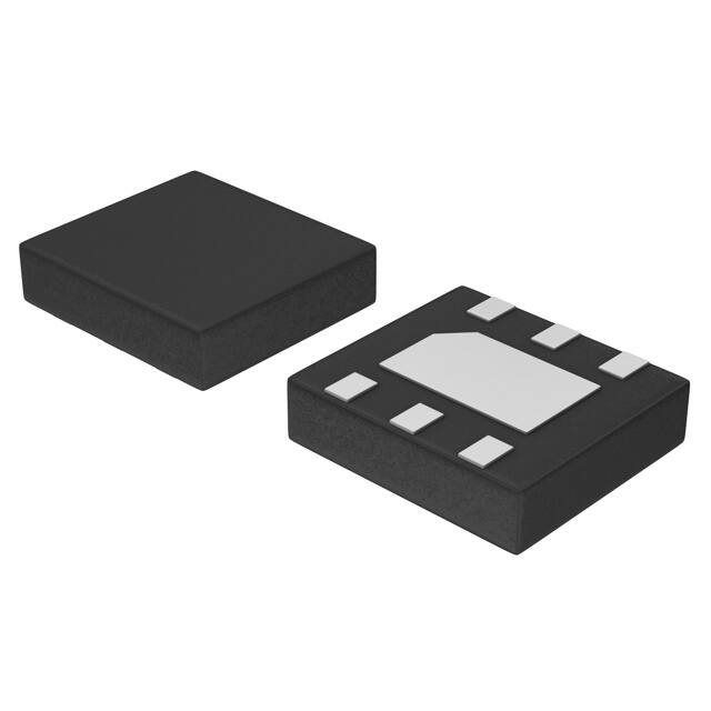

DATA SHEET www.onsemi.com Voltage Regulator - Low Iq, Low Dropout, Power Good Output GENERIC MARKING DIAGRAMS 1 NCV8187 The NCV8187 is 1.2 A LDO Linear Voltage Regulator. It is a very stable and accurate device with low quiescent current consumption (typ. 30 mA over the full temperature range), low dropout, low output noise and very good PSRR. The regulator incorporates several protection features such as Thermal Shutdown, Soft Start, Current Limiting and also Power Good Output signal for easy MCU interfacing. • • Operating Input Voltage Range: 1.5 V to 5.5 V Adjustable and Fixed Voltage Options Available: 0.8 V to 5.2 V Low Quiescent Current: typ. 30 mA over Temperature ±2% Accuracy Over Full Load, Line and Temperature variations PSRR: 75 dB at 1 kHz Low Noise: typ. 15 mVRMS from 10 Hz to 100 kHz Stable With Small 10 mF Ceramic Capacitor Soft−start to Reduce Inrush Current and Overshoots Thermal Shutdown and Current Limit Protection Power Good Signal Extends Application Range Available in WDFN6 and WDFNW6 2x2, DFN6 3x3, DFNW6 3x3, DFNW8 3x3 and DPAK−5 with Wettable Flank (pin edge plating) NCV Prefix for Automotive and Other Applications Requiring Unique Site and Control Change Requirements; AEC−Q100 Qualified and PPAP Capable These Devices are Pb−Free, Halogen Free/BFR Free and are RoHS Compliant Typical Applications • • • • • • • 1 1 DFN6/DFNW6 3x3 CASE 506DK & 507AW 1 1 Features • • • • • • • • • • • XX M WDFN6/WDFNW6 2x2 CASE 511BR & 511DW 1.2 A DFNW8 3x3 CASE 507AD XXXXX XXXXX ALYWG G XXXXXX XXXXXX ALYWG G XXXXXXG ALYWW DPAK−5 CASE 175AA XXXXXX = Specific Device Code A = Assembly Location L = Wafer Lot Y = Year W/WW = Work Week D = Date Code G/G = Pb−Free Package (Note: Microdot may be in either location) ORDERING INFORMATION See detailed ordering and shipping information on page 12 of this data sheet. Wireless Chargers and Portable Equipment Smart Camera and Robotic Vision Systems Telecommunication and Networking Systems Infotainment and Cluster Modular Platforms for Dashboard Display Internet Connection Sharing (ICS) Gateway Server Applications General Purpose Automotive VIN CIN IN 1 mF Ceramic EN OUT NCV8187 SNS GND PG ON VOUT COUT 10 mF Ceramic OFF Figure 1. Typical Application Schematic © Semiconductor Components Industries, LLC, 2018 August, 2021 − Rev. 8 1 Publication Order Number: NCV8187/D NCV8187 PIN FUNCTION CONNECTION DFN6 3x3 mm, DFNW6 3x3 mm (Top View) WDFN6 2x2 mm WDFNW6 2x2 mm (Top View) DFNW8 3x3 mm (Top View) DPAK−5 (Top View) Figure 2. Pin Function Connection PIN FUNCTION DESCRIPTION Pin No. WDFN6 & WDFNW6 2x2 Pin No. DFN6 & DFNW6 3x3 Pin No. DFNW8 3x3 Pin No. DPAK−5 Pin Name 1 6 8 2 IN 6 4 1 4 OUT Regulated output voltage pin. A small 10 mF ceramic capacitor is needed from this pin to ground to assure stability 3, EXP 2, EXP 5, EXP TAB GND Power supply ground 2 1 7 1 EN 5 − 2/− 5/− SNS Sense pin. Connect this pin to regulated output voltage − − −/2 −/5 ADJ Adjustable feedback voltage input. Connect this pin to external resistor divider for desired voltage output 4 3 3 − PG Power Good, open collector. Use 10 kW to 100 kW pull−up resistor connected to output or input voltage − 5 4, 6 − NC No connection. This pin can be tied to ground to improve thermal dissipation or left disconnected Description Input pin. A small capacitor is needed from this pin to ground to assure stability Enable pin. Driving this pin high turns on the regulator. Driving EN pin low puts the regulator into shutdown mode www.onsemi.com 2 NCV8187 ABSOLUTE MAXIMUM RATINGS Symbol Value Unit Input Voltage (Note 1) Ratings VIN −0.3 to 6 V Enable Voltage VEN −0.3 to 6 V Power Good Current IPG 30 mA Power Good Voltage VPG −0.3 to 6 V Output Voltage VOUT −0.3 to VIN + 0.3 (max. 5.5) V Output Short Circuit Duration tSC Indefinite s TJ(MAX) 150 °C TSTG −55 to 150 °C ESD Capability, Human Body Model (Note 2) ESDHBM 2000 V ESD Capability, Machine Model (Note 2) ESDMM 200 V Maximum Junction Temperature Storage Temperature Stresses exceeding those listed in the Maximum Ratings table may damage the device. If any of these limits are exceeded, device functionality should not be assumed, damage may occur and reliability may be affected. 1. Refer to ELECTRICAL CHARACTERISTICS and APPLICATION INFORMATION for Safe Operating Area. 2. This device series incorporates ESD protection and is tested by the following methods: ESD Human Body Model tested per AEC−Q100−002 (EIA/JESD22−A114) ESD Machine Model tested per AEC−Q100−003 (EIA/JESD22−A115) THERMAL CHARACTERISTICS Rating Symbol Value Unit THERMAL CHARACTERISTICS, WDFN6, 2x2, 0.65 PITCH PACKAGE RqJA 51 °C/W Thermal Resistance, Junction−to−Case (top) RqJC(top) 142 °C/W Thermal Resistance, Junction−to−Case (bottom) (Note 4) RqJC(bot) 7.8 °C/W Thermal Resistance, Junction−to−Board RqJB 125 °C/W Characterization Parameter, Junction−to−Top YJT 2.0 °C/W Characterization Parameter, Junction−to−Board YJB 7.7 °C/W Thermal Resistance, Junction−to−Ambient (Note 3) THERMAL CHARACTERISTICS, DFN6 / DFNW6, 3x3, 0.95 PITCH PACKAGES RqJA 50 °C/W Thermal Resistance, Junction−to−Case (top) RqJC(top) 142 °C/W Thermal Resistance, Junction−to−Case (bottom) (Note 4) RqJC(bot) 7.9 °C/W RqJB 125 °C/W Characterization Parameter, Junction−to−Top YJT 2.0 °C/W Characterization Parameter, Junction−to−Board YJB 7.5 °C/W Thermal Resistance, Junction−to−Ambient (Note 3) Thermal Resistance, Junction−to−Board 3. The junction−to−ambient thermal resistance under natural convection is obtained in a simulation on a high−K board, following the JEDEC51.7 guidelines with assumptions as above, in an environment described in JESD51−2a. 4. The junction−to−case (bottom) thermal resistance is obtained by simulating a cold plate test on the IC exposed pad. Test description can be found in the ANSI SEMI standard G30−88. www.onsemi.com 3 NCV8187 ELECTRICAL CHARACTERISTICS − WDFN6 2x2, WDFNW6 2x2, DFN6 3x3 AND DFNW6 3x3 (−40°C ≤ TJ ≤ 150°C; VIN = VOUT + 1.0 V; IOUT = 10 mA, CIN = 1 mF, COUT = 10 mF, unless otherwise noted. Typical values are at TJ = +25°C. (Note 6)) Test Conditions Parameter Operating Input Voltage Output Voltage Accuracy −40°C ≤ TJ ≤ 150°C, VOUT +1 V < VIN < 5.5 V, 0 mA < IOUT < 1.2 A VOUT < 1.7 V Symbol Min Typ Max Unit VIN 1.5 − 5.5 V VOUT −35 mV − +35 mV V −2% − +2% VREF − 0.8 − V VOUT ≥ 1.7 V Reference Voltage Line Regulation VOUT + 1 V ≤ VIN ≤ 5.5 V, IOUT = 1 mA RegLINE − 40 − mV/V Load Regulation IOUT = 0 mA to 1.2 A RegLOAD − 2 − mV/mA Dropout Voltage VDO = VIN – (VOUT(NOM) – 3%) IOUT = 1.2 A VDO − 325 495 mV 1.5 V – 1.7 V − 240 400 1.8 V – 2.7 V − 200 335 2.8 V – 3.2 V − 165 250 3.3 V – 4.9 V − 150 220 5V − 120 180 IOUT 1300 1750 − mA 1.2 V – 1.4 V Maximum Output Current (Note 7) Short Circuit Current (Note 7) ISC − 1850 − mA Disable Current VEN = 0 V IDIS − 0.1 5.0 mA Quiescent Current IOUT = 0 mA IQ − 30 45 mA Ground Current IOUT = 1.2 A IGND − 2 − mA Power Supply Rejection Ratio VIN = 3.5 V + 100 mVpp VOUT = 2.5 V IOUT = 10 mA, COUT = 1 mF PSRR − 75 − dB Output Noise Voltage VOUT = 1.8 V, IOUT = 10 mA, f = 10 Hz to 100 kHz VN − 15 − mVrms Enable Input Threshold Voltage Voltage increasing VEN_HI 0.9 − − V Voltage decreasing VEN_LO − − 0.3 EN Pin Current VEN = 5.5 V − 100 − nA Active Output Discharge Resistance VIN = 5.5 V, VEN = 0 V RDIS − 120 − W Power Good, Output Voltage Raising VPGup − 92 − % Power Good, Output Voltage Falling VPGdw − 80 − % VPGlo − 0.14 0.4 V f = 1 kHz Power Good Output Voltage Low IPG = 6 mA, Open drain Thermal Shutdown Temperature (Note 5) Temperature increasing from TJ = +25°C TSD − 170 − °C Thermal Shutdown Hysteresis (Note 5) Temperature falling from TSD TSDH − 15 − °C Product parametric performance is indicated in the Electrical Characteristics for the listed test conditions, unless otherwise noted. Product performance may not be indicated by the Electrical Characteristics if operated under different conditions. 5. Guaranteed by design and characterization. 6. Performance guaranteed over the indicated operating temperature range by design and/or characterization production tested at TJ = TA = 25_C. Low duty cycle pulse techniques are used during testing to maintain the junction temperature as close to ambient as possible. 7. Respect SOA. www.onsemi.com 4 NCV8187 ELECTRICAL CHARACTERISTICS − DFNW8 3x3 AND DPAK−5 (−40°C ≤ TJ ≤ 150°C; VIN = VOUT + 1.0 V; IOUT = 10 mA, CIN = 1 mF, COUT = 10 mF, unless otherwise noted. Typical values are at TJ = +25°C. (Note 9)) Test Conditions Parameter Operating Input Voltage Output Voltage Accuracy −40°C ≤ TJ ≤ 150°C, VOUT + 1 V < VIN < 5.5 V, 0 mA < IOUT < 1 A VOUT < 1.7 V Symbol Min Typ Max Unit VIN 1.5 − 5.5 V VOUT −35 mV − +35 mV V −2% − +2% VREF − 1.2 − V VOUT ≥ 1.7 V Reference Voltage Line Regulation VOUT + 1 V ≤ VIN ≤ 5.5 V, IOUT = 1 mA RegLINE − 40 − mV/V Load Regulation IOUT = 0 mA to 1 A RegLOAD − 2 − mV/mA Dropout Voltage VDO = VIN – (VOUT(NOM) – 3%) IOUT = 1 A VDO − 295 450 mV 1.5 V – 1.7 V − 220 360 1.8 V – 2.7 V − 180 305 2.8 V – 3.2 V − 150 225 3.3 V – 4.9 V − 135 200 5V − 110 165 1.2 V – 1.4 V Maximum Output Current (Note 10), TJ = 25°C IOUT 1025 1500 1750 mA Maximum Output Current (Note 10) IOUT 1025 1500 1950 mA Short Circuit Current (Note 10) ISC − 1550 − mA Disable Current VEN = 0 V IDIS − 0.1 5.0 mA Quiescent Current IOUT = 0 mA IQ − 30 45 mA Ground Current IOUT = 1 A IGND − 2 − mA Power Supply Rejection Ratio VIN = 3.5 V + 100 mVpp VOUT = 2.5 V IOUT = 10 mA, COUT = 1 mF PSRR − 75 − dB Output Noise Voltage VOUT = 1.8 V, IOUT = 10 mA, f = 10 Hz to 100 kHz VN − 15 − mVrms Enable Input Threshold Voltage Voltage increasing VEN_HI 0.9 − − V Voltage decreasing VEN_LO − − 0.3 EN Pin Current VEN = 5.5 V Active Output Discharge Resistance VIN = 5.5 V, VEN = 0 V f = 1 kHz − 100 − nA RDIS − 120 − W Power Good, Output Voltage Raising VPGup − 92 − % Power Good, Output Voltage Falling VPGdw − 80 − % VPGlo − 0.14 0.4 V Power Good Output Voltage Low IPG = 6 mA, Open drain Thermal Shutdown Temperature (Note 8) Temperature increasing from TJ = +25°C TSD − 170 − °C Thermal Shutdown Hysteresis (Note 8) Temperature falling from TSD TSDH − 15 − °C Product parametric performance is indicated in the Electrical Characteristics for the listed test conditions, unless otherwise noted. Product performance may not be indicated by the Electrical Characteristics if operated under different conditions. 8. Guaranteed by design and characterization. 9. Performance guaranteed over the indicated operating temperature range by design and/or characterization production tested at TJ = TA = 25_C. Low duty cycle pulse techniques are used during testing to maintain the junction temperature as close to ambient as possible. 10. Respect SOA. www.onsemi.com 5 NCV8187 TYPICAL CHARACTERISTICS OUTPUT VOLTAGE (V) 1.215 1.210 1.820 VIN = 2.2 V IOUT = 1 mA COUT = 10 mF 1.815 OUTPUT VOLTAGE (V) 1.220 1.205 1.200 1.195 1.190 1.180 −40 −20 3.310 1.800 1.795 1.790 0 20 40 60 80 100 120 1.780 −40 −20 140 60 80 100 120 140 Figure 4. Output Voltage vs. Temperature – VOUT = 1.8 V 450 VIN = 4.3 V IOUT = 1 mA COUT = 10 mF 425 3.295 3.290 3.285 400 VOUT = 1.2 V IOUT = 1.2 A COUT = 10 mF 375 350 325 300 275 250 225 3.280 −40 −20 0 20 40 60 80 100 120 200 −40 −20 140 0 20 40 60 80 100 120 140 TEMPERATURE (°C) TEMPERATURE (°C) Figure 5. Output Voltage vs. Temperature – VOUT = 3.3 V Figure 6. Dropout Voltage vs. Temperature – VOUT = 1.2 V 240 325 VOUT = 1.8 V IOUT = 1.2 A COUT = 10 mF 220 VOLTAGE DROPOUT (mV) VOLTAGE DROPOUT (mV) 40 Figure 3. Output Voltage vs. Temperature – VOUT = 1.2 V 3.300 275 20 TEMPERATURE (°C) 3.305 300 0 TEMPERATURE (°C) VOLTAGE DROPOUT (mV) OUTPUT VOLTAGE (V) 3.315 1.805 1.785 1.185 3.320 1.810 VIN = 2.8 V IOUT = 1 mA COUT = 10 mF 250 225 200 175 150 125 100 75 −40 −20 0 20 40 60 80 100 120 200 VOUT = 3.3 V IOUT = 1.2 A COUT = 10 mF 180 160 140 120 100 80 60 40 −40 −20 140 0 20 40 60 80 100 120 140 TEMPERATURE (°C) TEMPERATURE (°C) Figure 7. Dropout Voltage vs. Temperature – VOUT = 1.8 V Figure 8. Dropout Voltage vs. Temperature – VOUT = 3.3 V www.onsemi.com 6 NCV8187 TYPICAL CHARACTERISTICS 3.0 36 VOUT = nom. IOUT = 0 mA COUT = 10 mF 34 32 30 28 26 24 22 20 −40 −20 CURRENT LIMIT (mA) 1950 1900 0 20 40 60 80 100 120 2.6 VOUT = nom. IOUT = 1.2 A COUT = 10 mF 2.4 2.2 2.0 1.8 1.6 1.4 1.2 1.0 −40 −20 140 0 20 40 60 80 100 120 140 TEMPERATURE (°C) TEMPERATURE (°C) Figure 9. Quiescent Current vs. Temperature Figure 10. Ground Current vs. Temperature 0.80 VOUT = nom. COUT = 10 mF 0.75 ENABLE THRESHOLD (V) 2000 1850 1800 1750 1700 1650 1600 1550 1500 −40 −20 POWER GOOD THRESHOLD (%) 2.8 GROUND CURRENT (mA) 38 0.70 Output ON 0.65 0.60 Output OFF 0.55 0.50 0.45 0 20 40 60 80 100 120 0.40 −40 −20 140 0 20 40 60 80 100 120 140 TEMPERATURE (°C) TEMPERATURE (°C) Figure 11. Current Limit vs. Temperature Figure 12. Enable Thresholds vs. Temperature 96 135 94 134 VOUT = rising to nominal 92 ACTIVE DISCHARGE (W) QUIESCENT CURRENT (mA) 40 90 88 86 VOUT = falling from nominal 84 82 80 −40 −20 0 20 40 60 80 100 120 133 EN = low COUT = 10 mF 132 131 130 129 128 127 126 125 −40 −20 140 0 20 40 60 80 100 120 140 TEMPERATURE (°C) TEMPERATURE (°C) Figure 13. Power Good Thresholds vs. Temperature Figure 14. Active Discharge Resistance vs. Temperature www.onsemi.com 7 NCV8187 TYPICAL CHARACTERISTICS NOISE SPECTRAL DENSITY (nV/√Hz) 100 90 80 PSRR (dB) 70 60 50 40 30 20 1.3 1.2 1.1 1.0 0.9 0.8 0.7 0.6 0.5 0.4 0.3 0.2 0.1 0.0 0.01 0.1 1 10 100 1k 10k 10 1 10 100 1k 10k 100k 1M FREQUENCY (Hz) Figure 15. Power Supply Rejection Ratio for VOUT = 1.8 V, IOUT = 10 mA, COUT = 10 mF Figure 16. Output Voltage Noise Spectral Density for VOUT = 1.8 V, IOUT = 10 mA, COUT = 10 mF IOUT 10 mA IOUT 500 mA 0.0 0.5 1.0 1.5 2.0 2.5 3.0 3.5 4.0 4.5 5.0 5.5 3.6 3.3 3.0 2.7 2.4 2.1 1.8 1.5 1.2 0.9 0.6 IOUT IOUT 10 mA 0.3 500 mA 0.0 0.0 0.5 1.0 1.5 2.0 2.5 3.0 3.5 4.0 4.5 5.0 5.5 INPUT VOLTAGE (V) INPUT VOLTAGE (V) Figure 17. Output Voltage vs. Input Voltage, VOUT = 1.2 V Figure 18. Output Voltage vs. Input Voltage, VOUT = 3.3 V 10000 GROUND CURRENT (mA) 10000 GROUND CURRENT (mA) 100 FREQUENCY (kHz) OUTPUT VOLTAGE (V) OUTPUT VOLTAGE (V) 10 0 1k 1000 100 10 0.001 0.01 0.1 1 10 100 1000 1000 100 10 0.001 0.01 0.1 1 10 100 1000 OUTPUT CURRENT (mA) OUTPUT CURRENT (mA) Figure 19. Ground Current vs. Output Current, VOUT = 1.2 V Figure 20. Ground Current vs. Output Current, VOUT = 3.3 V www.onsemi.com 8 NCV8187 TYPICAL CHARACTERISTICS 1.2025 IOUT 50 mA 500 450 400 350 300 250 200 150 100 IOUT 0.5 mA 50 0 −40 −20 0 20 40 60 25°C 1.2020 OUTPUT VOLTAGE (V) GROUND CURRENT (mA) 600 550 85°C 1.2015 1.2010 150°C 1.2005 1.2000 1.1995 1.1990 −40°C 1.1985 80 100 120 1.1980 1.5 140 2.0 TEMPERATURE (°C) Figure 21. Ground Current vs. Temperature VOLTAGE DROPOUT (mV) OUTPUT VOLTAGE (V) 85°C 3.300 3.298 150°C 3.296 −40°C 3.7 3.9 4.1 4.3 4.5 4.7 4.0 4.5 5.0 5.5 200 25°C 3.302 3.294 3.5 3.5 Figure 22. Line Regulation, VOUT = 1.2 V 220 3.304 3.0 INPUT VOLTAGE (V) 3.308 3.306 2.5 4.9 180 150°C 160 140 85°C 25°C 120 −40°C 100 80 60 40 20 5.1 5.3 5.5 00 0.1 0.2 0.3 0.4 0.5 0.6 0.7 0.8 0.9 1.0 1.1 1.2 INPUT VOLTAGE (V) OUTPUT CURRENT (A) Figure 23. Line Regulation, VOUT = 3.3 V Figure 24. Dropout Voltage vs. Output Current, VOUT = 3.3 V www.onsemi.com 9 NCV8187 APPLICATIONS INFORMATION Recommended operating current is between 10 mA and 1 mA to obtain low saturation voltage. External pull−up resistor can be connected to any voltage up to 5.5 V (please see Absolute Maximum Ratings table above). The NCV8187 is the member of new family of high output current and low dropout regulators which delivers low quiescent and ground current consumption, good noise and power supply ripple rejection ratio performance. The NCV8187 incorporates EN pin and power good output for simple controlling by MCU or logic. Standard features include current limiting, soft−start feature and thermal protection. Power Dissipation and Heat Sinking The maximum power dissipation supported by the device is dependent upon board design and layout. Mounting pad configuration on the PCB, the board material, and the ambient temperature affect the rate of junction temperature rise for the part. For reliable operation junction temperature should be limited to +125_C. The maximum power dissipation the NCV8187 can handle is given by: Input Decoupling (CIN) It is recommended to connect at least 1 mF ceramic X5R or X7R capacitor between IN and GND pin of the device. This capacitor will provide a low impedance path for any unwanted AC signals or noise superimposed onto constant input voltage. The good input capacitor will limit the influence of input trace inductances and source resistance during sudden load current changes. Higher capacitance and lower ESR capacitors will improve the overall line transient response. P D(MAX) + ƪTJ(MAX) * TAƫ (eq. 1) R qJA The power dissipated by the NCV8187 for given application conditions can be calculated from the following equations: P D [ V INǒI GND(I OUT)Ǔ ) I OUTǒV IN * V OUTǓ Output Decoupling (COUT) The NCV8187 does not require a minimum Equivalent Series Resistance (ESR) for the output capacitor. The device is designed to be stable with standard ceramics capacitors with values of 4.7 mF or greater. Recommended capacitor for the best performance is 10 mF. The X5R and X7R types have the lowest capacitance variations over temperature thus they are recommended. (eq. 2) or V IN(MAX) [ P D(MAX) ) ǒV OUT I OUT ) I GND I OUTǓ (eq. 3) Hints VIN and GND printed circuit board traces should be as wide as possible. When the impedance of these traces is high, there is a chance to pick up noise or cause the regulator to malfunction. Place external components, especially the output capacitor, as close as possible to the NCV8187, and make traces as short as possible. Power Good Output Connection The NCV8187 include Power Good functionality for better interfacing to MCU system. Power Good output is open collector type, capable to sink up to 10 mA. www.onsemi.com 10 NCV8187 ADJUSTABLE VERSION where VFIX is voltage of original fixed version (from 0.8 V up to 5.2 V). Do not operate the device at output voltage about 5.2 V, as device can be damaged. In order to avoid influence of current flowing into SNS pin to output voltage accuracy (SNS current varies with voltage option and temperature, typical value is 300 nA) it is recommended to use values of R1 and R2 below 500 kW. Not only adjustable version, but also any fixed version can be used to create adjustable voltage, where original fixed voltage becomes reference voltage for resistor divider and feedback loop. Output voltage can be equal or higher than original fixed option, while possible range is from 0.8 V up to 5.2 V. Picture below shows how to add external resistors to increase output voltage above fixed value. Output voltage is then given by equation: V OUT + V FIX (1 ) R1ńR2) VIN VOUT IN CIN NCV8187 OUT ADJ or FIX version 1 mF Ceramic EN GND R1 SNS ON R2 OFF COUT 10 mF Ceramic Figure 25. recommended to use as high fixed variant as possible – for example in case above it is better to use 3.3 V fixed variant to create 3.6 V output voltage, as output noise will be amplified only 3.6/3.3 = 1.09 × (16.4 mVrms). Please note that output noise is amplified by VOUT / VFIX ratio. For example, if original 0.8 V fixed variant is used to create 3.6 V output voltage, output noise is increased 3.6/0.8 = 4.5 times and real value will be 4.5 × 15 mVrms = 67.5ĂmVrms . For noise sensitive applications it is www.onsemi.com 11 NCV8187 ORDERING INFORMATION Voltage Option Marking Option Package Shipping† NCV8187AMT110TAG 1.1 V PM NCV8187AMT120TAG 1.2 V PJ With Active Output Discharge WDFN6 2x2 non WF (Pb−Free) 3,000 / Tape & Reel NCV8187AMT180TAG 1.8 V PK NCV8187AMT330TAG 3.3 V PL NCV8187AMN120TAG 1.2 V NA NCV8187AMN180TAG 1.8 V NH With Active Output Discharge DFN6 3x3 non WF (Pb−Free) 3,000 / Tape & Reel NCV8187AMTWADJTAG ADJ K2 NCV8187AMTW080TAG 0.8 V KG With Active Output Discharge WDFNW6 2x2 WF SLP (Pb−Free) 3,000 / Tape & Reel NCV8187AMTW090TAG 0.9 V KH NCV8187AMTW110TAG 1.1 V KM NCV8187AMTW180TAG 1.8 V KJ NCV8187AMTW330TAG 3.3 V KK NCV8187AML120TAG 1.2 V WD NCV8187AML180TAG 1.8 V WE With Active Output Discharge DFNW6 3x3 WF SLP (Pb−Free) 3,000 / Tape & Reel NCV8187AMLE120TCG 1.2 V CA NCV8187AMLE180TCG 1.8 V CC With Active Output Discharge DFNW8 3x3 WF (Pb−Free) 3,000 / Tape & Reel NCV8187AMLE280TCG 2.8 V CE NCV8187AMLE330TCG 3.3 V CD NCV8187AMLEADJTCG ADJ C2 NCV8187ADT180RKG* 1.8 V V8187BG NCV8187ADT330RKG* 3.3 V V8187CG With Active Output Discharge DPAK−5 (Pb−Free) 2,500 / Tape & Reel NCV8187ADTADJRKG* ADJ V8187AG Device Part No. †For information on tape and reel specifications, including part orientation and tape sizes, please refer to our Tape and Reel Packaging Specifications Brochure, BRD8011/D. *Package in development. www.onsemi.com 12 MECHANICAL CASE OUTLINE PACKAGE DIMENSIONS DPAK−5, CENTER LEAD CROP CASE 175AA ISSUE B DATE 15 MAY 2014 SCALE 1:1 −T− C B V NOTES: 1. DIMENSIONING AND TOLERANCING PER ANSI Y14.5M, 1982. 2. CONTROLLING DIMENSION: INCH. SEATING PLANE E R R1 Z A S 12 3 4 5 U K F J L H D G 5 PL 0.13 (0.005) M T 2.2 0.086 0.34 5.36 0.013 0.217 5.8 0.228 10.6 0.417 0.8 0.031 SCALE 4:1 mm Ǔ ǒinches *For additional information on our Pb−Free strategy and soldering details, please download the ON Semiconductor Soldering and Mounting Techniques Reference Manual, SOLDERRM/D. DOCUMENT NUMBER: DESCRIPTION: 98AON12855D INCHES MIN MAX 0.235 0.245 0.250 0.265 0.086 0.094 0.020 0.028 0.018 0.023 0.024 0.032 0.180 BSC 0.034 0.040 0.018 0.023 0.102 0.114 0.045 BSC 0.170 0.190 0.185 0.210 0.025 0.040 0.020 −−− 0.035 0.050 0.155 0.170 MILLIMETERS MIN MAX 5.97 6.22 6.35 6.73 2.19 2.38 0.51 0.71 0.46 0.58 0.61 0.81 4.56 BSC 0.87 1.01 0.46 0.58 2.60 2.89 1.14 BSC 4.32 4.83 4.70 5.33 0.63 1.01 0.51 −−− 0.89 1.27 3.93 4.32 GENERIC MARKING DIAGRAMS* RECOMMENDED SOLDERING FOOTPRINT* 6.4 0.252 DIM A B C D E F G H J K L R R1 S U V Z XXXXXXG ALYWW AYWW XXX XXXXXG IC Discrete XXXXXX A L Y WW G = Device Code = Assembly Location = Wafer Lot = Year = Work Week = Pb−Free Package *This information is generic. Please refer to device data sheet for actual part marking. Pb−Free indicator, “G” or microdot “ G”, may or may not be present. Electronic versions are uncontrolled except when accessed directly from the Document Repository. Printed versions are uncontrolled except when stamped “CONTROLLED COPY” in red. DPAK−5 CENTER LEAD CROP PAGE 1 OF 1 ON Semiconductor and are trademarks of Semiconductor Components Industries, LLC dba ON Semiconductor or its subsidiaries in the United States and/or other countries. ON Semiconductor reserves the right to make changes without further notice to any products herein. ON Semiconductor makes no warranty, representation or guarantee regarding the suitability of its products for any particular purpose, nor does ON Semiconductor assume any liability arising out of the application or use of any product or circuit, and specifically disclaims any and all liability, including without limitation special, consequential or incidental damages. ON Semiconductor does not convey any license under its patent rights nor the rights of others. © Semiconductor Components Industries, LLC, 2019 www.onsemi.com MECHANICAL CASE OUTLINE PACKAGE DIMENSIONS DFNW6 3x3, 0.95P CASE 506DK ISSUE A 1 SCALE 2:1 DATE 07 MAY 2021 GENERIC MARKING DIAGRAM* XXXXX XXXXX ALYWG G XXXXX = Specific Device Code A = Assembly Location L = Wafer Lot Y = Year W = Work Week G = Pb−Free Package (Note: Microdot may be in either location) *This information is generic. Please refer to device data sheet for actual part marking. Pb−Free indicator, “G” or microdot “G”, may or may not be present. Some products may not follow the Generic Marking. DOCUMENT NUMBER: DESCRIPTION: 98AON12549G DFNW6 3X3, 0.95P Electronic versions are uncontrolled except when accessed directly from the Document Repository. Printed versions are uncontrolled except when stamped “CONTROLLED COPY” in red. PAGE 1 OF 1 ON Semiconductor and are trademarks of Semiconductor Components Industries, LLC dba ON Semiconductor or its subsidiaries in the United States and/or other countries. ON Semiconductor reserves the right to make changes without further notice to any products herein. ON Semiconductor makes no warranty, representation or guarantee regarding the suitability of its products for any particular purpose, nor does ON Semiconductor assume any liability arising out of the application or use of any product or circuit, and specifically disclaims any and all liability, including without limitation special, consequential or incidental damages. ON Semiconductor does not convey any license under its patent rights nor the rights of others. © Semiconductor Components Industries, LLC, 2019 www.onsemi.com MECHANICAL CASE OUTLINE PACKAGE DIMENSIONS DFNW8 3x3, 0.65P CASE 507AD ISSUE A 1 SCALE 2:1 DATE 15 JUN 2018 A B D ÉÉÉ ÉÉÉ ÉÉÉ ÉÉÉ L3 L L ALTERNATE CONSTRUCTION DETAIL A E PIN ONE REFERENCE EXPOSED COPPER DETAIL B PLATING A1 A4 A ALTERNATE CONSTRUCTION DETAIL B A3 C C 0.05 C NOTE 4 A4 C SIDE VIEW SEATING PLANE PLATED SURFACES D2 DETAIL A NOTES: 1. DIMENSIONING AND TOLERANCING PER ASME Y14.5M, 1994. 2. CONTROLLING DIMENSION: MILLIMETERS. 3. DIMENSION b APPLIES TO PLATED TERMINAL AND IS MEASURED BETWEEN 0.15 AND 0.30mm FROM THE TERMINAL TIP. 4. COPLANARITY APPLIES TO THE EXPOSED PAD AS WELL AS THE TERMINALS. 5. THIS DEVICE CONTAINS WETTABLE FLANK DESIGN FEATURE TO AID IN FILLET FORMATION ON THE LEADS DURING MOUNTING. A4 A1 TOP VIEW 0.05 C L3 1 L3 SECTION C−C 4 DIM A A1 A3 A4 b D D2 E E2 e K L L3 GENERIC MARKING DIAGRAM* 1 8X L E2 K 8 5 e/2 8X 0.05 C NOTE 3 BOTTOM VIEW RECOMMENDED SOLDERING FOOTPRINT* *This information is generic. Please refer to device data sheet for actual part marking. Pb−Free indicator, “G” or microdot “ G”, may or may not be present. Some products may not follow the Generic Marking. 2.50 2.35 8X 0.58 8 5 1 4 XXXXXX XXXXXX ALYWG G XXXXXX = Specific Device Code A = Assembly Location L = Wafer Lot Y = Year W = Work Week G = Pb−Free Package (Note: Microdot may be in either location) b 0.10 C A B e MILLIMETERS MIN NOM MAX 1.00 0.80 0.90 −−− −−− 0.05 0.20 REF 0.10 −−− −−− 0.25 0.30 0.35 2.90 3.00 3.10 2.30 2.40 2.50 2.90 3.00 3.10 1.55 1.65 1.75 0.65 BSC 0.28 REF 0.30 0.40 0.50 0.05 REF 3.30 1.75 PACKAGE OUTLINE 8X 0.65 PITCH 0.40 DIMENSIONS: MILLIMETERS *For additional information on our Pb−Free strategy and soldering details, please download the ON Semiconductor Soldering and Mounting Techniques Reference Manual, SOLDERRM/D. DOCUMENT NUMBER: DESCRIPTION: 98AON17792G DFNW8 3x3, 0.65P Electronic versions are uncontrolled except when accessed directly from the Document Repository. Printed versions are uncontrolled except when stamped “CONTROLLED COPY” in red. PAGE 1 OF 1 ON Semiconductor and are trademarks of Semiconductor Components Industries, LLC dba ON Semiconductor or its subsidiaries in the United States and/or other countries. ON Semiconductor reserves the right to make changes without further notice to any products herein. ON Semiconductor makes no warranty, representation or guarantee regarding the suitability of its products for any particular purpose, nor does ON Semiconductor assume any liability arising out of the application or use of any product or circuit, and specifically disclaims any and all liability, including without limitation special, consequential or incidental damages. ON Semiconductor does not convey any license under its patent rights nor the rights of others. © Semiconductor Components Industries, LLC, 2018 www.onsemi.com MECHANICAL CASE OUTLINE PACKAGE DIMENSIONS DFNW6 3X3, 0.95P CASE 507AW ISSUE O 1 DATE 21 MAY 2019 EXPOSED COPPER GENERIC MARKING DIAGRAM* 1 XXXXX A L Y W G XXXXX XXXXX ALYWG G = Specific Device Code = Assembly Location = Wafer Lot = Year = Work Week = Pb−Free Package *This information is generic. Please refer to device data sheet for actual part marking. Pb−Free indicator, “G” or microdot “ G”, may or may not be present. Some products may not follow the Generic Marking. DOCUMENT NUMBER: DESCRIPTION: 98AON07566H DFNW6 3X3, 0.95P Electronic versions are uncontrolled except when accessed directly from the Document Repository. Printed versions are uncontrolled except when stamped “CONTROLLED COPY” in red. PAGE 1 OF 1 ON Semiconductor and are trademarks of Semiconductor Components Industries, LLC dba ON Semiconductor or its subsidiaries in the United States and/or other countries. ON Semiconductor reserves the right to make changes without further notice to any products herein. ON Semiconductor makes no warranty, representation or guarantee regarding the suitability of its products for any particular purpose, nor does ON Semiconductor assume any liability arising out of the application or use of any product or circuit, and specifically disclaims any and all liability, including without limitation special, consequential or incidental damages. ON Semiconductor does not convey any license under its patent rights nor the rights of others. © Semiconductor Components Industries, LLC, 2018 www.onsemi.com MECHANICAL CASE OUTLINE PACKAGE DIMENSIONS WDFN6 2x2, 0.65P CASE 511BR ISSUE C DATE 01 DEC 2021 GENERIC MARKING DIAGRAM* 1 XX M XX = Specific Device Code M = Date Code *This information is generic. Please refer to device data sheet for actual part marking. Pb−Free indicator, “G” or microdot “G”, may or may not be present. Some products may not follow the Generic Marking. DOCUMENT NUMBER: DESCRIPTION: 98AON55829E WDFN6 2X2, 0.65P Electronic versions are uncontrolled except when accessed directly from the Document Repository. Printed versions are uncontrolled except when stamped “CONTROLLED COPY” in red. PAGE 1 OF 1 onsemi and are trademarks of Semiconductor Components Industries, LLC dba onsemi or its subsidiaries in the United States and/or other countries. onsemi reserves the right to make changes without further notice to any products herein. onsemi makes no warranty, representation or guarantee regarding the suitability of its products for any particular purpose, nor does onsemi assume any liability arising out of the application or use of any product or circuit, and specifically disclaims any and all liability, including without limitation special, consequential or incidental damages. onsemi does not convey any license under its patent rights nor the rights of others. © Semiconductor Components Industries, LLC, 2019 www.onsemi.com MECHANICAL CASE OUTLINE PACKAGE DIMENSIONS WDFNW6 2x2, 0.65P CASE 511DW ISSUE B DATE 15 JUN 2018 SCALE 4:1 GENERIC MARKING DIAGRAM* XXMG G M G = Month Code = Pb−Free Package (Note: Microdot may be in either location) *This information is generic. Please refer to device data sheet for actual part marking. Pb−Free indicator, “G” or microdot “ G”, may or may not be present. Some products may not follow the Generic Marking. DOCUMENT NUMBER: DESCRIPTION: 98AON79327G WDFNW6 2x2, 0.65P Electronic versions are uncontrolled except when accessed directly from the Document Repository. Printed versions are uncontrolled except when stamped “CONTROLLED COPY” in red. PAGE 1 OF 1 ON Semiconductor and are trademarks of Semiconductor Components Industries, LLC dba ON Semiconductor or its subsidiaries in the United States and/or other countries. ON Semiconductor reserves the right to make changes without further notice to any products herein. ON Semiconductor makes no warranty, representation or guarantee regarding the suitability of its products for any particular purpose, nor does ON Semiconductor assume any liability arising out of the application or use of any product or circuit, and specifically disclaims any and all liability, including without limitation special, consequential or incidental damages. ON Semiconductor does not convey any license under its patent rights nor the rights of others. © Semiconductor Components Industries, LLC, 2018 www.onsemi.com onsemi, , and other names, marks, and brands are registered and/or common law trademarks of Semiconductor Components Industries, LLC dba “onsemi” or its affiliates and/or subsidiaries in the United States and/or other countries. onsemi owns the rights to a number of patents, trademarks, copyrights, trade secrets, and other intellectual property. A listing of onsemi’s product/patent coverage may be accessed at www.onsemi.com/site/pdf/Patent−Marking.pdf. onsemi reserves the right to make changes at any time to any products or information herein, without notice. The information herein is provided “as−is” and onsemi makes no warranty, representation or guarantee regarding the accuracy of the information, product features, availability, functionality, or suitability of its products for any particular purpose, nor does onsemi assume any liability arising out of the application or use of any product or circuit, and specifically disclaims any and all liability, including without limitation special, consequential or incidental damages. Buyer is responsible for its products and applications using onsemi products, including compliance with all laws, regulations and safety requirements or standards, regardless of any support or applications information provided by onsemi. “Typical” parameters which may be provided in onsemi data sheets and/or specifications can and do vary in different applications and actual performance may vary over time. All operating parameters, including “Typicals” must be validated for each customer application by customer’s technical experts. onsemi does not convey any license under any of its intellectual property rights nor the rights of others. onsemi products are not designed, intended, or authorized for use as a critical component in life support systems or any FDA Class 3 medical devices or medical devices with a same or similar classification in a foreign jurisdiction or any devices intended for implantation in the human body. Should Buyer purchase or use onsemi products for any such unintended or unauthorized application, Buyer shall indemnify and hold onsemi and its officers, employees, subsidiaries, affiliates, and distributors harmless against all claims, costs, damages, and expenses, and reasonable attorney fees arising out of, directly or indirectly, any claim of personal injury or death associated with such unintended or unauthorized use, even if such claim alleges that onsemi was negligent regarding the design or manufacture of the part. onsemi is an Equal Opportunity/Affirmative Action Employer. This literature is subject to all applicable copyright laws and is not for resale in any manner. PUBLICATION ORDERING INFORMATION LITERATURE FULFILLMENT: Email Requests to: orderlit@onsemi.com onsemi Website: www.onsemi.com ◊ TECHNICAL SUPPORT North American Technical Support: Voice Mail: 1 800−282−9855 Toll Free USA/Canada Phone: 011 421 33 790 2910 Europe, Middle East and Africa Technical Support: Phone: 00421 33 790 2910 For additional information, please contact your local Sales Representative
