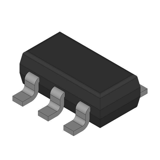

DATA SHEET www.onsemi.com LDO Linear Voltage Regulator - Ultra-Low Quiescent Current, Ultra-Low Noise TSOP−5 SN SUFFIX CASE 483 200 mA MARKING DIAGRAMS NCV8702 5 The NCV8702 is a low noise, low power consumption and low dropout Linear Voltage Regulator. With its excellent noise and PSRR specifications, the device is ideal for use in products utilizing RF receivers, imaging sensors, audio processors or any component requiring an extremely clean power supply. The NCV8702 uses an innovative Adaptive Ground Current circuit to ensure ultra low ground current during light load conditions. Features • Operating Input Voltage Range: 2.0 V to 5.5 V • Available in Fixed Voltage Options: 0.8 to 3.5 V in 2.5 mV steps • • • • • • • • • • • • Contact Factory for Other Voltage Options Ultra−Low Quiescent Current of Typ. 10 mA Ultra−Low Noise: 11 mVRMS from 100 Hz to 100 kHz Very Low Dropout: 140 mV Typical at 200 mA ±2% Accuracy Over Full Load/Line/Temperature High PSRR: 68 dB at 1 kHz Thermal Shutdown and Current Limit Protections Internal Soft−Start to Limit the Turn−On Inrush Current Stable with a 1 mF Ceramic Output Capacitor Available in TSOP−5 and XDFN 1.5 x 1.5 mm Package Active Output Discharge for Fast Output Turn−Off NCV Prefix for Automotive and Other Applications Requiring Unique Site and Control Change Requirements; AEC−Q100 Qualified and PPAP Capable These Devices are Pb−Free and are RoHS Compliant Typical Applications • • • • XDFN−6 MX SUFFIX CASE 711AE 1 XXXAYW G XM G 1 X, XXX = Specific Device Code M = Date Code A = Assembly Location Y = Year W = Work Week G = Pb−Free Package PIN CONNECTIONS 1 IN OUT GND EN N/C 5−Pin TSOP−5 (Top View) 1 OUT N/C GND IN N/C EN 6−Pin XDFN 1.5 x 1.5 mm (Top View) ORDERING INFORMATION See detailed ordering and shipping information on page 18 of this data sheet. Satellite Radio Receivers, GPS Rear View Camera, Electronic Mirrors, Lane Change Detectors Portable Entertainment Systems Other Battery Powered Applications VIN CIN IN 1 mF EN NCV8702 VOUT OUT GND COUT 1 mF Figure 1. Typical Application Schematic © Semiconductor Components Industries, LLC, 2015 September, 2022 − Rev. 3 1 Publication Order Number: NCV8702/D NCV8702 IN ENABLE LOGIC EN − BANDGAP REFERENCE THERMAL SHUTDOWN UVLO INTEGRATED SOFT−START + MOSFET DRIVER WITH CURRENT LIMIT OUT AUTO LOW POWER MODE ACTIVE DISCHARGE EEPROM EN GND Figure 2. Simplified Schematic Block Diagram Table 1. PIN FUNCTION DESCRIPTION Pin No. XDFN 6 Pin No. TSOP−5 Pin Name 1 5 OUT Regulated output voltage pin. A small 1 mF ceramic capacitor is needed from this pin to ground to assure stability. 2 4 N/C Not connected. This pin can be tied to ground to improve thermal dissipation. 3 2 GND Power supply ground. 4 3 EN Driving EN over 0.9 V turns on the regulator. Driving EN below 0.4 V puts the regulator into shutdown mode. N/C Not connected. This pin can be tied to ground to improve thermal dissipation. 5 6 1 IN Description Input pin. It is recommended to connect a 1 mF ceramic capacitor close to the device pin. Table 2. ABSOLUTE MAXIMUM RATINGS Rating Symbol Value Unit VIN −0.3 V to 6 V V Output Voltage VOUT −0.3 V to VIN + 0.3 V V Enable Input VEN −0.3 V to VIN + 0.3 V V Output Short Circuit Duration tSC Indefinite s TJ(MAX) 125 °C TSTG −55 to 150 °C ESD Capability, Human Body Model (Note 2) ESDHBM 2000 V ESD Capability, Machine Model (Note 2) ESDMM 200 V Input Voltage (Note 1) Maximum Junction Temperature Storage Temperature Stresses exceeding those listed in the Maximum Ratings table may damage the device. If any of these limits are exceeded, device functionality should not be assumed, damage may occur and reliability may be affected. 1. Refer to ELECTRICAL CHARACTERISTICS and APPLICATION INFORMATION for Safe Operating Area. 2. This device series incorporates ESD protection and is tested by the following methods: ESD Human Body Model tested per AEC−Q100−002 (EIA/JESD22−A114) ESD Machine Model tested per AEC−Q100−003 (EIA/JESD22−A115) Latchup Current Maximum Rating tested per JEDEC standard: JESD78. www.onsemi.com 2 NCV8702 Table 3. THERMAL CHARACTERISTICS (Note 3) Symbol Value Thermal Characteristics, TSOP−5, Thermal Resistance, Junction−to−Air Thermal Characterization Parameter, Junction−to−Lead (Pin 2) qJA yJA 224 115 Thermal Characteristics, XDFN6 1.5 x 1.5 mm Thermal Resistance, Junction−to−Air Thermal Characterization Parameter, Junction−to−Board qJA yJB 149 81 Rating Unit °C/W °C/W 3. Single component mounted on 1 oz, FR4 PCB with 645 mm2 Cu area. Table 4. ELECTRICAL CHARACTERISTICS (−40°C ≤ TJ ≤ 125°C; VIN = VOUT(NOM) + 0.3 V or 2.0 V, whichever is greater; VEN = 0.9 V, IOUT = 10 mA, CIN = COUT = 1 mF. Typical values are at TJ = +25°C. Min/Max values are specified for TJ = −40°C and TJ = 125°C respectively.) (Note 4) Parameter Test Conditions Operating Input Voltage Symbol Min Typ Max Unit 5.5 V 1.9 V +2 % VIN 2.0 Undervoltage lock−out VIN rising UVLO 1.2 Output Voltage Accuracy VOUT + 0.3 V ≤ VIN ≤ 5.5 V, IOUT = 0 − 200 mA VOUT −2 Line Regulation VOUT + 0.3 V ≤ VIN ≤ 4.5 V, IOUT = 10 mA RegLINE 290 mV/V VOUT + 0.3 V ≤ VIN ≤ 5.5 V, IOUT = 10 mA RegLINE 440 mV/V Load Regulation IOUT = 0 mA to 200 mA RegLOAD 13 mV/mA Dropout voltage (Note 5) IOUT = 200 mA, VOUT(nom) = 2.5 V VDO Output Current Limit VOUT = 90% VOUT(nom) ICL Quiescent current IOUT = 0 mA Ground current Shutdown current (Note 6) 1.6 140 200 mV 385 550 mA IQ 10 16 mA IOUT = 2 mA IGND 60 mA IOUT = 200 mA IGND 160 mA VEN ≤ 0.4 V IDIS 0.005 mA 0.01 220 VEN ≤ 0.4 V, VIN = 4.5 V IDIS EN Pin Threshold Voltage High Threshold Low Threshold 1 VEN Voltage increasing VEN Voltage decreasing VEN_HI VEN_LO EN Pin Input Current VEN = VIN = 5.5 V IEN 110 Turn−On Time (Note 7) COUT = 1.0 mF, IOUT = 1 mA tON 300 Output Voltage Overshoot on Start−up (Note 8) VEN = 0 V to 0.9 V, 0 ≤ IOUT ≤ 200 mA DVOUT Load Transient IOUT = 1 mA to 200 mA or IOUT = 200 mA to 1 mA in 10 ms, COUT = 1 mF DVOUT −30/+30 mV Power Supply Rejection Ratio VIN = 3 V, VOUT = 2.5 V IOUT = 150 mA PSRR 70 68 53 dB Output Noise Voltage VOUT = 2.5 V, VIN = 3 V, IOUT = 200 mA f = 100 Hz to 100 kHz VN 11 mVrms Active Discharge Resistance VEN < 0.4 V RDIS 1 kW Thermal Shutdown Temperature Temperature increasing from TJ = +25°C TSD 160 °C Thermal Shutdown Hysteresis Temperature falling from TSD TSDH mA V f = 100 Hz f = 1 kHz f = 10 kHz 0.9 0.4 500 ms 2 − 20 nA − % °C 4. Performance guaranteed over the indicated operating temperature range by design and/or characterization. Production tested at TJ = TA = 25_C. Low duty cycle pulse techniques are used during testing to maintain the junction temperature as close to ambient as possible. 5. Characterized when VOUT falls 100 mV below the regulated voltage at VIN = VOUT(NOM) + 0.3 V. 6. Shutdown Current is the current flowing into the IN pin when the device is in the disable state. 7. Turn−On time is measured from the assertion of EN pin to the point when the output voltage reaches 0.98 VOUT(NOM) 8. Guaranteed by design. www.onsemi.com 3 NCV8702 OUTPUT VOLTAGE NOISE (mV/rtHz) TYPICAL CHARACTERISTICS 10 VIN = 2.0 V VOUT = 0.8 V CIN = COUT = 1 mF MLCC, X5R, 0402 size 1 IOUT IOUT = 1 mA 0.1 IOUT = 200 mA 0.01 RMS Output Noise 10 Hz − 100 kHz 100 Hz − 100 kHz 21.17 1 mA 21.74 10 mA 14.62 14.07 200 mA 10.74 10.02 IOUT = 10 mA 0.001 10 100 1K 10 K 100 K 1M 10 M FREQUENCY (Hz) OUTPUT VOLTAGE NOISE (mV/rtHz) Figure 3. Output Voltage Noise Spectral Density for VOUT = 0.8 V, COUT = 1 mF 10 VIN = 2.0 V VOUT = 0.8 V CIN = COUT = 4.7 mF MLCC, X7R, 1206 size 1 IOUT = 1 mA IOUT IOUT = 10 mA 0.1 IOUT = 200 mA RMS Output Noise 10 Hz − 100 kHz 100 Hz − 100 kHz 1 mA 14.16 13.43 10 mA 14.20 13.70 200 mA 10.99 10.48 0.01 0.001 10 100 1K 10 K 100 K 1M 10 M FREQUENCY (Hz) OUTPUT VOLTAGE NOISE (mV/rtHz) Figure 4. Output Voltage Noise Spectral Density for VOUT = 0.8 V, COUT = 4.7 mF 10 1 IOUT = 1 mA VIN = 2.0 V VOUT = 0.8 V CIN = COUT = 10 mF MLCC, X7R, 1206 size IOUT IOUT = 10 mA 0.1 1 mA IOUT = 200 mA RMS Output Noise 10 Hz − 100 kHz 100 Hz − 100 kHz 12.94 12.11 10 mA 12.78 12.25 200 mA 11.33 10.83 0.01 0.001 10 100 1K 10 K 100 K 1M 10 M FREQUENCY (Hz) Figure 5. Output Voltage Noise Spectral Density for VOUT = 0.8 V, COUT = 10 mF www.onsemi.com 4 NCV8702 OUTPUT VOLTAGE NOISE (mV/rtHz) TYPICAL CHARACTERISTICS 10 VIN = 3.8 V VOUT = 3.3 V CIN = COUT = 1 mF MLCC, X5R, 0402 size 1 IOUT = 1 mA 0.1 IOUT = 10 mA IOUT = 200 mA 0.01 0.001 IOUT 10 100 1K 10 K 100 K 1M RMS Output Noise 10 Hz − 100 kHz 100 Hz − 100 kHz 17.87 1 mA 20.28 10 mA 16.73 13.90 200 mA 13.70 10.21 10 M FREQUENCY (Hz) OUTPUT VOLTAGE NOISE (mV/rtHz) Figure 6. Output Voltage Noise Spectral Density for VOUT = 3.3 V, COUT = 1 mF 10 VIN = 3.8 V VOUT = 3.3 V CIN = COUT = 4.7 mF MLCC, X7R, 1202 size 1 IOUT = 1 mA 0.1 IOUT IOUT = 10 mA IOUT = 200 mA RMS Output Noise 10 Hz − 100 kHz 100 Hz − 100 kHz 1 mA 15.76 11.82 10 mA 17.09 13.88 200 mA 14.51 11.47 0.01 0.001 10 100 1K 10 K 100 K 1M 10 M FREQUENCY (Hz) OUTPUT VOLTAGE NOISE (mV/rtHz) Figure 7. Output Voltage Noise Spectral Density for VOUT = 3.3 V, COUT = 4.7 mF 10 VIN = 3.8 V VOUT = 3.3 V CIN = COUT = 10 mF MLCC, X7R, 1206 size 1 IOUT = 1 mA 0.1 IOUT IOUT = 10 mA 100 Hz − 100 kHz 14.87 10.57 10 mA 16.00 12.65 200 mA 14.89 11.84 1 mA IOUT = 200 mA RMS Output Noise 10 Hz − 100 kHz 0.01 0.001 10 100 1K 10 K 100 K 1M 10 M FREQUENCY (Hz) Figure 8. Output Voltage Noise Spectral Density for VOUT = 3.3 V, COUT = 10 mF www.onsemi.com 5 NCV8702 TYPICAL CHARACTERISTICS 100 80 50 40 IOUT = 1 mA IOUT = 10 mA IOUT = 50 mA IOUT = 150 mA IOUT = 200 mA 30 20 10 0 10 100 1K 20 100 K 1M 10 0 10 M 60 40 20 100 K 1M 10 M 100 1K 10 K 60 50 40 VIN = 3.8 V VOUT = 3.3 V COUT = 4.7 mF CIN = none MLCC, X7R, 1206 size 30 20 10 100 K 1M 0 10 M 10 100 IOUT = 1 mA IOUT = 10 mA IOUT = 50 mA IOUT = 150 mA IOUT = 200 mA 1K 10 K 100 K 1M 10 M FREQUENCY (Hz) FREQUENCY (Hz) Figure 11. Power Supply Rejection Ratio, VOUT = 3.3 V, COUT = 1 mF Figure 12. Power Supply Rejection Ratio, VOUT = 3.3 V, COUT = 4.7 mF 100 90 90 80 80 70 PSRR (dB) 70 60 50 VIN = 3.8 V VOUT = 3.3 V COUT = 10 mF CIN = none MLCC, X7R, 1206 size 10 10 K 70 IOUT = 1 mA IOUT = 10 mA IOUT = 50 mA IOUT = 150 mA IOUT = 200 mA 30 10 0 1K 80 50 20 100 90 VIN = 3.8 V VOUT = 3.3 V COUT = 1 mF CIN = none MLCC, X5R, 0402 size 70 30 10 Figure 10. Power Supply Rejection Ratio, VOUT = 0.8 V, COUT = 4.7 mF 80 40 IOUT = 1 mA IOUT = 10 mA IOUT = 50 mA IOUT = 150 mA IOUT = 200 mA Figure 9. Power Supply Rejection Ratio, VOUT = 0.8 V, COUT = 1 mF 90 PSRR (dB) 40 FREQUENCY (Hz) 110 10 50 FREQUENCY (Hz) 100 10 0 60 30 10 K CIN = none MLCC, X7R, 1206 size 70 PSRR (dB) PSRR (dB) 60 VIN = 2.0 V VOUT = 0.8 V COUT = 4.7 mF 90 PSRR (dB) 80 70 PSRR (dB) 100 VIN = 2.0 V VOUT = 0.8 V COUT = 1 mF CIN = none MLCC, X5R, 0402 size 90 100 IOUT = 1 mA IOUT = 10 mA IOUT = 50 mA IOUT = 150 mA IOUT = 200 mA 1K 10 K 100 K 1M f = 100 Hz f = 1 kHz 60 f = 10 kHz 50 f = 100 kHz 40 f = 1 MHz 30 20 VOUT = 3.3 V COUT = 4.7 mF CIN = none 10 0 10 M 0 0.2 0.4 0.6 0.8 IOUT = 200 mA MLCC, X7R, 1206 size 1.0 1.2 1.4 FREQUENCY (Hz) VIN − VOUT VOLTAGE DIFFERENTIAL (V) Figure 13. Power Supply Rejection Ratio, VOUT = 3.3 V, COUT = 10 mF Figure 14. PSRR vs. Voltage Differential, COUT = 4.7 mF, IOUT = 200 mA www.onsemi.com 6 NCV8702 TYPICAL CHARACTERISTICS 80 70 f = 1 kHz PSRR (dB) 60 f = 10 kHz 50 f = 100 kHz 40 f = 1 MHz VOUT = 3.3 V COUT = 4.7 mF CIN = none IOUT = 10 mA MLCC, X7R, 1206 size 30 20 10 0 IQ, QUIESCENT CURRENT (mA) 12 0 0.2 0.4 0.6 0.8 1.0 1.2 4 VOUT = 3.3 V IOUT = 0 mA COUT = 1 mF 2 0 0.5 1.0 1.5 2.0 2.5 3.0 3.5 4.0 4.5 5.0 5.5 VIN, INPUT VOLTAGE (V) Figure 15. PSRR vs. Voltage Differential, COUT = 4.7 mF, IOUT = 10 mA Figure 16. Quiescent Current vs. Input Voltage, VOUT = 3.3 V 140 VDROP, DROPOUT VOLTAGE (mV) IQ, QUIESCENT CURRENT (mA) TJ = −40°C 6 VIN − VOUT VOLTAGE DIFFERENTIAL (V) 12 TJ = 125°C 10 TJ = 25°C 8 TJ = −40°C 6 4 VOUT = 0.8 V IOUT = 0 mA COUT = 1 mF 2 0 TJ = 25°C 8 0 1.4 TJ = 125°C 10 0 1 2 3 4 5 120 TJ = 25°C 80 60 TJ = −40°C 40 VOUT(nom) = 3.3 V CIN = COUT = 1 mF 20 0 6 TJ = 125°C 100 0 20 VIN, INPUT VOLTAGE (V) 180 0.813 160 140 TJ = 125°C TJ = 25°C 60 TJ = −40°C 40 20 0 VOUT(nom) = 2.5 V CIN = COUT = 1 mF 0 20 40 60 80 100 120 140 VOUT, OUTPUT VOLTAGE (V) VDROP, DROPOUT VOLTAGE (mV) 0.817 80 80 100 120 140 160 180 200 Figure 18. Dropout Voltage vs. Output Current, VOUT = 3.3 V 200 100 60 IOUT, OUTPUT CURRENT (mA) Figure 17. Quiescent Current vs. Input Voltage, VOUT = 0.8 V 120 40 0.809 0.805 0.801 0.797 0.793 VIN = 2.0 V VOUT(nom) = 0.8 V IOUT = 10 mA COUT = COUT = 1 mF 0.789 0.785 0.781 −40 −20 160 180 200 0 20 40 60 80 100 120 140 IOUT, OUTPUT CURRENT (mA) TJ, JUNCTION TEMPERATURE (°C) Figure 19. Dropout Voltage vs. Output Current, VOUT = 2.5 V Figure 20. Output Voltage vs. Temperature, VOUT = 0.8 V www.onsemi.com 7 NCV8702 TYPICAL CHARACTERISTICS 1.804 1.800 1.796 1.792 1.788 1.784 0 20 40 60 80 100 120 140 8 7 3.297 3.293 3.289 3.285 −40 −20 0 20 40 60 80 100 120 140 Figure 22. Output Voltage vs. Temperature, VOUT = 3.3 V VIN = 2.0 V VOUT = 0.8 V IOUT = 0 mA … 200 mA COUT = COUT = 1 mF 5 3 2 1 0 −40 −20 0 20 40 60 80 100 120 140 10 9 8 7 VIN = 2.1 V VOUT = 1.8 V IOUT = 0 mA … 200 mA COUT = COUT = 1 mF 6 5 4 3 2 1 0 −40 −20 0 20 40 60 80 100 120 140 TJ, JUNCTION TEMPERATURE (°C) TJ, JUNCTION TEMPERATURE (°C) Figure 23. Load Regulation vs. Temperature, VOUT = 0.8 V Figure 24. Load Regulation vs. Temperature, VOUT = 1.8 V 10 7 3.301 Figure 21. Output Voltage vs. Temperature, VOUT = 1.8 V 4 8 3.305 TJ, JUNCTION TEMPERATURE (°C) 6 9 3.309 TJ, JUNCTION TEMPERATURE (°C) 10 9 VIN = 3.8 V VOUT = 3.3 V IOUT = 10 mA COUT = COUT = 1 mF 3.313 REGLOAD, LOAD REGULATION (mV) REGLOAD, LOAD REGULATION (mV) VOUT, OUTPUT VOLTAGE (V) 1.808 1.780 −40 −20 REGLOAD, LOAD REGULATION (mV) 3.317 VIN = 2.1 V VOUT = 1.8 V IOUT = 10 mA COUT = COUT = 1 mF 1.812 1000 REGLINE, LINE REGULATION (mV/V) VOUT, OUTPUT VOLTAGE (V) 1.816 VIN = 3.6 V VOUT = 3.3 V IOUT = 0 mA … 200 mA COUT = COUT = 1 mF 6 5 4 3 2 1 0 −40 −20 0 20 40 60 80 100 120 140 VOUT = 0.8 V IOUT = 10 mA COUT = COUT = 1 mF 900 800 700 600 500 VIN = 2.0 V … 5.5 V 400 300 VIN = 2.0 V … 4.5 V 200 100 0 −40 −20 0 20 40 60 80 100 120 140 TJ, JUNCTION TEMPERATURE (°C) TJ, JUNCTION TEMPERATURE (°C) Figure 25. Load Regulation vs. Temperature, VOUT = 3.3 V Figure 26. Line Regulation vs. Temperature, VOUT = 0.8 V www.onsemi.com 8 NCV8702 TYPICAL CHARACTERISTICS 1000 REGLINE, LINE REGULATION (mV/V) REGLINE, LINE REGULATION (mV/V) 1000 VOUT = 1.8 V IOUT = 10 mA COUT = COUT = 1 mF 900 800 700 600 500 VIN = 2.1 V … 5.5 V 400 300 VIN = 2.1 V … 4.5 V 200 100 0 −40 −20 0 20 40 60 80 100 120 140 0.35 0.15 0.10 0.05 0 −0.05 −40 −20 300 VOUT = 3.3 V IOUT = 10 mA COUT = COUT = 1 mF 200 100 0 −40 −20 0 20 40 60 80 100 120 0.45 0 20 40 60 80 100 120 140 0.40 0.35 VIN = 5.5 V VOUT = 3.3 V VEN = 0 V COUT = COUT = 1 mF 0.30 0.25 0.20 0.15 0.10 0.05 0 −0.05 −40 −20 140 0 20 40 60 80 100 120 140 TJ, JUNCTION TEMPERATURE (°C) TJ, JUNCTION TEMPERATURE (°C) Figure 29. Disable Current vs. Temperature, VOUT = 1.8 V Figure 30. Disable Current vs. Temperature, VOUT = 3.3 V 450 0.50 VIN = 5.5 V VOUT = 0.8 V VEN = 0 V COUT = COUT = 1 mF IOUT, OUTPUT CURRENT (mA) IDIS, DISABLE CURRENT (mA) 400 0.50 VIN = 5.5 V VOUT = 1.8 V VEN = 0 V COUT = COUT = 1 mF 0.20 0.40 VIN = 3.6 V … 4.5 V Figure 28. Line Regulation vs. Temperature, VOUT = 3.3 V 0.25 0.35 600 500 Figure 27. Line Regulation vs. Temperature, VOUT = 1.8 V 0.30 0.45 VIN = 3.6 V … 5.5 V 700 TJ, JUNCTION TEMPERATURE (°C) IDIS, DISABLE CURRENT (mA) IDIS, DISABLE CURRENT (mA) 0.40 800 TJ, JUNCTION TEMPERATURE (°C) 0.50 0.45 900 0.30 0.25 0.20 0.15 0.10 0.05 0 −0.05 −40 −20 0 20 40 60 80 100 120 430 410 390 370 350 Output Current Limit VOUT = VOUT(nom) − 0.1 V 330 310 VIN = VEN = 2 V VOUT(nom) = 0.8 V CIN = COUT = 1 mF 290 270 250 −40 140 Output Short Circuit VOUT = 0 V −20 0 20 40 60 80 100 TJ, JUNCTION TEMPERATURE (°C) TJ, JUNCTION TEMPERATURE (°C) Figure 31. Disable Current vs. Temperature, VOUT = 0.8 V Figure 32. Output Current Limit vs. Temperature, VOUT = 0.8 V www.onsemi.com 9 120 140 NCV8702 TYPICAL CHARACTERISTICS 470 450 430 VIN = VEN = 3.6 V VOUT(nom) = 3.3 V CIN = COUT = 1 mF VEN_LOW, EN LOW THRESHOLD (V) IOUT, OUTPUT CURRENT (mA) 490 Output Short Circuit VOUT = 0 V 410 390 Output Current Limit VOUT = VOUT(nom) − 0.1 V 370 350 330 310 290 −40 −20 0 20 40 60 80 100 120 140 1.0 VOUT(nom) = 3.3 V VIN = 3.6 V IOUT = 10 mA COUT = COUT = 1 mF 0.9 0.8 0.7 0.6 0.5 0.4 0.3 0.2 −40 −20 0 20 40 60 80 100 120 140 TJ, JUNCTION TEMPERATURE (°C) TJ, JUNCTION TEMPERATURE (°C) Figure 33. Output Current Limit vs. Temperature, VOUT = 3.3 V Figure 34. Enable Low Threshold Voltage OUT IINRUSH IINRUSH = 60 mA 0.6 0.5 0.4 0.3 0.2 −40 −20 0 20 40 60 80 100 120 EN 140 100 ms/div TJ, JUNCTION TEMPERATURE (°C) VIN = 2.0 V VOUT(nom) = 0.8 V COUT = 1 mF CIN = none IOUT = 1 mA TA = 25°C 0.5 V/div VIN = 3.6 V VOUT(nom) = 3.3 V COUT = 3 mF CIN = none IOUT = 1 mA TA = 25°C IINRUSH = 115 mA IINRUSH IINRUSH = 20 mA EN 1 V/div 1 V/div Figure 36. Enable Turn−On Response, VOUT = 3.3 V, COUT = 1 mF 50 mA/div 1 V/div Figure 35. Enable High Threshold Voltage OUT 50 mA/div 0.7 VIN = 3.6 V VOUT(nom) = 3.3 V COUT = 1 mF CIN = none IOUT = 1 mA TA = 25°C 100 ms/div 100 ms/div Figure 37. Enable Turn−On Response, VOUT = 3.3 V, COUT = 3 mF Figure 38. Enable Turn−On Response, VOUT = 0.8 V, COUT = 1 mF www.onsemi.com 10 50 mA/div 0.8 1 V/div VOUT(nom) = 3.3 V VIN = 3.6 V IOUT = 10 mA COUT = COUT = 1 mF 0.9 1 V/div VEN_HI, EN HIGH THRESHOLD (V) 1.0 NCV8702 TYPICAL CHARACTERISTICS IINRUSH = 45 mA IINRUSH, INRUSH CURRENT (mA) 1 V/div 0.5 V/div VIN = 2.0 V VOUT(nom) = 0.8 V COUT = 3 mF CIN = none IOUT = 1 mA TA = 25°C 50 mA/div 200 VIN = VOUT + 0.3 V or 2 V whichever is greater VEN = 0 V to 1 V CIN = none, TJ = 25°C IOUT = 1 mA 160 120 VOUT = 3.3 V 80 VOUT = 0.8 V 40 0 100 ms/div 1 1.5 2 2.5 3 3.5 4 4.5 COUT, OUTPUT CAPACITANCE (mF) Figure 39. Enable Turn−On Response, VOUT = 0.8 V, COUT = 3 mF Figure 40. Turn−On Inrush Current vs. Output Capacitance Figure 41. Enable Turn−Off Response, VOUT = 3.3 V, COUT = 1 mF Figure 42. Enable Turn−Off Response, VOUT = 3.3 V, COUT = 4.7 mF Figure 43. Enable Turn−Off Response, VOUT = 3.3 V, COUT = 10 mF Figure 44. Slow Input Voltage Turn−On/Turn−Off, VOUT = 3.3 V www.onsemi.com 11 5 NCV8702 TYPICAL CHARACTERISTICS Figure 45. Line Transient Response − Rising Edge, VOUT = 3.3 V Figure 46. Line Transient Response − Falling Edge, VOUT = 3.3 V Figure 47. Load Transient Response − Rising Edge, IOUT = 1 mA − 200 mA, VOUT = 0.8 V Figure 48. Load Transient Response − Falling Edge, IOUT = 1 mA − 200 mA, VOUT = 0.8 V Figure 49. Load Transient Response − Rising Edge, IOUT = 1 mA − 200 mA, COUT = 1.0 mF Figure 50. Load Transient Response − Falling Edge, IOUT = 1 mA − 200 mA, COUT = 1.0 mF www.onsemi.com 12 NCV8702 TYPICAL CHARACTERISTICS Figure 51. Load Transient Response − Rising Edge, IOUT = 1 mA − 200 mA, COUT = 4.7 mF Figure 52. Load Transient Response − Falling Edge, IOUT = 1 mA − 200 mA, COUT = 4.7 mF Figure 53. Load Transient Response − Rising Edge, IOUT = 1 mA − 200 mA, COUT = 10 mF Figure 54. Load Transient Response − Falling Edge, IOUT = 1 mA − 200 mA, COUT = 10 mF Figure 55. Output Short Circuit Response Figure 56. Cycling between Output Short Circuit and Thermal Shutdown www.onsemi.com 13 NCV8702 TYPICAL CHARACTERISTICS IGND, GROUND CURRENT (mA) 70 60 50 TJ = −40°C 40 TJ = 25°C 30 VIN = 3.6 V VOUT = 3.3 V CIN = COUT = 1 mF MLCC, X7R, 1206 size 20 10 0 0.12 IEN, EN PIN INPUT CURRENT (mA) 180 TJ = 125°C 0 0.5 1 1.5 2 2.5 3 3.5 4 TJ = 125°C TJ = 25°C 160 140 TJ = −40°C 120 100 80 VIN = 3.6 V VOUT = 3.3 V CIN = COUT = 1 mF MLCC, X7R, 1206 size 60 40 20 0 4.5 0 20 40 60 80 100 120 140 160 180 200 IOUT, OUTPUT CURRENT (mA) IOUT, OUTPUT CURRENT (mA) Figure 57. Ground Current vs. Output Current, IOUT = 0 mA to 5 mA Figure 58. Ground Current vs. Output Current, IOUT = 0 mA to 200 mA 10 VOUT = 0.8 V 0.10 Unstable Operation 1 VOUT = 3.3 V 0.08 ESR (W) IGND, GROUND CURRENT (mA) 80 0.06 VIN = 5.5 V VOUT = 1.8 V IOUT = 10 mA TJ = 25°C CIN = COUT = 1 mF 0.04 0.02 0 0 0.5 1.0 1.5 2.0 2.5 Stable Operation 0.1 0.01 3.0 3.5 4.0 4.5 5.0 5.5 0.001 VIN = VOUT(nom) + 0.3 V or 2 V COUT = CIN = 1 mF TA = 25°C 0 20 40 60 80 100 120 140 160 180 200 VEN, ENABLE VOLTAGE (V) IOUT, OUTPUT CURRENT (mA) Figure 59. EN Pin Input Current vs. Enable Pin Voltage Figure 60. Output Capacitor ESR vs. Output Current www.onsemi.com 14 NCV8702 APPLICATIONS INFORMATION General capacitor will limit the influence of input trace inductance and source resistance during sudden load current changes. Larger input capacitor may be necessary if fast and large load transients are encountered in the application. The NCV8702 is a high performance 200 mA Low Dropout Linear Regulator. This device delivers excellent noise and dynamic performance. Thanks to its adaptive ground current feature the device consumes only 10 mA of quiescent current at no−load condition. The regulator features ultra−low noise of 11 mVRMS, PSRR of 68 dB at 1 kHz and very good load/line transient performance. Such excellent dynamic parameters and small package size make the device an ideal choice for powering the precision analog and noise sensitive circuitry in portable applications. The LDO achieves this ultra low noise level output without the need for a noise bypass capacitor. A logic EN input provides ON/OFF control of the output voltage. When the EN is low the device consumes as low as typ. 10 nA from the IN pin. The LDO achieves ultra−low output voltage noise without the need for additional noise bypass capacitor. The device is fully protected in case of output overload, output short circuit condition and overheating, assuring a very robust design. Output Decoupling (COUT) The NCV8702 is designed to be stable with a small 1.0 mF ceramic capacitor on the output. To assure proper operation it is strongly recommended to use min. 1.0 mF capacitor with the initial tolerance of ±10%, made of X7R or X5R dielectric material types. There is no requirement for the minimum value of Equivalent Series Resistance (ESR) for the COUT but the maximum value of ESR should be less than 700 mW. Larger output capacitors could be used to improve the load transient response or high frequency PSRR as shown in typical characteristics. The initial tolerance requirements can be wider than ±10% when using capacitors larger than 1 mF. It is not recommended to use tantalum capacitors on the output due to their large ESR. The equivalent series resistance of tantalum capacitors is also strongly dependent on the temperature, increasing at low temperature. The tantalum capacitors are generally more costly than ceramic capacitors. The table on this page lists the capacitors which were used during the IC evaluation. Input Capacitor Selection (CIN) It is recommended to connect a minimum of 1 mF Ceramic X5R or X7R capacitor close to the IN pin of the device. This capacitor will provide a low impedance path for unwanted AC signals or noise modulated onto constant input voltage. There is no requirement for the min./max. ESR of the input capacitor but it is recommended to use ceramic capacitors for their low ESR and ESL. A good input VIN 2 V ... 5.5 V No−load Operation The regulator remains stable and regulates the output voltage properly within the ±2% tolerance limits even with no external load applied to the output. OUT NCV8702 EN GND U1 IN C1 VOUT 0 mA ... 200 mA C2 Figure 61. Typical Applications Schematics LIST OF RECOMMENDED CAPACITORS: Symbol C1, C2 Manufacturer Part Number Description Kemet C0402C105K8PACTU 1 mF Ceramic ±10%, 10 V, 0402, X5R TDK C1005X5R1A105K −||− Murata GRM155R61A105KE15D −||− AVX 0402ZD105KAT2A −||− Multicomp MCCA000571 1 mF Ceramic ±10%, 50 V, 1206, X7R Panason − ECG ECJ−0EB0J475M 4.7 mF Ceramic ±20%, 6.3 V, 0402, X5R www.onsemi.com 15 NCV8702 APPLICATIONS INFORMATION Enable Operation current measured with the output voltage 100 mV lower than the nominal VOUT. If the Output Voltage is directly shorted to ground (VOUT = 0 V), the short circuit protection will limit the output current to 390 mA (typ). The current limit and short circuit protection will work properly up to VIN = 5.5 V at TA = 25°C. There is no limitation for the short circuit duration. The NCV8702 uses the EN pin to enable/disable its output and to deactivate/activate the active discharge function. If the EN pin voltage is 0.9 V the device is guaranteed to be enabled. The NCV8702 regulates the output voltage and the active discharge transistor is turned−off. The EN pin has internal pull−down current source with typ. value of 110 nA which assures that the device is turned−off when the EN pin is not connected. A build in 2 mV of hysteresis in the EN prevents from periodic on/off oscillations that can occur due to noise. In the case where the EN function isn’t required the EN pin should be tied directly to IN. Thermal Shutdown When the die temperature exceeds the Thermal Shutdown threshold (TSD − 160°C typical), Thermal Shutdown event is detected and the device is disabled. The IC will remain in this state until the die temperature decreases below the Thermal Shutdown Reset threshold (TSDU − 140°C typical). Once the IC temperature falls below the 140°C the LDO is enabled again. The thermal shutdown feature provides protection from a catastrophic device failure due to accidental overheating. This protection is not intended to be used as a substitute for proper heat sinking. Power Dissipation As power dissipated in the NCV8702 increases, it might become necessary to provide some thermal relief. The maximum power dissipation supported by the device is dependent upon board design and layout. Mounting pad configuration on the PCB, the board material, and the ambient temperature affect the rate of junction temperature rise for the part. The maximum power dissipation the NCV8702 can handle is given by: Undervoltage Lockout The internal UVLO circuitry assures that the device becomes disabled when the VIN falls below typ. 1.5 V. When the VIN voltage ramps−up the NCV8702 becomes enabled, if VIN rises above typ. 1.6 V. The 100 mV hysteresis prevents on/off oscillations that can occur due to noise on VIN line. Reverse Current The PMOS pass transistor has an inherent body diode which will be forward biased in the case that VOUT > VIN. Due to this fact in cases where the extended reverse current condition is anticipated the device may require additional external protection. P D(MAX) + P D [ V INǒI GND@I OUTǓ ) I OUTǒV IN * V OUTǓ 330 0.65 310 0.60 290 0.55 PD(MAX), TA = 25°C, 2 OZ CU 250 0.50 0.45 230 qJA, 1 OZ CU 210 qJA, 2 OZ CU 190 P D(MAX), TA = 25°C, 1 OZ CU 170 0.40 0.35 0.30 0.25 0 100 200 300 400 500 600 0.20 700 PCB COPPER AREA (mm2) Figure 62. qJA and PD(MAX) vs. Copper Area (TSOP5) www.onsemi.com 16 PD(MAX), MAXIMUM POWER DISSIPATION (W) qJA, JUNCTION TO AMBIENT THERMAL RESISTANCE (°C/W) Output Current is internally limited within the IC to a typical 380 mA. The NCV8702 will source this amount of 150 q JA (eq. 1) The power dissipated by the NCV8702 for given application conditions can be calculated from the following equations: Output Current Limit 270 ƪTJ(MAX) * TAƫ (eq. 2) 400 0.8 350 0.7 PD(MAX), TA = 25°C, 2 OZ CU 300 0.6 250 200 0.4 qJA, 1 OZ CU 150 0.3 qJA, 2 OZ CU 100 50 0.5 PD(MAX), TA = 25°C, 1 OZ CU 0 100 200 300 400 500 700 600 0.2 PD(MAX), MAXIMUM POWER DISSIPATION (W) qJA, JUNCTION TO AMBIENT THERMAL RESISTANCE (°C/W) NCV8702 0.1 800 PCB COPPER AREA (mm2) Figure 63. qJA and PD(MAX) vs. Copper Area (XDFN6) 400 The NCV8702 features very good load regulation of maximum 2.6 mV in the 0 mA to 200 mA range. In order to achieve this very good load regulation a special attention to PCB design is necessary. The trace resistance from the OUT pin to the point of load can easily approach 100 mΩ which will cause a 20 mV voltage drop at full load current, deteriorating the excellent load regulation. 360 EN, TURN−ON TIME (ms) Load Regulation Line Regulation The IC features very good line regulation of 0.44 mV/V measured from VIN = VOUT + 0.3 V to 5.5 V. For battery operated applications it may be important that the line regulation from VIN = VOUT + 0.3 V up to 4.5 V is only 0.29 mV/V. VOUT = 3.3 V 320 280 240 VOUT = 0.8 V 200 VOUT = 1.8 V 160 120 VIN = VOUT + 0.3 V or 2 V IOUT = 10 mA CIN = COUT = 1 mF VEN = 0 V −> 0.9 V 80 40 0 −40 −20 0 20 40 60 80 100 120 140 TJ, JUNCTION TEMPERATURE (°C) Figure 64. Turn−On Time vs. Temperature Power Supply Rejection Ratio The NCV8702 features very good Power Supply Rejection ratio. If desired the PSRR at higher frequencies in the range 100 kHz – 10 MHz can be tuned by the selection of COUT capacitor and proper PCB layout. Internal Soft­Start The Internal Soft−Start circuitry will limit the inrush current during the LDO turn-on phase. Please refer to Figure 43 for typical inrush current values for given output capacitance. The soft−start function prevents from any output voltage overshoots and assures monotonic ramp-up of the output voltage. Output Noise The IC is designed for ultra−low noise output voltage. Figures 3 – 8 illustrate the noise performance for different VOUT, IOUT, COUT. Generally the noise performance in the indicated frequency range improves with increasing output current, although even at IOUT = 1 mA the noise levels are below 22 mVRMS. PCB Layout Recommendations To obtain good transient performance and good regulation characteristics place CIN and COUT capacitors close to the device pins and make the PCB traces wide. In order to minimize the solution size use 0402 capacitors. Larger copper area connected to the pins will also improve the device thermal resistance. The actual power dissipation can be calculated by the formula given in Equation 2. Turn−On Time The turn−on time is defined as the time period from EN assertion to the point in which VOUT will reach 98% of its nominal value. This time is dependent on VOUT(NOM), COUT, TA. The turn−on time temperature dependence is shown below: www.onsemi.com 17 NCV8702 ORDERING INFORMATION Device* Voltage Option Marking NCV8702MX18TCG 1.8 V P NCV8702MX25TCG 2.5 V V NCV8702MX28TCG (Note 9) 2.8 V 2 NCV8702MX30TCG (Note 9) 3.0 V 3 NCV8702MX33TCG 3.3 V 4 NCV8702SN18T1G 1.8 V A5J NCV8702SN28T1G 2.8 V ADV NCV8702SN30T1G 3.0 V A5R NCV8702SN33T1G 3.3 V A5T Package Shipping† XDFN6 (Pb−Free) 3000 or 5000 / Tape & Reel (Note 9) TSOP-5 (Pb−Free) 3000 / Tape & Reel †For information on tape and reel specifications, including part orientation and tape sizes, please refer to our Tape and Reel Packaging Specifications Brochure, BRD8011/D. *NCV Prefix for Automotive and Other Applications Requiring Unique Site and Control Change Requirements; AEC−Q100 Qualified and PPAP Capable 9. Products processed after October 1, 2022 are shipped with quantity 5000 units / tape & reel. www.onsemi.com 18 MECHANICAL CASE OUTLINE PACKAGE DIMENSIONS TSOP−5 CASE 483 ISSUE N 5 1 SCALE 2:1 NOTES: 1. DIMENSIONING AND TOLERANCING PER ASME Y14.5M, 1994. 2. CONTROLLING DIMENSION: MILLIMETERS. 3. MAXIMUM LEAD THICKNESS INCLUDES LEAD FINISH THICKNESS. MINIMUM LEAD THICKNESS IS THE MINIMUM THICKNESS OF BASE MATERIAL. 4. DIMENSIONS A AND B DO NOT INCLUDE MOLD FLASH, PROTRUSIONS, OR GATE BURRS. MOLD FLASH, PROTRUSIONS, OR GATE BURRS SHALL NOT EXCEED 0.15 PER SIDE. DIMENSION A. 5. OPTIONAL CONSTRUCTION: AN ADDITIONAL TRIMMED LEAD IS ALLOWED IN THIS LOCATION. TRIMMED LEAD NOT TO EXTEND MORE THAN 0.2 FROM BODY. D 5X NOTE 5 2X DATE 12 AUG 2020 0.20 C A B 0.10 T M 2X 0.20 T 5 B 1 4 2 B S 3 K DETAIL Z G A A TOP VIEW DIM A B C D G H J K M S DETAIL Z J C 0.05 H C SIDE VIEW SEATING PLANE END VIEW GENERIC MARKING DIAGRAM* SOLDERING FOOTPRINT* 0.95 0.037 MILLIMETERS MIN MAX 2.85 3.15 1.35 1.65 0.90 1.10 0.25 0.50 0.95 BSC 0.01 0.10 0.10 0.26 0.20 0.60 0_ 10 _ 2.50 3.00 1.9 0.074 5 5 XXXAYWG G 1 1 Analog 2.4 0.094 XXX = Specific Device Code A = Assembly Location Y = Year W = Work Week G = Pb−Free Package 1.0 0.039 XXX MG G Discrete/Logic XXX = Specific Device Code M = Date Code G = Pb−Free Package (Note: Microdot may be in either location) 0.7 0.028 SCALE 10:1 mm Ǔ ǒinches *For additional information on our Pb−Free strategy and soldering details, please download the ON Semiconductor Soldering and Mounting Techniques Reference Manual, SOLDERRM/D. DOCUMENT NUMBER: DESCRIPTION: 98ARB18753C TSOP−5 *This information is generic. Please refer to device data sheet for actual part marking. Pb−Free indicator, “G” or microdot “ G”, may or may not be present. Electronic versions are uncontrolled except when accessed directly from the Document Repository. Printed versions are uncontrolled except when stamped “CONTROLLED COPY” in red. PAGE 1 OF 1 ON Semiconductor and are trademarks of Semiconductor Components Industries, LLC dba ON Semiconductor or its subsidiaries in the United States and/or other countries. ON Semiconductor reserves the right to make changes without further notice to any products herein. ON Semiconductor makes no warranty, representation or guarantee regarding the suitability of its products for any particular purpose, nor does ON Semiconductor assume any liability arising out of the application or use of any product or circuit, and specifically disclaims any and all liability, including without limitation special, consequential or incidental damages. ON Semiconductor does not convey any license under its patent rights nor the rights of others. © Semiconductor Components Industries, LLC, 2018 www.onsemi.com MECHANICAL CASE OUTLINE PACKAGE DIMENSIONS XDFN6 1.5x1.5, 0.5P CASE 711AE ISSUE B DATE 27 AUG 2015 SCALE 4:1 D L A B NOTES: 1. DIMENSIONING AND TOLERANCING PER ASME Y14.5M, 1994. 2. CONTROLLING DIMENSION: MILLIMETERS. 3. DIMENSION b APPLIES TO PLATED TERMINAL AND IS MEASURED BETWEEN 0.10 AND 0.20mm FROM TERMINAL TIP. L1 DETAIL A ÍÍÍÍ ÍÍÍÍ ÍÍÍÍ ALTERNATE TERMINAL CONSTRUCTIONS E PIN ONE REFERENCE ÉÉ ÉÉ EXPOSED Cu 0.10 C 2X 2X 0.10 C DIM A A1 A3 b D E e L L1 L2 TOP VIEW MOLD CMPD DETAIL B ALTERNATE CONSTRUCTIONS A DETAIL B A3 0.05 C GENERIC MARKING DIAGRAM* A1 0.05 C C SIDE VIEW DETAIL A e SEATING PLANE 1 XXXMG G XXX = Specific Device Code M = Date Code G = Pb−Free Package (Note: Microdot may be in either location) 5X L 3 1 MILLIMETERS MIN MAX 0.35 0.45 0.00 0.05 0.13 REF 0.20 0.30 1.50 BSC 1.50 BSC 0.50 BSC 0.40 0.60 --0.15 0.50 0.70 L2 *This information is generic. Please refer to device data sheet for actual part marking. Pb−Free indicator, “G” or microdot “ G”, may or may not be present. 6 4 6X RECOMMENDED MOUNTING FOOTPRINT* b 0.10 C A BOTTOM VIEW 0.05 C B NOTE 3 6X 0.35 5X 0.73 1.80 0.83 0.50 PITCH DIMENSIONS: MILLIMETERS *For additional information on our Pb−Free strategy and soldering details, please download the ON Semiconductor Soldering and Mounting Techniques Reference Manual, SOLDERRM/D. DOCUMENT NUMBER: DESCRIPTION: 98AON56376E XDFN6, 1.5 X 1.5, 0.5 P Electronic versions are uncontrolled except when accessed directly from the Document Repository. Printed versions are uncontrolled except when stamped “CONTROLLED COPY” in red. PAGE 1 OF 1 ON Semiconductor and are trademarks of Semiconductor Components Industries, LLC dba ON Semiconductor or its subsidiaries in the United States and/or other countries. ON Semiconductor reserves the right to make changes without further notice to any products herein. ON Semiconductor makes no warranty, representation or guarantee regarding the suitability of its products for any particular purpose, nor does ON Semiconductor assume any liability arising out of the application or use of any product or circuit, and specifically disclaims any and all liability, including without limitation special, consequential or incidental damages. ON Semiconductor does not convey any license under its patent rights nor the rights of others. © Semiconductor Components Industries, LLC, 2019 www.onsemi.com onsemi, , and other names, marks, and brands are registered and/or common law trademarks of Semiconductor Components Industries, LLC dba “onsemi” or its affiliates and/or subsidiaries in the United States and/or other countries. onsemi owns the rights to a number of patents, trademarks, copyrights, trade secrets, and other intellectual property. A listing of onsemi’s product/patent coverage may be accessed at www.onsemi.com/site/pdf/Patent−Marking.pdf. onsemi reserves the right to make changes at any time to any products or information herein, without notice. The information herein is provided “as−is” and onsemi makes no warranty, representation or guarantee regarding the accuracy of the information, product features, availability, functionality, or suitability of its products for any particular purpose, nor does onsemi assume any liability arising out of the application or use of any product or circuit, and specifically disclaims any and all liability, including without limitation special, consequential or incidental damages. Buyer is responsible for its products and applications using onsemi products, including compliance with all laws, regulations and safety requirements or standards, regardless of any support or applications information provided by onsemi. “Typical” parameters which may be provided in onsemi data sheets and/or specifications can and do vary in different applications and actual performance may vary over time. All operating parameters, including “Typicals” must be validated for each customer application by customer’s technical experts. onsemi does not convey any license under any of its intellectual property rights nor the rights of others. onsemi products are not designed, intended, or authorized for use as a critical component in life support systems or any FDA Class 3 medical devices or medical devices with a same or similar classification in a foreign jurisdiction or any devices intended for implantation in the human body. Should Buyer purchase or use onsemi products for any such unintended or unauthorized application, Buyer shall indemnify and hold onsemi and its officers, employees, subsidiaries, affiliates, and distributors harmless against all claims, costs, damages, and expenses, and reasonable attorney fees arising out of, directly or indirectly, any claim of personal injury or death associated with such unintended or unauthorized use, even if such claim alleges that onsemi was negligent regarding the design or manufacture of the part. onsemi is an Equal Opportunity/Affirmative Action Employer. This literature is subject to all applicable copyright laws and is not for resale in any manner. PUBLICATION ORDERING INFORMATION LITERATURE FULFILLMENT: Email Requests to: orderlit@onsemi.com onsemi Website: www.onsemi.com ◊ TECHNICAL SUPPORT North American Technical Support: Voice Mail: 1 800−282−9855 Toll Free USA/Canada Phone: 011 421 33 790 2910 Europe, Middle East and Africa Technical Support: Phone: 00421 33 790 2910 For additional information, please contact your local Sales Representative
