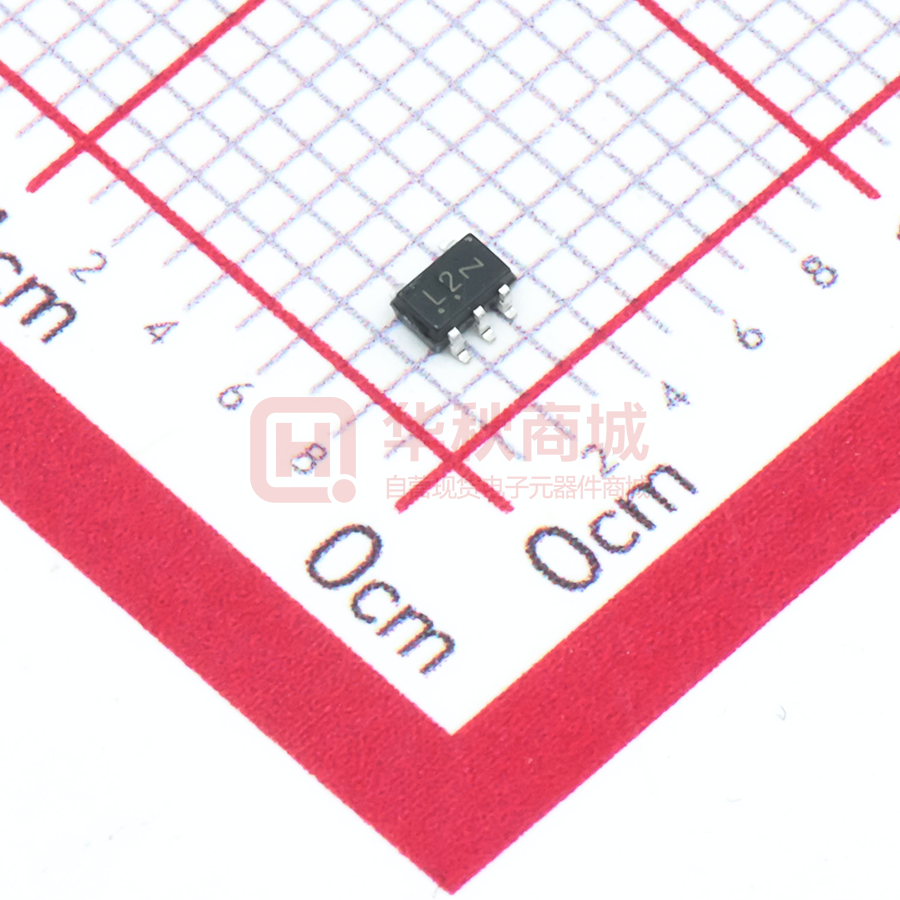

NL17SZ08DFT2G 数据手册
DATA SHEET www.onsemi.com Single 2-Input AND Gate MARKING DIAGRAMS NL17SZ08 The NL17SZ08 is a single 2−input AND Gate in tiny footprint packages. SC−88A DF SUFFIX CASE 419A XX MG G SC−74A DBV SUFFIX CASE 318BQ XXX MG G SOT−553 XV5 SUFFIX CASE 463B XX MG G SOT−953 P5 SUFFIX CASE 527AE XM Features • • • • • • • • • Designed for 1.65 V to 5.5 V VCC Operation 2.7 ns tPD at VCC = 5 V (typ) Inputs/Outputs Overvoltage Tolerant up to 5.5 V IOFF Supports Partial Power Down Protection Source/Sink 24 mA at 3.0 V Available in SC−88A, SC−74A, SOT−553, SOT−953 and UDFN6 Packages Chip Complexity < 100 FETs NLV Prefix for Automotive and Other Applications Requiring Unique Site and Control Change Requirements; AEC−Q100 Qualified and PPAP Capable These Devices are Pb−Free, Halogen Free/BFR Free and are RoHS Compliant A B & 1 UDFN6 1.45 x 1.0 CASE 517AQ 1 Y UDFN6 1.0 x 1.0 CASE 517BX Figure 1. Logic Symbol XX M G XM XM 1 = Specific Device Code = Date Code* = Pb−Free Package *Date Code orientation and/or position may vary depending upon manufacturing location. (Note: Microdot may be in either location) ORDERING INFORMATION See detailed ordering, marking and shipping information in the package dimensions section on page 7 of this data sheet. © Semiconductor Components Industries, LLC, 2011 May, 2022 − Rev. 27 1 Publication Order Number: NL17SZ08/D NL17SZ08 B VCC 1 5 A VCC A 5 1 B 1 6 VCC A 2 5 NC GND 3 4 Y GND 2 2 GND 4 3 Y B Y 4 3 SOT−953 (SC−88A/SOT−553/SC−74A) UDFN6 Figure 2. Pinout (Top View) PIN ASSIGNMENT (SC−88A/SOT−553/SC−74A) PIN ASSIGNMENT (SOT−953) PIN ASSIGNMENT (UDFN) Pin Function Pin Function Pin Function 1 B 1 A 1 B 2 A 2 GND 2 A 3 GND 3 B 3 GND 4 Y 4 Y 4 Y 5 VCC 5 VCC 5 NC 6 VCC FUNCTION TABLE Output Y = AB Input A B Y L L L L H L H L L H H H www.onsemi.com 2 NL17SZ08 MAXIMUM RATINGS Symbol Value Unit VCC DC Supply Voltage (NLV) −0.5 to +7.0 −0.5 to +6.5 V VIN DC Input Voltage (NLV) −0.5 to +7.0 −0.5 to +6.5 V V VOUT Characteristics DC Output Voltage (NLV) Active−Mode (High or Low State) Tri−State Mode (Note 1) Power−Down Mode (VCC = 0 V) −0.5 to VCC + 0.5 −0.5 to +7.0 −0.5 to +7.0 DC Output Voltage (NL17SZ08P5T5G−L22088 Only) −0.5 to VCC + 0.5 DC Output Voltage Active−Mode (High or Low State) Tri−State Mode (Note 1) Power−Down Mode (VCC = 0 V) −0.5 to VCC + 0.5 −0.5 to +6.5 −0.5 to +6.5 IIK DC Input Diode Current IOK IOUT ICC or IGND TSTG VIN < GND −50 mA DC Output Diode Current VOUT < GND −50 mA DC Output Diode Current (NL17SZ08P5T5G−L22088 Only) ±50 DC Output Source/Sink Current ±50 mA DC Supply Current per Supply Pin or Ground Pin ±100 mA −65 to +150 °C TL Storage Temperature Range Lead Temperature, 1 mm from Case for 10 secs 260 °C TJ Junction Temperature Under Bias +150 °C qJA Thermal Resistance (Note 2) SC−88A SC−74A SOT−553 SOT−953 UDFN6 377 320 324 254 154 °C/W PD Power Dissipation in Still Air SC−88A SC−74A SOT−553 SOT−953 UDFN6 332 390 386 491 812 mW Level 1 − MSL Moisture Sensitivity FR Flammability Rating Oxygen Index: 28 to 34 UL 94 V−0 @ 0.125 in − ESD Withstand Voltage (Note 3) Human Body Model Charged Device Model 2000 1000 V $100 mA VESD ILatchup Latchup Performance (Note 4) Stresses exceeding those listed in the Maximum Ratings table may damage the device. If any of these limits are exceeded, device functionality should not be assumed, damage may occur and reliability may be affected. 1. Applicable to devices with outputs that may be tri−stated. 2. Measured with minimum pad spacing on an FR4 board, using 10mm−by−1inch, 2 ounce copper trace no air flow per JESD51−7. 3. HBM tested to ANSI/ESDA/JEDEC JS−001−2017. CDM tested to EIA/JESD22−C101−F. JEDEC recommends that ESD qualification to EIA/JESD22−A115−A (Machine Model) be discontinued per JEDEC/JEP172A. 4. Tested to EIA/JESD78 Class II. www.onsemi.com 3 NL17SZ08 RECOMMENDED OPERATING CONDITIONS Symbol Characteristics VCC Positive DC Supply Voltage VIN DC Input Voltage VOUT TA tr , tf Min Max Unit 1.65 5.5 V 0 5.5 V DC Output Voltage Active−Mode (High or Low State) Tri−State Mode (Note 1) Power−Down Mode (VCC = 0 V) 0 0 0 VCC 5.5 5.5 V DC Output Voltage (NL17SZ08P5T5G−L22088 Only) 0 VCC Operating Temperature Range −55 +125 °C Input Rise and Fall Time (NLV) VCC = 3.0 V to 3.6 V VCC = 4.5 V to 5.5 V 0 0 100 20 ns/V Input Rise and Fall Time VCC = 1.65 V to 1.95 V VCC = 2.3 V to 2.7 V VCC = 3.0 V to 3.6 V VCC = 4.5 V to 5.5 V 0 0 0 0 20 20 10 5 Functional operation above the stresses listed in the Recommended Operating Ranges is not implied. Extended exposure to stresses beyond the Recommended Operating Ranges limits may affect device reliability. DC ELECTRICAL CHARACTERISTICS Symbol VIH VIL TA = 255C −555C 3 TA 3 1255C VCC (V) Min Typ Max Min Max Units High−Level Input Voltage (NLV) and NL17SZ08P5T5G−L22088 1.65 to 1.95 0.75 x VCC − − 0.75 x VCC − V 2.3 to 5.5 0.70 x VCC − − 0.70 x VCC − High−Level Input Voltage 1.65 to 1.95 0.65 x VCC − − 0.65 x VCC − 2.3 to 5.5 0.70 x VCC − − 0.70 x VCC − Low−Level Input Voltage (NLV) and NL17SZ08P5T5G−L22088 1.65 to 1.95 − − 0.25 x VCC − 0.25 x VCC 2.3 to 5.5 − − 0.30 x VCC − 0.30 x VCC Low−Level Input Voltage 1.65 to 1.95 − − 0.35 x VCC − 0.35 x VCC 2.3 to 5.5 − − 0.30 x VCC − 0.30 x VCC Parameter Condition V V V VOH High−Level Output Voltage VIN = VIH or VIL IOH = −100 mA IOH = −4 mA IOH = −8 mA IOH = −12 mA IOH = −16 mA IOH = −24 mA IOH = −32 mA 1.65 to 5.5 1.65 2.3 2.7 3.0 3.0 4.5 VCC − 0.1 1.29 1.9 2.2 2.4 2.3 3.8 VCC 1.4 2.1 2.4 2.7 2.5 4.0 − − − − − − − VCC − 0.1 1.29 1.9 2.2 2.4 2.3 3.8 − − − − − − − VOL Low−Level Output Voltage VIN = VIH or VIL IOL = 100 mA IOL = 4 mA IOL = 8 mA IOL = 12 mA IOL = 16 mA IOL = 24 mA IOL = 32 mA 1.65 to 5.5 1.65 2.3 2.7 3.0 3.0 4.5 − − − − − − − − 0.08 0.2 0.22 0.28 0.38 0.42 0.1 0.24 0.3 0.4 0.4 0.55 0.55 − − − − − − − 0.1 0.24 0.3 0.4 0.4 0.55 0.55 IIN Input Leakage Current VIN = 5.5 V or GND 1.65 to 5.5 − − ±0.1 − ±1.0 mA IOFF Power Off Leakage Current VIN = 5.5 V or VOUT = 5.5 V 0 − − 1.0 − 10 mA Power Off Leakage Current (NL17SZ08P5T5G− L22088 Only) VIN = 5.5 V 0 − − 1.0 − 10 mA Quiescent Supply Current VIN = VCC or GND 5.5 − − 1.0 − 10 mA ICC V V Product parametric performance is indicated in the Electrical Characteristics for the listed test conditions, unless otherwise noted. Product performance may not be indicated by the Electrical Characteristics if operated under different conditions. www.onsemi.com 4 NL17SZ08 AC ELECTRICAL CHARACTERISTICS Symbol tPLH, tPHL −555C 3 TA 3 1255C Min Typ Max Min Max Units RL = 1 MW, CL = 15 pF 1.65 to 1.95 − 6.3 12 − 12.7 ns RL = 1 MW, CL = 15 pF 2.3 to 2.7 − 3.4 7.0 − 7.5 RL = 1 MW, CL = 15 pF 3.0 to 3.6 − 2.6 4.7 − 5.0 − 3.3 5.2 − 5.5 − 2.2 4.1 − 4.4 − 2.7 4.5 − 4.8 Parameter Propagation Delay, A to Y (Figures 3 and 4) TA = 255C VCC (V) Condition RL = 500 W, CL = 50 pF 4.5 to 5.5 RL = 1 MW, CL = 15 pF RL = 500 W, CL = 50 pF CAPACITIVE CHARACTERISTICS Symbol CIN Parameter Condition Typical Units Input Capacitance VCC = 5.5 V, VIN = 0 V or VCC 2.5 pF COUT Output Capacitance VCC = 5.5 V, VIN = 0 V or VCC 2.5 pF CPD Power Dissipation Capacitance (Note 5) 10 MHz, VCC = 3.3 V, VIN = 0 V or VCC 10 MHz, VCC = 5.5 V, VIN = 0 V or VCC 9 11 pF 5. CPD is defined as the value of the internal equivalent capacitance which is calculated from the operating current consumption without load. Average operating current can be obtained by the equation: ICC(OPR) = CPD  VCC  fin + ICC. CPD is used to determine the no−load dynamic power consumption; PD = CPD  VCC2  fin + ICC  VCC. www.onsemi.com 5 NL17SZ08 OPEN 2 x VCC Test Switch Position tPLH / tPHL Open tPLZ / tPZL 2 x VCC 50 500 500 tPHZ / tPZH GND 50 500 500 GND R1 OUTPUT DUT RL RT CL, pF RL, W R1 , W See AC Characteristics Table X = Don’t Care CL * CL includes probe and jig capacitance RT is ZOUT of pulse generator (typically 50 W) f = 1 MHz Figure 3. Test Circuit tr = 3 ns tf = 3 ns 90% 90% Vmi INPUT Vmi INPUT Vmi 10% 10% tPHL Vmi GND GND tPZL tPLH Vmo OUTPUT VCC VCC tPLZ ~VCC VOH Vmo OUTPUT Vmo VOL + VY VOL VOL tPLH OUTPUT tPHL Vmo tPZH VOH Vmo tPHZ VOH VOH − VY Vmo OUTPUT VOL ~0 V Figure 4. Switching Waveforms Vmo, V VCC, V Vmi, V tPLH, tPHL 1.65 to 1.95 VCC/2 VCC/2 VCC/2 0.15 2.3 to 2.7 VCC/2 VCC/2 VCC/2 0.15 3.0 to 3.6 VCC/2 VCC/2 VCC/2 0.3 4.5 to 5.5 VCC/2 VCC/2 VCC/2 0.3 www.onsemi.com 6 tPZL, tPLZ, tPZH, tPHZ VY, V NL17SZ08 DEVICE ORDERING INFORMATION Packages Specific Device Code Pin 1 Orientation (See below) Shipping† NL17SZ08DFT2G SC−88A L2 Q4 3000 / Tape & Reel NLV17SZ08DFT2G* SC−88A L2 Q4 3000 / Tape & Reel NL17SZ08DFT2G−F22038** SC−88A L2 Q4 3000 / Tape & Reel NL17SZ08DBVT1G SC−74A AH Q4 3000 / Tape & Reel NL17SZ08XV5T2G SOT−553 L2 Q4 4000 / Tape & Reel NL17SZ08XV5T2G−L22087** SOT−553 L2 Q4 4000 / Tape & Reel NL17SZ08P5T5G SOT−953 E (Rotated 180° CW) Q2 8000 / Tape & Reel NL17SZ08P5T5G−L22088 SOT−953 E (Rotated 180° CW) Q2 8000 / Tape & Reel NL17SZ08MU1TCG UDFN6, 1.45 x 1.0, 0.5P D (Rotated 180° CW) Q4 3000 / Tape & Reel NL17SZ08MU3TCG UDFN6, 1.0 x 1.0, 0.35P P (Rotated 180° CW) Q4 3000 / Tape & Reel Device †For information on tape and reel specifications, including part orientation and tape sizes, please refer to our Tape and Reel Packaging Specifications Brochure, BRD8011/D. *NLV Prefix for Automotive and Other Applications Requiring Unique Site and Control Change Requirements; AEC−Q100 Qualified and PPAP Capable. ** Please refer to NLV specifications for this device. Pin 1 Orientation in Tape and Reel www.onsemi.com 7 MECHANICAL CASE OUTLINE PACKAGE DIMENSIONS SC−74A CASE 318BQ ISSUE B 5 1 SCALE 2:1 5X DATE 18 JAN 2018 b 0.20 C A B E1 5 M 4 1 2 E 3 B 0.05 A1 e D A L DETAIL A NOTES: 1. DIMENSIONING AND TOLERANCING PER ASME Y14.5M, 1994. 2. CONTROLLING DIMENSION: MILLIMETERS. 3. MAXIMUM LEAD THICKNESS INCLUDES LEAD FINISH THICKNESS. MINIMUM LEAD THICKNESS IS THE MINIMUM THICKNESS OF BASE MATERIAL. 4. DIMENSIONS A AND B DO NOT INCLUDE MOLD FLASH, PROTRUSIONS, OR GATE BURRS. MOLD FLASH, PROTRUSIONS, OR GATE BURRS SHALL NOT EXCEED 0.15 PER SIDE. DIM A A1 b c D E E1 e L M TOP VIEW A SIDE VIEW DETAIL A C c SEATING PLANE END VIEW RECOMMENDED SOLDERING FOOTPRINT* MILLIMETERS MIN MAX 0.90 1.10 0.01 0.10 0.25 0.50 0.10 0.26 2.85 3.15 2.50 3.00 1.35 1.65 0.95 BSC 0.20 0.60 0_ 10 _ GENERIC MARKING DIAGRAM* 0.95 PITCH XXX MG G XXX M G 2.40 = Specific Device Code = Date Code = Pb−Free Package (Note: Microdot may be in either location) 5X 1.00 *This information is generic. Please refer to device data sheet for actual part marking. Pb−Free indicator, “G” or microdot “ G”, may or may not be present. Some products may not follow the Generic Marking. 5X 0.70 DIMENSIONS: MILLIMETERS *For additional information on our Pb−Free strategy and soldering details, please download the ON Semiconductor Soldering and Mounting Techniques Reference Manual, SOLDERRM/D. DOCUMENT NUMBER: DESCRIPTION: 98AON66279G SC−74A Electronic versions are uncontrolled except when accessed directly from the Document Repository. Printed versions are uncontrolled except when stamped “CONTROLLED COPY” in red. PAGE 1 OF 1 ON Semiconductor and are trademarks of Semiconductor Components Industries, LLC dba ON Semiconductor or its subsidiaries in the United States and/or other countries. ON Semiconductor reserves the right to make changes without further notice to any products herein. ON Semiconductor makes no warranty, representation or guarantee regarding the suitability of its products for any particular purpose, nor does ON Semiconductor assume any liability arising out of the application or use of any product or circuit, and specifically disclaims any and all liability, including without limitation special, consequential or incidental damages. ON Semiconductor does not convey any license under its patent rights nor the rights of others. © Semiconductor Components Industries, LLC, 2018 www.onsemi.com MECHANICAL CASE OUTLINE PACKAGE DIMENSIONS SC−88A (SC−70−5/SOT−353) CASE 419A−02 ISSUE L SCALE 2:1 A NOTES: 1. DIMENSIONING AND TOLERANCING PER ANSI Y14.5M, 1982. 2. CONTROLLING DIMENSION: INCH. 3. 419A−01 OBSOLETE. NEW STANDARD 419A−02. 4. DIMENSIONS A AND B DO NOT INCLUDE MOLD FLASH, PROTRUSIONS, OR GATE BURRS. G 5 4 −B− S 1 2 DATE 17 JAN 2013 DIM A B C D G H J K N S 3 D 5 PL 0.2 (0.008) B M M N INCHES MIN MAX 0.071 0.087 0.045 0.053 0.031 0.043 0.004 0.012 0.026 BSC --0.004 0.004 0.010 0.004 0.012 0.008 REF 0.079 0.087 MILLIMETERS MIN MAX 1.80 2.20 1.15 1.35 0.80 1.10 0.10 0.30 0.65 BSC --0.10 0.10 0.25 0.10 0.30 0.20 REF 2.00 2.20 J GENERIC MARKING DIAGRAM* C K H XXXMG G SOLDER FOOTPRINT 0.50 0.0197 XXX = Specific Device Code M = Date Code G = Pb−Free Package 0.65 0.025 0.65 0.025 0.40 0.0157 1.9 0.0748 SCALE 20:1 (Note: Microdot may be in either location) *This information is generic. Please refer to device data sheet for actual part marking. Pb−Free indicator, “G” or microdot “G”, may or may not be present. Some products may not follow the Generic Marking. mm Ǔ ǒinches STYLE 1: PIN 1. BASE 2. EMITTER 3. BASE 4. COLLECTOR 5. COLLECTOR STYLE 2: PIN 1. ANODE 2. EMITTER 3. BASE 4. COLLECTOR 5. CATHODE STYLE 3: PIN 1. ANODE 1 2. N/C 3. ANODE 2 4. CATHODE 2 5. CATHODE 1 STYLE 4: PIN 1. SOURCE 1 2. DRAIN 1/2 3. SOURCE 1 4. GATE 1 5. GATE 2 STYLE 6: PIN 1. EMITTER 2 2. BASE 2 3. EMITTER 1 4. COLLECTOR 5. COLLECTOR 2/BASE 1 STYLE 7: PIN 1. BASE 2. EMITTER 3. BASE 4. COLLECTOR 5. COLLECTOR STYLE 8: PIN 1. CATHODE 2. COLLECTOR 3. N/C 4. BASE 5. EMITTER STYLE 9: PIN 1. ANODE 2. CATHODE 3. ANODE 4. ANODE 5. ANODE DOCUMENT NUMBER: DESCRIPTION: 98ASB42984B STYLE 5: PIN 1. CATHODE 2. COMMON ANODE 3. CATHODE 2 4. CATHODE 3 5. CATHODE 4 Note: Please refer to datasheet for style callout. If style type is not called out in the datasheet refer to the device datasheet pinout or pin assignment. Electronic versions are uncontrolled except when accessed directly from the Document Repository. Printed versions are uncontrolled except when stamped “CONTROLLED COPY” in red. SC−88A (SC−70−5/SOT−353) PAGE 1 OF 1 ON Semiconductor and are trademarks of Semiconductor Components Industries, LLC dba ON Semiconductor or its subsidiaries in the United States and/or other countries. ON Semiconductor reserves the right to make changes without further notice to any products herein. ON Semiconductor makes no warranty, representation or guarantee regarding the suitability of its products for any particular purpose, nor does ON Semiconductor assume any liability arising out of the application or use of any product or circuit, and specifically disclaims any and all liability, including without limitation special, consequential or incidental damages. ON Semiconductor does not convey any license under its patent rights nor the rights of others. © Semiconductor Components Industries, LLC, 2018 www.onsemi.com MECHANICAL CASE OUTLINE PACKAGE DIMENSIONS SOT−553, 5 LEAD CASE 463B ISSUE C SCALE 4:1 D −X− 5 A 4 1 2 3 b e NOTES: 1. DIMENSIONING AND TOLERANCING PER ANSI Y14.5M, 1982. 2. CONTROLLING DIMENSION: MILLIMETERS 3. MAXIMUM LEAD THICKNESS INCLUDES LEAD FINISH THICKNESS. MINIMUM LEAD THICKNESS IS THE MINIMUM THICKNESS OF BASE MATERIAL. L E −Y− DATE 20 MAR 2013 HE DIM A b c D E e L HE c 5 PL 0.08 (0.003) M X Y RECOMMENDED SOLDERING FOOTPRINT* INCHES NOM 0.022 0.009 0.005 0.063 0.047 0.020 BSC 0.004 0.008 0.061 0.063 MIN 0.020 0.007 0.003 0.061 0.045 MAX 0.024 0.011 0.007 0.065 0.049 0.012 0.065 GENERIC MARKING DIAGRAM* 0.3 0.0118 XXMG G 0.45 0.0177 XX = Specific Device Code M = Date Code G = Pb−Free Package (Note: Microdot may be in either location) 1.0 0.0394 1.35 0.0531 MILLIMETERS NOM MAX 0.55 0.60 0.22 0.27 0.13 0.18 1.60 1.65 1.20 1.25 0.50 BSC 0.10 0.20 0.30 1.55 1.60 1.65 MIN 0.50 0.17 0.08 1.55 1.15 *This information is generic. Please refer to device data sheet for actual part marking. Pb−Free indicator, “G” or microdot “ G”, may or may not be present. 0.5 0.5 0.0197 0.0197 SCALE 20:1 mm Ǔ ǒinches *For additional information on our Pb−Free strategy and soldering details, please download the ON Semiconductor Soldering and Mounting Techniques Reference Manual, SOLDERRM/D. STYLE 1: PIN 1. BASE 2. EMITTER 3. BASE 4. COLLECTOR 5. COLLECTOR STYLE 2: PIN 1. CATHODE 2. COMMON ANODE 3. CATHODE 2 4. CATHODE 3 5. CATHODE 4 STYLE 3: PIN 1. ANODE 1 2. N/C 3. ANODE 2 4. CATHODE 2 5. CATHODE 1 STYLE 4: PIN 1. SOURCE 1 2. DRAIN 1/2 3. SOURCE 1 4. GATE 1 5. GATE 2 STYLE 6: PIN 1. EMITTER 2 2. BASE 2 3. EMITTER 1 4. COLLECTOR 1 5. COLLECTOR 2/BASE 1 STYLE 7: PIN 1. BASE 2. EMITTER 3. BASE 4. COLLECTOR 5. COLLECTOR STYLE 8: PIN 1. CATHODE 2. COLLECTOR 3. N/C 4. BASE 5. EMITTER STYLE 9: PIN 1. ANODE 2. CATHODE 3. ANODE 4. ANODE 5. ANODE DOCUMENT NUMBER: STATUS: 98AON11127D ON SEMICONDUCTOR STANDARD 1 © Semiconductor Components Industries, LLC, 2002 January, 2002 − Rev. 01O NEW STANDARD: © Semiconductor Components Industries, LLC, 2002 October, DESCRIPTION: 2002 − Rev. 0 SOT−553, 5 LEAD http://onsemi.com 1 STYLE 5: PIN 1. ANODE 2. EMITTER 3. BASE 4. COLLECTOR 5. CATHODE Electronic versions are uncontrolled except when accessed directly from the Document Repository. Printed versions are uncontrolled exceptCase when stamped Outline Number: 463B “CONTROLLED COPY” in red. Case Outline Number: PAGE 1 OFXXX 2 DOCUMENT NUMBER: 98AON11127D PAGE 2 OF 2 ISSUE REVISION DATE A ADDED STYLES 3−9. REQ. BY D. BARLOW 11 NOV 2003 B ADDED NOMINAL VALUES AND UPDATED GENERIC MARKING DIAGRAM. REQ. BY HONG XIAO 27 MAY 2005 C UPDATED DIMENSIONS D, E, AND HE. REQ. BY J. LETTERMAN. 20 MAR 2013 ON Semiconductor and are registered trademarks of Semiconductor Components Industries, LLC (SCILLC). SCILLC reserves the right to make changes without further notice to any products herein. SCILLC makes no warranty, representation or guarantee regarding the suitability of its products for any particular purpose, nor does SCILLC assume any liability arising out of the application or use of any product or circuit, and specifically disclaims any and all liability, including without limitation special, consequential or incidental damages. “Typical” parameters which may be provided in SCILLC data sheets and/or specifications can and do vary in different applications and actual performance may vary over time. All operating parameters, including “Typicals” must be validated for each customer application by customer’s technical experts. SCILLC does not convey any license under its patent rights nor the rights of others. SCILLC products are not designed, intended, or authorized for use as components in systems intended for surgical implant into the body, or other applications intended to support or sustain life, or for any other application in which the failure of the SCILLC product could create a situation where personal injury or death may occur. Should Buyer purchase or use SCILLC products for any such unintended or unauthorized application, Buyer shall indemnify and hold SCILLC and its officers, employees, subsidiaries, affiliates, and distributors harmless against all claims, costs, damages, and expenses, and reasonable attorney fees arising out of, directly or indirectly, any claim of personal injury or death associated with such unintended or unauthorized use, even if such claim alleges that SCILLC was negligent regarding the design or manufacture of the part. SCILLC is an Equal Opportunity/Affirmative Action Employer. This literature is subject to all applicable copyright laws and is not for resale in any manner. © Semiconductor Components Industries, LLC, 2013 March, 2013 − Rev. C Case Outline Number: 463B MECHANICAL CASE OUTLINE PACKAGE DIMENSIONS UDFN6, 1.45x1.0, 0.5P CASE 517AQ ISSUE O 1 SCALE 4:1 A B D DATE 15 MAY 2008 L L NOTES: 1. DIMENSIONING AND TOLERANCING PER ASME Y14.5M, 1994. 2. CONTROLLING DIMENSION: MILLIMETERS. 3. DIMENSION b APPLIES TO PLATED TERMINAL AND IS MEASURED BETWEEN 0.15 AND 0.30 mm FROM THE TERMINAL TIP. L1 PIN ONE REFERENCE 0.10 C ÉÉÉ ÉÉÉ DETAIL A E OPTIONAL CONSTRUCTIONS ÉÉ ÉÉ EXPOSED Cu TOP VIEW 0.10 C DETAIL B MOLD CMPD DETAIL B 0.05 C 6X DIM A A1 A2 b D E e L L1 OPTIONAL CONSTRUCTIONS A MILLIMETERS MIN MAX 0.45 0.55 0.00 0.05 0.07 REF 0.20 0.30 1.45 BSC 1.00 BSC 0.50 BSC 0.30 0.40 −−− 0.15 MOUNTING FOOTPRINT 0.05 C A1 SIDE VIEW A2 e 6X C SEATING PLANE 6X 0.30 PACKAGE OUTLINE L 1.24 3 1 DETAIL A 6X 0.53 6 4 6X BOTTOM VIEW b 0.10 C A B 0.05 C NOTE 3 1 0.50 PITCH DIMENSIONS: MILLIMETERS *For additional information on our Pb−Free strategy and soldering details, please download the ON Semiconductor Soldering and Mounting Techniques Reference Manual, SOLDERRM/D. GENERIC MARKING DIAGRAM* XM X M = Specific Device Code = Date Code *This information is generic. Please refer to device data sheet for actual part marking. Pb−Free indicator, “G” or microdot “ G”, may or may not be present. DOCUMENT NUMBER: DESCRIPTION: 98AON30313E UDFN6, 1.45x1.0, 0.5P Electronic versions are uncontrolled except when accessed directly from the Document Repository. Printed versions are uncontrolled except when stamped “CONTROLLED COPY” in red. PAGE 1 OF 1 onsemi and are trademarks of Semiconductor Components Industries, LLC dba onsemi or its subsidiaries in the United States and/or other countries. onsemi reserves the right to make changes without further notice to any products herein. onsemi makes no warranty, representation or guarantee regarding the suitability of its products for any particular purpose, nor does onsemi assume any liability arising out of the application or use of any product or circuit, and specifically disclaims any and all liability, including without limitation special, consequential or incidental damages. onsemi does not convey any license under its patent rights nor the rights of others. © Semiconductor Components Industries, LLC, 2018 www.onsemi.com MECHANICAL CASE OUTLINE PACKAGE DIMENSIONS UDFN6, 1x1, 0.35P CASE 517BX ISSUE O SCALE 4:1 PIN ONE REFERENCE 2X 0.10 C 2X 0.10 C NOTES: 1. DIMENSIONING AND TOLERANCING PER ASME Y14.5M, 1994. 2. CONTROLLING DIMENSION: MILLIMETERS. 3. DIMENSION b APPLIES TO PLATED TERMINAL AND IS MEASURED BETWEEN 0.15 AND 0.20 MM FROM TERMINAL TIP. 4. PACKAGE DIMENSIONS EXCLUSIVE OF BURRS AND MOLD FLASH. A B D ÉÉ ÉÉ ÉÉ DATE 18 MAY 2011 E DIM A A1 A3 b D E e L L1 TOP VIEW A3 0.05 C A MILLIMETERS MIN MAX 0.45 0.55 0.00 0.05 0.13 REF 0.12 0.22 1.00 BSC 1.00 BSC 0.35 BSC 0.25 0.35 0.30 0.40 0.05 C SIDE VIEW A1 C SEATING PLANE RECOMMENDED SOLDERING FOOTPRINT* 5X e 5X 0.48 L 6X 0.22 3 1 L1 1.18 6 4 6X BOTTOM VIEW b 0.10 M C A B 0.05 M C NOTE 3 0.53 1 PKG OUTLINE 0.35 PITCH DIMENSIONS: MILLIMETERS *For additional information on our Pb−Free strategy and soldering details, please download the ON Semiconductor Soldering and Mounting Techniques Reference Manual, SOLDERRM/D. GENERIC MARKING DIAGRAM* XM 1 X = Specific Device Code M = Date Code *This information is generic. Please refer to device data sheet for actual part marking. Pb−Free indicator, “G” or microdot “G”, may or may not be present. Some products may not follow the Generic Marking. DOCUMENT NUMBER: DESCRIPTION: 98AON56787E UDFN6, 1x1, 0.35P Electronic versions are uncontrolled except when accessed directly from the Document Repository. Printed versions are uncontrolled except when stamped “CONTROLLED COPY” in red. PAGE 1 OF 1 onsemi and are trademarks of Semiconductor Components Industries, LLC dba onsemi or its subsidiaries in the United States and/or other countries. onsemi reserves the right to make changes without further notice to any products herein. onsemi makes no warranty, representation or guarantee regarding the suitability of its products for any particular purpose, nor does onsemi assume any liability arising out of the application or use of any product or circuit, and specifically disclaims any and all liability, including without limitation special, consequential or incidental damages. onsemi does not convey any license under its patent rights nor the rights of others. © Semiconductor Components Industries, LLC, 2018 www.onsemi.com MECHANICAL CASE OUTLINE PACKAGE DIMENSIONS SOT−953 CASE 527AE ISSUE E DATE 02 AUG 2011 SCALE 4:1 X Y D 5 PIN ONE INDICATOR A 4 HE E 1 2 3 NOTES: 1. DIMENSIONING AND TOLERANCING PER ASME Y14.5M, 1994. 2. CONTROLLING DIMENSION: MILLIMETERS 3. MAXIMUM LEAD THICKNESS INCLUDES LEAD FINISH. MINIMUM LEAD THICKNESS IS THE MINIMUM THICKNESS OF THE BASE MATERIAL. 4. DIMENSIONS D AND E DO NOT INCLUDE MOLD FLASH, PROTRUSIONS, OR GATE BURRS. DIM A b C D E e HE L L2 L3 C TOP VIEW SIDE VIEW e L 5X 5X L3 5X L2 MILLIMETERS MIN NOM MAX 0.34 0.37 0.40 0.10 0.15 0.20 0.07 0.12 0.17 0.95 1.00 1.05 0.75 0.80 0.85 0.35 BSC 0.95 1.00 1.05 0.175 REF 0.05 0.10 0.15 −−− −−− 0.15 GENERIC MARKING DIAGRAM* 5X BOTTOM VIEW XM b 1 0.08 X Y X M SOLDERING FOOTPRINT* *This information is generic. Please refer to device data sheet for actual part marking. Pb−Free indicator, “G” or microdot “ G”, may or may not be present. 5X 0.35 5X 0.20 = Specific Device Code = Month Code PACKAGE OUTLINE 1.20 1 0.35 PITCH DIMENSIONS: MILLIMETERS *For additional information on our Pb−Free strategy and soldering details, please download the ON Semiconductor Soldering and Mounting Techniques Reference Manual, SOLDERRM/D. DOCUMENT NUMBER: DESCRIPTION: 98AON26457D SOT−953 Electronic versions are uncontrolled except when accessed directly from the Document Repository. Printed versions are uncontrolled except when stamped “CONTROLLED COPY” in red. PAGE 1 OF 1 ON Semiconductor and are trademarks of Semiconductor Components Industries, LLC dba ON Semiconductor or its subsidiaries in the United States and/or other countries. ON Semiconductor reserves the right to make changes without further notice to any products herein. ON Semiconductor makes no warranty, representation or guarantee regarding the suitability of its products for any particular purpose, nor does ON Semiconductor assume any liability arising out of the application or use of any product or circuit, and specifically disclaims any and all liability, including without limitation special, consequential or incidental damages. ON Semiconductor does not convey any license under its patent rights nor the rights of others. © Semiconductor Components Industries, LLC, 2019 www.onsemi.com onsemi, , and other names, marks, and brands are registered and/or common law trademarks of Semiconductor Components Industries, LLC dba “onsemi” or its affiliates and/or subsidiaries in the United States and/or other countries. onsemi owns the rights to a number of patents, trademarks, copyrights, trade secrets, and other intellectual property. A listing of onsemi’s product/patent coverage may be accessed at www.onsemi.com/site/pdf/Patent−Marking.pdf. onsemi reserves the right to make changes at any time to any products or information herein, without notice. The information herein is provided “as−is” and onsemi makes no warranty, representation or guarantee regarding the accuracy of the information, product features, availability, functionality, or suitability of its products for any particular purpose, nor does onsemi assume any liability arising out of the application or use of any product or circuit, and specifically disclaims any and all liability, including without limitation special, consequential or incidental damages. Buyer is responsible for its products and applications using onsemi products, including compliance with all laws, regulations and safety requirements or standards, regardless of any support or applications information provided by onsemi. “Typical” parameters which may be provided in onsemi data sheets and/or specifications can and do vary in different applications and actual performance may vary over time. All operating parameters, including “Typicals” must be validated for each customer application by customer’s technical experts. onsemi does not convey any license under any of its intellectual property rights nor the rights of others. onsemi products are not designed, intended, or authorized for use as a critical component in life support systems or any FDA Class 3 medical devices or medical devices with a same or similar classification in a foreign jurisdiction or any devices intended for implantation in the human body. Should Buyer purchase or use onsemi products for any such unintended or unauthorized application, Buyer shall indemnify and hold onsemi and its officers, employees, subsidiaries, affiliates, and distributors harmless against all claims, costs, damages, and expenses, and reasonable attorney fees arising out of, directly or indirectly, any claim of personal injury or death associated with such unintended or unauthorized use, even if such claim alleges that onsemi was negligent regarding the design or manufacture of the part. onsemi is an Equal Opportunity/Affirmative Action Employer. This literature is subject to all applicable copyright laws and is not for resale in any manner. PUBLICATION ORDERING INFORMATION LITERATURE FULFILLMENT: Email Requests to: orderlit@onsemi.com onsemi Website: www.onsemi.com ◊ TECHNICAL SUPPORT North American Technical Support: Voice Mail: 1 800−282−9855 Toll Free USA/Canada Phone: 011 421 33 790 2910 Europe, Middle East and Africa Technical Support: Phone: 00421 33 790 2910 For additional information, please contact your local Sales Representative
