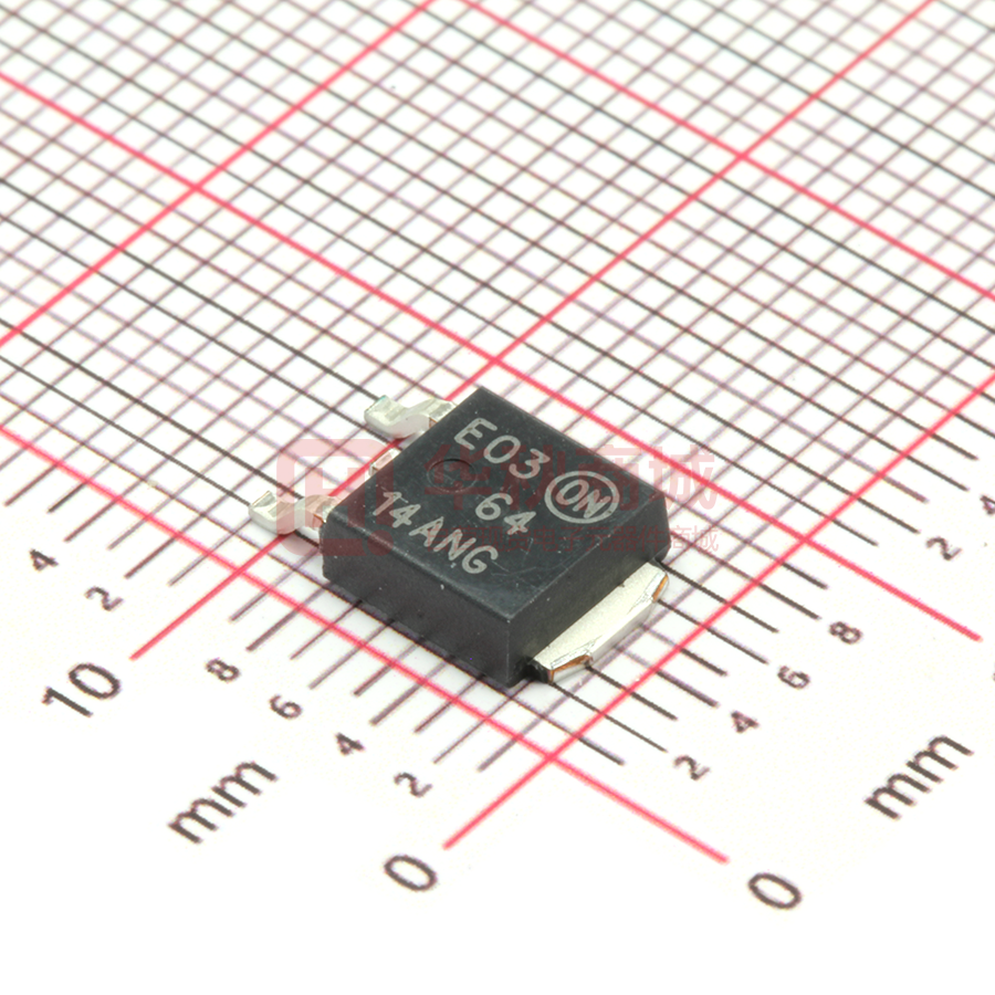

NTD6414AN N-Channel Power MOSFET 100 V, 32 A, 37 mW Features • • • • Low RDS(on) High Current Capability 100% Avalanche Tested These Devices are Pb−Free, Halogen Free/BFR Free and are RoHS Compliant http://onsemi.com ID MAX (Note 1) 32 A V(BR)DSS 100 V RDS(on) MAX 37 mW @ 10 V MAXIMUM RATINGS (TJ = 25°C unless otherwise noted) Parameter Drain−to−Source Voltage Gate−to−Source Voltage − Continuous Continuous Drain Current RqJC Power Dissipation RqJC Pulsed Drain Current Steady State Steady State TC = 25°C TC = 100°C TC = 25°C PD IDM TJ, Tstg IS EAS Symbol VDSS VGS ID Value 100 $20 32 22 100 117 −55 to +175 32 154 W Unit V V A N−Channel D G A °C A mJ 12 4 1 3 S 4 tp = 10 ms Operating and Storage Temperature Range Source Current (Body Diode) Single Pulse Drain−to−Source Avalanche Energy (VDD = 50 Vdc, VGS = 10 Vdc, IL(pk) = 32 A, L = 0.3 mH, RG = 25 W) Lead Temperature for Soldering Purposes, 1/8″ from Case for 10 Seconds TL 260 °C THERMAL RESISTANCE RATINGS Parameter Junction−to−Case (Drain) Steady State Junction−to−Ambient (Note 1) Symbol RqJC RqJA Max 1.5 37 Unit °C/W DPAK CASE 369AA STYLE 2 3 IPAK CASE 369D STYLE 2 2 YWW 64 14ANG 1 Gate 2 Drain 3 Source YWW 64 14ANG 1 Gate 2 Drain 3 Source Publication Order Number: NTD6414AN/D Stresses exceeding Maximum Ratings may damage the device. Maximum Ratings are stress ratings only. Functional operation above the Recommended Operating Conditions is not implied. Extended exposure to stresses above the Recommended Operating Conditions may affect device reliability. 1. Surface mounted on FR4 board using 1 sq in pad size, (Cu Area 1.127 sq in [1 oz] including traces). MARKING DIAGRAM & PIN ASSIGNMENTS 4 Drain 4 Drain 6414AN Y WW G = Device Code = Year = Work Week = Pb−Free Package ORDERING INFORMATION See detailed ordering and shipping information in the package dimensions section on page 5 of this data sheet. © Semiconductor Components Industries, LLC, 2009 November, 2009 − Rev. 0 1 NTD6414AN ELECTRICAL CHARACTERISTICS (TJ = 25°C unless otherwise noted) Parameter OFF CHARACTERISTICS Drain−to−Source Breakdown Voltage Drain−to−Source Breakdown Voltage Temperature Coefficient Zero Gate Voltage Drain Current Gate−to−Source Leakage Current ON CHARACTERISTICS (Note 3) Gate Threshold Voltage Negative Threshold Temperature Coefficient Drain−to−Source On−Resistance Forward Transconductance Input Capacitance Output Capacitance Reverse Transfer Capacitance Total Gate Charge Threshold Gate Charge Gate−to−Source Charge Gate−to−Drain Charge Plateau Voltage Gate Resistance SWITCHING CHARACTERISTICS (Note 4) Turn−On Delay Time Rise Time Turn−Off Delay Time Fall Time Forward Diode Voltage Reverse Recovery Time Charge Time Discharge Time Reverse Recovery Charge td(on) tr td(off) tf VSD tRR Ta Tb QRR VGS = 0 V, dIS/dt = 100 A/ms, IS = 32 A TJ = 25°C TJ = 125°C VGS = 10 V, VDD = 80 V, ID = 32 A, RG = 6.1 W 11 52 38 48 0.87 0.76 68 51 16 195 nC ns 1.2 V ns VGS(TH) VGS(TH)/TJ RDS(on) gFS CISS COSS CRSS QG(TOT) QG(TH) QGS QGD VGP RG VGS = 10 V, VDS = 80 V, ID = 32 A VGS = 0 V, f = 1.0 MHz, VDS = 25 V VGS = 10 V, ID = 32 A VGS = 5.0 V, ID = 10 A VGS = VDS, ID = 250 mA 2.0 8.3 30 18 1450 230 95 40 1.7 8.0 20 5.9 1.9 V W nC 37 4.0 V mV/°C mW S pF V(BR)DSS V(BR)DSS/TJ IDSS IGSS VGS = 0 V, VDS = 100 V TJ = 25°C TJ = 125°C VGS = 0 V, ID = 250 mA 100 107 1.0 100 "100 nA V mV/°C mA Symbol Test Condition Min Typ Max Unit VDS = 0 V, VGS = "20 V CHARGES, CAPACITANCES AND GATE RESISTANCE DRAIN−SOURCE DIODE CHARACTERISTICS VGS = 0 V, IS = 32 A 2. Surface mounted on FR4 board using 1 in sq pad size (Cu area = 1.127 in sq [1 oz] including traces). 3. Pulse Test: Pulse Width ≤ 300 ms, Duty Cycle ≤ 2%. 4. Switching characteristics are independent of operating junction temperatures. http://onsemi.com 2 NTD6414AN TYPICAL CHARACTERISTICS 70 60 ID, DRAIN CURRENT (A) 50 40 30 20 5.0 V 10 0 0 1 2 3 4 4.5 V 5 5.5 V 70 6.5 V ID, DRAIN CURRENT (A) 60 50 40 30 20 10 0 TJ = −55°C 2 3 4 5 6 7 8 VGS, GATE−TO−SOURCE VOLTAGE (V) TJ = 125°C TJ = 25°C VDS w 10 V TJ = 25°C 10 V 7.5 V 6.0 V VDS, DRAIN−TO−SOURCE VOLTAGE (V) Figure 1. On−Region Characteristics 0.07 0.06 0.05 0.04 0.03 0.02 ID = 32 A TJ = 25°C RDS(on), DRAIN−TO−SOURCE RESISTANCE (W) RDS(on), DRAIN−TO−SOURCE RESISTANCE (W) 0.10 Figure 2. Transfer Characteristics VGS = 10 V 0.08 0.06 0.04 0.02 TJ = −55°C 0.00 10 15 20 25 30 35 TJ = 175°C TJ = 125°C TJ = 25°C 5 6 7 8 9 10 VGS, GATE−TO−SOURCE VOLTAGE (V) ID, DRAIN CURRENT (A) Figure 3. On−Region versus Gate Voltage Figure 4. On−Resistance versus Drain Current and Gate Voltage 10000 3 RDS(on), DRAIN−TO−SOURCE RESISTANCE (NORMALIZED) 2.5 2 ID = 32 A VGS = 10 V VGS = 0 V TJ = 150°C IDSS, LEAKAGE (nA) 1000 1.5 1 100 TJ = 125°C 0.5 −50 −25 0 25 50 75 100 125 150 175 10 10 20 30 40 50 60 70 80 90 100 Figure 5. On−Resistance Variation with Temperature TJ, JUNCTION TEMPERATURE (°C) Figure 6. Drain−to−Source Leakage Current versus Voltage VDS, DRAIN−TO−SOURCE VOLTAGE (V) http://onsemi.com 3 NTD6414AN TYPICAL CHARACTERISTICS 10 8 6 4 2 0 ID = 32 A TJ = 25°C 0 5 10 15 20 25 30 Qg, TOTAL GATE CHARGE (nC) 35 Qgs VGS, GATE−TO−SOURCE VOLTAGE (V) 2400 C, CAPACITANCE (pF) 2000 1600 1200 800 400 0 Crss 0 Coss Ciss TJ = 25°C VGS = 0 V QT VDS Qgd VGS 100 80 60 40 20 0 40 20 40 60 80 VDS, DRAIN−TO−SOURCE VOLTAGE (V) 100 Figure 7. Capacitance Variation 1000 Figure 8. Gate−to−Source Voltage and Drain−to−Source Voltage versus Total Charge 35 IS, SOURCE CURRENT (A) 30 25 20 15 10 5 0 0.4 0.5 0.6 0.7 0.8 VSD, SOURCE−TO−DRAIN VOLTAGE (V) 0.9 TJ = 25°C VGS = 0 V VDS = 80 V ID = 32 A VGS = 10 V tr tf td(off) t, TIME (ns) 100 10 td(on) 1 1 10 RG, GATE RESISTANCE (W) 100 Figure 9. Resistive Switching Time Variation versus Gate Resistance Figure 10. Diode Forward Voltage versus Current 100 AVALANCHE ENERGY (mJ) 10 ms ID, DRAIN CURRENT (A) 10 100 ms 1 ms VGS = 10 V SINGLE PULSE TC = 25°C RDS(on) LIMIT THERMAL LIMIT PACKAGE LIMIT 1 10 100 VDS, DRAIN−TO−SOURCE VOLTAGE (V) 1000 10 ms dc 160 140 120 100 80 60 40 20 0 25 50 75 100 125 150 TJ, STARTING JUNCTION TEMPERATURE 175 ID = 32 A 1 0.1 Figure 11. Maximum Rated Forward Biased Safe Operating Area Figure 12. Maximum Avalanche Energy versus Starting Junction Temperature http://onsemi.com 4 VDS, DRAIN−TO−SOURCE VOLTAGE (V) 2800 NTD6414AN TYPICAL CHARACTERISTICS 10 1 D = 0.5 R(t) (°C/W) 0.2 0.1 0.1 0.05 0.02 0.01 0.01 SINGLE PULSE 0.001 0.000001 0.00001 0.0001 0.001 0.01 t, PULSE TIME (s) 0.1 1 10 Figure 13. Thermal Response ORDERING INFORMATION Device NTD6414ANT4G NTD6414AN−1G Package DPAK (Pb−Free) IPAK (Pb−Free) Shipping† 2500 / Tape & Reel 75 Units / Rail †For information on tape and reel specifications, including part orientation and tape sizes, please refer to our Tape and Reel Packaging Specification Brochure, BRD8011/D. http://onsemi.com 5 NTD6414AN PACKAGE DIMENSIONS DPAK CASE 369AA−01 ISSUE A −T− B V R 4 SEATING PLANE C E NOTES: 1. DIMENSIONING AND TOLERANCING PER ANSI Y14.5M, 1982. 2. CONTROLLING DIMENSION: INCH. INCHES MIN MAX 0.235 0.245 0.250 0.265 0.086 0.094 0.025 0.035 0.018 0.024 0.030 0.045 0.386 0.410 0.018 0.023 0.090 BSC 0.180 0.215 0.024 0.040 0.020 −−− 0.035 0.050 0.155 −−− MILLIMETERS MIN MAX 5.97 6.22 6.35 6.73 2.19 2.38 0.63 0.89 0.46 0.61 0.77 1.14 9.80 10.40 0.46 0.58 2.29 BSC 4.57 5.45 0.60 1.01 0.51 −−− 0.89 1.27 3.93 −−− S A 1 2 3 Z H U F L D 2 PL J DIM A B C D E F H J L R S U V Z 0.13 (0.005) M T STYLE 2: PIN 1. GATE 2. DRAIN 3. SOURCE 4. DRAIN SOLDERING FOOTPRINT* 6.20 0.244 3.0 0.118 2.58 0.101 5.80 0.228 1.6 0.063 6.172 0.243 SCALE 3:1 mm inches *For additional information on our Pb−Free strategy and soldering details, please download the ON Semiconductor Soldering and Mounting Techniques Reference Manual, SOLDERRM/D. http://onsemi.com 6 NTD6414AN PACKAGE DIMENSIONS DPAK CASE 369D−01 ISSUE B B V R 4 C E Z NOTES: 1. DIMENSIONING AND TOLERANCING PER ANSI Y14.5M, 1982. 2. CONTROLLING DIMENSION: INCH. DIM A B C D E F G H J K R S V Z INCHES MIN MAX 0.235 0.245 0.250 0.265 0.086 0.094 0.027 0.035 0.018 0.023 0.037 0.045 0.090 BSC 0.034 0.040 0.018 0.023 0.350 0.380 0.180 0.215 0.025 0.040 0.035 0.050 0.155 −−− MILLIMETERS MIN MAX 5.97 6.35 6.35 6.73 2.19 2.38 0.69 0.88 0.46 0.58 0.94 1.14 2.29 BSC 0.87 1.01 0.46 0.58 8.89 9.65 4.45 5.45 0.63 1.01 0.89 1.27 3.93 −−− S −T− SEATING PLANE A 1 2 3 K F D G 3 PL J H M 0.13 (0.005) T STYLE 2: PIN 1. GATE 2. DRAIN 3. SOURCE 4. DRAIN ON Semiconductor and are registered trademarks of Semiconductor Components Industries, LLC (SCILLC). SCILLC reserves the right to make changes without further notice to any products herein. SCILLC makes no warranty, representation or guarantee regarding the suitability of its products for any particular purpose, nor does SCILLC assume any liability arising out of the application or use of any product or circuit, and specifically disclaims any and all liability, including without limitation special, consequential or incidental damages. “Typical” parameters which may be provided in SCILLC data sheets and/or specifications can and do vary in different applications and actual performance may vary over time. All operating parameters, including “Typicals” must be validated for each customer application by customer’s technical experts. SCILLC does not convey any license under its patent rights nor the rights of others. SCILLC products are not designed, intended, or authorized for use as components in systems intended for surgical implant into the body, or other applications intended to support or sustain life, or for any other application in which the failure of the SCILLC product could create a situation where personal injury or death may occur. Should Buyer purchase or use SCILLC products for any such unintended or unauthorized application, Buyer shall indemnify and hold SCILLC and its officers, employees, subsidiaries, affiliates, and distributors harmless against all claims, costs, damages, and expenses, and reasonable attorney fees arising out of, directly or indirectly, any claim of personal injury or death associated with such unintended or unauthorized use, even if such claim alleges that SCILLC was negligent regarding the design or manufacture of the part. SCILLC is an Equal Opportunity/Affirmative Action Employer. This literature is subject to all applicable copyright laws and is not for resale in any manner. PUBLICATION ORDERING INFORMATION LITERATURE FULFILLMENT: Literature Distribution Center for ON Semiconductor P.O. Box 5163, Denver, Colorado 80217 USA Phone: 303−675−2175 or 800−344−3860 Toll Free USA/Canada Fax: 303−675−2176 or 800−344−3867 Toll Free USA/Canada Email: orderlit@onsemi.com N. American Technical Support: 800−282−9855 Toll Free USA/Canada Europe, Middle East and Africa Technical Support: Phone: 421 33 790 2910 Japan Customer Focus Center Phone: 81−3−5773−3850 ON Semiconductor Website: www.onsemi.com Order Literature: http://www.onsemi.com/orderlit For additional information, please contact your local Sales Representative http://onsemi.com 7 NTD6414AN/D
NTD6414ANT4G
物料型号: - 型号为NTD6414AN。
器件简介: - NTD6414AN是一款N沟道功率MOSFET,具有100V、32A的电性参数,以及低导通电阻和高电流能力。该器件经过100%雪崩测试,并且符合RoHS标准,无铅、无卤素/BFR。
引脚分配: - 引脚1:栅极(Gate) - 引脚2:漏极(Drain) - 引脚3:源极(Source) - 引脚4:漏极(Drain)焊接垫
参数特性: - 最大漏源电压(V(BR)DSS):100V - 最大导通电阻(RDs(on) MAX):37mΩ @ 10V - 最大漏极电流(ID MAX):32A - 工作和存储温度范围:-55至+175℃ - 雪崩能量(EAS):154mJ
功能详解: - 该MOSFET具备低导通电阻和高电流能力,适用于需要高效率和高功率容量的应用场合。器件还经过雪崩测试,确保了在极端条件下的可靠性。
应用信息: - 适用于需要高电压和大电流的应用,如电源管理、电机控制和电动汽车等领域。
封装信息: - 提供DPAK和IPAK两种封装方式,均为无铅封装。 - DPAK封装的型号为NTD6414ANT4G,IPAK封装的型号为NTD6414AN-1G。
