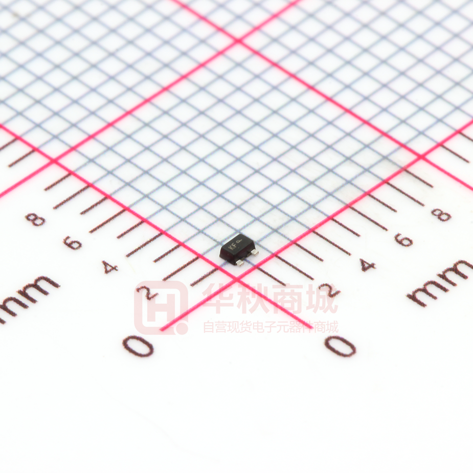

    类型:N沟道 漏源电压(Vdss):20V 连续漏极电流(Id):890mA 功率(Pd):310mW 导通电阻(RDS(on)@Vgs,Id):350mΩ@4.5V,890mA 阈值电压(Vgs(t...
NTK3134NT1G 数据手册
NTK3134N Power MOSFET 20 V, 890 mA, Single N−Channel with ESD Protection, SOT−723 Features • • • • • • • • • http://onsemi.com V(BR)DSS RDS(on) TYP 0.20 W @ 4.5 V 20 V 0.26 W @ 2.5 V 0.42 W @ 1.8 V 0.62 W @ 1.5 V ID Max 890 mA 790 mA 700 mA 200 mA N channel Switch with Low RDS(on) 44% Smaller Footprint and 38% Thinner than SC89 Low Threshold Levels Allowing 1.5 V RDS(on) Rating Operated at Low Logic Level Gate Drive These are Pb−Free Devices Applications Load/Power Switching Interface Switching Logic Level Shift Battery Management for Ultra Small Portable Electronics MAXIMUM RATINGS (TJ = 25°C unless otherwise stated) Parameter Drain−to−Source Voltage Gate−to−Source Voltage Continuous Drain Current (Note 1) Steady State t≤5s Power Dissipation (Note 1) Steady State t≤5s Continuous Drain Current (Note 2) Power Dissipation (Note 2) Pulsed Drain Current tp = 10 ms Steady State TA = 25°C TA = 85°C TA = 25°C PD IDM TJ, TSTG TL ID TA = 25°C TA = 85°C TA = 25°C TA = 25°C PD Symbol VDSS VGS ID Value 20 ±6 890 640 990 450 550 750 540 310 1.8 −55 to 150 260 mW A °C °C mA mW Unit V V mA SOT−723 (3−LEAD) 3 1 Top View 2 1 − Gate 2 − Source 3 − Drain MARKING DIAGRAM KF M SOT−723 CASE 631AA STYLE 5 1 KF M = Specific Device Code = Date Code Operating Junction and Storage Temperature Lead Temperature for Soldering Purposes (1/8” from case for 10 s) ORDERING INFORMATION Device NTK3134NT1G NTK3134NT5G Package SOT−723* SOT−723* Shipping † 4000 / Tape & Reel 8000 / Tape & Reel Stresses exceeding Maximum Ratings may damage the device. Maximum Ratings are stress ratings only. Functional operation above the Recommended Operating Conditions is not implied. Extended exposure to stresses above the Recommended Operating Conditions may affect device reliability. 1. Surface mounted on FR4 board using 1 in sq pad size (Cu area = 1.127 in sq [1 oz] including traces) 2. Surface mounted on FR4 board using the minimum recommended pad size †For information on tape and reel specifications, including part orientation and tape sizes, please refer to our Tape and Reel Packaging Specification Brochure, BRD8011/D. *These packages are inherently Pb−Free. © Semiconductor Components Industries, LLC, 2006 1 December, 2006 − Rev. 0 Publication Order Number: NTK3134N/D NTK3134N THERMAL RESISTANCE RATINGS Parameter Junction−to−Ambient – Steady State (Note 3) Junction−to−Ambient – t = 5 s (Note 3) Junction−to−Ambient – Steady State Minimum Pad (Note 4) Symbol RqJA RqJA RqJA Max 280 228 400 Unit °C/W 3. Surface mounted on FR4 board using 1 in sq pad size (Cu area = 1.127 in sq [1 oz] including traces) 4. Surface mounted on FR4 board using the minimum recommended pad size MOSFET ELECTRICAL CHARACTERISTICS (TJ = 25°C unless otherwise specified) Parameter OFF CHARACTERISTICS Drain−to−Source Breakdown Voltage Drain−to−Source Breakdown Voltage Temperature Coefficient Zero Gate Voltage Drain Current V(BR)DSS V(BR)DSS/TJ IDSS VGS = 0 V, ID = 250 mA ID = 250 mA, Reference to 25°C VGS = 0 V, VDS = 16 V TJ = 25°C TJ = 125°C 20 18 1.0 2.0 ±0.5 mA V mV/°C mA Symbol Test Condition Min Typ Max Unit Gate−to−Source Leakage Current ON CHARACTERISTICS (Note 5) Gate Threshold Voltage Negative Threshold Temperature Coefficient Drain−to−Source On Resistance IGSS VDS = 0 V, VGS = ±4.5 V VGS(TH) VGS(TH)/TJ RDS(on) VGS = VDS, ID = 250 mA 0.45 2.4 1.2 V mV/°C VGS = 4.5 V, ID = 890 mA VGS = 2.5 V, ID = 780 mA VGS = 1.8 V, ID = 700 mA VGS = 1.5 V, ID = 200 mA 0.20 0.26 0.43 0.56 1.6 0.35 0.45 0.65 1.2 W Forward Transconductance gFS VDS = 10 V, ID = 800 mA S CHARGES, CAPACITANCES AND GATE RESISTANCE Input Capacitance Output Capacitance Reverse Transfer Capacitance CISS COSS CRSS VGS = 0 V, f = 1 MHz, VDS = 16 V 79 13 9.0 120 20 15 pF SWITCHING CHARACTERISTICS, VGS = 4.5 V (Note 6) Turn On Delay Time Rise Time TurnOff Delay Time Fall Time td(ON) tr td(OFF) tf VGS = 4.5 V, VDS = 10 V, ID = 500 mA, RG = 10 W 6.7 4.8 17.3 7.4 ns DRAIN SOURCE DIODE CHARACTERISTICS Forward Diode Voltage Reverse Recovery Time Charge Time Discharge Time Reverse Recovery Charge VSD tRR ta tb QRR VGS = 0 V, IS = 350 mA TJ = 25°C 0.75 8.1 6.4 1.7 3.0 nC 1.2 V ns VGS = 0 V, dISD/dt = 100 A/ms, IS = 1.0 A, VDD = 20 V 5. Pulse Test: pulse width = 300 ms, duty cycle = 2% 6. Switching characteristics are independent of operating junction temperatures http://onsemi.com 2 NTK3134N TYPICAL CHARACTERISTICS 2.0 2.0 V ID, DRAIN CURRENT (A) ID, DRAIN CURRENT (A) VGS = 4.5 V to 2.2 V 1.5 1.8 V 1.0 TJ = 25°C 1.6 V 0.5 1.5 V 1.4 V 0 0 0.5 1 1.5 2 2.5 3 3.5 4 4.5 5 5.5 6 VDS, DRAIN−TO−SOURCE VOLTAGE (V) 0 0.75 1.0 1.25 VDS ≥ 5 V 1.5 2.0 1.0 TJ = 25°C 0.5 TJ = 125°C TJ = −55°C 1.5 1.75 2.0 VGS, GATE−TO−SOURCE VOLTAGE (V) Figure 1. On−Region Characteristics RDS(on), DRAIN−TO−SOURCE RESISTANCE (W) 1.50 1.25 1.00 0.75 0.50 0.25 0 1 1.5 2 2.5 3 3.5 4 4.5 5 5.5 6 VGS, GATE VOLTAGE (V) ID = 0.89 A TJ = 25°C RDS(on), DRAIN−TO−SOURCE RESISTANCE (W) 0.30 Figure 2. Transfer Characteristics TJ = 25°C 0.28 0.25 0.23 0.20 0.18 0.15 0.3 0.6 0.8 1.1 1.3 1.6 1.8 ID, DRAIN CURRENT (A) VGS = 4.5 V VGS = 2.5 V Figure 3. On−Resistance vs. Gate−to−Source Voltage RDS(on), DRAIN−TO−SOURCE RESISTANCE (W) 10,000 0.6 0.5 VGS = 1.8 V, ID = 710 mA 0.4 0.3 0.2 0.1 −60 −35 VGS = 4.5 V, ID = 1 A −10 15 40 65 90 115 140 10 VGS = 2.5 V, ID = 710 mA VGS = 1.5 V, ID = 200 mA IDSS, LEAKAGE (nA) Figure 4. On−Resistance vs. Drain Current and Gate Voltage VGS = 0 V 1000 TJ = 150°C TJ = 125°C 100 5.0 10 15 20 TJ, JUNCTION TEMPERATURE (°C) VDS, DRAIN−TO−SOURCE VOLTAGE (V) Figure 5. On−Resistance Variation with Temperature Figure 6. Drain−to−Source Leakage Current vs. Voltage http://onsemi.com 3 NTK3134N TYPICAL CHARACTERISTICS 140 120 C, CAPACITANCE (pF) 100 80 60 40 Coss 20 Crss 0 0 2 4 6 8 10 12 14 16 18 20 DRAIN−TO−SOURCE VOLTAGE (V) 1 1 10 RG, GATE RESISTANCE (W) 100 Ciss t, TIME (ns) td(off) 10 td(on) tr tf VGS = 0 V TJ = 25°C 100 VDD = 10 V ID = 500 mA VGS = 4.5 V Figure 7. Capacitance Variation 1.0 0.9 IS, SOURCE CURRENT (A) 0.8 0.7 0.6 0.5 0.4 0.3 0.2 0.1 0 0.3 0.4 0.5 0.6 0.7 VGS = 0 V Figure 8. Resistive Switching Time Variation vs. Gate Resistance 150°C 125°C 25°C TJ = −55°C 0.8 0.9 1.0 VSD, SOURCE−TO−DRAIN VOLTAGE (V) Figure 9. Diode Forward Voltage vs. Current http://onsemi.com 4 NTK3134N PACKAGE DIMENSIONS SOT−723 CASE 631AA−01 ISSUE C NOTES: 1. DIMENSIONING AND TOLERANCING PER ANSI Y14.5M, 1982. 2. CONTROLLING DIMENSION: MILLIMETERS. 3. MAXIMUM LEAD THICKNESS INCLUDES LEAD FINISH. MINIMUM LEAD THICKNESS IS THE MINIMUM THICKNESS OF BASE MATERIAL. 4. DIMENSIONS D AND E DO NOT INCLUDE MOLD FLASH, PROTRUSIONS OR GATE BURRS. −X− D b1 −Y− 3 A E 1 2 L C HE DIM A b b1 C D E e HE L e b 2X 0.08 (0.0032) X Y MILLIMETERS MIN NOM MAX 0.45 0.50 0.55 0.15 0.21 0.27 0.25 0.31 0.37 0.07 0.12 0.17 1.15 1.20 1.25 0.75 0.80 0.85 0.40 BSC 1.15 1.20 1.25 0.15 0.20 0.25 INCHES MIN NOM MAX 0.018 0.020 0.022 0.0059 0.0083 0.0106 0.010 0.012 0.015 0.0028 0.0047 0.0067 0.045 0.047 0.049 0.03 0.032 0.034 0.016 BSC 0.045 0.047 0.049 0.0059 0.0079 0.0098 STYLE 5: PIN 1. GATE 2. SOURCE 3. DRAIN SOLDERING FOOTPRINT* 0.40 0.0157 0.40 0.0157 1.0 0.039 0.40 0.0157 0.40 0.0157 0.40 0.0157 SCALE 20:1 mm inches *For additional information on our Pb−Free strategy and soldering details, please download the ON Semiconductor Soldering and Mounting Techniques Reference Manual, SOLDERRM/D. ON Semiconductor and are registered trademarks of Semiconductor Components Industries, LLC (SCILLC). SCILLC reserves the right to make changes without further notice to any products herein. SCILLC makes no warranty, representation or guarantee regarding the suitability of its products for any particular purpose, nor does SCILLC assume any liability arising out of the application or use of any product or circuit, and specifically disclaims any and all liability, including without limitation special, consequential or incidental damages. “Typical” parameters which may be provided in SCILLC data sheets and/or specifications can and do vary in different applications and actual performance may vary over time. All operating parameters, including “Typicals” must be validated for each customer application by customer’s technical experts. SCILLC does not convey any license under its patent rights nor the rights of others. SCILLC products are not designed, intended, or authorized for use as components in systems intended for surgical implant into the body, or other applications intended to support or sustain life, or for any other application in which the failure of the SCILLC product could create a situation where personal injury or death may occur. Should Buyer purchase or use SCILLC products for any such unintended or unauthorized application, Buyer shall indemnify and hold SCILLC and its officers, employees, subsidiaries, affiliates, and distributors harmless against all claims, costs, damages, and expenses, and reasonable attorney fees arising out of, directly or indirectly, any claim of personal injury or death associated with such unintended or unauthorized use, even if such claim alleges that SCILLC was negligent regarding the design or manufacture of the part. SCILLC is an Equal Opportunity/Affirmative Action Employer. This literature is subject to all applicable copyright laws and is not for resale in any manner. PUBLICATION ORDERING INFORMATION LITERATURE FULFILLMENT: Literature Distribution Center for ON Semiconductor P.O. Box 5163, Denver, Colorado 80217 USA Phone: 303−675−2175 or 800−344−3860 Toll Free USA/Canada Fax: 303−675−2176 or 800−344−3867 Toll Free USA/Canada Email: orderlit@onsemi.com N. American Technical Support: 800−282−9855 Toll Free USA/Canada Europe, Middle East and Africa Technical Support: Phone: 421 33 790 2910 Japan Customer Focus Center Phone: 81−3−5773−3850 ON Semiconductor Website: www.onsemi.com Order Literature: http://www.onsemi.com/orderlit For additional information, please contact your local Sales Representative http://onsemi.com 5 NTK3134N/D
