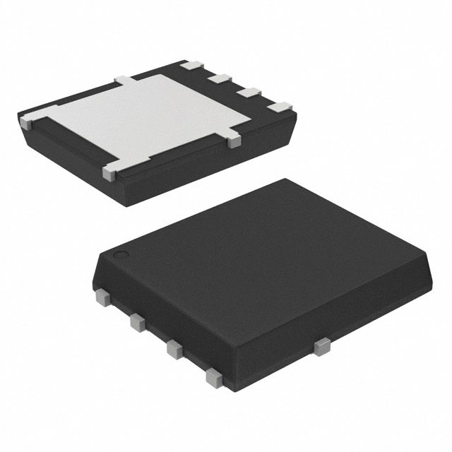

NTMFS4C022NT3G 数据手册
MOSFET – Power, Single, N-Channel, SO-8FL 30 V, 1.7 mW, 136 A NTMFS4C022N Features • • • • Small Footprint (5x6 mm) for Compact Design Low RDS(on) to Minimize Conduction Losses Low QG and Capacitance to Minimize Driver Losses These Devices are Pb−Free, Halogen Free/BFR Free and are RoHS Compliant www.onsemi.com V(BR)DSS RDS(ON) MAX ID MAX 1.7 mW @ 10 V 30 V 136 A 2.4 mW @ 4.5 V MAXIMUM RATINGS (TJ = 25°C unless otherwise noted) Symbol Value Unit Drain−to−Source Voltage VDSS 30 V Gate−to−Source Voltage VGS "20 V TC = 25°C ID 136 A TC = 25°C PD 64 W TA = 25°C ID 30 A TA = 25°C PD 3.1 W Parameter Continuous Drain Current RqJC (Notes 1, 3) Power Dissipation RqJC (Notes 1, 3) Continuous Drain Current RqJA (Notes 1, 2, 3) Power Dissipation RqJA (Notes 1, 2, 3) Pulsed Drain Current Steady State Steady State TA = 25°C, tp = 10 ms Operating Junction and Storage Temperature Source Current (Body Diode) D (5,6) G (4) IDM 352 A TJ, Tstg −55 to 150 °C S (1,2,3) N−CHANNEL MOSFET MARKING DIAGRAM D 1 IS 53 A Single Pulse Drain−to−Source Avalanche Energy (IL(pk) = 11 A) EAS 549 mJ Lead Temperature for Soldering Purposes (1/8″ from case for 10 s) TL 260 °C Stresses exceeding those listed in the Maximum Ratings table may damage the device. If any of these limits are exceeded, device functionality should not be assumed, damage may occur and reliability may be affected. SO−8 FLAT LEAD CASE 488AA STYLE 1 A Y W ZZ S S S G D 4C022 AYWZZ D D = Assembly Location = Year = Work Week = Lot Traceability THERMAL RESISTANCE MAXIMUM RATINGS (Note 1) Symbol Value Unit Junction−to−Case − Steady State (Note 2) RqJC 1.95 °C/W Junction−to−Ambient − Steady State (Note 2) RqJA 40 Parameter 1. The entire application environment impacts the thermal resistance values shown, they are not constants and are only valid for the particular conditions noted. 2. Surface−mounted on FR4 board using a 650 mm2, 2 oz. Cu pad. 3. Maximum current for pulses as long as 1 second is higher but is dependent on pulse duration and duty cycle. © Semiconductor Components Industries, LLC, 2016 November, 2019− Rev. 3 1 ORDERING INFORMATION Device Package Shipping† NTMFS4C022NT1G SO−8FL (Pb−Free) 1500 / Tape & Reel NTMFS4C022NT3G SO−8FL (Pb−Free) 5000 / Tape & Reel †For information on tape and reel specifications, including part orientation and tape sizes, please refer to our Tape and Reel Packaging Specifications Brochure, BRD8011/D. Publication Order Number: NTMFS4C022N/D NTMFS4C022N ELECTRICAL CHARACTERISTICS (TJ = 25°C unless otherwise specified) Parameter Symbol Test Condition Min Drain−to−Source Breakdown Voltage V(BR)DSS VGS = 0 V, ID = 250 mA 30 Drain−to−Source Breakdown Voltage Temperature Coefficient V(BR)DSS/ TJ Typ Max Unit OFF CHARACTERISTICS Zero Gate Voltage Drain Current Gate−to−Source Leakage Current IDSS V 18.2 VGS = 0 V, VDS = 24 V mV/°C TJ = 25 °C 1 TJ = 125°C 10 IGSS VDS = 0 V, VGS = 20 V VGS(TH) VGS = VDS, ID = 250 mA 100 mA nA ON CHARACTERISTICS (Note 4) Gate Threshold Voltage Negative Threshold Temperature Coefficient Drain−to−Source On Resistance VGS(TH)/TJ RDS(on) 1.3 2.2 4.8 V mV/°C VGS = 10 V ID = 30 A 1.4 1.7 VGS = 4.5 V ID = 30 A 2.0 2.4 mW Forward Transconductance gFS VDS = 3 V, ID = 30 A 136 S Gate Resistance RG TA = 25 °C 1.0 W CHARGES AND CAPACITANCES Input Capacitance CISS Output Capacitance COSS Reverse Transfer Capacitance CRSS 67 Total Gate Charge QG(TOT) 20.8 Threshold Gate Charge QG(TH) Gate−to−Source Charge QGS Gate−to−Drain Charge QGD Total Gate Charge 3071 VGS = 0 V, f = 1 MHz, VDS = 15 V VGS = 4.5 V, VDS = 15 V; ID = 30 A 1673 pF 4.9 nC 8.5 4.7 QG(TOT) VGS = 10 V, VDS = 15 V, ID = 30 A 45.2 nC SWITCHING CHARACTERISTICS (Note 5) Turn−On Delay Time Rise Time Turn−Off Delay Time Fall Time td(ON) 14 tr td(OFF) VGS = 4.5 V, VDS = 15 V, ID = 15 A, RG = 3.0 W tf 32 ns 27 17 DRAIN−SOURCE DIODE CHARACTERISTICS Forward Diode Voltage Reverse Recovery Time VSD TJ = 25°C 0.75 TJ = 125°C 0.6 tRR Charge Time ta Discharge Time tb Reverse Recovery Charge VGS = 0 V, IS = 10 A 1.1 V 47 VGS = 0 V, dIS/dt = 100 A/ms, IS = 30 A QRR 23 ns 24 39 nC Product parametric performance is indicated in the Electrical Characteristics for the listed test conditions, unless otherwise noted. Product performance may not be indicated by the Electrical Characteristics if operated under different conditions. 4. Pulse Test: pulse width v 300 ms, duty cycle v 2%. 5. Switching characteristics are independent of operating junction temperatures. www.onsemi.com 2 NTMFS4C022N TYPICAL CHARACTERISTICS 250 250 4.5 V 200 ID, DRAIN CURRENT (A) 3.4 V VGS = 10 V 150 3.2 V 125 100 3.0 V 75 50 2.8 V 25 2.6 V 0.0 0.5 1.0 1.5 2.0 2.5 125 100 75 TJ = 150°C 50 TJ = 25°C TJ = −55°C 25 0 3.0 1.5 2 2.5 3 3.5 4 Figure 2. Transfer Characteristics TJ = 25°C 2.6 2.4 2.2 2.0 1.8 1.6 4 5 6 7 8 9 VGS, GATE−TO−SOURCE VOLTAGE (V) 4.5 3.0 TJ = 25°C 2.8 2.6 2.4 VGS = 4.5 V 2.2 2.0 1.8 1.6 1.4 10 VGS = 10 V 0 25 50 75 100 125 150 175 200 225 250 ID, DRAIN CURRENT (A) Figure 3. On−Resistance vs. VGS Figure 4. On−Resistance vs. Drain Current and Gate Voltage 1.8 10000 VGS = 0 V ID = 30 A VGS = 10 V IDSS, LEAKAGE (nA) RDS(on), DRAIN−TO−SOURCE RESISTANCE (NORMALIZED) 150 Figure 1. On−Region Characteristics 2.8 1.6 175 VGS, GATE−TO−SOURCE VOLTAGE (V) ID = 30 A 3 200 VDS, DRAIN−TO−SOURCE VOLTAGE (V) 3.0 1.4 VDS = 3 V 225 3.6 V 175 0 RDS(on), DRAIN−TO−SOURCE RESISTANCE (mW) TJ = 25°C 3.8 V RDS(on), DRAIN−TO−SOURCE RESISTANCE (mW) ID, DRAIN CURRENT (A) 225 1.4 1.2 1.0 TJ = 125°C 1000 TJ = 100°C TJ = 85°C 100 0.8 0.6 −50 −25 0 25 50 75 100 125 150 10 0 5 10 15 20 25 TJ, JUNCTION TEMPERATURE (°C) VDS, DRAIN−TO−SOURCE VOLTAGE (V) Figure 5. On−Resistance Variation with Temperature Figure 6. Drain−to−Source Leakage Current vs. Voltage www.onsemi.com 3 30 NTMFS4C022N TYPICAL CHARACTERISTICS C, CAPACITANCE (pF) Ciss Coss 1000 100 10 Crss VGS = 0 V TJ = 25°C f = 1 MHz 0.1 1 10 100 QT 10 15 9 8 7 VDS 6 12 VGS 9 5 4 Qgs 3 Qgd TJ = 25°C VDS = 15 V ID = 30 A 2 1 0 5 10 15 20 25 30 35 40 45 VDS, DRAIN−TO−SOURCE VOLTAGE (V) Qg, TOTAL GATE CHARGE (nC) Figure 7. Capacitance Variation Figure 8. Gate−to−Source and Drain−to−Source Voltage vs. Total Charge 6 3 0 50 1000.0 VDD = 15 V ID = 15 A VGS = 4.5 V td(off) 100 tf tr td(on) 0.1 1 10 IS, SOURCE CURRENT (A) VGS = 0 V 100 100.0 TJ = 150°C 10.0 TJ = 25°C 1.0 0.1 TJ = −55°C 0.3 0.4 0.5 0.6 0.7 0.8 0.9 1.0 RG, GATE RESISTANCE (W) VSD, SOURCE−TO−DRAIN VOLTAGE (V) Figure 9. Resistive Switching Time Variation vs. Gate Resistance Figure 10. Diode Forward Voltage vs. Current 1000 ID, DRAIN CURRENT (A) t, TIME (ns) 18 11 0 1000 10 12 VDS, DRAIN−TO−SOURCE VOLTAGE (V) VGS, GATE−TO−SOURCE VOLTAGE (V) 10000 1 ms 100 10 ms 10 ms 10 VGS ≤ 10 V TC = 25°C 100 ms RDS(on) Limit Thermal Limit Package Limit 1 0.1 1 10 VDS, DRAIN−TO−SOURCE VOLTAGE (V) Figure 11. Maximum Rated Forward Biased Safe Operating Area www.onsemi.com 4 100 NTMFS4C022N TYPICAL CHARACTERISTICS RqJA Steady State = 40°C/W Duty Cycle = 50% 10 20% 10% 5% 1 2% 1% PCB Cu Area = 650 mm2 PCB Cu Thk = 2 oz 0.1 0.01 0.001 1E−06 Single Pulse 1E−05 1E−04 1E−03 1E−02 1E−01 1E+00 PULSE TIME (sec) Figure 12. Thermal Impedance (Junction−to−Ambient) 100 IPEAK, (A) R(t) (°C/W) 100 TJ(initial) = 25°C 10 TJ(initial) = 100°C 1 1.00E−04 1.00E−03 TIME IN AVALANCHE (s) Figure 13. Avalanche Characteristics www.onsemi.com 5 1.00E−02 1E+01 1E+02 1E+03 MECHANICAL CASE OUTLINE PACKAGE DIMENSIONS DFN5 5x6, 1.27P (SO−8FL) CASE 488AA ISSUE N 1 DATE 25 JUN 2018 SCALE 2:1 2X NOTES: 1. DIMENSIONING AND TOLERANCING PER ASME Y14.5M, 1994. 2. CONTROLLING DIMENSION: MILLIMETER. 3. DIMENSION D1 AND E1 DO NOT INCLUDE MOLD FLASH PROTRUSIONS OR GATE BURRS. 0.20 C D A 2 B D1 2X 0.20 C 4X E1 2 q E c 1 2 3 A1 4 TOP VIEW C DETAIL A 0.10 C SEATING PLANE A 0.10 C SIDE VIEW MILLIMETERS MIN NOM MAX 0.90 1.00 1.10 0.00 −−− 0.05 0.33 0.41 0.51 0.23 0.28 0.33 5.00 5.15 5.30 4.70 4.90 5.10 3.80 4.00 4.20 6.00 6.30 6.15 5.70 5.90 6.10 3.45 3.65 3.85 1.27 BSC 0.51 0.575 0.71 1.20 1.35 1.50 0.51 0.575 0.71 0.125 REF 3.00 3.40 3.80 0_ −−− 12 _ DIM A A1 b c D D1 D2 E E1 E2 e G K L L1 M q GENERIC MARKING DIAGRAM* DETAIL A 1 0.10 b C A B 0.05 c 8X XXXXXX AYWZZ e/2 e L 1 4 K RECOMMENDED SOLDERING FOOTPRINT* E2 PIN 5 (EXPOSED PAD) L1 M 2X 0.495 4.560 2X 1.530 G D2 2X BOTTOM VIEW XXXXXX = Specific Device Code A = Assembly Location Y = Year W = Work Week ZZ = Lot Traceability *This information is generic. Please refer to device data sheet for actual part marking. Pb−Free indicator, “G” or microdot “ G”, may or may not be present. Some products may not follow the Generic Marking. 0.475 3.200 4.530 STYLE 1: PIN 1. SOURCE 2. SOURCE 3. SOURCE 4. GATE 5. DRAIN 1.330 STYLE 2: 2X PIN 1. ANODE 0.905 2. ANODE 3. ANODE 4. NO CONNECT 0.965 5. CATHODE 1 4X 1.000 4X 0.750 1.270 PITCH DIMENSIONS: MILLIMETERS *For additional information on our Pb−Free strategy and soldering details, please download the ON Semiconductor Soldering and Mounting Techniques Reference Manual, SOLDERRM/D. DOCUMENT NUMBER: DESCRIPTION: 98AON14036D DFN5 5x6, 1.27P (SO−8FL) Electronic versions are uncontrolled except when accessed directly from the Document Repository. Printed versions are uncontrolled except when stamped “CONTROLLED COPY” in red. PAGE 1 OF 1 ON Semiconductor and are trademarks of Semiconductor Components Industries, LLC dba ON Semiconductor or its subsidiaries in the United States and/or other countries. ON Semiconductor reserves the right to make changes without further notice to any products herein. ON Semiconductor makes no warranty, representation or guarantee regarding the suitability of its products for any particular purpose, nor does ON Semiconductor assume any liability arising out of the application or use of any product or circuit, and specifically disclaims any and all liability, including without limitation special, consequential or incidental damages. ON Semiconductor does not convey any license under its patent rights nor the rights of others. © Semiconductor Components Industries, LLC, 2018 www.onsemi.com onsemi, , and other names, marks, and brands are registered and/or common law trademarks of Semiconductor Components Industries, LLC dba “onsemi” or its affiliates and/or subsidiaries in the United States and/or other countries. onsemi owns the rights to a number of patents, trademarks, copyrights, trade secrets, and other intellectual property. A listing of onsemi’s product/patent coverage may be accessed at www.onsemi.com/site/pdf/Patent−Marking.pdf. onsemi reserves the right to make changes at any time to any products or information herein, without notice. The information herein is provided “as−is” and onsemi makes no warranty, representation or guarantee regarding the accuracy of the information, product features, availability, functionality, or suitability of its products for any particular purpose, nor does onsemi assume any liability arising out of the application or use of any product or circuit, and specifically disclaims any and all liability, including without limitation special, consequential or incidental damages. Buyer is responsible for its products and applications using onsemi products, including compliance with all laws, regulations and safety requirements or standards, regardless of any support or applications information provided by onsemi. “Typical” parameters which may be provided in onsemi data sheets and/or specifications can and do vary in different applications and actual performance may vary over time. All operating parameters, including “Typicals” must be validated for each customer application by customer’s technical experts. onsemi does not convey any license under any of its intellectual property rights nor the rights of others. onsemi products are not designed, intended, or authorized for use as a critical component in life support systems or any FDA Class 3 medical devices or medical devices with a same or similar classification in a foreign jurisdiction or any devices intended for implantation in the human body. Should Buyer purchase or use onsemi products for any such unintended or unauthorized application, Buyer shall indemnify and hold onsemi and its officers, employees, subsidiaries, affiliates, and distributors harmless against all claims, costs, damages, and expenses, and reasonable attorney fees arising out of, directly or indirectly, any claim of personal injury or death associated with such unintended or unauthorized use, even if such claim alleges that onsemi was negligent regarding the design or manufacture of the part. onsemi is an Equal Opportunity/Affirmative Action Employer. This literature is subject to all applicable copyright laws and is not for resale in any manner. PUBLICATION ORDERING INFORMATION LITERATURE FULFILLMENT: Email Requests to: orderlit@onsemi.com onsemi Website: www.onsemi.com ◊ TECHNICAL SUPPORT North American Technical Support: Voice Mail: 1 800−282−9855 Toll Free USA/Canada Phone: 011 421 33 790 2910 Europe, Middle East and Africa Technical Support: Phone: 00421 33 790 2910 For additional information, please contact your local Sales Representative
