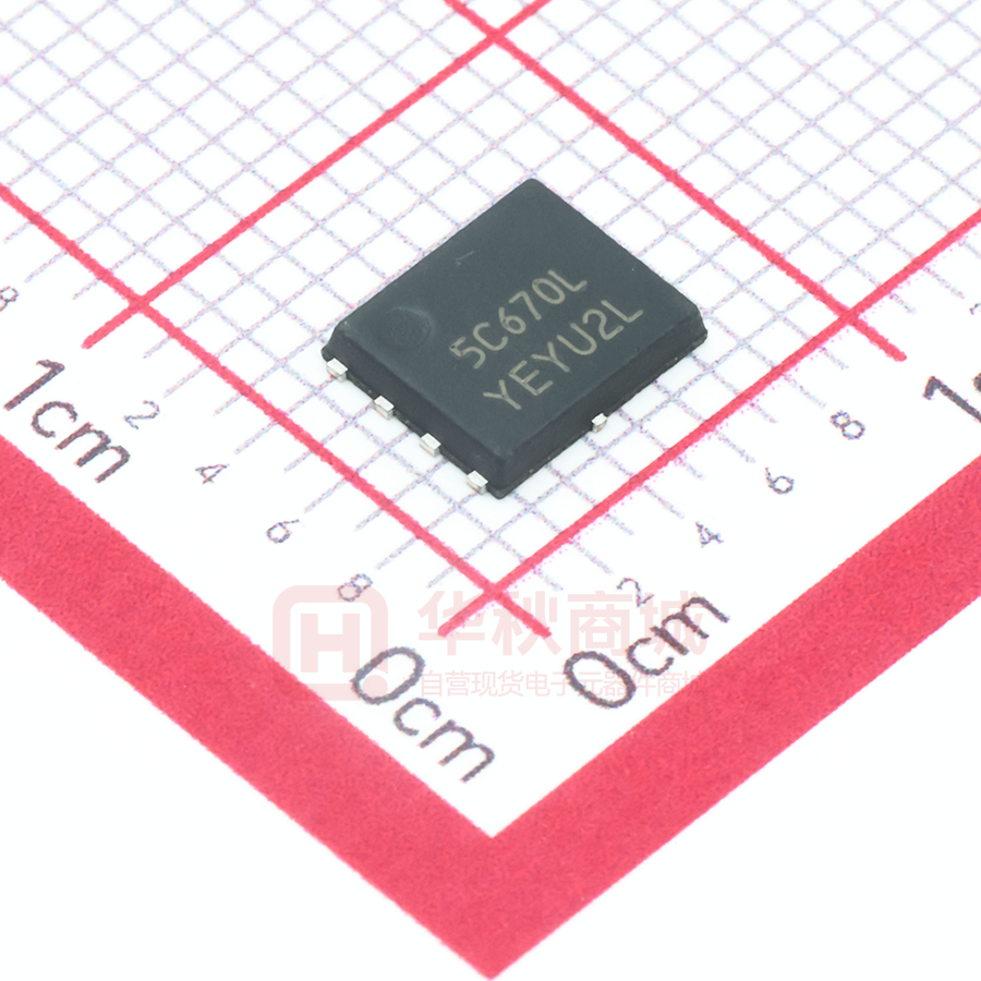

NTMFS5C670NL MOSFET – Power, Single, N-Channel 60 V, 6.1 mW, 71 A Features • • • • www.onsemi.com Small Footprint (5x6 mm) for Compact Design Low RDS(on) to Minimize Conduction Losses Low QG and Capacitance to Minimize Driver Losses These Devices are Pb−Free and are RoHS Compliant V(BR)DSS RDS(ON) MAX 6.1 mW @ 10 V 60 V Symbol Value Unit VDSS 60 V Gate−to−Source Voltage VGS ±20 V ID 71 A Parameter Continuous Drain Current RqJC (Notes 1, 3) TC = 25°C Power Dissipation RqJC (Note 1) Continuous Drain Current RqJA (Notes 1, 2, 3) Steady State TC = 100°C TC = 25°C Pulsed Drain Current PD TC = 100°C TA = 25°C Power Dissipation RqJA (Notes 1 & 2) 50 Steady State TA = 100°C TA = 25°C G (4) W 61 S (1,2,3) A 17 PD W 3.6 440 A TJ, Tstg −55 to +175 °C IS 68 A Single Pulse Drain−to−Source Avalanche Energy (IL(pk) = 3.6 A) EAS 166 mJ Lead Temperature for Soldering Purposes (1/8″ from case for 10 s) TL 260 Source Current (Body Diode) °C Stresses exceeding those listed in the Maximum Ratings table may damage the device. If any of these limits are exceeded, device functionality should not be assumed, damage may occur and reliability may be affected. THERMAL RESISTANCE MAXIMUM RATINGS Parameter MARKING DIAGRAM 1.8 IDM Operating Junction and Storage Temperature N−CHANNEL MOSFET 12 TA = 100°C TA = 25°C, tp = 10 ms D (5) 31 ID 71 A 8.8 mW @ 4.5 V MAXIMUM RATINGS (TJ = 25°C unless otherwise noted) Drain−to−Source Voltage ID MAX 1 DFN5 (SO−8FL) CASE 488AA STYLE 1 5C670L A Y W ZZ D S S S G D 5C670L AYWZZ D D = Specific Device Code = Assembly Location = Year = Work Week = Lot Traceability ORDERING INFORMATION Symbol Value Unit Junction−to−Case − Steady State RqJC 2.4 °C/W Junction−to−Ambient − Steady State (Note 2) RqJA 41 See detailed ordering, marking and shipping information on page 5 of this data sheet. 1. The entire application environment impacts the thermal resistance values shown, they are not constants and are only valid for the particular conditions noted. 2. Surface−mounted on FR4 board using a 650 mm2, 2 oz. Cu pad. 3. Maximum current for pulses as long as 1 second is higher but is dependent on pulse duration and duty cycle. © Semiconductor Components Industries, LLC, 2016 May, 2019 − Rev. 1 1 Publication Order Number: NTMFS5C670NL/D NTMFS5C670NL ELECTRICAL CHARACTERISTICS (TJ = 25°C unless otherwise specified) Parameter Symbol Test Condition Min Drain−to−Source Breakdown Voltage V(BR)DSS VGS = 0 V, ID = 250 mA 60 Drain−to−Source Breakdown Voltage Temperature Coefficient V(BR)DSS/ TJ Typ Max Unit OFF CHARACTERISTICS Zero Gate Voltage Drain Current IDSS Gate−to−Source Leakage Current V 27 VGS = 0 V, VDS = 60 V mV/°C TJ = 25 °C 10 TJ = 125°C 250 IGSS VDS = 0 V, VGS = 20 V VGS(TH) VGS = VDS, ID = 53 mA 100 mA nA ON CHARACTERISTICS (Note 4) Gate Threshold Voltage Threshold Temperature Coefficient VGS(TH)/TJ Drain−to−Source On Resistance Forward Transconductance RDS(on) 1.2 2.0 −4.7 VGS = 10 V ID = 35 A 5.1 6.1 VGS = 4.5 V ID = 35 A 7.0 8.8 gFS VDS = 15 V, ID = 35 A V mV/°C 82 mW S CHARGES AND CAPACITANCES Input Capacitance CISS Output Capacitance COSS Reverse Transfer Capacitance CRSS 1400 VGS = 0 V, f = 1 MHz, VDS = 25 V 640 pF 15 Total Gate Charge QG(TOT) VGS = 4.5 V, VDS = 30 V; ID = 35 A 9.0 Total Gate Charge QG(TOT) VGS = 10 V, VDS = 30 V; ID = 35 A 20 Threshold Gate Charge QG(TH) Gate−to−Source Charge QGS Gate−to−Drain Charge QGD Plateau Voltage VGP 3.1 td(ON) 11 2.5 VGS = 10 V, VDS = 30 V; ID = 35 A nC 4.5 2.0 V SWITCHING CHARACTERISTICS (Note 5) Turn−On Delay Time Rise Time Turn−Off Delay Time Fall Time tr td(OFF) VGS = 4.5 V, VDS = 30 V, ID = 35 A, RG = 2.5 W tf 60 ns 15 4 DRAIN−SOURCE DIODE CHARACTERISTICS Forward Diode Voltage Reverse Recovery Time Charge Time Discharge Time Reverse Recovery Charge VSD VGS = 0 V, IS = 35 A TJ = 25°C 0.9 TJ = 125°C 0.8 tRR ta tb 1.2 V 34 VGS = 0 V, dIS/dt = 100 A/ms, IS = 35 A QRR 17 ns 17 19 nC Product parametric performance is indicated in the Electrical Characteristics for the listed test conditions, unless otherwise noted. Product performance may not be indicated by the Electrical Characteristics if operated under different conditions. 4. Pulse Test: pulse width v 300 ms, duty cycle v 2%. 5. Switching characteristics are independent of operating junction temperatures. www.onsemi.com 2 NTMFS5C670NL TYPICAL CHARACTERISTICS 3.8 V 100 80 3.4 V 60 40 3.0 V 20 RDS(on), DRAIN−TO−SOURCE RESISTANCE (mW) 0 0.5 1.0 1.5 2.0 2.5 3.0 3.5 60 TJ = 25°C 40 4.0 TJ = 125°C 0 0.5 1.0 1.5 2.0 TJ = −55°C 2.5 3.0 3.5 VDS, DRAIN−TO−SOURCE VOLTAGE (V) VGS, GATE−TO−SOURCE VOLTAGE (V) Figure 1. On−Region Characteristics Figure 2. Transfer Characteristics 14 TJ = 25°C ID = 35 A 13 12 11 10 9 8 7 6 3.5 80 0 15 5 100 20 2.6 V 0 VDS = 5 V 120 RDS(on), DRAIN−TO−SOURCE RESISTANCE (mW) ID, DRAIN CURRENT (A) 120 140 4.5 V 6.5 V to 10 V ID, DRAIN CURRENT (A) 140 4.5 5.5 6.5 7.5 8.5 9.5 VGS, GATE VOLTAGE (V) 4.0 10 TJ = 25°C 9 8 VGS = 4.5 V 7 6 VGS = 10 V 5 4 5 15 25 35 45 55 65 75 ID, DRAIN CURRENT (A) Figure 3. On−Resistance vs. Gate−to−Source Voltage Figure 4. On−Resistance vs. Drain Current and Gate Voltage 100000 1.8 VGS = 10 V ID = 35 A TJ = 175°C IDSS, LEAKAGE (nA) RDS(on), NORMALIZED DRAIN−TO− SOURCE RESISTANCE 2.0 1.6 1.4 1.2 1.0 10000 TJ = 125°C 1000 TJ = 85°C 100 0.8 0.6 −50 −25 0 25 50 75 100 125 150 175 10 10 20 30 40 50 TJ, JUNCTION TEMPERATURE (°C) VDS, DRAIN−TO−SOURCE VOLTAGE (V) Figure 5. On−Resistance Variation with Temperature Figure 6. Drain−to−Source Leakage Current vs. Voltage www.onsemi.com 3 60 NTMFS5C670NL TYPICAL CHARACTERISTICS VGS, GATE−TO−SOURCE VOLTAGE (V) C, CAPACITANCE (pF) 10000 CISS 1000 COSS 100 CRSS 10 1 VGS = 0 V TJ = 25°C f = 1 MHz 0 10 20 30 40 50 60 10 QT 9 8 7 6 5 4 QGD QGS 3 VDS = 30 V TJ = 25°C ID = 35 A 2 1 0 0 2 4 6 8 10 12 14 16 18 VDS, DRAIN−TO−SOURCE VOLTAGE (V) QG, TOTAL GATE CHARGE (nC) Figure 7. Capacitance Variation Figure 8. Gate−to−Source and Drain−to−Source Voltage vs. Total Charge 20 t, TIME (ns) 100 IS, SOURCE CURRENT (A) 1000 tr td(on) td(off) 10 VGS = 4.5 V VDS = 30 V ID = 35 A tf 1 ID, DRAIN CURRENT (A) 1000 100 10 TJ = −55°C 0.3 0.4 0.5 0.6 0.7 0.8 0.9 1.0 VSD, SOURCE−TO−DRAIN VOLTAGE (V) Figure 9. Resistive Switching Time Variation vs. Gate Resistance Figure 10. Diode Forward Voltage vs. Current 100 TC = 25°C VGS ≤ 10 V Single Pulse 10 10 ms 0.1 0.1 TJ = 25°C RG, GATE RESISTANCE (W) 500 ms 1 10 1 100 IPEAK, DRAIN CURRENT (A) 1 TJ = 125°C RDS(on) Limit Thermal Limit Package Limit 1 1 ms 10 TJ = 25°C TJ = 100°C 1 0.1 10 100 1E−5 1E−4 1E−3 1E−2 VDS (V) TIME IN AVALANCHE (s) Figure 11. Maximum Rated Forward Biased Safe Operating Area Figure 12. Maximum Drain Current vs. Time in Avalanche www.onsemi.com 4 NTMFS5C670NL 100 R(t) (°C/W) 50% Duty Cycle 10 20% 10% 5% 1 2% 1% 0.1 0.01 0.000001 Single Pulse 0.00001 0.0001 0.001 0.01 0.1 1 10 100 1000 PULSE TIME (sec) Figure 13. Thermal Characteristics DEVICE ORDERING INFORMATION Device Marking Package Shipping† NTMFS5C670NLT1G 5C670L DFN5 (Pb−Free) 1500 / Tape & Reel NTMFS5C670NLT3G 5C670L DFN5 (Pb−Free) 5000 / Tape & Reel †For information on tape and reel specifications, including part orientation and tape sizes, please refer to our Tape and Reel Packaging Specifications Brochure, BRD8011/D. www.onsemi.com 5 MECHANICAL CASE OUTLINE PACKAGE DIMENSIONS DFN5 5x6, 1.27P (SO−8FL) CASE 488AA ISSUE N 1 DATE 25 JUN 2018 SCALE 2:1 2X NOTES: 1. DIMENSIONING AND TOLERANCING PER ASME Y14.5M, 1994. 2. CONTROLLING DIMENSION: MILLIMETER. 3. DIMENSION D1 AND E1 DO NOT INCLUDE MOLD FLASH PROTRUSIONS OR GATE BURRS. 0.20 C D A 2 B D1 2X 0.20 C 4X E1 2 q E c 1 2 3 A1 4 TOP VIEW C DETAIL A 0.10 C SEATING PLANE A 0.10 C SIDE VIEW MILLIMETERS MIN NOM MAX 0.90 1.00 1.10 0.00 −−− 0.05 0.33 0.41 0.51 0.23 0.28 0.33 5.00 5.15 5.30 4.70 4.90 5.10 3.80 4.00 4.20 6.00 6.30 6.15 5.70 5.90 6.10 3.45 3.65 3.85 1.27 BSC 0.51 0.575 0.71 1.20 1.35 1.50 0.51 0.575 0.71 0.125 REF 3.00 3.40 3.80 0_ −−− 12 _ DIM A A1 b c D D1 D2 E E1 E2 e G K L L1 M q GENERIC MARKING DIAGRAM* DETAIL A 1 0.10 b C A B 0.05 c 8X XXXXXX AYWZZ e/2 e L 1 4 K RECOMMENDED SOLDERING FOOTPRINT* E2 PIN 5 (EXPOSED PAD) L1 M 2X 0.495 4.560 2X 1.530 G D2 2X BOTTOM VIEW XXXXXX = Specific Device Code A = Assembly Location Y = Year W = Work Week ZZ = Lot Traceability *This information is generic. Please refer to device data sheet for actual part marking. Pb−Free indicator, “G” or microdot “ G”, may or may not be present. Some products may not follow the Generic Marking. 0.475 3.200 4.530 STYLE 1: PIN 1. SOURCE 2. SOURCE 3. SOURCE 4. GATE 5. DRAIN 1.330 STYLE 2: 2X PIN 1. ANODE 0.905 2. ANODE 3. ANODE 4. NO CONNECT 0.965 5. CATHODE 1 4X 1.000 4X 0.750 1.270 PITCH DIMENSIONS: MILLIMETERS *For additional information on our Pb−Free strategy and soldering details, please download the ON Semiconductor Soldering and Mounting Techniques Reference Manual, SOLDERRM/D. DOCUMENT NUMBER: DESCRIPTION: 98AON14036D DFN5 5x6, 1.27P (SO−8FL) Electronic versions are uncontrolled except when accessed directly from the Document Repository. Printed versions are uncontrolled except when stamped “CONTROLLED COPY” in red. PAGE 1 OF 1 ON Semiconductor and are trademarks of Semiconductor Components Industries, LLC dba ON Semiconductor or its subsidiaries in the United States and/or other countries. ON Semiconductor reserves the right to make changes without further notice to any products herein. ON Semiconductor makes no warranty, representation or guarantee regarding the suitability of its products for any particular purpose, nor does ON Semiconductor assume any liability arising out of the application or use of any product or circuit, and specifically disclaims any and all liability, including without limitation special, consequential or incidental damages. ON Semiconductor does not convey any license under its patent rights nor the rights of others. © Semiconductor Components Industries, LLC, 2018 www.onsemi.com onsemi, , and other names, marks, and brands are registered and/or common law trademarks of Semiconductor Components Industries, LLC dba “onsemi” or its affiliates and/or subsidiaries in the United States and/or other countries. onsemi owns the rights to a number of patents, trademarks, copyrights, trade secrets, and other intellectual property. A listing of onsemi’s product/patent coverage may be accessed at www.onsemi.com/site/pdf/Patent−Marking.pdf. onsemi reserves the right to make changes at any time to any products or information herein, without notice. The information herein is provided “as−is” and onsemi makes no warranty, representation or guarantee regarding the accuracy of the information, product features, availability, functionality, or suitability of its products for any particular purpose, nor does onsemi assume any liability arising out of the application or use of any product or circuit, and specifically disclaims any and all liability, including without limitation special, consequential or incidental damages. Buyer is responsible for its products and applications using onsemi products, including compliance with all laws, regulations and safety requirements or standards, regardless of any support or applications information provided by onsemi. “Typical” parameters which may be provided in onsemi data sheets and/or specifications can and do vary in different applications and actual performance may vary over time. All operating parameters, including “Typicals” must be validated for each customer application by customer’s technical experts. onsemi does not convey any license under any of its intellectual property rights nor the rights of others. onsemi products are not designed, intended, or authorized for use as a critical component in life support systems or any FDA Class 3 medical devices or medical devices with a same or similar classification in a foreign jurisdiction or any devices intended for implantation in the human body. Should Buyer purchase or use onsemi products for any such unintended or unauthorized application, Buyer shall indemnify and hold onsemi and its officers, employees, subsidiaries, affiliates, and distributors harmless against all claims, costs, damages, and expenses, and reasonable attorney fees arising out of, directly or indirectly, any claim of personal injury or death associated with such unintended or unauthorized use, even if such claim alleges that onsemi was negligent regarding the design or manufacture of the part. onsemi is an Equal Opportunity/Affirmative Action Employer. This literature is subject to all applicable copyright laws and is not for resale in any manner. PUBLICATION ORDERING INFORMATION LITERATURE FULFILLMENT: Email Requests to: orderlit@onsemi.com onsemi Website: www.onsemi.com ◊ TECHNICAL SUPPORT North American Technical Support: Voice Mail: 1 800−282−9855 Toll Free USA/Canada Phone: 011 421 33 790 2910 Europe, Middle East and Africa Technical Support: Phone: 00421 33 790 2910 For additional information, please contact your local Sales Representative
NTMFS5C670NLT1G
物料型号:NTMFS5C670NL
器件简介:这是一个60V,6.1mΩ,71A的N-Channel功率MOSFET,具有小尺寸(5x6 mm)和低导通电阻,适用于紧凑设计。
引脚分配:DFN5封装,引脚1为源极,引脚2、3、4为源极,引脚5为栅极,引脚D1和D2为漏极。
参数特性: - 最大漏源电压(VDSS):60V - 栅源电压(VGS):±20V - 连续漏电流(ID):71A(25°C时)/ 50A(100°C时) - 功率耗散(PD):61W(25°C时)/ 31W(100°C时) - 工作结温和存储温度(TJ, Tstg):-55至+175°C
功能详解: - 器件具有低Qg和电容,以最小化驱动损耗。 - 符合RoHS标准且无铅。
应用信息:适用于需要高效率和紧凑尺寸的应用,如开关电源、电机驱动等。
封装信息:DFN5(SO-8FL)封装,尺寸为5x6 mm。
电气特性包括: - 漏源击穿电压(V(BR)DSS):60V - 导通电阻(RDS(on)):最大值为6.1mΩ - 栅极电荷(QG(TOT)):最大值为44nC - 开关特性,如延迟时间和上升/下降时间。
