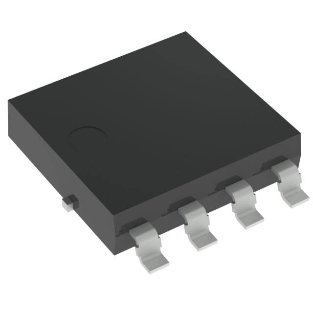

    适用于紧凑和高能效设计的汽车用功率 MOSFET,采用 5x6mm LFPAK 封装且具有较高的热性能。通过 AEC-Q101 认证的 MOSFET,符合生产件批准程序 (PPAP),适用于要求增强板...
NVMJS2D5N06CLTWG 数据手册
MOSFET – Power, Single N-Channel 60 V, 2.4 mW, 164 A NVMJS2D5N06CL Features • • • • • • www.onsemi.com Small Footprint (5x6 mm) for Compact Design Low RDS(on) to Minimize Conduction Losses Low QG and Capacitance to Minimize Driver Losses LFPAK8 Package, Industry Standard AEC−Q101 Qualified and PPAP Capable These Devices are Pb−Free and are RoHS Compliant V(BR)DSS Value Unit Drain−to−Source Voltage VDSS 60 V Gate−to−Source Voltage VGS ±20 V ID 164 A Steady State Power Dissipation RqJC (Note 1) Continuous Drain Current RqJA (Notes 1, 2, 3) TC = 100°C TC = 25°C Power Dissipation RqJA (Notes 1 & 2) TA = 25°C PD S (1,2,3) W 113 56 ID TA = 100°C TA = 25°C A 31 PD A TJ, Tstg −55 to + 175 °C IS 94 A Single Pulse Drain−to−Source Avalanche Energy (IL(pk) = 9 A) EAS 565 mJ Lead Temperature for Soldering Purposes (1/8″ from case for 10 s) TL 260 °C Stresses exceeding those listed in the Maximum Ratings table may damage the device. If any of these limits are exceeded, device functionality should not be assumed, damage may occur and reliability may be affected. THERMAL RESISTANCE MAXIMUM RATINGS Parameter D 2.0 900 Source Current (Body Diode) MARKING DIAGRAM W 3.9 IDM Operating Junction and Storage Temperature N−CHANNEL MOSFET 22 TA = 100°C TA = 25°C, tp = 10 ms G (4) 116 TC = 100°C Steady State Pulsed Drain Current TC = 25°C 164 A 3.3 mW @ 4.5 V D (5,8) Symbol Continuous Drain Current RqJC (Notes 1, 3) ID MAX 2.4 mW @ 10 V 60 V MAXIMUM RATINGS (TJ = 25°C unless otherwise noted) Parameter RDS(ON) MAX D D D 2D5N06 CL AWLYW LFPAK8 CASE 760AA 1 S S S G 2D5N06CL = Specific Device Code A = Assembly Location WL = Wafer Lot Y = Year W = Work Week ORDERING INFORMATION Symbol Value Unit Junction−to−Case − Steady State RqJC 1.3 °C/W Junction−to−Ambient − Steady State (Note 2) RqJA 38 See detailed ordering, marking and shipping information on page 5 of this data sheet. 1. The entire application environment impacts the thermal resistance values shown, they are not constants and are only valid for the particular conditions noted. 2. Surface−mounted on FR4 board using a 650 mm2, 2 oz. Cu pad. 3. Maximum current for pulses as long as 1 second is higher but is dependent on pulse duration and duty cycle. © Semiconductor Components Industries, LLC, 2018 June, 2021 − Rev. 1 1 Publication Order Number: NVMJS2D5N06CL/D NVMJS2D5N06CL ELECTRICAL CHARACTERISTICS (TJ = 25°C unless otherwise specified) Parameter Symbol Test Condition Min Drain−to−Source Breakdown Voltage V(BR)DSS VGS = 0 V, ID = 250 mA 60 Drain−to−Source Breakdown Voltage Temperature Coefficient V(BR)DSS/ TJ Typ Max Unit OFF CHARACTERISTICS Zero Gate Voltage Drain Current IDSS Gate−to−Source Leakage Current V 26 VGS = 0 V, VDS = 60 V mV/°C TJ = 25°C 10 TJ = 125°C 250 IGSS VDS = 0 V, VGS = 20 V VGS(TH) VGS = VDS, ID = 135 mA 100 mA nA ON CHARACTERISTICS (Note 4) Gate Threshold Voltage Threshold Temperature Coefficient VGS(TH)/TJ Drain−to−Source On Resistance Forward Transconductance RDS(on) 1.2 2.0 −5.0 VGS = 10 V ID = 50 A 2.0 2.4 VGS = 4.5 V ID = 50 A 2.6 3.3 gFS VDS =15 V, ID = 50 A V mV/°C mW 286 S pF CHARGES, CAPACITANCES & GATE RESISTANCE Input Capacitance CISS 3600 Output Capacitance COSS 1700 Reverse Transfer Capacitance CRSS VGS = 0 V, f = 1 MHz, VDS = 25 V 28 nC Total Gate Charge QG(TOT) VGS = 4.5 V, VDS = 48 V; ID = 50 A 24 Total Gate Charge QG(TOT) VGS = 10 V, VDS = 48 V; ID = 50 A 52 Threshold Gate Charge QG(TH) Gate−to−Source Charge QGS Gate−to−Drain Charge QGD Plateau Voltage VGP 3.0 V td(ON) 10 ns 6.0 VGS = 10 V, VDS = 48 V; ID = 50 A 12 4.5 SWITCHING CHARACTERISTICS (Note 5) Turn−On Delay Time Rise Time Turn−Off Delay Time Fall Time tr td(OFF) VGS = 10 V, VDS = 48 V, ID = 50 A, RG = 2.5 W tf 55 37 8.5 DRAIN−SOURCE DIODE CHARACTERISTICS Forward Diode Voltage Reverse Recovery Time Charge Time Discharge Time Reverse Recovery Charge VSD VGS = 0 V, IS = 50 A TJ = 25°C 0.8 TJ = 125°C 0.75 tRR ta tb 55 VGS = 0 V, dIs/dt = 100 A/ms, IS = 50 A QRR 1.2 V ns 28 28 60 nC Product parametric performance is indicated in the Electrical Characteristics for the listed test conditions, unless otherwise noted. Product performance may not be indicated by the Electrical Characteristics if operated under different conditions. 4. Pulse Test: pulse width v 300 ms, duty cycle v 2%. 5. Switching characteristics are independent of operating junction temperatures. www.onsemi.com 2 NVMJS2D5N06CL TYPICAL CHARACTERISTICS 250 225 3.6 V 225 ID, DRAIN CURRENT (A) 200 175 150 3.2 V 125 100 75 2.8 V 50 25 RDS(on), DRAIN−TO−SOURCE RESISTANCE (mW) 0 0 1.0 2.0 3.0 150 125 100 TJ = 25°C 75 50 4.0 TJ = 125°C 0 2.5 3.0 5 4 3 2 3 4 5 7 6 8 9 10 VGS, GATE−TO−SOURCE VOLTAGE (V) 4.0 3.5 Figure 2. Transfer Characteristics 6 3.0 TJ = 25°C 2.8 VGS = 4.5 V 2.6 2.4 2.2 VGS = 10 V 2.0 1.8 1.6 0 20 40 60 80 100 120 140 160 ID, DRAIN CURRENT (A) Figure 3. On−Resistance vs. Gate−to−Source Voltage Figure 4. On−Resistance vs. Drain Current and Gate Voltage 1.E+06 2.0 VGS = 10 V ID = 50 A TJ = 175°C 1.E+05 IDSS, LEAKAGE (nA) RDS(on), NORMALIZED DRAIN−TO− SOURCE RESISTANCE 2.0 Figure 1. On−Region Characteristics 7 1.6 1.4 1.2 1.0 1.E+04 TJ = 125°C 1.E+03 TJ = 85°C 1.E+02 0.8 0.6 −50 1.5 VGS, GATE−TO−SOURCE VOLTAGE (V) 8 1.8 1.0 0.5 TJ = −55°C VDS, DRAIN−TO−SOURCE VOLTAGE (V) TJ = 25°C ID = 50 A 2 175 0 9 1 VDS = 5 V 200 25 2.4 V RDS(on), DRAIN−TO−SOURCE RESISTANCE (mW) ID, DRAIN CURRENT (A) 250 VGS = 4.0 V to 10 V −25 0 25 50 75 100 125 150 175 1.E+01 5 15 25 35 45 55 TJ, JUNCTION TEMPERATURE (°C) VDS, DRAIN−TO−SOURCE VOLTAGE (V) Figure 5. On−Resistance Variation with Temperature Figure 6. Drain−to−Source Leakage Current vs. Voltage www.onsemi.com 3 NVMJS2D5N06CL C, CAPACITANCE (pF) 10000 VGS, GATE−TO−SOURCE VOLTAGE (V) TYPICAL CHARACTERISTICS CISS COSS 1000 100 10 VGS = 0 V TJ = 25°C f = 1 MHz 1 0.1 CRSS 0 10 20 30 40 60 50 5 QGD QGS 4 3 VDS = 48 V TJ = 25°C ID = 50 A 2 1 0 0 20 10 40 30 50 Figure 8. Gate−to−Source vs. Total Charge 100 IS, SOURCE CURRENT (A) t, TIME (ns) 7 6 Figure 7. Capacitance Variation tf tr 100 td(on) 10 VGS = 10 V VDS = 48 V ID = 50 A 1 10 VGS = 0 V 10 1 TJ = 125°C 0.1 100 0.3 0.4 0.5 TJ = 25°C 0.6 0.7 TJ = −55°C 0.8 0.9 1.0 RG, GATE RESISTANCE (W) VSD, SOURCE−TO−DRAIN VOLTAGE (V) Figure 9. Resistive Switching Time Variation vs. Gate Resistance Figure 10. Diode Forward Voltage vs. Current 100 1000 1 ms 10 ms 100 500 ms IPEAK, DRAIN CURRENT (A) ID, DRAIN CURRENT (A) 8 QG, TOTAL GATE CHARGE (nC) td(off) 10 TC = 25°C VGS ≤ 10 V Single Pulse 1 RDS(on) Limit Thermal Limit Package Limit 0.1 0.01 QT 9 VDS, DRAIN−TO−SOURCE VOLTAGE (V) 1000 1 10 0.1 1 TJ (initial)= 25°C 10 TJ (initial)= 100°C 1 10 100 1.E−05 1.E−04 1.E−03 1.E−02 VDS, DRAIN−TO−SOURCE VOLTAGE (V) TAV, TIME IN AVALANCHE (s) Figure 11. Maximum Rated Forward Biased Safe Operating Area Figure 12. Maximum Drain Current vs. Time in Avalanche www.onsemi.com 4 NVMJS2D5N06CL RqJA, EFFECTIVE TRANSIENT THERMAL RESISTANCE (°C/W) TYPICAL CHARACTERISTICS 100 50% Duty Cycle 10 20% 10% 5% 1 2% 0.1 1% 0.01 0.001 0.0000001 Single Pulse 0.000001 0.00001 0.0001 0.001 0.01 0.1 1 10 100 1000 PULSE TIME (sec) Figure 13. Thermal Characteristics DEVICE ORDERING INFORMATION Device NVMJS2D5N06CLTWG Marking Package Shipping† 2D5N06CL LFPAK8 (Pb−Free) 3000 / Tape & Reel †For information on tape and reel specifications, including part orientation and tape sizes, please refer to our Tape and Reel Packaging Specifications Brochure, BRD8011/D. www.onsemi.com 5 MECHANICAL CASE OUTLINE PACKAGE DIMENSIONS LFPAK8 5x6 CASE 760AA ISSUE C GENERIC MARKING DIAGRAM* XXXXXX XXXXXX AWLYW DOCUMENT NUMBER: DESCRIPTION: XXXXXX A WL Y W DATE 13 AUG 2019 = Specific Device Code = Assembly Location = Wafer Lot = Year = Work Week *This information is generic. Please refer to device data sheet for actual part marking. Some products may not follow the Generic Marking. 98AON82475G LFPAK8 5x6 Electronic versions are uncontrolled except when accessed directly from the Document Repository. Printed versions are uncontrolled except when stamped “CONTROLLED COPY” in red. PAGE 1 OF 1 ON Semiconductor and are trademarks of Semiconductor Components Industries, LLC dba ON Semiconductor or its subsidiaries in the United States and/or other countries. ON Semiconductor reserves the right to make changes without further notice to any products herein. ON Semiconductor makes no warranty, representation or guarantee regarding the suitability of its products for any particular purpose, nor does ON Semiconductor assume any liability arising out of the application or use of any product or circuit, and specifically disclaims any and all liability, including without limitation special, consequential or incidental damages. ON Semiconductor does not convey any license under its patent rights nor the rights of others. © Semiconductor Components Industries, LLC, 2018 www.onsemi.com onsemi, , and other names, marks, and brands are registered and/or common law trademarks of Semiconductor Components Industries, LLC dba “onsemi” or its affiliates and/or subsidiaries in the United States and/or other countries. onsemi owns the rights to a number of patents, trademarks, copyrights, trade secrets, and other intellectual property. A listing of onsemi’s product/patent coverage may be accessed at www.onsemi.com/site/pdf/Patent−Marking.pdf. onsemi reserves the right to make changes at any time to any products or information herein, without notice. The information herein is provided “as−is” and onsemi makes no warranty, representation or guarantee regarding the accuracy of the information, product features, availability, functionality, or suitability of its products for any particular purpose, nor does onsemi assume any liability arising out of the application or use of any product or circuit, and specifically disclaims any and all liability, including without limitation special, consequential or incidental damages. Buyer is responsible for its products and applications using onsemi products, including compliance with all laws, regulations and safety requirements or standards, regardless of any support or applications information provided by onsemi. “Typical” parameters which may be provided in onsemi data sheets and/or specifications can and do vary in different applications and actual performance may vary over time. All operating parameters, including “Typicals” must be validated for each customer application by customer’s technical experts. onsemi does not convey any license under any of its intellectual property rights nor the rights of others. onsemi products are not designed, intended, or authorized for use as a critical component in life support systems or any FDA Class 3 medical devices or medical devices with a same or similar classification in a foreign jurisdiction or any devices intended for implantation in the human body. Should Buyer purchase or use onsemi products for any such unintended or unauthorized application, Buyer shall indemnify and hold onsemi and its officers, employees, subsidiaries, affiliates, and distributors harmless against all claims, costs, damages, and expenses, and reasonable attorney fees arising out of, directly or indirectly, any claim of personal injury or death associated with such unintended or unauthorized use, even if such claim alleges that onsemi was negligent regarding the design or manufacture of the part. onsemi is an Equal Opportunity/Affirmative Action Employer. This literature is subject to all applicable copyright laws and is not for resale in any manner. PUBLICATION ORDERING INFORMATION LITERATURE FULFILLMENT: Email Requests to: orderlit@onsemi.com onsemi Website: www.onsemi.com ◊ TECHNICAL SUPPORT North American Technical Support: Voice Mail: 1 800−282−9855 Toll Free USA/Canada Phone: 011 421 33 790 2910 Europe, Middle East and Africa Technical Support: Phone: 00421 33 790 2910 For additional information, please contact your local Sales Representative
