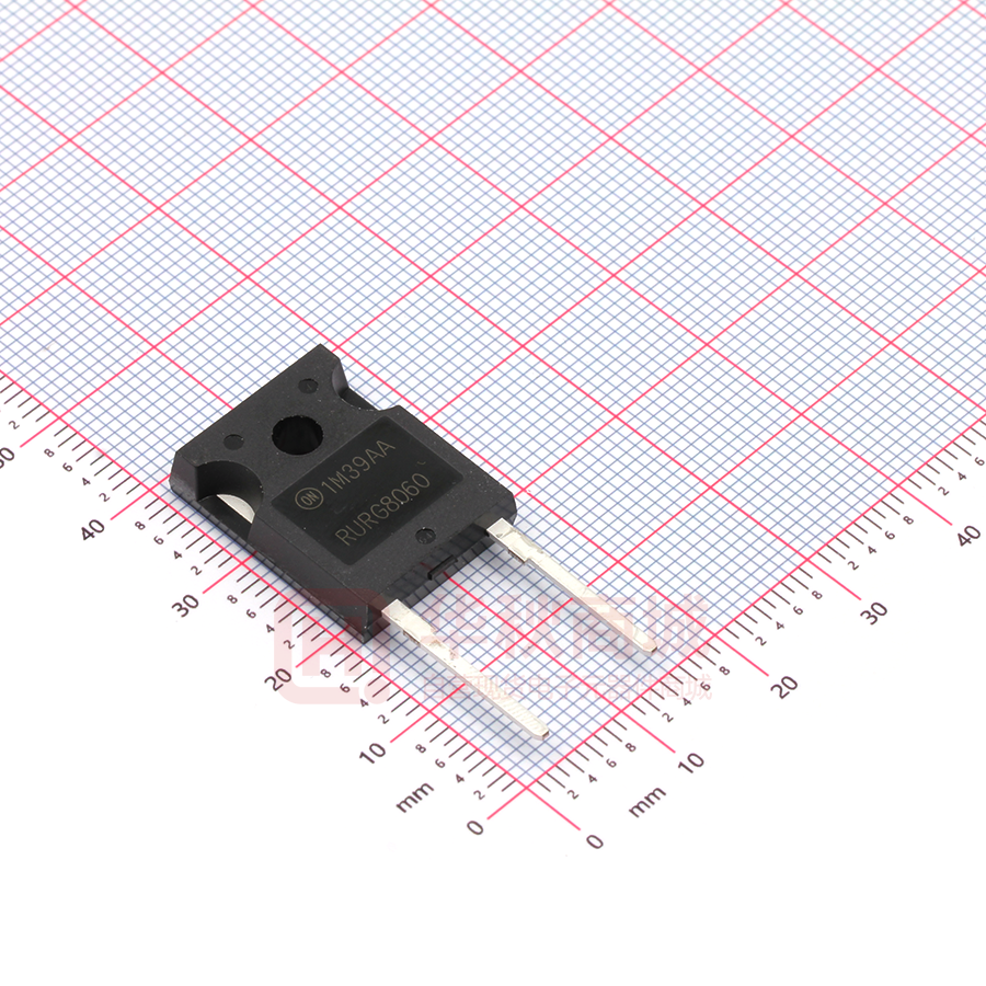

Ultrafast Diode 80 A, 600 V RURG8060 Description The RURG8060 is an ultrafast diode with low forward voltage drop. This device is intended for use as freewheeling and clamping diodes in a variety of switching power supplies and other power switching applications. It is specially suited for use in switching power supplies and industrial application. www.onsemi.com Features • • • • • Ultrafast Recovery, trr = 85 ns (@ IF = 80 A ) Max Forward Voltage, VF = 1.6 V (@ TC = 25 °C ) 600 V Reverse Voltage and High Reliability Avalanche Energy Rated This Device is Pb−Free and is RoHS Compliant JEDEC STYLE 2 LEAD TO−247 340CL Applications • Switching Power Supplies • Power Switching Circuits • General Purpose MARKING DIAGRAM ABSOLUTE MAXIMUM RATINGS (TC = 25°C unless otherwise noted) Rating Symbol Value Unit Peak Repetitive Reverse Voltage VRRM 600 V Working Peak Reverse Voltage VRWM 600 V VR 600 V Average Rectified Forward Current (TC = 72 °C) IF(AV) 80 A Repetitive Peak Surge Current (Square Wave, 20 kHz) IFRM 160 A Nonrepetitive Peak Surge Current (Halfwave 1 Phase, 60 Hz) IFSM 800 A Maximum Power Dissipation PD 180 W Avalanche Energy (See Figure 7 and Figure 8) EAVL 50 mJ TSTG, TJ −65 to +175 °C DC Blocking Voltage Operating and Storage Temperature CATHODE (BOTTOM SIDE METAL) CATHODE ANODE Stresses exceeding those listed in the Maximum Ratings table may damage the device. If any of these limits are exceeded, device functionality should not be assumed, damage may occur and reliability may be affected. $Y&Z&3&K RURG8060 $Y &Z &3 &K RURG80100 1. Cathode = ON Semiconductor Logo = Assembly Plant Code = Numeric Date Code = Lot Code = Specific Device Code 2. Anode ORDERING INFORMATION See detailed ordering and shipping information on page 2 of this data sheet. © Semiconductor Components Industries, LLC, 2001 October, 2020 − Rev. 4 1 Publication Order Number: RURG8060/D RURG8060 PACKAGE MARKING AND ORDERING INFORMATION Part Number Package Brand RURG8060 TO−247−2L RURG8060 ELECTRICAL CHARACTERISTICS (TC = 25°C unless otherwise noted) Symbol VF IR trr Parameter Test Conditions Min Typ Max Unit Instantaneous Forward Voltage (Pulse Width = 300 ms, Duty Cycle = 2%) IF = 80 A 1.6 V IF = 80 A, TC = 150°C 1.4 V Instantaneous Reverse Current VR = 600 V 250 mA VR = 600 V TC = 150°C 2.0 mA IF = 1 A, dlF/dt = 100 A/ms 75 ns IF = 80 A, dIF/dt = 100 A/ms 85 ns Reverse Recovery Time (See Figure 6 ) Summation of ta + tb ta Time to Reach Peak Reverse Current (See Figure 6) IF = 80 A, dIF/dt = 100 A/ms 40 ns tb Time from Peak IRM to Projected Zero Crossing of IRM Based on a Straight Line from Peak IRM Through 25% of IRM (See Figure 6) IF = 80 A, dIF/dt = 100 A/ms 25 ns RqJC Thermal Resistance Junction to Case 0.83 °C/W Product parametric performance is indicated in the Electrical Characteristics for the listed test conditions, unless otherwise noted. Product performance may not be indicated by the Electrical Characteristics if operated under different conditions. www.onsemi.com 2 RURG8060 TYPICAL PERFORMANCE CURVES 1000 175oC 100 IR, Reverse Current (mA) IF, Forward Current (A) 400 100oC 10 1 25oC 0 0.5 1.0 1.5 2.0 2.5 10 100oC 1 0.1 0.01 3.0 175oC 100 25oC 0 100 VF, Forward Voltage (V) IF(AV), Average Forward Current (A) 60 t, Times (ns) trr 40 ta tb 1 400 500 600 Figure 2. Reverse Current vs. Reverse Voltage 80 0 300 VR, Reverse Voltage (V) Figure 1. Forward Current vs. Forward Voltage 20 200 10 80 100 80 DC 60 SQ. WAVE 40 20 0 25 IF, Forward Current (A) 50 75 100 125 TC, Case Temperature (5C) Figure 3. trr, ta and tb Curves vs. Forward Current Figure 4. Current Derating Curve www.onsemi.com 3 150 175 RURG8060 TEST CIRCUITS AND WAVEFORMS VGE AMPLITUDE AND RG CONTROL dlF/dt t1 AND t2 CONTROL IF L DUT RG CURRENT SENSE VGE dIF Trr dt ta 0 VDD − IGBT t1 IF + tb 0.25I RM IRM t2 Figure 5. Trr Test Circuit Figure 6. Trr Waveforms and Definitions I = 1.6 A L = 40 mH R < 0.1 W EAVL = 1/2LI2 [VR(AVL)/(VR(AVL)−VDD)] Q1 = IGBT (BVCES > DUT VR(AVL)) L VAVL R CURRENT SENSE + VDD DUT − IL IL I V Q1 VDD t0 Figure 7. Avalanche Energy Test Circuit t1 t2 t Figure 8. Avalanche Current and Voltage Waveforms www.onsemi.com 4 MECHANICAL CASE OUTLINE PACKAGE DIMENSIONS TO−247−2LD CASE 340CL ISSUE A DATE 03 DEC 2019 GENERIC MARKING DIAGRAM* AYWWZZ XXXXXXX XXXXXXX XXXX A Y WW ZZ = Specific Device Code = Assembly Location = Year = Work Week = Assembly Lot Code *This information is generic. Please refer to device data sheet for actual part marking. Pb−Free indicator, “G” or microdot “G”, may or may not be present. Some products may not follow the Generic Marking. DOCUMENT NUMBER: DESCRIPTION: 98AON13850G TO−247−2LD Electronic versions are uncontrolled except when accessed directly from the Document Repository. Printed versions are uncontrolled except when stamped “CONTROLLED COPY” in red. PAGE 1 OF 1 ON Semiconductor and are trademarks of Semiconductor Components Industries, LLC dba ON Semiconductor or its subsidiaries in the United States and/or other countries. ON Semiconductor reserves the right to make changes without further notice to any products herein. ON Semiconductor makes no warranty, representation or guarantee regarding the suitability of its products for any particular purpose, nor does ON Semiconductor assume any liability arising out of the application or use of any product or circuit, and specifically disclaims any and all liability, including without limitation special, consequential or incidental damages. ON Semiconductor does not convey any license under its patent rights nor the rights of others. © Semiconductor Components Industries, LLC, 2018 www.onsemi.com ON Semiconductor and are trademarks of Semiconductor Components Industries, LLC dba ON Semiconductor or its subsidiaries in the United States and/or other countries. ON Semiconductor owns the rights to a number of patents, trademarks, copyrights, trade secrets, and other intellectual property. A listing of ON Semiconductor’s product/patent coverage may be accessed at www.onsemi.com/site/pdf/Patent−Marking.pdf. ON Semiconductor reserves the right to make changes without further notice to any products herein. ON Semiconductor makes no warranty, representation or guarantee regarding the suitability of its products for any particular purpose, nor does ON Semiconductor assume any liability arising out of the application or use of any product or circuit, and specifically disclaims any and all liability, including without limitation special, consequential or incidental damages. Buyer is responsible for its products and applications using ON Semiconductor products, including compliance with all laws, regulations and safety requirements or standards, regardless of any support or applications information provided by ON Semiconductor. “Typical” parameters which may be provided in ON Semiconductor data sheets and/or specifications can and do vary in different applications and actual performance may vary over time. All operating parameters, including “Typicals” must be validated for each customer application by customer’s technical experts. ON Semiconductor does not convey any license under its patent rights nor the rights of others. ON Semiconductor products are not designed, intended, or authorized for use as a critical component in life support systems or any FDA Class 3 medical devices or medical devices with a same or similar classification in a foreign jurisdiction or any devices intended for implantation in the human body. Should Buyer purchase or use ON Semiconductor products for any such unintended or unauthorized application, Buyer shall indemnify and hold ON Semiconductor and its officers, employees, subsidiaries, affiliates, and distributors harmless against all claims, costs, damages, and expenses, and reasonable attorney fees arising out of, directly or indirectly, any claim of personal injury or death associated with such unintended or unauthorized use, even if such claim alleges that ON Semiconductor was negligent regarding the design or manufacture of the part. ON Semiconductor is an Equal Opportunity/Affirmative Action Employer. This literature is subject to all applicable copyright laws and is not for resale in any manner. PUBLICATION ORDERING INFORMATION LITERATURE FULFILLMENT: Email Requests to: orderlit@onsemi.com ON Semiconductor Website: www.onsemi.com ◊ TECHNICAL SUPPORT North American Technical Support: Voice Mail: 1 800−282−9855 Toll Free USA/Canada Phone: 011 421 33 790 2910 www.onsemi.com 1 Europe, Middle East and Africa Technical Support: Phone: 00421 33 790 2910 For additional information, please contact your local Sales Representative
