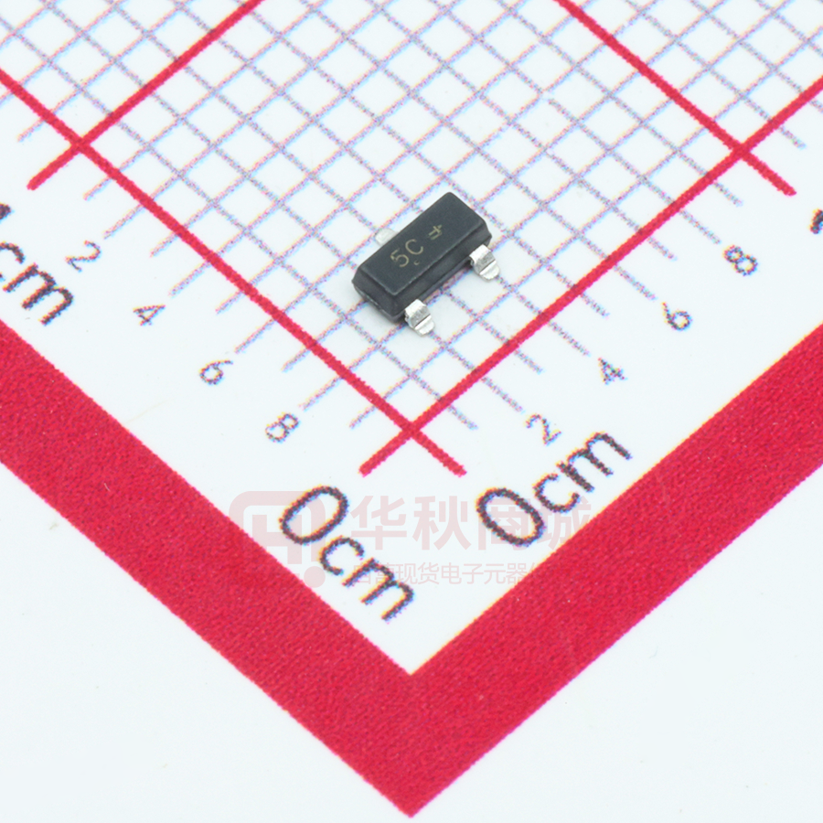

    该共阴极肖特基二极管适用于高速开关应用、电路保护和电压箝位。极低正向电压降低了导通损耗。微型表面贴装封装非常适用于空间有限的手持和便携式应用。
SBAT54CLT1G 数据手册
Schottky Barrier Diodes, Dual Common Cathode BAT54CL These Schottky barrier diodes are designed for high speed switching applications, circuit protection, and voltage clamping. Extremely low forward voltage reduces conduction loss. Miniature surface mount package is excellent for hand−held and portable applications where space is limited. Features • Extremely Fast Switching Speed • Low Forward Voltage − 0.35 V (Typ) @ IF = 10 mAdc • S Prefix for Automotive and Other Applications Requiring Unique • www.onsemi.com 30 VOLT DUAL COMMON CATHODE SCHOTTKY BARRIER DIODES 3 Site and Control Change Requirements; AEC−Q101 Qualified and PPAP Capable These Devices are Pb−Free, Halogen Free/BFR Free and are RoHS Compliant MAXIMUM RATINGS (TJ = 125°C unless otherwise noted) Rating Symbol Value Unit Reverse Voltage VR 30 V Forward Power Dissipation @ TA = 25°C Derate above 25°C PF 225 1.8 mW mW/°C RqJA 508 311 °C/W IF 200 Max mA Thermal Resistance (Note 1) Junction-to-Ambient (Note 2) Forward Current (DC) Non−Repetitive Peak Forward Current tp < 10 msec IFSM Repetitive Peak Forward Current Pulse Wave = 1 sec, Duty Cycle = 66% IFRM 1 2 SOT−23 CASE 318 STYLE 9 1 ANODE 3 CATHODE MARKING DIAGRAM 5C MG G mA 600 1 mA 300 2 ANODE 5C M G = Device Code = Date Code = Pb−Free Package Junction Temperature TJ −55 to +150 °C (Note: Microdot may be in either location) Storage Temperature Range Tstg −55 to +150 °C *Date Code orientation and/or position may vary depending upon manufacturing location. Stresses exceeding those listed in the Maximum Ratings table may damage the device. If any of these limits are exceeded, device functionality should not be assumed, damage may occur and reliability may be affected. 1. FR−4 @ Minimum Pad. 2. FR−4 @ 1.0 x 1.0 inch Pad. ORDERING INFORMATION Device Package Shipping† BAT54CLT1G SOT−23 (Pb−Free) 3,000 / Tape & Reel SBAT54CLT1G SOT−23 (Pb−Free) 3,000 / Tape & Reel BAT54CLT3G SOT−23 (Pb−Free) 10,000 / Tape & Reel †For information on tape and reel specifications, including part orientation and tape sizes, please refer to our Tape and Reel Packaging Specifications Brochure, BRD8011/D. © Semiconductor Components Industries, LLC, 2003 November, 2019 − Rev. 12 1 Publication Order Number: BAT54CLT1/D BAT54CL ELECTRICAL CHARACTERISTICS (TA = 25°C unless otherwise noted) (EACH DIODE) Characteristic Symbol Reverse Breakdown Voltage (IR = 10 mA) V(BR)R Total Capacitance (VR = 1.0 V, f = 1.0 MHz) CT Reverse Leakage (VR = 25 V) IR Forward Voltage (IF = 0.1 mA) (IF = 1.0 mA) (IF = 10 mA) (IF = 30 mA) (IF = 100 mA) VF Reverse Recovery Time (IF = IR = 10 mAdc, IR(REC) = 1.0 mAdc, Figure 1) trr Min Typ Max 30 − − − 7.6 10 − 0.5 2.0 − − − − − 0.22 0.29 0.35 0.41 0.52 0.24 0.32 0.40 0.50 0.80 − − 5.0 Unit V pF mA V ns Product parametric performance is indicated in the Electrical Characteristics for the listed test conditions, unless otherwise noted. Product performance may not be indicated by the Electrical Characteristics if operated under different conditions. 820 W +10 V 2k 100 mH 0.1 mF IF tr 0.1 mF tp T IF trr 10% T DUT 50 W OUTPUT PULSE GENERATOR 50 W INPUT SAMPLING OSCILLOSCOPE 90% VR IR INPUT SIGNAL iR(REC) = 1 mA OUTPUT PULSE (IF = IR = 10 mA; measured at iR(REC) = 1 mA) Notes: 1. A 2.0 kW variable resistor adjusted for a Forward Current (IF) of 10 mA. Notes: 2. Input pulse is adjusted so IR(peak) is equal to 10 mA. Notes: 3. tp » trr Figure 1. Recovery Time Equivalent Test Circuit www.onsemi.com 2 BAT54CL TYPICAL CHARACTERISTICS 100 IF, FORWARD CURRENT (mA) 1 25°C 85°C 10 1 50°C 1.0 25°C 0.1 0.0 −40°C −55°C 0.2 0.3 0.4 0.1 0.5 VF, FORWARD VOLTAGE (VOLTS) 0.6 Figure 2. Forward Voltage IR, REVERSE CURRENT (mA) 1000 TA = 150°C 100 TA = 125°C 10 TA = 85°C 1.0 TA = 25°C 0.1 0.01 0 5 15 25 10 20 VR, REVERSE VOLTAGE (VOLTS) 30 Figure 3. Leakage Current CT, TOTAL CAPACITANCE (pF) 14 12 10 8 6 4 2 0 0 5 10 15 20 VR, REVERSE VOLTAGE (VOLTS) Figure 4. Total Capacitance www.onsemi.com 3 25 30 MECHANICAL CASE OUTLINE PACKAGE DIMENSIONS SOT−23 (TO−236) CASE 318−08 ISSUE AS DATE 30 JAN 2018 SCALE 4:1 D 0.25 3 E 1 2 T HE NOTES: 1. DIMENSIONING AND TOLERANCING PER ASME Y14.5M, 1994. 2. CONTROLLING DIMENSION: MILLIMETERS. 3. MAXIMUM LEAD THICKNESS INCLUDES LEAD FINISH. MINIMUM LEAD THICKNESS IS THE MINIMUM THICKNESS OF THE BASE MATERIAL. 4. DIMENSIONS D AND E DO NOT INCLUDE MOLD FLASH, PROTRUSIONS, OR GATE BURRS. DIM A A1 b c D E e L L1 HE T L 3X b L1 VIEW C e TOP VIEW A A1 SIDE VIEW SEE VIEW C c MIN 0.89 0.01 0.37 0.08 2.80 1.20 1.78 0.30 0.35 2.10 0° MILLIMETERS NOM MAX 1.00 1.11 0.06 0.10 0.44 0.50 0.14 0.20 2.90 3.04 1.30 1.40 1.90 2.04 0.43 0.55 0.54 0.69 2.40 2.64 −−− 10 ° MIN 0.035 0.000 0.015 0.003 0.110 0.047 0.070 0.012 0.014 0.083 0° INCHES NOM 0.039 0.002 0.017 0.006 0.114 0.051 0.075 0.017 0.021 0.094 −−− MAX 0.044 0.004 0.020 0.008 0.120 0.055 0.080 0.022 0.027 0.104 10° GENERIC MARKING DIAGRAM* END VIEW RECOMMENDED SOLDERING FOOTPRINT XXXMG G 1 3X 2.90 3X XXX = Specific Device Code M = Date Code G = Pb−Free Package 0.90 *This information is generic. Please refer to device data sheet for actual part marking. Pb−Free indicator, “G” or microdot “ G”, may or may not be present. 0.95 PITCH 0.80 DIMENSIONS: MILLIMETERS STYLE 1 THRU 5: CANCELLED STYLE 6: PIN 1. BASE 2. EMITTER 3. COLLECTOR STYLE 7: PIN 1. EMITTER 2. BASE 3. COLLECTOR STYLE 9: PIN 1. ANODE 2. ANODE 3. CATHODE STYLE 10: PIN 1. DRAIN 2. SOURCE 3. GATE STYLE 11: STYLE 12: PIN 1. ANODE PIN 1. CATHODE 2. CATHODE 2. CATHODE 3. CATHODE−ANODE 3. ANODE STYLE 15: PIN 1. GATE 2. CATHODE 3. ANODE STYLE 16: PIN 1. ANODE 2. CATHODE 3. CATHODE STYLE 17: PIN 1. NO CONNECTION 2. ANODE 3. CATHODE STYLE 18: STYLE 19: STYLE 20: PIN 1. NO CONNECTION PIN 1. CATHODE PIN 1. CATHODE 2. CATHODE 2. ANODE 2. ANODE 3. GATE 3. ANODE 3. CATHODE−ANODE STYLE 21: PIN 1. GATE 2. SOURCE 3. DRAIN STYLE 22: PIN 1. RETURN 2. OUTPUT 3. INPUT STYLE 23: PIN 1. ANODE 2. ANODE 3. CATHODE STYLE 24: PIN 1. GATE 2. DRAIN 3. SOURCE STYLE 27: PIN 1. CATHODE 2. CATHODE 3. CATHODE STYLE 28: PIN 1. ANODE 2. ANODE 3. ANODE DOCUMENT NUMBER: DESCRIPTION: 98ASB42226B SOT−23 (TO−236) STYLE 8: PIN 1. ANODE 2. NO CONNECTION 3. CATHODE STYLE 13: PIN 1. SOURCE 2. DRAIN 3. GATE STYLE 25: PIN 1. ANODE 2. CATHODE 3. GATE STYLE 14: PIN 1. CATHODE 2. GATE 3. ANODE STYLE 26: PIN 1. CATHODE 2. ANODE 3. NO CONNECTION Electronic versions are uncontrolled except when accessed directly from the Document Repository. Printed versions are uncontrolled except when stamped “CONTROLLED COPY” in red. PAGE 1 OF 1 ON Semiconductor and are trademarks of Semiconductor Components Industries, LLC dba ON Semiconductor or its subsidiaries in the United States and/or other countries. ON Semiconductor reserves the right to make changes without further notice to any products herein. ON Semiconductor makes no warranty, representation or guarantee regarding the suitability of its products for any particular purpose, nor does ON Semiconductor assume any liability arising out of the application or use of any product or circuit, and specifically disclaims any and all liability, including without limitation special, consequential or incidental damages. ON Semiconductor does not convey any license under its patent rights nor the rights of others. © Semiconductor Components Industries, LLC, 2019 www.onsemi.com onsemi, , and other names, marks, and brands are registered and/or common law trademarks of Semiconductor Components Industries, LLC dba “onsemi” or its affiliates and/or subsidiaries in the United States and/or other countries. onsemi owns the rights to a number of patents, trademarks, copyrights, trade secrets, and other intellectual property. A listing of onsemi’s product/patent coverage may be accessed at www.onsemi.com/site/pdf/Patent−Marking.pdf. onsemi reserves the right to make changes at any time to any products or information herein, without notice. The information herein is provided “as−is” and onsemi makes no warranty, representation or guarantee regarding the accuracy of the information, product features, availability, functionality, or suitability of its products for any particular purpose, nor does onsemi assume any liability arising out of the application or use of any product or circuit, and specifically disclaims any and all liability, including without limitation special, consequential or incidental damages. Buyer is responsible for its products and applications using onsemi products, including compliance with all laws, regulations and safety requirements or standards, regardless of any support or applications information provided by onsemi. “Typical” parameters which may be provided in onsemi data sheets and/or specifications can and do vary in different applications and actual performance may vary over time. All operating parameters, including “Typicals” must be validated for each customer application by customer’s technical experts. onsemi does not convey any license under any of its intellectual property rights nor the rights of others. onsemi products are not designed, intended, or authorized for use as a critical component in life support systems or any FDA Class 3 medical devices or medical devices with a same or similar classification in a foreign jurisdiction or any devices intended for implantation in the human body. Should Buyer purchase or use onsemi products for any such unintended or unauthorized application, Buyer shall indemnify and hold onsemi and its officers, employees, subsidiaries, affiliates, and distributors harmless against all claims, costs, damages, and expenses, and reasonable attorney fees arising out of, directly or indirectly, any claim of personal injury or death associated with such unintended or unauthorized use, even if such claim alleges that onsemi was negligent regarding the design or manufacture of the part. onsemi is an Equal Opportunity/Affirmative Action Employer. This literature is subject to all applicable copyright laws and is not for resale in any manner. PUBLICATION ORDERING INFORMATION LITERATURE FULFILLMENT: Email Requests to: orderlit@onsemi.com onsemi Website: www.onsemi.com ◊ TECHNICAL SUPPORT North American Technical Support: Voice Mail: 1 800−282−9855 Toll Free USA/Canada Phone: 011 421 33 790 2910 Europe, Middle East and Africa Technical Support: Phone: 00421 33 790 2910 For additional information, please contact your local Sales Representative
