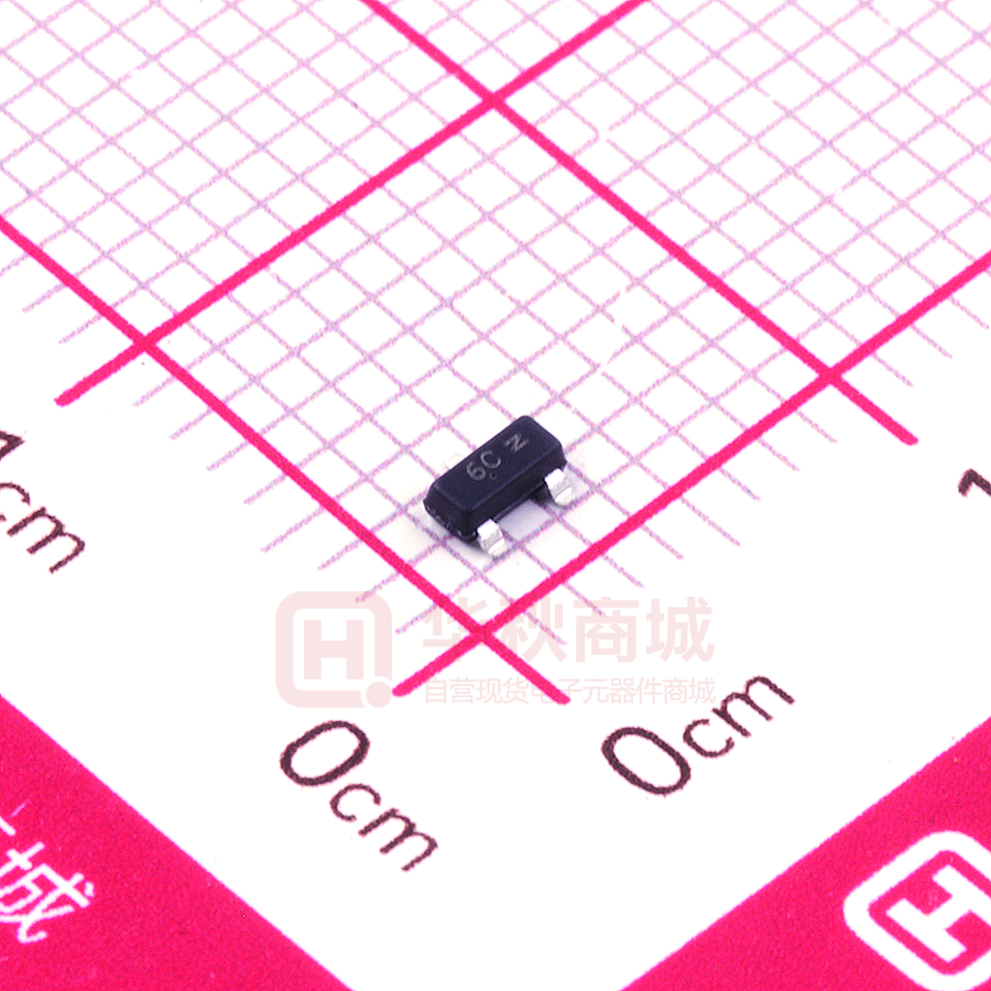

SBC817-40LT1G
SBC817-40LT1G
    ONSEMI(安森美)
    SOT-23
    通用三极管 NPN 45V 500mA SOT-23
SBC817-40LT1G 数据手册
DATA SHEET www.onsemi.com General Purpose Transistors COLLECTOR 3 NPN Silicon 1 BASE BC817-16L, SBC817-16L, BC817-25L, SBC817-25L, BC817-40L, SBC817-40L 2 EMITTER Features 3 • S and NSV Prefixes for Automotive and Other Applications • Requiring Unique Site and Control Change Requirements; AEC−Q101 Qualified and PPAP Capable These Devices are Pb−Free, Halogen Free/BFR Free and are RoHS Compliant Symbol Value Unit Collector − Emitter Voltage VCEO 45 V Collector − Base Voltage VCBO 50 V Emitter − Base Voltage VEBO 5.0 V IC 500 mAdc Symbol Max Unit 225 1.8 mW mW/°C 556 °C/W Collector Current − Continuous THERMAL CHARACTERISTICS Characteristic Total Device Dissipation FR− 5 Board, (Note 1) TA = 25°C Derate above 25°C Thermal Resistance, Junction−to−Ambient Total Device Dissipation Alumina Substrate, (Note 2) TA = 25°C Derate above 25°C Thermal Resistance, Junction−to−Ambient Junction and Storage Temperature 2 SOT−23 CASE 318 STYLE 6 MARKING DIAGRAM MAXIMUM RATINGS Rating 1 PD RqJA 6x M G G 1 6x M G = Device Code x = A, B, or C = Date Code* = Pb−Free Package (Note: Microdot may be in either location) *Date Code orientation and/or overbar may vary depending upon manufacturing location. ORDERING INFORMATION PD 300 2.4 mW mW/°C RqJA 417 °C/W TJ, Tstg −65 to +150 °C See detailed ordering and shipping information in the package dimensions section on page 2 of this data sheet. Stresses exceeding those listed in the Maximum Ratings table may damage the device. If any of these limits are exceeded, device functionality should not be assumed, damage may occur and reliability may be affected. 1. FR−5 = 1.0 x 0.75 x 0.062 in. 2. Alumina = 0.4 x 0.3 x 0.024 in 99.5% alumina. © Semiconductor Components Industries, LLC, 1997 October, 2021 − Rev. 17 1 Publication Order Number: BC817−16LT1/D BC817−16L, SBC817−16L, BC817−25L, SBC817−25L, BC817−40L, SBC817−40L ELECTRICAL CHARACTERISTICS (TA = 25°C unless otherwise noted) Symbol Min Typ Max Unit Collector −Emitter Breakdown Voltage (IC = 10 mA) V(BR)CEO 45 − − V Collector −Emitter Breakdown Voltage (VEB = 0, IC = 10 mA) V(BR)CES 50 − − V Emitter −Base Breakdown Voltage (IE = 1.0 mA) V(BR)EBO 5.0 − − V Collector Cutoff Current (VCB = 20 V) (VCB = 20 V, TA = 150°C) ICBO − − − − 100 5.0 nA mA 100 160 250 40 − − − − 250 400 600 − Characteristic OFF CHARACTERISTICS ON CHARACTERISTICS DC Current Gain (IC = 100 mA, VCE = 1.0 V) (IC = 500 mA, VCE = 1.0 V) hFE BC817−16, SBC817−16 BC817−25, SBC817−25 BC817−40, SBC817−40 − Collector −Emitter Saturation Voltage (IC = 500 mA, IB = 50 mA) VCE(sat) − − 0.7 V Base −Emitter On Voltage (IC = 500 mA, VCE = 1.0 V) VBE(on) − − 1.2 V fT 100 − − MHz Cobo − 10 − pF SMALL− SIGNAL CHARACTERISTICS Current −Gain − Bandwidth Product (IC = 10 mA, VCE = 5.0 Vdc, f = 100 MHz) Output Capacitance (VCB = 10 V, f = 1.0 MHz) Product parametric performance is indicated in the Electrical Characteristics for the listed test conditions, unless otherwise noted. Product performance may not be indicated by the Electrical Characteristics if operated under different conditions. ORDERING INFORMATION Device Specific Marking Package 6A SOT−23 (Pb−Free) BC817−16LT1G NSVBC817−16LT1G BC817−16LT3G BC817−25LT1G BC817−25LT3G 3000 / Tape & Reel SOT−23 (Pb−Free) 6B 10,000 / Tape & Reel SBC817−25LT3G BC817−40LT1G SBC817−40LT1G BC817−40LT3G 3000 / Tape & Reel 10,000 / Tape & Reel SBC817−16LT3G SBC817−25LT1G Shipping† 3000 / Tape & Reel SOT−23 (Pb−Free) 6C 10,000 / Tape & Reel SBC817−40LT3G †For information on tape and reel specifications, including part orientation and tape sizes, please refer to our Tape and Reel Packaging Specifications Brochure, BRD8011/D. www.onsemi.com 2 BC817−16L, SBC817−16L, BC817−25L, SBC817−25L, BC817−40L, SBC817−40L TYPICAL CHARACTERISTICS − BC817−16L, SBC817−16L 300 1 hFE, DC CURRENT GAIN 200 25°C −55°C 100 0 VCE(sat), COLLECTOR−EMITTER SATURATION VOLTAGE (V) VCE = 1 V 150°C 0.001 0.01 0.01 0.1 1 Figure 1. DC Current Gain vs. Collector Current Figure 2. Collector Emitter Saturation Voltage vs. Collector Current VBE(on), BASE−EMITTER VOLTAGE (V) −55°C IC/IB = 10 25°C 0.8 150°C 0.7 0.6 0.5 0.4 0.3 0.0001 0.001 0.01 0.1 1 1.2 VCE = 5 V 1.1 1.0 −55°C 0.9 0.8 25°C 0.7 0.6 150°C 0.5 0.4 0.3 0.2 0.0001 0.001 0.01 0.1 IC, COLLECTOR CURRENT (A) IC, COLLECTOR CURRENT (A) Figure 3. Base Emitter Saturation Voltage vs. Collector Current Figure 4. Base Emitter Voltage vs. Collector Current 1000 fT, CURRENT−GAIN−BANDWIDTH PRODUCT (MHz) VBE(sat), BASE−EMITTER SATURATION VOLTAGE (V) 0.001 IC, COLLECTOR CURRENT (A) 0.9 0.2 −55°C 0.1 IC, COLLECTOR CURRENT (A) 1.1 1.0 150°C 25°C 0.01 1 0.1 IC/IB = 10 VCE = 1 V TA = 25°C 100 10 0.1 1 10 100 1000 IC, COLLECTOR CURRENT (mA) Figure 5. Current Gain Bandwidth Product vs. Collector Current www.onsemi.com 3 1 BC817−16L, SBC817−16L, BC817−25L, SBC817−25L, BC817−40L, SBC817−40L θV, TEMPERATURE COEFFICIENTS (mV/°C) 1.0 TJ = 25°C 0.8 0.6 0.4 IC = 10 mA 100 mA 300 mA 500 mA 0.2 0 0.01 0.1 1 IB, BASE CURRENT (mA) 10 +1 qVC for VCE(sat) 0 -1 qVB for VBE -2 100 1 Figure 6. Saturation Region 10 100 IC, COLLECTOR CURRENT (mA) Figure 7. Temperature Coefficients 100 C, CAPACITANCE (pF) VCE , COLLECTOR-EMITTER VOLTAGE (VOLTS) TYPICAL CHARACTERISTICS − BC817−16L, SBC817−16L Cib 10 Cob 1 0.1 10 1 VR, REVERSE VOLTAGE (VOLTS) Figure 8. Capacitances www.onsemi.com 4 100 1000 BC817−16L, SBC817−16L, BC817−25L, SBC817−25L, BC817−40L, SBC817−40L TYPICAL CHARACTERISTICS − BC817−25L, SBC817−25L 500 1 hFE, DC CURRENT GAIN 150°C VCE(sat), COLLECTOR−EMITTER SATURATION VOLTAGE (V) VCE = 1 V 400 300 25°C 200 −55°C 100 0 0.001 0.01 0.001 0.01 0.1 1 Figure 9. DC Current Gain vs. Collector Current Figure 10. Collector Emitter Saturation Voltage vs. Collector Current VBE(on), BASE−EMITTER VOLTAGE (V) −55°C IC/IB = 10 25°C 0.8 150°C 0.7 0.6 0.5 0.4 0.3 0.0001 0.001 0.01 0.1 1 1.2 VCE = 5 V 1.1 1.0 0.9 −55°C 0.8 25°C 0.7 0.6 0.5 150°C 0.4 0.3 0.2 0.0001 0.001 0.01 0.1 IC, COLLECTOR CURRENT (A) IC, COLLECTOR CURRENT (A) Figure 11. Base Emitter Saturation Voltage vs. Collector Current Figure 12. Base Emitter Voltage vs. Collector Current 1000 fT, CURRENT−GAIN−BANDWIDTH PRODUCT (MHz) VBE(sat), BASE−EMITTER SATURATION VOLTAGE (V) −55°C IC, COLLECTOR CURRENT (A) 0.9 0.2 0.1 IC, COLLECTOR CURRENT (A) 1.1 1.0 150°C 25°C 0.01 1 0.1 IC/IB = 10 VCE = 1 V TA = 25°C 100 10 0.1 1 10 100 IC, COLLECTOR CURRENT (mA) Figure 13. Current Gain Bandwidth Product vs. Collector Current www.onsemi.com 5 1000 1 BC817−16L, SBC817−16L, BC817−25L, SBC817−25L, BC817−40L, SBC817−40L θV, TEMPERATURE COEFFICIENTS (mV/°C) 1.0 TJ = 25°C 0.8 0.6 0.4 IC = 10 mA 100 mA 300 mA 500 mA 0.2 0 0.01 0.1 1 IB, BASE CURRENT (mA) 10 +1 qVC for VCE(sat) 0 -1 qVB for VBE -2 100 1 Figure 14. Saturation Region 10 100 IC, COLLECTOR CURRENT (mA) Figure 15. Temperature Coefficients 100 C, CAPACITANCE (pF) VCE , COLLECTOR-EMITTER VOLTAGE (VOLTS) TYPICAL CHARACTERISTICS − BC817−25L, SBC81725L Cib 10 Cob 1 0.1 10 1 VR, REVERSE VOLTAGE (VOLTS) Figure 16. Capacitances www.onsemi.com 6 100 1000 BC817−16L, SBC817−16L, BC817−25L, SBC817−25L, BC817−40L, SBC817−40L TYPICAL CHARACTERISTICS − BC817−40L, SBC817−40L 1 700 150°C VCE(sat), COLLECTOR−EMITTER SATURATION VOLTAGE (V) hFE, DC CURRENT GAIN 600 VCE = 1 V 500 25°C 400 300 −55°C 200 100 0 0.001 0.01 0.001 0.01 0.1 1 Figure 17. DC Current Gain vs. Collector Current Figure 18. Collector Emitter Saturation Voltage vs. Collector Current VBE(on), BASE−EMITTER VOLTAGE (V) −55°C IC/IB = 10 0.8 25°C 0.7 0.6 150°C 0.5 0.4 0.3 0.0001 0.001 0.01 0.1 1 1.2 VCE = 5 V 1.1 1.0 0.9 −55°C 0.8 25°C 0.7 0.6 0.5 150°C 0.4 0.3 0.2 0.0001 0.001 0.01 0.1 IC, COLLECTOR CURRENT (A) IC, COLLECTOR CURRENT (A) Figure 19. Base Emitter Saturation Voltage vs. Collector Current Figure 20. Base Emitter Voltage vs. Collector Current 1000 fT, CURRENT−GAIN−BANDWIDTH PRODUCT (MHz) VBE(sat), BASE−EMITTER SATURATION VOLTAGE (V) 0.01 IC, COLLECTOR CURRENT (A) 0.9 0.2 −55°C IC, COLLECTOR CURRENT (A) 1.1 1.0 150°C 25°C 0.1 0.001 1 0.1 IC/IB = 10 VCE = 1 V TA = 25°C 100 10 0.1 1 10 100 IC, COLLECTOR CURRENT (mA) Figure 21. Current Gain Bandwidth Product vs. Collector Current www.onsemi.com 7 1000 1 BC817−16L, SBC817−16L, BC817−25L, SBC817−25L, BC817−40L, SBC817−40L θV, TEMPERATURE COEFFICIENTS (mV/°C) 1.0 TJ = 25°C 0.8 0.6 0.4 IC = 10 mA 100 mA 300 mA 500 mA 0.2 0 0.01 0.1 1 IB, BASE CURRENT (mA) 10 +1 qVC for VCE(sat) 0 -1 qVB for VBE -2 100 1 Figure 22. Saturation Region 10 100 IC, COLLECTOR CURRENT (mA) Figure 23. Temperature Coefficients 100 C, CAPACITANCE (pF) VCE , COLLECTOR-EMITTER VOLTAGE (VOLTS) TYPICAL CHARACTERISTICS − BC817−40L, SBC817−40L Cib 10 Cob 1 0.1 10 1 VR, REVERSE VOLTAGE (VOLTS) Figure 24. Capacitances www.onsemi.com 8 100 1000 BC817−16L, SBC817−16L, BC817−25L, SBC817−25L, BC817−40L, SBC817−40L TYPICAL CHARACTERISTICS − BC817−16L, SBC817−16L, BC817−25L, SBC817−25L, BC817−40L, SBC817−40L 1 1 ms 10 ms 100 ms 1s Thermal Limit IC (A) 0.1 0.01 Single Pulse Test @ TA = 25°C 0.001 0.01 0.1 1 VCE (Vdc) 10 Figure 25. Safe Operating Area www.onsemi.com 9 100 MECHANICAL CASE OUTLINE PACKAGE DIMENSIONS SOT−23 (TO−236) CASE 318−08 ISSUE AS DATE 30 JAN 2018 SCALE 4:1 D 0.25 3 E 1 2 T HE NOTES: 1. DIMENSIONING AND TOLERANCING PER ASME Y14.5M, 1994. 2. CONTROLLING DIMENSION: MILLIMETERS. 3. MAXIMUM LEAD THICKNESS INCLUDES LEAD FINISH. MINIMUM LEAD THICKNESS IS THE MINIMUM THICKNESS OF THE BASE MATERIAL. 4. DIMENSIONS D AND E DO NOT INCLUDE MOLD FLASH, PROTRUSIONS, OR GATE BURRS. DIM A A1 b c D E e L L1 HE T L 3X b L1 VIEW C e TOP VIEW A A1 SIDE VIEW SEE VIEW C c MIN 0.89 0.01 0.37 0.08 2.80 1.20 1.78 0.30 0.35 2.10 0° MILLIMETERS NOM MAX 1.00 1.11 0.06 0.10 0.44 0.50 0.14 0.20 2.90 3.04 1.30 1.40 1.90 2.04 0.43 0.55 0.54 0.69 2.40 2.64 −−− 10 ° MIN 0.035 0.000 0.015 0.003 0.110 0.047 0.070 0.012 0.014 0.083 0° INCHES NOM 0.039 0.002 0.017 0.006 0.114 0.051 0.075 0.017 0.021 0.094 −−− MAX 0.044 0.004 0.020 0.008 0.120 0.055 0.080 0.022 0.027 0.104 10° GENERIC MARKING DIAGRAM* END VIEW RECOMMENDED SOLDERING FOOTPRINT XXXMG G 1 3X 2.90 3X XXX = Specific Device Code M = Date Code G = Pb−Free Package 0.90 *This information is generic. Please refer to device data sheet for actual part marking. Pb−Free indicator, “G” or microdot “ G”, may or may not be present. 0.95 PITCH 0.80 DIMENSIONS: MILLIMETERS STYLE 1 THRU 5: CANCELLED STYLE 6: PIN 1. BASE 2. EMITTER 3. COLLECTOR STYLE 7: PIN 1. EMITTER 2. BASE 3. COLLECTOR STYLE 9: PIN 1. ANODE 2. ANODE 3. CATHODE STYLE 10: PIN 1. DRAIN 2. SOURCE 3. GATE STYLE 11: STYLE 12: PIN 1. ANODE PIN 1. CATHODE 2. CATHODE 2. CATHODE 3. CATHODE−ANODE 3. ANODE STYLE 15: PIN 1. GATE 2. CATHODE 3. ANODE STYLE 16: PIN 1. ANODE 2. CATHODE 3. CATHODE STYLE 17: PIN 1. NO CONNECTION 2. ANODE 3. CATHODE STYLE 18: STYLE 19: STYLE 20: PIN 1. NO CONNECTION PIN 1. CATHODE PIN 1. CATHODE 2. CATHODE 2. ANODE 2. ANODE 3. GATE 3. ANODE 3. CATHODE−ANODE STYLE 21: PIN 1. GATE 2. SOURCE 3. DRAIN STYLE 22: PIN 1. RETURN 2. OUTPUT 3. INPUT STYLE 23: PIN 1. ANODE 2. ANODE 3. CATHODE STYLE 24: PIN 1. GATE 2. DRAIN 3. SOURCE STYLE 27: PIN 1. CATHODE 2. CATHODE 3. CATHODE STYLE 28: PIN 1. ANODE 2. ANODE 3. ANODE DOCUMENT NUMBER: DESCRIPTION: 98ASB42226B SOT−23 (TO−236) STYLE 8: PIN 1. ANODE 2. NO CONNECTION 3. CATHODE STYLE 13: PIN 1. SOURCE 2. DRAIN 3. GATE STYLE 25: PIN 1. ANODE 2. CATHODE 3. GATE STYLE 14: PIN 1. CATHODE 2. GATE 3. ANODE STYLE 26: PIN 1. CATHODE 2. ANODE 3. NO CONNECTION Electronic versions are uncontrolled except when accessed directly from the Document Repository. Printed versions are uncontrolled except when stamped “CONTROLLED COPY” in red. PAGE 1 OF 1 ON Semiconductor and are trademarks of Semiconductor Components Industries, LLC dba ON Semiconductor or its subsidiaries in the United States and/or other countries. ON Semiconductor reserves the right to make changes without further notice to any products herein. ON Semiconductor makes no warranty, representation or guarantee regarding the suitability of its products for any particular purpose, nor does ON Semiconductor assume any liability arising out of the application or use of any product or circuit, and specifically disclaims any and all liability, including without limitation special, consequential or incidental damages. ON Semiconductor does not convey any license under its patent rights nor the rights of others. © Semiconductor Components Industries, LLC, 2019 www.onsemi.com onsemi, , and other names, marks, and brands are registered and/or common law trademarks of Semiconductor Components Industries, LLC dba “onsemi” or its affiliates and/or subsidiaries in the United States and/or other countries. onsemi owns the rights to a number of patents, trademarks, copyrights, trade secrets, and other intellectual property. A listing of onsemi’s product/patent coverage may be accessed at www.onsemi.com/site/pdf/Patent−Marking.pdf. onsemi reserves the right to make changes at any time to any products or information herein, without notice. The information herein is provided “as−is” and onsemi makes no warranty, representation or guarantee regarding the accuracy of the information, product features, availability, functionality, or suitability of its products for any particular purpose, nor does onsemi assume any liability arising out of the application or use of any product or circuit, and specifically disclaims any and all liability, including without limitation special, consequential or incidental damages. Buyer is responsible for its products and applications using onsemi products, including compliance with all laws, regulations and safety requirements or standards, regardless of any support or applications information provided by onsemi. “Typical” parameters which may be provided in onsemi data sheets and/or specifications can and do vary in different applications and actual performance may vary over time. All operating parameters, including “Typicals” must be validated for each customer application by customer’s technical experts. onsemi does not convey any license under any of its intellectual property rights nor the rights of others. onsemi products are not designed, intended, or authorized for use as a critical component in life support systems or any FDA Class 3 medical devices or medical devices with a same or similar classification in a foreign jurisdiction or any devices intended for implantation in the human body. Should Buyer purchase or use onsemi products for any such unintended or unauthorized application, Buyer shall indemnify and hold onsemi and its officers, employees, subsidiaries, affiliates, and distributors harmless against all claims, costs, damages, and expenses, and reasonable attorney fees arising out of, directly or indirectly, any claim of personal injury or death associated with such unintended or unauthorized use, even if such claim alleges that onsemi was negligent regarding the design or manufacture of the part. onsemi is an Equal Opportunity/Affirmative Action Employer. This literature is subject to all applicable copyright laws and is not for resale in any manner. PUBLICATION ORDERING INFORMATION LITERATURE FULFILLMENT: Email Requests to: orderlit@onsemi.com onsemi Website: www.onsemi.com ◊ TECHNICAL SUPPORT North American Technical Support: Voice Mail: 1 800−282−9855 Toll Free USA/Canada Phone: 011 421 33 790 2910 Europe, Middle East and Africa Technical Support: Phone: 00421 33 790 2910 For additional information, please contact your local Sales Representative
