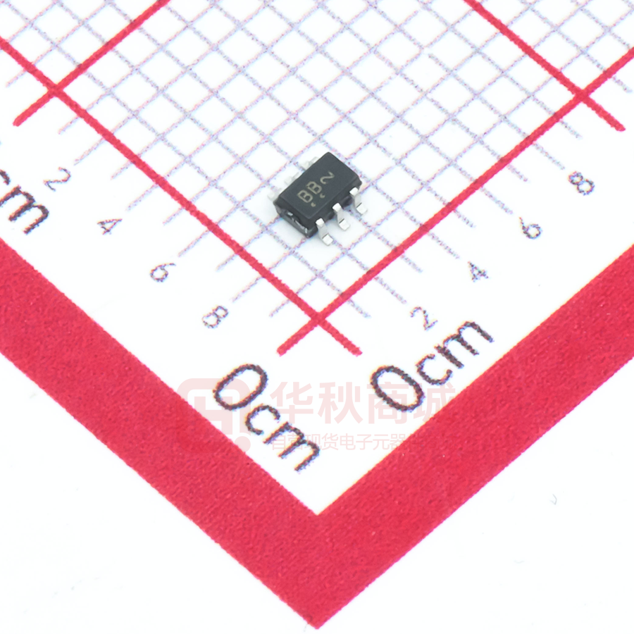

DATA SHEET www.onsemi.com Dual General Purpose Transistors SOT−363 CASE 419B STYLE 1 NPN/PNP Duals (Complementary) BC846BPDW1, BC847BPDW1, BC848CPDW1 Series (3) Features Q2 (4) XX MG G 1 XX = Device Code M = Date Code G = Pb−Free Package MAXIMUM RATINGS − NPN Value Unit Collector-Emitter Voltage BC846 BC847 BC848 VCEO Collector-Base Voltage BC846 BC847 BC848 VCBO Emitter−Base Voltage VEBO 6.0 V IC 100 mAdc ICM 200 mAdc Symbol Value Unit Collector Current − Continuous Collector Current − Peak V 65 45 30 V MAXIMUM RATINGS − PNP Rating Collector-Emitter Voltage BC846 BC847 BC848 VCEO Collector-Base Voltage BC846 BC847 BC848 VCBO Emitter−Base Voltage VEBO −6.0 V IC −100 mAdc ICM −200 mAdc Collector Current − Continuous Collector Current − Peak (Note: Microdot may be in either location) ORDERING INFORMATION Device 80 50 30 V −65 −45 −30 V −80 −50 −30 (6) 6 Site and Control Change Requirements; AEC−Q101 Qualified and PPAP Capable These Devices are Pb−Free, Halogen Free/BFR Free and are RoHS Compliant Symbol (5) MARKING DIAGRAM • S Prefix for Automotive and Other Applications Requiring Unique Rating (1) Q1 These transistors are designed for general purpose amplifier applications. They are housed in the SOT−363/SC−88 which is designed for low power surface mount applications. • (2) Mark Package Shipping† BC846BPDW1T1G, SBC846BPDW1T1G BB SOT−363 3,000 / (Pb−Free) Tape & Reel SBC846BPDW1T2G BB SOT−363 3,000 / (Pb−Free) Tape & Reel SBC846BPDW1T3G BB SOT−363 10,000 / (Pb−Free) Tape & Reel BC847BPDW1T1G BF SOT−363 3,000 / (Pb−Free) Tape & Reel SBC847BPDW1T1G BF SOT−363 3,000 / (Pb−Free) Tape & Reel SBC847BPDW1T3G BF SOT−363 10,000 / (Pb−Free) Tape & Reel BC847BPDW1T2G BF SOT−363 3,000 / (Pb−Free) Tape & Reel BC848CPDW1T1G BL SOT−363 3,000 / (Pb−Free) Tape & Reel †For information on tape and reel specifications, including part orientation and tape sizes, please refer to our Tape and Reel Packaging Specification Brochure, BRD8011/D. Stresses exceeding those listed in the Maximum Ratings table may damage the device. If any of these limits are exceeded, device functionality should not be assumed, damage may occur and reliability may be affected. © Semiconductor Components Industries, LLC, 2016 May, 2022 − Rev. 13 1 Publication Order Number: BC846BPDW1T1/D BC846BPDW1, BC847BPDW1, BC848CPDW1 Series THERMAL CHARACTERISTICS Characteristic Symbol Max Unit 380 250 3.0 mW mW/°C mW/°C RqJA 328 °C/W TJ, Tstg −55 to +150 °C Total Device Dissipation Per Device FR− 5 Board (Note 1) TA = 25°C Derate above 25°C PD Thermal Resistance, Junction−to−Ambient Junction and Storage Temperature 1. FR−5 = 1.0 x 0.75 x 0.062 in. ELECTRICAL CHARACTERISTICS (NPN) (TA = 25°C unless otherwise noted) Characteristic Symbol Min Typ Max Unit OFF CHARACTERISTICS Collector −Emitter Breakdown Voltage (IC = 10 mA) BC846 BC847 BC848 V(BR)CEO Collector −Emitter Breakdown Voltage (IC = 10 mA, VEB = 0) BC846 BC847B BC848 V(BR)CES Collector −Base Breakdown Voltage (IC = 10 mA) BC846 BC847 BC848 V(BR)CBO Emitter −Base Breakdown Voltage (IE = 1.0 mA) BC846 BC847 BC848 V(BR)EBO V 65 45 30 − − − − − − V 80 50 30 ICBO − − − V 80 50 30 Collector Cutoff Current (VCB = 30 V) (VCB = 30 V, TA = 150°C) − − − − − − − − − V 6.0 6.0 6.0 − − − − − − − − − − 15 5.0 nA mA ON CHARACTERISTICS DC Current Gain (IC = 10 mA, VCE = 5.0 V) BC846B, BC847B BC848C (IC = 2.0 mA, VCE = 5.0 V) BC846B, BC847B BC848C hFE Collector −Emitter Saturation Voltage (IC = 10 mA, IB = 0.5 mA) All devices except SBC847BPDW1T1G SBC847BPDW1T1G only (IC = 100 mA, IB = 5.0 mA) All devices (IC = 2 mA, IB = 0.5 mA) SBC847BPDW1T1G only VCE(sat) Base −Emitter Saturation Voltage (IC = 10 mA, IB = 0.5 mA) (IC = 100 mA, IB = 5.0 mA) VBE(sat) Base −Emitter Voltage (IC = 2.0 mA, VCE = 5.0 V) (IC = 10 mA, VCE = 5.0 V) VBE(on) − − − 150 270 − − 200 420 290 520 475 800 − − − − − − − 0.024 0.25 0.1 0.6 − − − 0.7 0.9 − − 580 − 660 − 700 770 100 − − − − 4.5 V V mV SMALL− SIGNAL CHARACTERISTICS Current −Gain − Bandwidth Product (IC = 10 mA, VCE = 5.0 Vdc, f = 100 MHz) fT Output Capacitance (VCB = 10 V, f = 1.0 MHz) Cobo Noise Figure (IC = 0.2 mA, VCE = 5.0 Vdc, RS = 2.0 kW, f = 1.0 kHz, BW = 200 Hz) NF www.onsemi.com 2 − − 10 MHz pF dB BC846BPDW1, BC847BPDW1, BC848CPDW1 Series ELECTRICAL CHARACTERISTICS (PNP) (TA = 25°C unless otherwise noted) Characteristic Symbol Min Typ Max Unit OFF CHARACTERISTICS Collector −Emitter Breakdown Voltage (IC = −10 mA) BC846 BC847 BC848 V(BR)CEO Collector −Emitter Breakdown Voltage (IC = −10 mA, VEB = 0) BC846 BC847 BC848 V(BR)CES Collector −Base Breakdown Voltage (IC = −10 mA) BC846 BC847 BC848 V(BR)CBO Emitter −Base Breakdown Voltage (IE = −1.0 mA) BC846 BC847 BC848 V(BR)EBO V −65 −45 −30 − − − − − − V −80 −50 −30 ICBO − − − V −80 −50 −30 Collector Cutoff Current (VCB = −30 V) (VCB = −30 V, TA = 150°C) − − − − − − − − − V −6.0 −6.0 −6.0 − − − − − − − − − − −15 −4.0 nA mA ON CHARACTERISTICS hFE DC Current Gain (IC = −10 mA, VCE = −5.0 V) BC846B, BC847B BC848C (IC = −2.0 mA, VCE = −5.0 V) BC846B, BC847B BC848C Collector −Emitter Saturation Voltage (IC = −10 mA, IB = −0.5 mA) All devices except SBC847BPDW1T1G SBC847BPDW1T1G only (IC = −100 mA, IB = −5.0 mA) All devices (IC = −2 mA, IB = −0.5 mA) SBC847BPDW1T1G only VCE(sat) Base −Emitter Saturation Voltage (IC = −10 mA, IB = −0.5 mA) (IC = −100 mA, IB = −5.0 mA) VBE(sat) Base −Emitter On Voltage (IC = −2.0 mA, VCE = −5.0 V) (IC = −10 mA, VCE = −5.0 V) VBE(on) − − − 150 270 − − 200 420 290 520 475 800 − − − − − − − −0.024 −0.3 −0.1 −0.65 − − − −0.7 −0.9 − − −0.6 − − − −0.75 −0.82 100 − − − − 4.5 − − 10 V V V SMALL− SIGNAL CHARACTERISTICS fT Current −Gain − Bandwidth Product (IC = −10 mA, VCE = −5.0 Vdc, f = 100 MHz) Output Capacitance (VCB = −10 V, f = 1.0 MHz) Cob Noise Figure (IC = −0.2 mA, VCE = −5.0 Vdc, RS = 2.0 kW, f = 1.0 kHz, BW = 200 Hz) NF www.onsemi.com 3 MHz pF dB BC846BPDW1, BC847BPDW1, BC848CPDW1 Series TYPICAL NPN CHARACTERISTICS − BC846 0.30 500 VCE = 5 V VCE(sat), COLLECTOR−EMITTER SATURATION VOLTAGE (V) hFE, DC CURRENT GAIN 150°C 400 25°C 300 200 −55°C 100 0 0.001 0.01 0.1 VBE(on), BASE−EMITTER VOLTAGE (V) VBE(sat), BASE−EMITTER SATURATION VOLTAGE (V) 0.05 −55°C 0.0001 25°C 0.5 150°C 0.3 0.1 0.0001 0.001 0.01 0.1 VCE = 5 V 1.0 −55°C 0.9 0.8 25°C 0.7 0.6 150°C 0.5 0.4 0.3 0.2 0.0001 0.001 0.01 0.1 IC, COLLECTOR CURRENT (A) Figure 3. Base Emitter Saturation Voltage vs. Collector Current Figure 4. Base Emitter Voltage vs. Collector Current 2.0 -1.0 θVB, TEMPERATURE COEFFICIENT (mV/ °C) VCE , COLLECTOR-EMITTER VOLTAGE (VOLTS) 0.01 1.2 1.1 IC, COLLECTOR CURRENT (A) TA = 25°C 1.6 20 mA 50 mA 100 mA 200 mA 1.2 IC = 10 mA 0.8 0.4 0 0.001 Figure 2. Collector Emitter Saturation Voltage vs. Collector Current 0.6 0.2 25°C Figure 1. DC Current Gain vs. Collector Current −55°C 0.4 150°C 0.10 IC, COLLECTOR CURRENT (A) 0.9 0.7 0.15 IC, COLLECTOR CURRENT (A) IC/IB = 20 0.8 0.20 0 1 1.1 1.0 IC/IB = 20 0.25 0.02 0.05 0.1 0.2 0.5 1.0 2.0 IB, BASE CURRENT (mA) 5.0 10 20 -1.4 -1.8 qVB for VBE -55°C to 125°C -2.2 -2.6 -3.0 0.2 Figure 5. Collector Saturation Region 0.5 10 20 1.0 2.0 5.0 IC, COLLECTOR CURRENT (mA) 50 100 200 Figure 6. Base−Emitter Temperature Coefficient www.onsemi.com 4 BC846BPDW1, BC847BPDW1, BC848CPDW1 Series TYPICAL NPN CHARACTERISTICS − BC846 f, T CURRENT-GAIN - BANDWIDTH PRODUCT 40 C, CAPACITANCE (pF) TA = 25°C 20 Cib 10 6.0 Cob 4.0 2.0 0.1 0.2 0.5 1.0 2.0 10 20 5.0 VR, REVERSE VOLTAGE (VOLTS) 50 VCE = 5 V TA = 25°C 500 200 100 50 20 1.0 5.0 10 50 100 IC, COLLECTOR CURRENT (mA) 100 Figure 7. Capacitance Figure 8. Current−Gain − Bandwidth Product www.onsemi.com 5 BC846BPDW1, BC847BPDW1, BC848CPDW1 Series TYPICAL PNP CHARACTERISTICS — BC846 0.30 500 400 25°C 300 −55°C 200 100 0 0.001 0.01 0.1 VBE(sat), BASE−EMITTER SATURATION VOLTAGE (V) 0.20 25°C 0.15 0.10 −55°C 0.05 0.0001 0.1 Figure 10. Collector Emitter Saturation Voltage vs. Collector Current −55°C IC/IB = 20 25°C 0.6 150°C 0.5 0.4 0.3 0.0001 0.001 0.01 0.1 1.2 1.1 VCE = 5 V 1.0 0.9 −55°C 0.8 25°C 0.7 0.6 150°C 0.5 0.4 0.3 0.2 0.0001 IC, COLLECTOR CURRENT (A) 0.001 0.01 0.1 IC, COLLECTOR CURRENT (A) Figure 11. Base Emitter Saturation Voltage vs. Collector Current Figure 12. Base Emitter Voltage vs. Collector Current -2.0 -1.0 -1.6 IC = -10 mA -20 mA -50 mA -100 mA -200 mA -0.8 -0.4 TJ = 25°C 0 -0.02 -0.05 -0.1 -0.2 -0.5 -1.0 -2.0 IB, BASE CURRENT (mA) -5.0 -10 θVB, TEMPERATURE COEFFICIENT (mV/ °C) VCE , COLLECTOR-EMITTER VOLTAGE (VOLTS) 0.01 Figure 9. DC Current Gain vs. Collector Current 0.7 -1.2 0.001 IC, COLLECTOR CURRENT (A) 0.8 0.2 150°C IC, COLLECTOR CURRENT (A) 1.0 0.9 IC/IB = 20 0.25 0 1 VBE(on), BASE−EMITTER VOLTAGE (V) hFE, DC CURRENT GAIN 150°C VCE(sat), COLLECTOR−EMITTER SATURATION VOLTAGE (V) VCE = 5 V -20 Figure 13. Collector Saturation Region -1.4 -1.8 qVB for VBE -55°C to 125°C -2.2 -2.6 -3.0 -0.2 -0.5 -1.0 -50 -2.0 -5.0 -10 -20 IC, COLLECTOR CURRENT (mA) -100 -200 Figure 14. Base−Emitter Temperature Coefficient www.onsemi.com 6 BC846BPDW1, BC847BPDW1, BC848CPDW1 Series TYPICAL PNP CHARACTERISTICS — BC846 f, T CURRENT-GAIN - BANDWIDTH PRODUCT 40 C, CAPACITANCE (pF) TJ = 25°C 20 Cib 10 8.0 6.0 Cob 4.0 2.0 -0.1 -0.2 -0.5 -1.0 -2.0 -5.0 -10 -20 VR, REVERSE VOLTAGE (VOLTS) VCE = -5.0 V 500 200 100 50 20 -100 -1.0 -10 IC, COLLECTOR CURRENT (mA) -50 -100 Figure 15. Capacitance Figure 16. Current−Gain − Bandwidth Product www.onsemi.com 7 BC846BPDW1, BC847BPDW1, BC848CPDW1 Series TYPICAL NPN CHARACTERISTICS − BC847 0.30 500 VCE = 5 V VCE(sat), COLLECTOR−EMITTER SATURATION VOLTAGE (V) hFE, DC CURRENT GAIN 150°C 400 25°C 300 200 −55°C 100 0 0.001 0.01 0.1 0.10 −55°C 0.05 0.0001 0.1 Figure 18. Collector Emitter Saturation Voltage vs. Collector Current −55°C IC/IB = 20 25°C 150°C 0.7 0.6 0.5 0.4 0.3 0.0001 0.001 0.01 0.1 1.2 1.1 VCE = 5 V 1.0 0.9 −55°C 0.8 25°C 0.7 150°C 0.6 0.5 0.4 0.3 0.2 0.0001 IC, COLLECTOR CURRENT (A) 0.001 0.01 0.1 IC, COLLECTOR CURRENT (A) Figure 19. Base Emitter Saturation Voltage vs. Collector Current Figure 20. Base Emitter Voltage vs. Collector Current 1.0 θVB, TEMPERATURE COEFFICIENT (mV/ °C) 2.0 VCE , COLLECTOR-EMITTER VOLTAGE (V) 0.01 Figure 17. DC Current Gain vs. Collector Current 0.8 TA = 25°C 1.6 IC = 200 mA 1.2 IC = IC = 10 mA 20 mA IC = 50 mA IC = 100 mA 0.8 0.4 0 0.001 IC, COLLECTOR CURRENT (A) VBE(on), BASE−EMITTER VOLTAGE (V) VBE(sat), BASE−EMITTER SATURATION VOLTAGE (V) 25°C 0.15 IC, COLLECTOR CURRENT (A) 0.9 0.2 150°C 0.20 0 1 1.1 1.0 IC/IB = 20 0.25 0.02 10 0.1 1.0 IB, BASE CURRENT (mA) 20 -55°C to +125°C 1.2 1.6 2.0 2.4 2.8 0.2 Figure 21. Collector Saturation Region 10 1.0 IC, COLLECTOR CURRENT (mA) Figure 22. Base−Emitter Temperature Coefficient www.onsemi.com 8 100 BC846BPDW1, BC847BPDW1, BC848CPDW1 Series f, T CURRENT-GAIN - BANDWIDTH PRODUCT (MHz) TYPICAL NPN CHARACTERISTICS − BC847 10 C, CAPACITANCE (pF) 7.0 TA = 25°C 5.0 Cib 3.0 Cob 2.0 1.0 0.4 0.6 0.8 1.0 2.0 4.0 6.0 8.0 10 VR, REVERSE VOLTAGE (VOLTS) 20 40 Figure 23. Capacitances 400 300 200 VCE = 10 V TA = 25°C 100 80 60 40 30 20 0.5 0.7 1.0 2.0 3.0 5.0 7.0 10 20 IC, COLLECTOR CURRENT (mAdc) 30 Figure 24. Current−Gain − Bandwidth Product www.onsemi.com 9 50 BC846BPDW1, BC847BPDW1, BC848CPDW1 Series TYPICAL PNP CHARACTERISTICS − BC847 0.35 150°C VCE = 5 V VCE(sat), COLLECTOR−EMITTER SATURATION VOLTAGE (V) hFE, DC CURRENT GAIN 500 400 25°C 300 200 −55°C 100 0 0.001 0.01 0.1 0.10 −55°C 0.05 0.0001 −55°C IC/IB = 20 25°C 150°C 0.6 0.5 0.4 0.3 0.0001 0.001 0.01 0.1 VCE = 5 V 1.0 −55°C 0.9 0.8 25°C 0.7 0.6 150°C 0.5 0.4 0.3 0.2 0.0001 0.001 0.01 0.1 IC, COLLECTOR CURRENT (A) Figure 27. Base Emitter Saturation Voltage vs. Collector Current Figure 28. Base Emitter Voltage vs. Collector Current 1.0 θVB , TEMPERATURE COEFFICIENT (mV/ °C) -2.0 VCE , COLLECTOR-EMITTER VOLTAGE (V) 0.1 1.2 1.1 IC, COLLECTOR CURRENT (A) TA = 25°C -1.6 -1.2 IC = -10 mA IC = -50 mA IC = -20 mA -0.4 0 0.01 Figure 26. Collector Emitter Saturation Voltage vs. Collector Current 0.7 -0.8 0.001 Figure 25. DC Current Gain vs. Collector Current VBE(on), BASE−EMITTER VOLTAGE (V) VBE(sat), BASE−EMITTER SATURATION VOLTAGE (V) 25°C 0.15 IC, COLLECTOR CURRENT (A) 0.8 0.2 0.20 IC, COLLECTOR CURRENT (A) 1.0 0.9 150°C 0.25 0 1 IC/IB = 20 0.30 -0.02 -0.1 -1.0 IB, BASE CURRENT (mA) IC = -200 mA IC = -100 mA -55°C to +125°C 1.2 1.6 2.0 2.4 2.8 -10 -20 Figure 29. Collector Saturation Region -0.2 -10 -1.0 IC, COLLECTOR CURRENT (mA) Figure 30. Base−Emitter Temperature Coefficient www.onsemi.com 10 -100 BC846BPDW1, BC847BPDW1, BC848CPDW1 Series 10 Cib 7.0 C, CAPACITANCE (pF) TA = 25°C 5.0 Cob 3.0 2.0 1.0 -0.4 -0.6 -1.0 -2.0 -4.0 -6.0 -10 -20 -30 -40 f, T CURRENT-GAIN - BANDWIDTH PRODUCT (MHz) TYPICAL PNP CHARACTERISTICS − BC847 400 300 200 150 VCE = -10 V TA = 25°C 100 80 60 40 30 20 -0.5 -1.0 -2.0 -3.0 -5.0 -10 -20 -30 -50 VR, REVERSE VOLTAGE (VOLTS) IC, COLLECTOR CURRENT (mAdc) Figure 31. Capacitances Figure 32. Current−Gain − Bandwidth Product www.onsemi.com 11 BC846BPDW1, BC847BPDW1, BC848CPDW1 Series TYPICAL NPN CHARACTERISTICS − BC848 1000 0.30 hFE, DC CURRENT GAIN 900 VCE(sat), COLLECTOR−EMITTER SATURATION VOLTAGE (V) VCE = 5 V 800 150°C 700 600 25°C 500 400 300 −55°C 200 100 0 0.001 0.01 0.1 −55°C 0.05 0.0001 IC/IB = 20 −55°C 25°C 0.7 150°C 0.6 0.5 0.4 0.3 0.1 0.0001 0.001 0.01 0.1 1.2 1.1 VCE = 5 V 1.0 −55°C 0.9 0.8 25°C 0.7 0.6 150°C 0.5 0.4 0.3 0.2 0.0001 IC, COLLECTOR CURRENT (A) 0.001 0.01 0.1 IC, COLLECTOR CURRENT (A) Figure 35. Base Emitter Saturation Voltage vs. Collector Current Figure 36. Base Emitter Voltage vs. Collector Current 1.0 θVB, TEMPERATURE COEFFICIENT (mV/ °C) 2.0 VCE , COLLECTOR-EMITTER VOLTAGE (V) 0.01 Figure 34. Collector Emitter Saturation Voltage vs. Collector Current 0.8 TA = 25°C 1.6 IC = 200 mA 1.2 IC = IC = 10 mA 20 mA IC = 50 mA IC = 100 mA 0.8 0.4 0 0.001 Figure 33. DC Current Gain vs. Collector Current VBE(on), BASE−EMITTER VOLTAGE (V) VBE(sat), BASE−EMITTER SATURATION VOLTAGE (V) 0.10 IC, COLLECTOR CURRENT (A) 0.9 0.2 25°C 0.15 IC, COLLECTOR CURRENT (A) 1.1 1.0 150°C 0.20 0 1 IC/IB = 20 0.25 0.02 10 0.1 1.0 IB, BASE CURRENT (mA) 20 -55°C to +125°C 1.2 1.6 2.0 2.4 2.8 0.2 Figure 37. Collector Saturation Region 10 1.0 IC, COLLECTOR CURRENT (mA) Figure 38. Base−Emitter Temperature Coefficient www.onsemi.com 12 100 BC846BPDW1, BC847BPDW1, BC848CPDW1 Series f, T CURRENT-GAIN - BANDWIDTH PRODUCT (MHz) TYPICAL NPN CHARACTERISTICS − BC848 10 C, CAPACITANCE (pF) 7.0 TA = 25°C 5.0 Cib 3.0 Cob 2.0 1.0 0.4 0.6 0.8 1.0 2.0 4.0 6.0 8.0 10 VR, REVERSE VOLTAGE (VOLTS) 20 40 Figure 39. Capacitances 400 300 200 VCE = 10 V TA = 25°C 100 80 60 40 30 20 0.5 0.7 1.0 2.0 3.0 5.0 7.0 10 20 IC, COLLECTOR CURRENT (mAdc) 30 Figure 40. Current−Gain − Bandwidth Product www.onsemi.com 13 50 BC846BPDW1, BC847BPDW1, BC848CPDW1 Series TYPICAL PNP CHARACTERISTICS − BC848 1000 0.30 VCE(sat), COLLECTOR−EMITTER SATURATION VOLTAGE (V) 150°C 900 hFE, DC CURRENT GAIN VCE = 5 V 800 700 25°C 600 500 400 −55°C 300 200 100 0 0.001 0.01 0.1 0.10 −55°C 0.05 0.0001 −55°C IC/IB = 20 25°C 150°C 0.5 0.4 0.3 0.0001 0.001 0.01 0.1 1.2 1.1 VCE = 5 V 1.0 0.9 −55°C 0.8 25°C 0.7 0.6 150°C 0.5 0.4 0.3 0.2 0.0001 IC, COLLECTOR CURRENT (A) 0.001 0.01 0.1 IC, COLLECTOR CURRENT (A) Figure 43. Base Emitter Saturation Voltage vs. Collector Current Figure 44. Base Emitter Voltage vs. Collector Current 1.0 θVB , TEMPERATURE COEFFICIENT (mV/ °C) -2.0 VCE , COLLECTOR-EMITTER VOLTAGE (V) 0.1 Figure 42. Collector Emitter Saturation Voltage vs. Collector Current 0.6 TA = 25°C -1.6 -1.2 IC = -10 mA IC = -50 mA IC = -20 mA -0.4 0 0.01 Figure 41. DC Current Gain vs. Collector Current 0.7 -0.8 0.001 IC, COLLECTOR CURRENT (A) VBE(on), BASE−EMITTER VOLTAGE (V) VBE(sat), BASE−EMITTER SATURATION VOLTAGE (V) 25°C 0.15 IC, COLLECTOR CURRENT (A) 0.8 0.2 150°C 0.20 0 1 1.0 0.9 IC/IB = 20 0.25 -0.02 -0.1 -1.0 IB, BASE CURRENT (mA) IC = -200 mA IC = -100 mA -55°C to +125°C 1.2 1.6 2.0 2.4 2.8 -10 -20 Figure 45. Collector Saturation Region -0.2 -10 -1.0 IC, COLLECTOR CURRENT (mA) Figure 46. Base−Emitter Temperature Coefficient www.onsemi.com 14 -100 BC846BPDW1, BC847BPDW1, BC848CPDW1 Series 10 Cib 7.0 C, CAPACITANCE (pF) TA = 25°C 5.0 Cob 3.0 2.0 1.0 -0.4 -0.6 -1.0 -2.0 -4.0 -6.0 -10 -20 -30 -40 f, T CURRENT-GAIN - BANDWIDTH PRODUCT (MHz) TYPICAL PNP CHARACTERISTICS − BC848 400 300 200 150 VCE = -10 V TA = 25°C 100 80 60 40 30 20 -0.5 -1.0 -2.0 -3.0 -5.0 -10 -20 -30 -50 VR, REVERSE VOLTAGE (VOLTS) IC, COLLECTOR CURRENT (mAdc) Figure 47. Capacitances Figure 48. Current−Gain − Bandwidth Product www.onsemi.com 15 BC846BPDW1, BC847BPDW1, BC848CPDW1 Series 1.0 r(t), TRANSIENT THERMAL RESISTANCE (NORMALIZED) D = 0.5 0.2 0.1 0.1 0.05 0.02 0.01 ZqJA(t) = r(t) RqJA RqJA = 328°C/W MAX D CURVES APPLY FOR POWER PULSE TRAIN SHOWN READ TIME AT t1 TJ(pk) − TC = P(pk) RqJC(t) P(pk) t1 0.01 t2 DUTY CYCLE, D = t1/t2 SINGLE PULSE 0.001 0 1.0 10 100 1.0k 10k 100k 1.0M t, TIME (ms) Figure 49. Thermal Response IC, COLLECTOR CURRENT (mA) 1000 The safe operating area curves indicate IC−VCE limits of the transistor that must be observed for reliable operation. Collector load lines for specific circuits must fall below the limits indicated by the applicable curve. The data of Figure 50 is based upon TJ(pk) = 150°C; TC or TA is variable depending upon conditions. Pulse curves are valid for duty cycles to 10% provided TJ(pk) ≤ 150°C. TJ(pk) may be calculated from the data in Figure 49. At high case or ambient temperatures, thermal limitations will reduce the power that can be handled to values less than the limitations imposed by the secondary breakdown. 1 ms 10 ms 100 ms 100 10 1 ms 3 ms 10 ms 100 ms BC846 1s 1.0 1.0 10 VCE, COLLECTOR-EMITTER VOLTAGE (V) 100 Figure 50. Safe Operating Area − BC846 1000 1 ms 10 ms 100 ms 1 ms 3 ms 10 ms 100 IC, COLLECTOR CURRENT (mA) IC, COLLECTOR CURRENT (mA) 1000 100 ms 10 1.0 1.0 BC847 1s 10 VCE, COLLECTOR-EMITTER VOLTAGE (V) 100 10 1.0 1.0 100 Figure 51. Safe Operating Area − BC847 BC848 1 ms 10 ms 100 ms 1 ms 3 ms 10 ms 100 ms 1s 10 VCE, COLLECTOR-EMITTER VOLTAGE (V) Figure 52. Safe Operating Area − BC848 www.onsemi.com 16 100 MECHANICAL CASE OUTLINE PACKAGE DIMENSIONS SC−88/SC70−6/SOT−363 CASE 419B−02 ISSUE Y 1 SCALE 2:1 DATE 11 DEC 2012 2X aaa H D D H A D 6 5 GAGE PLANE 4 1 2 L L2 E1 E DETAIL A 3 aaa C 2X bbb H D 2X 3 TIPS e B 6X b ddd TOP VIEW C A-B D M A2 DETAIL A A 6X NOTES: 1. DIMENSIONING AND TOLERANCING PER ASME Y14.5M, 1994. 2. CONTROLLING DIMENSION: MILLIMETERS. 3. DIMENSIONS D AND E1 DO NOT INCLUDE MOLD FLASH, PROTRUSIONS, OR GATE BURRS. MOLD FLASH, PROTRUSIONS, OR GATE BURRS SHALL NOT EXCEED 0.20 PER END. 4. DIMENSIONS D AND E1 AT THE OUTERMOST EXTREMES OF THE PLASTIC BODY AND DATUM H. 5. DATUMS A AND B ARE DETERMINED AT DATUM H. 6. DIMENSIONS b AND c APPLY TO THE FLAT SECTION OF THE LEAD BETWEEN 0.08 AND 0.15 FROM THE TIP. 7. DIMENSION b DOES NOT INCLUDE DAMBAR PROTRUSION. ALLOWABLE DAMBAR PROTRUSION SHALL BE 0.08 TOTAL IN EXCESS OF DIMENSION b AT MAXIMUM MATERIAL CONDITION. THE DAMBAR CANNOT BE LOCATED ON THE LOWER RADIUS OF THE FOOT. ccc C A1 SIDE VIEW C SEATING PLANE END VIEW c RECOMMENDED SOLDERING FOOTPRINT* 6X DIM A A1 A2 b C D E E1 e L L2 aaa bbb ccc ddd MILLIMETERS MIN NOM MAX −−− −−− 1.10 0.00 −−− 0.10 0.70 0.90 1.00 0.15 0.20 0.25 0.08 0.15 0.22 1.80 2.00 2.20 2.00 2.10 2.20 1.15 1.25 1.35 0.65 BSC 0.26 0.36 0.46 0.15 BSC 0.15 0.30 0.10 0.10 GENERIC MARKING DIAGRAM* 6 XXXMG G 6X 0.30 INCHES NOM MAX −−− 0.043 −−− 0.004 0.035 0.039 0.008 0.010 0.006 0.009 0.078 0.086 0.082 0.086 0.049 0.053 0.026 BSC 0.010 0.014 0.018 0.006 BSC 0.006 0.012 0.004 0.004 MIN −−− 0.000 0.027 0.006 0.003 0.070 0.078 0.045 0.66 1 2.50 0.65 PITCH XXX = Specific Device Code M = Date Code* G = Pb−Free Package (Note: Microdot may be in either location) DIMENSIONS: MILLIMETERS *For additional information on our Pb−Free strategy and soldering details, please download the ON Semiconductor Soldering and Mounting Techniques Reference Manual, SOLDERRM/D. *Date Code orientation and/or position may vary depending upon manufacturing location. *This information is generic. Please refer to device data sheet for actual part marking. Pb−Free indicator, “G” or microdot “G”, may or may not be present. Some products may not follow the Generic Marking. STYLES ON PAGE 2 DOCUMENT NUMBER: DESCRIPTION: 98ASB42985B SC−88/SC70−6/SOT−363 Electronic versions are uncontrolled except when accessed directly from the Document Repository. Printed versions are uncontrolled except when stamped “CONTROLLED COPY” in red. PAGE 1 OF 2 ON Semiconductor and are trademarks of Semiconductor Components Industries, LLC dba ON Semiconductor or its subsidiaries in the United States and/or other countries. ON Semiconductor reserves the right to make changes without further notice to any products herein. ON Semiconductor makes no warranty, representation or guarantee regarding the suitability of its products for any particular purpose, nor does ON Semiconductor assume any liability arising out of the application or use of any product or circuit, and specifically disclaims any and all liability, including without limitation special, consequential or incidental damages. ON Semiconductor does not convey any license under its patent rights nor the rights of others. © Semiconductor Components Industries, LLC, 2019 www.onsemi.com SC−88/SC70−6/SOT−363 CASE 419B−02 ISSUE Y DATE 11 DEC 2012 STYLE 1: PIN 1. EMITTER 2 2. BASE 2 3. COLLECTOR 1 4. EMITTER 1 5. BASE 1 6. COLLECTOR 2 STYLE 2: CANCELLED STYLE 3: CANCELLED STYLE 4: PIN 1. CATHODE 2. CATHODE 3. COLLECTOR 4. EMITTER 5. BASE 6. ANODE STYLE 5: PIN 1. ANODE 2. ANODE 3. COLLECTOR 4. EMITTER 5. BASE 6. CATHODE STYLE 6: PIN 1. ANODE 2 2. N/C 3. CATHODE 1 4. ANODE 1 5. N/C 6. CATHODE 2 STYLE 7: PIN 1. SOURCE 2 2. DRAIN 2 3. GATE 1 4. SOURCE 1 5. DRAIN 1 6. GATE 2 STYLE 8: CANCELLED STYLE 9: PIN 1. EMITTER 2 2. EMITTER 1 3. COLLECTOR 1 4. BASE 1 5. BASE 2 6. COLLECTOR 2 STYLE 10: PIN 1. SOURCE 2 2. SOURCE 1 3. GATE 1 4. DRAIN 1 5. DRAIN 2 6. GATE 2 STYLE 11: PIN 1. CATHODE 2 2. CATHODE 2 3. ANODE 1 4. CATHODE 1 5. CATHODE 1 6. ANODE 2 STYLE 12: PIN 1. ANODE 2 2. ANODE 2 3. CATHODE 1 4. ANODE 1 5. ANODE 1 6. CATHODE 2 STYLE 13: PIN 1. ANODE 2. N/C 3. COLLECTOR 4. EMITTER 5. BASE 6. CATHODE STYLE 14: PIN 1. VREF 2. GND 3. GND 4. IOUT 5. VEN 6. VCC STYLE 15: PIN 1. ANODE 1 2. ANODE 2 3. ANODE 3 4. CATHODE 3 5. CATHODE 2 6. CATHODE 1 STYLE 16: PIN 1. BASE 1 2. EMITTER 2 3. COLLECTOR 2 4. BASE 2 5. EMITTER 1 6. COLLECTOR 1 STYLE 17: PIN 1. BASE 1 2. EMITTER 1 3. COLLECTOR 2 4. BASE 2 5. EMITTER 2 6. COLLECTOR 1 STYLE 18: PIN 1. VIN1 2. VCC 3. VOUT2 4. VIN2 5. GND 6. VOUT1 STYLE 19: PIN 1. I OUT 2. GND 3. GND 4. V CC 5. V EN 6. V REF STYLE 20: PIN 1. COLLECTOR 2. COLLECTOR 3. BASE 4. EMITTER 5. COLLECTOR 6. COLLECTOR STYLE 21: PIN 1. ANODE 1 2. N/C 3. ANODE 2 4. CATHODE 2 5. N/C 6. CATHODE 1 STYLE 22: PIN 1. D1 (i) 2. GND 3. D2 (i) 4. D2 (c) 5. VBUS 6. D1 (c) STYLE 23: PIN 1. Vn 2. CH1 3. Vp 4. N/C 5. CH2 6. N/C STYLE 24: PIN 1. CATHODE 2. ANODE 3. CATHODE 4. CATHODE 5. CATHODE 6. CATHODE STYLE 25: PIN 1. BASE 1 2. CATHODE 3. COLLECTOR 2 4. BASE 2 5. EMITTER 6. COLLECTOR 1 STYLE 26: PIN 1. SOURCE 1 2. GATE 1 3. DRAIN 2 4. SOURCE 2 5. GATE 2 6. DRAIN 1 STYLE 27: PIN 1. BASE 2 2. BASE 1 3. COLLECTOR 1 4. EMITTER 1 5. EMITTER 2 6. COLLECTOR 2 STYLE 28: PIN 1. DRAIN 2. DRAIN 3. GATE 4. SOURCE 5. DRAIN 6. DRAIN STYLE 29: PIN 1. ANODE 2. ANODE 3. COLLECTOR 4. EMITTER 5. BASE/ANODE 6. CATHODE STYLE 30: PIN 1. SOURCE 1 2. DRAIN 2 3. DRAIN 2 4. SOURCE 2 5. GATE 1 6. DRAIN 1 Note: Please refer to datasheet for style callout. If style type is not called out in the datasheet refer to the device datasheet pinout or pin assignment. DOCUMENT NUMBER: DESCRIPTION: 98ASB42985B SC−88/SC70−6/SOT−363 Electronic versions are uncontrolled except when accessed directly from the Document Repository. Printed versions are uncontrolled except when stamped “CONTROLLED COPY” in red. PAGE 2 OF 2 ON Semiconductor and are trademarks of Semiconductor Components Industries, LLC dba ON Semiconductor or its subsidiaries in the United States and/or other countries. ON Semiconductor reserves the right to make changes without further notice to any products herein. ON Semiconductor makes no warranty, representation or guarantee regarding the suitability of its products for any particular purpose, nor does ON Semiconductor assume any liability arising out of the application or use of any product or circuit, and specifically disclaims any and all liability, including without limitation special, consequential or incidental damages. ON Semiconductor does not convey any license under its patent rights nor the rights of others. © Semiconductor Components Industries, LLC, 2019 www.onsemi.com onsemi, , and other names, marks, and brands are registered and/or common law trademarks of Semiconductor Components Industries, LLC dba “onsemi” or its affiliates and/or subsidiaries in the United States and/or other countries. onsemi owns the rights to a number of patents, trademarks, copyrights, trade secrets, and other intellectual property. A listing of onsemi’s product/patent coverage may be accessed at www.onsemi.com/site/pdf/Patent−Marking.pdf. onsemi reserves the right to make changes at any time to any products or information herein, without notice. The information herein is provided “as−is” and onsemi makes no warranty, representation or guarantee regarding the accuracy of the information, product features, availability, functionality, or suitability of its products for any particular purpose, nor does onsemi assume any liability arising out of the application or use of any product or circuit, and specifically disclaims any and all liability, including without limitation special, consequential or incidental damages. Buyer is responsible for its products and applications using onsemi products, including compliance with all laws, regulations and safety requirements or standards, regardless of any support or applications information provided by onsemi. “Typical” parameters which may be provided in onsemi data sheets and/or specifications can and do vary in different applications and actual performance may vary over time. All operating parameters, including “Typicals” must be validated for each customer application by customer’s technical experts. onsemi does not convey any license under any of its intellectual property rights nor the rights of others. onsemi products are not designed, intended, or authorized for use as a critical component in life support systems or any FDA Class 3 medical devices or medical devices with a same or similar classification in a foreign jurisdiction or any devices intended for implantation in the human body. Should Buyer purchase or use onsemi products for any such unintended or unauthorized application, Buyer shall indemnify and hold onsemi and its officers, employees, subsidiaries, affiliates, and distributors harmless against all claims, costs, damages, and expenses, and reasonable attorney fees arising out of, directly or indirectly, any claim of personal injury or death associated with such unintended or unauthorized use, even if such claim alleges that onsemi was negligent regarding the design or manufacture of the part. onsemi is an Equal Opportunity/Affirmative Action Employer. This literature is subject to all applicable copyright laws and is not for resale in any manner. PUBLICATION ORDERING INFORMATION LITERATURE FULFILLMENT: Email Requests to: orderlit@onsemi.com onsemi Website: www.onsemi.com ◊ TECHNICAL SUPPORT North American Technical Support: Voice Mail: 1 800−282−9855 Toll Free USA/Canada Phone: 011 421 33 790 2910 Europe, Middle East and Africa Technical Support: Phone: 00421 33 790 2910 For additional information, please contact your local Sales Representative

物料型号: - BC846BPDW1T1/D - BC847BPDW1T2G - SBC847BPDW1T1G - BC848CPDW1T1G - SBC846BPDW1T1G - SBC846BPDW1T2G - SBC847BPDW1T3G - SBC846BPDW1T3G
器件简介: 这些晶体管是为通用目的放大器应用设计的,采用SOT−363/SC−88封装,适用于低功耗表面安装应用。
引脚分配: - 采用SOT−363封装,具体引脚分配在文档中有详细说明。
参数特性: - 这些设备为无铅、无卤素/无溴化物,符合RoHS标准。 - 列出了NPN和PNP晶体管的最大额定值,包括集电极-发射极电压、集电极-基极电压、发射极-基极电压、集电极电流等。
功能详解: - 提供了详细的电气特性,包括关断特性、导通特性和小信号特性。
应用信息: - 设计用于通用目的放大器应用,具体应用场景未在文档中详述。
封装信息: - 封装类型为SOT−363,也称为SC−88,适用于低功耗表面安装。
