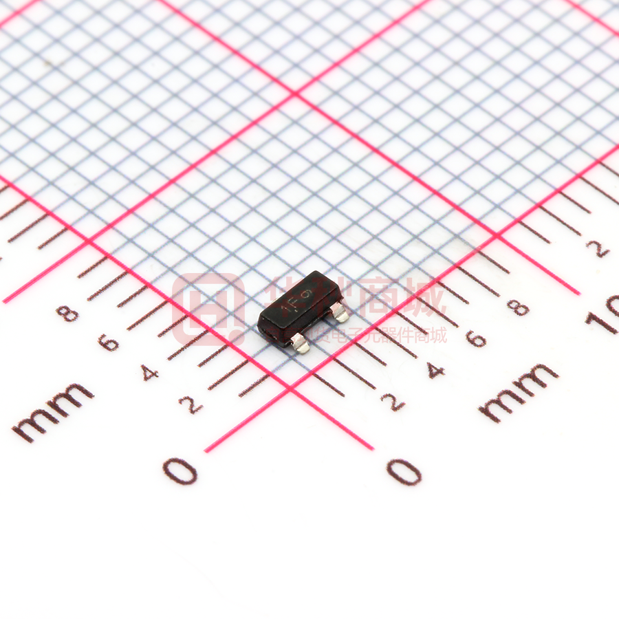

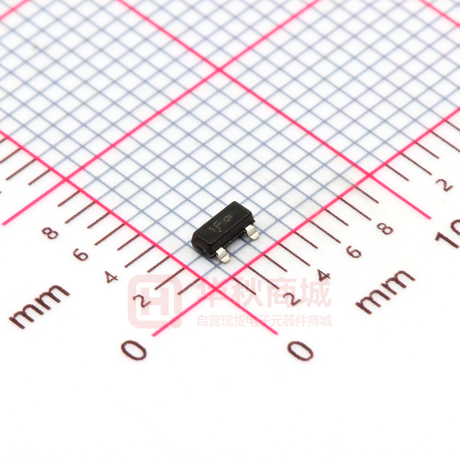

SBC847BLT1G
SBC847BLT1G
    ONSEMI(安森美)
    SOT-23
    晶体管类型:NPN 集射极击穿电压(Vceo):45V 集电极电流(Ic):100mA 功率(Pd):225mW 集电极截止电流(Icbo):15nA 集电极-发射极饱和电压(VCE(sat)@Ic,...
SBC847BLT1G 数据手册
DATA SHEET www.onsemi.com General Purpose Transistors COLLECTOR 3 1 BASE NPN Silicon 2 EMITTER BC846ALT1G Series Features 3 • Moisture Sensitivity Level: 1 • ESD Rating − Human Body Model: > 4000 V • • 1 ESD Rating − Machine Model: > 400 V S and NSV Prefix for Automotive and Other Applications Requiring Unique Site and Control Change Requirements; AEC−Q101 Qualified and PPAP Capable These Devices are Pb−Free, Halogen Free/BFR Free and are RoHS Compliant 2 SOT−23 CASE 318 STYLE 6 MARKING DIAGRAM MAXIMUM RATINGS Rating Symbol Collector-Emitter Voltage BC846 BC847, BC850 BC848, BC849 Collector−Base Voltage BC846 BC847, BC850 BC848, BC849 Emitter−Base Voltage BC846 BC847, BC850 BC848, BC849 Collector Current − Continuous VCEO VCBO VEBO IC Value XX M G G Unit Vdc 65 45 30 Vdc 80 50 30 1 XX M G = Device Code = Date Code* = Pb−Free Package (Note: Microdot may be in either location) *Date Code orientation and/or overbar may vary depending upon manufacturing location. Vdc 6.0 6.0 5.0 100 ORDERING INFORMATION mAdc See detailed ordering and shipping information in the package dimensions section on page 12 of this data sheet. Stresses exceeding those listed in the Maximum Ratings table may damage the device. If any of these limits are exceeded, device functionality should not be assumed, damage may occur and reliability may be affected. THERMAL CHARACTERISTICS Characteristic Total Device Dissipation FR− 5 Board, (Note 1) TA = 25°C Derate above 25°C Thermal Resistance, Junction−to−Ambient (Note 1) Total Device Dissipation Alumina Substrate (Note 2) TA = 25°C Derate above 25°C Thermal Resistance, Junction−to−Ambient (Note 2) Junction and Storage Temperature Range Symbol Max Unit PD 225 mW 1.8 mW/°C RqJA 556 °C/W PD 300 mW 2.4 mW/°C RqJA 417 °C/W TJ, Tstg −55 to +150 °C 1. FR− 5 = 1.0  0.75  0.062 in. 2. Alumina = 0.4  0.3  0.024 in 99.5% alumina. © Semiconductor Components Industries, LLC, 1994 August, 2021 − Rev. 19 1 Publication Order Number: BC846ALT1/D BC846ALT1G Series ELECTRICAL CHARACTERISTICS (TA = 25°C unless otherwise noted) Characteristic Symbol Min Typ Max Unit OFF CHARACTERISTICS Collector −Emitter Breakdown Voltage (IC = 10 mA) BC846A, B, C BC847A, B, C, BC850B, C BC848A, B, C, BC849B, C V(BR)CEO 65 45 30 − − − − − − V Collector −Emitter Breakdown Voltage (IC = 10 mA, VEB = 0) BC846A, B, C BC847A, B, C BC850B, C BC848A, B, C, BC849B, C V(BR)CES 80 50 30 − − − − − − V Collector −Base Breakdown Voltage (IC = 10 mA) BC846A, B, C BC847A, B, C, BC850B, C BC848A, B, C, BC849B, C V(BR)CBO 80 50 30 − − − − − − V Emitter −Base Breakdown Voltage (IE = 1.0 mA) BC846A, B, C BC847A, B, C, BC850B, C BC848A, B, C, BC849B, C V(BR)EBO 6.0 6.0 5.0 − − − − − − V ICBO − − − − 15 5.0 nA mA hFE − − − 90 150 270 − − − − 110 200 180 290 220 450 420 520 800 Collector Cutoff Current (VCB = 30 V) (VCB = 30 V, TA = 150°C) ON CHARACTERISTICS DC Current Gain (IC = 10 mA, VCE = 5.0 V) (IC = 2.0 mA, VCE = 5.0 V) BC846A, BC847A, BC848A BC846B, BC847B, BC848B BC846C, BC847C, BC848C BC846A, BC847A, BC848A BC846B, BC847B, BC848B, BC849B, BC850B BC846C, BC847C, BC848C, BC849C, BC850C Collector −Emitter Saturation Voltage (IC = 10 mA, IB = 0.5 mA) Collector −Emitter Saturation Voltage (IC = 100 mA, IB = 5.0 mA) VCE(sat) − − − − 0.25 0.6 V Base −Emitter Saturation Voltage (IC = 10 mA, IB = 0.5 mA) Base −Emitter Saturation Voltage (IC = 100 mA, IB = 5.0 mA) VBE(sat) − − 0.7 0.9 − − V Base −Emitter Voltage (IC = 2.0 mA, VCE = 5.0 V) Base −Emitter Voltage (IC = 10 mA, VCE = 5.0 V) VBE(on) 580 − 660 − 700 770 mV fT 100 − − MHz Cobo − − 4.5 SMALL− SIGNAL CHARACTERISTICS Current −Gain − Bandwidth Product (IC = 10 mA, VCE = 5.0 Vdc, f = 100 MHz) Output Capacitance (VCB = 10 V, f = 1.0 MHz) Noise Figure (IC = 0.2 mA, VCE = 5.0 Vdc, RS = 2.0 kW, f = 1.0 kHz, BW = 200 Hz) NF BC846A,B,C, BC847A,B,C, BC848A,B,C BC849B,C, BC850B,C pF dB − − − − 10 4.0 Product parametric performance is indicated in the Electrical Characteristics for the listed test conditions, unless otherwise noted. Product performance may not be indicated by the Electrical Characteristics if operated under different conditions. www.onsemi.com 2 BC846ALT1G Series BC846A, BC847A, BC848A, SBC846A 300 300 VCE = 1 V 200 25°C 100 −55°C 0 0.001 0.01 200 25°C 100 −55°C 0 1 0.1 VCE = 5 V 150°C hFE, DC CURRENT GAIN hFE, DC CURRENT GAIN 150°C 0.001 0.01 1 0.1 IC, COLLECTOR CURRENT (A) IC, COLLECTOR CURRENT (A) Figure 1. DC Current Gain vs. Collector Current Figure 2. DC Current Gain vs. Collector Current VCE(sat), COLLECTOR−EMITTER SATURATION VOLTAGE (V) 0.18 0.16 IC/IB = 20 150°C 0.14 0.12 25°C 0.10 0.08 0.06 −55°C 0.04 0.02 0 0.0001 0.001 0.01 0.1 IC, COLLECTOR CURRENT (A) Figure 3. Collector Emitter Saturation Voltage vs. Collector Current 0.9 VBE(on), BASE−EMITTER VOLTAGE (V) VBE(sat), BASE−EMITTER SATURATION VOLTAGE (V) 1.0 −55°C IC/IB = 20 0.8 25°C 0.7 0.6 150°C 0.5 0.4 0.3 0.2 0.0001 0.001 0.01 0.1 1.2 VCE = 5 V 1.1 1.0 −55°C 0.9 0.8 25°C 0.7 0.6 150°C 0.5 0.4 0.3 0.2 0.0001 0.001 0.01 IC, COLLECTOR CURRENT (A) IC, COLLECTOR CURRENT (A) Figure 4. Base Emitter Saturation Voltage vs. Collector Current Figure 5. Base Emitter Voltage vs. Collector Current www.onsemi.com 3 0.1 BC846ALT1G Series BC846A, BC847A, BC848A, SBC846A 1.0 θVB, TEMPERATURE COEFFICIENT (mV/ °C) VCE , COLLECTOR-EMITTER VOLTAGE (V) 2.0 TA = 25°C 1.6 IC = 200 mA 1.2 IC = IC = 10 mA 20 mA IC = 50 mA IC = 100 mA 0.8 0.4 0 0.02 10 0.1 1.0 IB, BASE CURRENT (mA) -55°C to +125°C 1.2 1.6 2.0 2.4 2.8 20 10 C, CAPACITANCE (pF) 5.0 TA = 25°C Cib 3.0 Cob 2.0 1.0 0.4 0.6 0.8 1.0 2.0 20 4.0 6.0 8.0 10 VR, REVERSE VOLTAGE (VOLTS) 100 Figure 7. Base−Emitter Temperature Coefficient 40 f, T CURRENT-GAIN - BANDWIDTH PRODUCT (MHz) Figure 6. Collector Saturation Region 7.0 10 1.0 IC, COLLECTOR CURRENT (mA) 0.2 Figure 8. Capacitances 400 300 200 VCE = 10 V TA = 25°C 100 80 60 40 30 20 0.5 0.7 1.0 2.0 3.0 5.0 7.0 10 20 IC, COLLECTOR CURRENT (mAdc) 30 Figure 9. Current−Gain − Bandwidth Product www.onsemi.com 4 50 BC846ALT1G Series BC846B, SBC846B 600 VCE = 1 V 150°C 500 hFE, DC CURRENT GAIN hFE, DC CURRENT GAIN 600 400 25°C 300 200 −55°C 100 0 0.001 0.01 400 25°C 300 200 −55°C 100 0 1 0.1 VCE = 5 V 150°C 500 0.001 0.01 1 0.1 IC, COLLECTOR CURRENT (A) IC, COLLECTOR CURRENT (A) Figure 10. DC Current Gain vs. Collector Current Figure 11. DC Current Gain vs. Collector Current VCE(sat), COLLECTOR−EMITTER SATURATION VOLTAGE (V) 0.30 IC/IB = 20 150°C 0.25 0.20 25°C 0.15 0.10 −55°C 0.05 0 0.0001 0.001 0.01 0.1 IC, COLLECTOR CURRENT (A) Figure 12. Collector Emitter Saturation Voltage vs. Collector Current 1.0 IC/IB = 20 VBE(on), BASE−EMITTER VOLTAGE (V) VBE(sat), BASE−EMITTER SATURATION VOLTAGE (V) 1.1 −55°C 0.9 25°C 0.8 0.7 150°C 0.6 0.5 0.4 0.3 0.2 0.0001 0.001 0.01 0.1 1.2 VCE = 5 V 1.1 1.0 −55°C 0.9 0.8 25°C 0.7 0.6 150°C 0.5 0.4 0.3 0.2 0.0001 0.001 0.01 IC, COLLECTOR CURRENT (A) IC, COLLECTOR CURRENT (A) Figure 13. Base Emitter Saturation Voltage vs. Collector Current Figure 14. Base Emitter Voltage vs. Collector Current www.onsemi.com 5 0.1 BC846ALT1G Series 1.0 2.0 θVB, TEMPERATURE COEFFICIENT (mV/ °C) VCE , COLLECTOR-EMITTER VOLTAGE (VOLTS) BC846B, SBC846B TA = 25°C 1.6 20 mA 50 mA 100 mA 200 mA 1.2 IC = 10 mA 0.8 0.4 0 0.02 0.05 0.1 0.2 0.5 1.0 2.0 IB, BASE CURRENT (mA) 5.0 10 1.4 1.8 qVB for VBE 2.6 3.0 20 0.2 Figure 15. Collector Saturation Region f, T CURRENT-GAIN - BANDWIDTH PRODUCT C, CAPACITANCE (pF) TA = 25°C 20 Cib 10 6.0 2.0 Cob 0.1 0.2 1.0 2.0 10 20 0.5 5.0 VR, REVERSE VOLTAGE (VOLTS) 50 0.5 10 20 50 1.0 2.0 5.0 IC, COLLECTOR CURRENT (mA) 100 200 Figure 16. Base−Emitter Temperature Coefficient 40 4.0 -55°C to 125°C 2.2 VCE = 5 V TA = 25°C 500 200 100 50 20 1.0 5.0 10 50 100 IC, COLLECTOR CURRENT (mA) 100 Figure 17. Capacitance Figure 18. Current−Gain − Bandwidth Product www.onsemi.com 6 BC846ALT1G Series BC847B, BC848B, BC849B, BC850B, SBC847B, SBC848B 600 VCE = 1 V 150°C 500 hFE, DC CURRENT GAIN hFE, DC CURRENT GAIN 600 400 25°C 300 200 −55°C 100 0 0.001 0.01 400 25°C 300 200 −55°C 100 0 1 0.1 VCE = 5 V 150°C 500 0.001 0.01 1 0.1 IC, COLLECTOR CURRENT (A) IC, COLLECTOR CURRENT (A) Figure 19. DC Current Gain vs. Collector Current Figure 20. DC Current Gain vs. Collector Current VCE(sat), COLLECTOR−EMITTER SATURATION VOLTAGE (V) 0.30 IC/IB = 20 0.25 150°C 0.20 25°C 0.15 0.10 −55°C 0.05 0 0.0001 0.001 0.01 0.1 IC, COLLECTOR CURRENT (A) Figure 21. Collector Emitter Saturation Voltage vs. Collector Current VBE(sat), BASE−EMITTER SATURATION VOLTAGE (V) 1.0 IC/IB = 20 VBE(on), BASE−EMITTER VOLTAGE (V) 1.1 −55°C 0.9 25°C 0.8 0.7 150°C 0.6 0.5 0.4 0.3 0.2 0.0001 0.001 0.01 0.1 1.2 VCE = 5 V 1.1 1.0 −55°C 0.9 0.8 25°C 0.7 0.6 150°C 0.5 0.4 0.3 0.2 0.0001 0.001 0.01 IC, COLLECTOR CURRENT (A) IC, COLLECTOR CURRENT (A) Figure 22. Base Emitter Saturation Voltage vs. Collector Current Figure 23. Base Emitter Voltage vs. Collector Current www.onsemi.com 7 0.1 BC846ALT1G Series BC847B, BC848B, BC849B, BC850B, SBC846B, SBC847B, SBC848B 1.0 θVB, TEMPERATURE COEFFICIENT (mV/ °C) VCE , COLLECTOR-EMITTER VOLTAGE (V) 2.0 TA = 25°C 1.6 IC = 200 mA 1.2 IC = IC = 10 mA 20 mA IC = 50 mA IC = 100 mA 0.8 0.4 0 0.02 10 0.1 1.0 IB, BASE CURRENT (mA) -55°C to +125°C 1.2 1.6 2.0 2.4 2.8 20 10 C, CAPACITANCE (pF) 5.0 TA = 25°C Cib 3.0 Cob 2.0 1.0 0.4 0.6 0.8 1.0 2.0 20 4.0 6.0 8.0 10 VR, REVERSE VOLTAGE (VOLTS) 100 Figure 25. Base−Emitter Temperature Coefficient 40 f, T CURRENT-GAIN - BANDWIDTH PRODUCT (MHz) Figure 24. Collector Saturation Region 7.0 10 1.0 IC, COLLECTOR CURRENT (mA) 0.2 Figure 26. Capacitances 400 300 200 VCE = 10 V TA = 25°C 100 80 60 40 30 20 0.5 0.7 1.0 2.0 3.0 5.0 7.0 10 20 IC, COLLECTOR CURRENT (mAdc) 30 Figure 27. Current−Gain − Bandwidth Product www.onsemi.com 8 50 BC846ALT1G Series BC846C, BC847C, BC848C, BC849C, BC850C, SBC847C 1000 1000 VCE = 1 V 150°C 800 700 600 25°C 500 400 300 −55°C 200 100 0 VCE = 5 V 900 150°C hFE, DC CURRENT GAIN hFE, DC CURRENT GAIN 900 800 700 600 25°C 500 400 −55°C 300 200 100 0.001 0.01 0 1 0.1 0.001 0.01 1 0.1 IC, COLLECTOR CURRENT (A) IC, COLLECTOR CURRENT (A) Figure 28. DC Current Gain vs. Collector Current Figure 29. DC Current Gain vs. Collector Current VCE(sat), COLLECTOR−EMITTER SATURATION VOLTAGE (V) 0.30 IC/IB = 20 0.25 150°C 0.20 25°C 0.15 0.10 −55°C 0.05 0 0.0001 0.001 0.01 0.1 IC, COLLECTOR CURRENT (A) Figure 30. Collector Emitter Saturation Voltage vs. Collector Current VBE(sat), BASE−EMITTER SATURATION VOLTAGE (V) 1.0 IC/IB = 20 VBE(on), BASE−EMITTER VOLTAGE (V) 1.1 −55°C 0.9 25°C 0.8 0.7 150°C 0.6 0.5 0.4 0.3 0.2 0.0001 0.001 0.01 0.1 1.2 VCE = 5 V 1.1 1.0 −55°C 0.9 0.8 25°C 0.7 0.6 150°C 0.5 0.4 0.3 0.2 0.0001 0.001 0.01 IC, COLLECTOR CURRENT (A) IC, COLLECTOR CURRENT (A) Figure 31. Base Emitter Saturation Voltage vs. Collector Current Figure 32. Base Emitter Voltage vs. Collector Current www.onsemi.com 9 0.1 BC846ALT1G Series BC846C, BC847C, BC848C, BC849C, BC850C, SBC847C 1.0 θVB, TEMPERATURE COEFFICIENT (mV/ °C) VCE , COLLECTOR-EMITTER VOLTAGE (V) 2.0 TA = 25°C 1.6 IC = 200 mA 1.2 IC = IC = 10 mA 20 mA IC = 50 mA IC = 100 mA 0.8 0.4 0 0.02 10 0.1 1.0 IB, BASE CURRENT (mA) -55°C to +125°C 1.2 1.6 2.0 2.4 2.8 20 10 C, CAPACITANCE (pF) 5.0 TA = 25°C Cib 3.0 Cob 2.0 1.0 0.4 0.6 0.8 1.0 2.0 20 4.0 6.0 8.0 10 VR, REVERSE VOLTAGE (VOLTS) 100 Figure 34. Base−Emitter Temperature Coefficient 40 f, T CURRENT-GAIN - BANDWIDTH PRODUCT (MHz) Figure 33. Collector Saturation Region 7.0 10 1.0 IC, COLLECTOR CURRENT (mA) 0.2 Figure 35. Capacitances 400 300 200 VCE = 10 V TA = 25°C 100 80 60 40 30 20 0.5 0.7 1.0 2.0 3.0 5.0 7.0 10 20 IC, COLLECTOR CURRENT (mAdc) 30 Figure 36. Current−Gain − Bandwidth Product www.onsemi.com 10 50 BC846ALT1G Series 1 1S 0.1 IC, COLLECTOR CURRENT (A) 100 mS 10 mS 1 mS Thermal Limit 0.01 0.001 1 10 100 100 mS 10 mS 1 mS 0.1 1S Thermal Limit 0.01 0.001 0.1 1 10 100 VCE, COLLECTOR EMITTER VOLTAGE (V) VCE, COLLECTOR EMITTER VOLTAGE (V) Figure 37. Safe Operating Area for BC846A, BC846B, BC846C Figure 38. Safe Operating Area for BC847A, BC847B, BC847C, BC850B, BC850C 1 IC, COLLECTOR CURRENT (A) IC, COLLECTOR CURRENT (A) 1 100 mS 10 mS 1S 0.1 Thermal Limit 0.01 0.001 1 mS 0.1 1 10 VCE, COLLECTOR EMITTER VOLTAGE (V) Figure 39. Safe Operating Area for BC848A, BC848B, BC848C, BC849B, BC849C www.onsemi.com 11 100 BC846ALT1G Series ORDERING INFORMATION Device Marking Package BC846ALT1G SBC846ALT1G* 3,000 / Tape & Reel 1A BC846ALT3G 10,000 / Tape & Reel BC846BLT1G SBC846BLT1G* BC846BLT3G 3,000 / Tape & Reel 1B 10,000 / Tape & Reel SBC846BLT3G* BC846CLT1G BC847ALT1G BC847ALT3G 3C 3,000 / Tape & Reel 3,000 / Tape & Reel 1E 10,000 / Tape & Reel BC847BLT1G SBC847BLT1G* BC847BLT3G 3,000 / Tape & Reel 1F 10,000 / Tape & Reel NSVBC847BLT3G* BC847CLT1G SBC847CLT1G* 3,000 / Tape & Reel 1G SOT−23 (Pb−Free) BC847CLT3G BC848ALT1G 1J 3,000 / Tape & Reel 1K BC848BLT3G 10,000 / Tape & Reel BC848CLT1G NSVBC848CLT1G* 3,000 / Tape & Reel 1L BC848CLT3G 10,000 / Tape & Reel BC849BLT1G NSVBC849BLT1G* 3,000 / Tape & Reel 2B BC849BLT3G BC849CLT1G BC849CLT3G BC850BLT1G NSVBC850BLT1G* BC850CLT1G NSVBC850CLT1G* 10,000 / Tape & Reel 3,000 / Tape & Reel BC848BLT1G SBC848BLT1G* Shipping† 10,000 / Tape & Reel 3,000 / Tape & Reel 2C 10,000 / Tape & Reel 2F 3,000 / Tape & Reel 2G †For information on tape and reel specifications, including part orientation and tape sizes, please refer to our Tape and Reel Packaging Specifications Brochure, BRD8011/D. *S and NSV Prefix for Automotive and Other Applications Requiring Unique Site and Control Change Requirements; AEC−Q101 Qualified and PPAP Capable. www.onsemi.com 12 MECHANICAL CASE OUTLINE PACKAGE DIMENSIONS SOT−23 (TO−236) CASE 318−08 ISSUE AS DATE 30 JAN 2018 SCALE 4:1 D 0.25 3 E 1 2 T HE NOTES: 1. DIMENSIONING AND TOLERANCING PER ASME Y14.5M, 1994. 2. CONTROLLING DIMENSION: MILLIMETERS. 3. MAXIMUM LEAD THICKNESS INCLUDES LEAD FINISH. MINIMUM LEAD THICKNESS IS THE MINIMUM THICKNESS OF THE BASE MATERIAL. 4. DIMENSIONS D AND E DO NOT INCLUDE MOLD FLASH, PROTRUSIONS, OR GATE BURRS. DIM A A1 b c D E e L L1 HE T L 3X b L1 VIEW C e TOP VIEW A A1 SIDE VIEW SEE VIEW C c MIN 0.89 0.01 0.37 0.08 2.80 1.20 1.78 0.30 0.35 2.10 0° MILLIMETERS NOM MAX 1.00 1.11 0.06 0.10 0.44 0.50 0.14 0.20 2.90 3.04 1.30 1.40 1.90 2.04 0.43 0.55 0.54 0.69 2.40 2.64 −−− 10 ° MIN 0.035 0.000 0.015 0.003 0.110 0.047 0.070 0.012 0.014 0.083 0° INCHES NOM 0.039 0.002 0.017 0.006 0.114 0.051 0.075 0.017 0.021 0.094 −−− MAX 0.044 0.004 0.020 0.008 0.120 0.055 0.080 0.022 0.027 0.104 10° GENERIC MARKING DIAGRAM* END VIEW RECOMMENDED SOLDERING FOOTPRINT XXXMG G 1 3X 2.90 3X XXX = Specific Device Code M = Date Code G = Pb−Free Package 0.90 *This information is generic. Please refer to device data sheet for actual part marking. Pb−Free indicator, “G” or microdot “ G”, may or may not be present. 0.95 PITCH 0.80 DIMENSIONS: MILLIMETERS STYLE 1 THRU 5: CANCELLED STYLE 6: PIN 1. BASE 2. EMITTER 3. COLLECTOR STYLE 7: PIN 1. EMITTER 2. BASE 3. COLLECTOR STYLE 9: PIN 1. ANODE 2. ANODE 3. CATHODE STYLE 10: PIN 1. DRAIN 2. SOURCE 3. GATE STYLE 11: STYLE 12: PIN 1. ANODE PIN 1. CATHODE 2. CATHODE 2. CATHODE 3. CATHODE−ANODE 3. ANODE STYLE 15: PIN 1. GATE 2. CATHODE 3. ANODE STYLE 16: PIN 1. ANODE 2. CATHODE 3. CATHODE STYLE 17: PIN 1. NO CONNECTION 2. ANODE 3. CATHODE STYLE 18: STYLE 19: STYLE 20: PIN 1. NO CONNECTION PIN 1. CATHODE PIN 1. CATHODE 2. CATHODE 2. ANODE 2. ANODE 3. GATE 3. ANODE 3. CATHODE−ANODE STYLE 21: PIN 1. GATE 2. SOURCE 3. DRAIN STYLE 22: PIN 1. RETURN 2. OUTPUT 3. INPUT STYLE 23: PIN 1. ANODE 2. ANODE 3. CATHODE STYLE 24: PIN 1. GATE 2. DRAIN 3. SOURCE STYLE 27: PIN 1. CATHODE 2. CATHODE 3. CATHODE STYLE 28: PIN 1. ANODE 2. ANODE 3. ANODE DOCUMENT NUMBER: DESCRIPTION: 98ASB42226B SOT−23 (TO−236) STYLE 8: PIN 1. ANODE 2. NO CONNECTION 3. CATHODE STYLE 13: PIN 1. SOURCE 2. DRAIN 3. GATE STYLE 25: PIN 1. ANODE 2. CATHODE 3. GATE STYLE 14: PIN 1. CATHODE 2. GATE 3. ANODE STYLE 26: PIN 1. CATHODE 2. ANODE 3. NO CONNECTION Electronic versions are uncontrolled except when accessed directly from the Document Repository. Printed versions are uncontrolled except when stamped “CONTROLLED COPY” in red. PAGE 1 OF 1 ON Semiconductor and are trademarks of Semiconductor Components Industries, LLC dba ON Semiconductor or its subsidiaries in the United States and/or other countries. ON Semiconductor reserves the right to make changes without further notice to any products herein. ON Semiconductor makes no warranty, representation or guarantee regarding the suitability of its products for any particular purpose, nor does ON Semiconductor assume any liability arising out of the application or use of any product or circuit, and specifically disclaims any and all liability, including without limitation special, consequential or incidental damages. ON Semiconductor does not convey any license under its patent rights nor the rights of others. © Semiconductor Components Industries, LLC, 2019 www.onsemi.com onsemi, , and other names, marks, and brands are registered and/or common law trademarks of Semiconductor Components Industries, LLC dba “onsemi” or its affiliates and/or subsidiaries in the United States and/or other countries. onsemi owns the rights to a number of patents, trademarks, copyrights, trade secrets, and other intellectual property. A listing of onsemi’s product/patent coverage may be accessed at www.onsemi.com/site/pdf/Patent−Marking.pdf. onsemi reserves the right to make changes at any time to any products or information herein, without notice. The information herein is provided “as−is” and onsemi makes no warranty, representation or guarantee regarding the accuracy of the information, product features, availability, functionality, or suitability of its products for any particular purpose, nor does onsemi assume any liability arising out of the application or use of any product or circuit, and specifically disclaims any and all liability, including without limitation special, consequential or incidental damages. Buyer is responsible for its products and applications using onsemi products, including compliance with all laws, regulations and safety requirements or standards, regardless of any support or applications information provided by onsemi. “Typical” parameters which may be provided in onsemi data sheets and/or specifications can and do vary in different applications and actual performance may vary over time. All operating parameters, including “Typicals” must be validated for each customer application by customer’s technical experts. onsemi does not convey any license under any of its intellectual property rights nor the rights of others. onsemi products are not designed, intended, or authorized for use as a critical component in life support systems or any FDA Class 3 medical devices or medical devices with a same or similar classification in a foreign jurisdiction or any devices intended for implantation in the human body. Should Buyer purchase or use onsemi products for any such unintended or unauthorized application, Buyer shall indemnify and hold onsemi and its officers, employees, subsidiaries, affiliates, and distributors harmless against all claims, costs, damages, and expenses, and reasonable attorney fees arising out of, directly or indirectly, any claim of personal injury or death associated with such unintended or unauthorized use, even if such claim alleges that onsemi was negligent regarding the design or manufacture of the part. onsemi is an Equal Opportunity/Affirmative Action Employer. This literature is subject to all applicable copyright laws and is not for resale in any manner. PUBLICATION ORDERING INFORMATION LITERATURE FULFILLMENT: Email Requests to: orderlit@onsemi.com onsemi Website: www.onsemi.com ◊ TECHNICAL SUPPORT North American Technical Support: Voice Mail: 1 800−282−9855 Toll Free USA/Canada Phone: 011 421 33 790 2910 Europe, Middle East and Africa Technical Support: Phone: 00421 33 790 2910 For additional information, please contact your local Sales Representative
