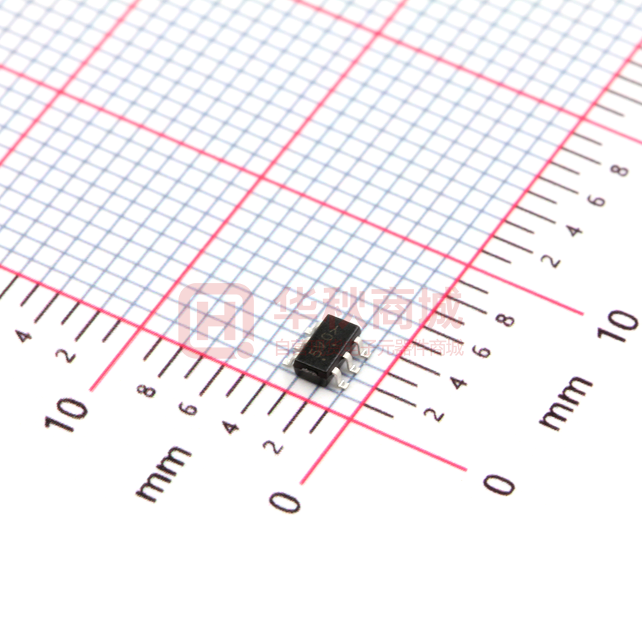

SC-74 Quad ESD and Surge Protector Surge Protection Up to 350 W Peak Power SMS05T1 Series This quad monolithic silicon ESD and Surge Protector is designed for applications requiring ESD protection. It is intended for use in voltage and ESD sensitive equipment such as computers, printers, business machines, communication systems and other applications. This quad device provides superior surge protection over current quad Zener MMQA series by providing up to 350 watts peak power. Features www.onsemi.com SC−74 QUAD ESD AND SURGE PROTECTOR 350 WATTS PEAK POWER 5 VOLTS • SC-74 Package Allows Four Separate Unidirectional Configurations • Peak Power − 350 W, 8 x 20 ms • ESD Rating of Class N (Exceeding 25 kV) per 6 • SC−74 CASE 318F STYLE 1 • • • 1 the Human Body Model ESD Rating: IEC 61000−4−2 (ESD) 15 kV (Air) 8 kV (Contact) IEC 61000−4−4 (EFT) 40 A (5/5 ns) IEC 61000−4−5 (Surge) 23 A (8/20 ms) UL Flammability Rating of 94 V−0 These Devices are Pb−Free and are RoHS Compliant SZ Prefix for Automotive and Other Applications Requiring Unique Site and Control Change Requirements; AEC−Q101 Qualified and PPAP Capable Typical Applications • Hand Held Portable Applications such as Cell Phones, Pagers, Notebooks and Notebook Computers MAXIMUM RATINGS Symbol Value Unit Peak Power Dissipation 8 x 20 mS @ TA = 25°C (Note 1) Rating Ppk 350 W Total Power Dissipation on FR−5 Board @ TA = 25°C (Note 2) Derate Above 25°C PD 225 mW 1.8 mW/°C Thermal Resistance, Junction−to−Ambient RqJA 556 °C/W Junction and Storage Temperature Range TJ, Tstg −55 to +150 °C TL 260 °C Lead Solder Temperature Maximum 10 Seconds Duration Stresses exceeding those listed in the Maximum Ratings table may damage the device. If any of these limits are exceeded, device functionality should not be assumed, damage may occur and reliability may be affected. 1. Non−repetitive current pulse 8 x 20 ms exponential decay waveform. 2. FR−5 = 1.0 x 0.75 x 0.62 in. MARKING DIAGRAM xxx M G G 1 xxx = Specific Device Code M = Date Code* G = Pb−Free Package (Note: Microdot may be in either location) *Date Code orientation and/or position may vary depending upon manufacturing location. PIN ASSIGNMENT 1 6 2 5 3 4 PIN 1. 2. 3. 4. 5. 6. CATHODE ANODE CATHODE CATHODE ANODE CATHODE DEVICE MARKING INFORMATION See specific marking information in the device marking column of the Electrical Characteristics table on page 2 of this data sheet. ORDERING INFORMATION See detailed ordering, marking and shipping information in the ordering information section on page 2 of this data sheet. © Semiconductor Components Industries, LLC, 2014 November, 2019 − Rev. 9 1 Publication Order Number: SMS05T1/D SMS05T1 Series ELECTRICAL CHARACTERISTICS (TA = 25°C unless otherwise noted) Symbol Parameter IPP Maximum Reverse Peak Pulse Current VC Clamping Voltage @ IPP VRWM IR VBR IT QVBR I IF Working Peak Reverse Voltage Maximum Reverse Leakage Current @ VRWM Breakdown Voltage @ IT VC VBR VRWM Maximum Temperature Coefficient of VBR IF Forward Current VF Forward Voltage @ IF ZZT Maximum Zener Impedance @ IZT IZK Reverse Current ZZK Maximum Zener Impedance @ IZK V IR VF IT Test Current IPP Uni−Directional ELECTRICAL CHARACTERISTICS − UNIDIRECTIONAL Max Reverse Leakage Current Max Reverse Voltage (Clamping Voltage) At Specified Reverse Surge Current (IRSM) Max Reverse Voltage (Clamping Voltage) At Specified Reverse Surge Current (IRSM) IT IR VR IRSM (8x20 ms) VRSM (8x20 ms) IRSM (8x20 ms) VRSM (8x20 ms) Breakdown Voltage VBR(V) Capacitance @ 0 Volt Bias, 1 MHz (pF) Device* Device Marking Min Nom Max (mA) (mA) (V) (A) (V) (A) (V) Min Max SMS05T1G 5V0 6.0 − 7.2 1.0 20 5.0 5.0 9.8 23 15.5 250 400 SMS12T1G 12V 13.3 − 15 1.0 1.0 12 5.0 19.0 15 23.0 80 150 SMS15T1G 15V 16.7 − 18.5 1.0 1.0 15 5.0 24.0 12 29.0 60 125 SMS24T1G 24V 26.7 − 32 1.0 1.0 24 5.0 40.0 8 44.0 40 75 *Includes SZ−prefix devices where applicable. ORDERING INFORMATION Package Shipping† SMS05T1G, SZSMS05T1G** SC−74 (Pb−Free) 3000 / Tape & Reel SMS12T1G SC−74 (Pb−Free) 3000 / Tape & Reel SMS15T1G, SZSMS15T1G** SC−74 (Pb−Free) 3000 / Tape & Reel SMS24T1G, SZSMS24T1G** SC−74 (Pb−Free) 3000 / Tape & Reel Device †For information on tape and reel specifications, including part orientation and tape sizes, please refer to our Tape and Reel Packaging Specifications Brochure, BRD8011/D. **SZ Prefix for Automotive and Other Applications Requiring Unique Site and Control Change Requirements; AEC−Q101 Qualified and PPAP Capable. www.onsemi.com 2 SMS05T1 Series TYPICAL CHARACTERISTICS 110 100 % OF RATED POWER OR IPP PPP, PEAK PULSE POWER (kW) 10 1 0.1 0.01 0.1 1 10 100 90 80 70 60 50 40 30 20 10 0 1000 100 125 150 50 WAVEFORM PARAMETERS tr = 8 ms td = 20 ms 80 70 VC, CLAMPING VOLTAGE (V) PERCENT OF IPP 75 Figure 2. Power Derating Curve 90 c−t 60 td = IPP/2 50 40 30 20 0 5 10 15 20 45 WAVEFORM PARAMETERS tr = 8 ms td = 20 ms SMS24 40 35 30 SMS15 25 SMS12 20 15 SMS05 10 5 0 30 25 0 5 10 15 20 25 t, TIME (ms) IPP, PEAK PULSE CURRENT (A) Figure 3. Pulse Waveform Figure 4. Clamping Voltage versus Peak Pulse Current 300 5 PULSE WAVEFORM tr = 8 ms td = 20 ms 4 250 3 C, CAPACITANCE (pF) VF, FORWARD VOLTAGE (V) 50 Figure 1. Non−Repetitive Peak Pulse Power versus Pulse Time 110 8 X 20 ms SURGE 2 1 0 25 TA, AMBIENT TEMPERATURE (°C) 100 10 0 0 tp, PULSE DURATION (ms) TJ = 25°C 200 SMS05 150 100 SMS12 50 0 5 10 15 0 20 SMS15 0 5 10 SMS24 15 20 25 IF, FORWARD CURRENT (A) VR, REVERSE VOLTAGE (V) Figure 5. 8 x 20 ms VF Figure 6. Typical Capacitance (SMS05 Series) www.onsemi.com 3 MECHANICAL CASE OUTLINE PACKAGE DIMENSIONS SC−74 CASE 318F ISSUE P 6 1 SCALE 2:1 DATE 07 OCT 2021 GENERIC MARKING DIAGRAM* XXX MG G XXX M G = Specific Device Code = Date Code = Pb−Free Package (Note: Microdot may be in either location) *This information is generic. Please refer to device data sheet for actual part marking. Pb−Free indicator, “G” or microdot “G”, may or may not be present. Some products may not follow the Generic Marking. STYLE 1: PIN 1. CATHODE 2. ANODE 3. CATHODE 4. CATHODE 5. ANODE 6. CATHODE STYLE 2: PIN 1. NO CONNECTION 2. COLLECTOR 3. EMITTER 4. NO CONNECTION 5. COLLECTOR 6. BASE STYLE 3: PIN 1. EMITTER 1 2. BASE 1 3. COLLECTOR 2 4. EMITTER 2 5. BASE 2 6. COLLECTOR 1 STYLE 4: PIN 1. COLLECTOR 2 2. EMITTER 1/EMITTER 2 3. COLLECTOR 1 4. EMITTER 3 5. BASE 1/BASE 2/COLLECTOR 3 6. BASE 3 STYLE 5: PIN 1. CHANNEL 1 2. ANODE 3. CHANNEL 2 4. CHANNEL 3 5. CATHODE 6. CHANNEL 4 STYLE 7: PIN 1. SOURCE 1 2. GATE 1 3. DRAIN 2 4. SOURCE 2 5. GATE 2 6. DRAIN 1 STYLE 8: PIN 1. EMITTER 1 2. BASE 2 3. COLLECTOR 2 4. EMITTER 2 5. BASE 1 6. COLLECTOR 1 STYLE 9: PIN 1. EMITTER 2 2. BASE 2 3. COLLECTOR 1 4. EMITTER 1 5. BASE 1 6. COLLECTOR 2 STYLE 10: PIN 1. ANODE/CATHODE 2. BASE 3. EMITTER 4. COLLECTOR 5. ANODE 6. CATHODE STYLE 11: PIN 1. EMITTER 2. BASE 3. ANODE/CATHODE 4. ANODE 5. CATHODE 6. COLLECTOR DOCUMENT NUMBER: DESCRIPTION: 98ASB42973B SC−74 STYLE 6: PIN 1. CATHODE 2. ANODE 3. CATHODE 4. CATHODE 5. CATHODE 6. CATHODE Electronic versions are uncontrolled except when accessed directly from the Document Repository. Printed versions are uncontrolled except when stamped “CONTROLLED COPY” in red. PAGE 1 OF 1 onsemi and are trademarks of Semiconductor Components Industries, LLC dba onsemi or its subsidiaries in the United States and/or other countries. onsemi reserves the right to make changes without further notice to any products herein. onsemi makes no warranty, representation or guarantee regarding the suitability of its products for any particular purpose, nor does onsemi assume any liability arising out of the application or use of any product or circuit, and specifically disclaims any and all liability, including without limitation special, consequential or incidental damages. onsemi does not convey any license under its patent rights nor the rights of others. © Semiconductor Components Industries, LLC, 2019 www.onsemi.com onsemi, , and other names, marks, and brands are registered and/or common law trademarks of Semiconductor Components Industries, LLC dba “onsemi” or its affiliates and/or subsidiaries in the United States and/or other countries. onsemi owns the rights to a number of patents, trademarks, copyrights, trade secrets, and other intellectual property. A listing of onsemi’s product/patent coverage may be accessed at www.onsemi.com/site/pdf/Patent−Marking.pdf. onsemi reserves the right to make changes at any time to any products or information herein, without notice. The information herein is provided “as−is” and onsemi makes no warranty, representation or guarantee regarding the accuracy of the information, product features, availability, functionality, or suitability of its products for any particular purpose, nor does onsemi assume any liability arising out of the application or use of any product or circuit, and specifically disclaims any and all liability, including without limitation special, consequential or incidental damages. Buyer is responsible for its products and applications using onsemi products, including compliance with all laws, regulations and safety requirements or standards, regardless of any support or applications information provided by onsemi. “Typical” parameters which may be provided in onsemi data sheets and/or specifications can and do vary in different applications and actual performance may vary over time. All operating parameters, including “Typicals” must be validated for each customer application by customer’s technical experts. onsemi does not convey any license under any of its intellectual property rights nor the rights of others. onsemi products are not designed, intended, or authorized for use as a critical component in life support systems or any FDA Class 3 medical devices or medical devices with a same or similar classification in a foreign jurisdiction or any devices intended for implantation in the human body. Should Buyer purchase or use onsemi products for any such unintended or unauthorized application, Buyer shall indemnify and hold onsemi and its officers, employees, subsidiaries, affiliates, and distributors harmless against all claims, costs, damages, and expenses, and reasonable attorney fees arising out of, directly or indirectly, any claim of personal injury or death associated with such unintended or unauthorized use, even if such claim alleges that onsemi was negligent regarding the design or manufacture of the part. onsemi is an Equal Opportunity/Affirmative Action Employer. This literature is subject to all applicable copyright laws and is not for resale in any manner. PUBLICATION ORDERING INFORMATION LITERATURE FULFILLMENT: Email Requests to: orderlit@onsemi.com onsemi Website: www.onsemi.com ◊ TECHNICAL SUPPORT North American Technical Support: Voice Mail: 1 800−282−9855 Toll Free USA/Canada Phone: 011 421 33 790 2910 Europe, Middle East and Africa Technical Support: Phone: 00421 33 790 2910 For additional information, please contact your local Sales Representative
